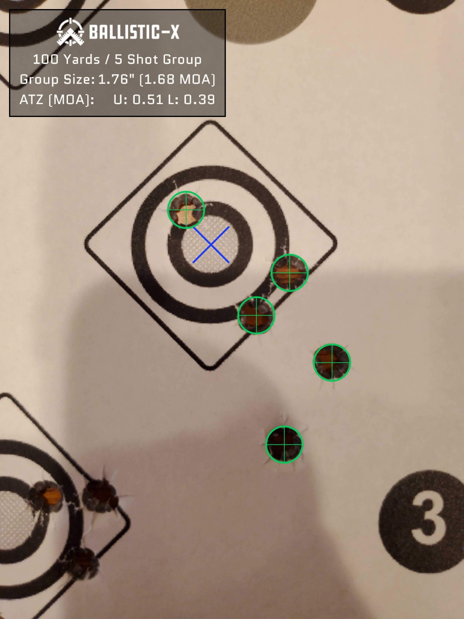

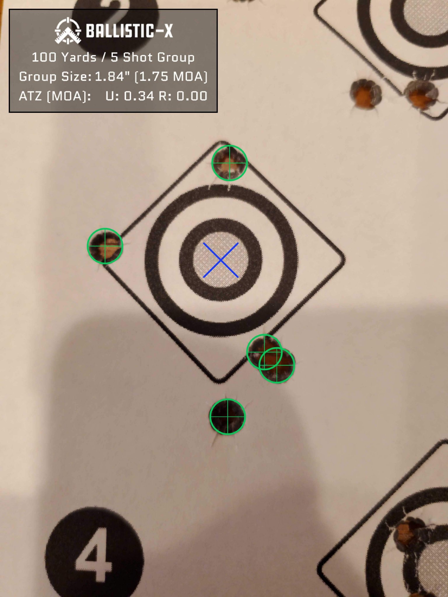

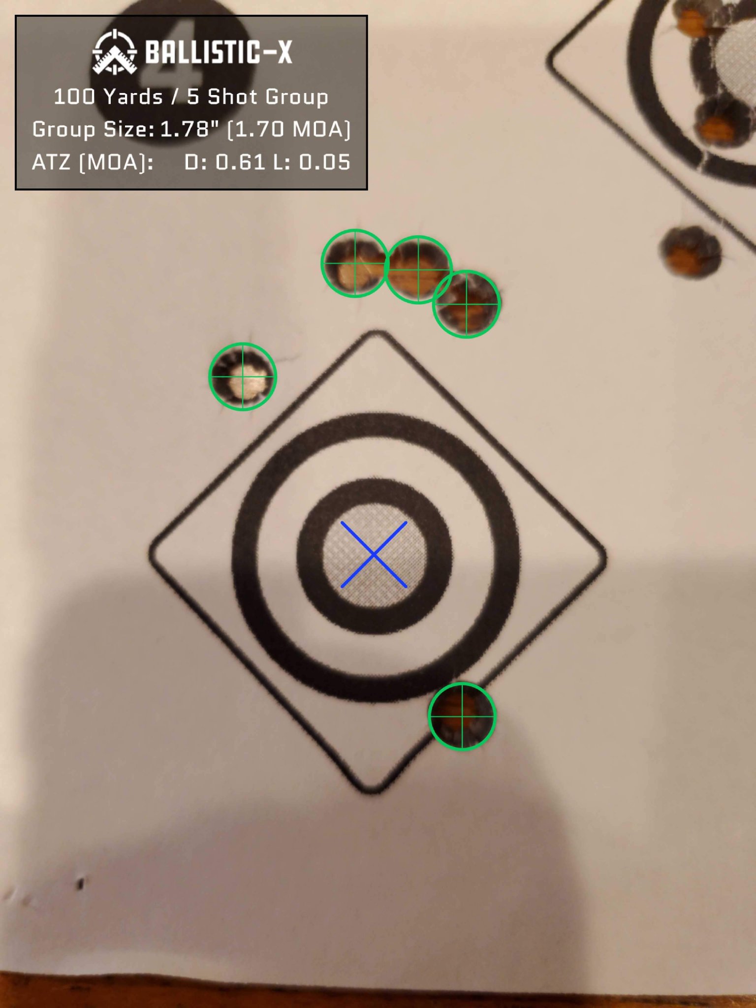

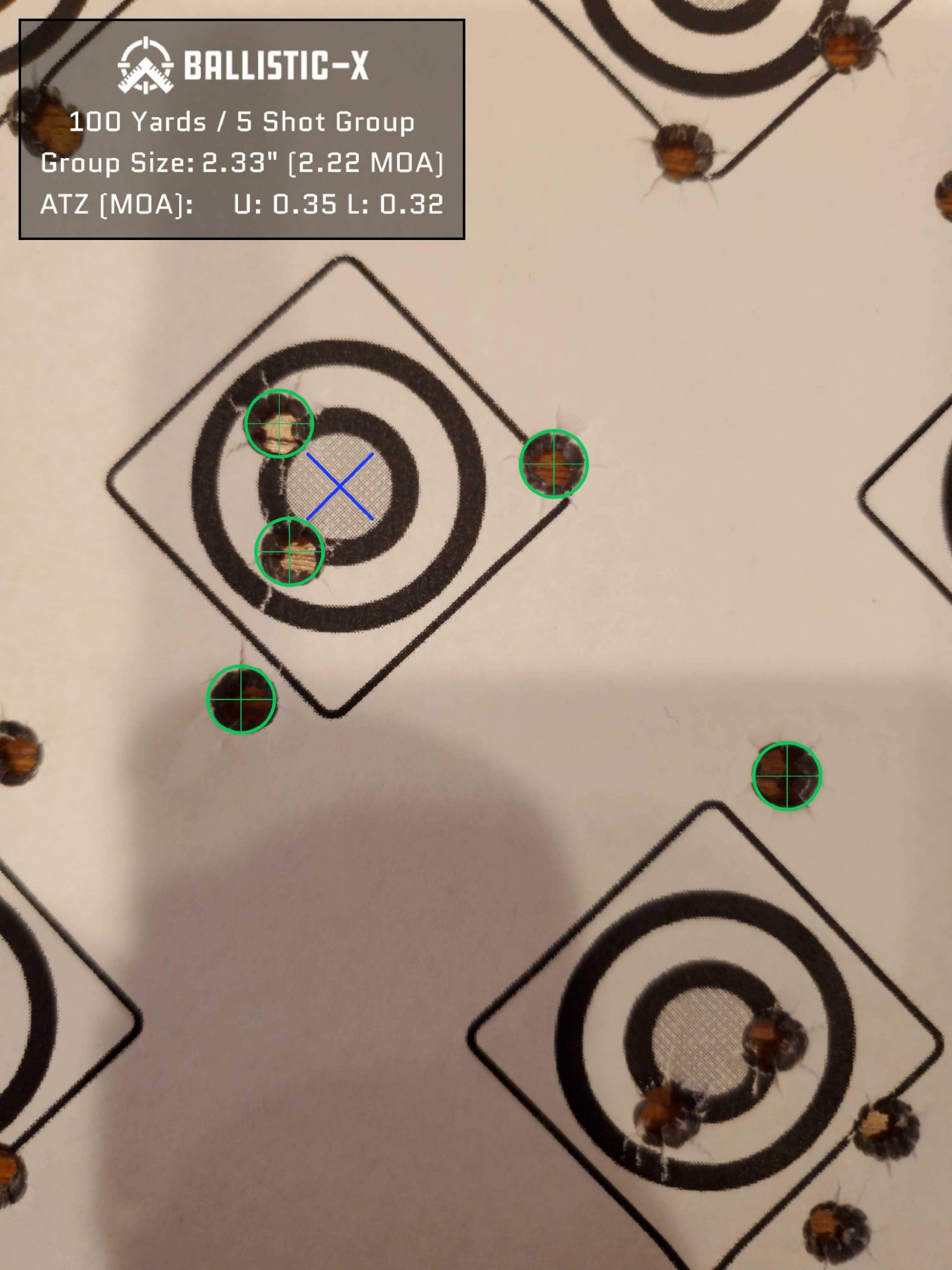

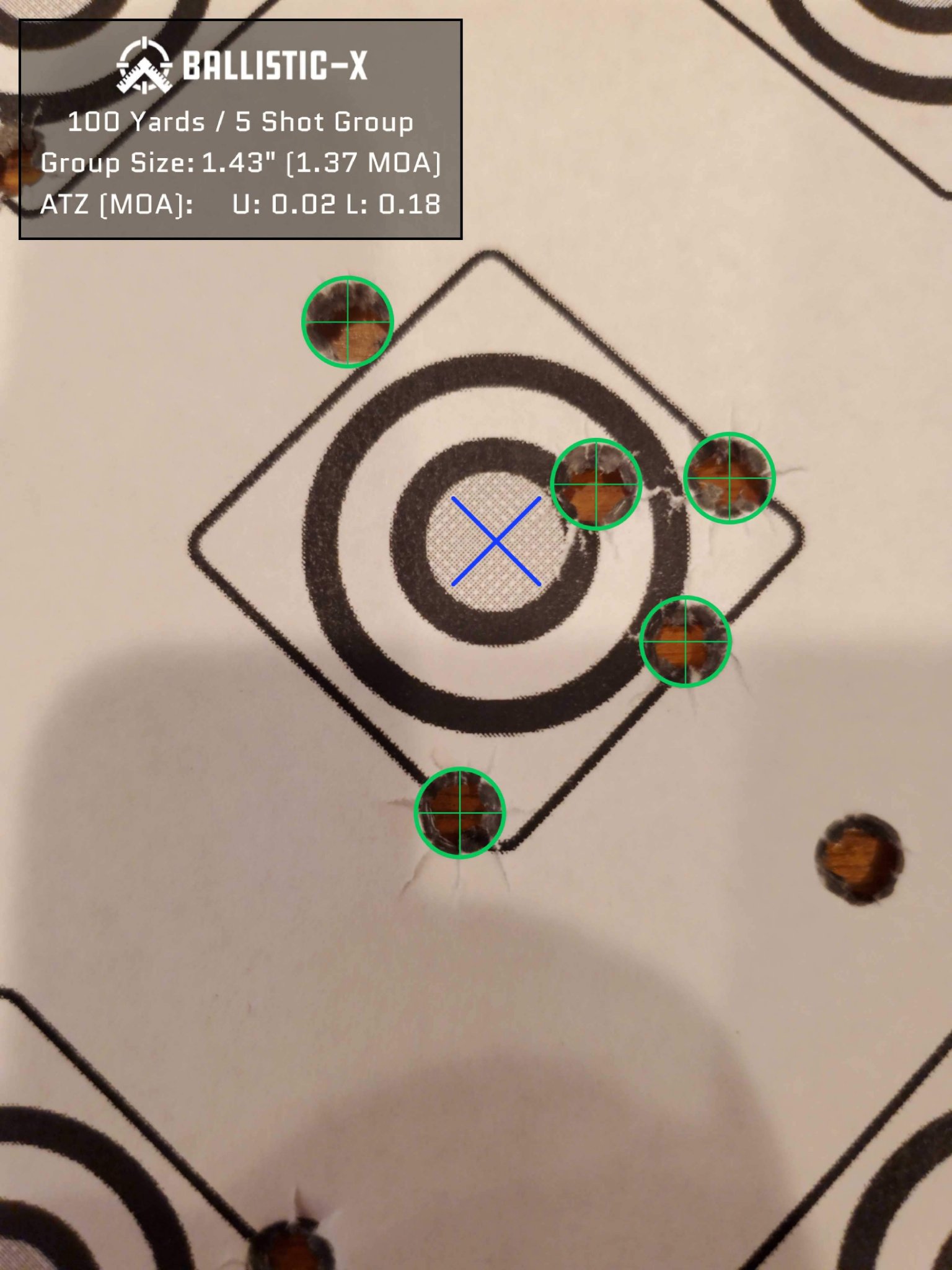

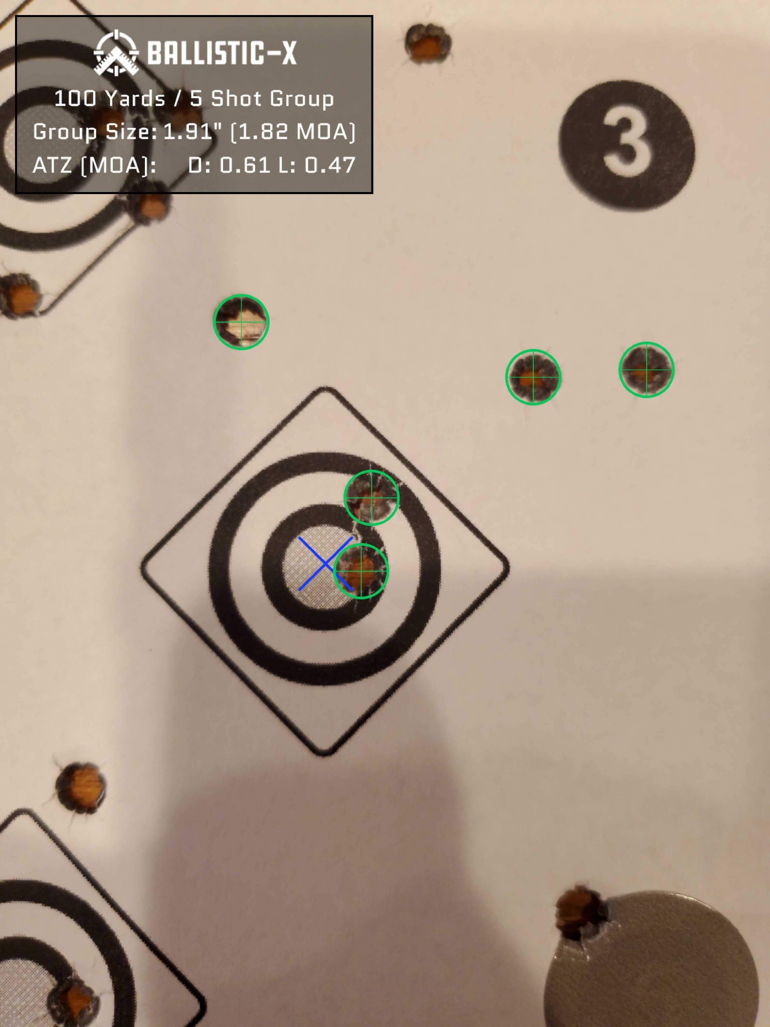

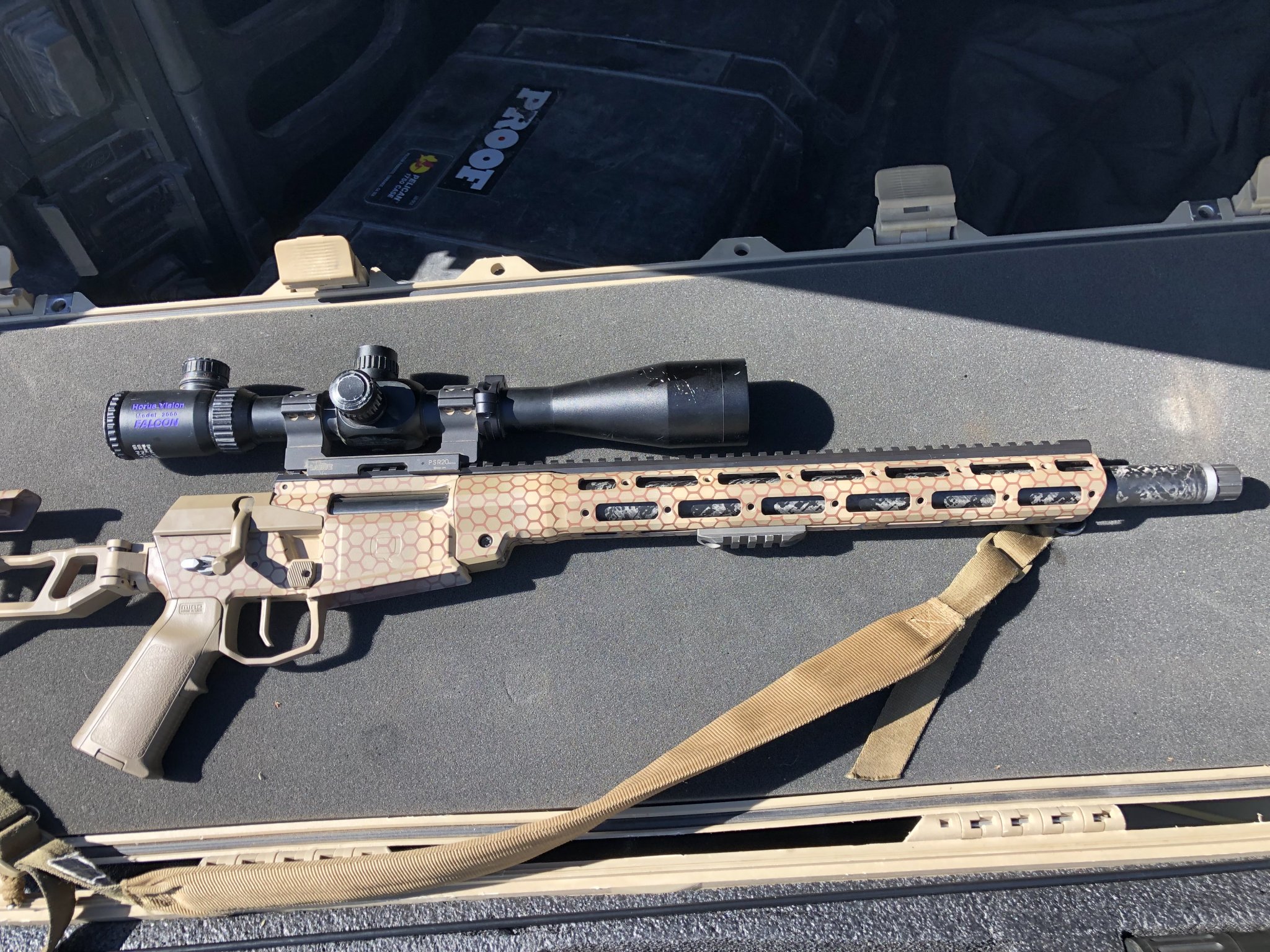

What am I doing wrong.....
I just received my Fix - 24" 6.5 Creedmoor Proof barrel. I took it to the range yesterday for the first time giddy with excitement. Loaded 50 ladder test rounds using Lapua small primer brass, Hodgdon H4350, CCI 450 Primers, and 123gr Lapua Scenar Bullets, no pressure signs. Shot off a concrete bench with an Atlas bipod and a rear bag. Scope is a Leupold MK5 HD in an ADM Mount (proven reliable on another rifle).
It's really disappointing that this appears to be a 2MOA gun without a distinct vertical or horizontal dispersion pattern. It irked me that the guy net to me with a Howa 1500 was printing 1/2" groups. The only thing I can think is that the 123gr bullets may be over-stabilized for the 1:8 twist rate.
Images below. Advice?
No such thing as over stable at 1:8
Those barrels were amazing with 140 gr ELD match. Sub 1/2 MOA.
Looks like you are using quality components, try heavier projectiles? Check torque on receiver and rail screws.
I'm sure you haven't MidCarolina'd your scope, but make sure it's tight in the mount and mount is tight to the rail.
Let me know if you can't or don't want to sort it. You can RMA it to us and we will gladly do it for you.
@Kevin Brittingham - Thanks for the reply. I'll try some 140 Barnes Match Burners and see how these perform. Appreciate the offer to diagnose but will try a few things first. Scope is mounted rock solid.
