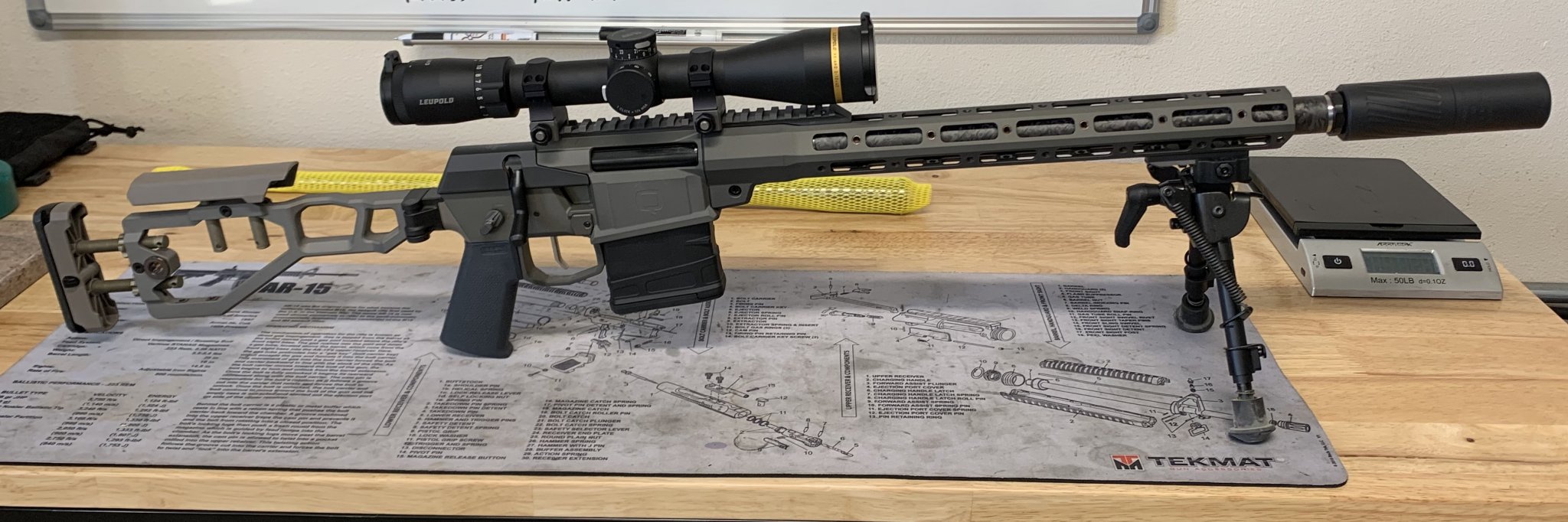

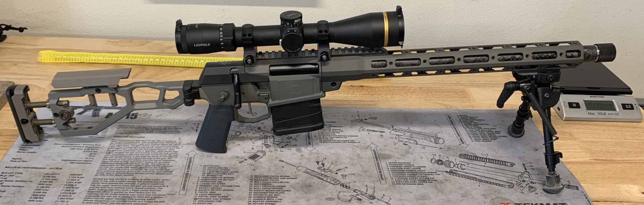

The Fix from Q

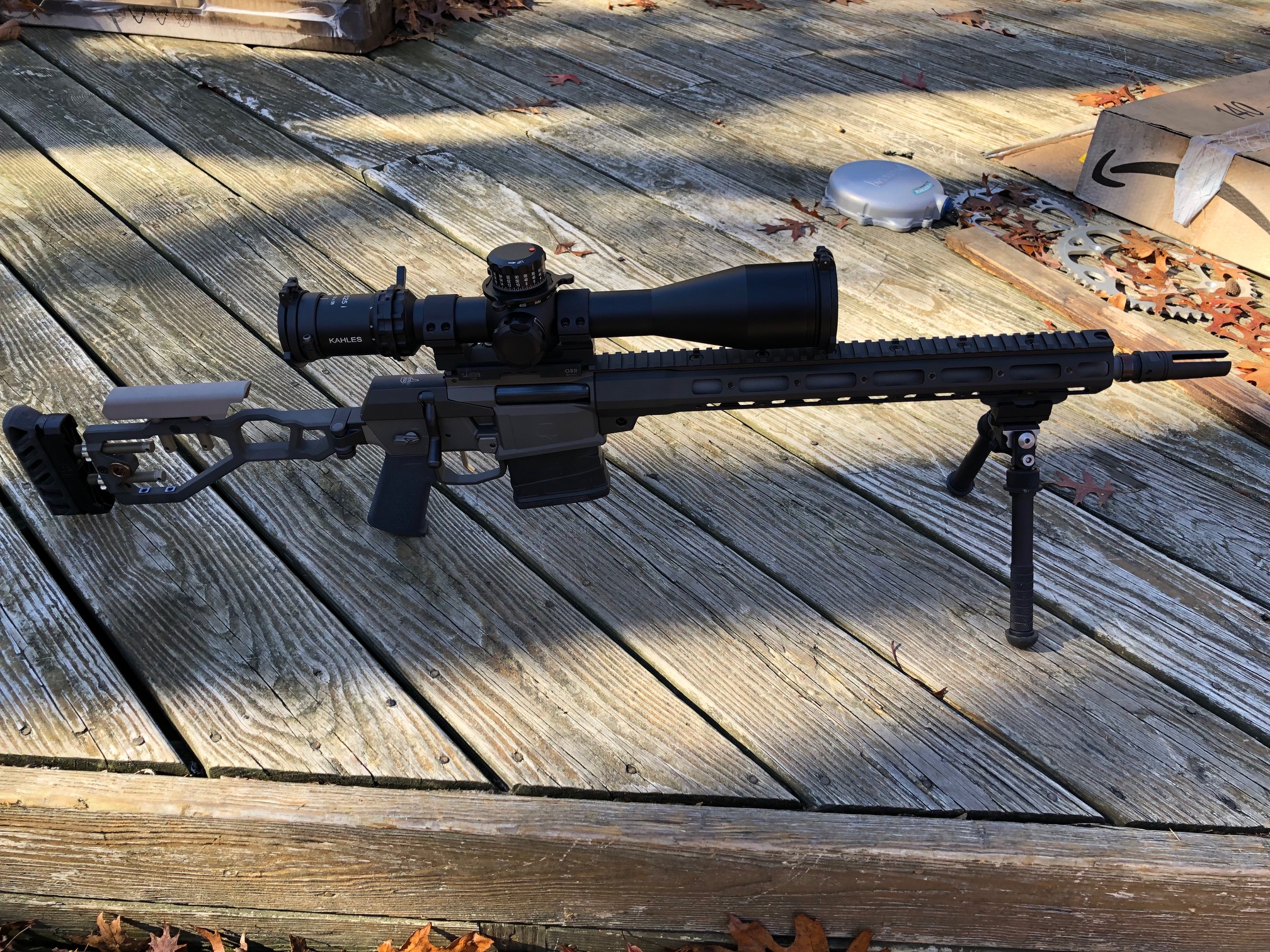

I can't believe this is a 12 lb rifle. It started life at 6.4 lbs and between a Scope, Mount, Bipod, Can, Sling, and a loaded 10 round Magazine now it's 12 heavy pounds. Maybe I'll find a smaller, lighter optic.
Get rid of that boat anchor scope, bipod, and a lighter silencer and you will be fine.

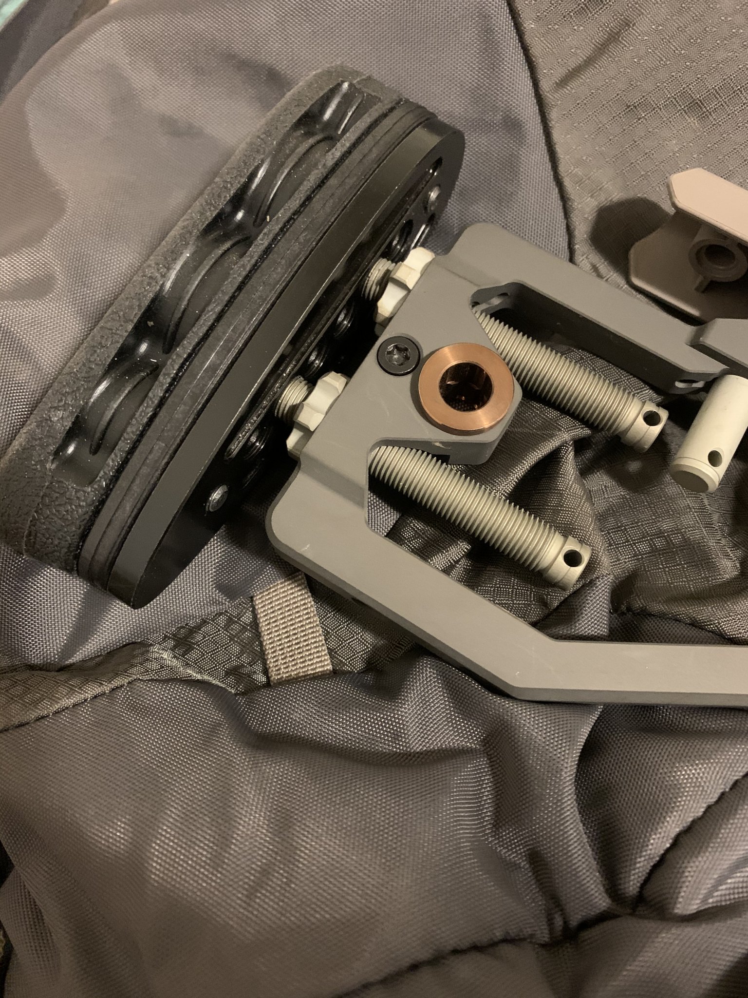

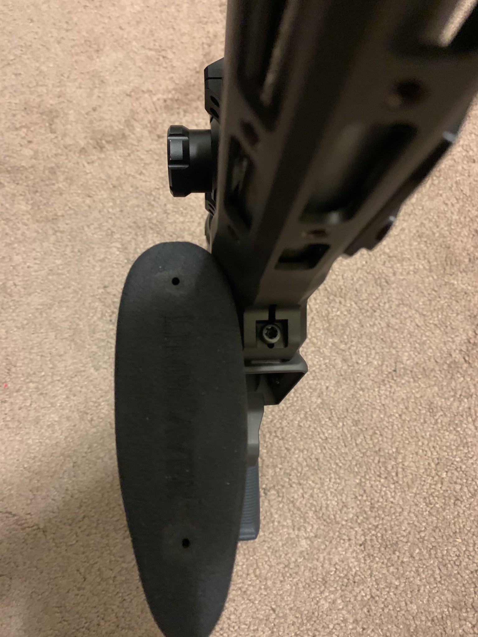

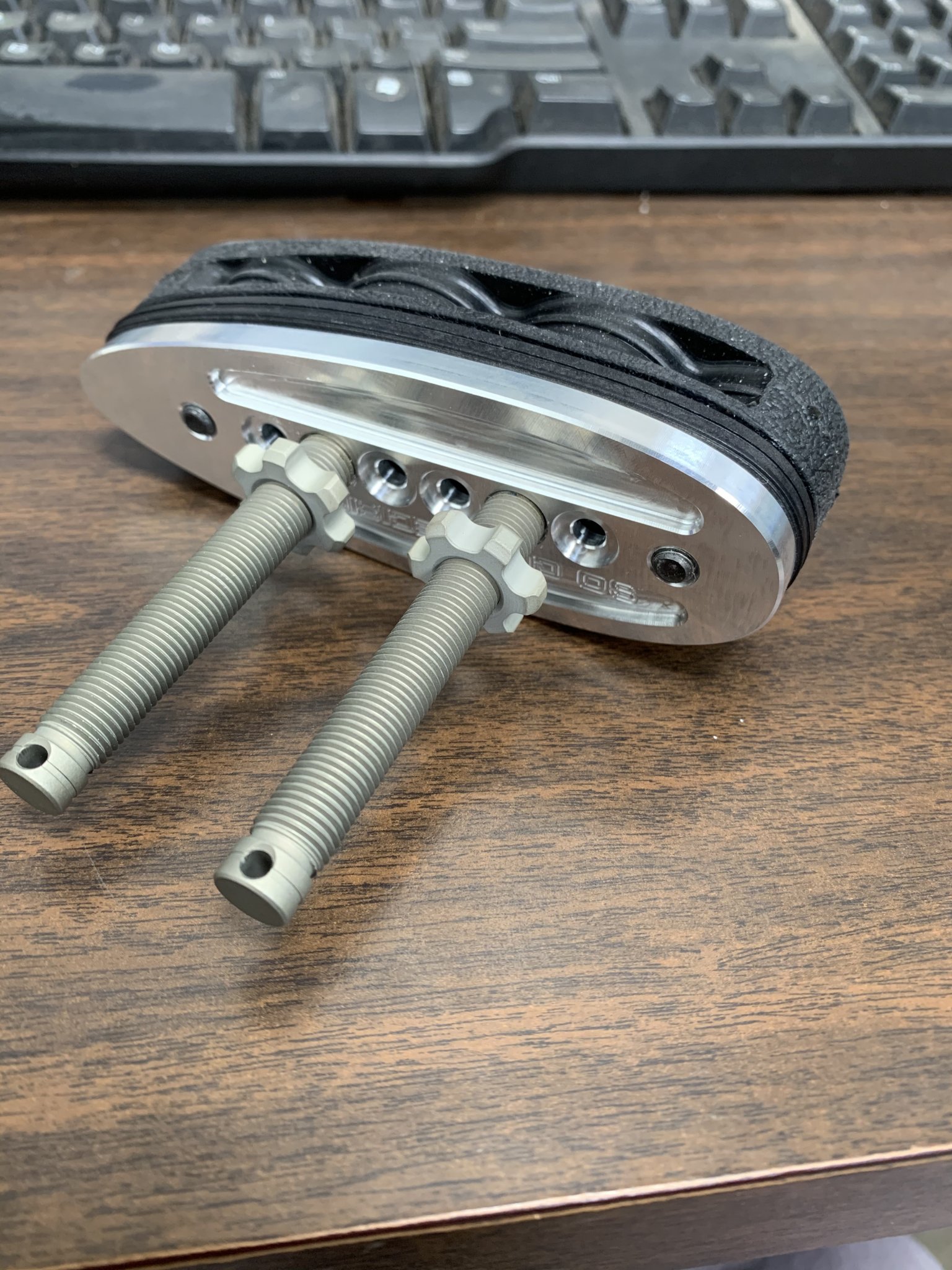

I like this, it appears the extra holes are threaded as seen in the second photo so you can adjust the pad up or down one position. Great idea.
The extra holes are through holes that allow adjustment of the pad up or down about .420"
However the adjustment comes from moving the larger 3/8" studs up or down. The butt pad stays in the same spot on the plate. I think it would've looked odd to have the pad overhang the plate if it went up or down.

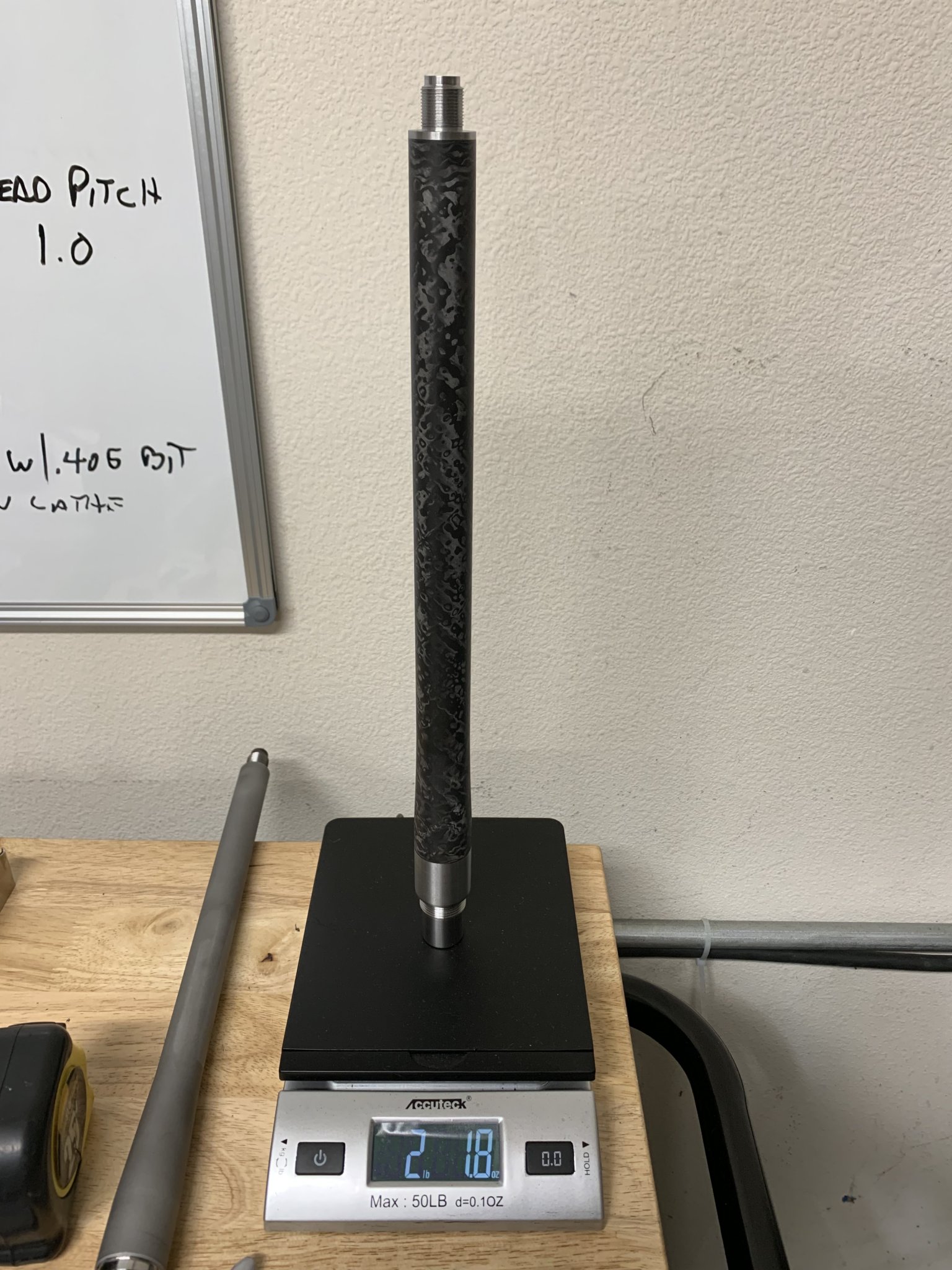

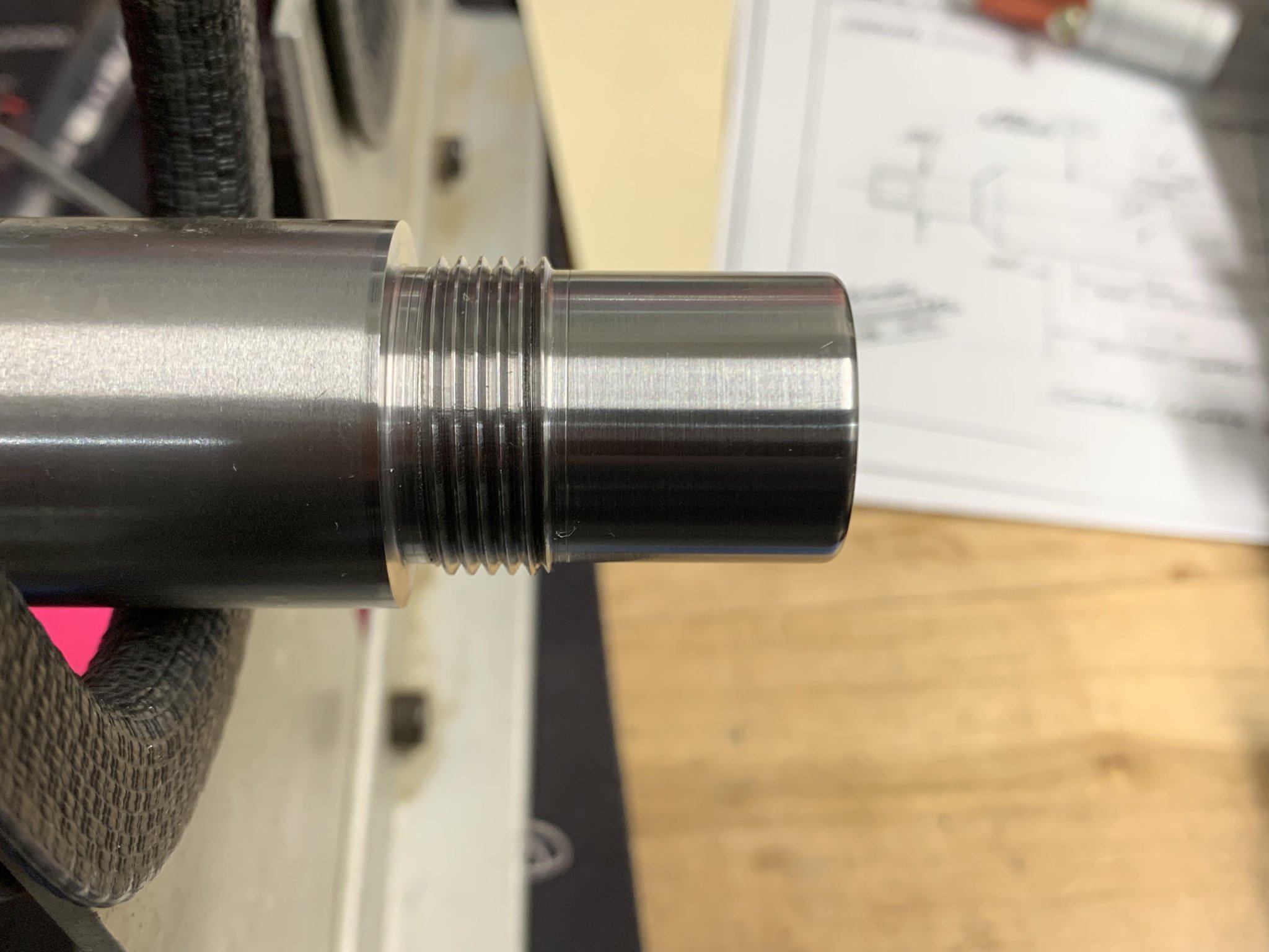

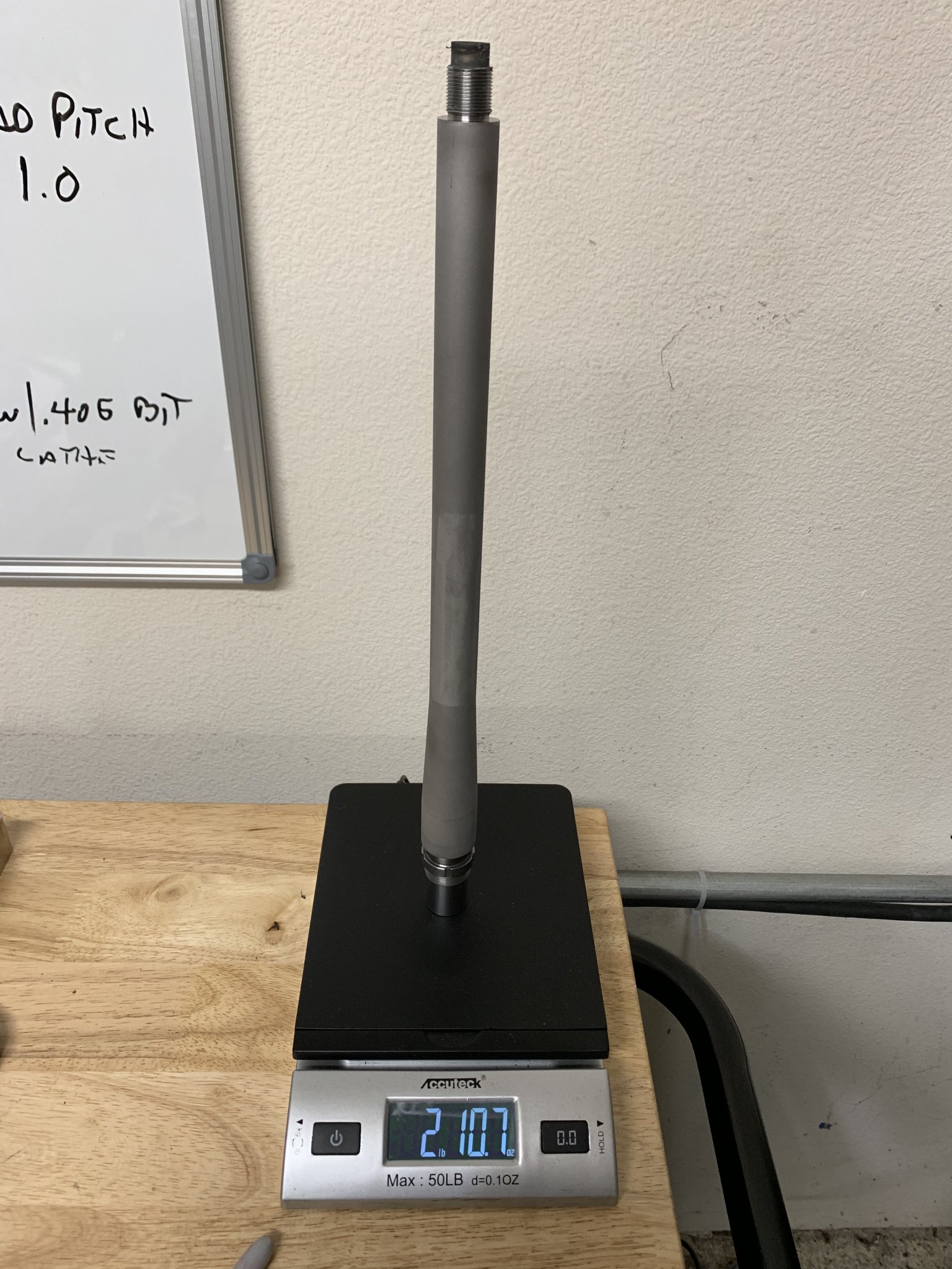

Finally got around to spinning up a short Proof barrel for mine. I knew this already, but the weight savings is minimal over the same length heavy Creedmoor barrel, about 9 ounces.

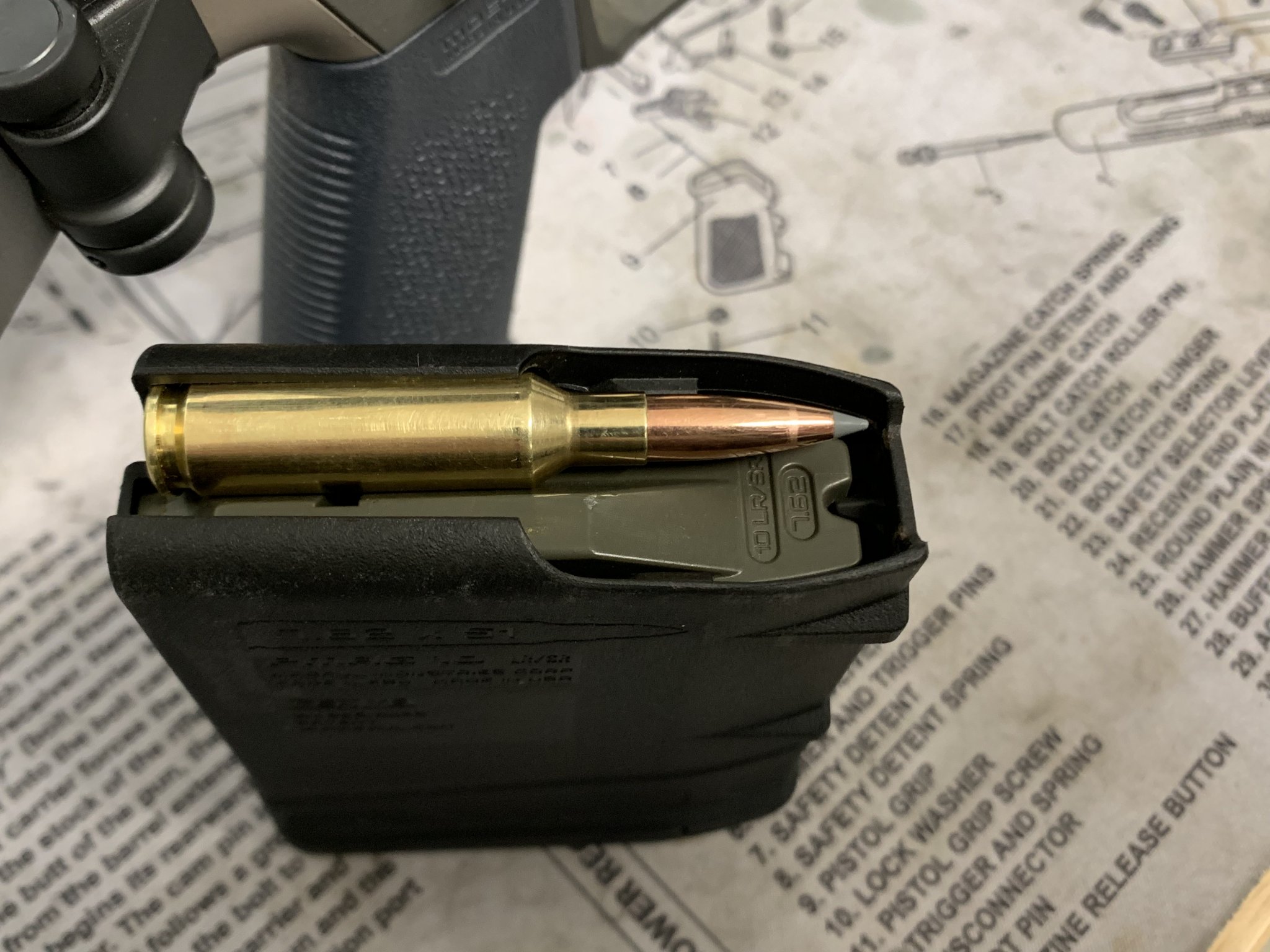

I pondered doing a 6 creedmoor, but in the end decided on 6.5x47. Mag fit is easy, and feeding is good. Here’s one with a 129 Accubond LR. I haven’t shot it yet, maybe tomorrow.
It weighs 8.5 lbs with the ultra 5, bipod not included.

One other thing for those that are wondering, the 1.2” shank on the proof blank clears the inside of the forend, but only by about the thickness of a business card all the way around.

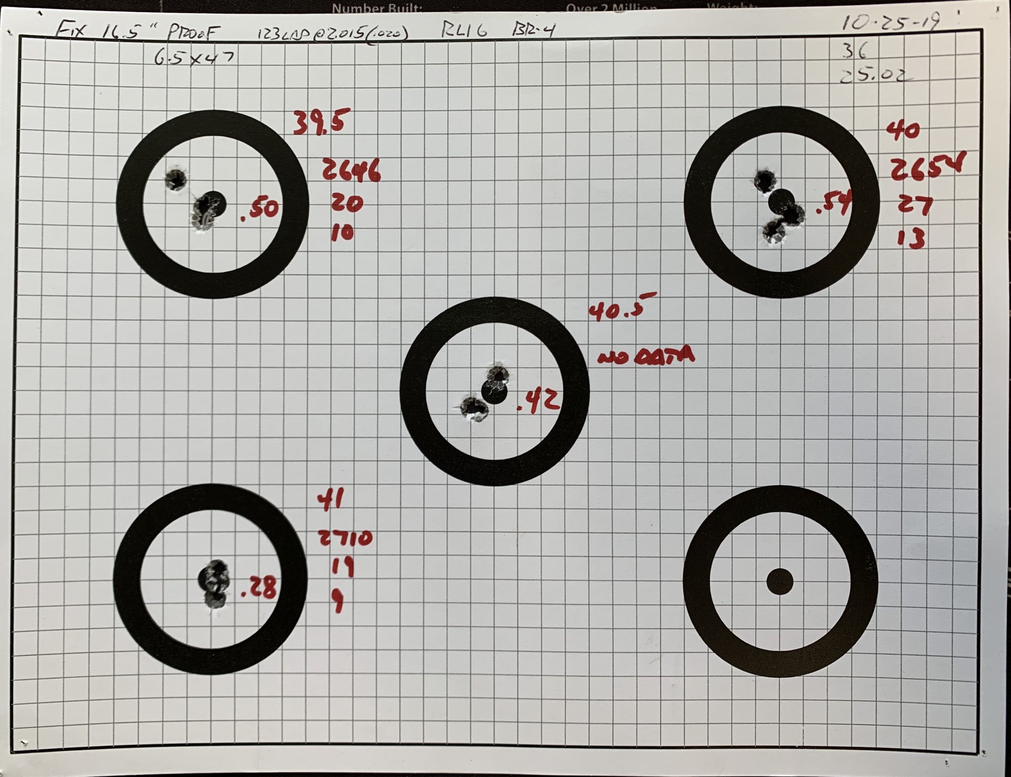

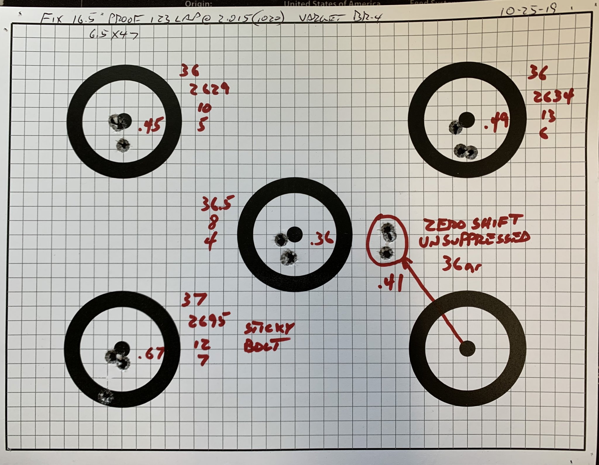

Shorty wants to shoot! I loaded up some 123 Lapuas .020 off, with RL16 and Varget. The suppressor was an ultra 7. The scope is a VX-6HD, 2-12, with a standard duplex reticle and no parallax adjustment.

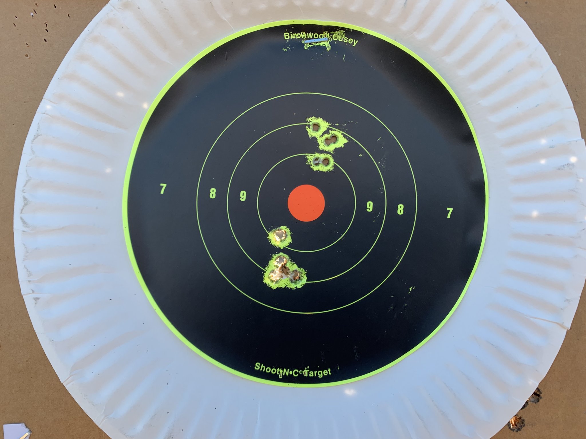

First five rounds out of the barrel. Lucked out with the bore sight, that lone hole at 7 o’clock, then put four into a respectable group. This was 39.5 gr of RL16.
RL16 loads. Listed is charge weight, speed, ES and SD. Group size in the circles. 41 gr is right up there with pressure, but no sticky bolt. 41 is about all I can get into the case without going to a big drop tube.
Varget. The starting charge was nearing max. Sticky bolt by the end.
Super happy so far. Rl16 has impressed in every cartridge I’ve tried it in, and the 47 is no different. The 47 feeds beautifully from the mag, or single feeding. Recoil seemed really mellow compared to the 16” creedmoor barrel I just took off. The load in that barrel was 42 gr of RL16 and the exact same bullet, which goes 2650 FPS. Off to a good start with this one.
That is nice! How did you go about spinning up the 16.5 inch proof barrel? I am still waiting on the 16 inch proof barrels from TAG. I hope they come like yours without the taper for the Q break. I have an Ultra 7 like you and do not like the idea of having another spacer involved that close to the muzzle. Nice shooting BTW.
I’m on the cards either 16.5” carbon proof 6mm creedmoor or 18” steel.
I want it to compliment the 20” Bartlein and 24” 6.5 creedmoor’s I have.
I dont think proof does anything but a sendero profile on these shorties. I don’t know how TAG does them, but it wouldn’t hurt to call and ask that they do a standard shoulder on the muzzle.

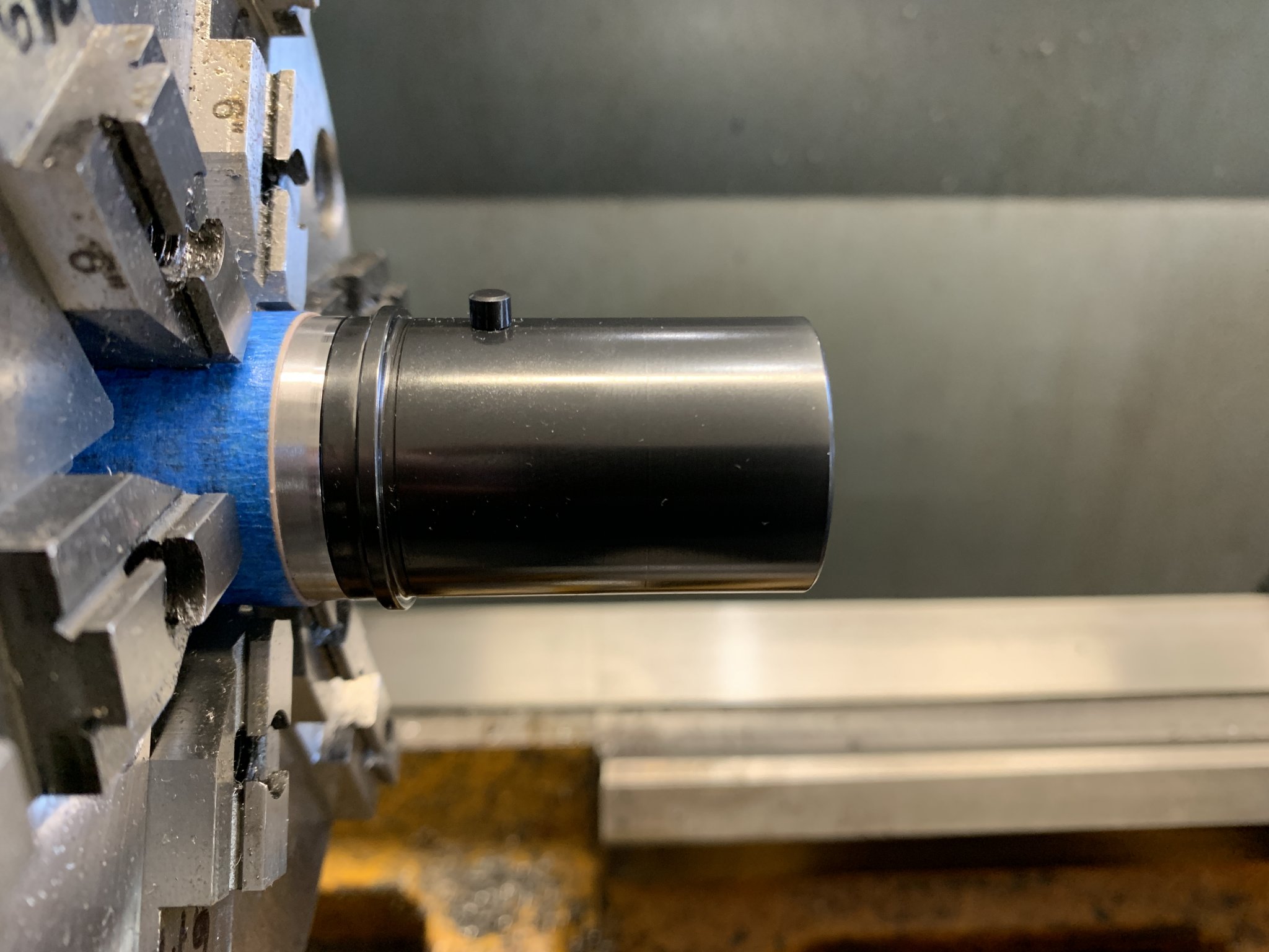

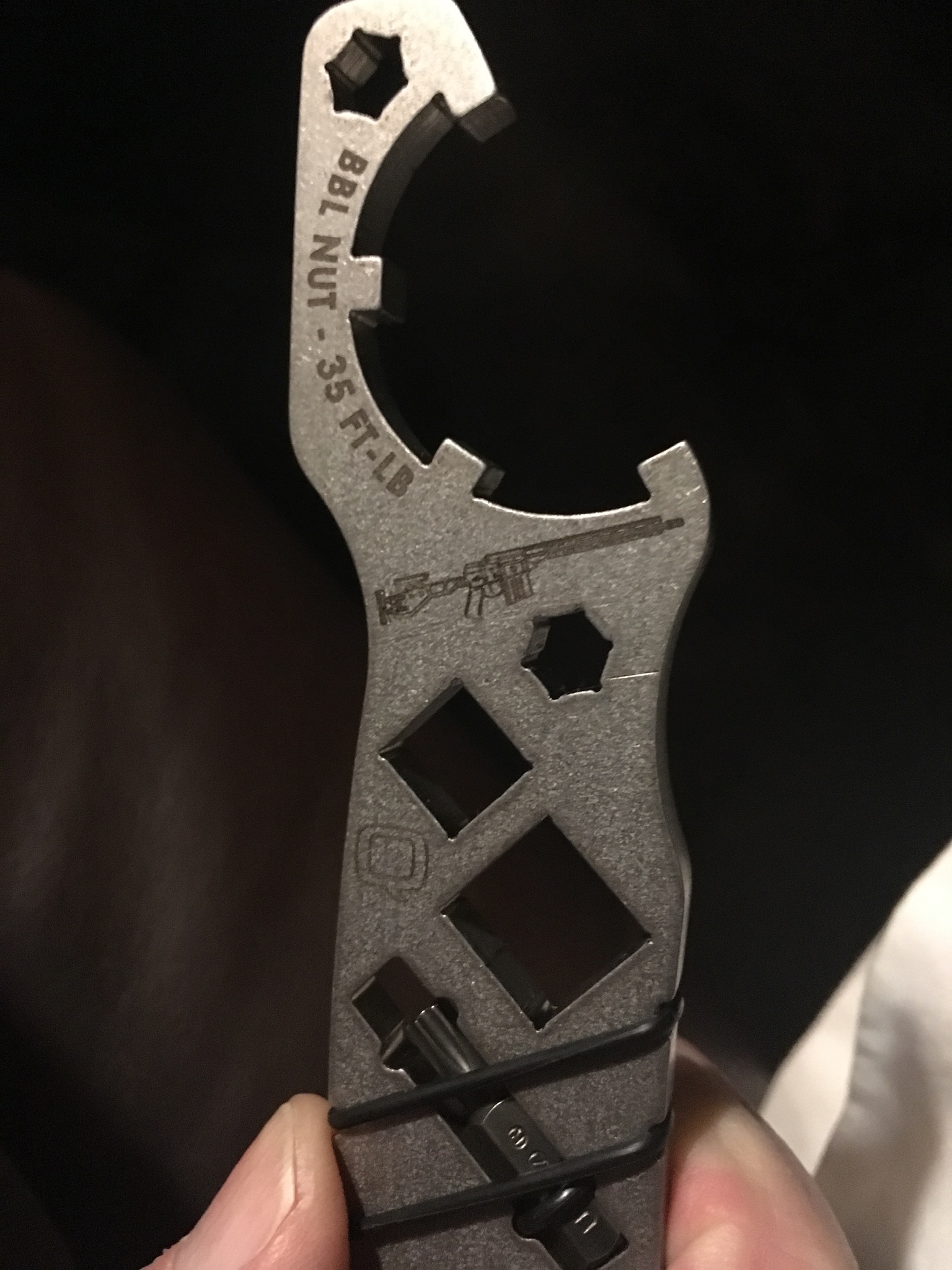

I omitted the jam nut at the breech end and just torqued the extension using a wrench I made. headspacing is done like any standard barrel.
Per the specs from TAG firearms they come with a tapered muzzle.
I dont think proof does anything but a sendero profile on these shorties. I don’t knoe how TAG does them, but it wouldn’t hurt to call and ask that they do a standard shoulder on the muzzle.
I omitted the jam nut at the breech end and just torqued the extension using a wrench I made. heafspacing is done like any standard barrel.View attachment 7170824View attachment 7170826
Can you post a picture of the wrench? I need one
Super simple. It’s a round shaft with a single raised spline that engages one of the large slots in the extension. I milled a hex in the other end. I’m traveling right now, and don’t have access to a pic.
I just got my 16" 308 proof barrel from TAG and it has the Q taper on the barrel so you are gonna need the taper adapter. Love the barrel though. Mine seems to have more clearance than a business card around the inside of the handguard. Does proof use a thinner contour than Supersubes did??

The factory 16" Proof barrel I got from TAG in 308 saved 2 ounces over the lightweight contour factory B/T 308 barrel in 16". I wanted to maintain or decrease a little weight but wanted a heavier contour to maybe be able to shoot a little more without the thing walking around on me so fast.

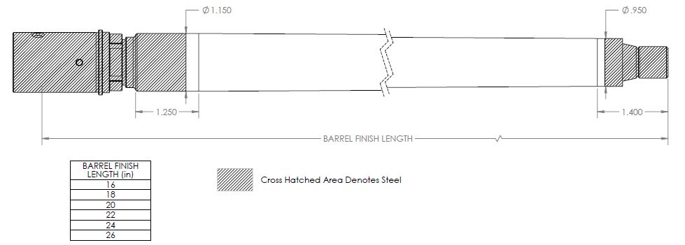

With the quantity they probably bought, they could have had whatever they wanted. I think the oem FIX barrels are 1.150 or thereabouts. I can’t recall exactly.
Reactions: DAVETOOLEY
This. Q spec'd out the barrel tenon to be a smaller diameter than what Proof builds other barrels to, I'd bet Tag used the same spec to build their barrels to. That way there isn't any fit issues.
This. Q spec'd out the barrel tennon to be a smaller diameter than what Proof builds other barrels to, I'd bet Tag used the same spec to build their barrels to. That way there isn't any fit issues.

I know that, but proof has different tenon diameters that they make. It's likely Tag would've spec'd out the smaller diameter for a better fit. That's probably why the barrels were done as a preorder, Tag may have had a minimum order to get these barrels built that weren't previously offered by Proof.
I don’t think Tag have spec’d anything. They are supplying proof prefits.

They are proof made pre-fits, but outside of ordering from TAG, they’re a non-cataloged item. I’m curious to see what their contour and shank diameter is.
Proof’s catalog is gradually evolving, but the only small shank barrels they make are 1.13, and they don’t make those in short lengths for example. I had no opportunity to buy anything but a 1.2” shank sendero contour for any 16.5” blank, regardless of bore diameter. TAG’s order could kick off some new contours though, in the same way Special Purpose Rifles kicked off Desert Tech blanks.
FWIW my 6mm Creed Fix that was a factory proof barreled model measured 1.1995” at the fattest part of the cylinder with certified Browne and Sharp dial calipers. Yet supposedly 1.20” shank barrels won’t work...
The prefits are on the proof research website. You can order from any proof research dealer. You don’t have to order from TAG.
TAG haven’t done anything special here. They haven’t spec’d their own barrel from proof.
I posted the link to proofs website already.
