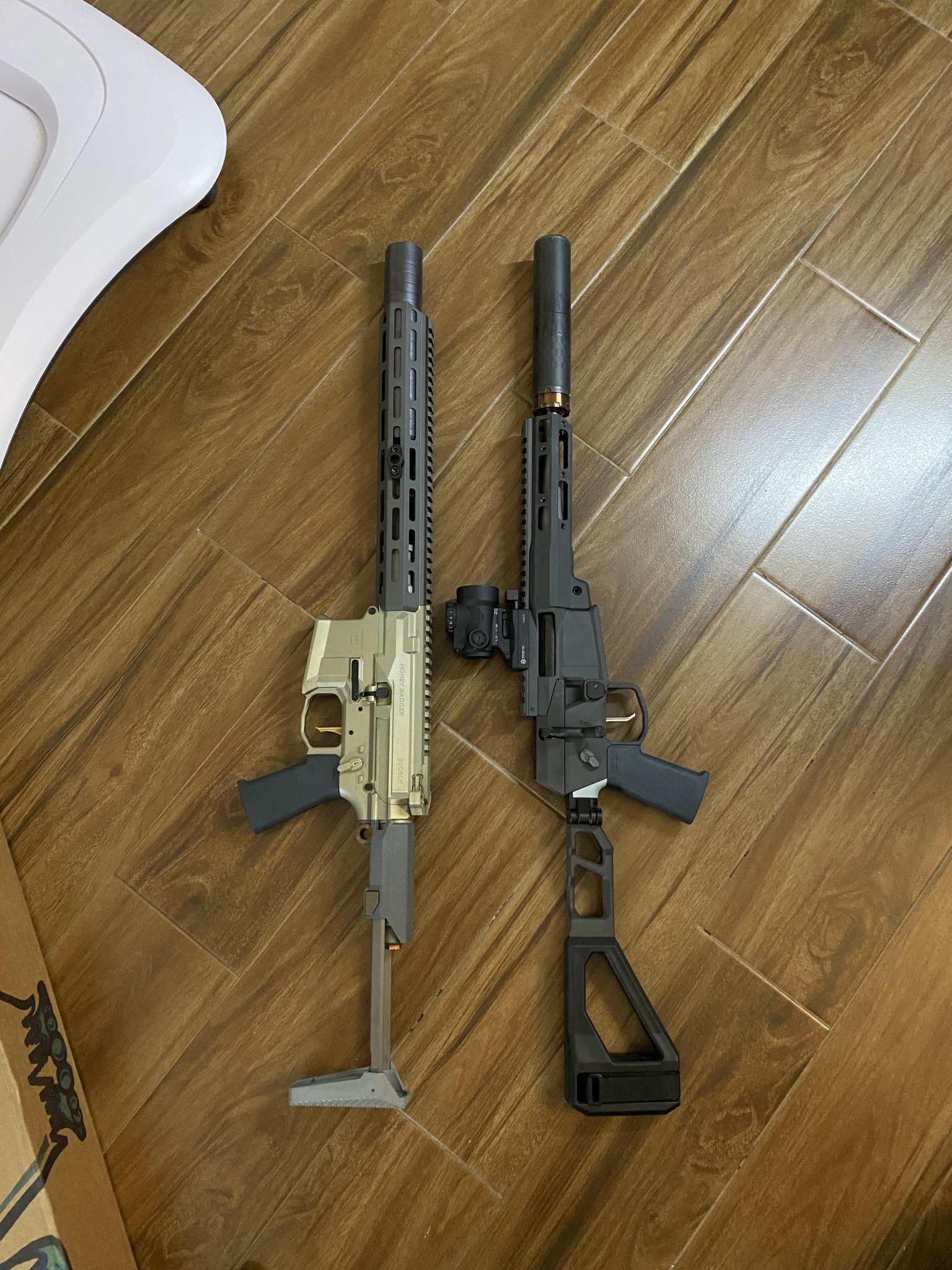

Am confirmed to be getting one of the first 25 miniFIx pistols ... i heard they had some crown and chambering issues so redoing the barrels - cant wait.
mine is #27 and I am hoping to see it at my ffl this week. the staff said they would need to take it to the range to test it out for any issues but I will ask tomorrow if they an skip it so that I would have it this coming weekend for final deer hunt of the season. the little setup is so gnarly. I even got a baby dick etched on the bolt and my son's name on the shroud. I will post photos and my experience sometime this week when I get some down time.
Looks like Sig barely even tried not to copy the Fix with their new "Cross" rifle.
I don't know if kb had started on a "fix" type rifle while at sig and that's what it has finally ended up as but that's some straight up GA mess right there if they did that from "scratch".
