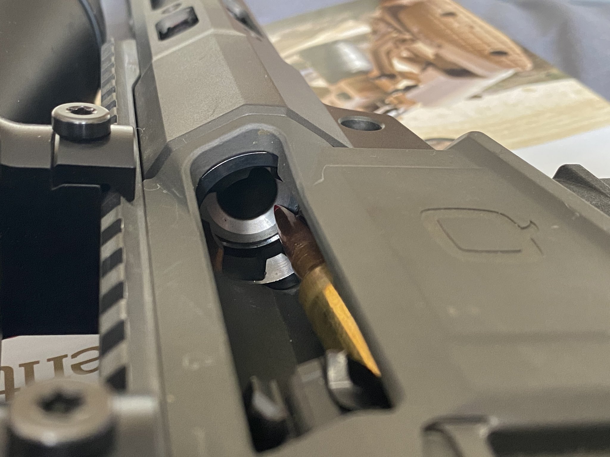

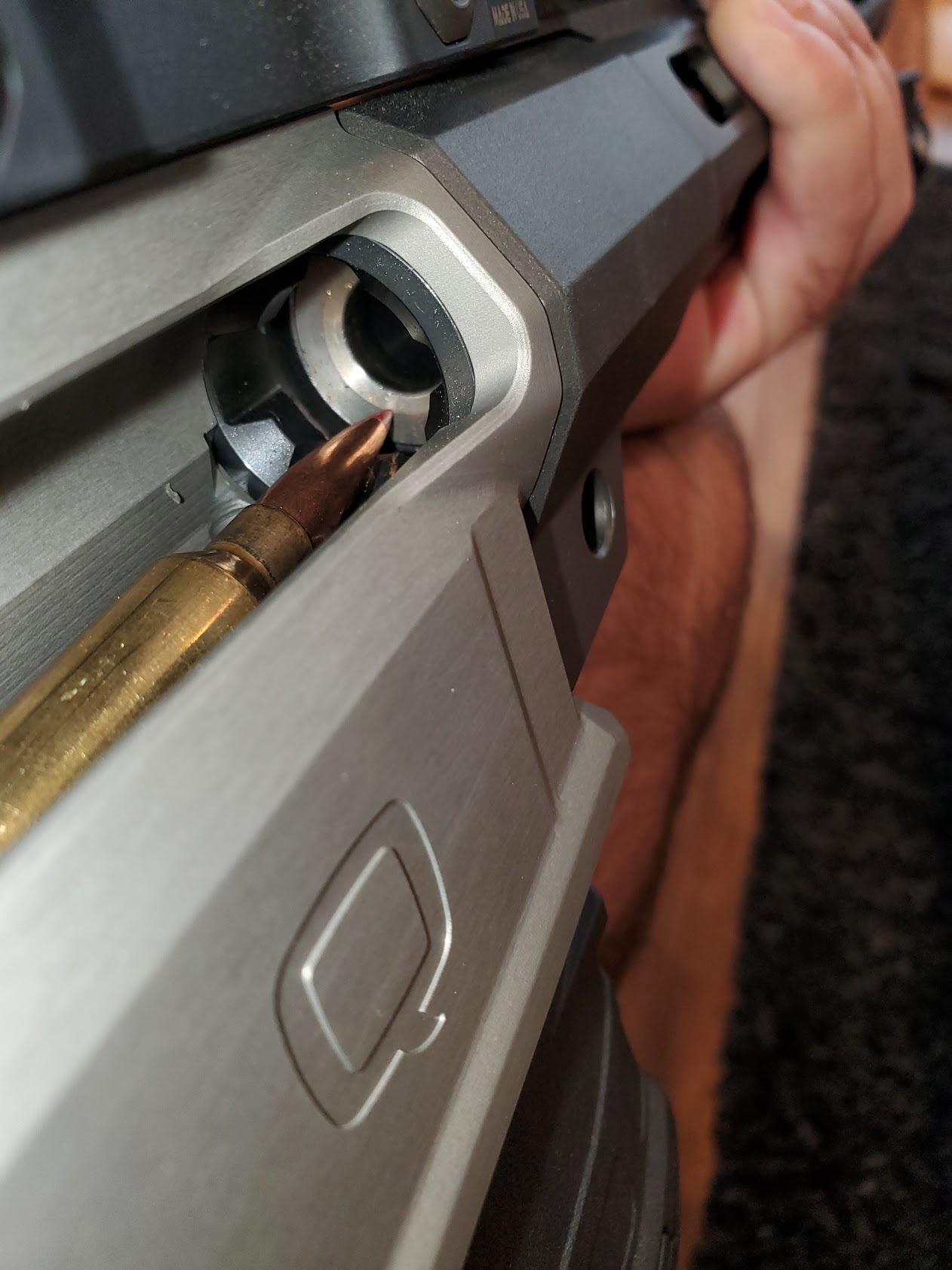

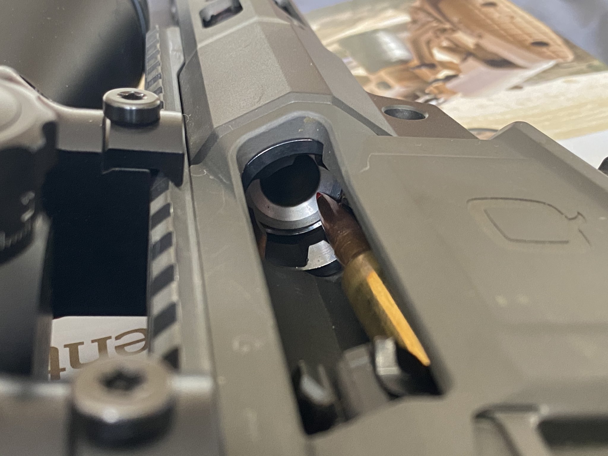

Well.... I picked up my rifle today after a 14 day wait to allow the wonderful state of CA to make sure I'm worthy of a firearm. After re-assembling everything, I tried out my brand new receiver by loading a few rounds into a magazine and running the bolt.
Same fucking problem. Bullet tips still strike the barrel before feeding into the chamber. What a waste of time. I give up..... I'm not going to waste any more effort on this. I guess I just have to accept that I'm stuck with a $3K lemon and learn to love the taste of lemonade.
I've attached a picture of the bullet tip hitting the junction between the barrel perpendicular and chamber chamfer.
I haven’t followed your initial issues. Is your barrel an early Tooley Bartlein? 6.5 or .308?
This is one of the reasons I hate SR25 mags for bolt guns. If Q's rifle used AICS mags you'd be able to tune the feeding. In your case I'd probably try some cheap metal mags and bend the lips as much as possible to try to fix the feeding problems.
It's a Proof barrel but this is not a barrel problem. It's the combination of barrel extension, magazine, and receiver geometry. A 308 feeds fine because the thicker round has the center point of the bullet riding higher when gliding up the feed ramp. 6.5mm rides lower (mine is 6.5). I can only assume that the problem is worse on a 6mm.
Totally agree with the other post that using AICS mags would have solved this.

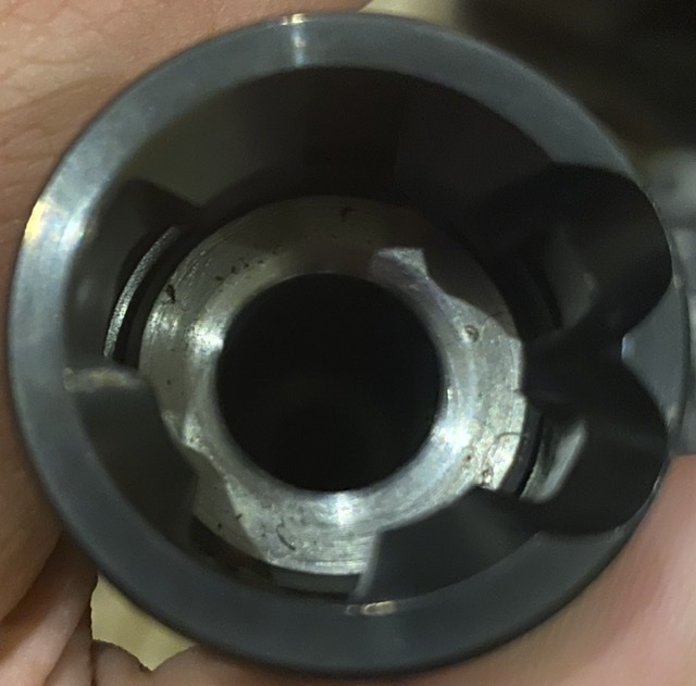

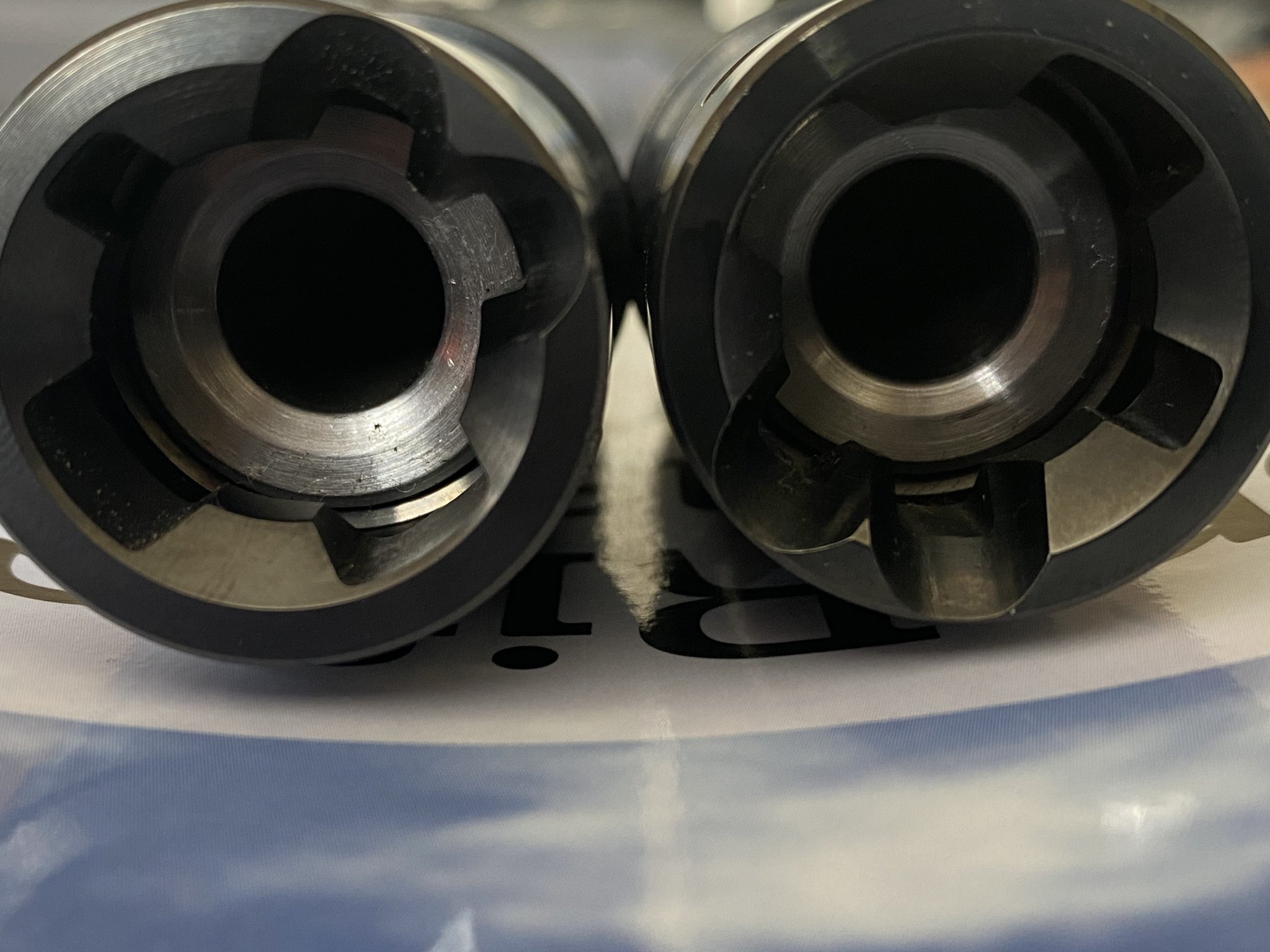

This is my 6.5CM Proof. The chamfer is far larger than yours. My rifle feeds perfectly. Proof is currently on the rifle.
my .308 Tooley feeds as does my 6.5 Tooley.
The .308 is on the left.
Super interesting to see the inconsistency. Yup - a larger chamfer would definitely solve this problem. I was thinking about using a dremel to increase the chamfer at the spot where the bullet tip impacts. I think I'll do this. Your picture makes me believe that an increase in the chamfer won't reduce chamber support of the round in any material manner. Thanks for sharing.
increasing the chamfer won’t relieve support on the cartridge. It believe it will sort the feed issue and I’m surprised we didn’t pick up on it sooner.
Do not take a dremel to that barrel.

Id argue the barrels put out in the beginning had more Issues than later barrels.
After looking at as many as I have—the distance from lug to barrel face seems to be larger in early barrels.
Early barrels also have no chamfer
All the barrels I did from day one had a chamfer and the end gap on the bolt was the same.
