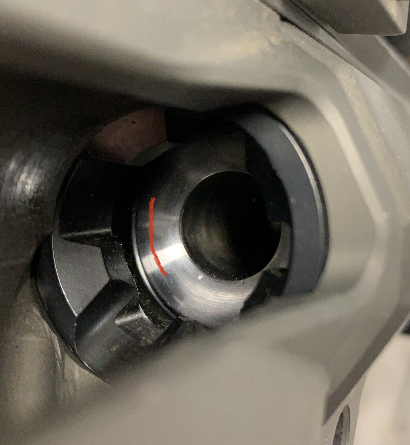

It's really hard to tell from photos but your chamfer and my 6.5 look better to me than my factory Q 308 chamfer. Wish I had your knowledge and skill, your work looks beautiful.
The red line is the end of the chamfer approximately.

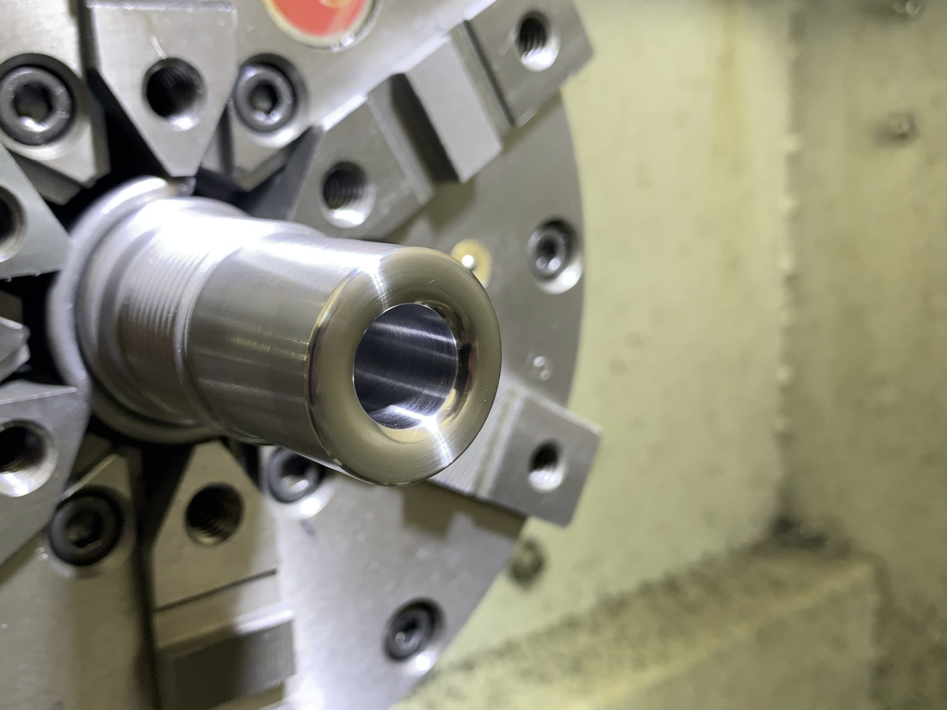

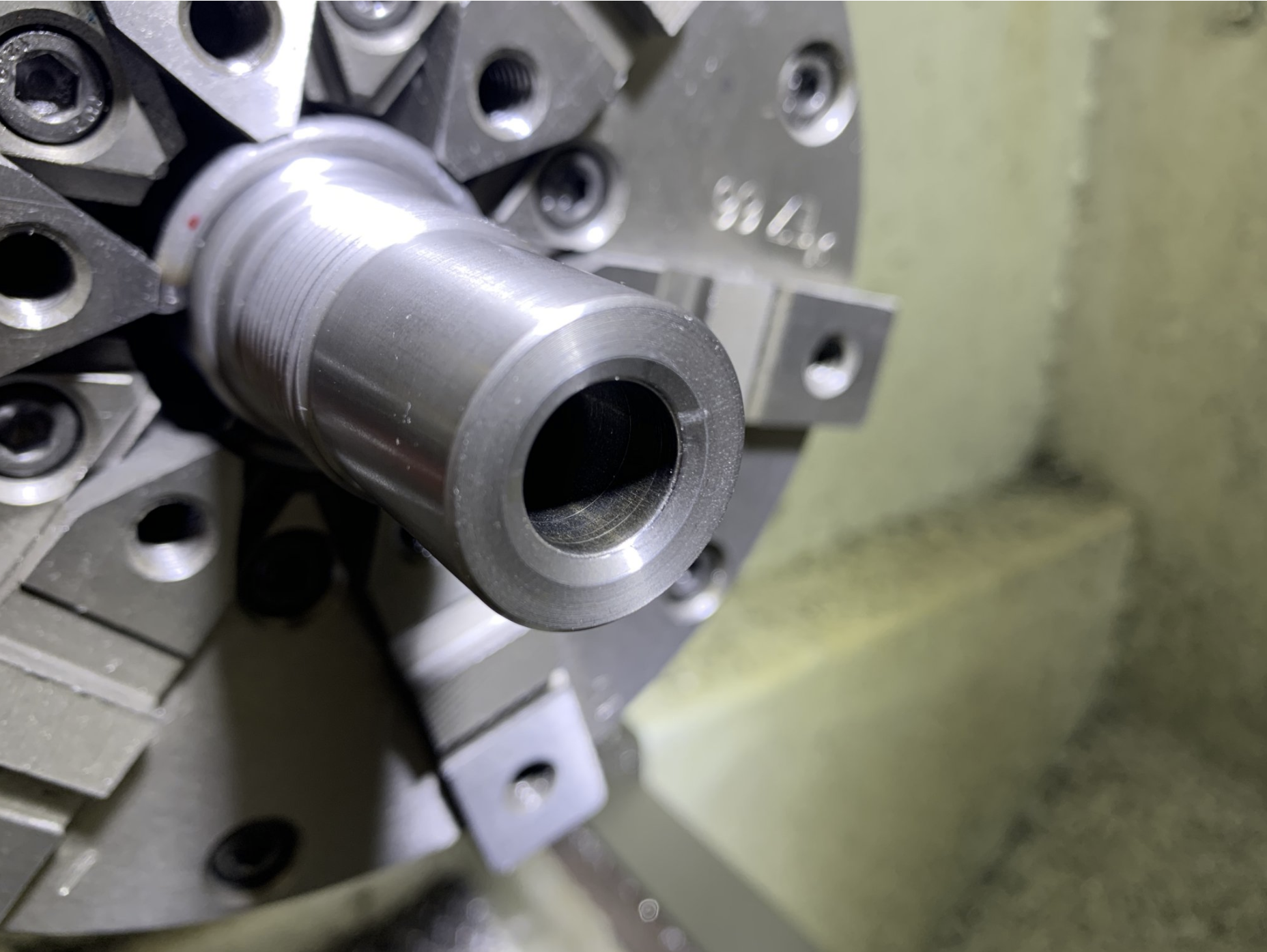

I sent my 6.5 barrel to @Supersubes to fix the chamfer. He sent me the before and after pictures below. Damn that's beautiful! I have high confidence that this will solve the feed issues and will share a writeup after I get the barrel back.
Thank you again @Supersubes for doing this for me and turning it around so fast.
I received the barrel this evening and re-assembled everything. I'm happy to report that feeding is night & day better than before. Bullet tips slide along the polished chamfer into the chamber with no visible damage. Case closed on this issue!

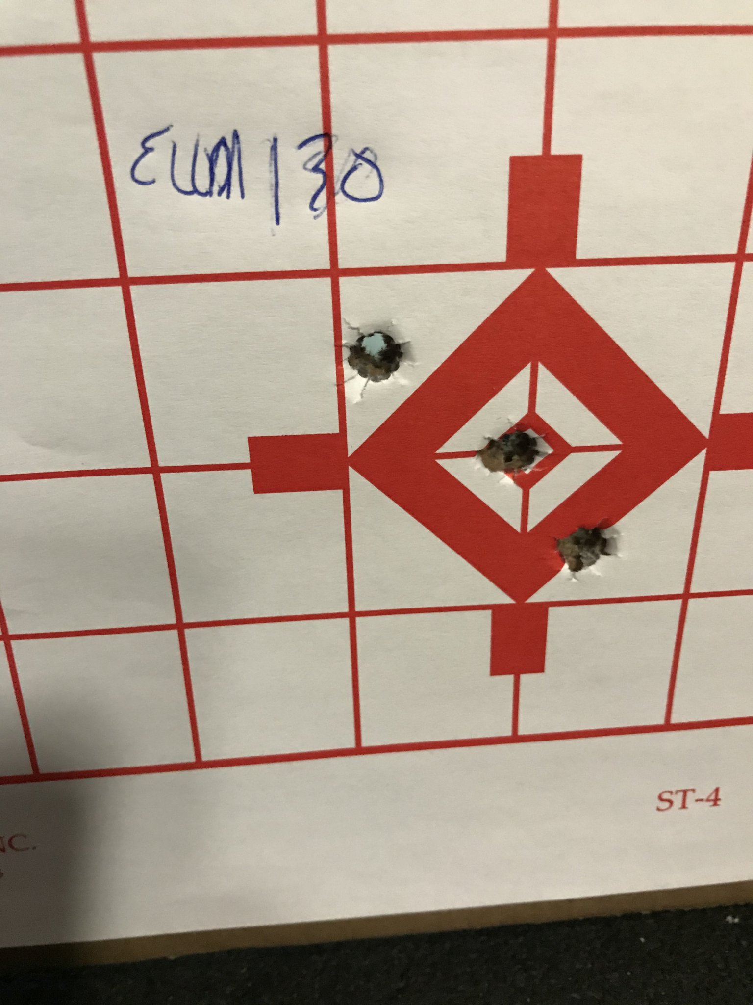

took it out again today and shot 2 new loads through it, copper creek 130eldm and 153atip as well as the 140 eldm and prime 130 offerings. No bueno, emailed Q and will wait and see. I have had to send a honey badger in for repairs and it was hassle free and came back in tip top shape. Hopefully this goes the same way. I'll update when it's resolved. I pulled the scope and mount off as a unit and put it back on a 5.56 gasser that shoots in the .8's to 1 inch range and fired 1 shot at 50 adjusted the turrets and then sure as shit shot a 5 shot group at .82 MOA with 75 grain frontier. It even shoots 55 grain imi into an inch and a quarter. Threw the scope back on the fix and it was the same story 1.5-3 inch groups with everything. I can't make heads or tails out of it so hopefully the boys can take a look at it and get it running right. As previously stated though no feeding issues with hornady 140eldm, 143eldx, copper creek 130eldm, 135berger classic hunter, 135atip, 153atip, or prime 130's.

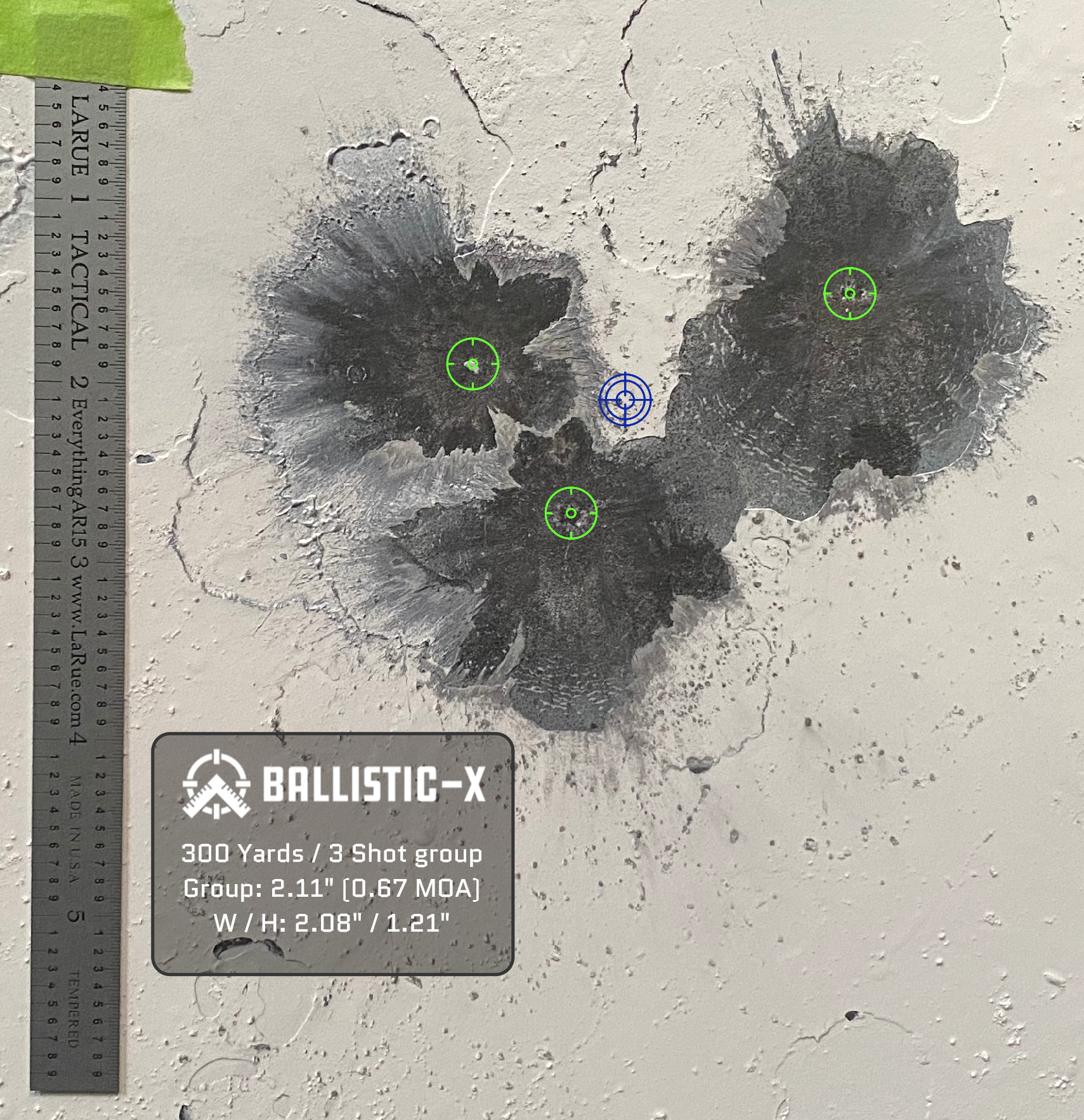

Ask them for the targets from their test. A buddy of mine was having an issue and they sent the targets back of 1/2 moa groups. Never told him what the issue was, he was also having the same problem as you. Both of us are shooting .308.
Mine was shit groups for maybe the first couple hundred rounds. Figured it was me not being used to the rifle and just powered through it. I was seeing the same results as you, now with no warranty work done it is easily grouping 1/2 moa if I do my part. Swapped in a 20" Proof Carbon barrel and seeing the same results. Maybe it was me that needed breaking in...
I defiantly had buyers remorse after the first couple boxes of ammo. Now that I've had the rifle for a couple years I love it. Great hunting rifle!

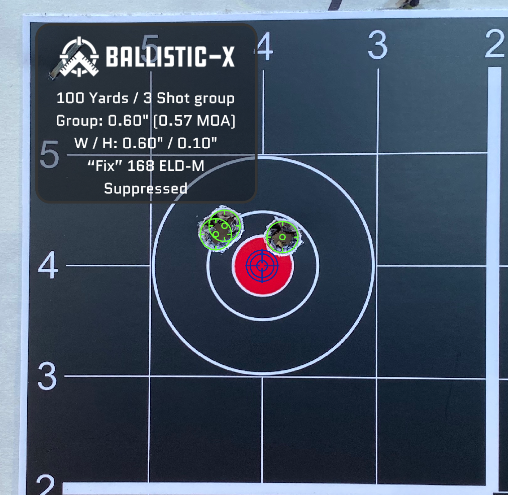

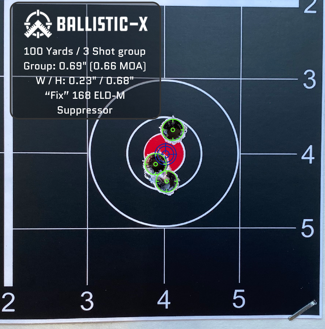

Reactions: esw004
Thanks for the info!!! That is exactly the type of knowledge I was seeking. It's on it's way back to them now and I will definitely post with updates when it comes back. I'll check with them on the test targets. My OBR came with one and it was a spot on example of what the rifle was capable of. None of my GA Precisions did but, all three shoot very well. Thanks again for the input.

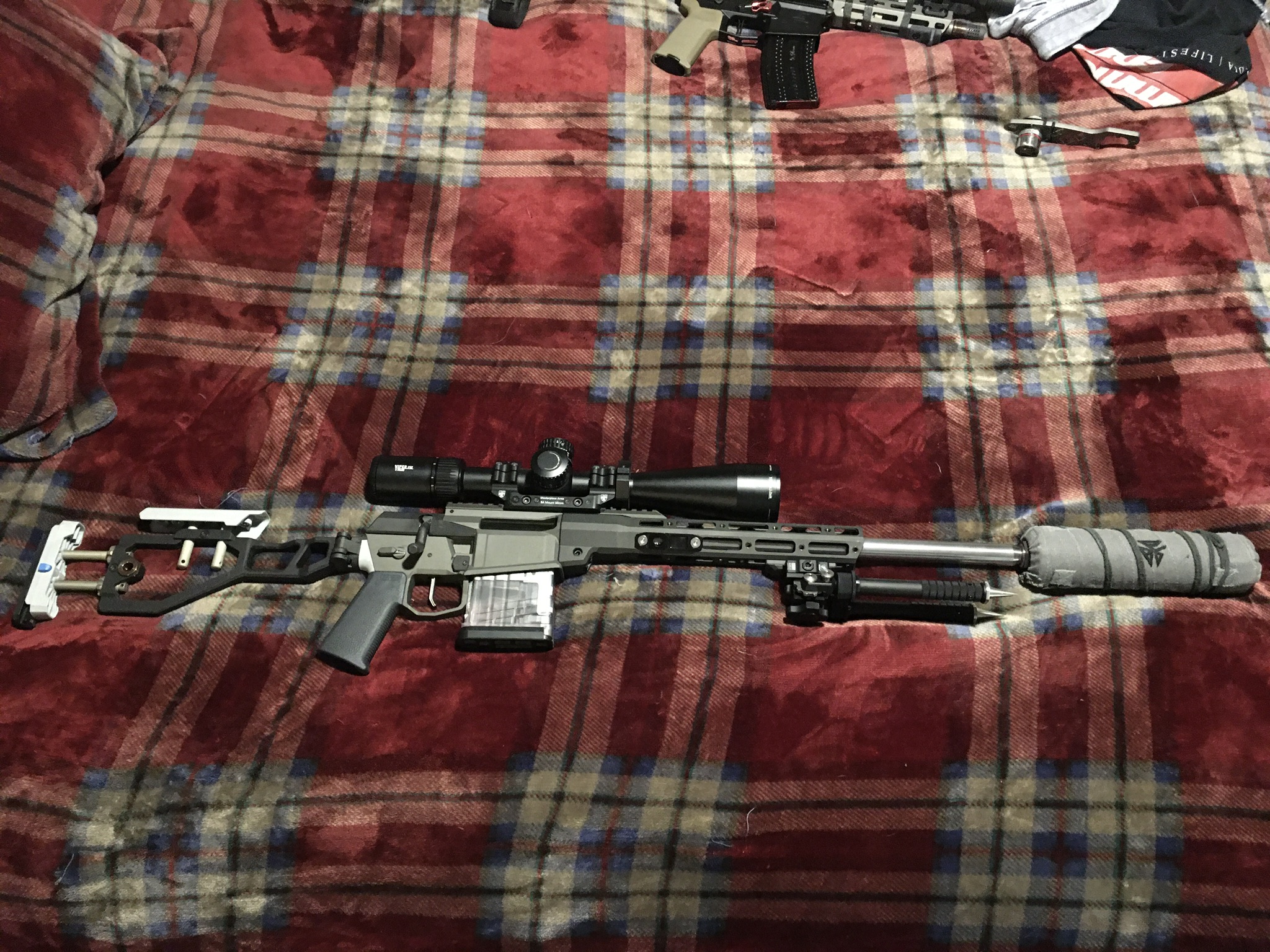

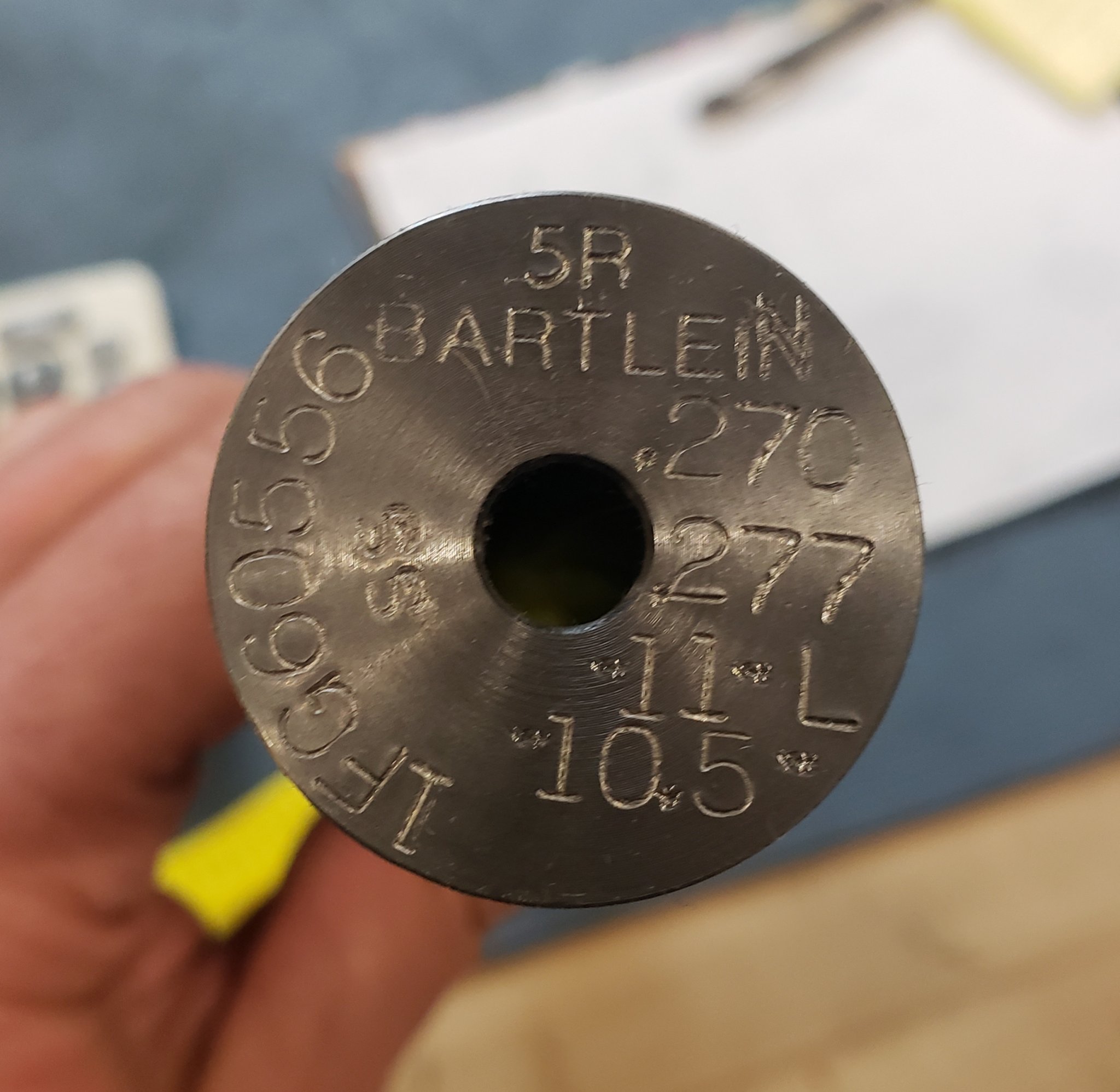

It was a 22” 6.5cm but with a suppressor, it was just too long to carry around for hunting. Chopped to 17.5” and still shoots sub .5 moa. View attachment 7500525
How does this balance/feel now at 17.5"? Have you tried/handled the 16" light contour in comparison? I've been debating for like a year+ on chopping my 22" 6.5 down because the 16" .308 just feels so much more handy - I probably just need to get it done.
Reactions: Sjc141
I’ve heard that it really shines with the slimmer contour. I wouldn’t mind picking up a .308 barrel just to have the caliber option but I have not handled one personally. With a can, it’s front heavy. I can hit a 10” steel plate at 300 yards standing up but I have to use my bipod as a foregrip.
