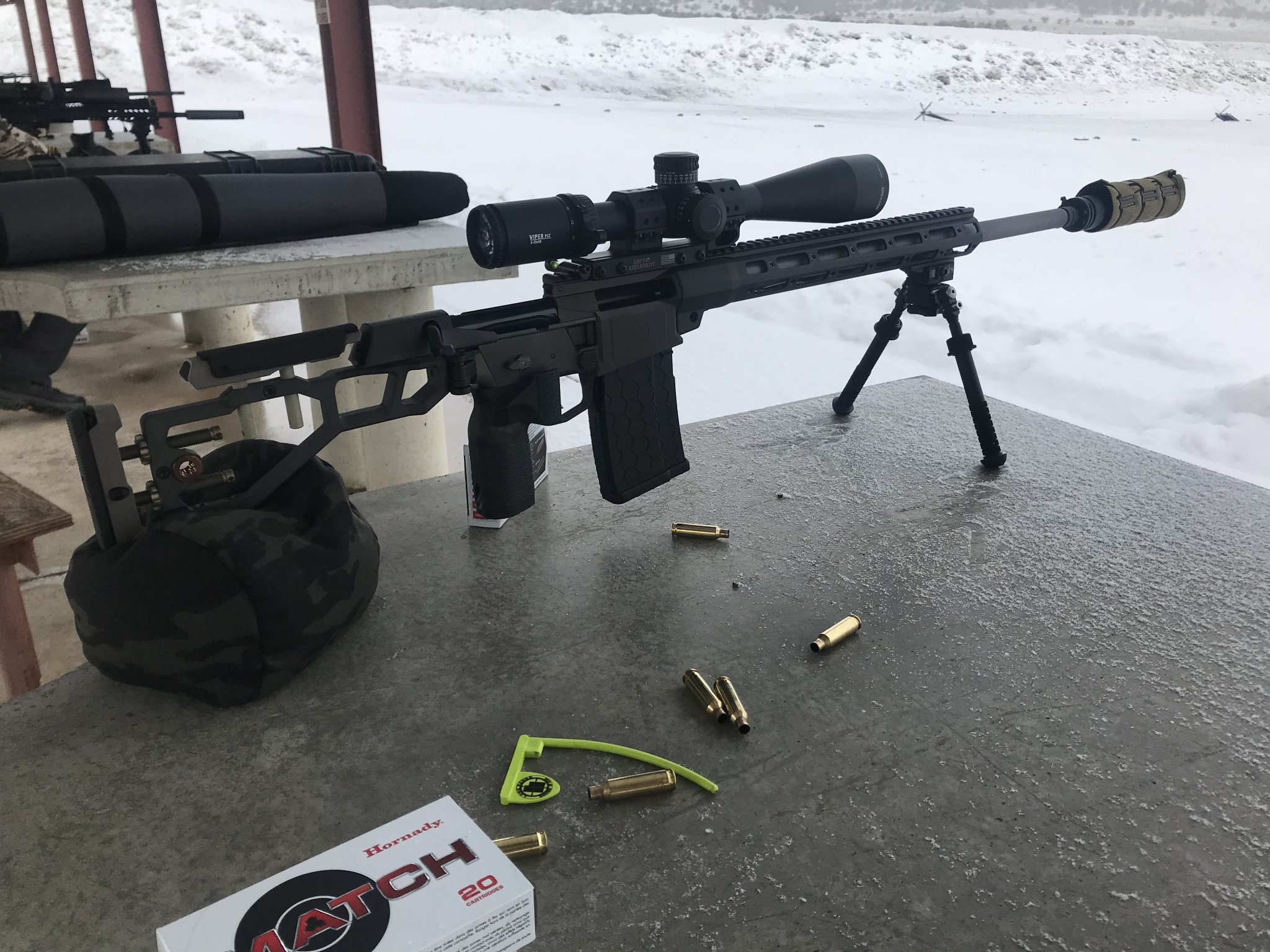

I took my Fix 6.5CM 22 inch barrel to a Precision rifle course last week and shot out to 1000 yards. I was one of a few that completed the “Milk Jug Challenge” which is hitting the milk jug size steel target at 1000 yards, it took me five shots. Used Hornady MATCH ELD 140gr.

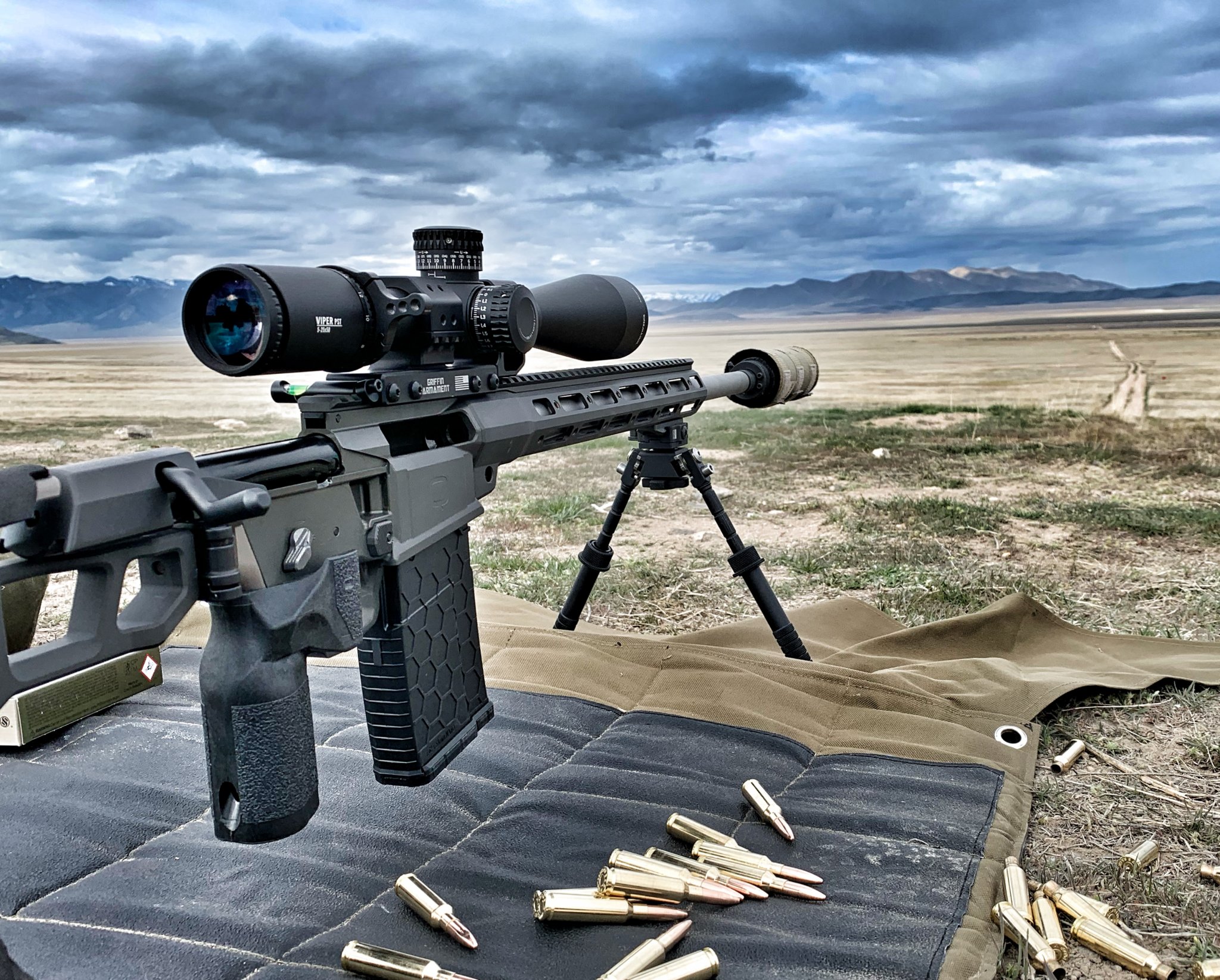

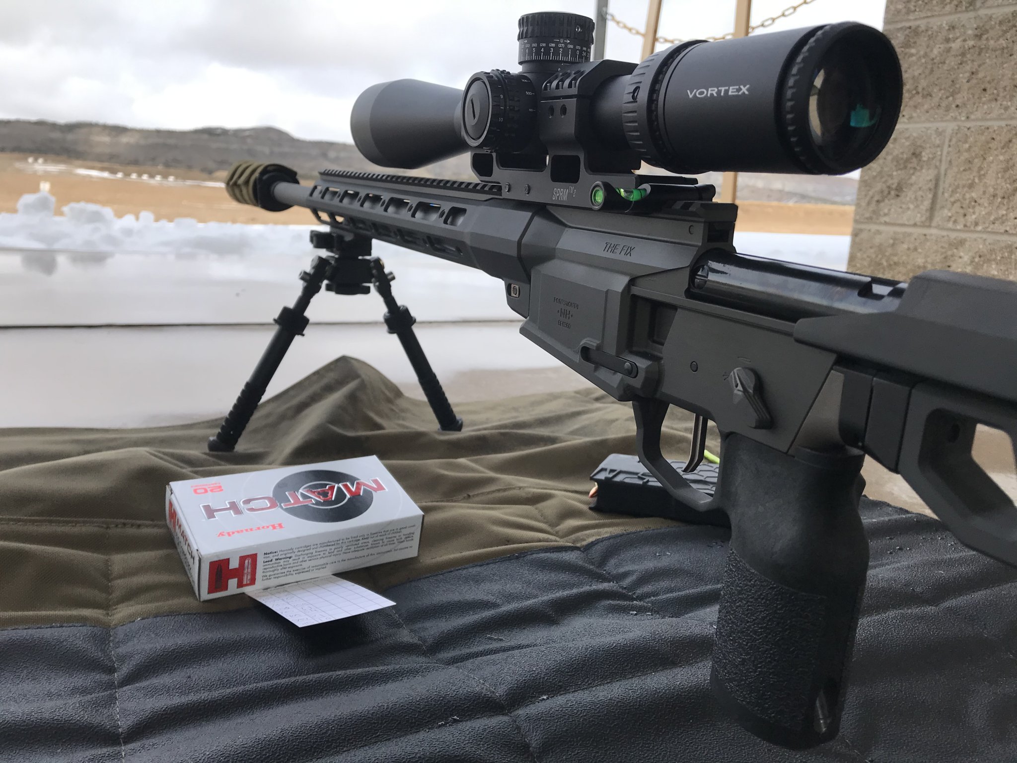

Just mounted up the new Vortex Razor HD LHT 3-15X50... haven't had a chance to zero it in yet, but the glass is super clear and the weight to rifle ratio now seems perfect with this scope. Had a Vudu 5-25x50 on it and the weight balance just didnt feel right to me.

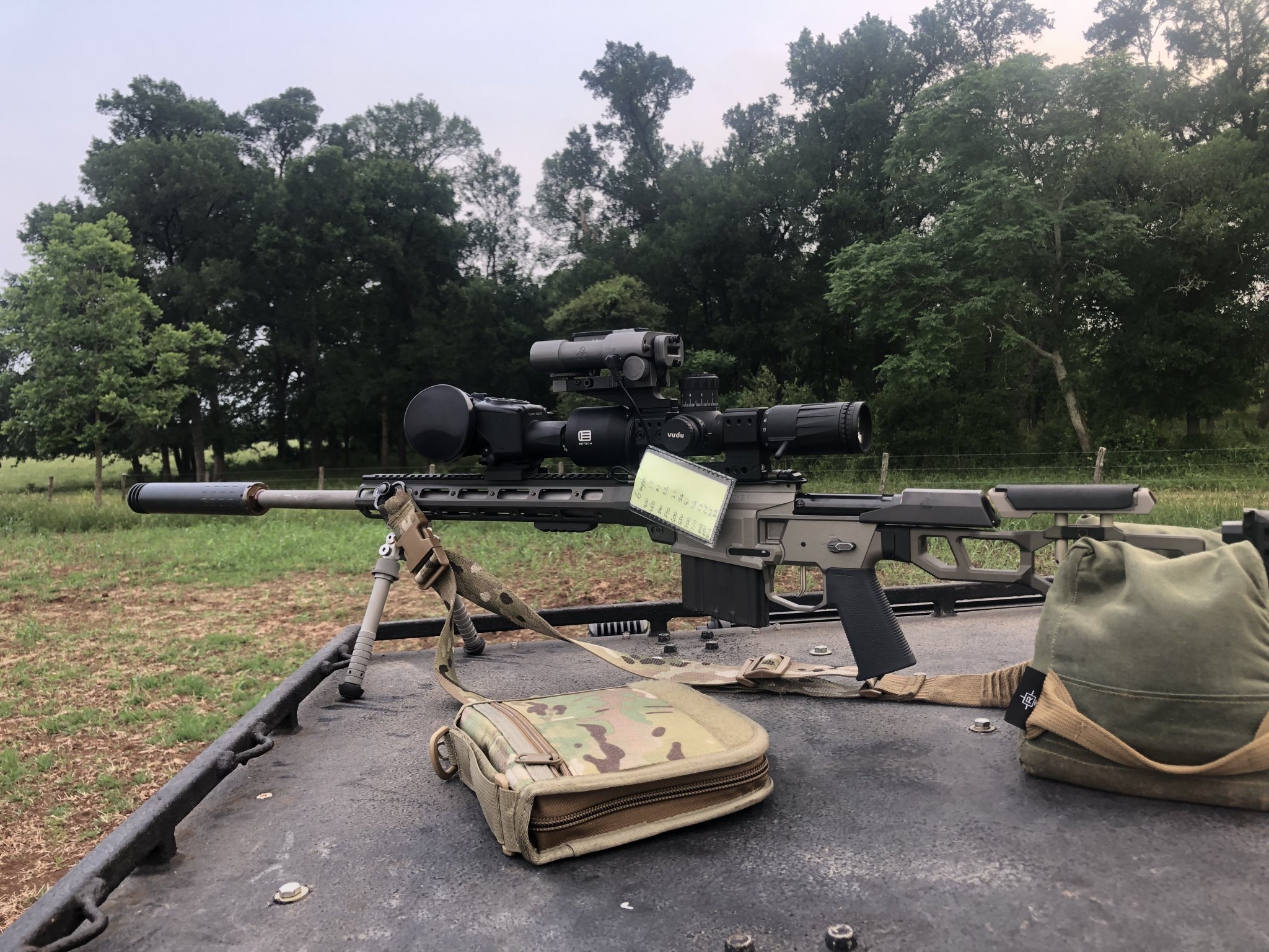

Happiness is a cold bore shot going where you want it to. The fix has been good in that regard with both the 6.5 and 308 barrels. 143eldx/h4350 and 178eldx/varget loads. The last time the 308 barrel was on I smacked a boar at 450 in the middle of the night and then a center punched 750 on steel. Before today I only put 5rds through the 6.5 since getting it back with the new receiver. 4 to rezero and one on a 300yd coyote pup a few nights ago.
Today I just happened to prop up at 675 and let 2 fly based off my dope card only. Wind was off a little. It has been overcast so I couldn't actually make out the steel with the thermal.

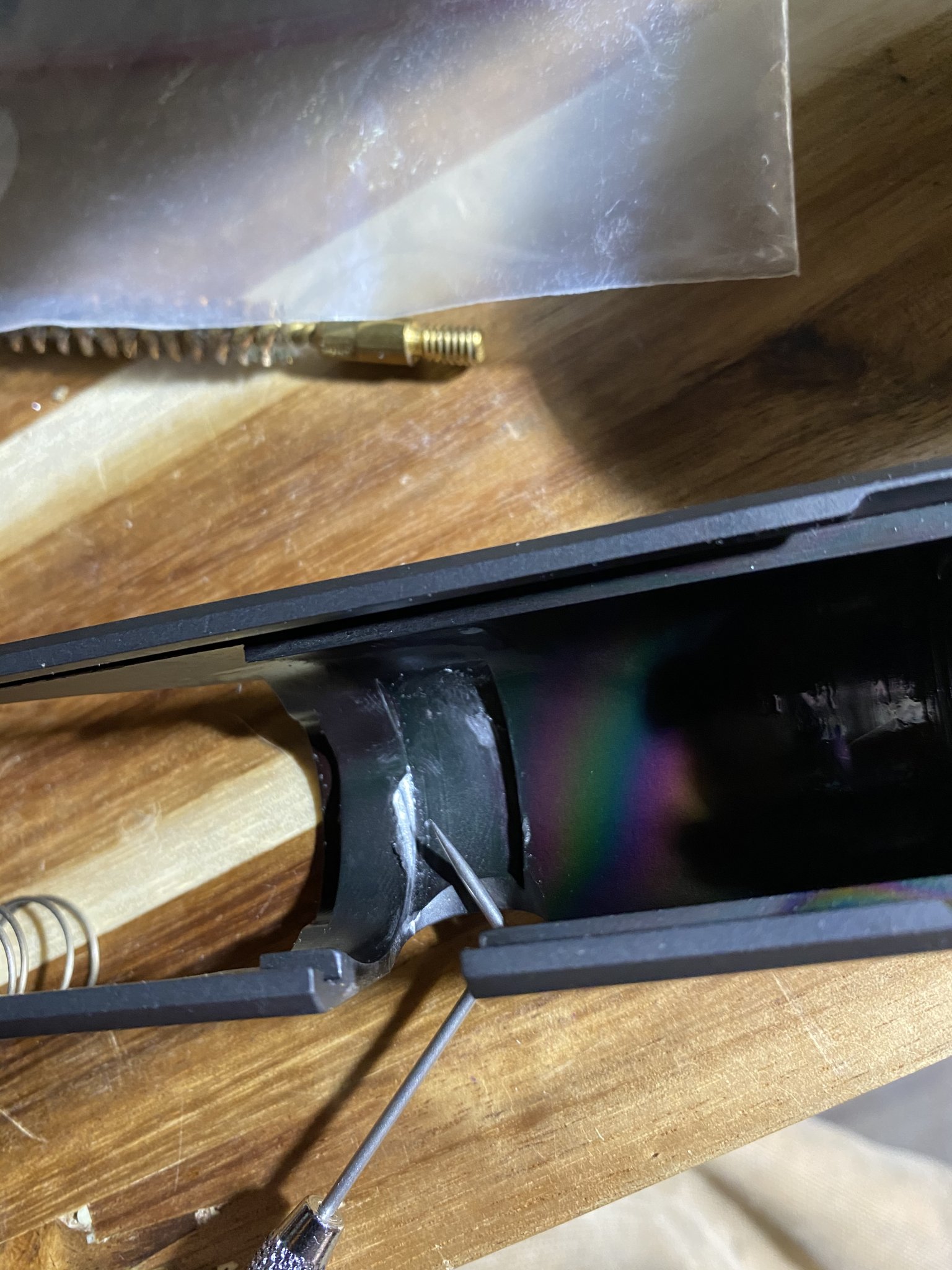

after spending a few hours on here reading I am very disappointed in my purchase. I bought my fix about two months ago and it has been inoperable more than I can shoot it. Right away my bolt was extremely rough and was a pain to operate. So I contacted Q and they sent over a shipping label for my bolt which took 7 days to ship there, and then they had it another 3 weeks with no response. On Easter I commented something on their Instagram post how my Easter would be better if I was shooting my fix and it wasn’t getting fixed. Well I noticed they removed my comment and so I posted it again and guess what, they blocked me. So I reached out to Tori at Q and she got my bolt fixed and shipped out to me the next day. Now that I finally got my bolt here and went to go shoot it for only the second time I am having extreme failures to feed. I’m not sure I have got a pmag that came with the gun to function fully without jamming yet. It is the same problem a lot of people are having and even if I run the bolt fast it does it and will even dent or scrape my brass. I am at an extremely loss and anger over this 3k rifle. At this point I don’t even know what to do. If I could return my gun and get my money back I would, this gun is not worth the extreme hassle and problems. That is just my opinion. Thanks for the info on here guys.

I wasn’t even belligerent on their social media, they just cannot stand true criticism and it shows. My rifle is a 6.5 and I have only tried the original two pmags that came with the rifle. I have not had the chance to try different mags, or even put Velcro in it but there is no way I should need to on a 3k gun. Mine is a 300+ serial number. And mine doesn’t enter the chamber and seems to jam the bullet. I need to get a video of it happening. But it sounds identical to other guys issue in this thread.

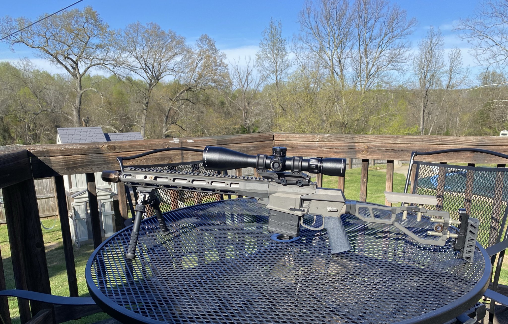

this pic is from shooting in the desert last weekend.
