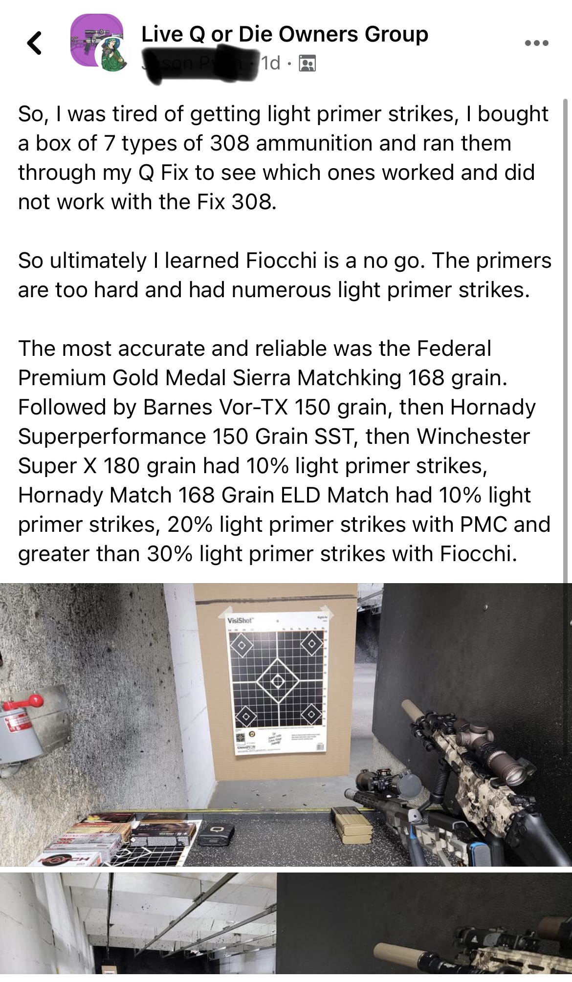

So apparently light strikes can be an issue with the full size fix also now. As per past experiences Kevin showed up in the post crying about “machine gun primers” and striker fired guns that a cheap Remington or savage has no issue digesting and I assume posts or the whole thread disappeared.
Like the 6.5 feeding issues (that now YEARS later they finally admitted to) it’s not so much that they have growing pains that’s the problem. It’s the arrogant, condescending attitude that obviously you’re doing something wrong and our product is perfect.
Making a bolt gun that goes bang when you pull the trigger. Unpossible apparently.

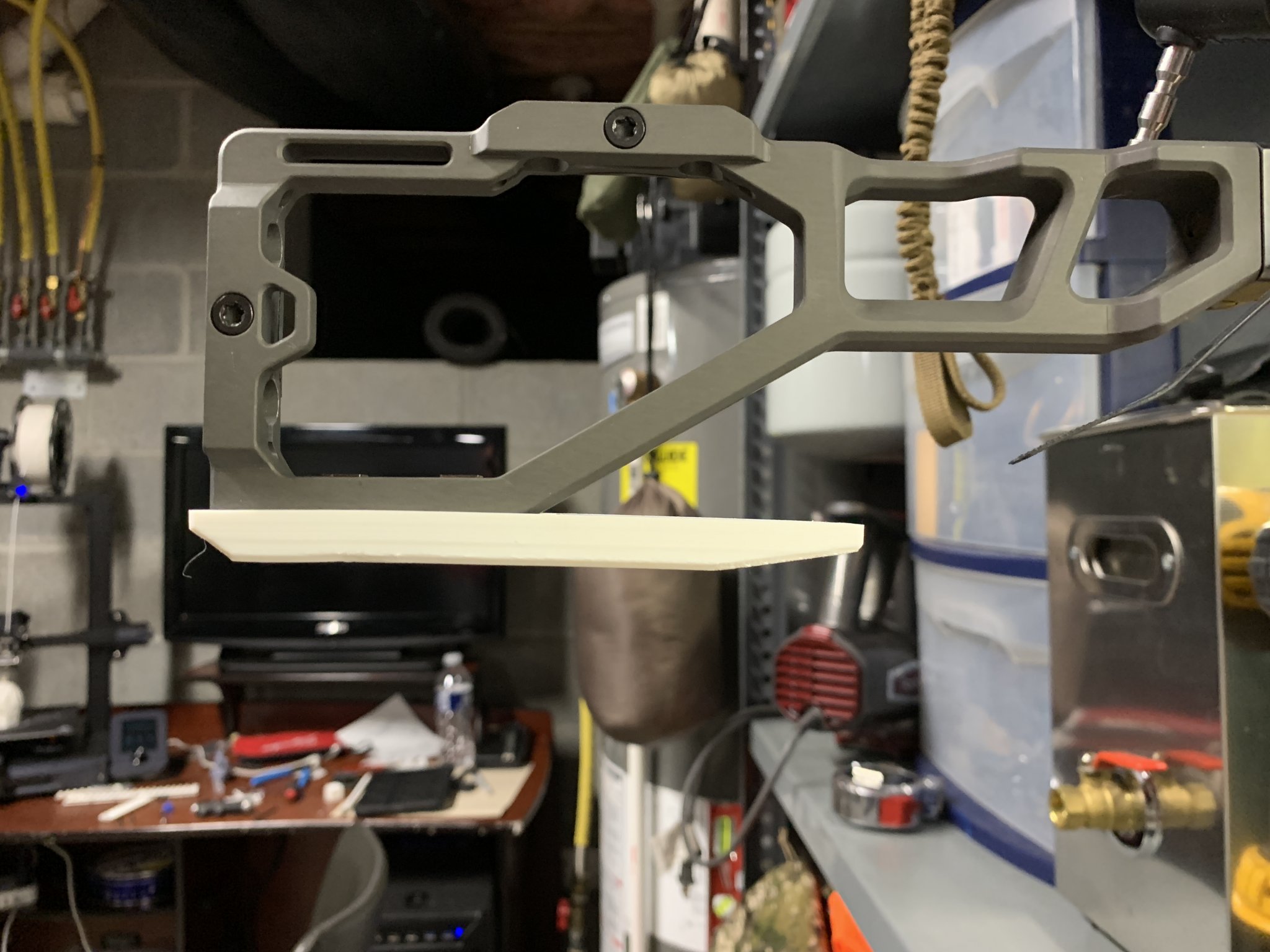

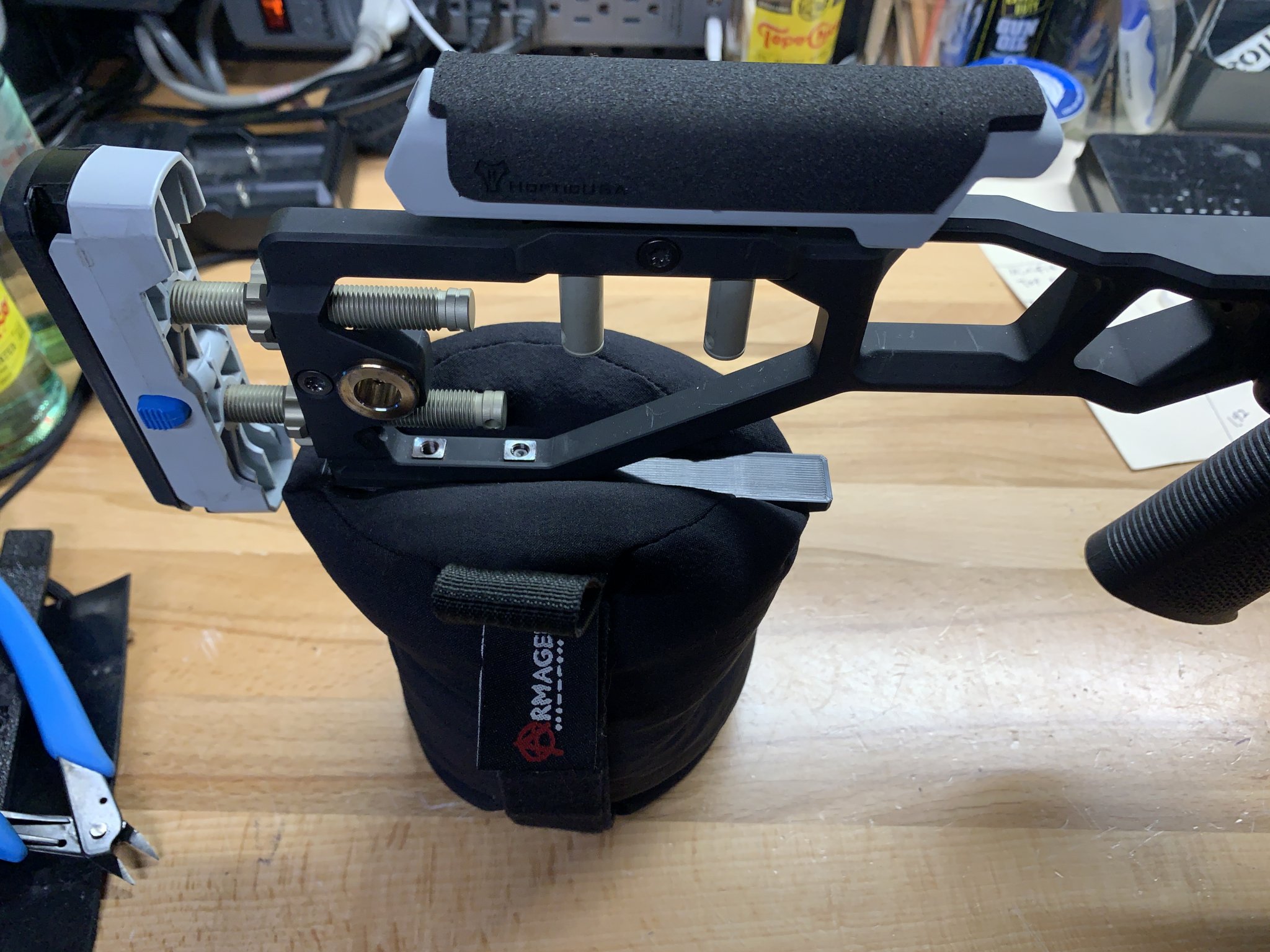

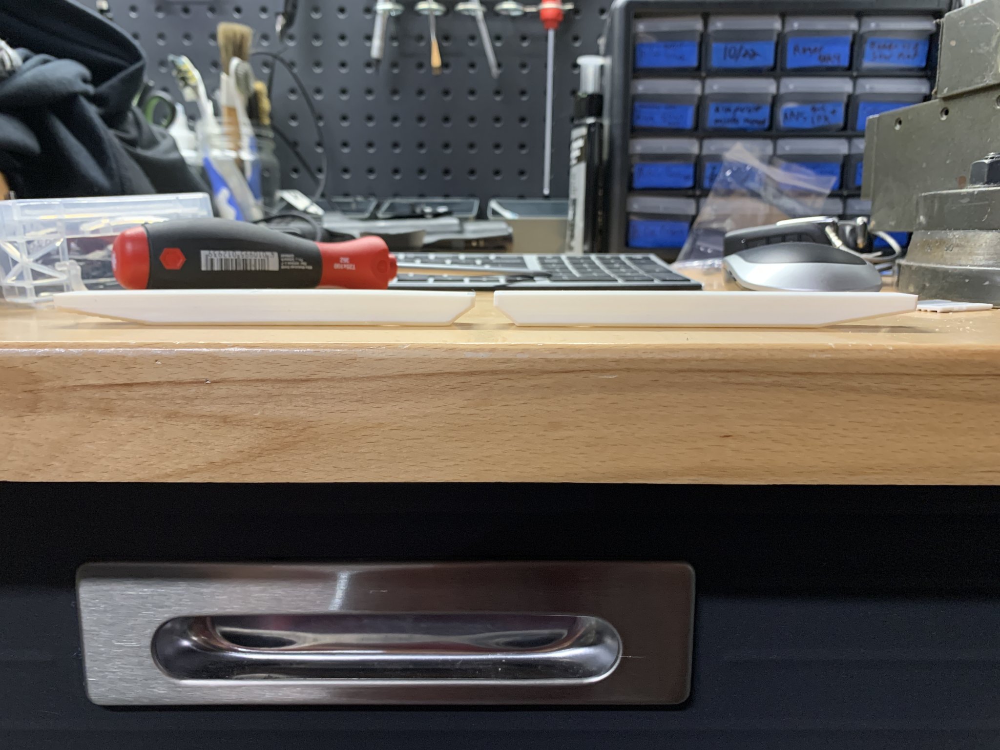

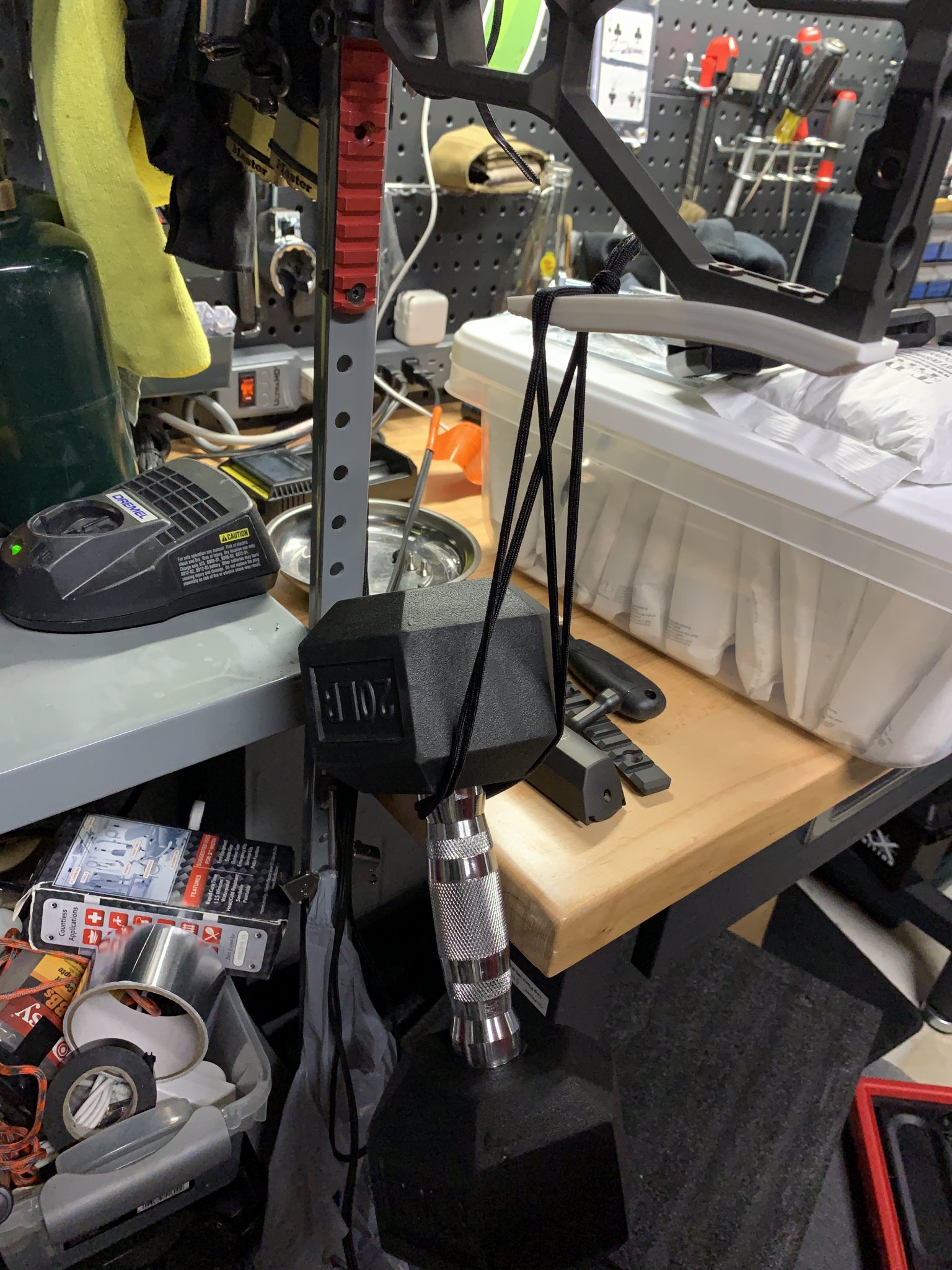

I finally made the time to finish my design and 3d print a couple for testing. Decently strong and returns to form. The tested (left) vs the brand new (right) we’re identical even after holding 20 lbs.

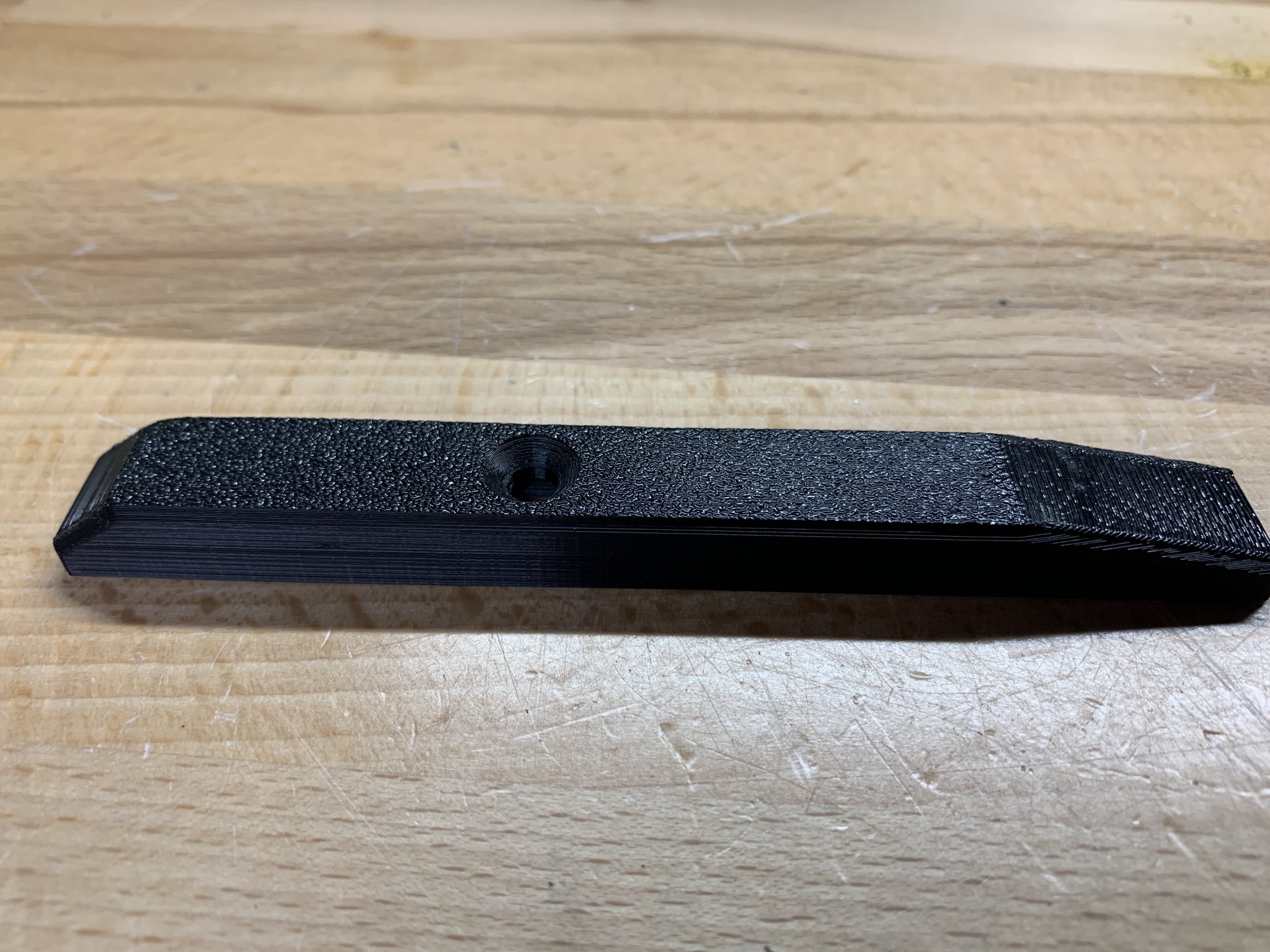

Haven’t been on the forum in a while, but I came into contact with a guy on Instagram that 3D printed this one.. it’s awesome. Sorry not a great pic. But, I can try and find his info.

I've never really messed with bag riders before but would the flat bottom be ideal over a rounded bottom?
From what I’ve tested, it’s not really the shape as much as it is the width and rear bag density. I use an Armageddon Gear Squishy rear bag and it’s been great. Shot the majority of the small bore winter season with a Vudoo in a chassis with The Fix stock.
2" Delrin rod is cheap enough to try whittling different shapes and turning down the diameter. Maybe even try grip tape or whatever.

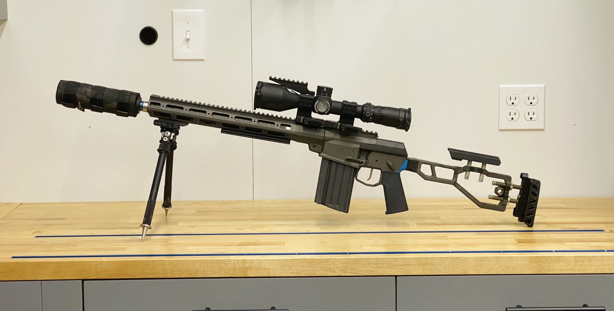

i don’t know why but mine only likes 1 of my 3 kac mags. It’s super annoying. It likes lancers/pmags, I actually just ordered one of the s/w mags?… lol. We’ll see how that goes… but it’s like the next mag down from a kac that’s available and aluminum.
