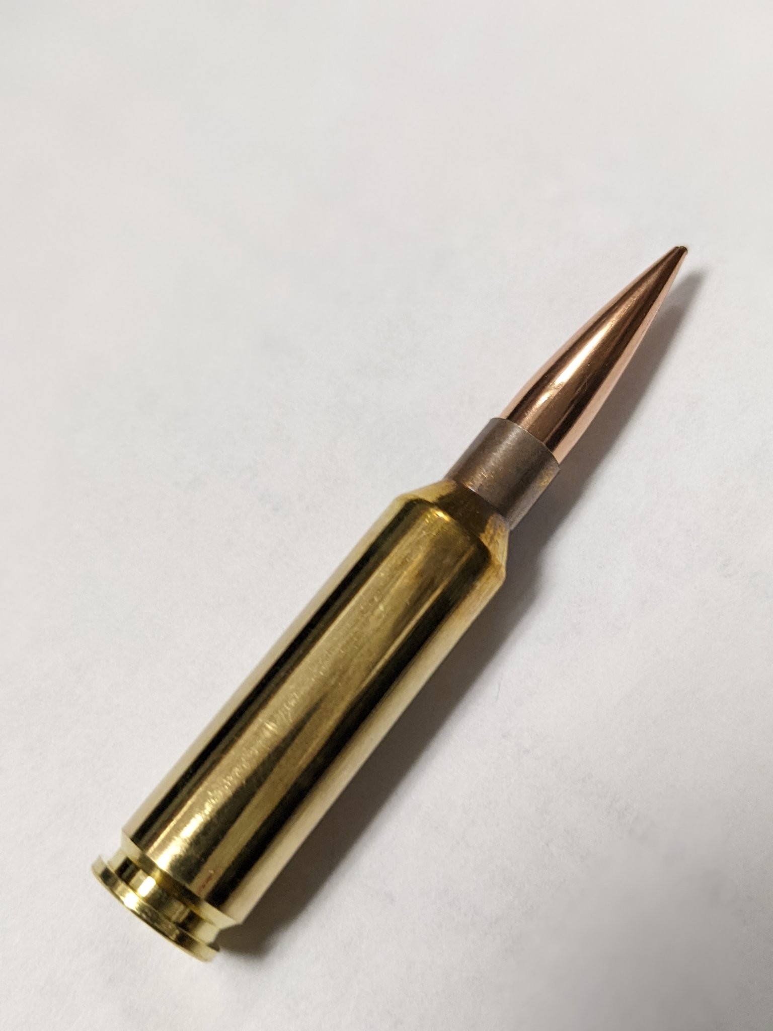

I run 140 eldm, 143 eldx, and 147 eldms all factory.
I've tried the 140 & 147 eldm and the polymer tip is easier to ride the chamfer into the chamber, but it is still a man handle event to get it in the chamber in my example
I have never had a feed issue - Magpul mags only. I run my bolt pretty hard though. I suspect if I was gentle it might be more of a thing for me.

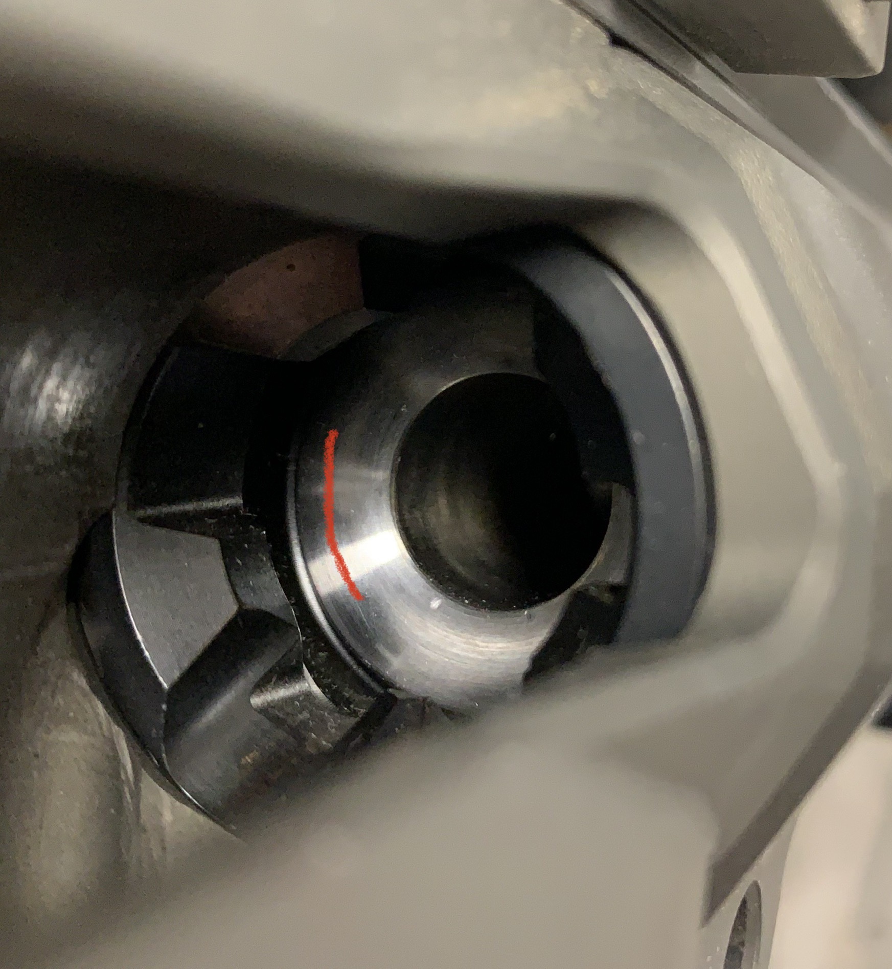

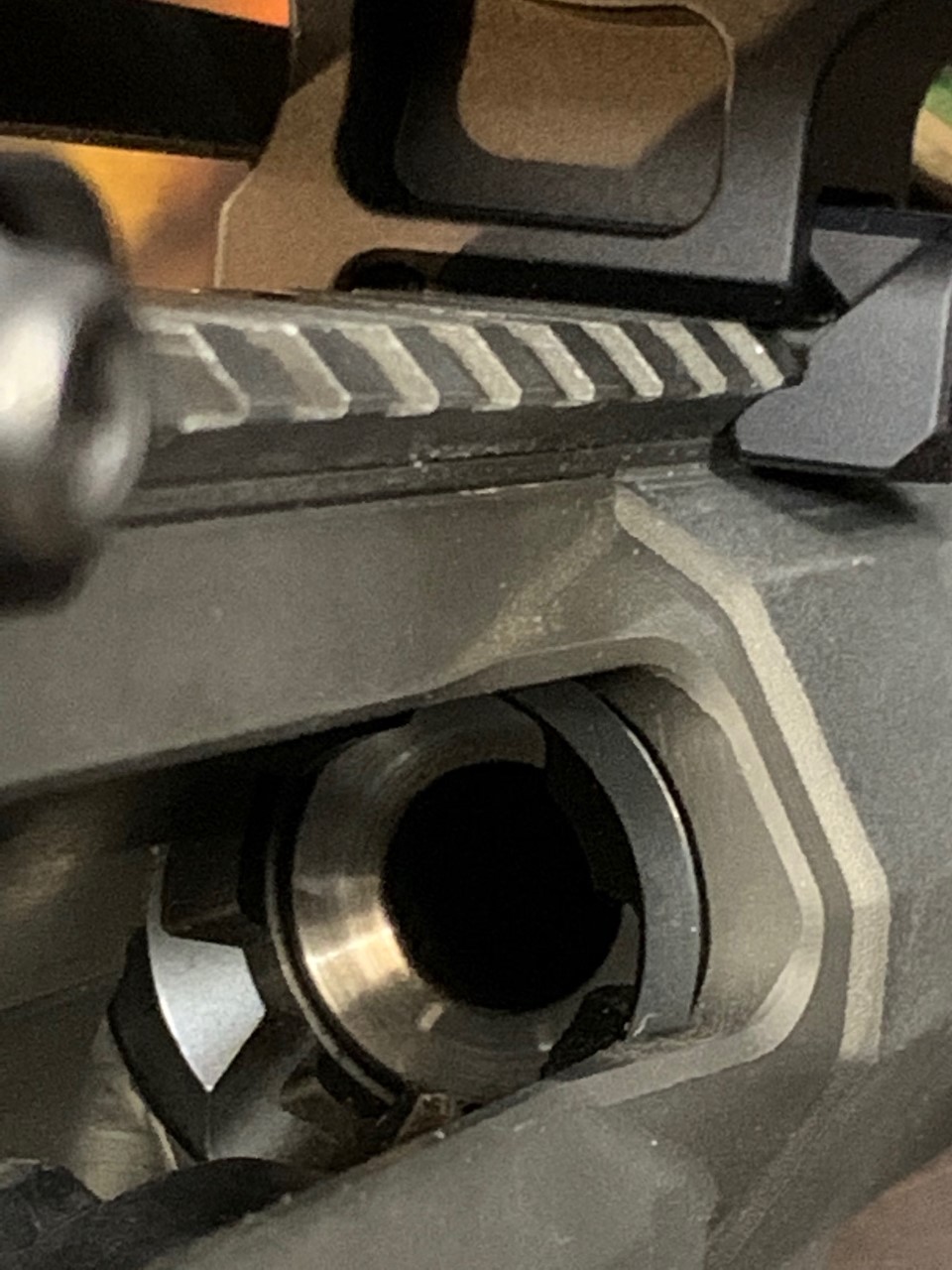

Curious next time you've got it good and dirty if you notice the marks along the bottom of your chamber where it's riding into the chamber or if something is different in your case?
... it seems like that was with the 6.5 and mine are 308Win, 300Blk and 8.6Blk...

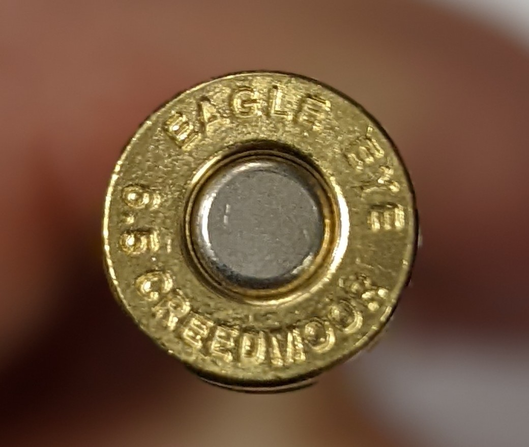

I think anything. 30 and up would be fine. Was thinking a 338fed might be an interesting use of a barrel extension.
I've even wondered if a 7-08 might feed into the chamber better.
Now spill the beans on the 8.6 lol!
Eldm at 2.780. I never had any issues with my factory barrel, but this is a barrel I chambered myself in 6.5x47. Virtually identical neck/shoulder/bullet relationship to a creed, but with the shoulder being .080 back from a creed, this is a worse situation.
I must say that's far better than what I'm seeing!
I'm thinking the bullet would either be in the chamber or stuck on the nose / chamfer before the shoulder makes it to contact the extension anyway ... So I'm not sure you are any worse off... I need to test some more and see how far my case is from contacting...

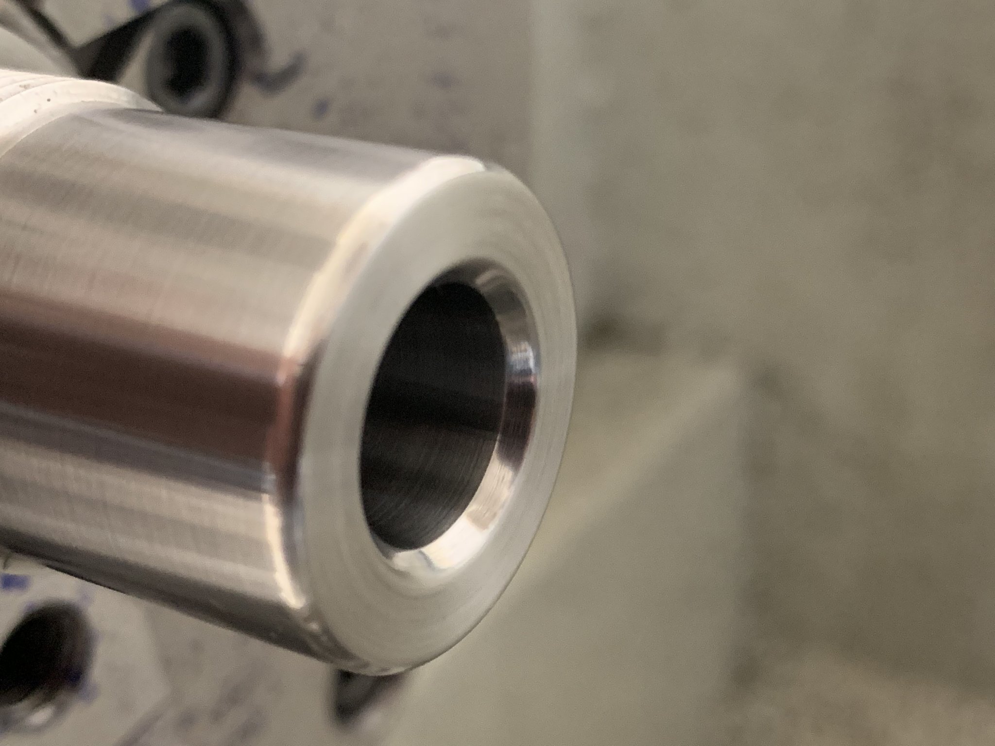

Did you end up increasing the chamfer angle into the chamber?
If so...
Able to abandon the prefit design and actually push the barrel back closer to the bolt face? Or did you have to leave more of the case unsupported in comparison?

If you scroll back a couple of pages, there’s member who has a barrel I altered for him. It’s a totally different chamfer design. Case is completely supported though. I don’t shoot heavy bullets in my gun, I made that dummy round for the sake of the video. I shoot 95 vmax’s and I think they’re around 2.65 or something like that.
Had to search a little, but yes I had missed these pics. (Hard to not miss stuff in a hundred page thread though lol)
Thanks for the explanation!
cut two wider angles on the existing chamfer(going no deeper), and blended them. View attachment 7462063
I also noticed between your photo and fmj's that there is still the same mark showing in yours as well. Is that even with the 95 vmaxs?
View attachment 7462110.
If so I take it there is nothing that will actually feed into the chamber in 6.5, but it is possible to polish the chamfer terd to high hell and at least help it get to the chamber in a much smoother motion it appears from your videos
Only way I could see avoiding it is to lengthen the extension, and change the bolt head. Total redesign of those parts in other words. I dont see it as a problem at all the way it is. They just need to cut better chamfers.

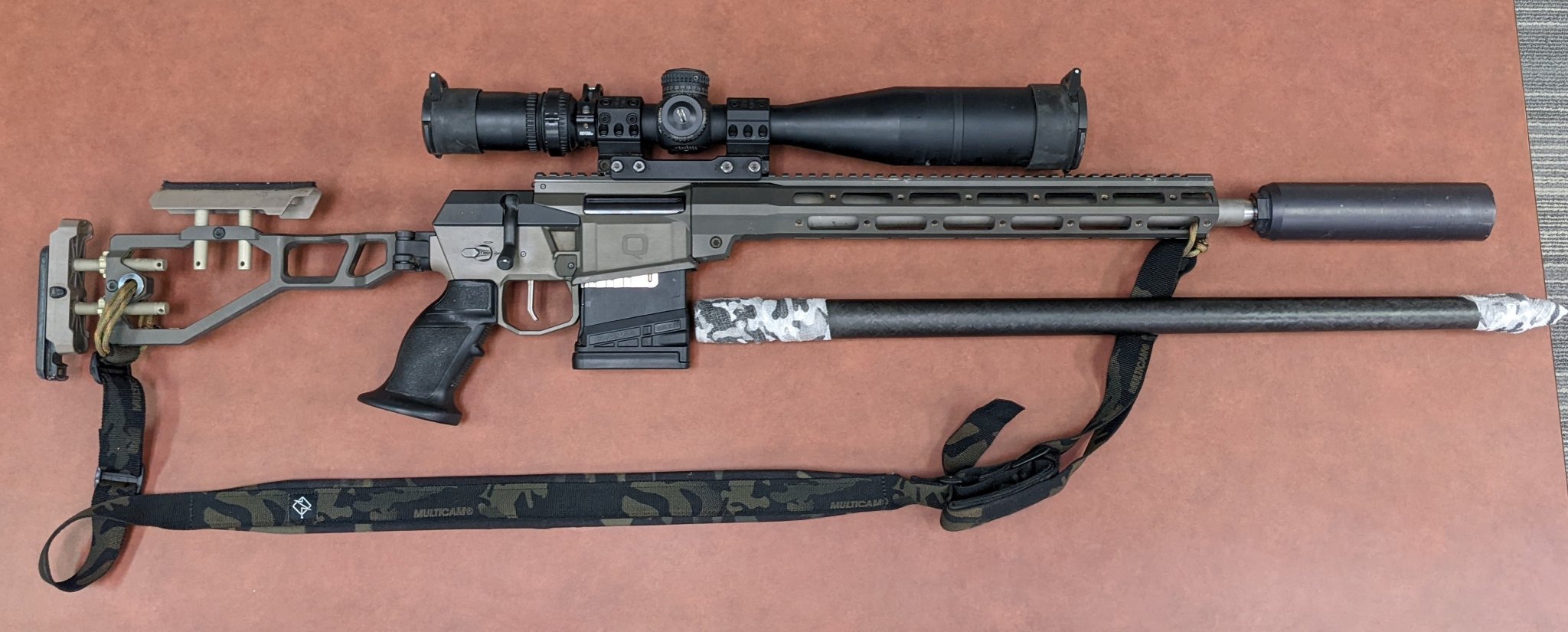

The Fix is my primary hunting rifle and I do pretty much everything with it. It is under 10lbs as configured with an optic, so recoil control takes a little work, but if I really want to do competition-style shooting with it, I can always add weight. However, if you have an 18lb gun as is, you can not take weight off when it comes to hiking uphill.
I am thinking of picking up a dedicated heavy precision gun, but in the meantime, the Fix does pretty much everything I need it to.

The lighter weight is what I was after for sure
The original idea was to get a 6mm running in it (that's why I picked up the extra barrel extension)
After what I've seen in 6.5 that seems like a pipe dream though...

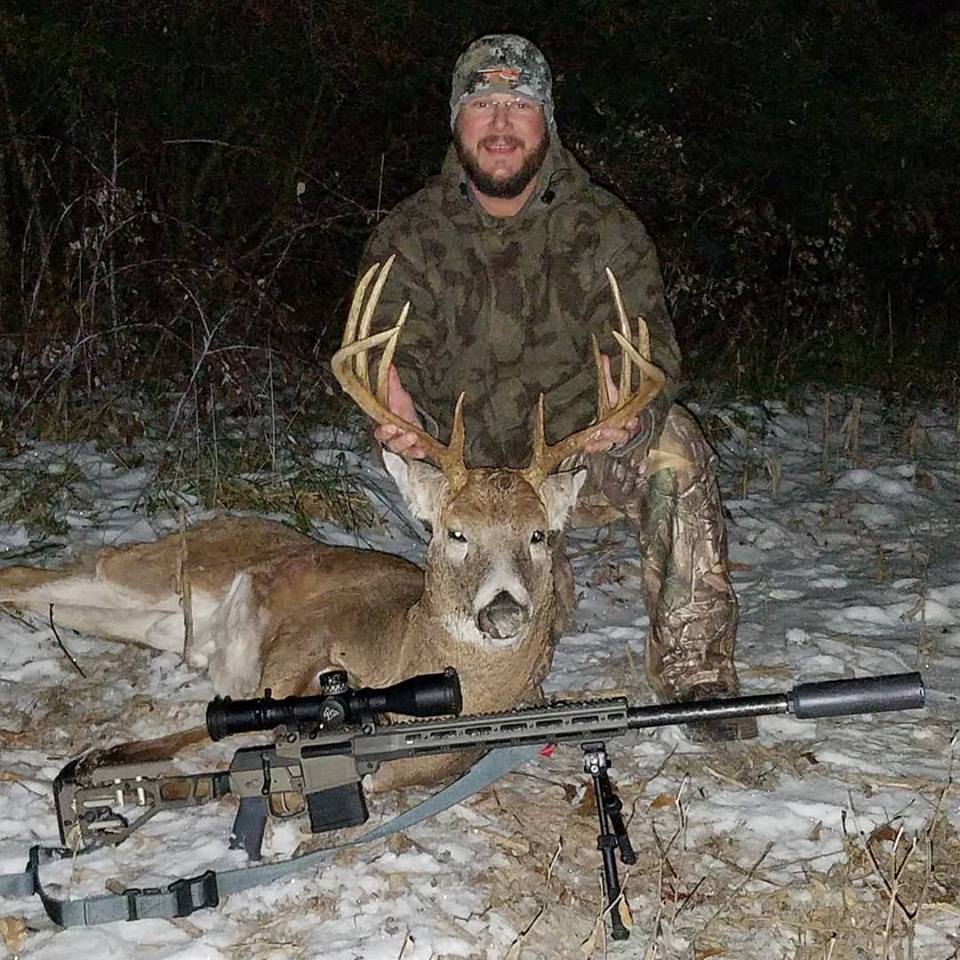

I got an early serial "Fix" in 6.5 CM #0086 with matching serial Trash Panda. Never had and issue with feeding in pmag. I changed to Lancer Mags and still no issues. I have the original Bartlein/Tooley 1:7 and 24" Proof 1:8. (Proof is for sale if anyone is interested)
I just had my original Bartlein/Tooley 22" cut down to 16.5" for more mobility. No complaints so far.
Longest shot on Whitetail was 535 Yards in NE Missouri with 24" Proof barrel (Snow Pic Below)
Love this rifle...
^^ yes dude. I had been all about the 20+ barrels, but Bachelor talked me right out of that haha. 16-18 is such a perfect barrel length for this platform.
Beautiful deer too, man. Love it!
The 24" Proof is a shooter now, but the length with Trash Panda is not fun hunting like I do. I do miss the close to 2800fps with handloads on the 24". Only getting about 2410s on current load pushing 140 Berger, but is stacking them.

No problem Gotlag1789! My problem is I have 100 rounds arriving tomorrow from Eagle Eye Precision loaded with this "problem" 140 Berger Hybrid Target Bullet. I just ordered the one box of the Berger Factory ammo with that bullet to compare to the Eagle Eye Precision Ammo.
That's when I noticed my 1st feeding problem since I bought this rifle back in 2018.

Of course look what shows up today in all it's beauty.. Eagle Eye Ammo guys do it right! Too bad they won't feed!!! 140 Berger Hybrid Target..
:mad::mad::mad::cry::cry::cry:
