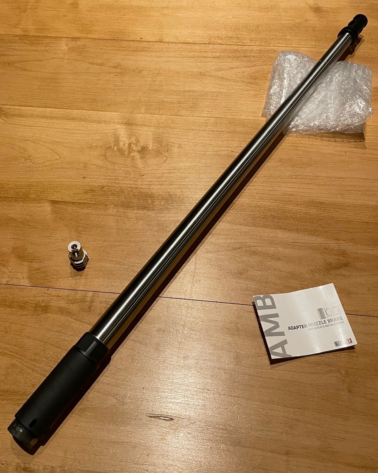

Look what Brown Santa just dropped off today for my MRAD... 30" Bartlein 33XC ModBB barrel...

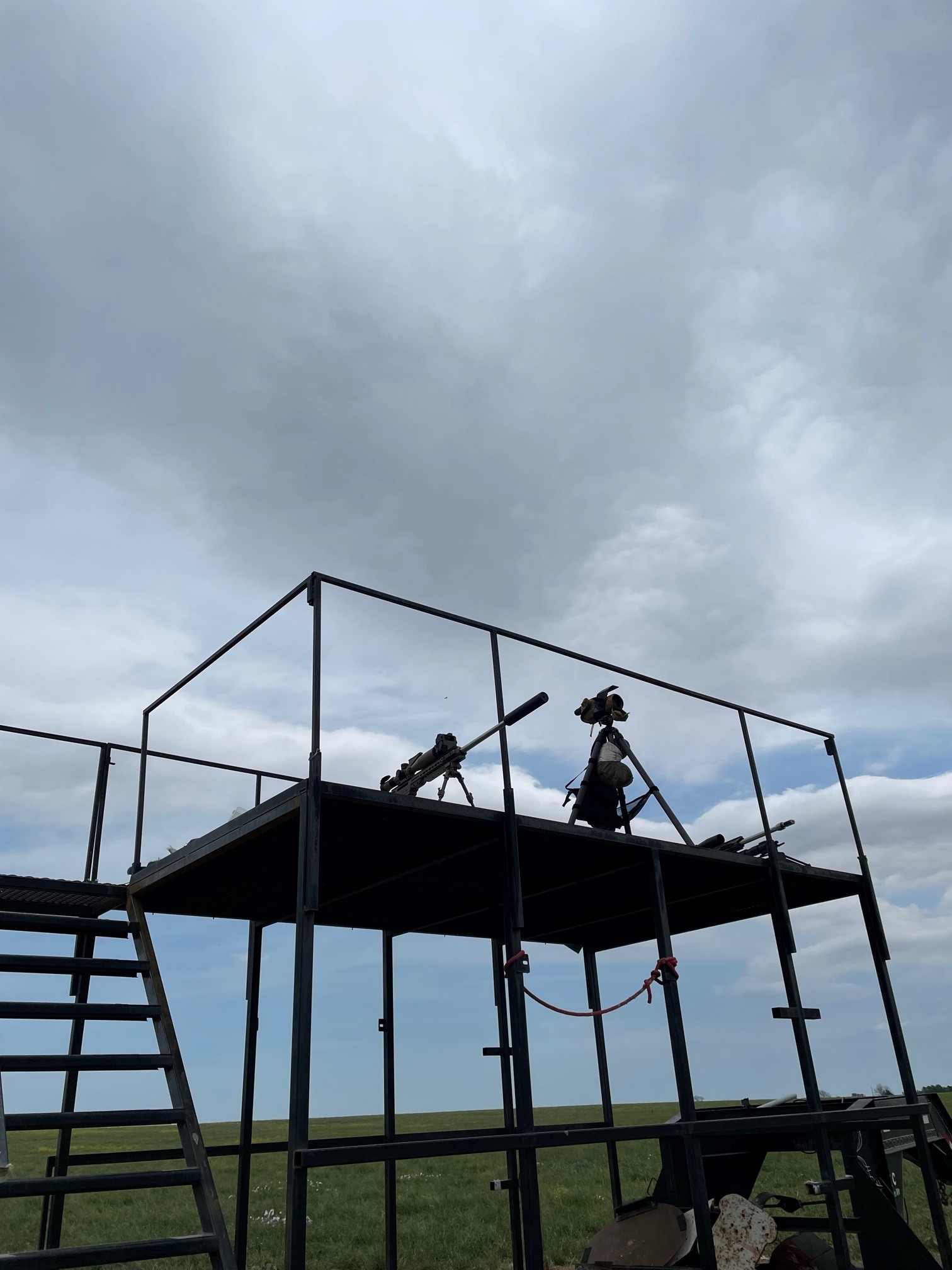

Just got back from Texas late last night. I will post up some pics this weekend. Can't remember if I said this but my 2-day class with Chase Stroud was Monday and Tuesday. The first day was an intro into reloading and load development since I have never re-loaded. Chase was EXTREMELY knowledgeable. I was not interested in ringing out every last fps but wanted something decent with good barrel life. We wound up with 120.4 grains of H50BMG for the Badlands 275gr Super Bulldozer-2 at 3180 fps after fire forming. When Chase was done, this barrel was putting 5 bullets through the same hole at 100 yards and shooting a 1-inch group at 500 yds. Even Chase was pretty astonished at the accuracy. Since his reloading equipment was 15 feet from his range, me trying to duplicate this where I live would have taken me countless hours and trips.
Spoiler Alert: The next day, with Chase spotting, I was able to make two consecutive hits at 2-miles in 13-22 mph winds. When I was leaving, Chase told me my rifle could easily compete in the King of 2 Miles. To say I was ecstatic with the whole experience is the understatement of the year!!! If you are interested in taking your ELR skill the next level, or the first level in my case, I would highly recommend ONE-ON-ONE training with Chase. I've always believed the best person to learn from is the one who is doing it and doing it extremely well.

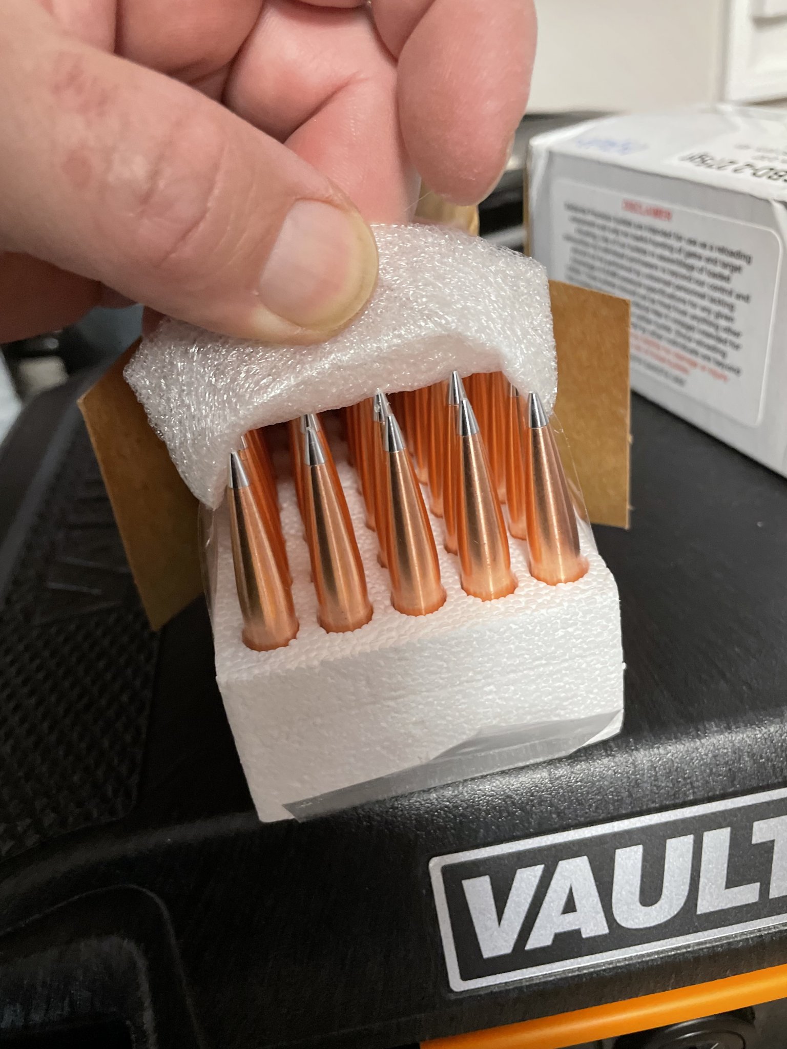

What made you go with the 275 Bulldozers
Length: 2.00″​
BC (G1): .880​
BC (G7): .451​
vs the 265 ICBM
Length: 1.957​
BC (G1): 0.910​
Just out of curiosity

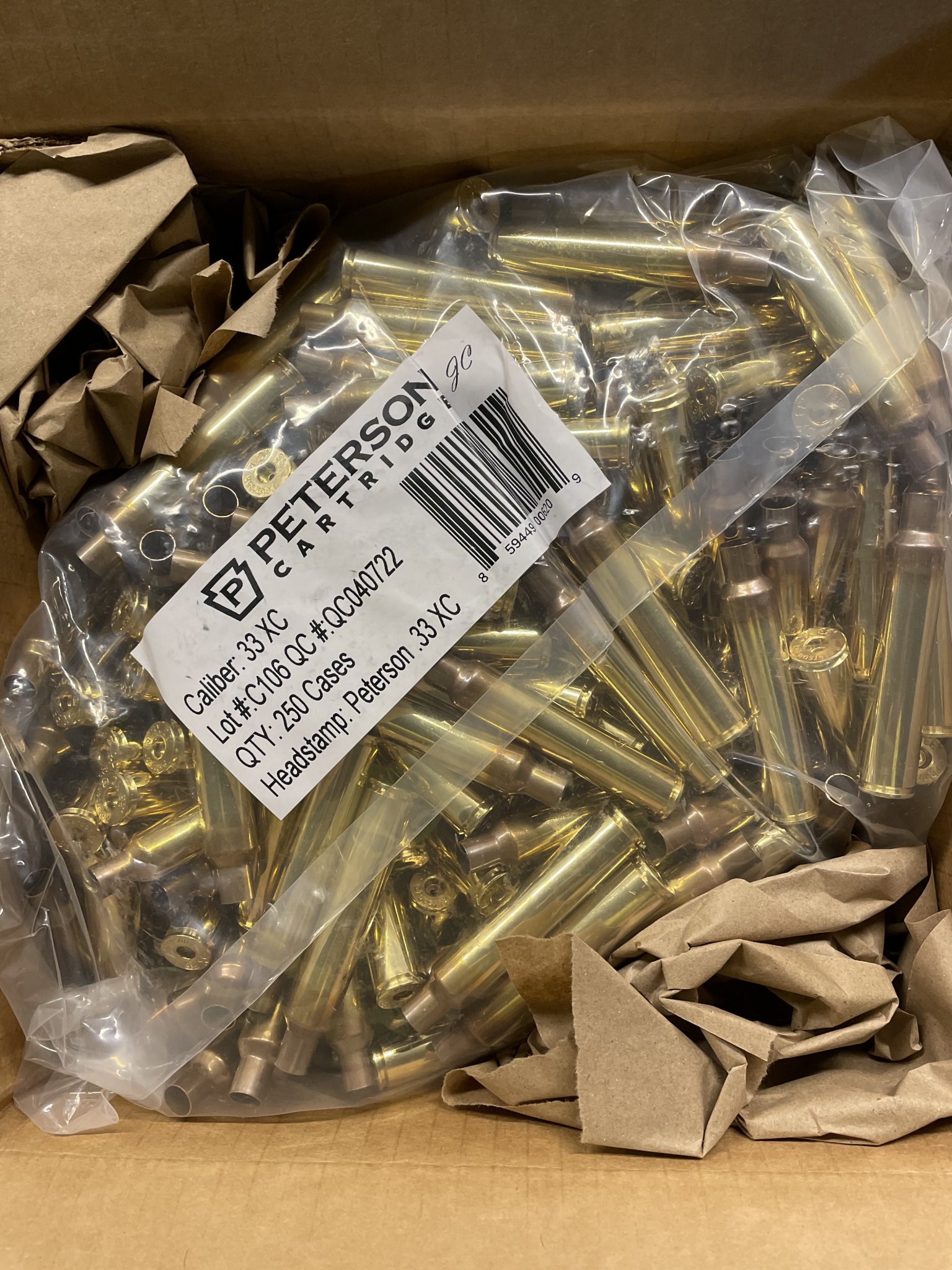

Super newb so take my comments with a grain of salt since I'm still learning... I was told I should have gotten a 34" barrel for the 33XC to take full advantage of H50BMG's slower burn rate. I could have achieved even more velocity without pressure signs and no unburned powder. Being in the Phoenix area, personally temp stable powder seems best for our wide swings. Finally, I was able to find (2) 8 pounders fairly easily on Midway and LG Outdoors website.
