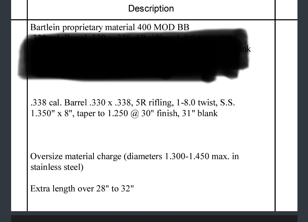

Specs on that barrel
I'd go a little heavier on the taper next time, Greg at Southern Precision wasn't happy with how close it was to the rail and tapered it down a bit. With the flutes it came in at 8.3 lbs finished, so puts the rifle at 24lbs or so, so plenty of room for the elr light class.

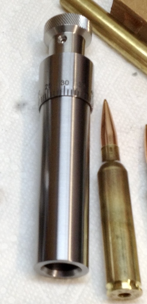

Anyone make 37xc in line seater?
ETA For a 375 cal round; a custom seating plug is required. Maybe Wilson would make the plug for you.
The person that chambered your barrel could use the reamer a second time to cut a chamber that will screw onto a 338 cal Wilson inline seater. Just give him the top side parts. Here is one I made
