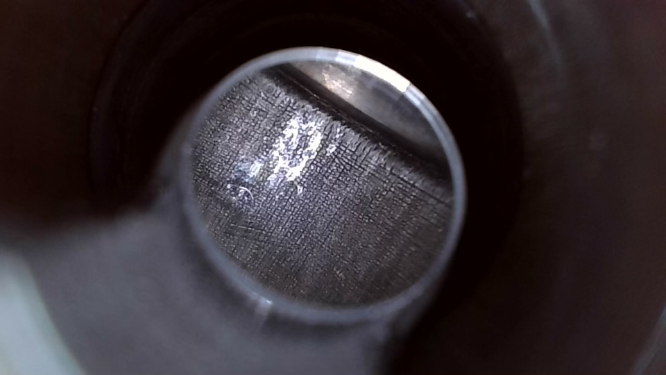

Ah but there is... Bartlein ModBB. I am "only" running 3180 fps on SB2-275gr solids but after 100 rounds, Chase Stroud scoped it and found ZERO fire cracking. I expect at least 1500-1800 out of this barrel with that load, which for me at my current round count means 5 years or more.33xc is a throat eater. No way around it.
I'm running H50BMG.I also run a modBB and w n570 she ain’t pretty.. I have a spare barrel coming. I think I will only run H50bmg in that barrel and see what the round count difference will be.
What grains and velocity?I’m running a ModBB and use H50BMG, this is how mine looks after 65 rounds

Edit- NVM I looked back and see that you indeed are. That's rank for 65 rounds.
