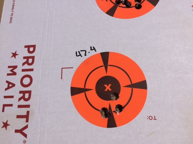

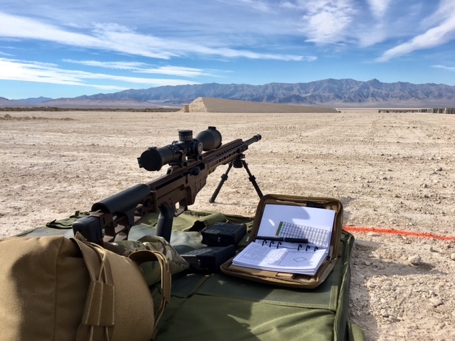

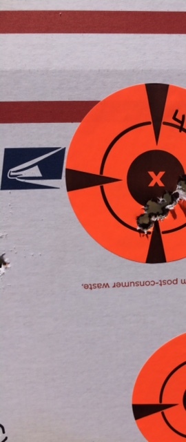

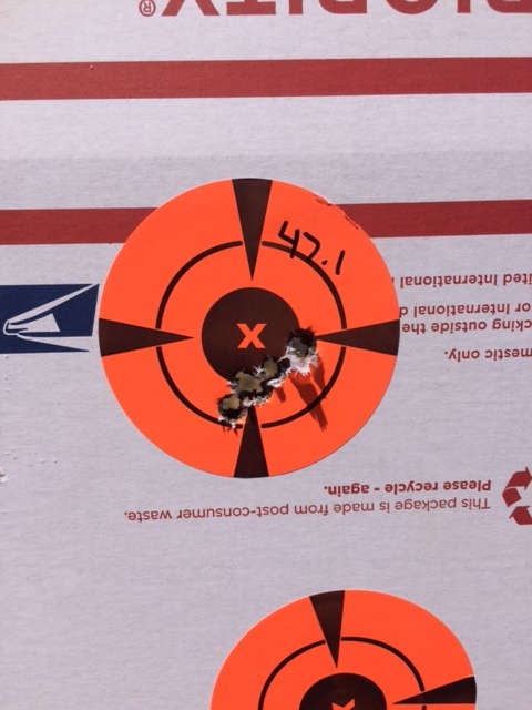

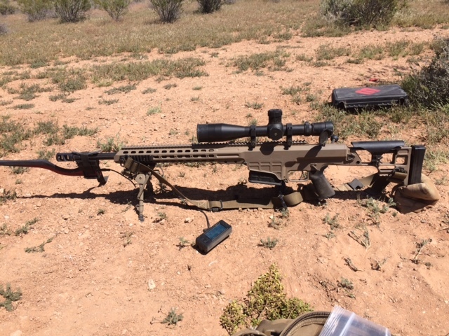

Since I said I would, I took a quick action photo while out doing load development today. Nothing too crazy, just the MRAD with the Magnetospeed on it. I'll put some more up later with everything on it ;)
Did some 308 today and was trying out a 2000MR / 175SMK combo to see if there was something there, before changing up to the 185 Juggernaut. The bad news is, the Juggernaut has a lot to live up to because the 175 in this gun is insane so far. I'd love to get the 185 going as I love more energy on target, but we shall see.
After centering the gun at 100 and managing to put 5 rounds into 3 holes, I put it out to 200 and started shooting 5 shot groups for each charge increment I had with me. Posted max for 2000MR is 47.7 grains so I stopped short at 47.4 since it was already in the 90s and just wanted to see how temp sensitive it is. At 47.4 I didn't notice any hint of anything and I'm willing to bet I could go over max (if I wanted) with this even in the 110+ degree weather I'm about to start getting there. With the results I had, I'm going to keep going to see if I can get the same results with higher velocity.
4, 5 shot groups @ 200 yards, in a row. No cherry pick, same board/backer, all 20 rounds shot <.75 groups. Only thing I did was check temps, load ammo, reset the Magnetospeed and shoot 5 rounds. Wait a few mins and rinse/repeat.
Load I'm running right now for the 175 is:
175g SMK
.001 on the bushing in a Redding die
2000MR (started at 46.8 currently ended at 47.4)
Tula 7.62 primer
WInchester case
2.805 COAL

Digging in the dirt! Nice work German. What scope do you have on the MRAD there? Nice shooting Tex!
99% of the time where I shoot, it looks like that or off some sort of cliff wall. That's just a spot that I know isn't too far into the desert where I can get a straight/even shot out to 2-300 if needed. Works great for stuff like this.
Scope is a Leupold Mk4 6.5-20 with H27 reticle, M5 locking turret that has 10 mils per rev, auto locks and zerostop.

That in some cases is .25 MOA at 200, out of a factory gun. Regardless, just as last time, this isn't cherrypicked and the #1 thing I love about the MRAD is that its repeatable on demand.

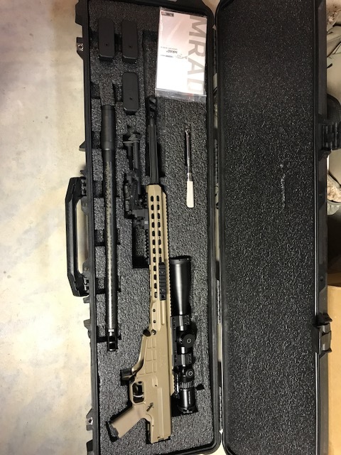

Finally able to get this working..haha. Here are some pics of my MRAD. In picture is my 6.5 CM, been taking that round out to some far distances with some great results. I also have it chambered to .308 (22').

My MRAD in 6.5CM configuration. Atlas Bipod and monopod pictured, along with Bushnell Elite DMR in Badger rings.
Have since upgraded to the newer generation DMR-IIi and a Spuhr QD mount
Also have .338LM and 308 barrels... and a Thunderbeast Ultra in jail for it. [IMG2=JSON]{"data-align":"none","data-size":"full","src":"http:\/\/i996.photobucket.com\/albums\/af85\/performify\/MCRC\/2016-10-09%2017.41.33_zps9ivha2v8.jpg"}[/IMG2]
writeup of my first shooting experience with it on ARFCOM: https://www.ar15.com/forums/t_16_17/...CM--long-.html
