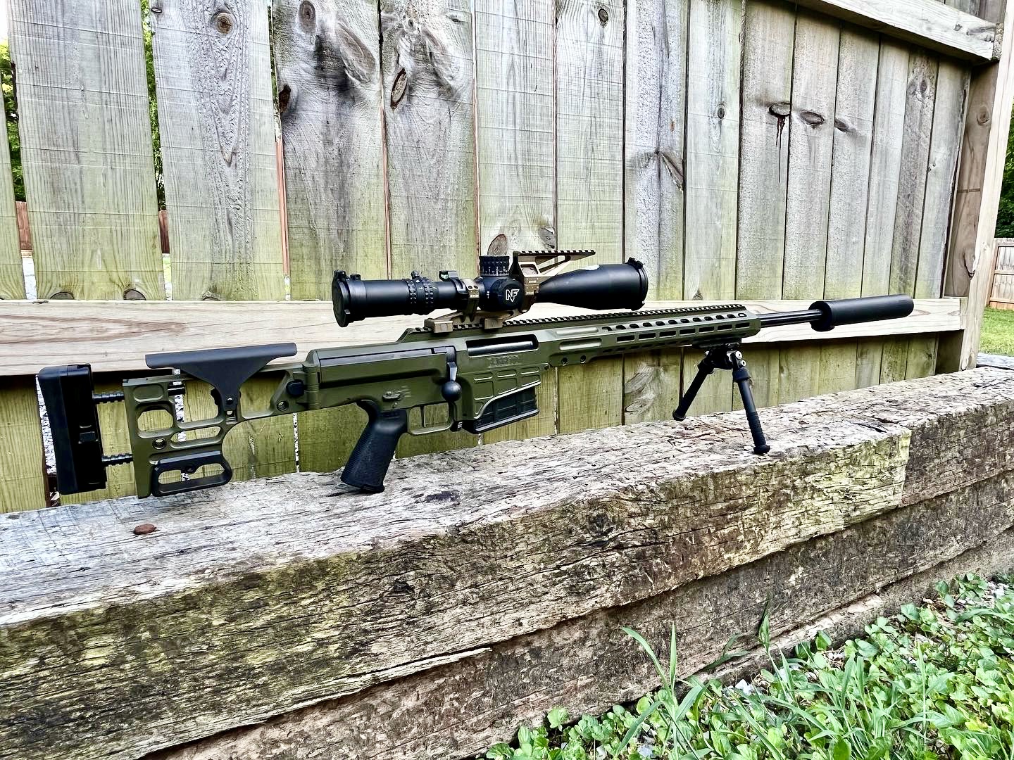

That's what they told me too, but @Riverlife87 said they re-cerakoted his in E-190.
Maybe he found the right person at Barrett or something.
Yeah - he got lucky is all hah.
I literally called and talked to 3 different employees on different occasions and all of them said no to cerakoting.
That being said, they were very helpful with any questions I or my gunsmith/cerakoter had in terms of how to disassemble and reassemble everything.
And it was already mentioned, but the commercial MRAD is identical to the Mk22 sans the markings and different factory cerakote. And the different barrel lengths. But that's it. It's the same gun.
Commercial factory cerakote is H or E-265.
Mk22 is E-190.
The guy at Barrett actually laughed when I asked what the difference was between the Mk22 and the commercial version. He laughed and said, "dude - it's just a different color - paint that shit E-190 and you're 95% there."
I can live without the Mk22 markings on the side. That saves you $5000.
By the way, I'm not knocking guys who own legit Mk22s, those are awesome collector's pieces.

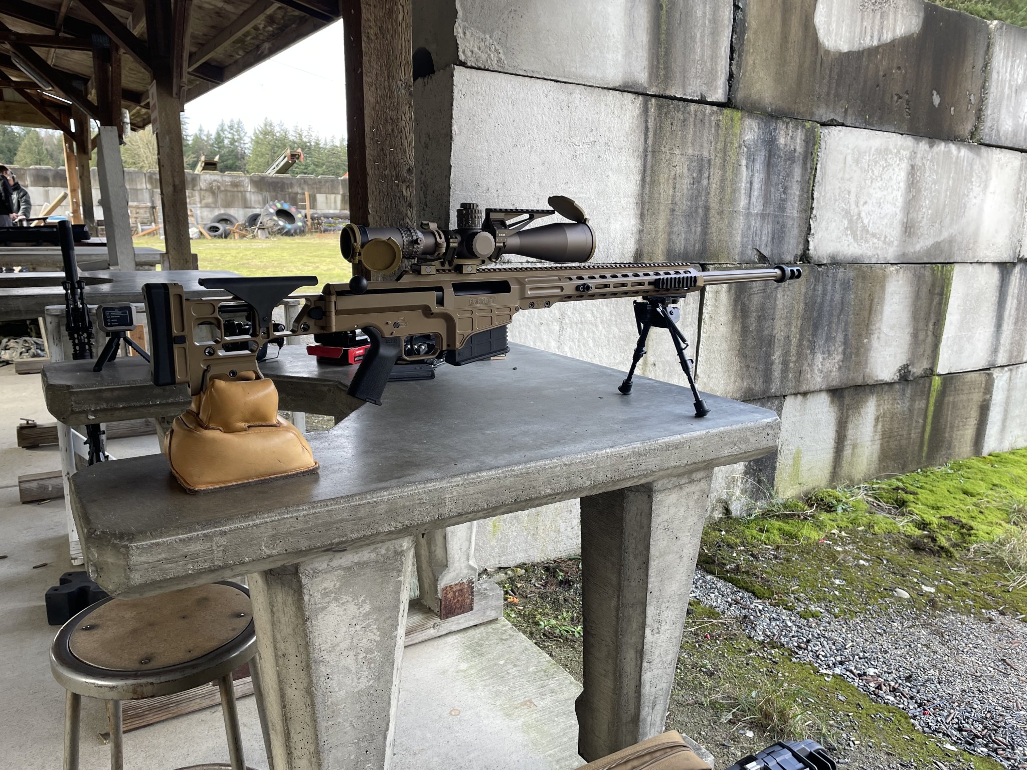

That’s interesting and annoying. If the shift does exist, then taking a bench rest and shooting with it at different forend lengths would expose it.

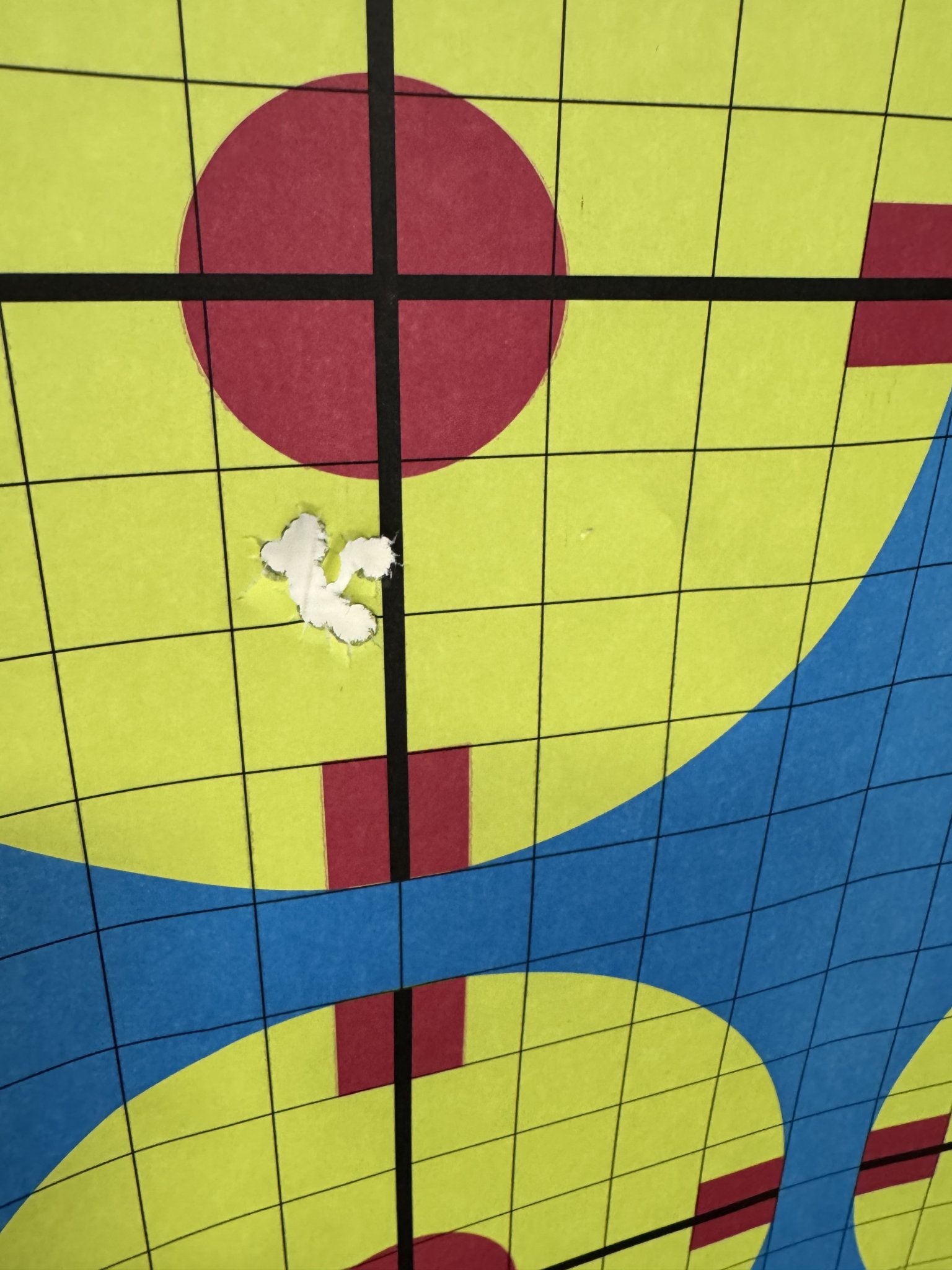

Has anyone tested their MRAD for POI shift when changing bipod/tripod position? Scott at @Veracity alluded to shift occurring but I can’t find any specifics.
For the 308 barrel in the Mk22 I see a consistent .3 mil. I haven’t tested the 300NM but the 338NM barrel w/ Mk22 suppressor was .4 mil consistently. I have only fired a few rounds from civilian variant MRAD’s and typically saw the same .2-.3 mil shifts. Regardless of reseating the barrel and torque of the screws.
The longer and heavier the barrel the more shift I have seen, as with AR’s. MRAD’s aren’t typically fired from barricades but it was interesting to see. LMT AR’s have the same phenomenon even thought they are monolithic.

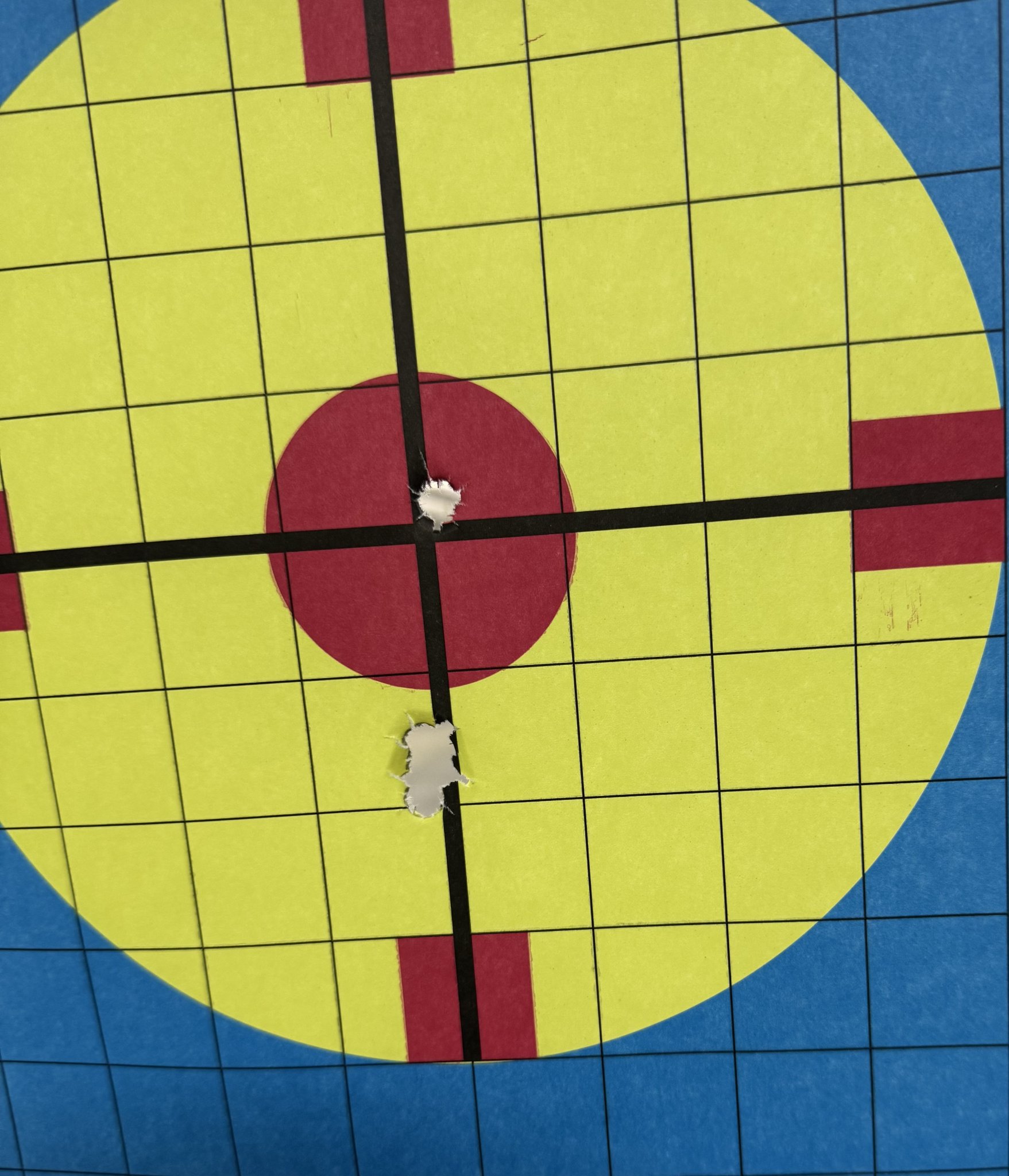

After more testing this week. The newer Mk22/MRAD are exhibiting more shift than older ones. There are machining differences on the receiver around the barrel nut that could be causing more reflection on newer manufacture rifles.
Mk22 were consistently .3-.4 MIL just with moving bipod.

On a side note, .3 mil RTZ error is ~1moa target radius, so that system is gonna miss a 2MOA target downrange?
Placement was at each ends of forend using arca. And if repeatable one could miss a .6mil/2moa~ target or barely clip it with that much POI shift.
That's actually how I noticed the issue with MRADs a few years ago but shooting .4/.5mil steel at 500-700m from various positions with the Mk22.

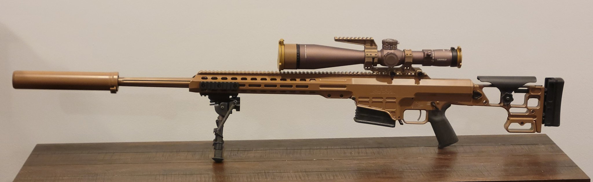

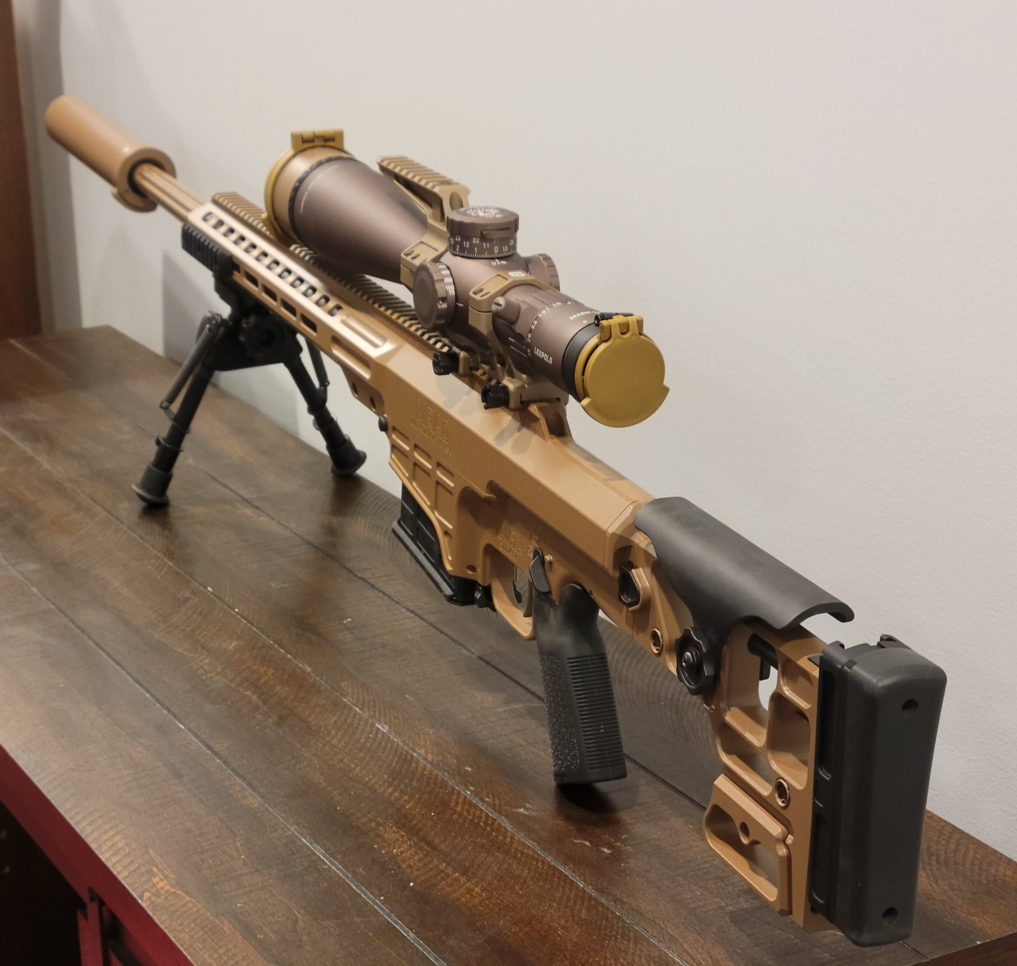

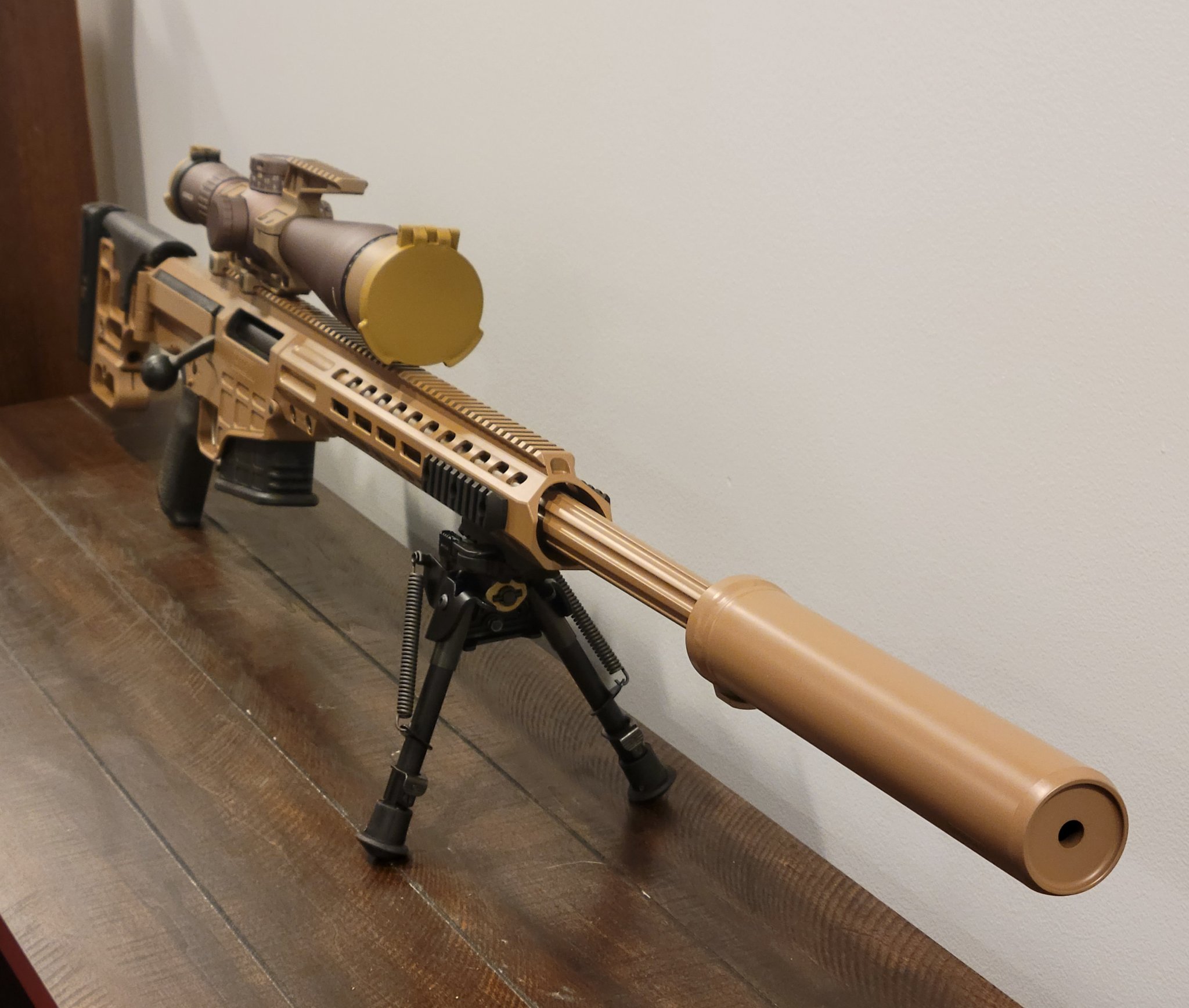

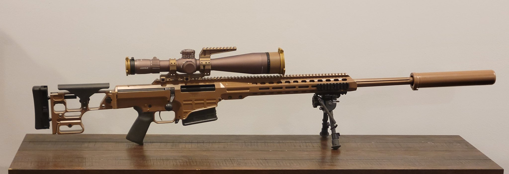

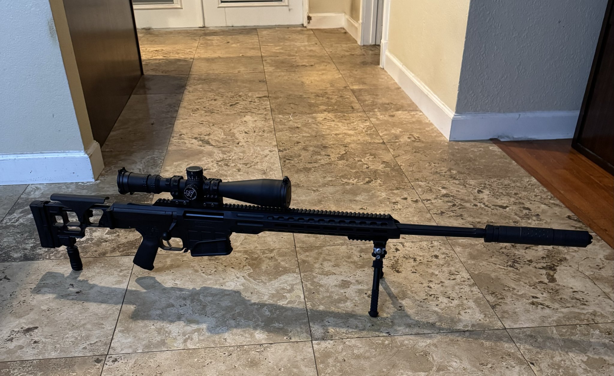

Got a new MRAD and was looking it over before mounting a scope.
I found it neat how the surface finish is smooth enough that even with the black cerakote, it's reflective. You can see the white edge of the door reflected on the top rail. Being able to do that with a (somewhat) mass produced gun is cool.
Ok. Time to go find a load for this.

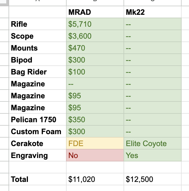

Not sure if this helps anyone make a dumb decision, but this was my napkin math a year or two ago. I went with a Mk22 single-barrel kit. Shook out to basically a $1,500 clone correct engraving on a $11,000 kit at the time, if you ignore the mil-spec details on the included scope and mount. Not sure what things look like today, but I haven't seen an MRAD under $6500 for a hot minute.

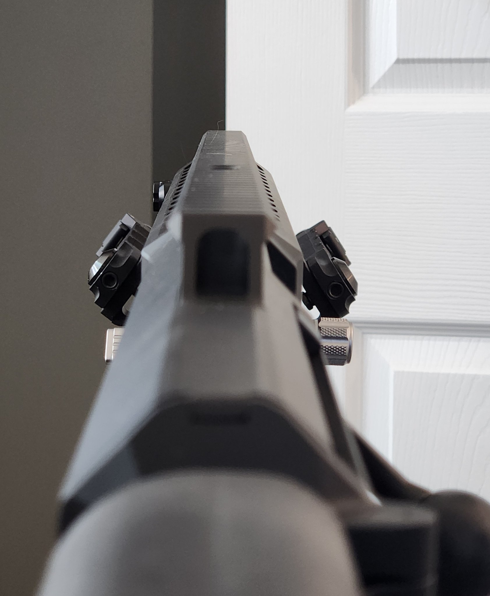

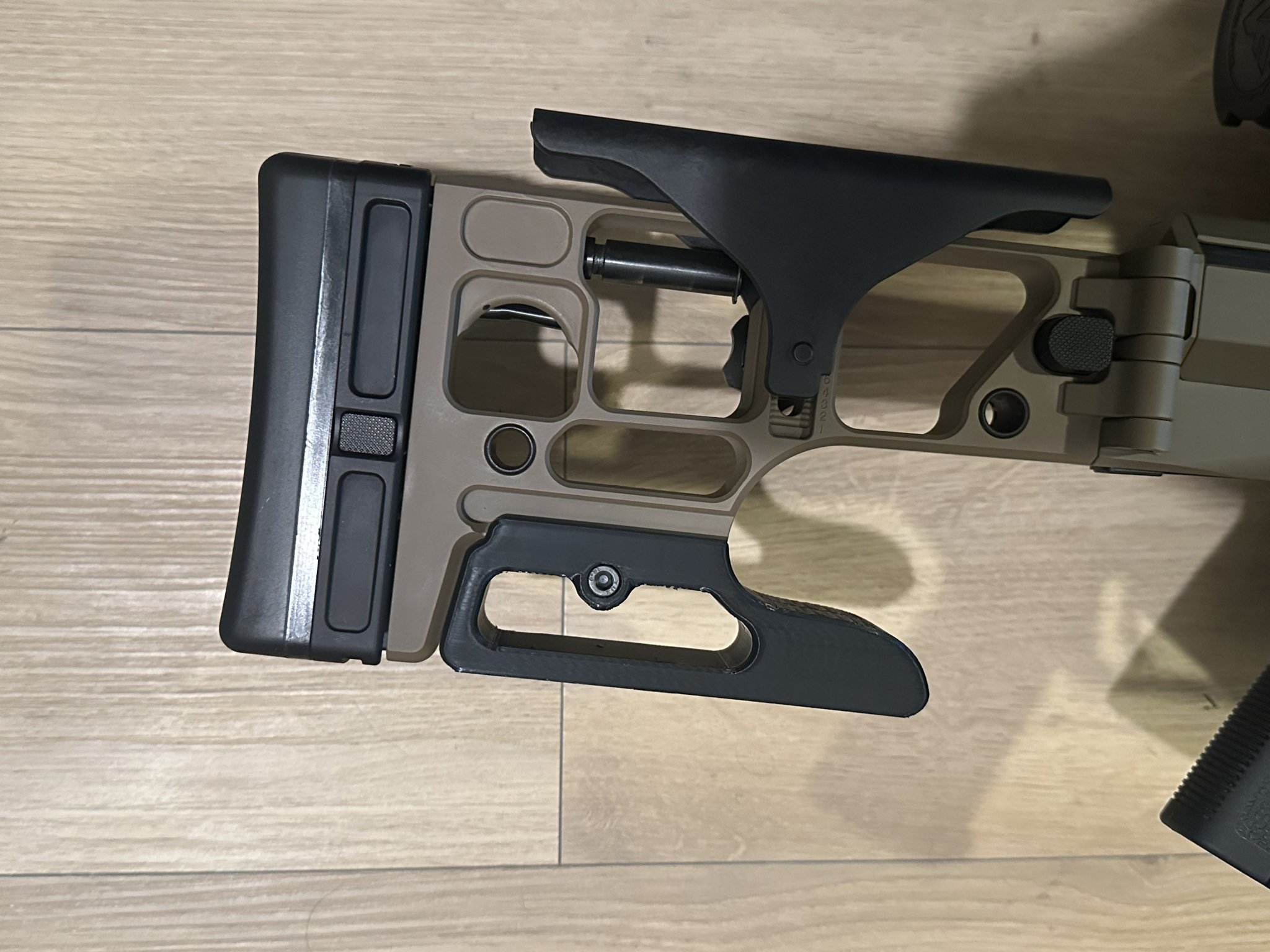

I created a 3D model for an extended bag rider for MRADs and the community. When printed in nylon, it’s extremely light and durable with more surface area than Barrett’s model.
3D model / STL file is free here:
Dude this is awesome thank you so much! My MRAD arrives next week and I'm so stoked. I'm up to 4+ 3D printers at this point but I've been so busy lately that I didn't even think to try looking for something like this much less whipping it up. Definitely gonna have to give this a print!

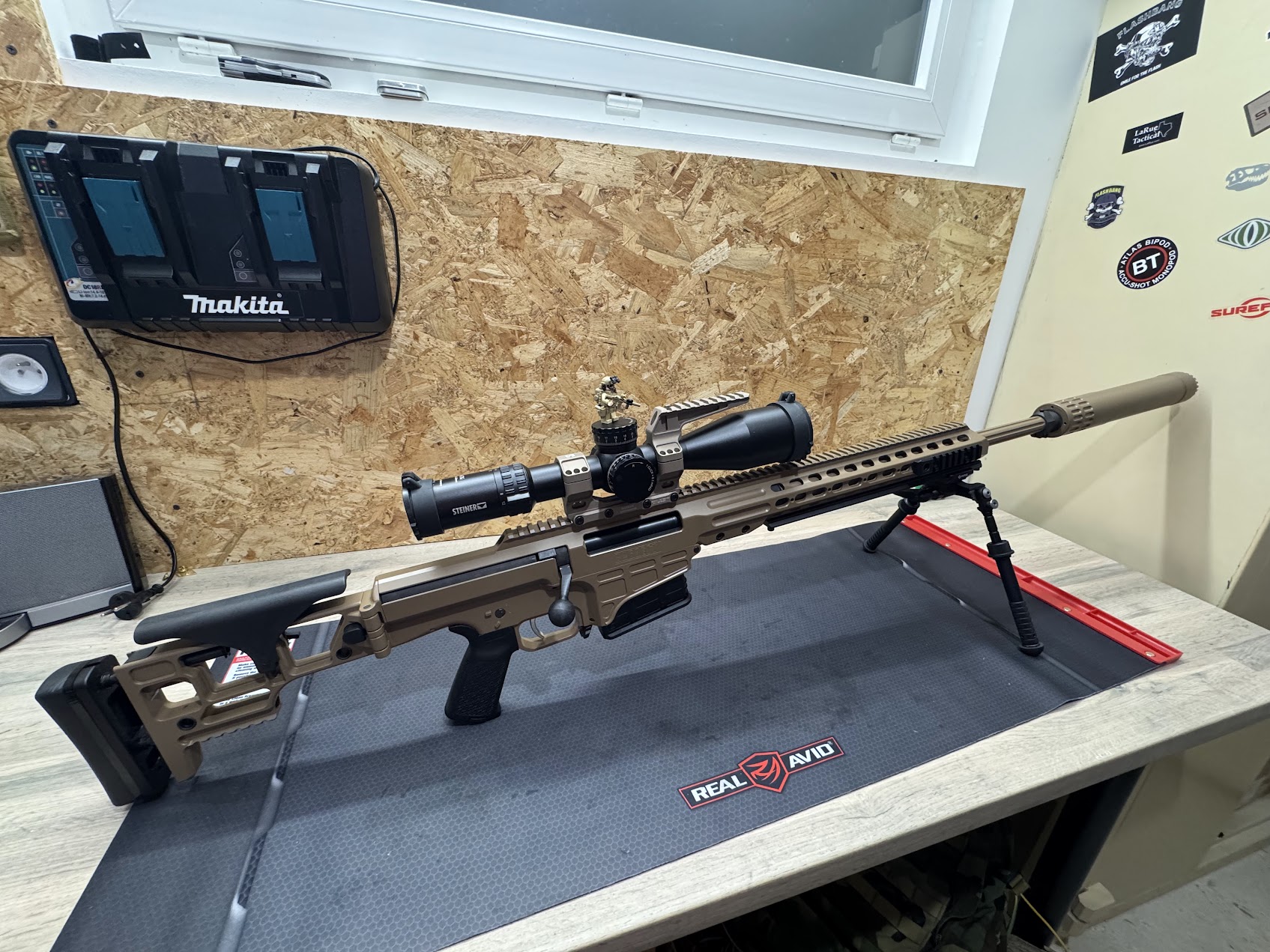

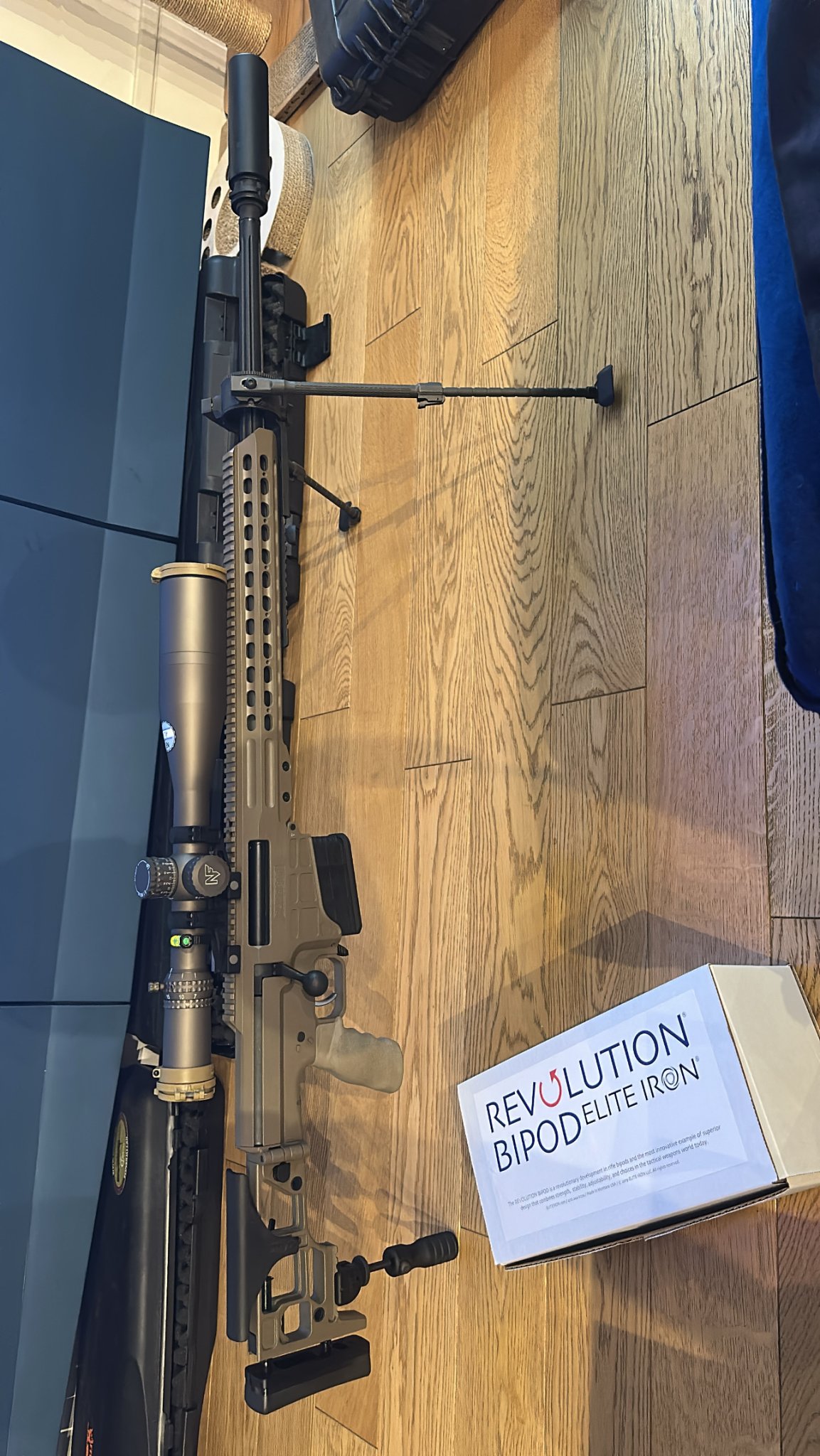

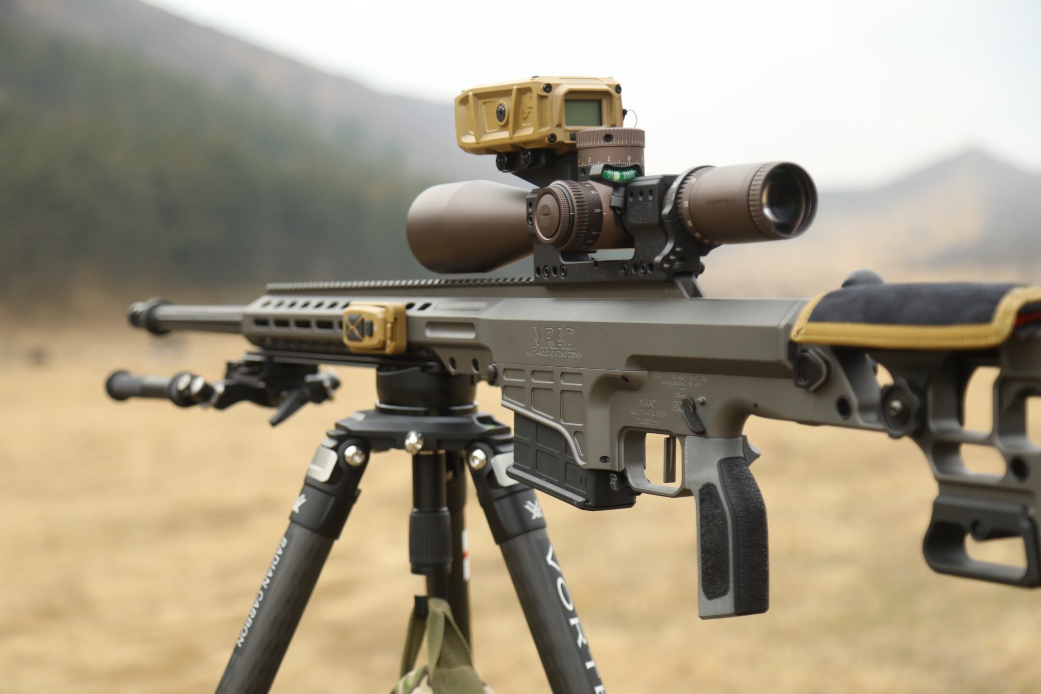

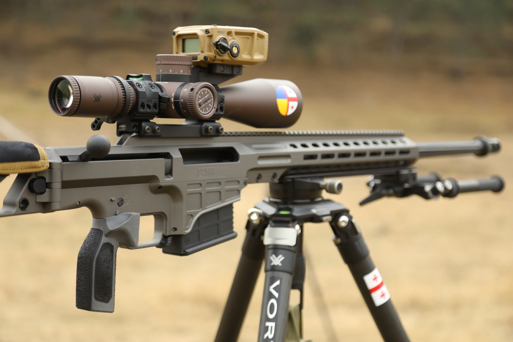

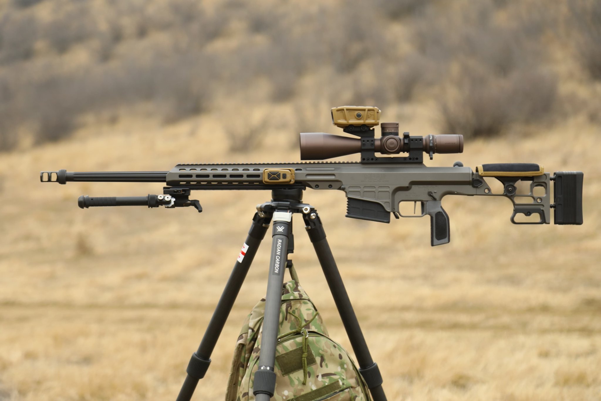

I finished this project (I hope) :D
Barrett MRAD
.338 LM , 308 Win , 6.5 Creedmoor
Vortex Optics RAZOR HD GEN III 6-36X56 FFP
EBR-7D (MRAD) Reticle
Spuhr mount for Picatinny, 34 mm, 20 MOA
Vortex Impact 4000
Ballistic Rail-Mounted Laser Rangefinder
Trigger Assembly, MRAD, Two Stage, Flat (First stage 200 grams, second stage 400 grams)
MK Machining Adaptive Precision Grip
B&T Industries BT72-NC Super CAL Atlas Bipod
RRSS Universal SOAR Rail
Really Right Stuff SOAR-ARC R-Lock Bipod Clamp
Wiebadgear Mini Stock Pad
Vortex Radian Carbon Fiber Tripod + Leveling Head
