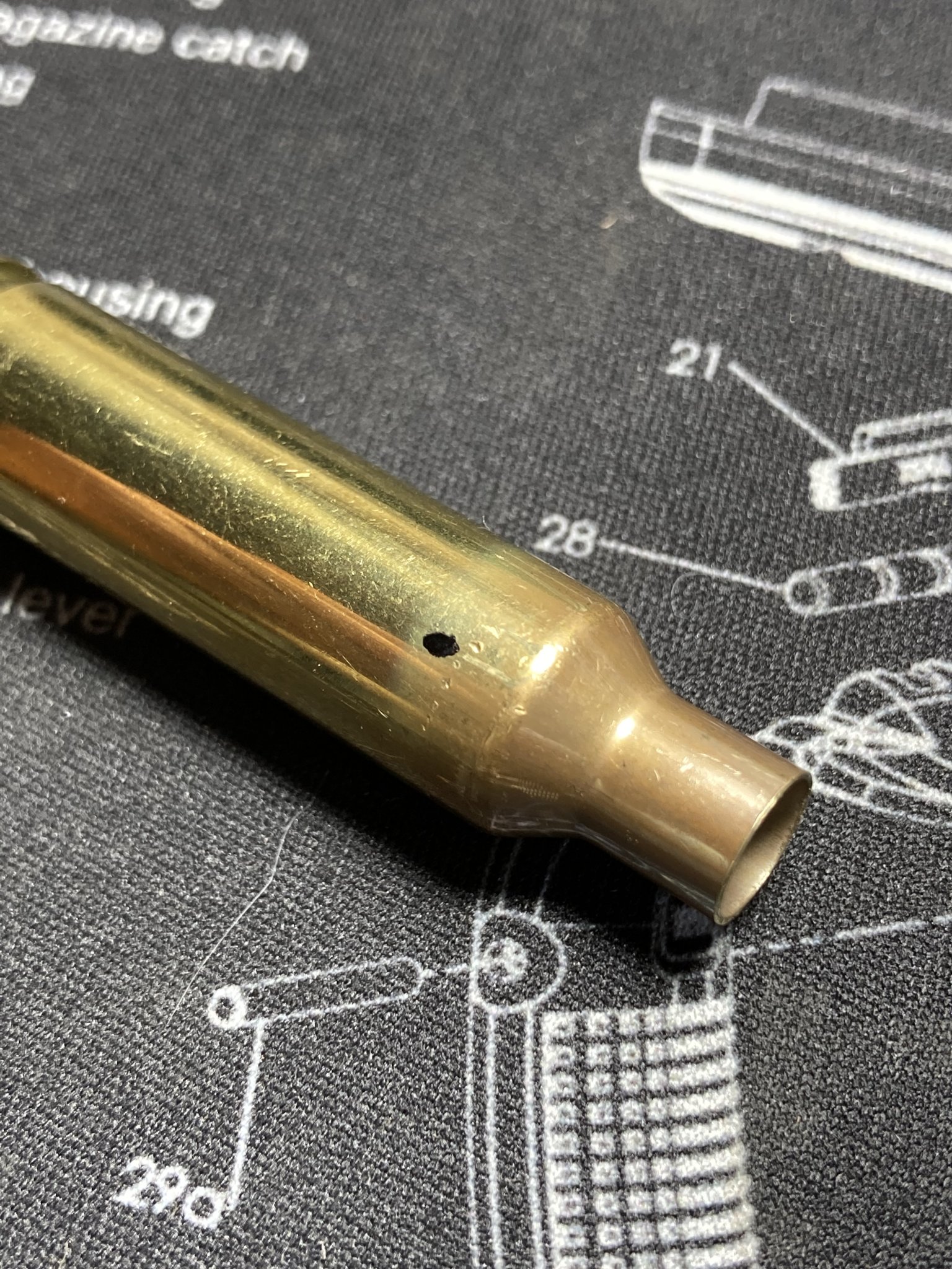

Finally got a chance to take it out and get her 100yd zero and test a few loads. Best shooting load was the 143gr ELD-X seated .050 off the lands (or at my max OAL for my magazine). Very impressed with the rifle, soft shooting and pretty damn accurate. Action cycles very smooth. Only issue I’m having is my brass is getting a little chewed up near the shoulder…I’ll post below

Not sure what’s going on with this…maybe burs in the throat? Cleaned it and still the issue persists

No not a hole, just a sharpie mark noting where the small gouges are. Look directly above and you’ll see little chew marks like there’s something in the throat
Call springfield tomorrow and they should email you to prepaid shipping label to send it back
How many times did you cycle that one piece of brass through the action? It appears to have multiple marks across the neck and shoulder even.
That piece of brass I started fresh with my test after cleaning. Cycled it once, found the gouges, and marked with a sharpie. Flipped it upside down and cycled again, marked again. Did this to see which part of the throat was marring the case. Appears to be the top end
