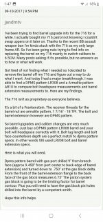

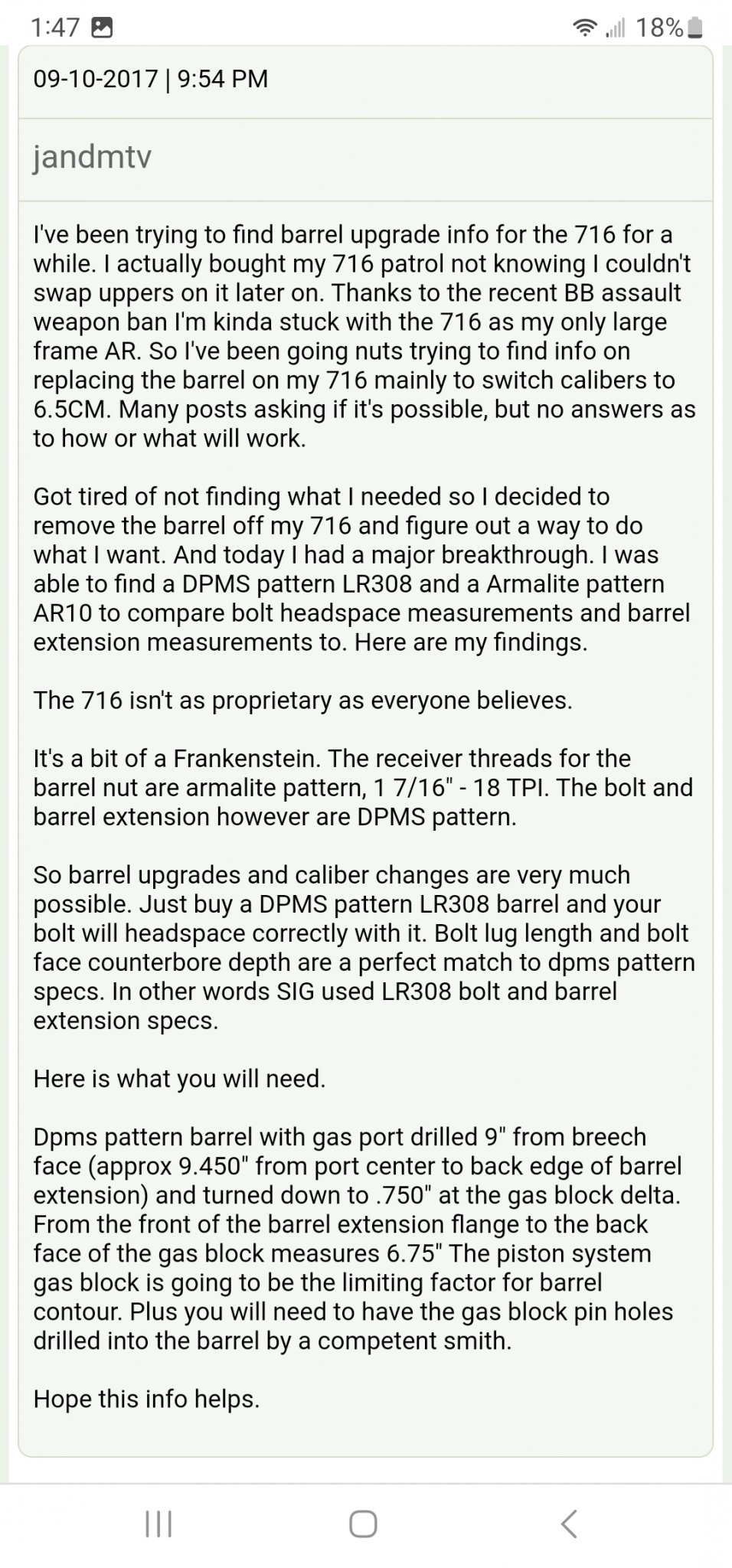

Has anyone pulled the barrel and changed it out? Wanting to run 18" instead of the 16. What's a good barrel and best way to go about it?
There was one on gunbroker with different handguards and wilson combat barrel. The short answer is DPMS bolt and extension, armalite barrel nut threads, dremel the DPMS claw block to fit the Sig716 upper contour, tons of threadlocker on the barrel nut.
Reactions: GLD1980
since it's a DPMS-pattern bolt and barrel extension, you can use an AR-10 reaction rod, either the G or the MI.
Reactions: GLD1980
So, swap out the sig bolt in the sig carrier, with a dpms, to fit dpms extension in the replacement barrel? Armalite barrel nut to replace sig barrel nut? Not familiar with a claw block, seems to be a stand to work on the upper from a Google search? Is the block necessarily needed?
Reactions: GLD1980
you could probably re-use your Sig bolt and Sig carrier with a new replacement DPMS-pattern barrel, if you're on the cheap. My take from reading the Sig 716 threads is that the Sig bolt is DPMS-pattern. So, as long as it head-spaces okay. but most folks go with a new BCG when they swap out to a new barrel. Bolt lugs "wear in" and mate with the barrel extension lugs, so they say.
MI reaction rod.
I'm guessing the G AR-10 reaction rod probably costs more, doesn't have the "fin".
MI reaction rod.
Problem is, I think the sig bolt carrier group is also proprietary. Unless I'm wrong. Pretty much they thought this rifle out.lol
Reactions: GLD1980
you're right, the carrier is proprietary, that's why the charging handle is proprietary. The bolt itself is probably DPMS-pattern, though, if the barrel extension is DPMS-pattern, as mentioned above.
Reactions: GLD1980
If someone here has a dpms 308 they could tear down the bolt and post measurements (like depth of bolt face, length of bolt from face to tail, firing pin length). The firing pin in the 716i is the 716g2 firing pin, in the older 716s some people got away with regular dpms 308 pins.
Or if they have a spare 308 dpms barrel they could check to see if the 716i bolt cams into the lugs and headspaces properly.

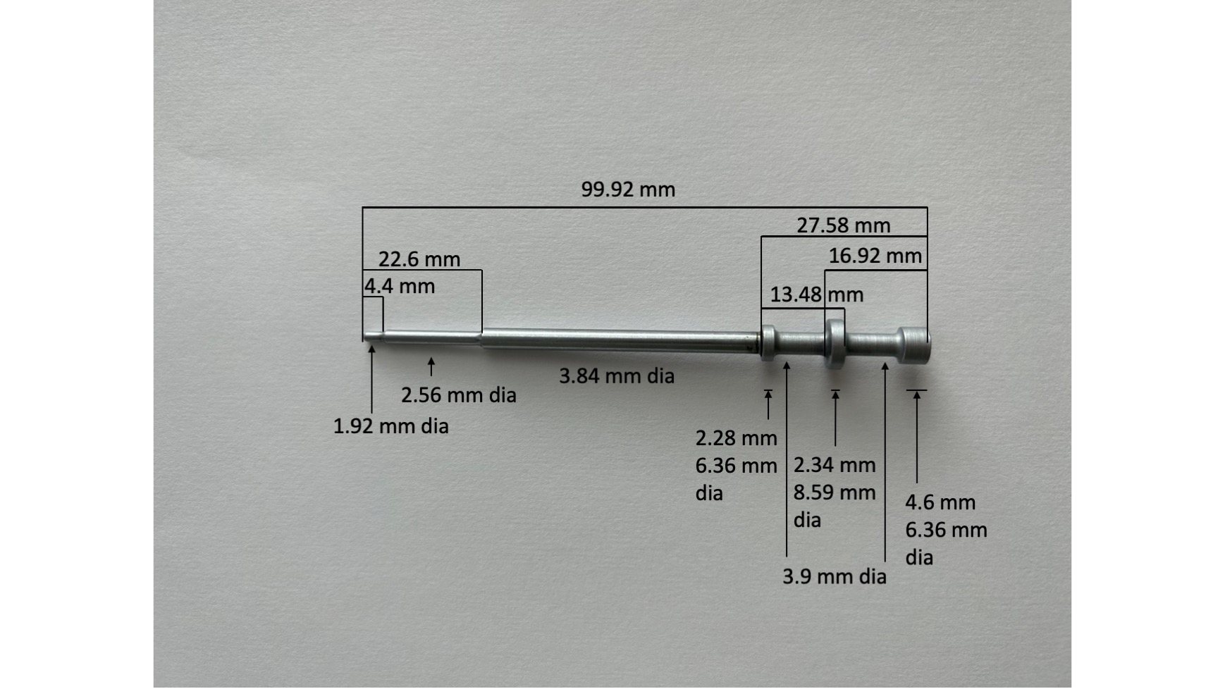

Length of firing pin (overall and tip to the ring that hits the tail of the bolt), diameter of firing pin (I think that the DPMS steps down whereas the 716i is thick the whole way) bolt face to tail, that would tell people if a regular DPMS 308 firing pin might work vs the 50 dollar replacement one Sig sells.
Thinking I found something.
This firing pin is part of a LR308 bought in about 2012.
I have a replacement firing pin kicking around here somewhere. I can dig it out and measure it as well if you like...
