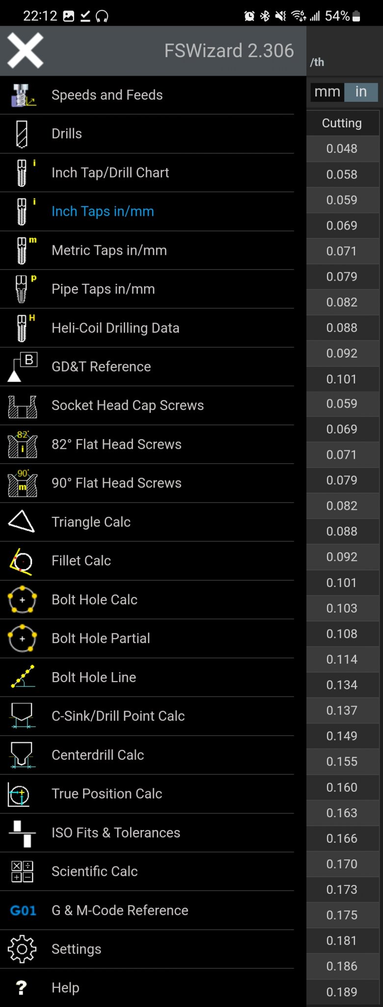

Except it says it won't work on my phone. Not updated in 4 years.
I just found one thanks to the post that looks like it might be good. I SUCK with phones it is just called handyman calculator and it is green. I just downloaded it so I have nothing to say about it yet, but it looks like it could be good. Something to play with today.
This should be printable….
You’re welcome!!

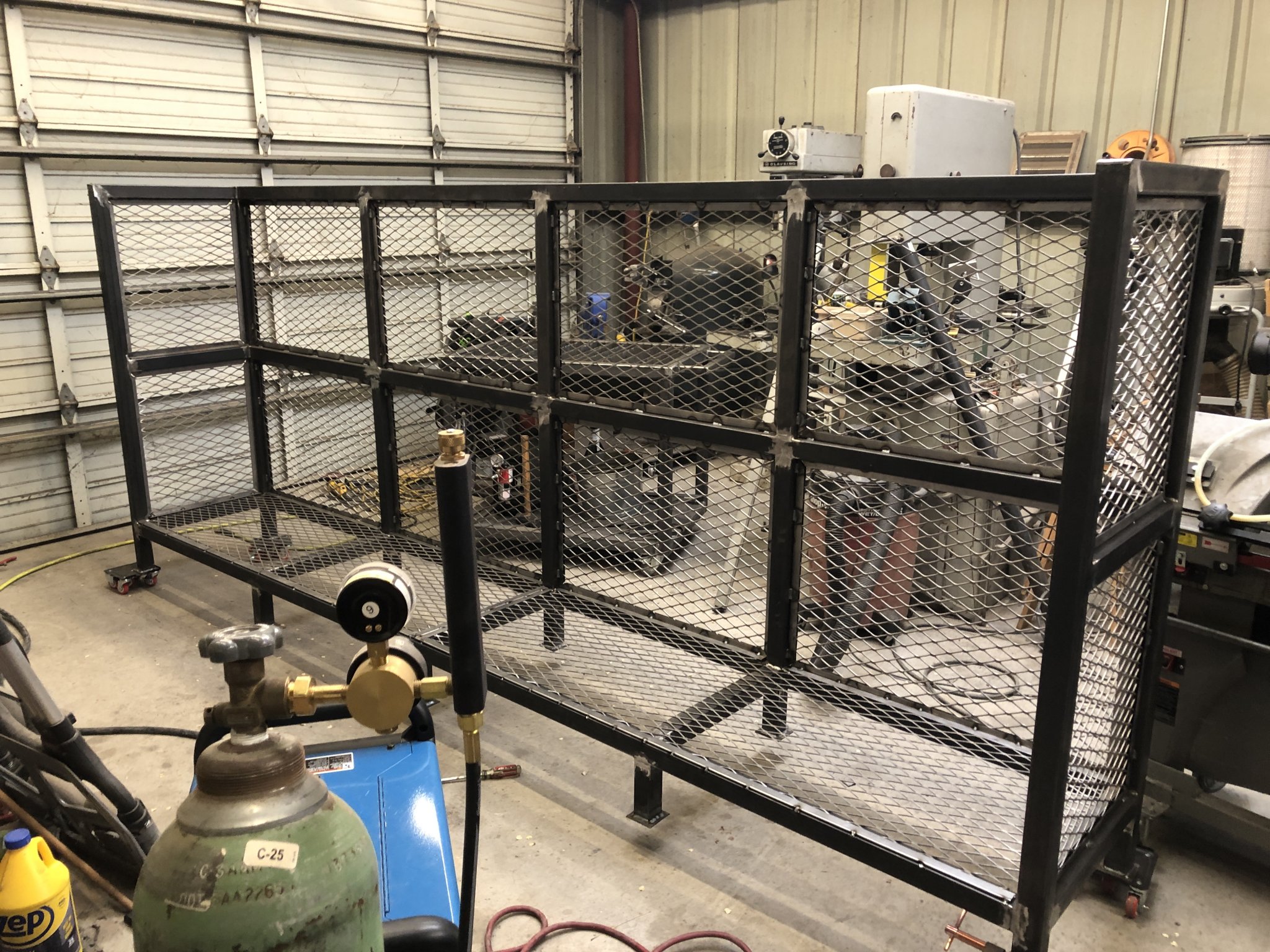

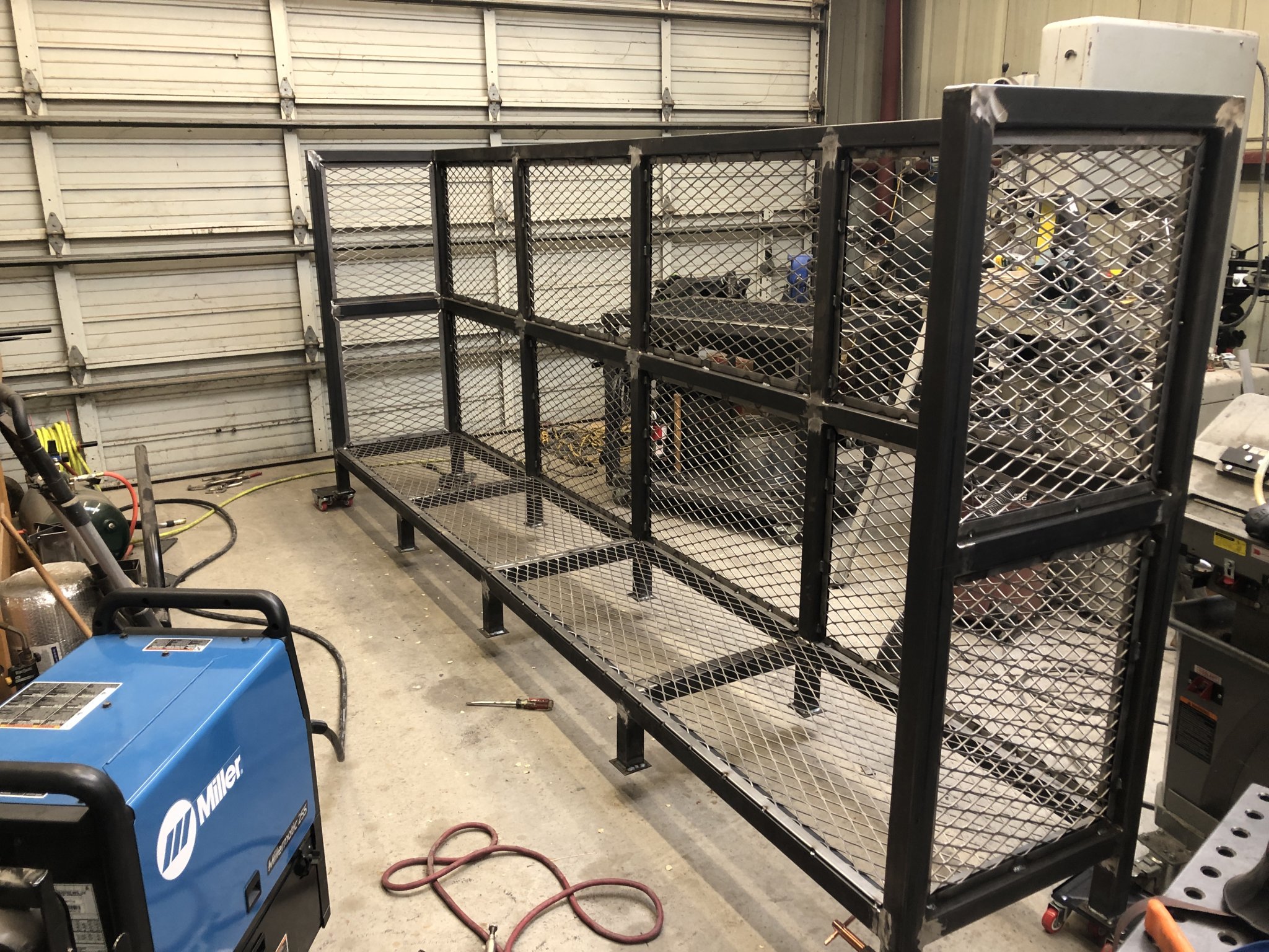

Firewood rack for a custom home friend is building for a client. 12'x5'x2' made with 14 ga 2" square tubing, 1.5" 9F expanded metal with U-trim. Should hold nearly a cord.
Reactions: ZiaHunter

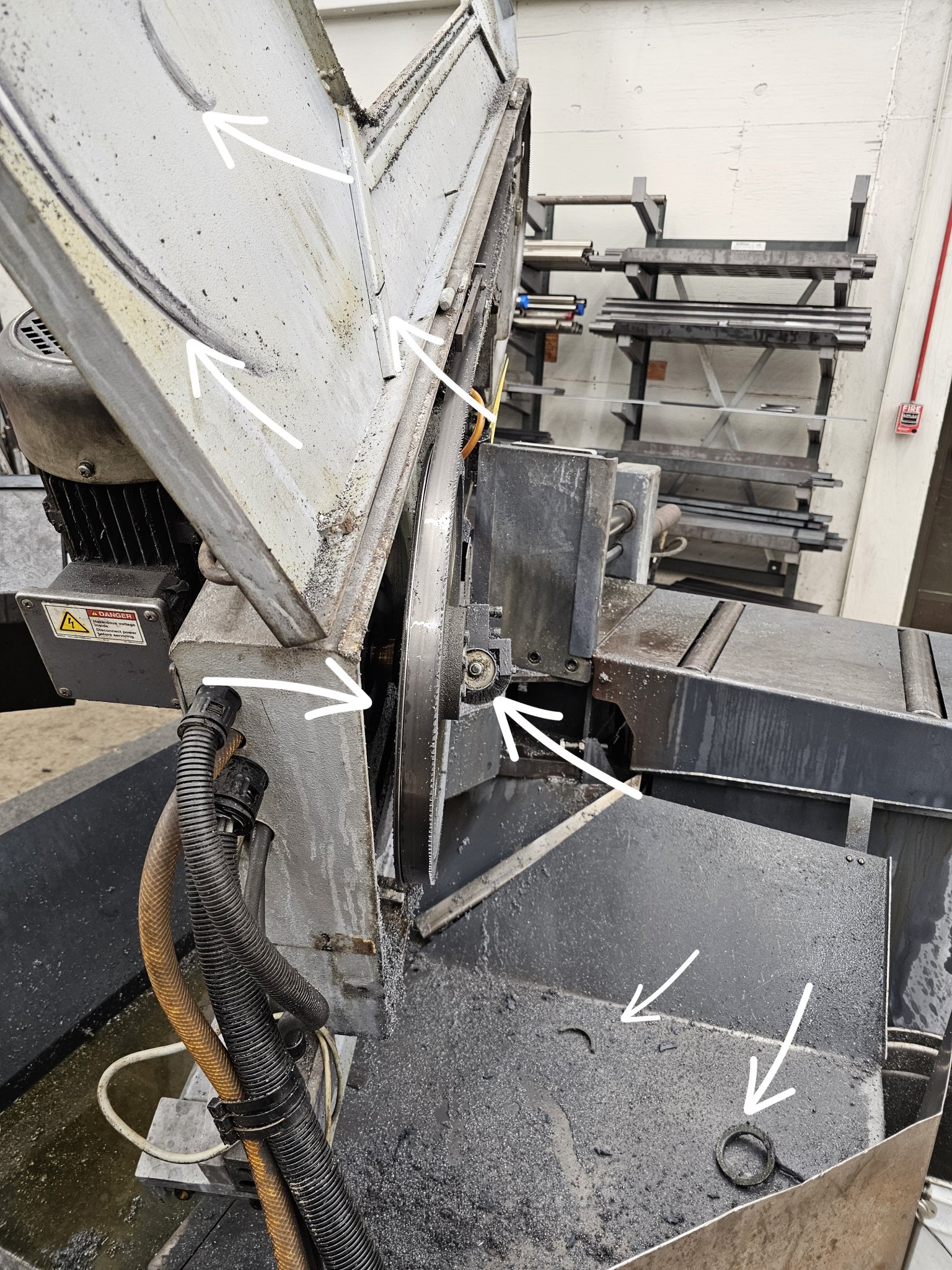

Students ability to break the shit out of stuff will never stop amazing me. My eyes went from top to bottom with increasing thoughts of how the hell?
So, one of the kids got over-zealous and over-tightened the blade tension to 'shaft-snapping' levels?
Or did they "help" the saw by pushing down on the head end?
Reactions: Hobo Hilton
Not sure. It wasn't working right so we started investigationg. Saw the tension was low so started adding it and it never went up. Cracked it open and peices started falling out. And the more we looked the worse it got.
My guess is a student had an issue of some sort and tried to sort it out on their own and made it worse.

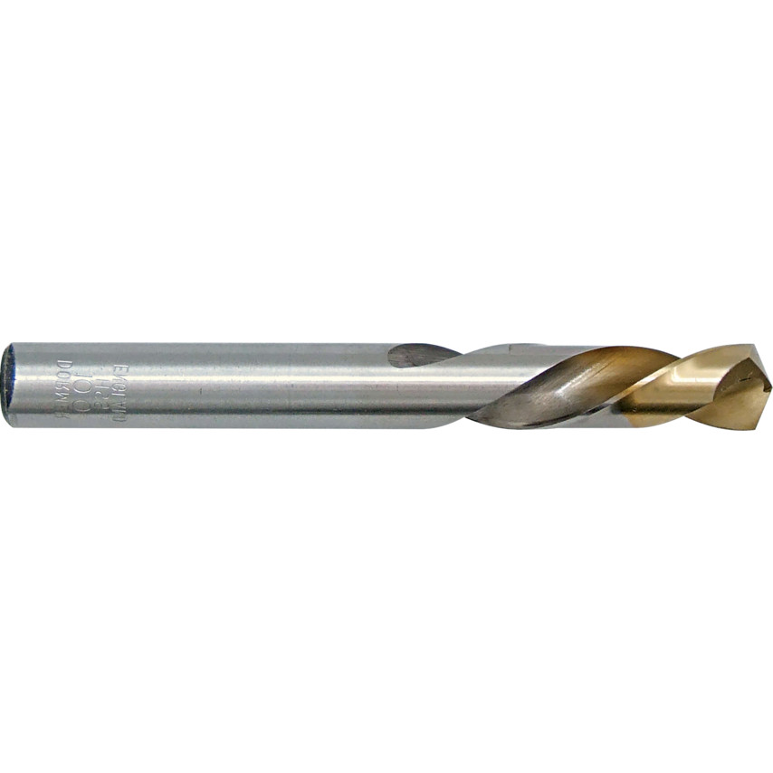

10.3mm stub drill is what you seek. Ask your local tool supplier.
This is what I was thinking too, but just checking with the crew if there was a better option out there. Makinchips option is good as well. All of my current 10.3 drills were for deep holes in stainless. Good drills, but not applicable to this job.

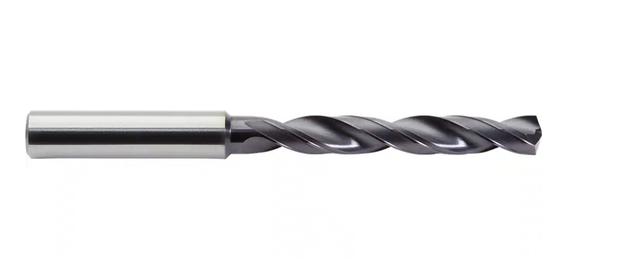

You can get a carbide with thru coolant and reduced shank if thats your thing. However for the price, you can buy 20 HSS drills, which will work fine in alu.

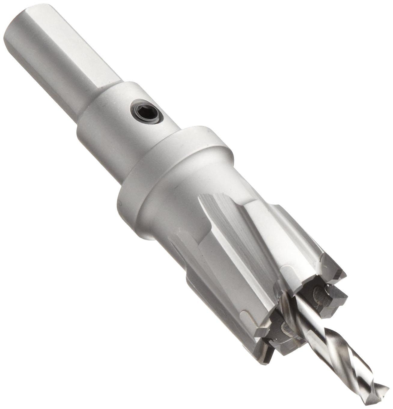

I do remember something about a drill which had a interchangable centre drill in it, sort of like a counterbore drill, but had a changeable insert for centring... sort of like this:

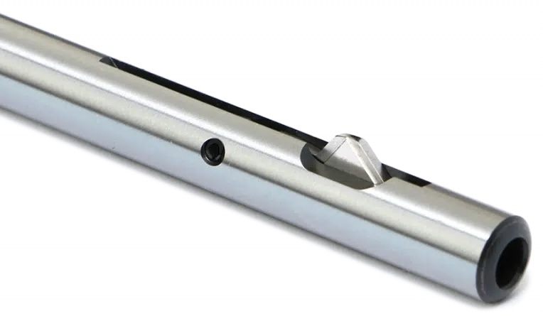

It can be drilled (several different methods) and then follow by running a BURRAWAY from cogsdill. Amazing tool! I don’t like deburring 4000 holes by hand.

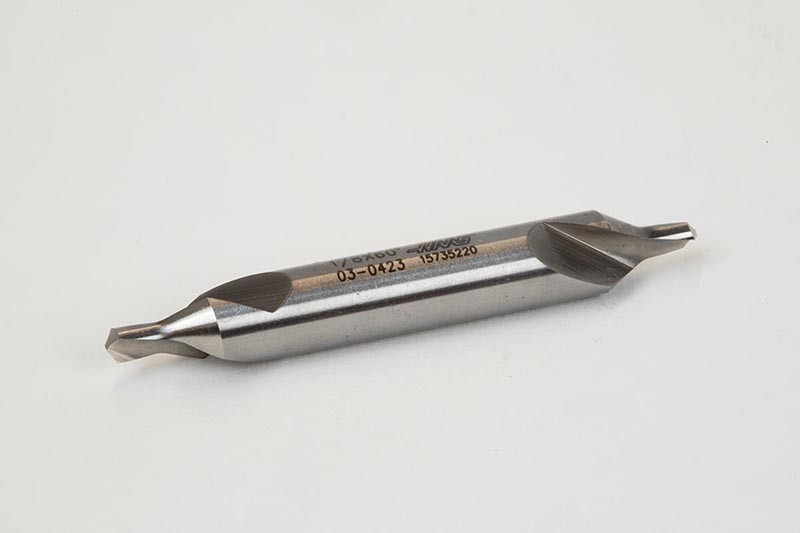

With a GOOD point that doesn’t walk, you don’t need a spot drill in many cases, especially in aluminum. In that case utilizing the shank as a pilot is unnecessary.
A proper drill point will cut a clean hole without walking. It’s ALL IN THE DRILL POINT.
And eliminate runout. Runout is dumb.
Example of burraway tool.
Reactions: iceng and lariat

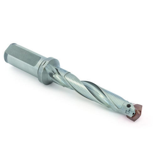

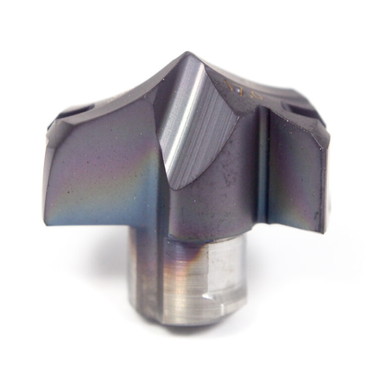

You can get drills with twist on changable tips. The shank is marginally smaller than your tip which you buy, and they will centre themselves and work REAL well, but are expensive. But for 2000+ holes, work it into the price of the job.
With thru coolant and on alloy, they are stupid fast. Spin em and push em.
Edit: iscar and kennametal do them.

I have used these before on some big tubing jobs. Forgot about them. I’ll see if either company has them in 10.3. I have changed some of my standby reliable endmill models for kennametal and that high initial price got cheap when I looked at how long it lasted.

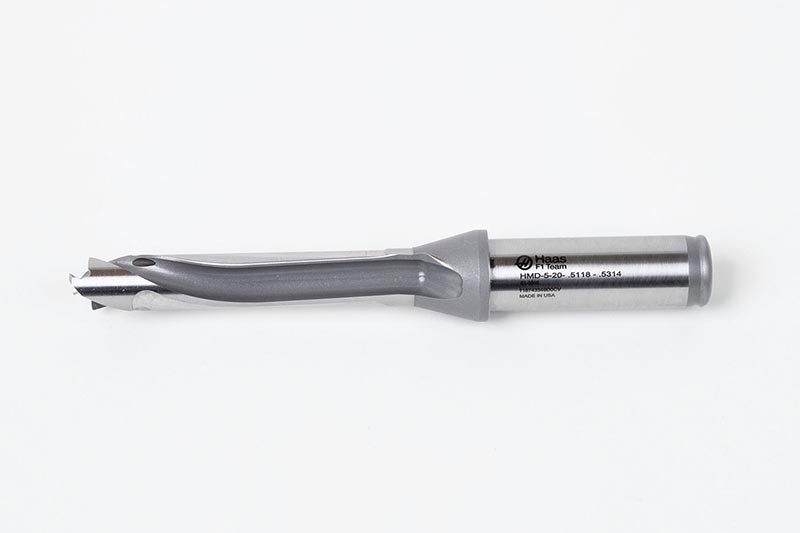

Don't know how good it actually works but this looks interesting
