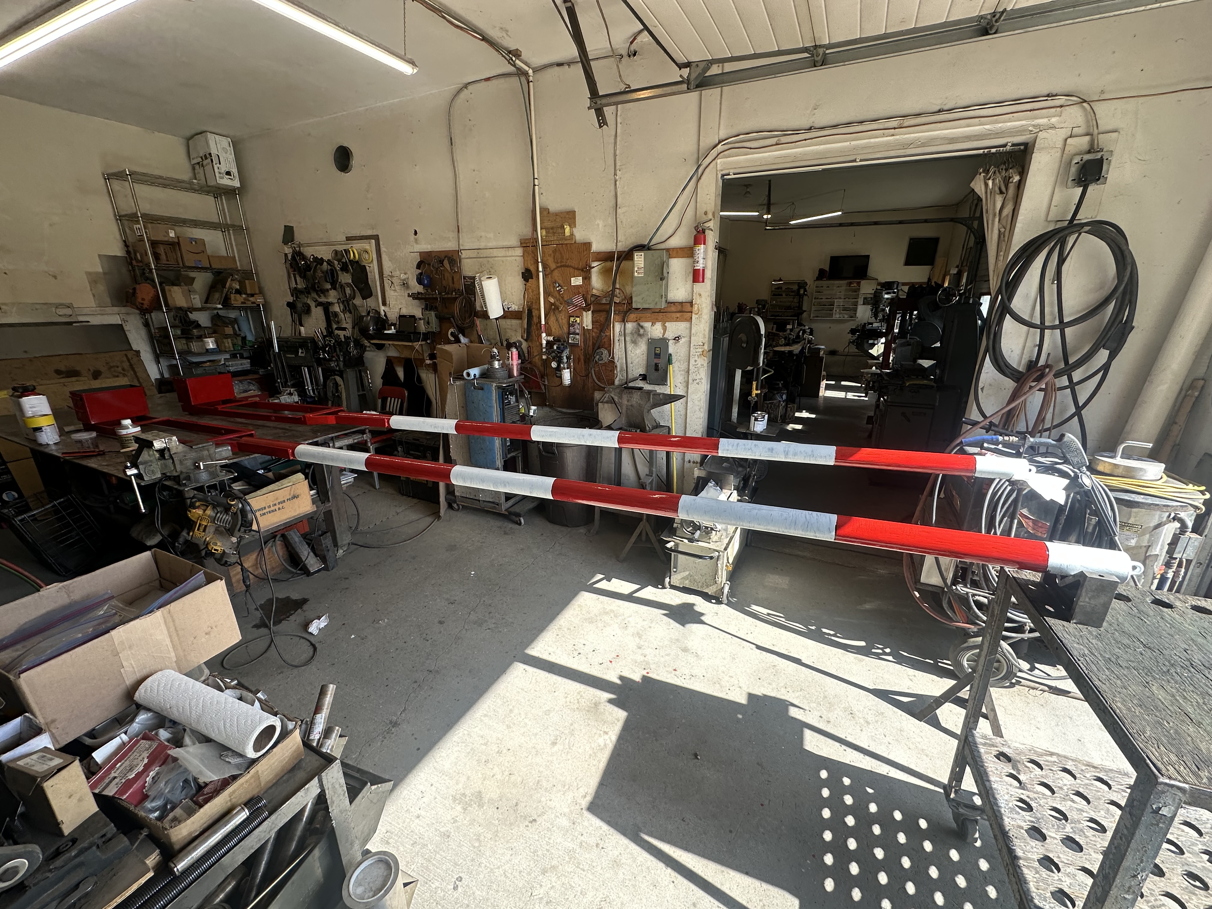

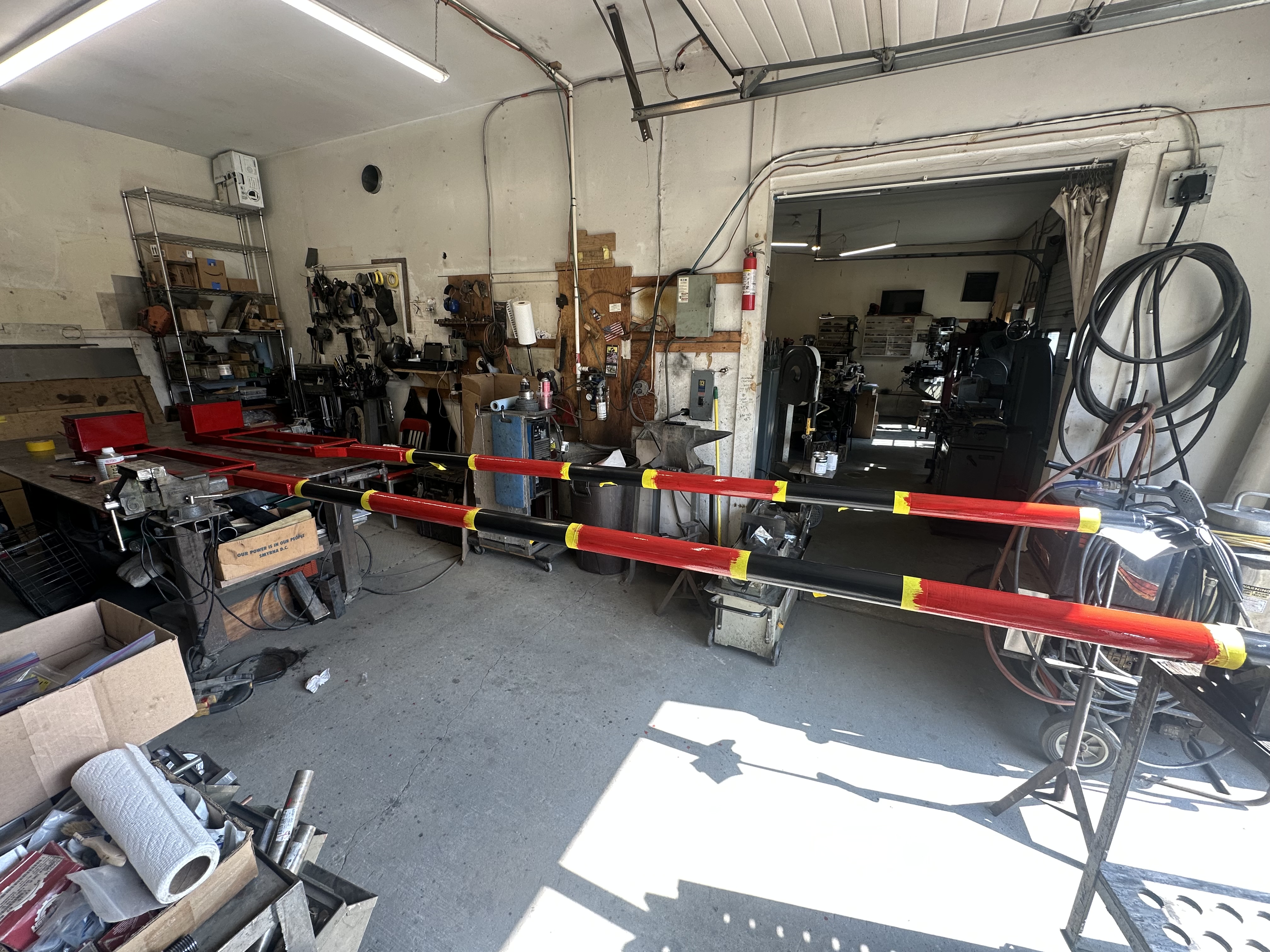

I put together 2 target stands and some midget stripper poles for obstacles for USPSA style practice in my back yard. Mostly stuff I had laying around from old projects.
Old rollbar tubing and some 1x2 rectangle tubing
The obstacles were made out of some CM tubing I was using to build a set of wheelie bars.
Been a whole since I've used any of these tools... had to re-learn some atuff.

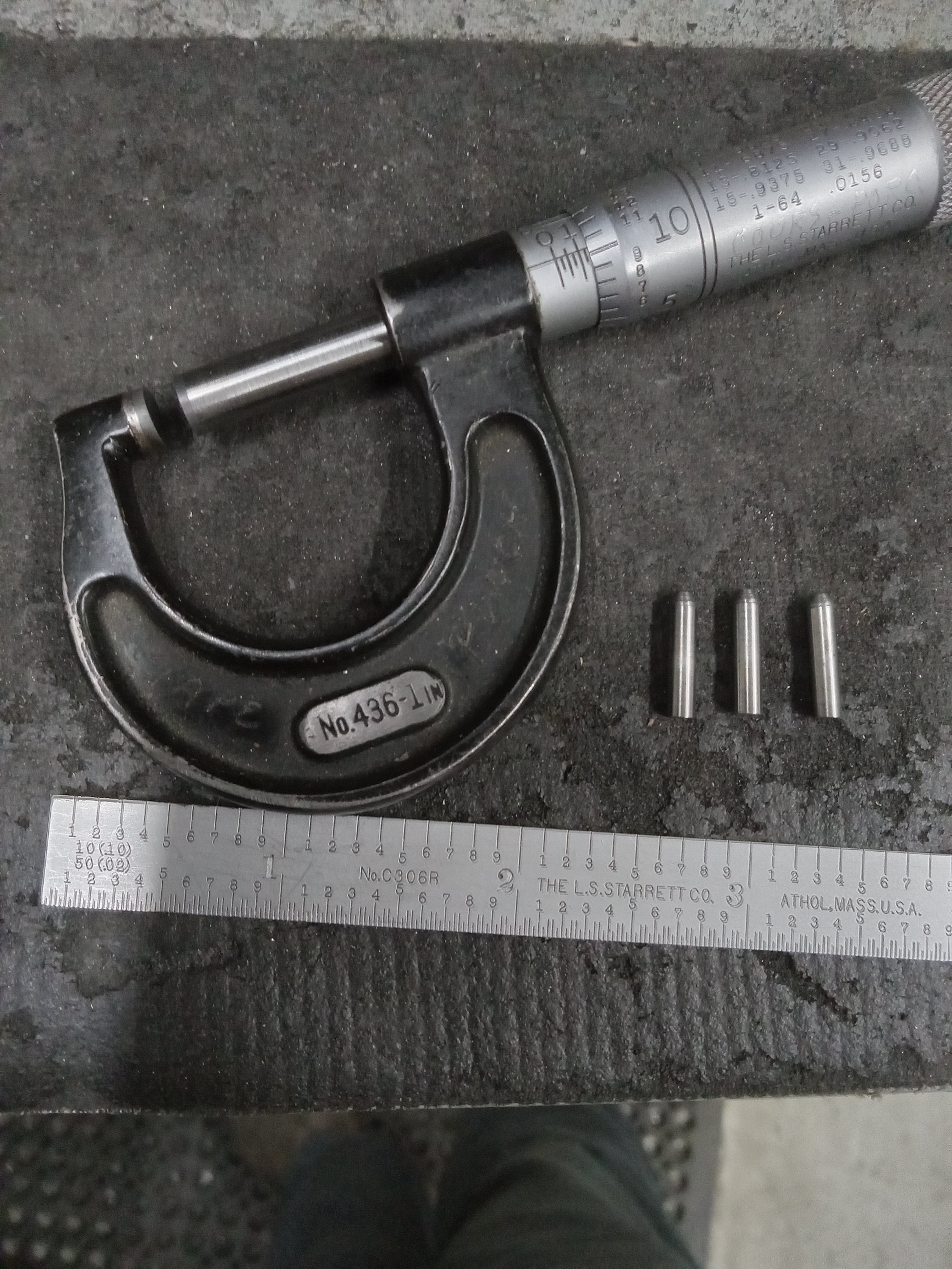

I made some small alignment pins today.

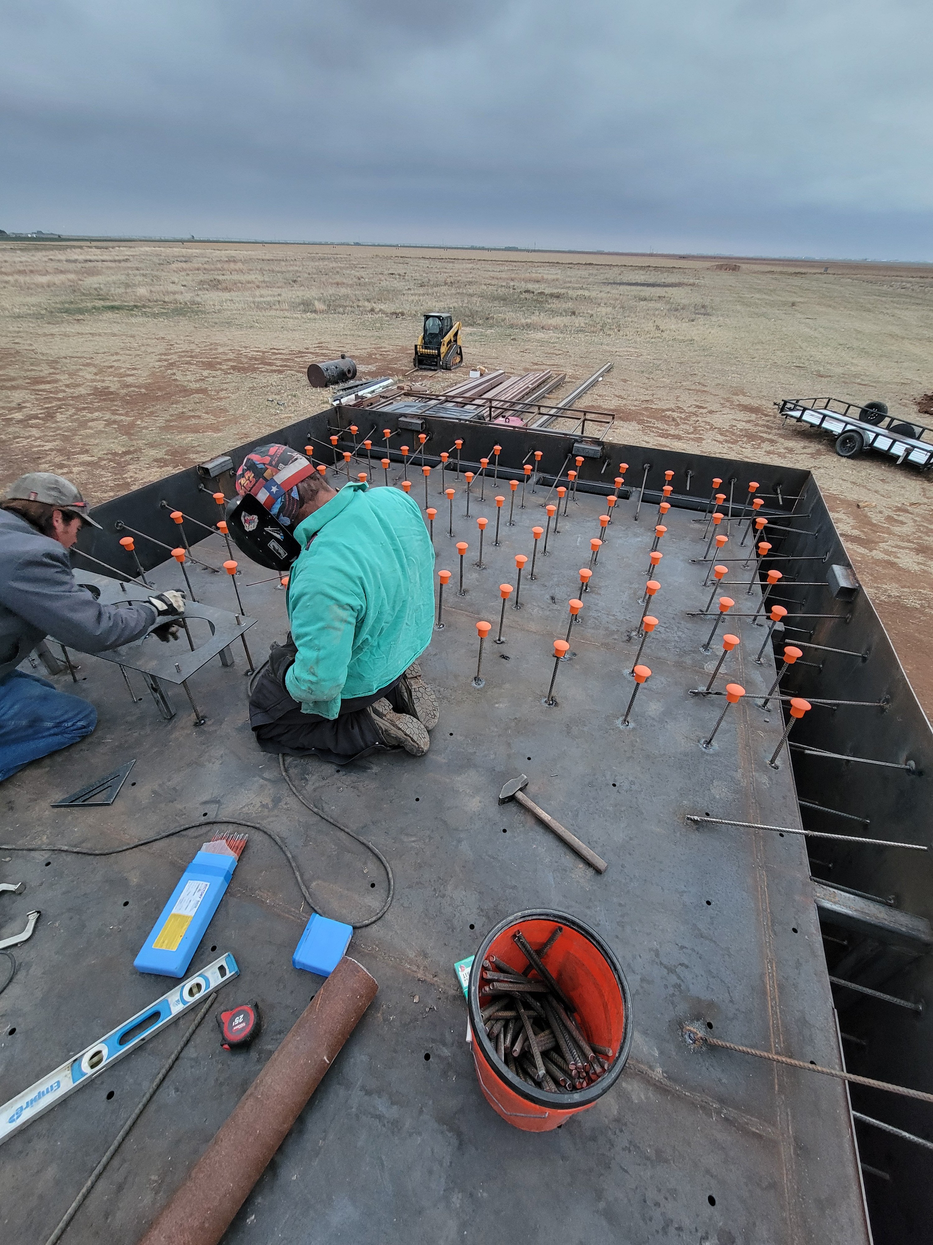

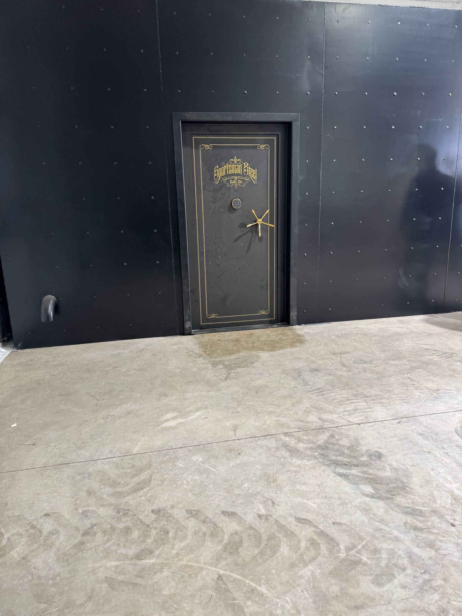

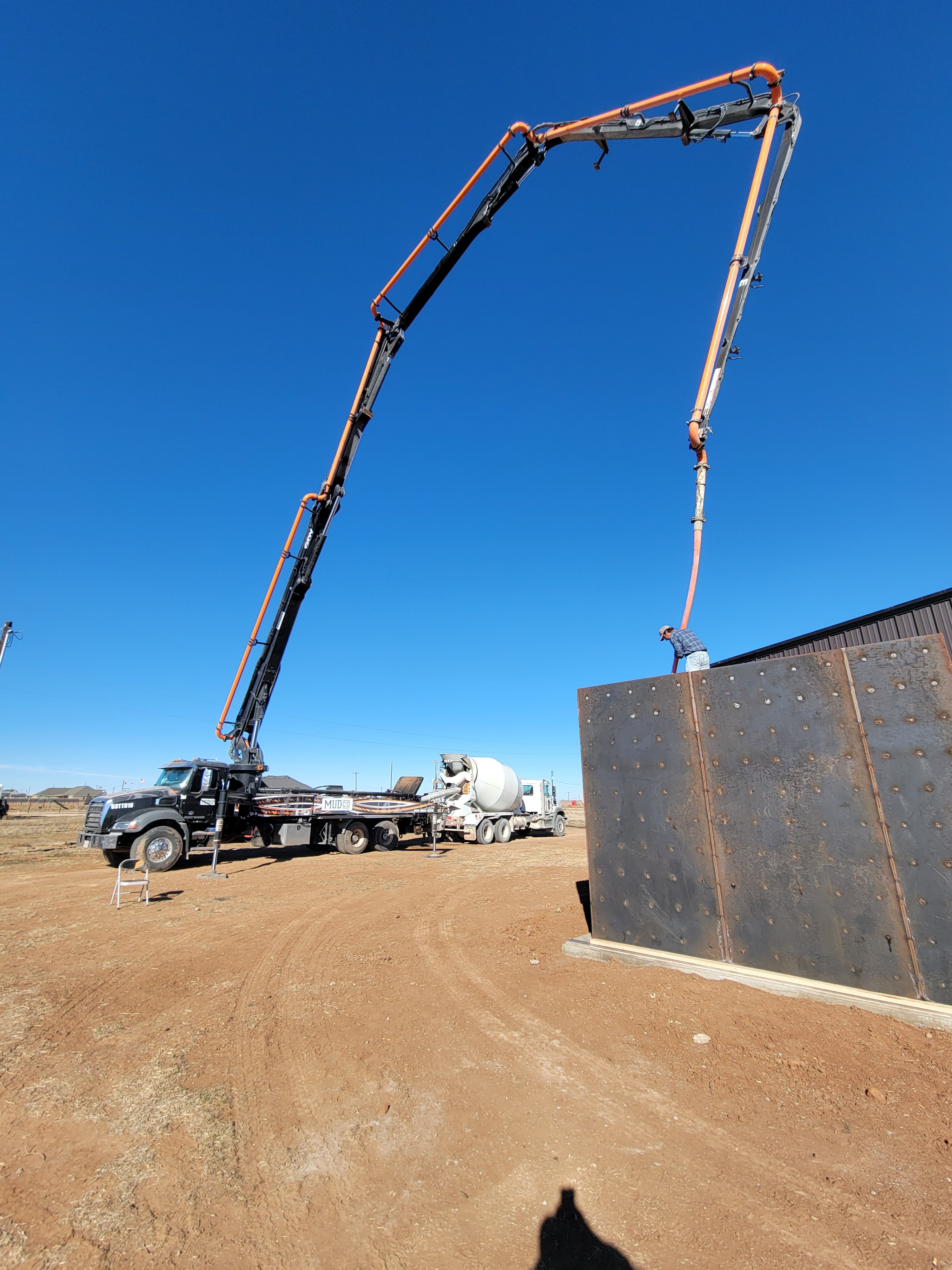

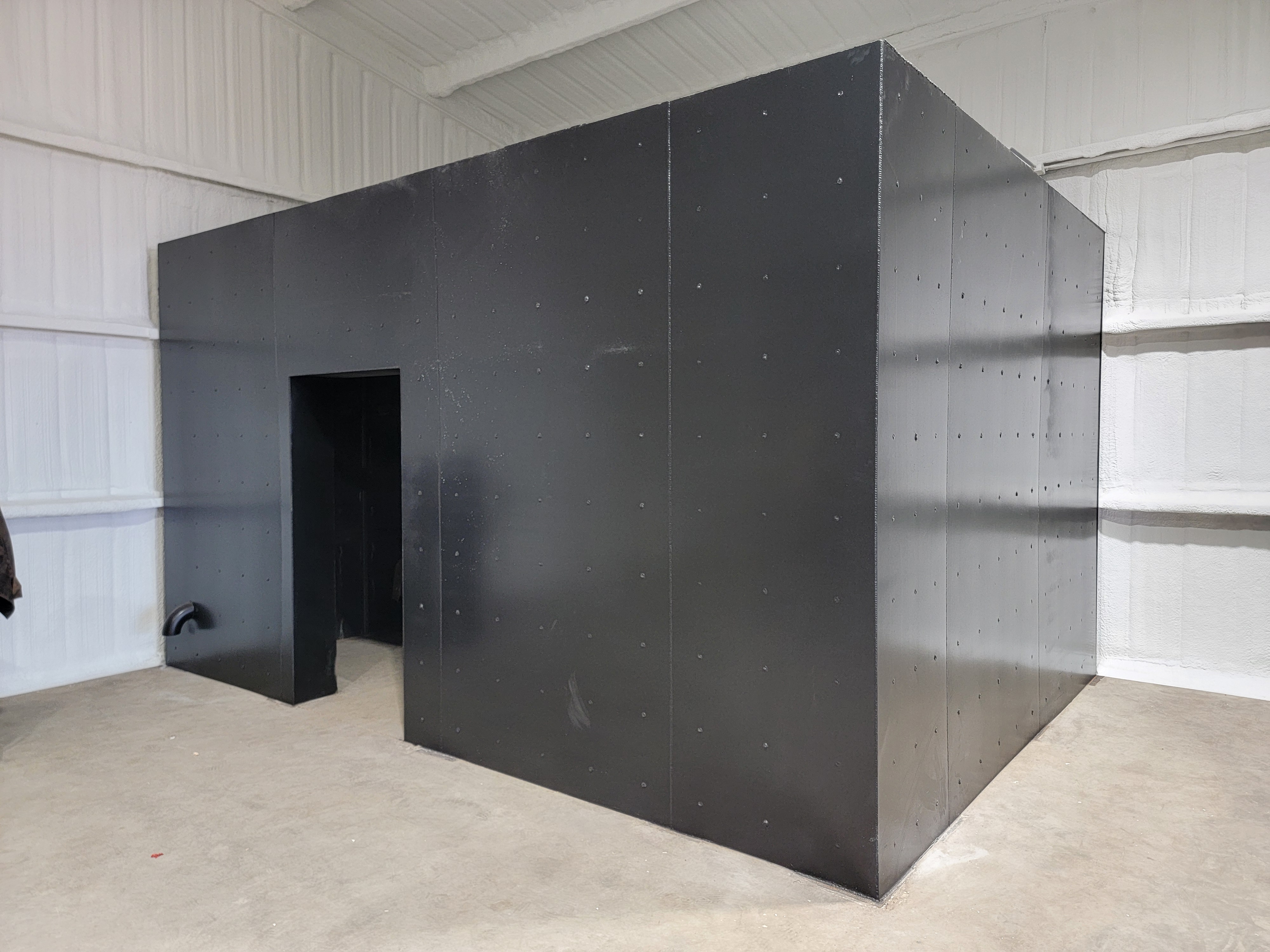

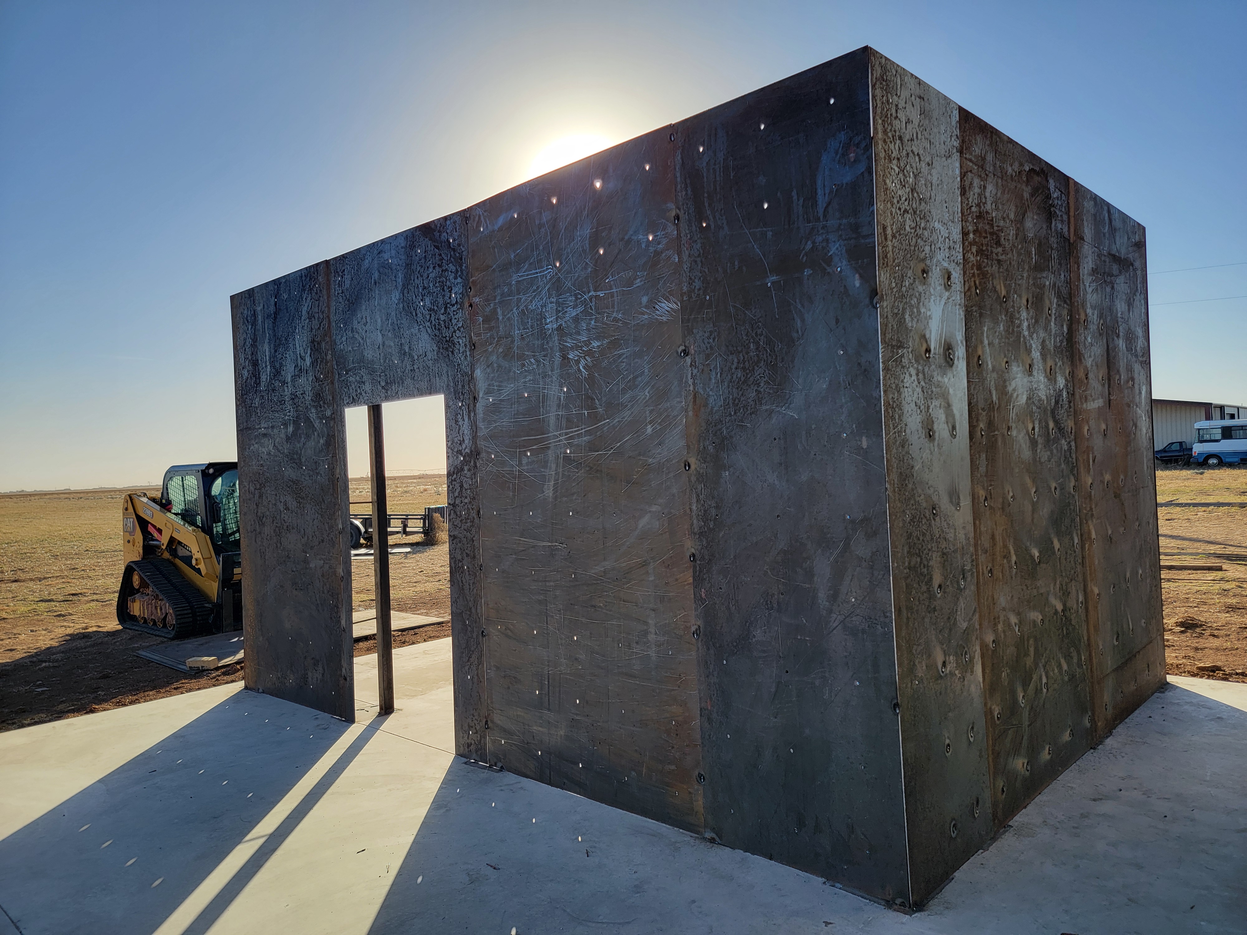

That looks like a 12" thick concrete wall between the interior and exterior steel, true? Then maybe a 12" cap on top? That is a heck of a "storm shelter"!
Exactly. 12" 4000psi concrete on a 24x36 footer and 8" slab with 1/2" rebar. 1/4" plate inside and out tied together with 1/2" rebar every 12 inches.

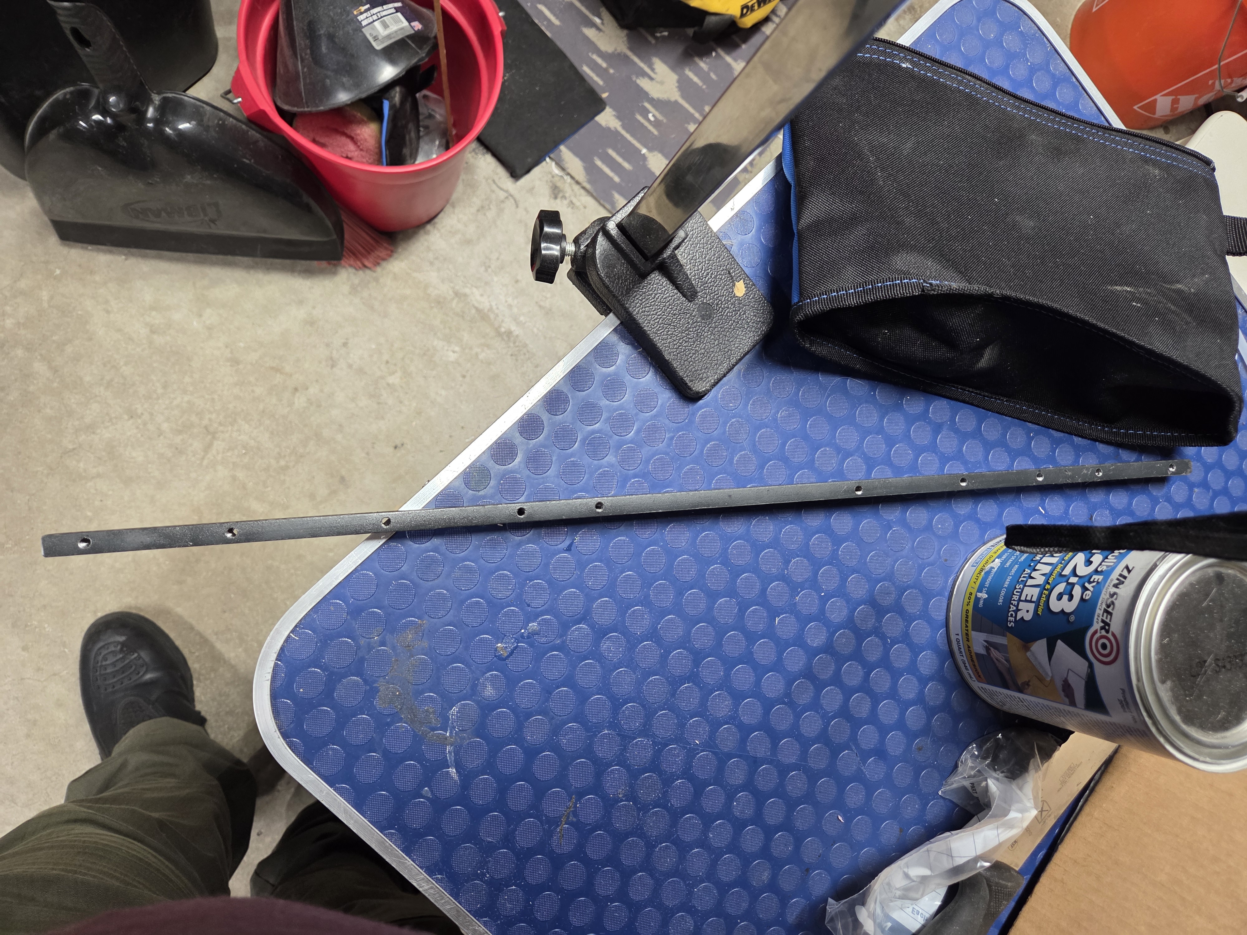

Got this all made up to reinforce my dipping garage door. 3/8x 3/4 x24. Started as 1" wide. Drilled and tapped 10-32. Going to be a bit til I can install it. View attachment 8721954

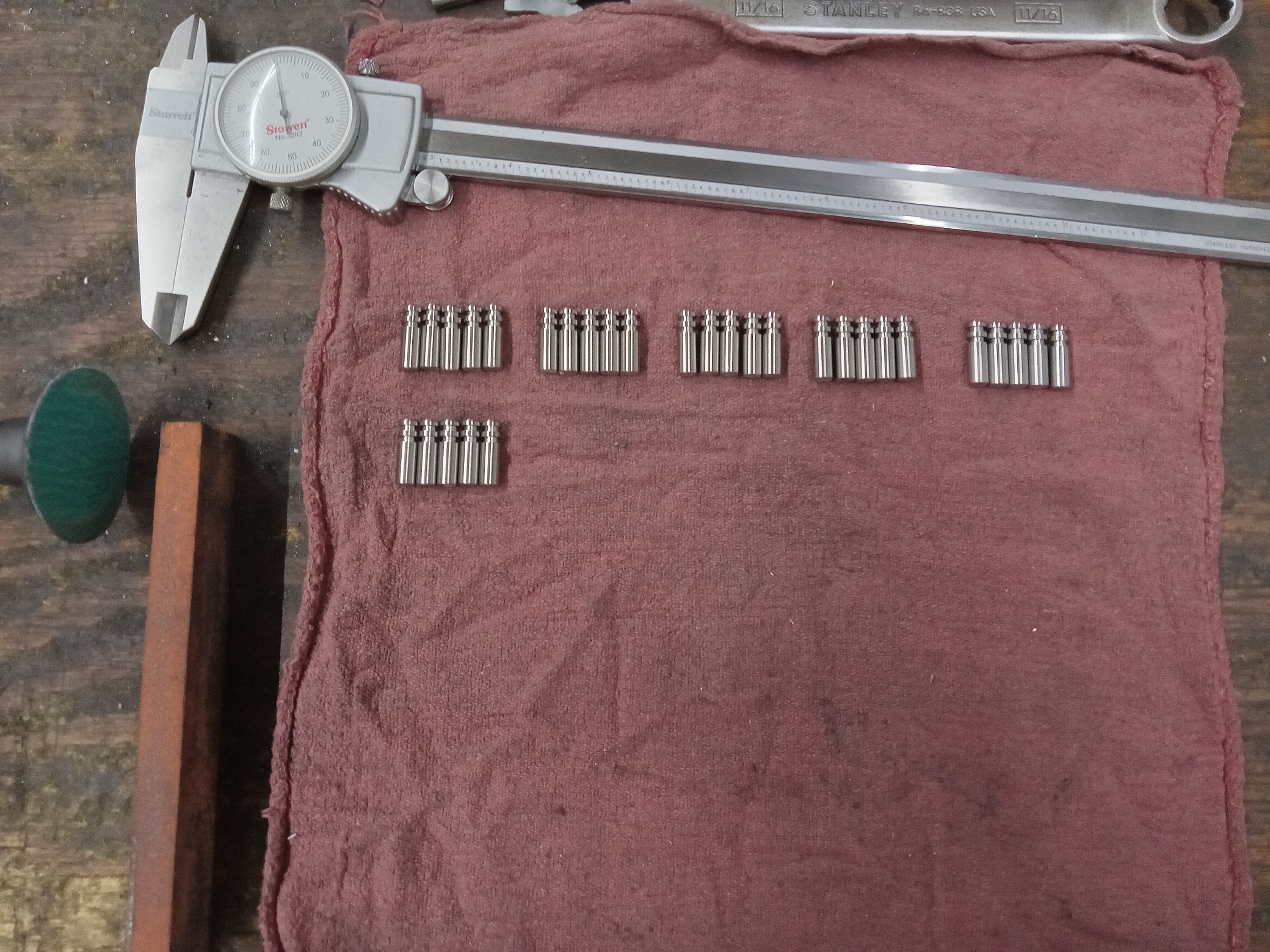

I'm making these pins right now out of stainless. Customer needed 20 pcs ASAP, and an additional 180 afterwards. Got the first 20 done and handed off to the boss, now working on the rest.
Running as a bar job in a collet chuck. Cutting the angle on the end, then the grooves, then cutting off into a parts catcher (which the part will occasionally miss, I need to figure that out lol).
Probably will drop the RPM's on the cut-off so it drops straight down instead of slinging it into the chip trough.
X20.
G96 s250 m03
G01 x5. F0.1
G97 s300
G01 x-1. F0.05
G96 s300
G00 x20.
M09
G00 x100. Z100.
M30
If you have a bar feeder it will be different. But summary is:
Part off normally until 5mm diameter, slowly rpm down to 300, and slow feed rate also. Go 1mm past centre (face off), and part should fall easily and not be thrown into some place you will never find.
Speed chuck back up, pull tool out, coolant off, get tool out the way, then stop.
Insert gcode or macro for parts catcher and bar feeder.
Replace your g96 surface speed to what's appropriate.
Reactions: Makinchips208
Parts are .25" in diameter. Using material right on size, so no need to turn O.D. I run the spindle at 300 RPM for the cut-off. No bar feed. I bring the rougher down to Z .02" and pull material out to touch. Clamp collet and go.

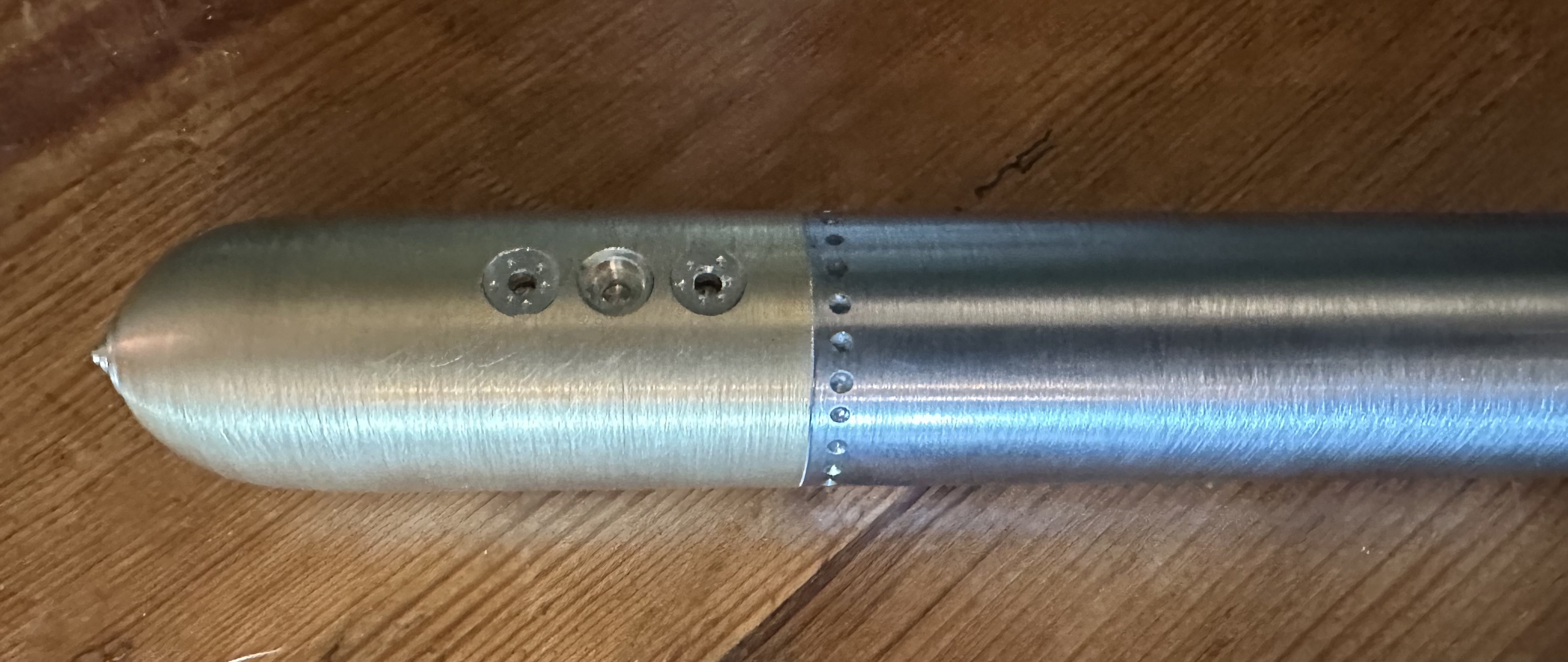

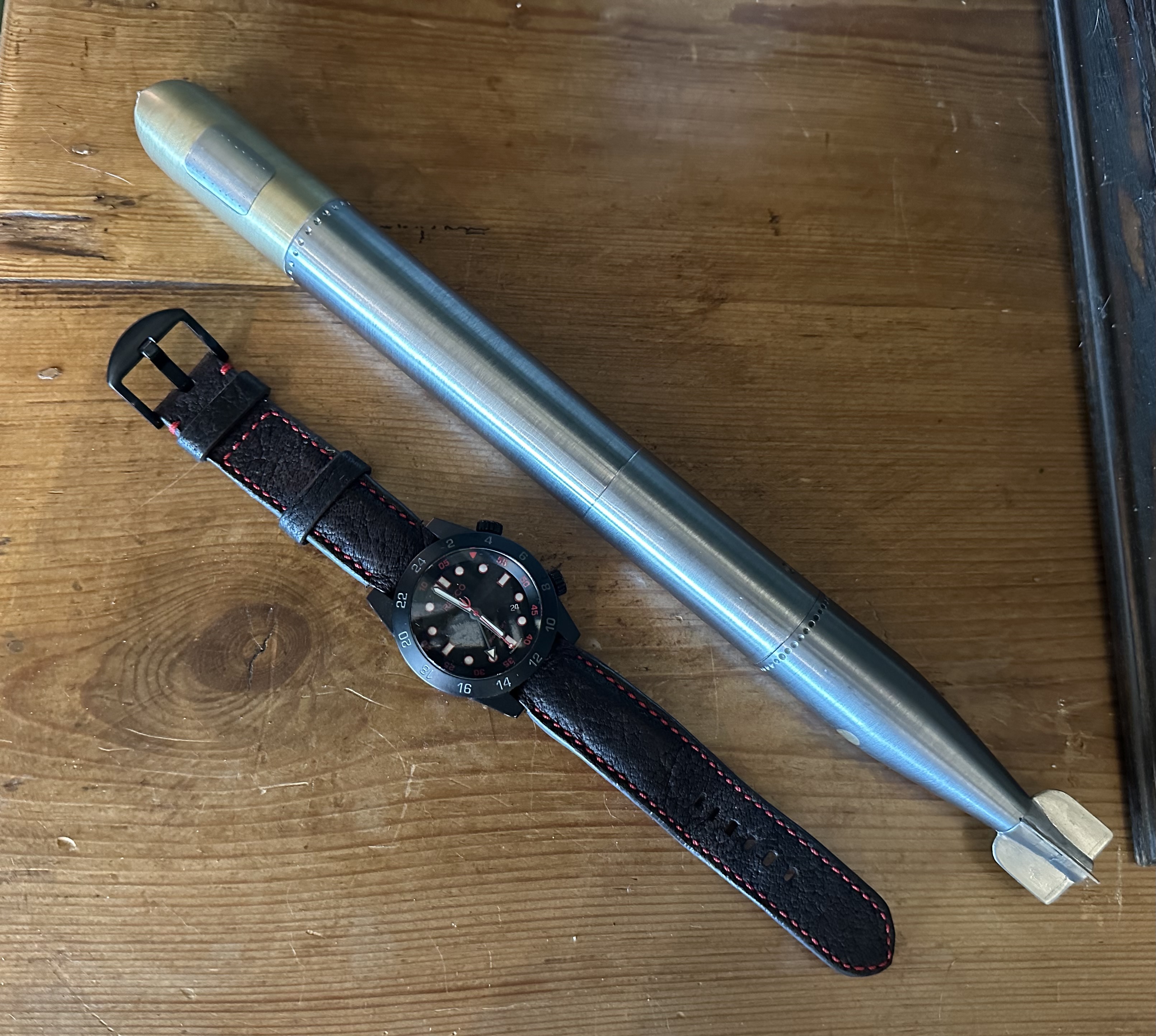

Had a little fun in the shop making a c. 1/20 scale WW2 Navy Mk 14 torpedo from some scrap.
Seen a few of these models in museums, but since they won’t let me take one home, I just figured I’d bang one out!
I’ll make the stand next time it’s to $&@ing hot to go outside and do tractor work.
These were made by the thousands at the torpedo factory in Alexandria, VA. Now some kind of mall/Starbucks and fern bar. But once upon a time, they made the torps that (once they were fixed!!!) ended the war for Japan. All the Atom bombs really did was wake them up to the fact they rost.
Sirhr
PS. Waiting on a small pair of brass propellers, since machining those would be a bitch!

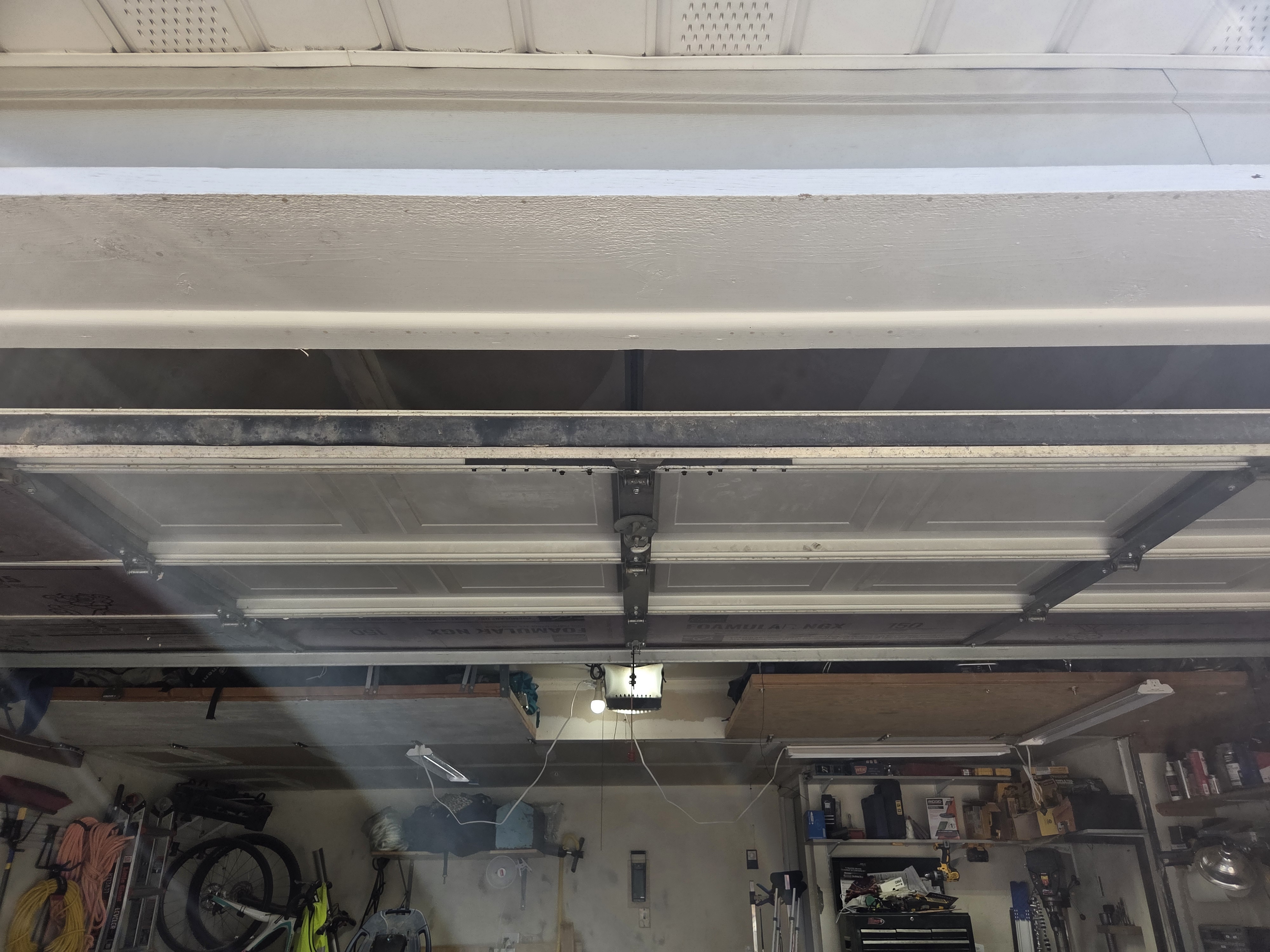

Broke tibia fibula on Monday and have a tibia rod in my leg now. More details in the that's not gonna buff out thread.

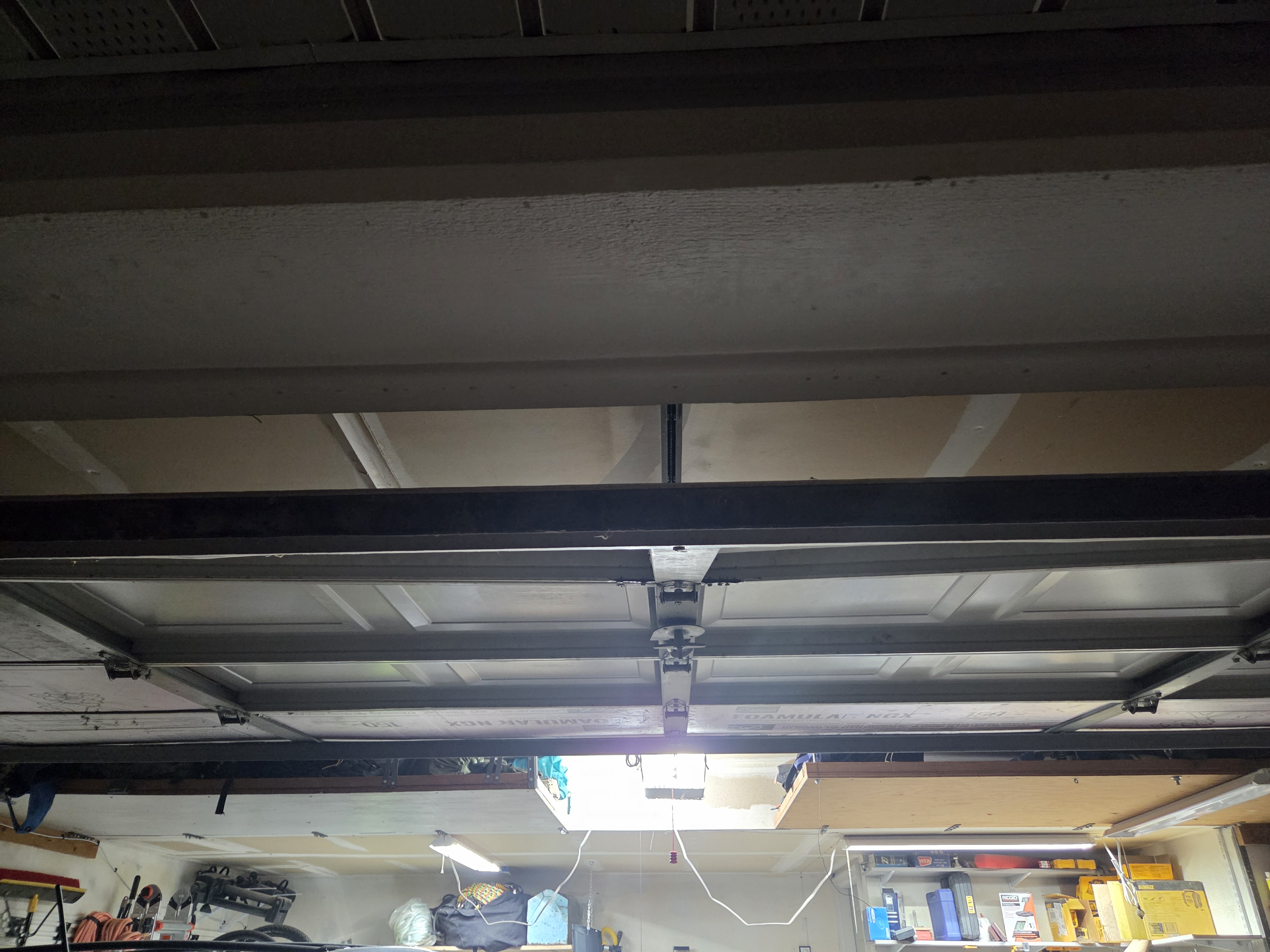

Continuation of project. Most of work done sitting side saddle on my MILs mobility scooter.
Had to do 2 8-32's in the middle and used the other foot with more tapped holes to reinforce the above piece. Much more room to be able to get that one in. Used bench grinder to relieve the edge and a little unfolding of the sheet metal to be able to get longer piece into place.
Top piece
Rebent the under side sheet metal after the pic.
Before sag
After fix
The rest of the insulating of the garage will have to wait. Can't get up on ladder to tension garage spring more and I can tell it needs it. 1/3 - 1/2 of the way done with insulation.

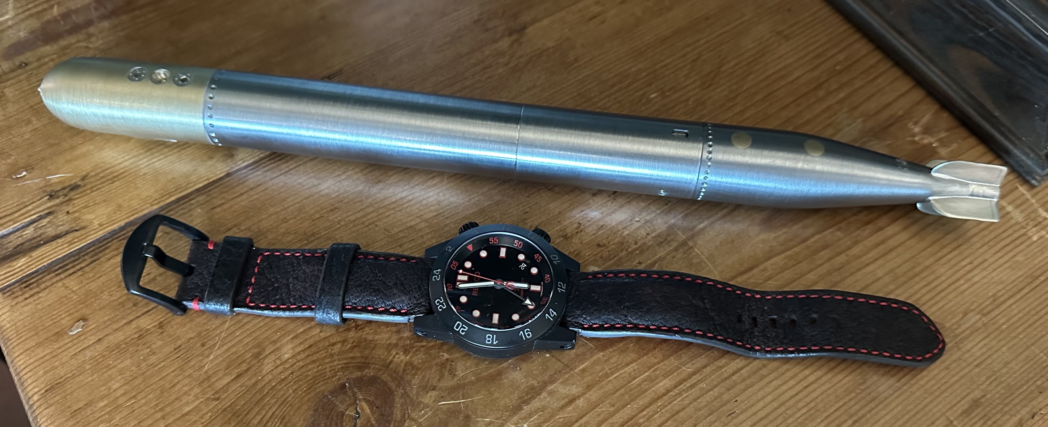

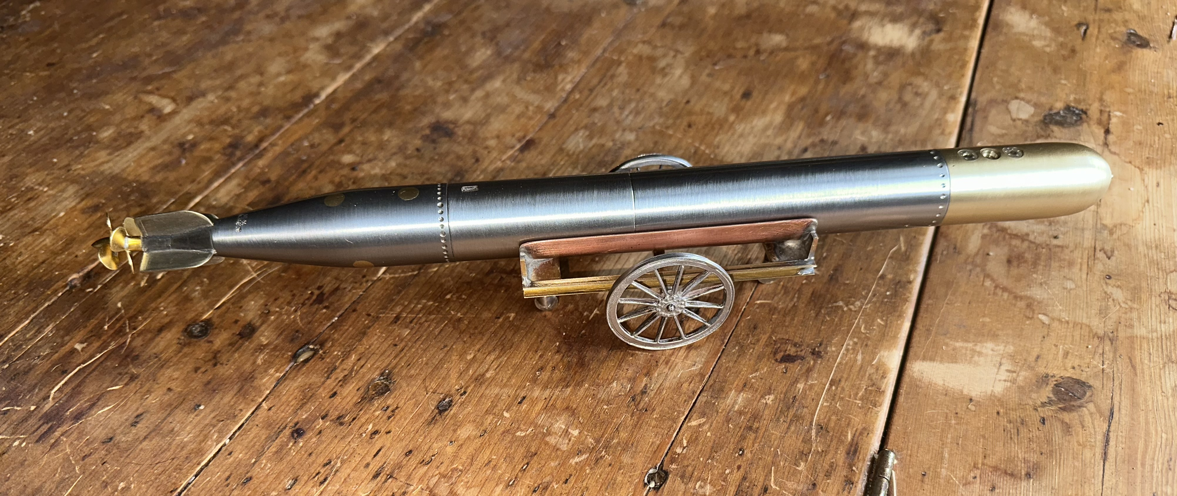

Finished my little model torpedo today with a pair of counter-rotating props and a 'moving cart' similar to those used at the Torpedo Factory in Alexandria. Wheels are from a 1/35th ScaleLink cannon that I'm mounting in a truck... so don't need the wheels!
Fun little museum-type project that was easy, quick and looks wicked cool!

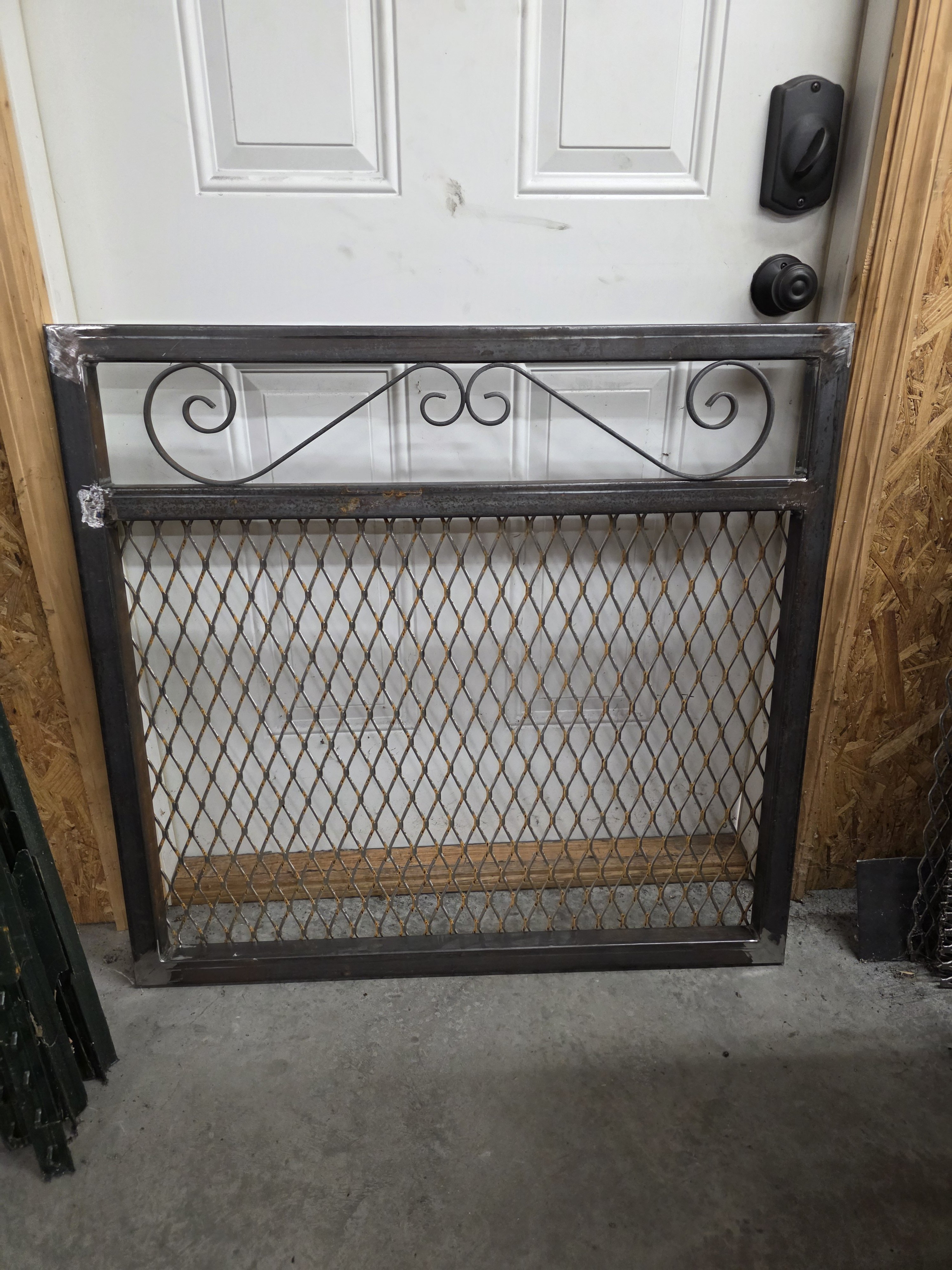

I got a 36 inch inseam and would hesitate to step over that. Lol
Nice job on the gate the scroll work is a nice touch.
I bought a pedestal mounted decorative scroll bender and twister about 10 years ago to make some metal deck furniture for the wife and deck rails for one of my daughters. It was a good buy. I use it for all kind of stuff even here on the farm that needs radiuses, circles bends or twists.

Nicely done. and awesome detail. Did you make this on your Monarch

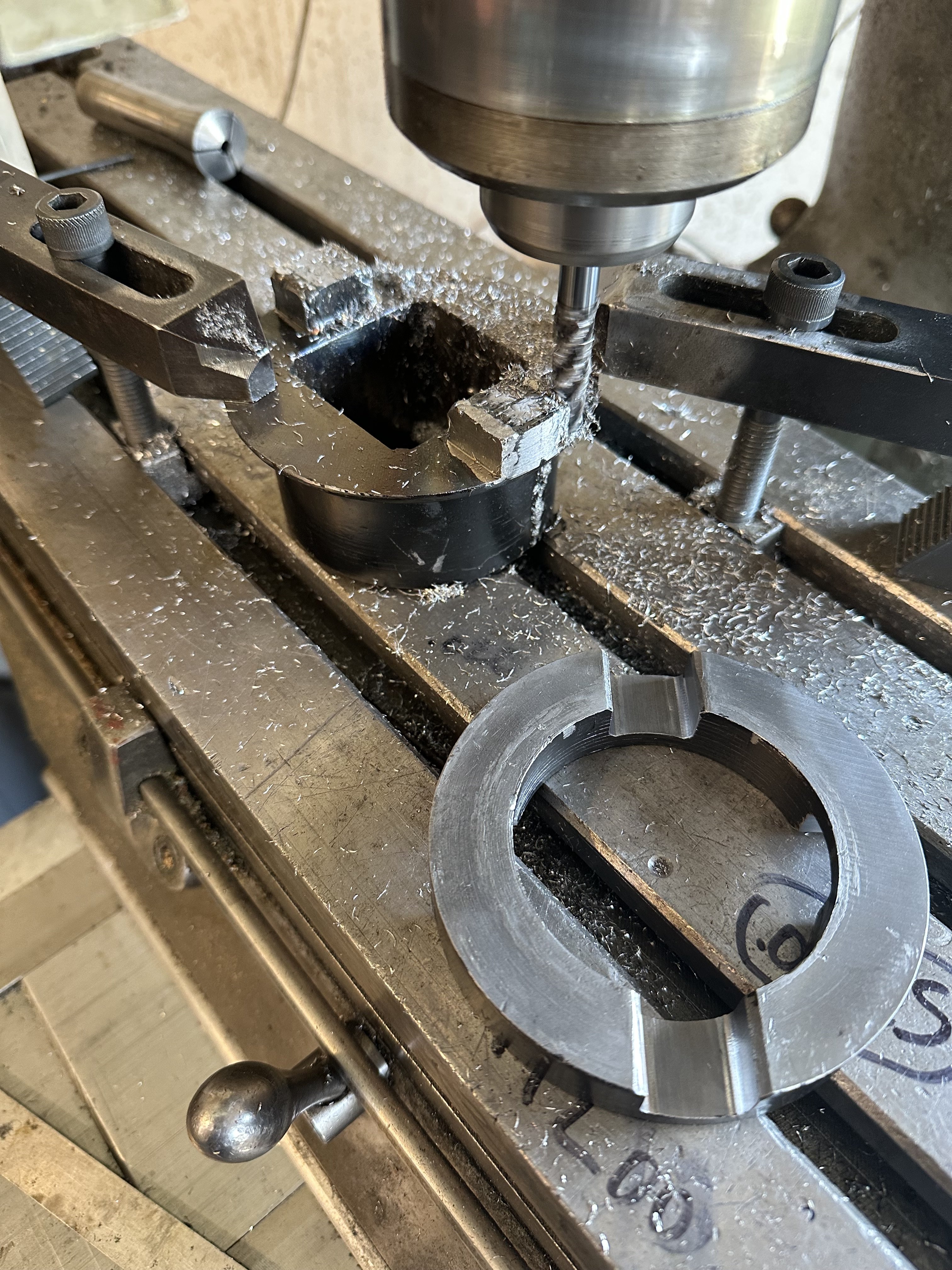

Not a “fun” project but an actual repair of a universal joint coupler called a Carden shaft on a 1913 Buick. The lugs had almost 100 thou of wear in them so had to build up the male lugs with weld and then true the 'females.' There are 4 of them, for an X-Y axis. The disk is harder than woodpecker lips. But with a carbide bit, got through it.
Then centered up the male drive pieces and they are getting cut on each side to center on the drum. And then cut to .0005-ish over the width of the females. and the rest will be done with sanding blocks and lap to get a perfect slip fit two directions.
Lots of math to get everything exactly centered where I want it. This is why I love DRO’s!!!
