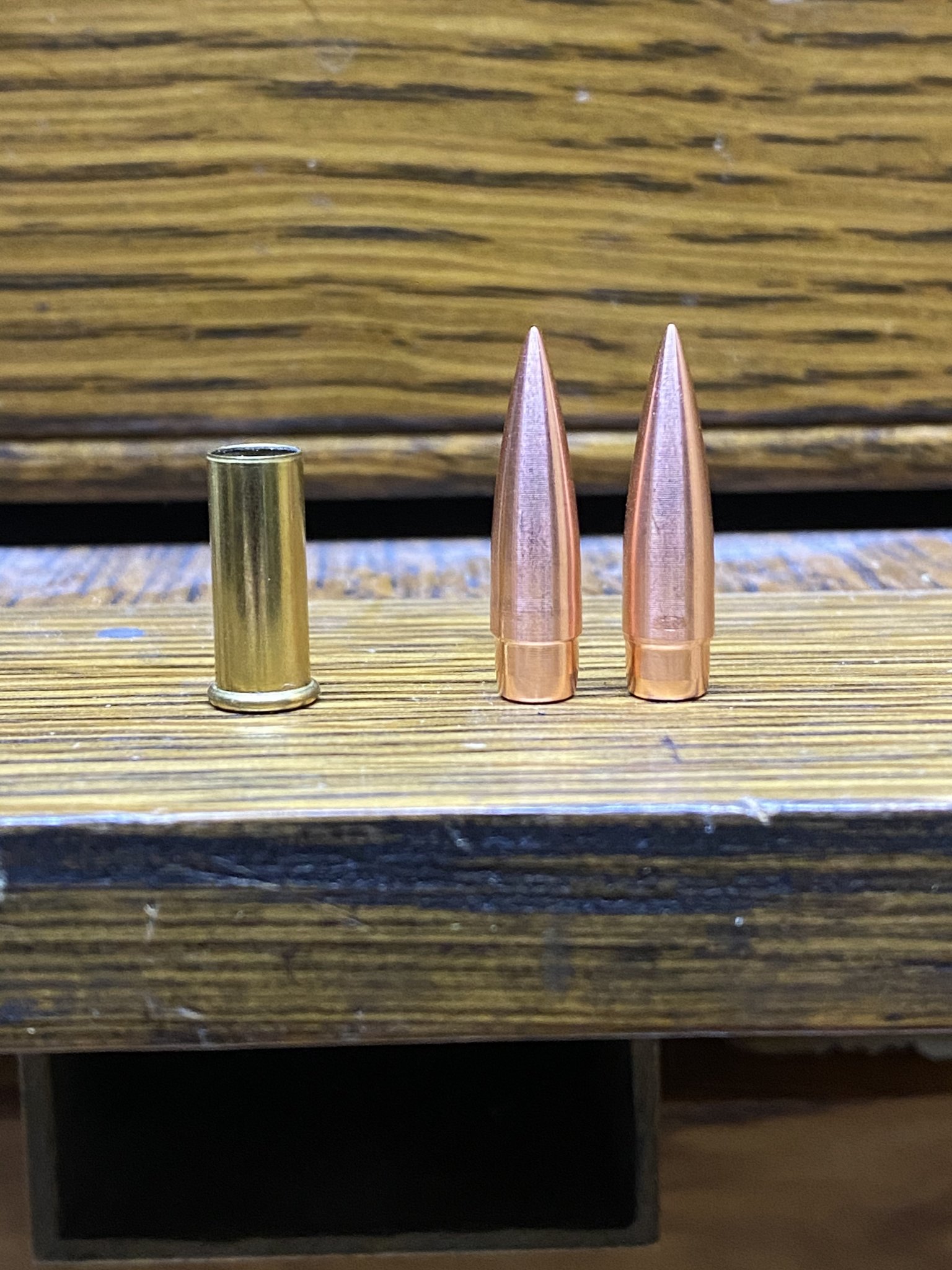

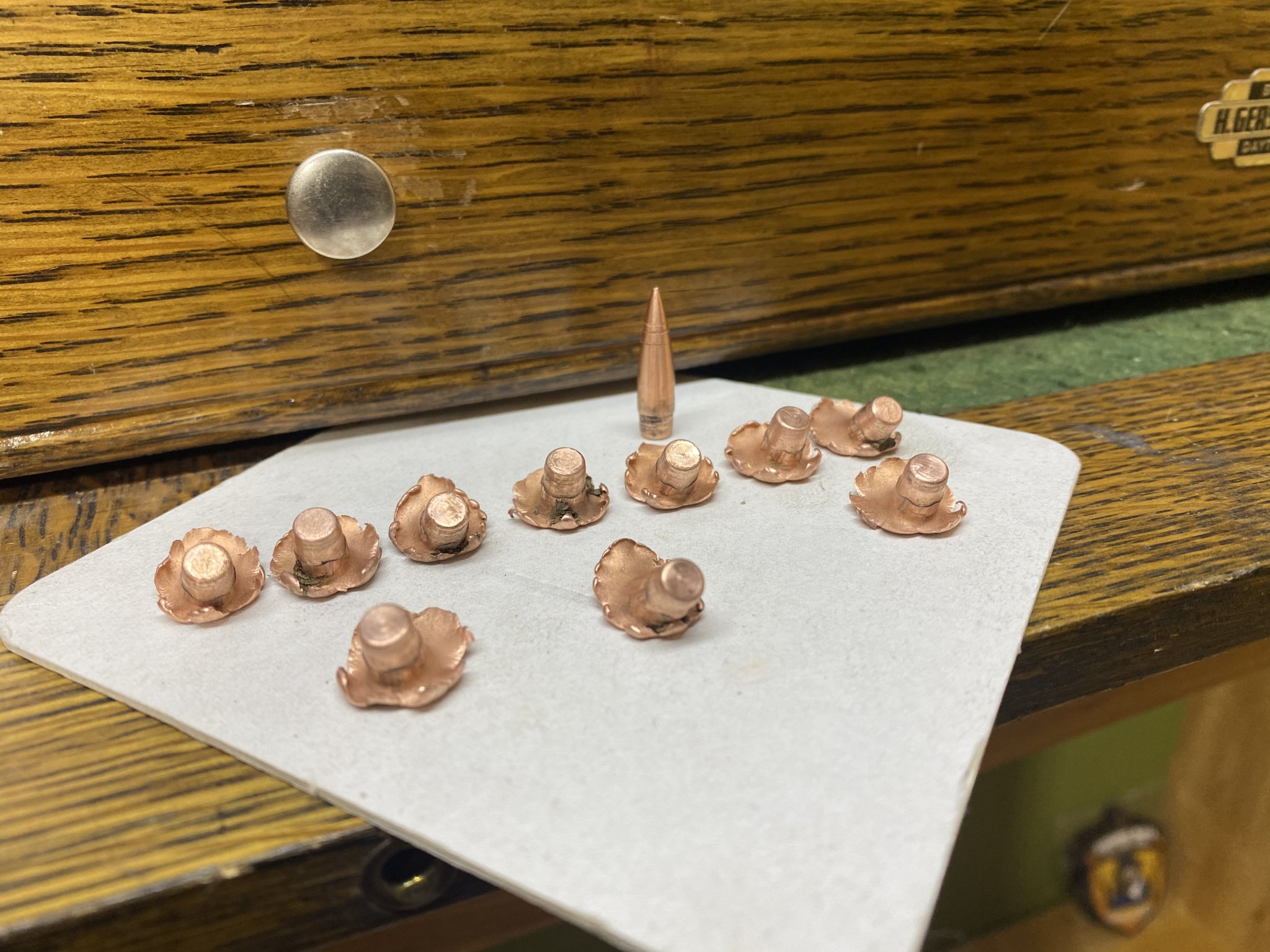

The bullets are from Badlands Precision.
Also talked about in this thread.
Here is post 96

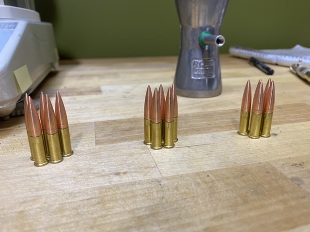

Currently these aren’t available to the public. The guys and badlands and myself wouldn’t want an unproven design out there. It’s one step at a time in the testing and evaluation. Once I’m certain that it doesn’t what I want it to do, then it’ll be available

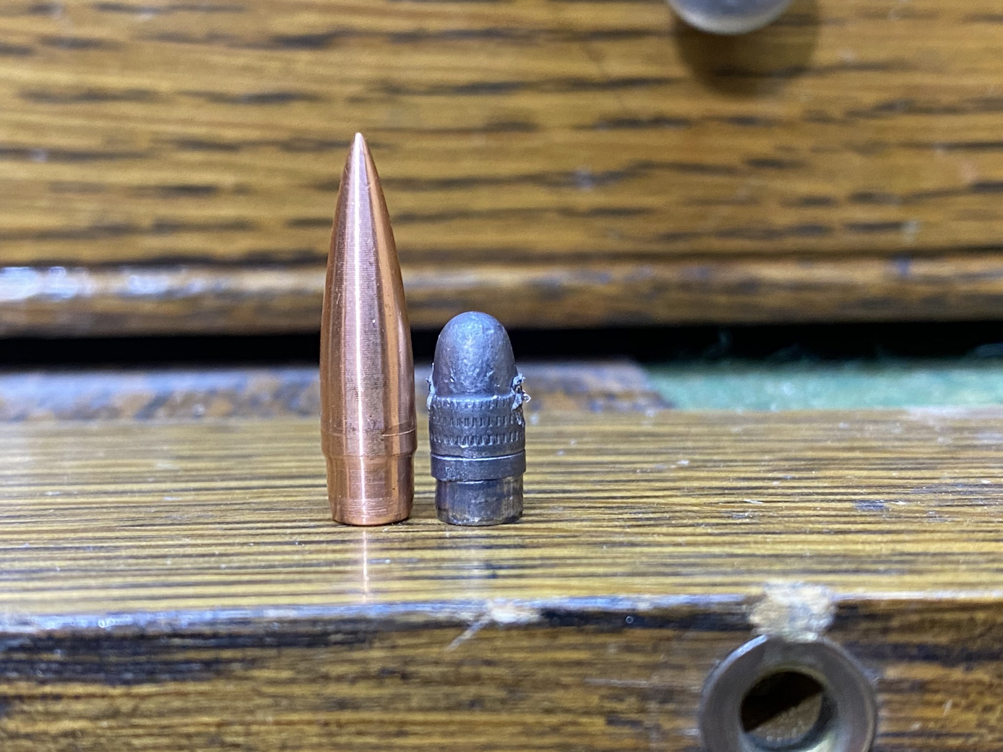

The first generation of the bullet is proven to work. It does what I wanted and more tha. I expected. I’ve talked with Badlands, and whenever they want to release them to the public, is up to them and their production capacity. This was thrown on their plate on top of all the things that they had in the works before I started this project.
The second gen. Bullet hasn’t been fired from a barrel yet. It’s designed to take advantage of a different barrel geometry gain speed and increase weight with no negatives. The new barrel geometry should still fire regular lead ammo just fine, but I haven’t proven that yet.
I would say the more interest they receive, the faster they bring this bullet into full production
Awesome!

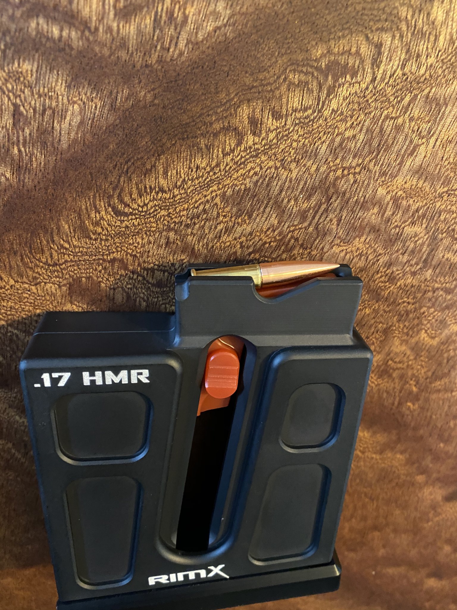

Just so I have this right... If they _were_ to produce the gen 1 projectiles and sell them -- they would have to be fed into the action one at a time due to not fitting into a standard .22lr magazine - correct?

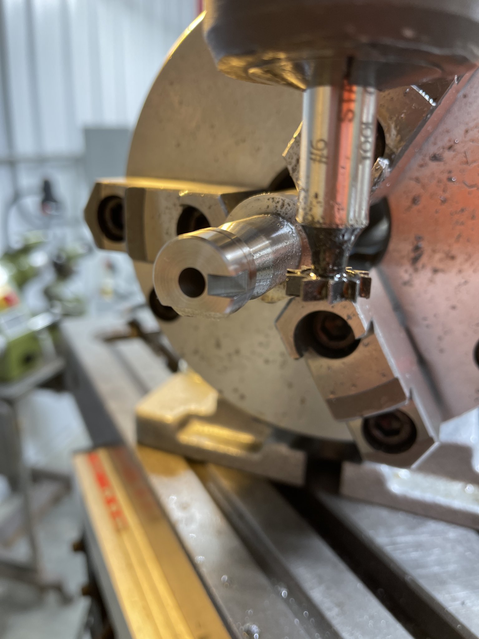

It’s not really a crimp. I made a make shift “neck sizing” die out of a scrap 223 barrel. The rifling is actually sizing the neck down to give it grip on the bullet. Once I get to really where I want to be with all the load info, I’ll make a proper bushing die and start changing the tension that retains the bullet
Gotcha that's far better then ring crimping I made one out of A2 today a donut style I turned the bullet shank to expand the brass .0003 under the chamber size then my die was .0008 under chamber. It passed through really easy I hope a .150 shoulder with .0005 interference is enough. You proably already know but with the dual alloy Noslers it might be different.
Probably both. The gen 2 is simply designed or a different barrel geometry. It’s not a common thing in the 22 industry Yet so I’m not sure how it’ll behave with traditional ammo
