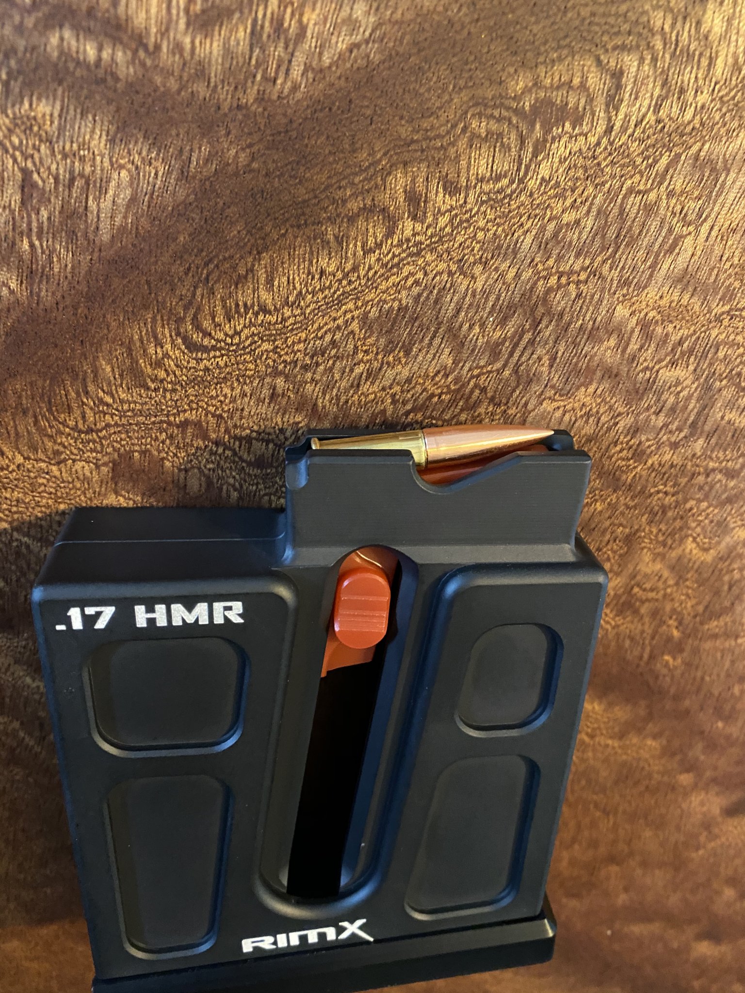

Think I’ll take a step forward with the Vudoo, well 22lr anyway. Let’s try a Quad

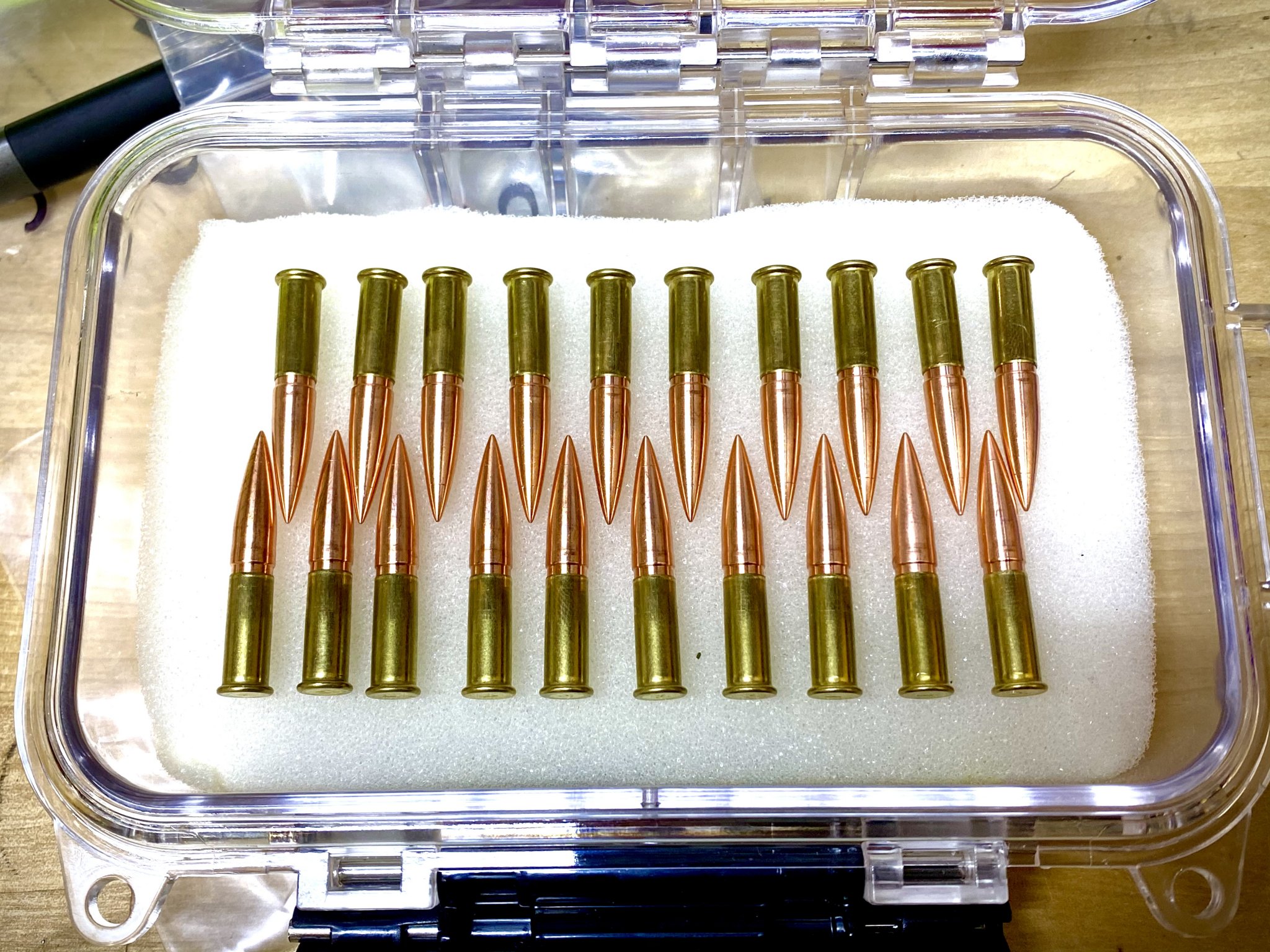

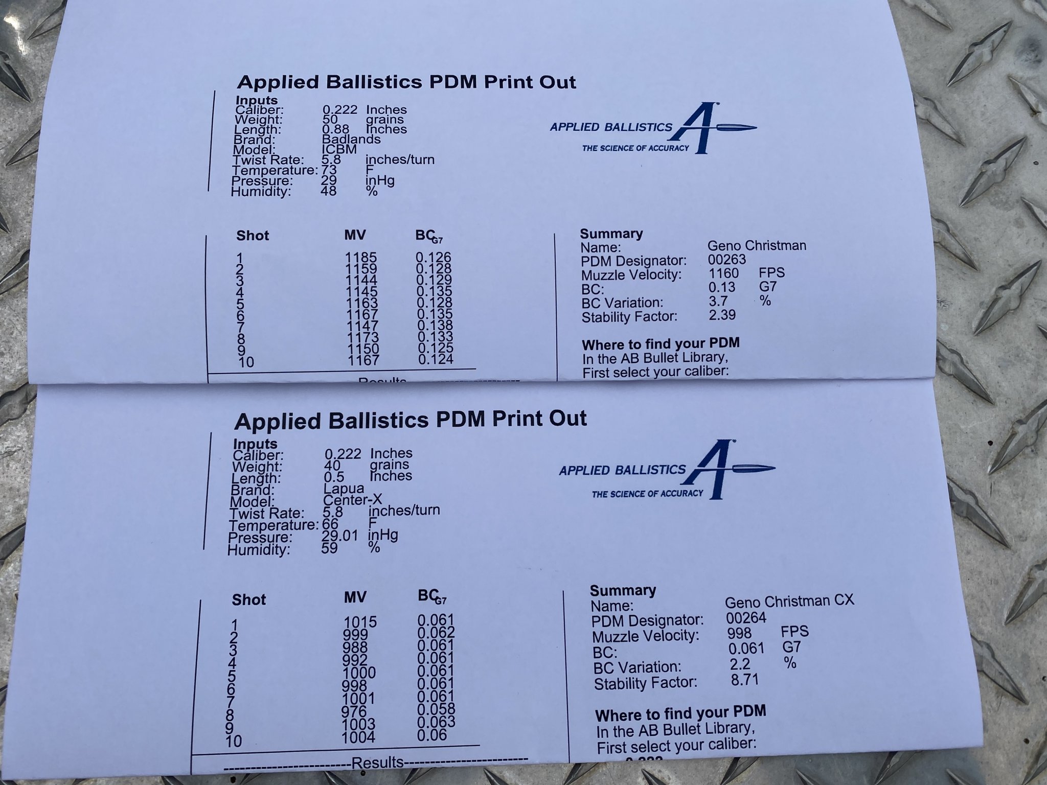

Been working on this whenever I can. Been trying to get something consistent speed wise so the 217/222” bullet can be shot over the AB radar today. Should have some results on bc and consistency. A friend will be shooting it because I can’t guarantee I’ll be free from work and be able to.

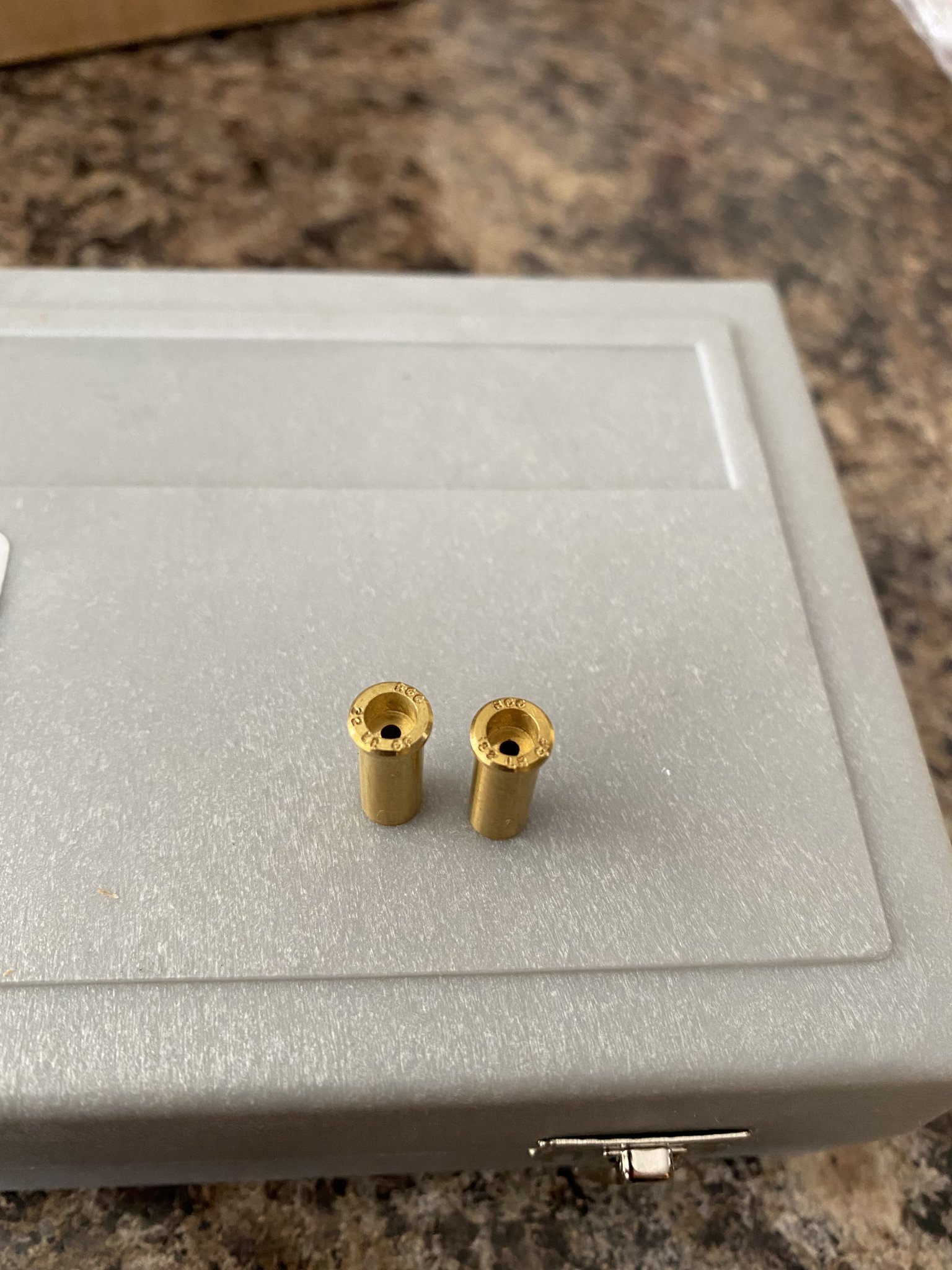

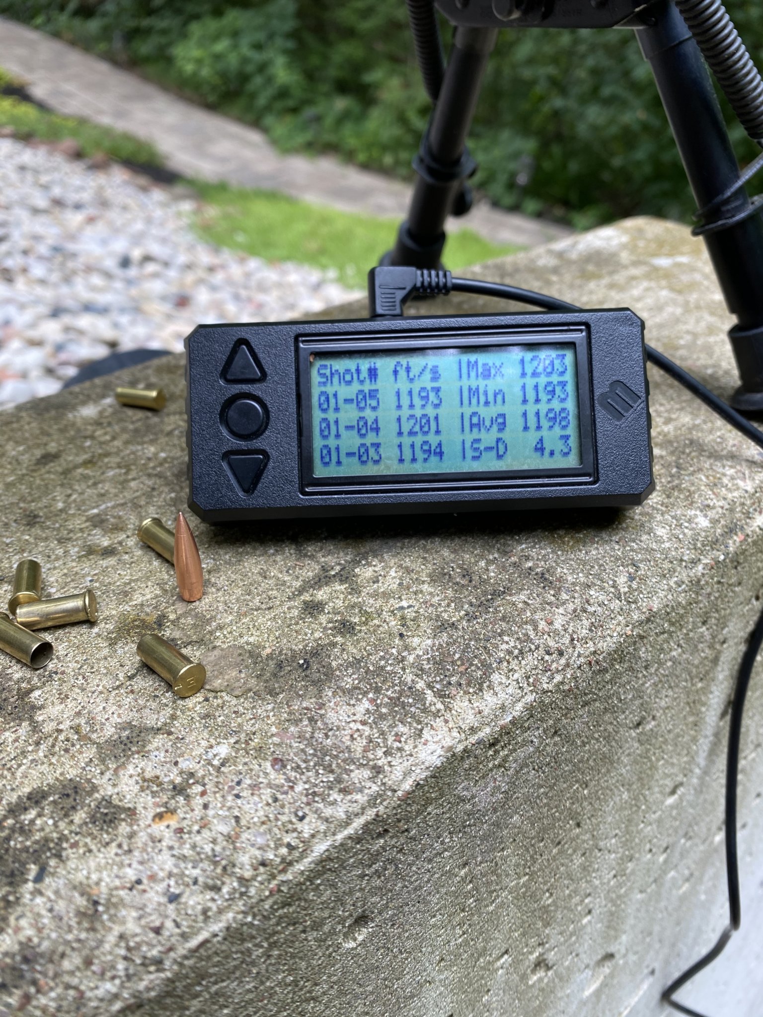

Been running AA9 has been running around 1300fps but every once in a while it’ll pop a case. I switched to N105 for the radar run and will be running at 1200fps for safety. I was able to get a solid load that held for 2 different range trips so as long as it does what it shows it will, we should get some solid data this evening.

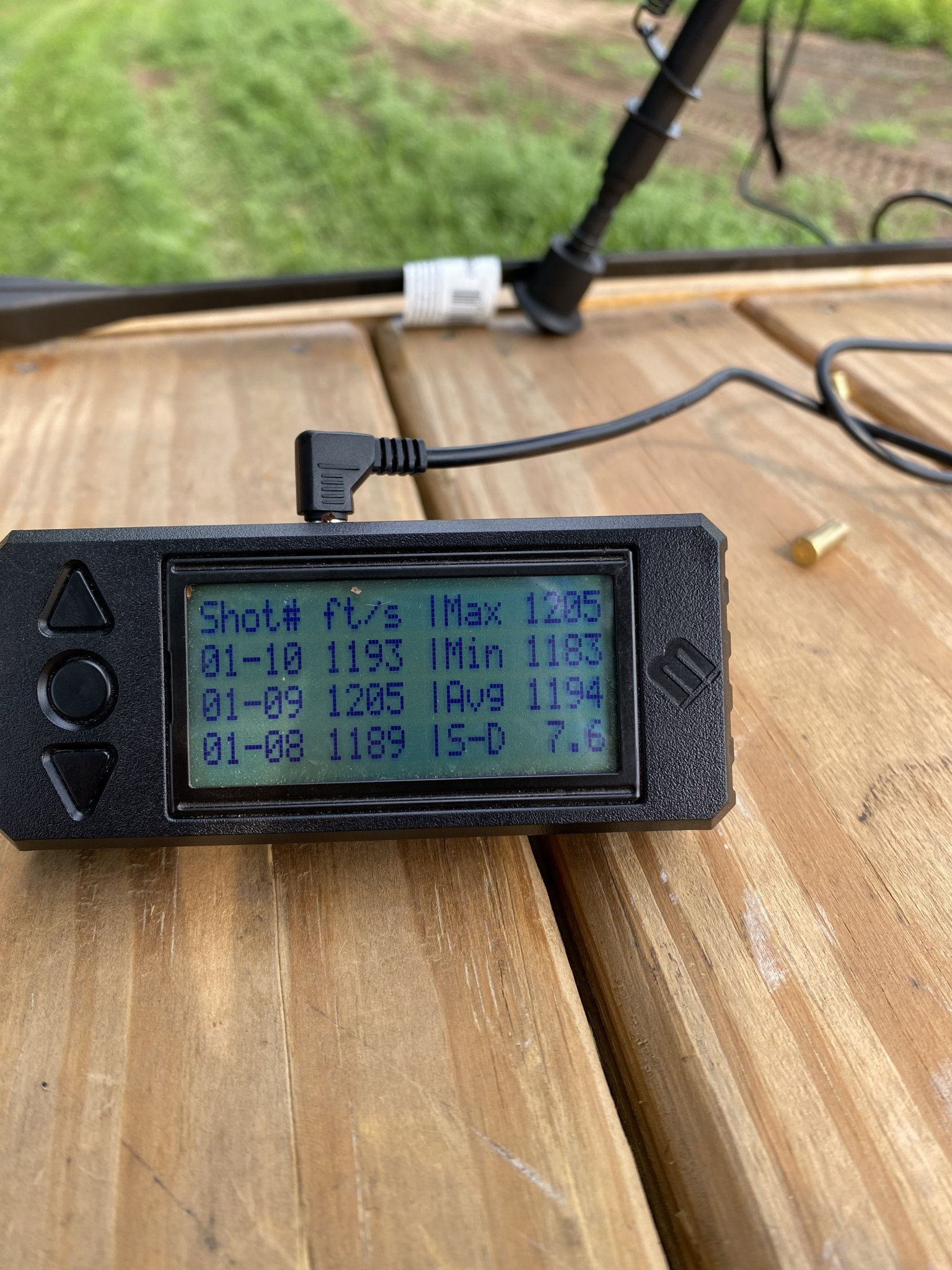

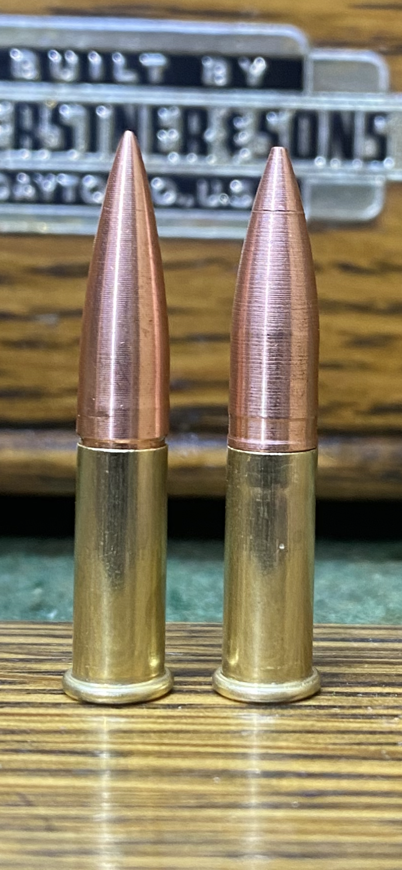

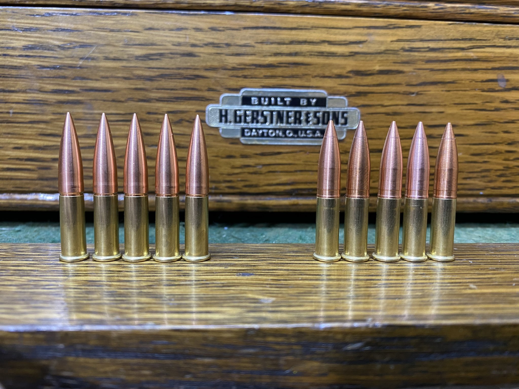

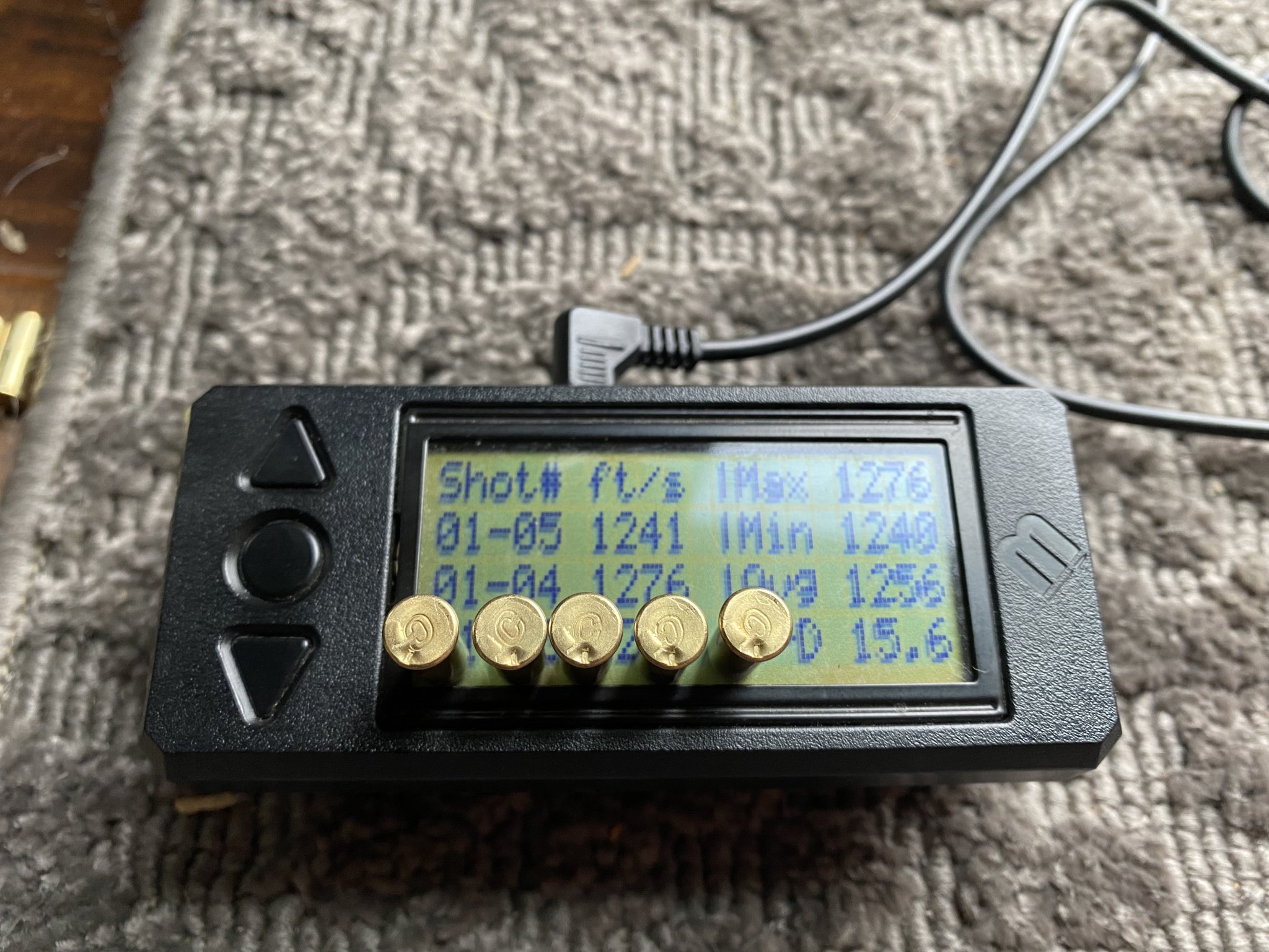

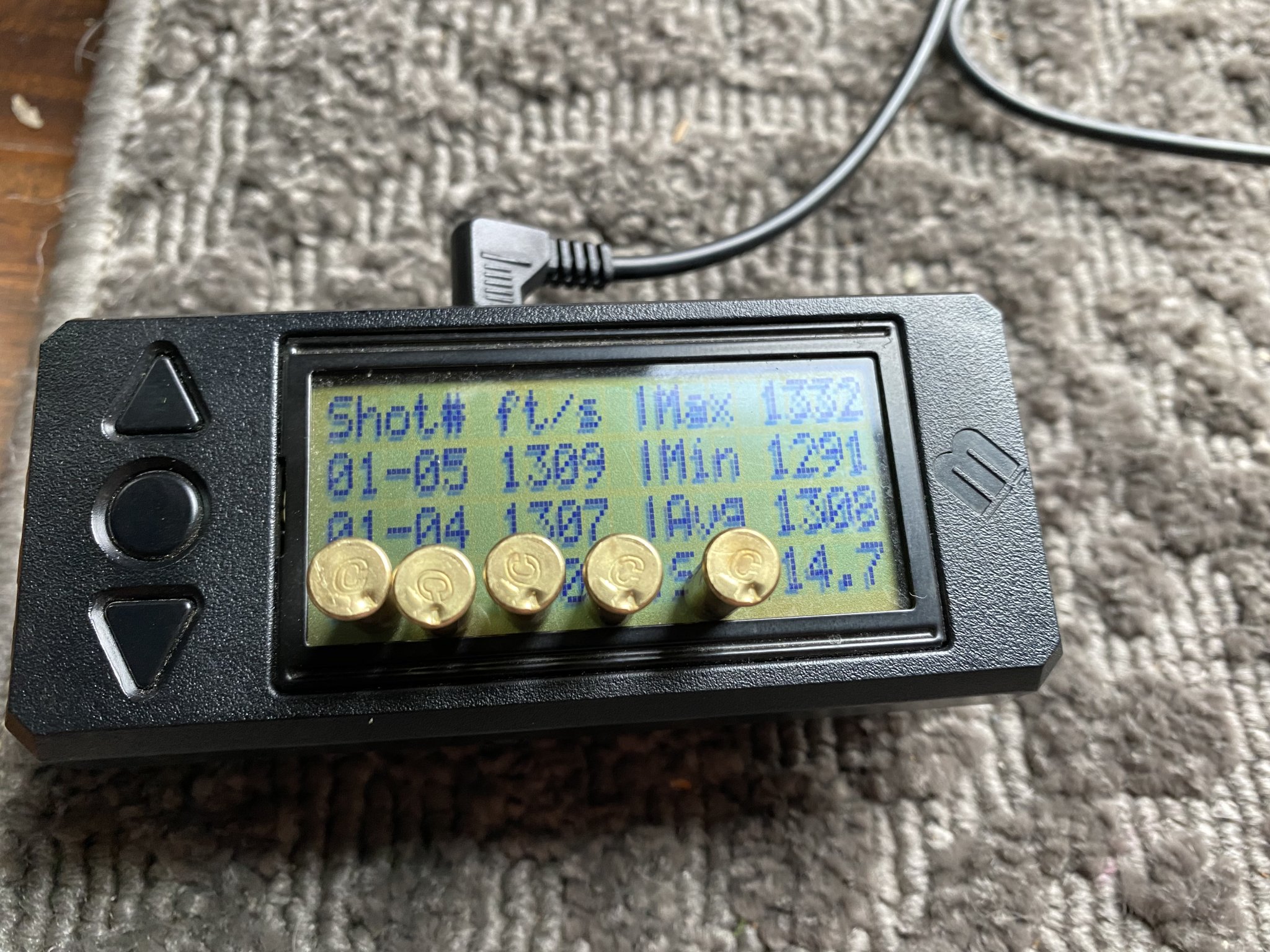

Been working with this some just always forget to update here. This was a comparison of the 50gr from Badlands and Cutting Edge. Cutting edge runs a bit faster. I’ll have to run the numbers to see if that makes up for the lower bc enough though. This load wasn’t tuned for either bullet. It was just the highest load of Pro Reach that I would run with hopes of all of the cases holding together. This was also shot with the CCI cases that came with the Cutting edge bullets, and it the usual Eley cases I’ve been using lately.
View attachment 7760977View attachment 7760978View attachment 7760979View attachment 7760981Been working with this some just always forget to update here. This was a comparison of the 50gr from Badlands and Cutting Edge. Cutting edge runs a bit faster. I’ll have to run the numbers to see if that makes up for the lower bc enough though. This load wasn’t tuned for either bullet. It was just the highest load of Pro Reach that I would run with hopes of all of the cases holding together. This was also shot with the CCI cases that came with the Cutting edge bullets, and it the usual Eley cases I’ve been using lately.
