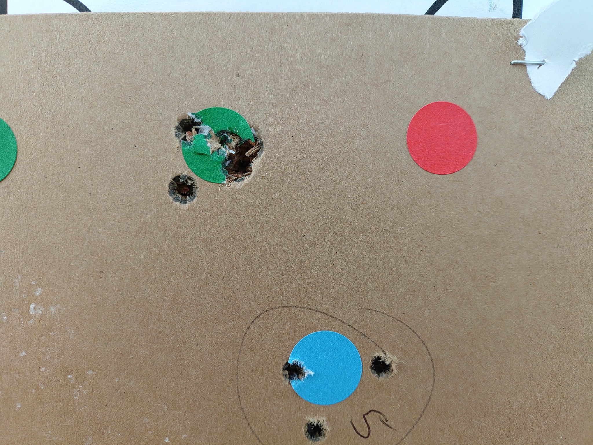

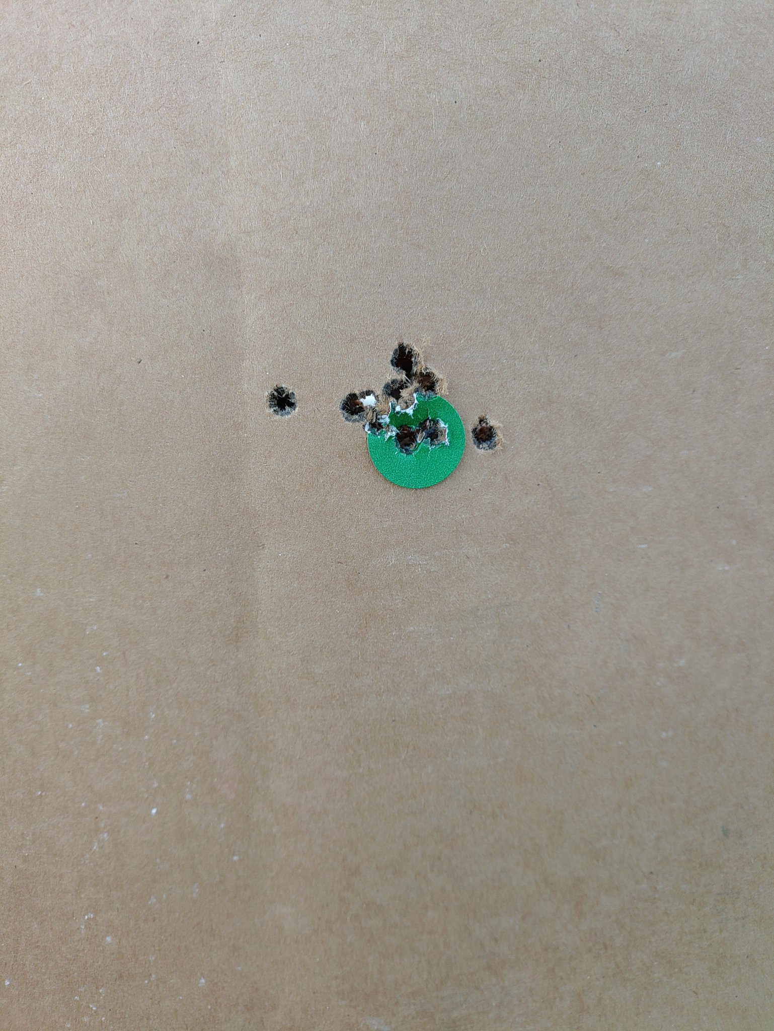

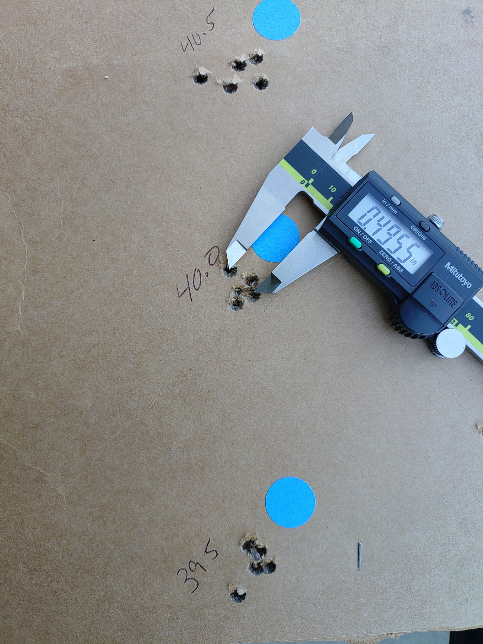

Finally put my overstock 6mm creed barrel onto one of my Bighorn Origins and shot 30 rounds through it this morning.....I might have to get another one to chop down this one looks like it'll shoot
10 shot 100 yards group with leftover (from another 6 creed I have) 112gr Match Burners at 2970fps. 1/2" sticker. That's pretty decent for a $200 barrel with ammo developed in another rifle. 8 of the 10 shots were in 5/8" the whole group was 1 1/2".
Also shot the 125gr load from the Solus 308 I had worked up. Chrono'ed 3040fps but 5 shot groups at 100 was as expected.....blue dot groups is a Non- Solus 25-06AI with 87gr HP @ 3740fps

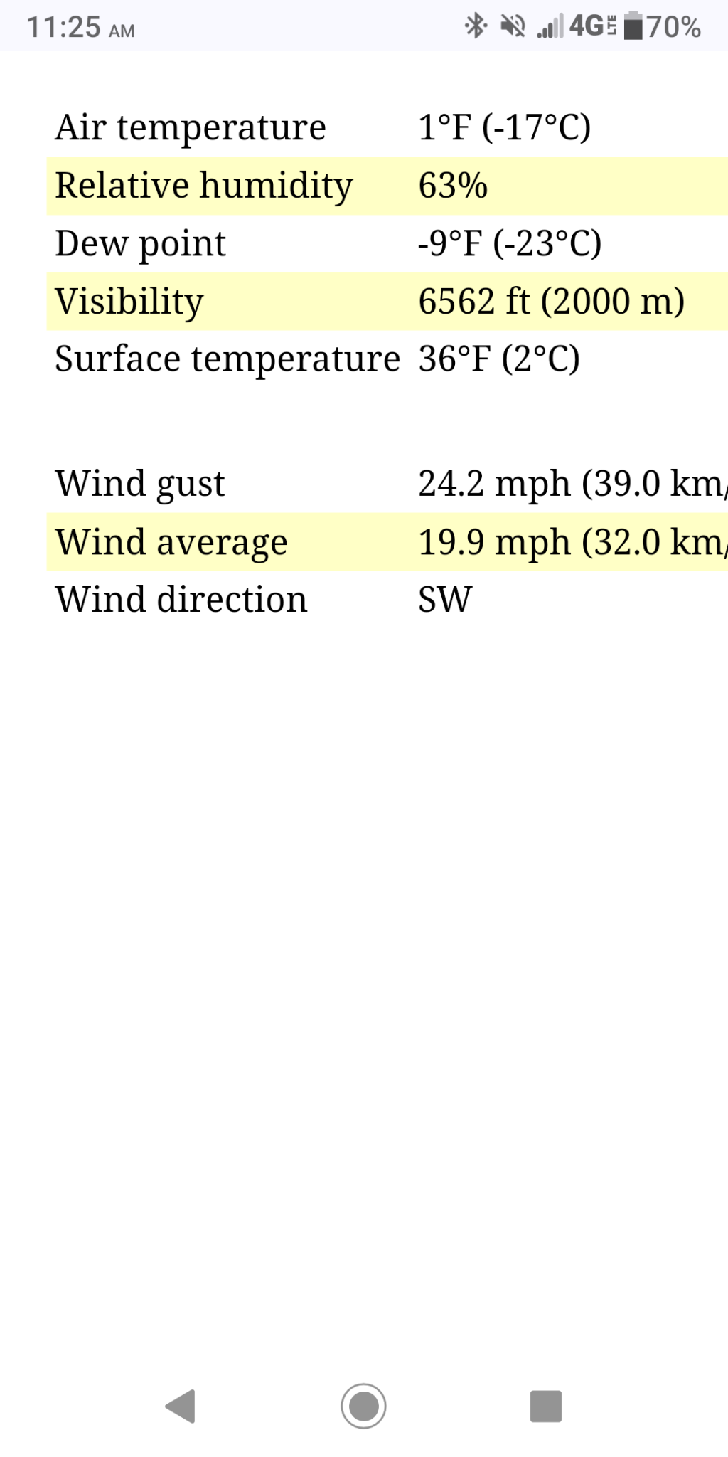

Less than ideal conditions for shooting today but I wanted to finish this leftover ammo so I can prep the brass. 9 shot group on the right. 112gr match burners @ 2970. 10 shot group on the left 115gr DTac @ 2950. Both are right at 1"
I shoot prone out of my truck bed between the wind moving the truck and the target I'm not disappointed. My other 6creed shoots that same 115gr load about 25fps slower and sub 1/2 so I'm curious what it'll take to tune in this barrel.

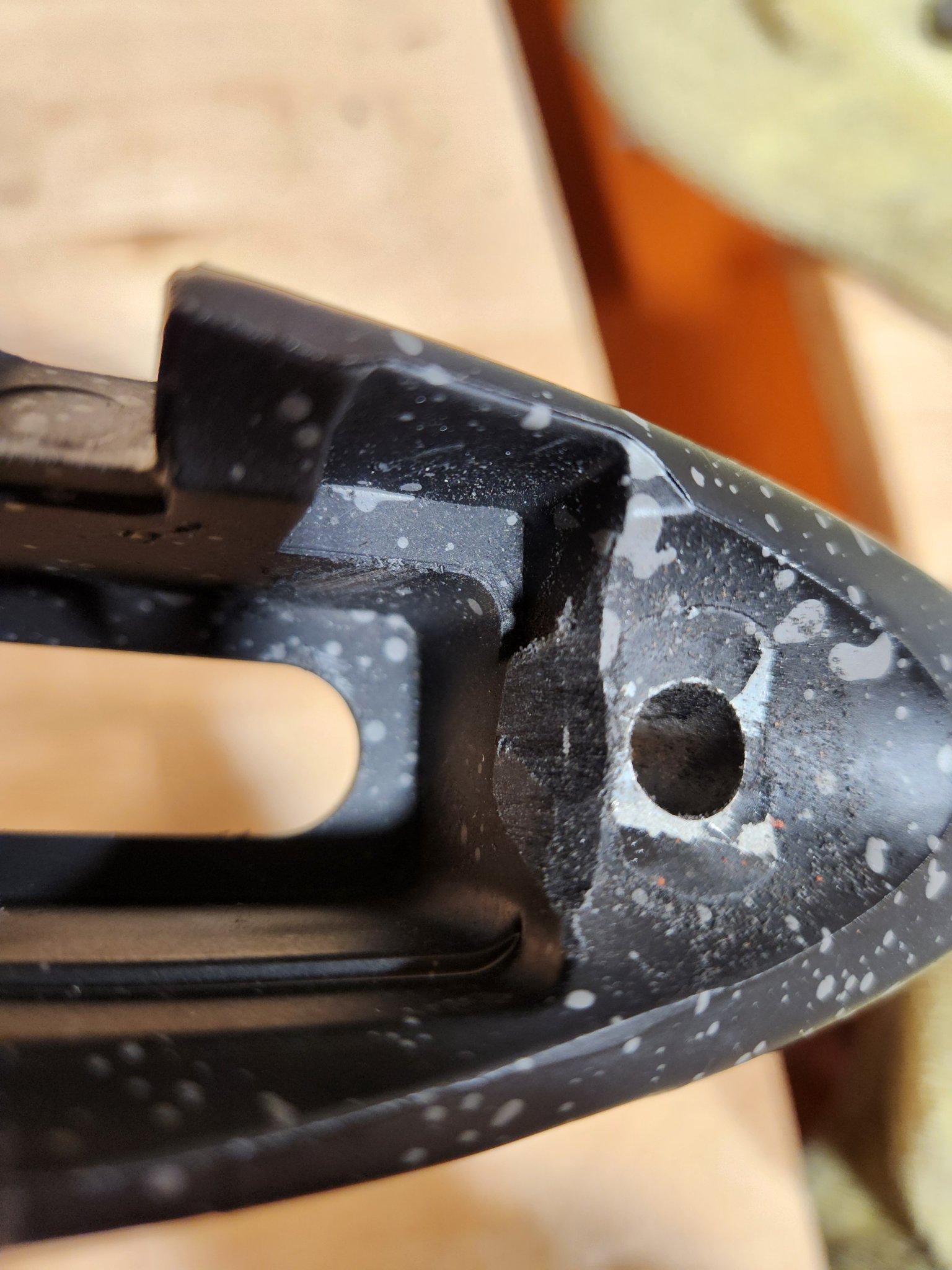

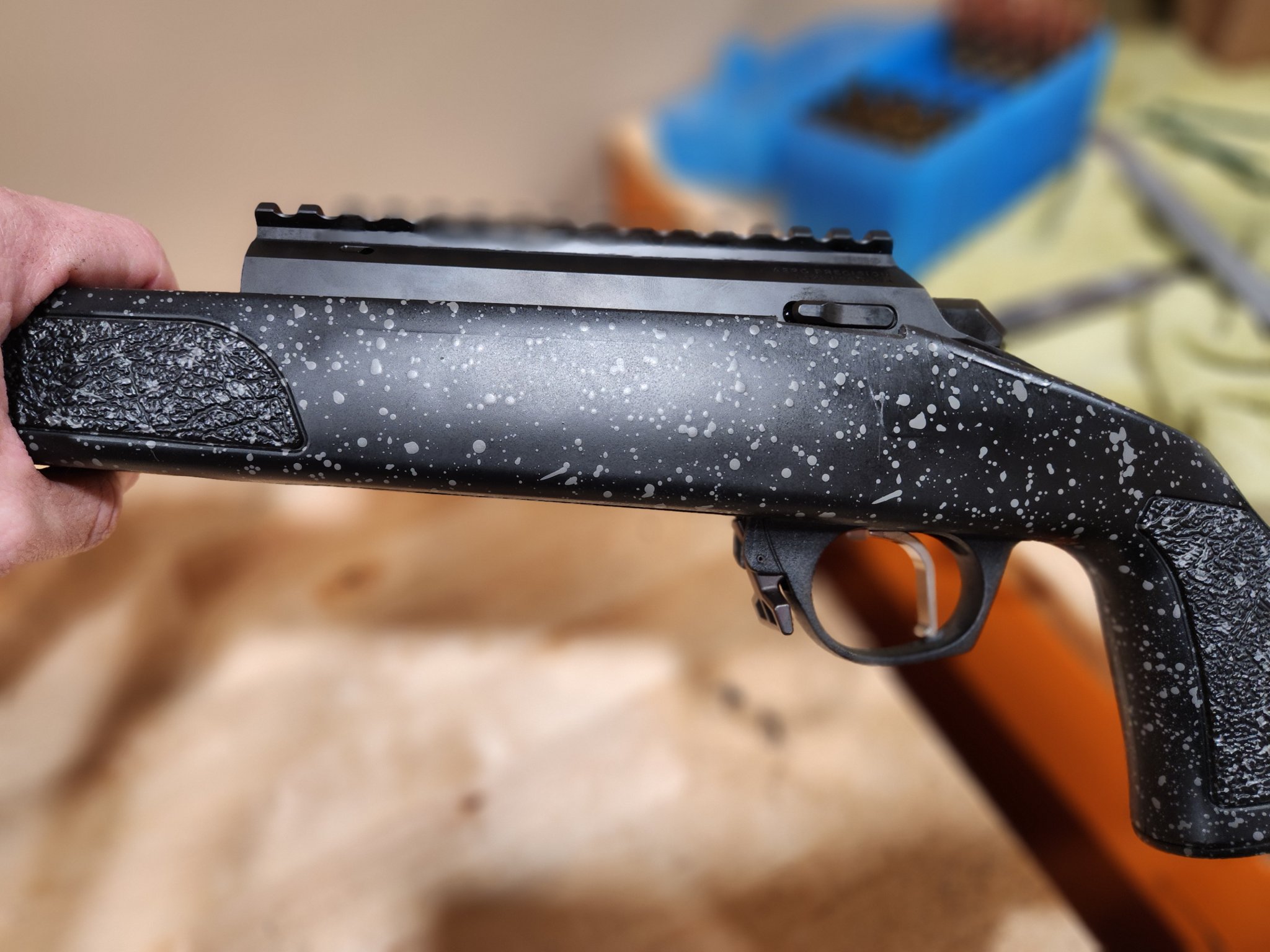

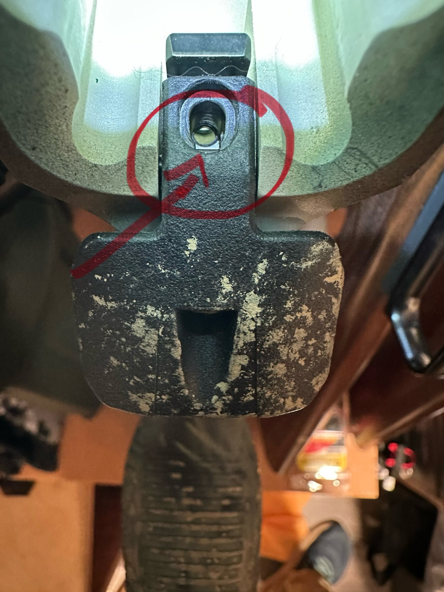

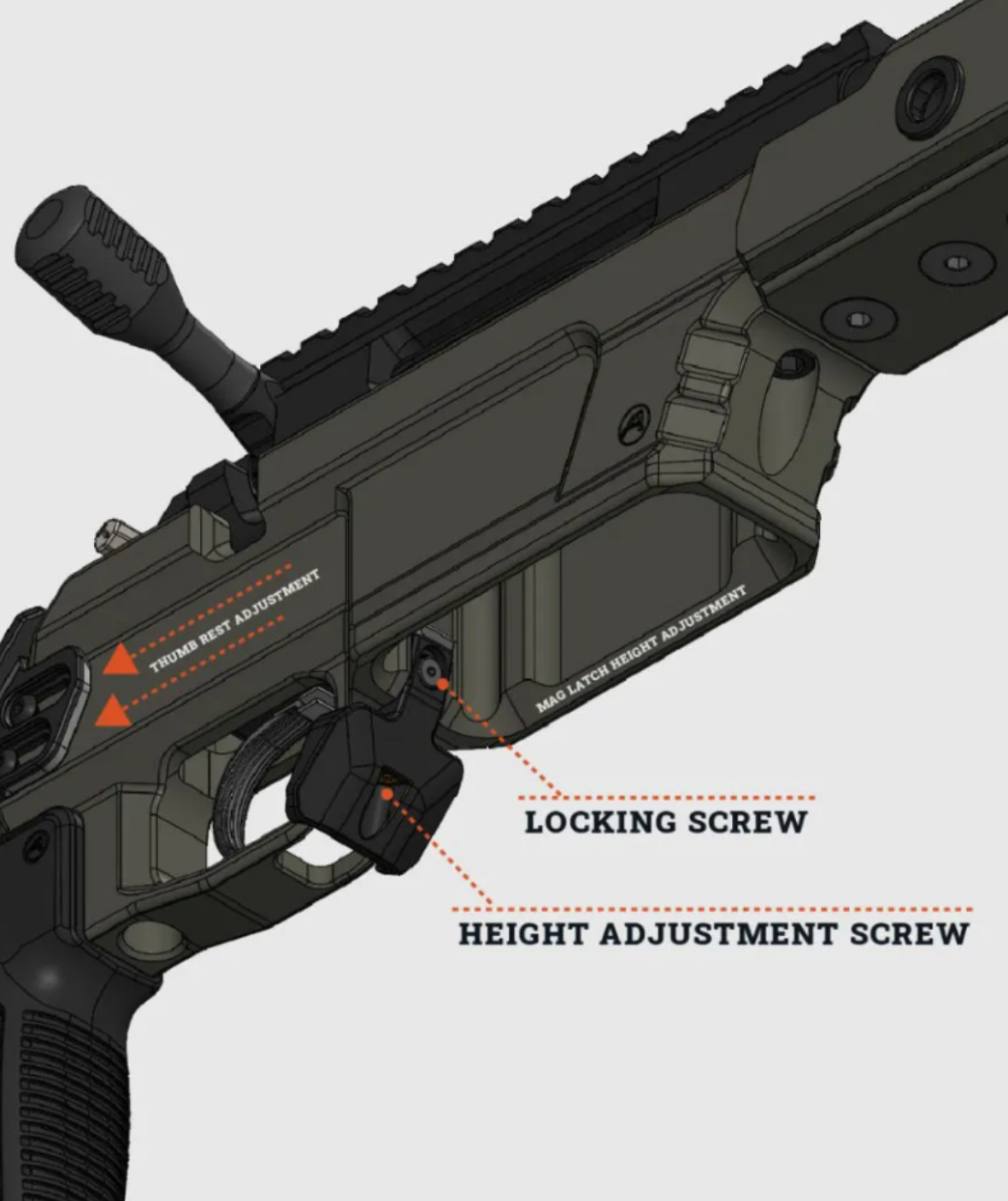

Do any of you all have the Aero Solus chassis and if so could you check something for me? I have a 17” chassis and right at the end of my last shooting session, I started having some difficulties with the Mags not seating quite right. When I got home and was cleaning it, I noticed I might be missing a screw. Look at the picture below. I believe there’s suppose to be a small screw there.
Reactions: FuhQ and KYAggie
Oh God help me. I knew it. Now……how the heck am I supposed to get a hold of Aero for a replacement or the size so I can replace it myself? Their CS, or gross lack there of, has been the subject of a few threads recently. I should probably just send them a hand written letter via snail mail, it would probably be more successful than trying to wait in their qeu line for hours. 😡
Edit: I filled out a tech request form on their website. Let’s see how long it takes for them to get back to me.
Reactions: FuhQ
6-32x3/8”. The standard screw is a light head socket cap. I used a flat head and it also fixed the issue of the screw not having enough friction to hold the catch securely
I'd also put some Loc-Tite or VibraTite on there to ensure it doesn't fall out again. I had this happen on one of mine, except I didn't lose the screw, it just fell out of place, and the mag catch was riding up and down trying to remove the mag and wouldn't let it go. The magazine was stuck in the fucking chassis, at the range, so I had to single-shot the rifle until I could get home. I removed the screw-pin (it screws into one side with a small torx or allen bit, not a friction roll pin), and carefully dropped the whole mag and latch assembly out at once. Then put it all back together, and tossed a little Vibratite on the screw to keep that from happening again. That screw would benefit from being slightly longer shafted, IMO.

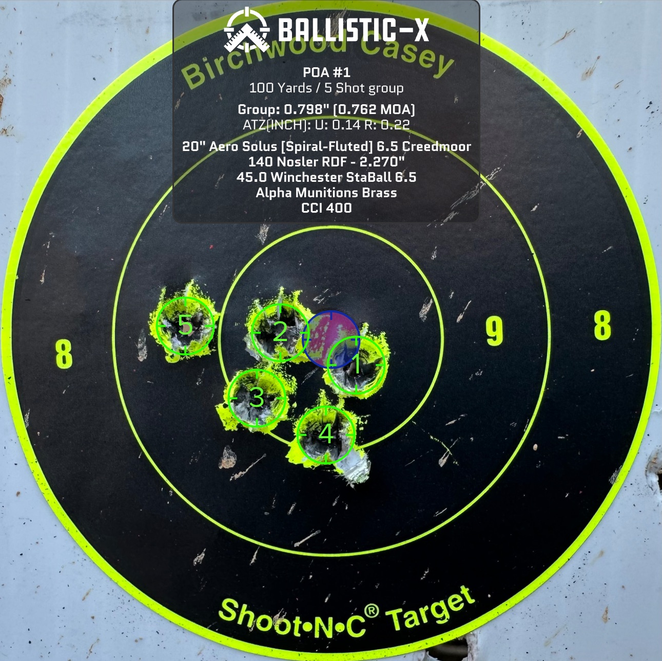

Better conditions yesterday shot the 6creed overrun barrel with H4350, 115gr DTac, Norma brass with Magtech primers. 40.0gr gave single digit SD average 2943fps and printed a nice mostly round 1/2" group with possibly a "flyer"... Good enough and other than the brass and primer it is the exact load data I shoot in my other 6creed.
Test two was 6.5 Staball and 58gr VMAX in large rifle Federal brass. All loads tested were out running the labradar so 3900+ fps. Nothing amazing accuracy wise 5/8" to 3/4" for 3 shots with a couple of charges.

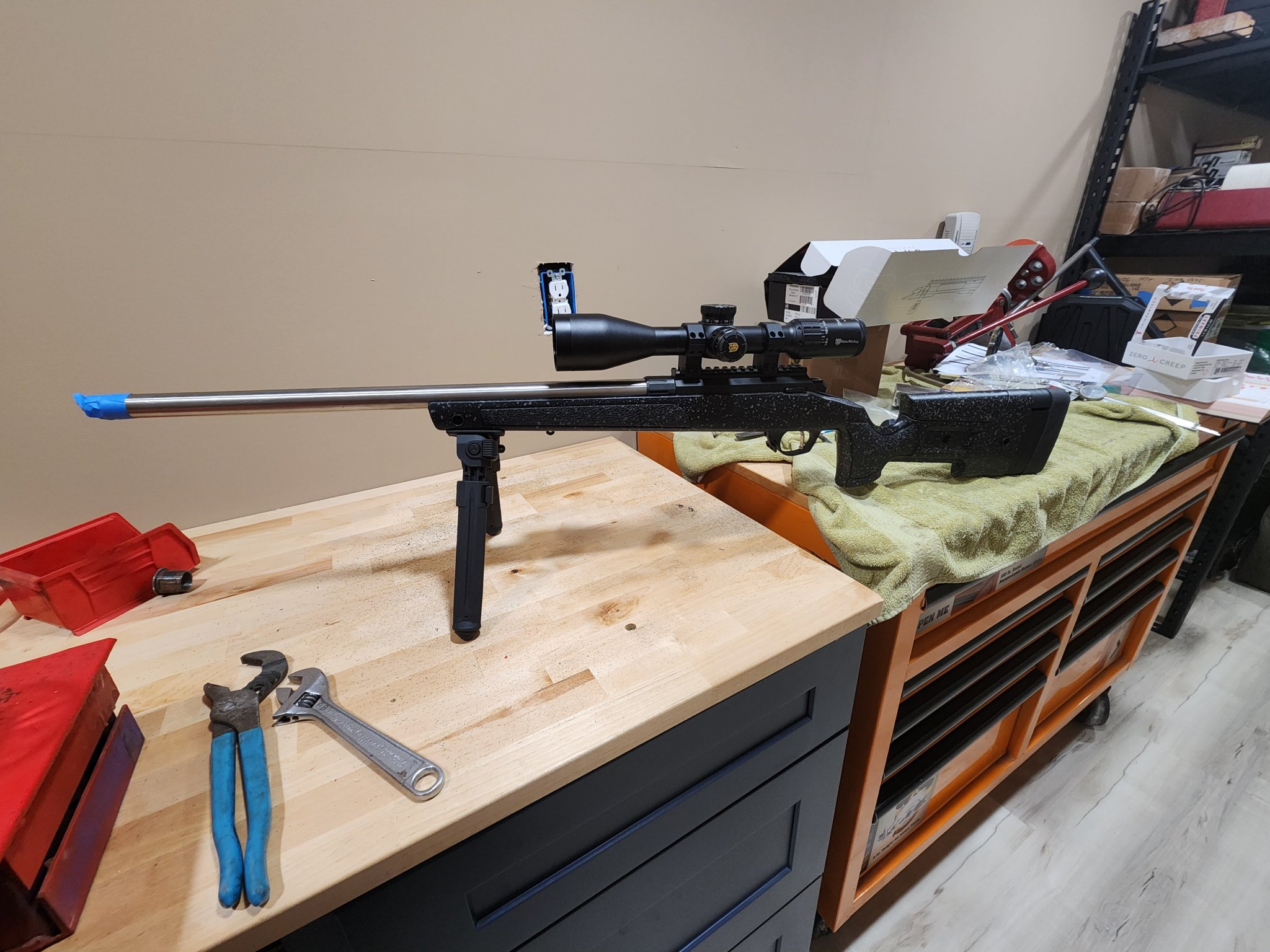

Currently this barrel is on a Bighorn Origin in a Magpul Hunter stock with a Leupold VX3. It's not bedded I don't really want to because I swap it around on different actions.

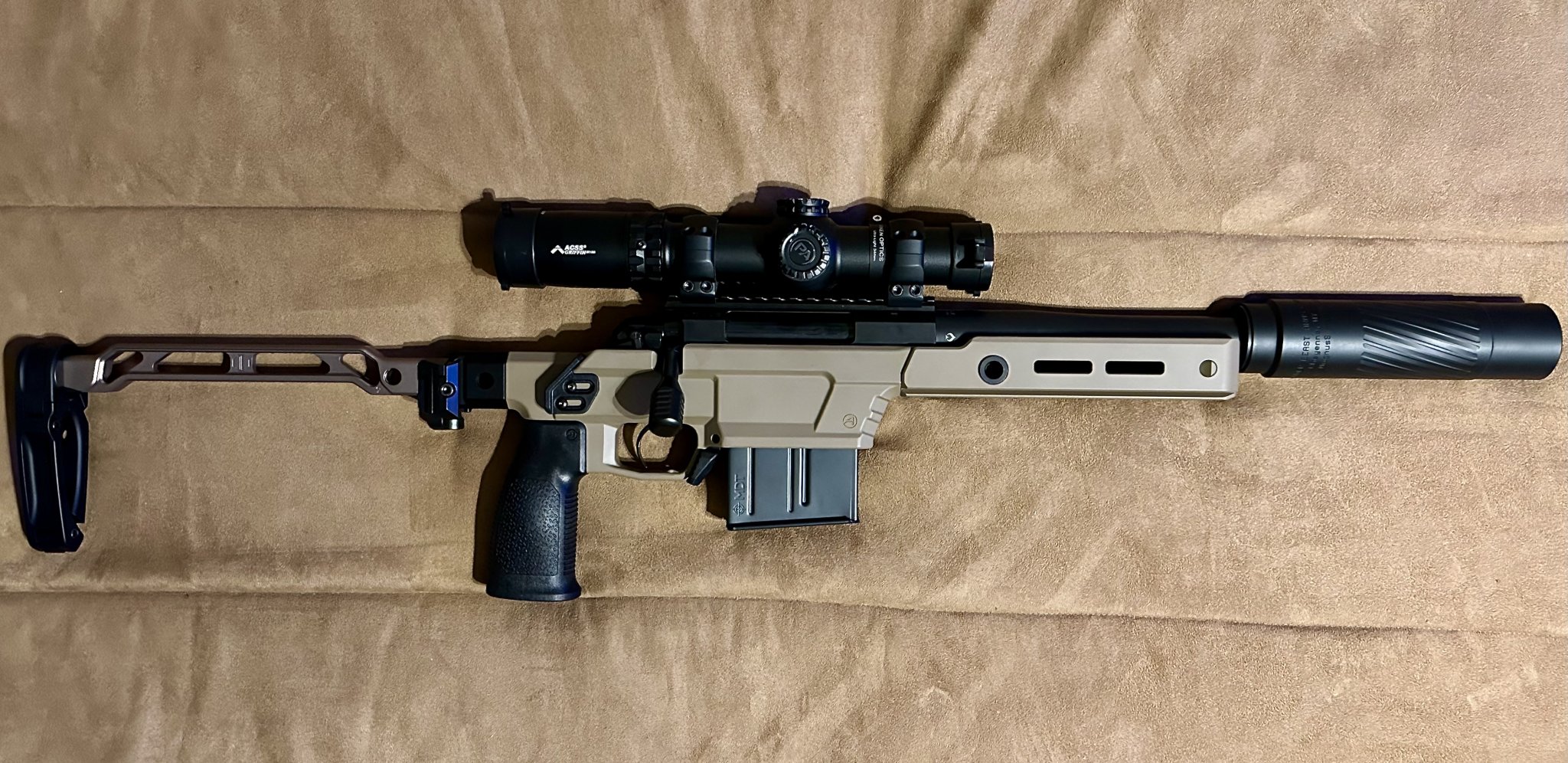

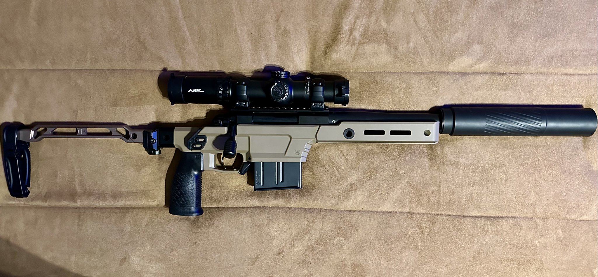

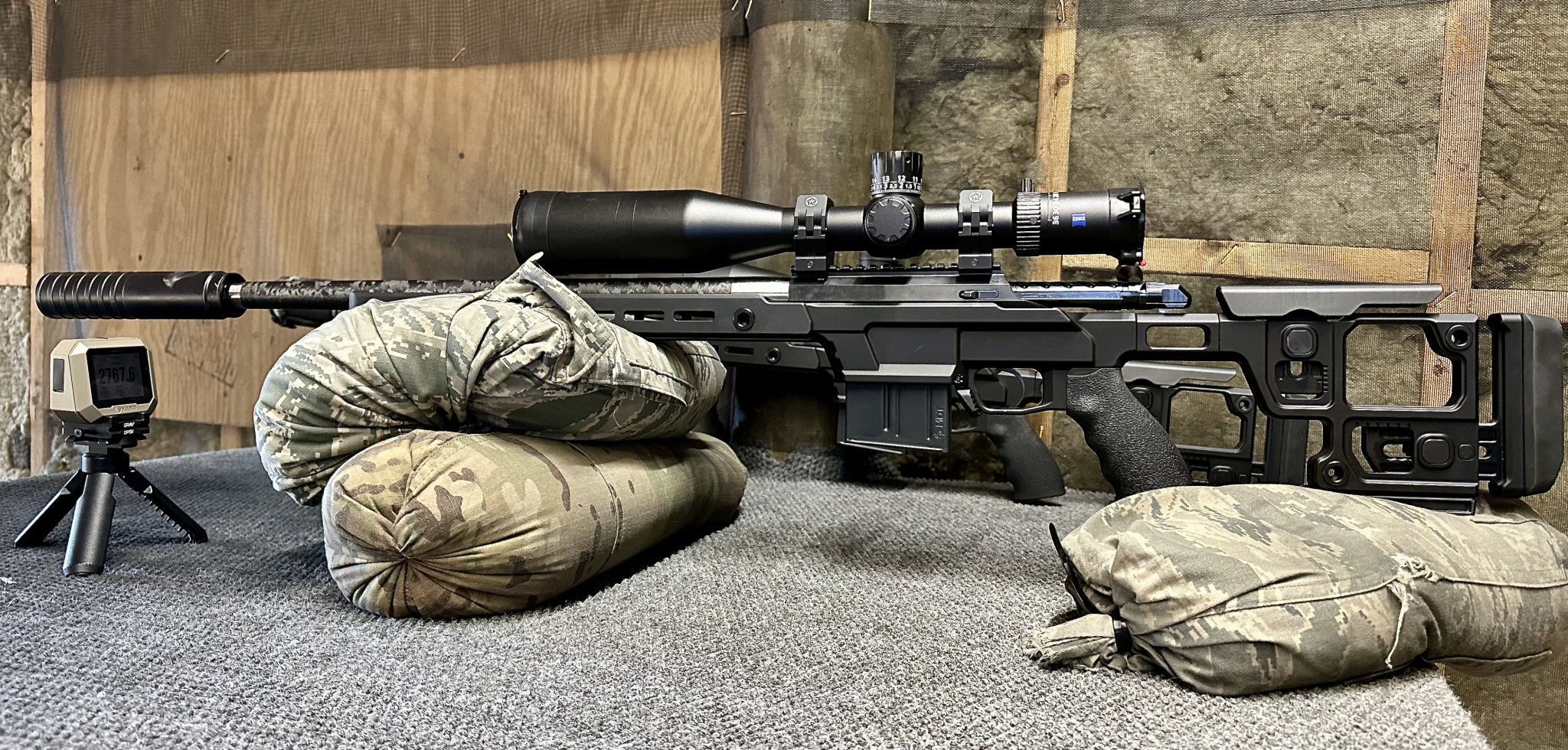

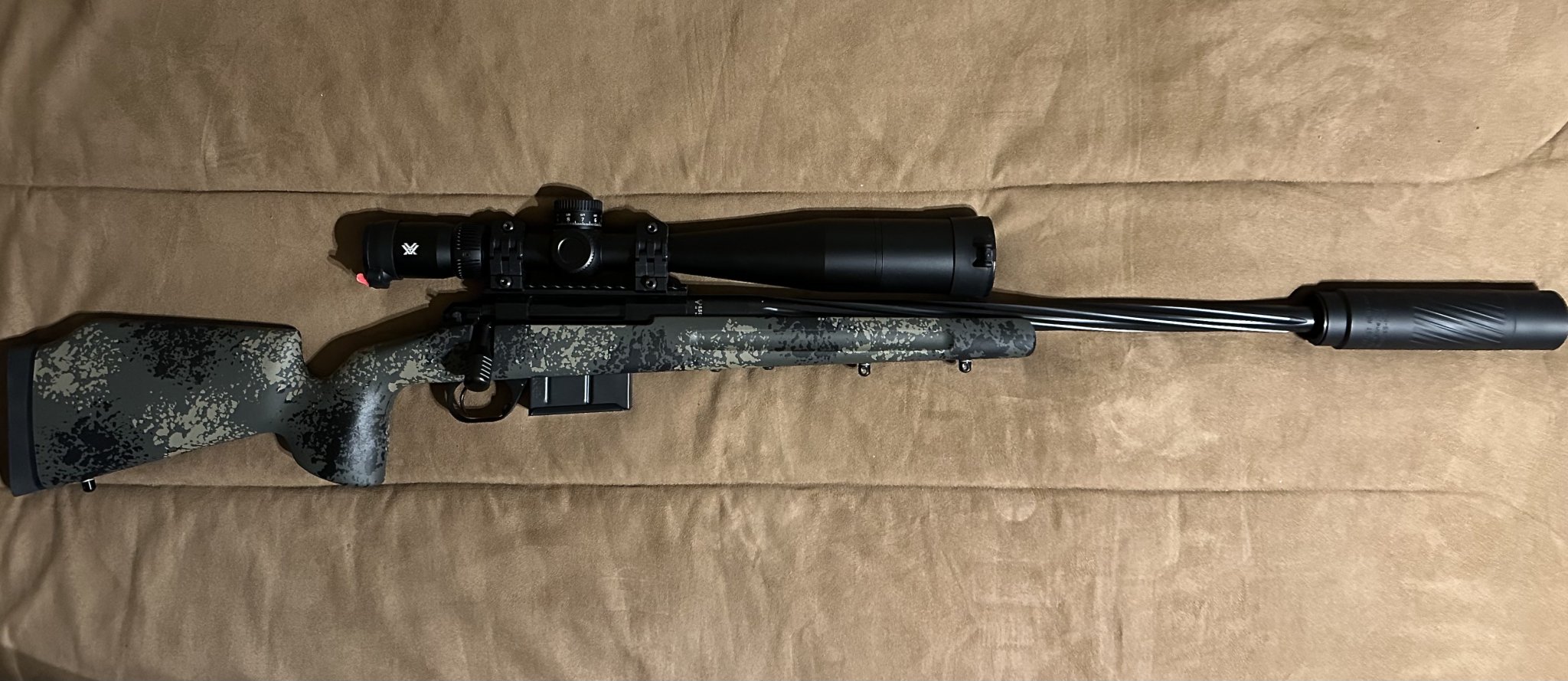

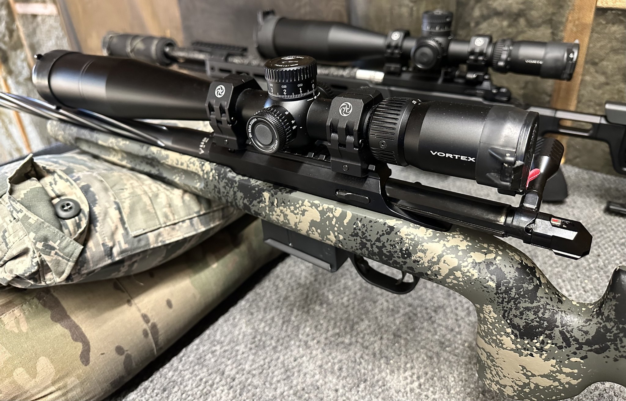

Current configuration with the Aero contract overrun spiral-fluted 20" 6.5CM barrel setup... It's lightweight enough to make into a hunting rifle. It's a full-weight Solus action, TriggerTech Special set @ 1lbs., in a McMillan Game Warden Edge Fill (28 oz) stock, with a Hawkins M5 bottom metal, an MDT 5rd mag (no binder plate), a new Vortex Viper HD 5-25x50 FFP MRAD in ARC M-Brace rings, and my TBAC Magnus-S. This setup weighs about 10 lbs. It's REALLY light.
We'll see how she shoots in this stock tomorrow at the range. Hopefully it's still a 0.3xx" MOA gun, like it was in the chassis.

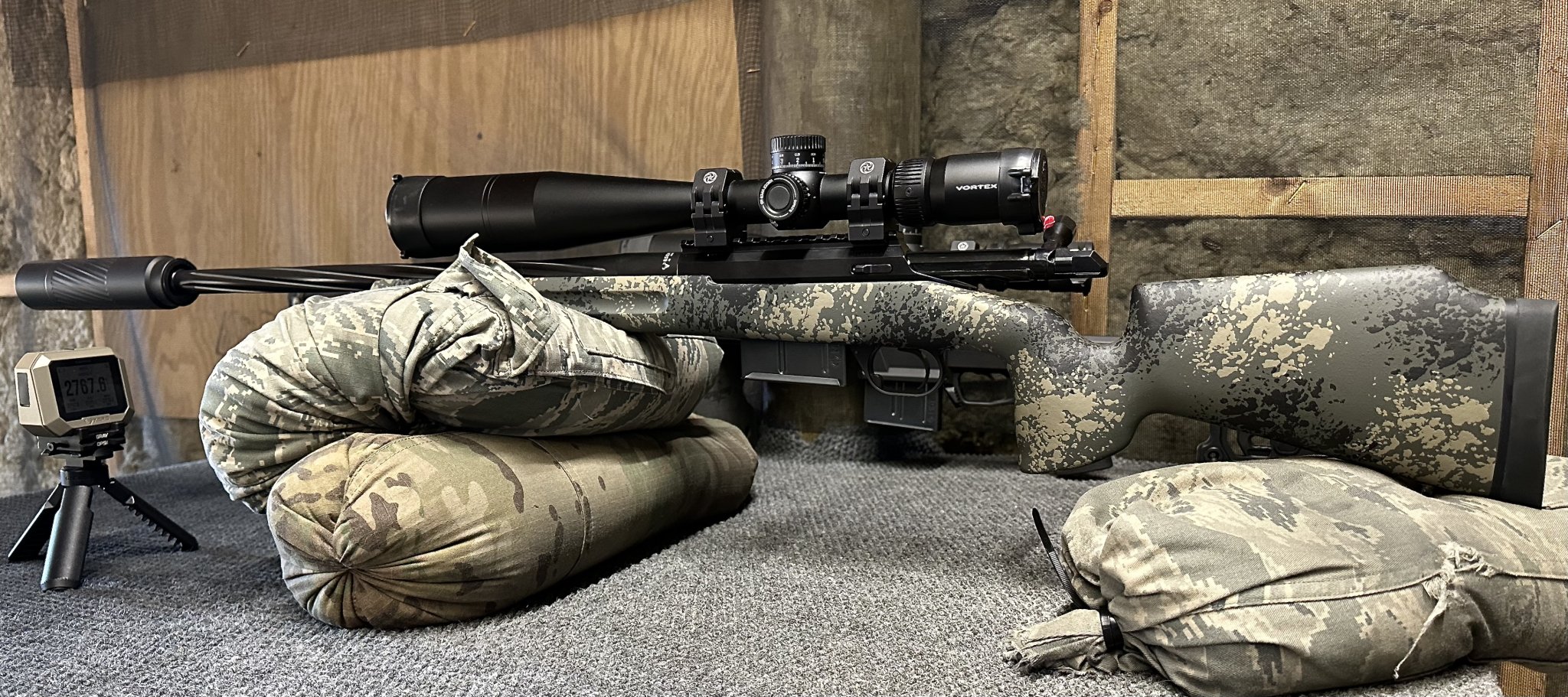

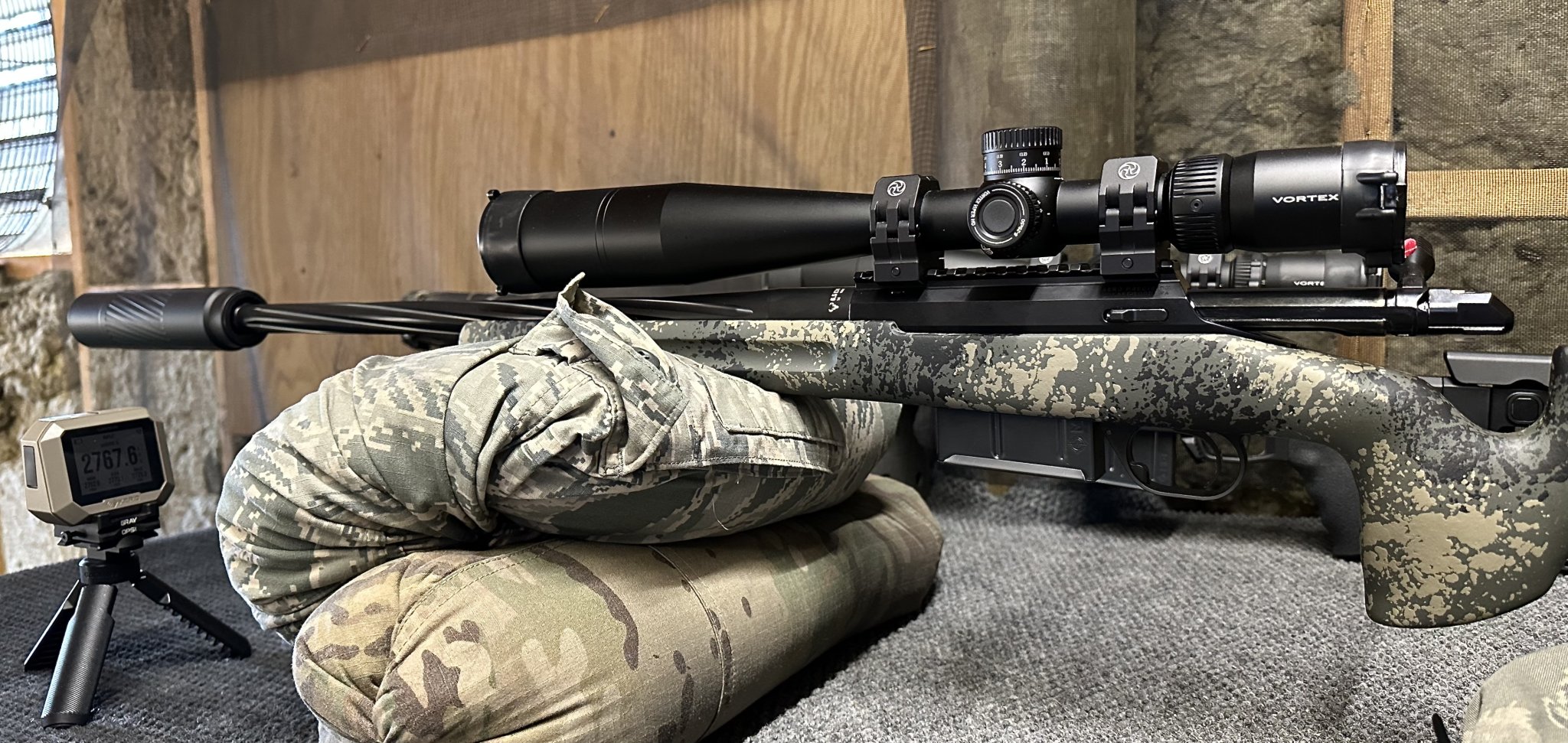

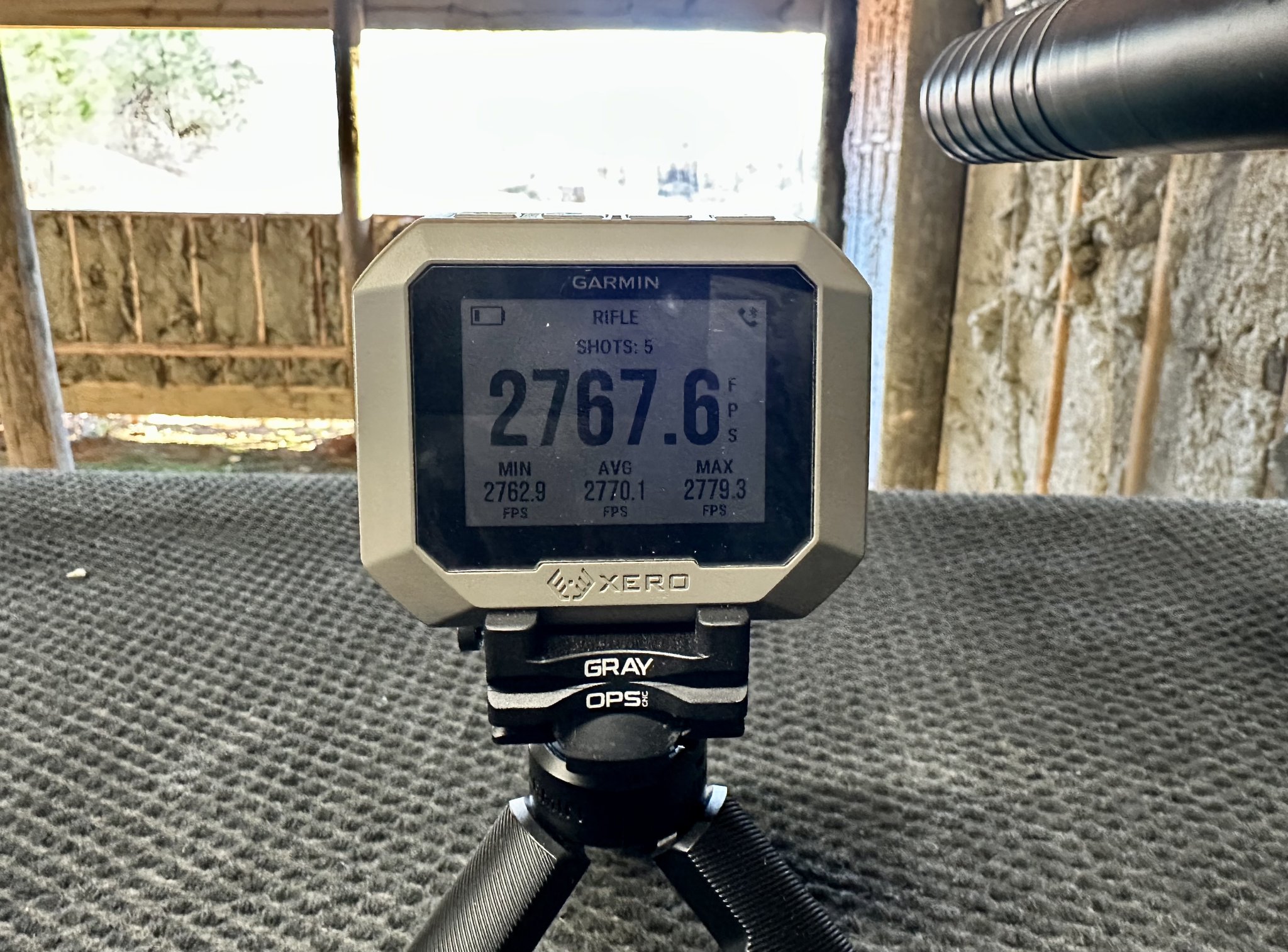

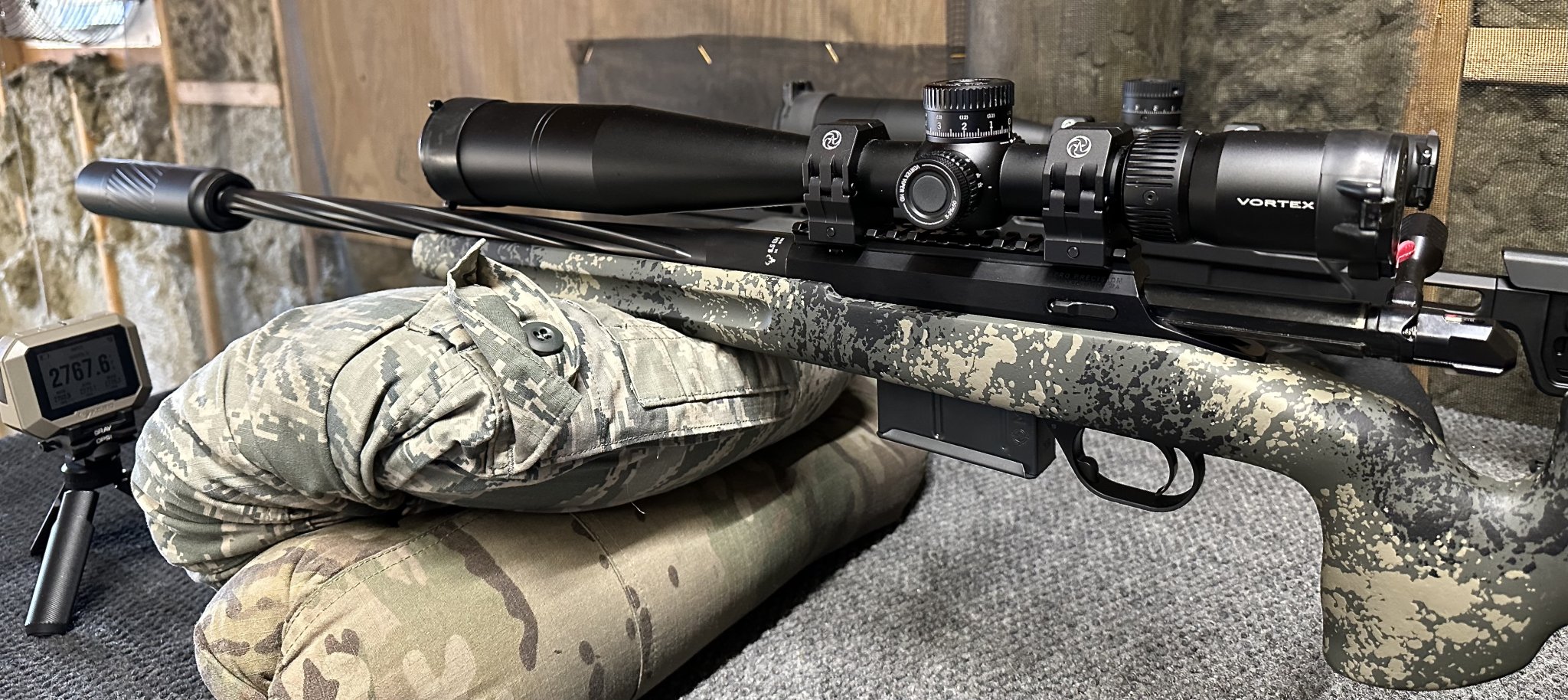

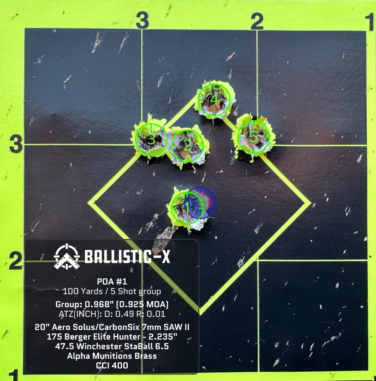

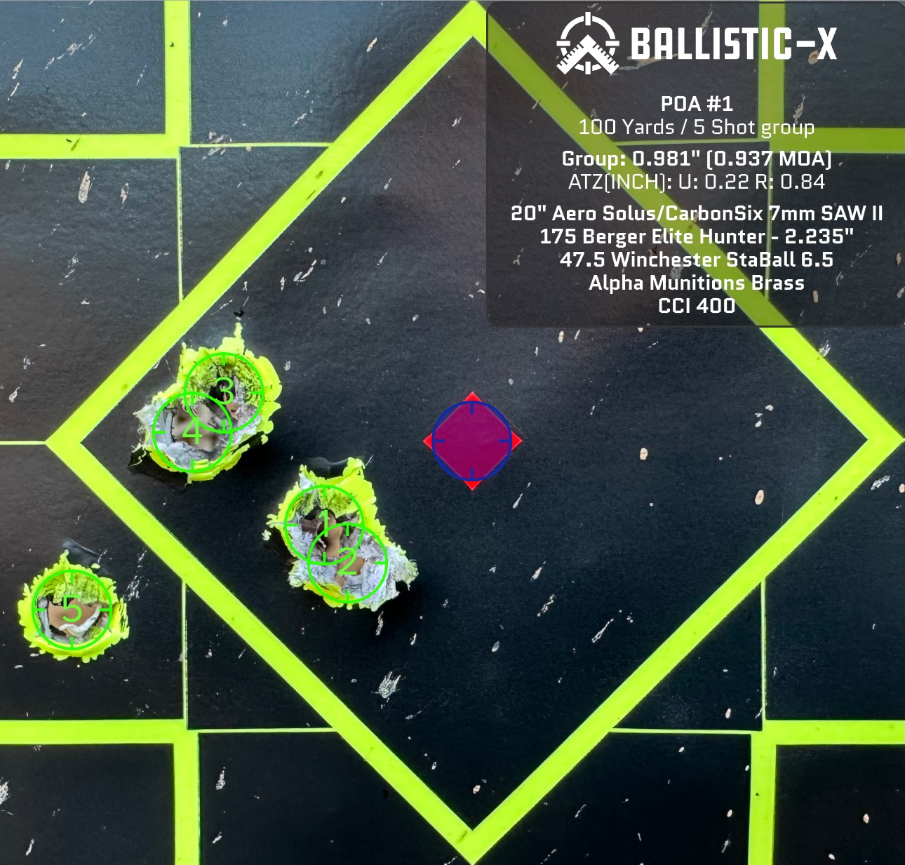

I put the replacement CarbonSix barrel on my Solus Obsidian action, and put it into the chassis, and topped it off with my Zeiss LRP S3 6-36x56 MRAD scope. I'll get pics tomorrow at the range. We're going to see how she shoots now that I got the new barrel in.
Well... The contract overrun barrel shot ok in the stock, I think mostly it was me not being used to the stock... But still pulled off 3/4 MOA with the same loads, and if you pulled the 5th-shot flier out of the group (that was me, not the gun), It would be closer to 0.4xx" to 0.5xx". The fact that it is now about half the weight it was before, and that I dropped down from a big heavy 30x scope to a lightweight 25x scope with a totally different cheek-weld was probably a bit of a hindrance, as well. However, it still smacks the MOA gongs at 300 with 1.1 MILs dope. So, I'm happy for a light-ish hunting rifle. I think things will improve the more I get used to shooting it with this stock and scope and at this light of weight.
This goddamn @CarbonSix barrel is still not shooting great, HOWEVER... I loaded 25 rounds at 47.5gr of StaBall 6.5. Everything the same on all the loads. And that barrel sped up 100 FPS over the span of that first 25 rounds! It started out right at 2,660 FPS, and ended up at 2,768. I've never seen one speed up that fast to that level. And the more I shot it, the better the ES/SD numbers got, so it's definitely breaking-in very fast. I got back home and did my initial check where I check torque on everything on the guns, and the rear (tang) action screw gave a pop and then torqued on up to 65, as I expected it to. So, I'm expecting that to help groups next go around, as well as the break-in. And while watching the chrono while shooting each shot in the groups, the barrel was speeding up a few FPS every damn shot, since it was speeding up so drastically, I think that was why the groups might have been a bit random. Once it finally settles, I'm hoping for better groups. It's showing better groups than the old barrel, but I'm still not impressed at all... Time will tell...As will the targets.

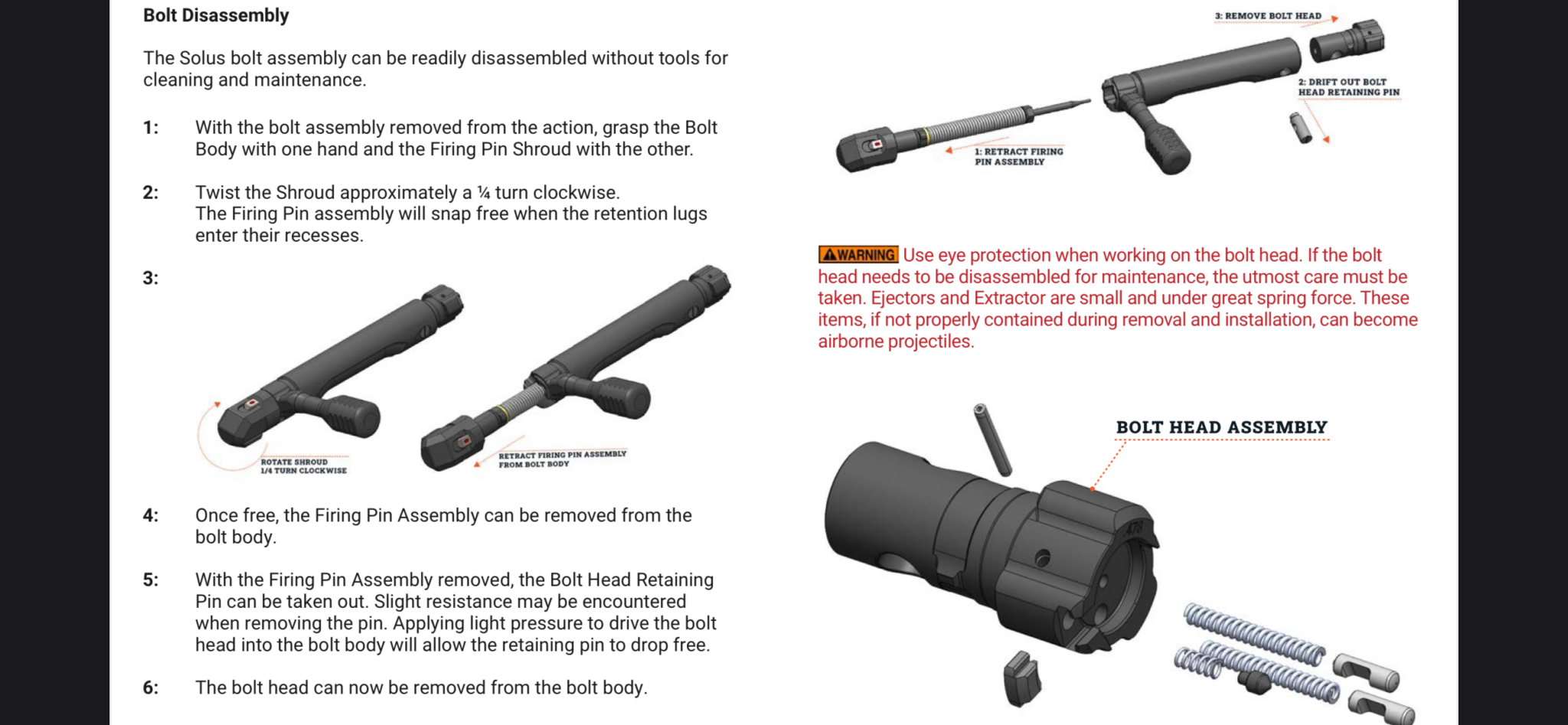

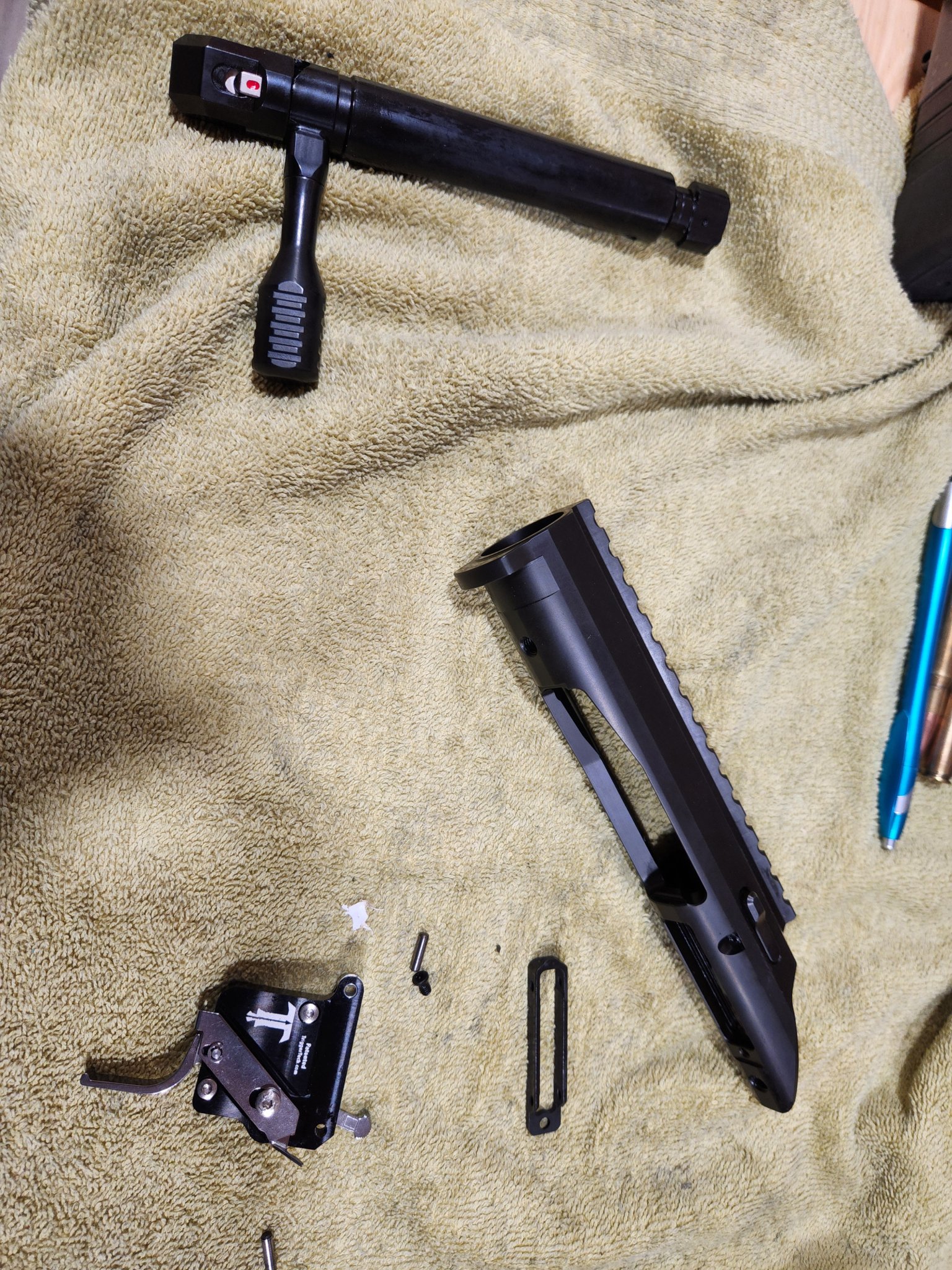

So... can you actually remove the dual ejectors to check headspace / seating depth with a stripped bolt?
You can, but it's not necessary to remove the ejectors. I've checked headspace on them with a stripped bolt, and with the FP in place. Same result, as long as you have a trigger installed...Becaue you install the trigger, put it on safe, and it holds the FP back anyway.
Finally going to the range tomorrow, life got in the way the last couple days. But, got everything scrubbed clean, and ready to go for the .300 BLK and the 7mm SAW. I scrubbed the shit out of the SAW barrel, and it was absolutely filthy after only 25 rounds of break-in last week. It was all gray, too, so I'm guessing that was ultra-fine metal from the barrel breaking-in, since it sped-up over 100 FPS in just that 25 rounds. I have a ladder test loaded up for it, from 46.0 to 48.0 grains of StaBall 6.5, and we'll see how she shoots. Barrel is absolutely spotless now. Patches were coming out 95% clean.
You get the same level of 'feel' with the FP and ejectors in and the safety on, as you do with a completely stripped bolt?
If you have both a go & a no-go gauge, the only important feel you'll notice is that the Go gauge closes fine, and the No-Go stops you right as you start to cam the bolt over to close it, and it won't let you push the handle down...
If you'd feel more comfortable just pop the firing pin out real quick and leave the ejectors in and do it that way.
What all is involved in removing the ejectors, though?
Elsewhere, someone (possibly with ties to Aero) claimed that you won't be able to get them back in. That seems like a kind of odd design, where the end-user can't remove the ejectors for cleaning, maintenance... or checking headspace / seating depth. For what I want to do, the spring pressure of the ejectors would interfere and mask the feel.
Reactions: Huskydriver
You can easily fully strip the bolt and put it back together:
Reactions: memilanuk
Oh, if you know what you're doing, you can remove them, but you don't want to do all that shit. Small parts can go flying, and good luck getting spare parts from Aero right now. I don't think you want to have an inoperable gun for a while, do you? Because you can't get those parts from anyone else, should you lose one.
Maintenance of ejector springs is maybe a once in a lifetime situation, unless you shoot 10K+ rounds a year.
I have checked HS on all my Aero Solus rifles with full bolt heads, and both with and without a firing pin installed, and all have checked-out just fine. As long as you have a Go and No-Go, then it won't matter. I think you're listening to too much Reddit and YouTubers.
What specifically are you trying to do that the feel is needed that badly? Are you trying to just get away with using a Go gauge and a piece of scotch tape? If so, please, do yourself a favor and just buy a proper No-Go gauge and have a set...They're not THAT expensive. At some point, all the headache and labor isn't worth saving the extra $50 for a No-Go gauge.
I'm not talking about checking headspace in terms of go/no-go gauges, I'm talking in terms of finding the minimum amount of shoulder bump to allow the *completely stripped* bolt to fall freely on a sized case. And after that, finding the exact seating depth to the lands - which needs said sized case. Aka, the "Wheeler method".
I'm pretty proficient at it; been doing it for years on my competition guns. With most actions, it takes a few minutes to remove the FP assembly and tap out the retaining pin for the ejector plunger. Not a big deal. Not sure why Aero people are so averse to the whole process.
I have removed and reinstalled the ejectors on my .478 bolt head to measure shoulder bump.
It's a simple process and not difficult to do at all.
Punch the roll pin out that holds the ejectors in while making sure you have something to "catch" the ejector just in case it wants to spring out.
To put it back together, do the reverse. I used a glock tool to depress each ejector and installed them one at a time.
