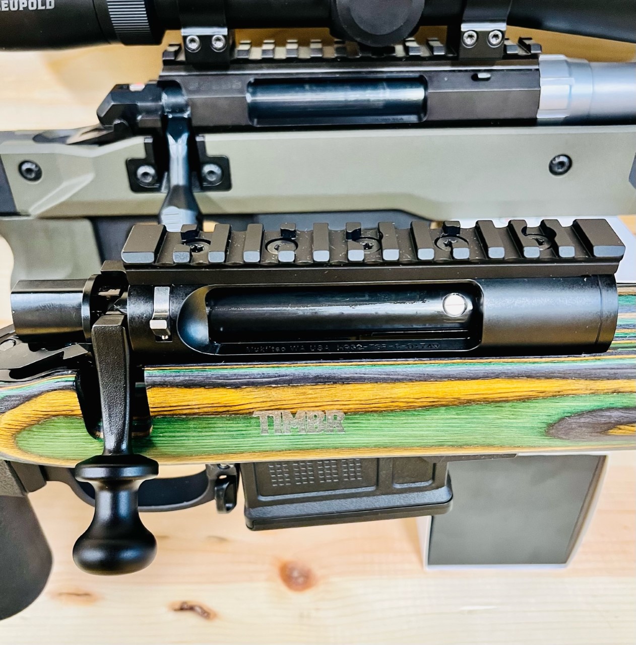

Head to head comparisons: My opinion matters a lot and I will b taking donations for my trouble on the following "scholarly article" immense with objective & scientific methods of review and reporting...
Both these actions are new, unfired. Both tested straight from box, and then after a whole bunch of cycles. The Aero has significantly less bolt lift force. The bolt on both ride smooth. The Nucleus large bolt knob, however, gives a mechanical advantage to make the heavier bolt lift manageable. Grabbing and cycling the bolts like you mean it makes this comparison a bit moot point. They both get'er done.
SOLUS has a better applied finish and dimensionally sleeker. Although the rear tang of the Nucleus tapers out thinner and fits the drop in stocks with smoother appearance. The SOLUS a bit proud and clunky back there in the rear tang. The SOLUS is at home in the KRG and Magpul Pro stocks. The Nucleus too, but also sits better in the MDT TIMBR. The SOLUS looked like Lego baked clunky dog shit.
I really do dig the big "fuck off" features on the Nucleus. :d The bolt handle size and design just make me smile. The CRF action, if it works by design, is an added nice feature. My professional opinion is this: Go buy this shit for yourself, try them, test them, keep what you like and just keep doing this until you die. And remember. Live free or Die trying!

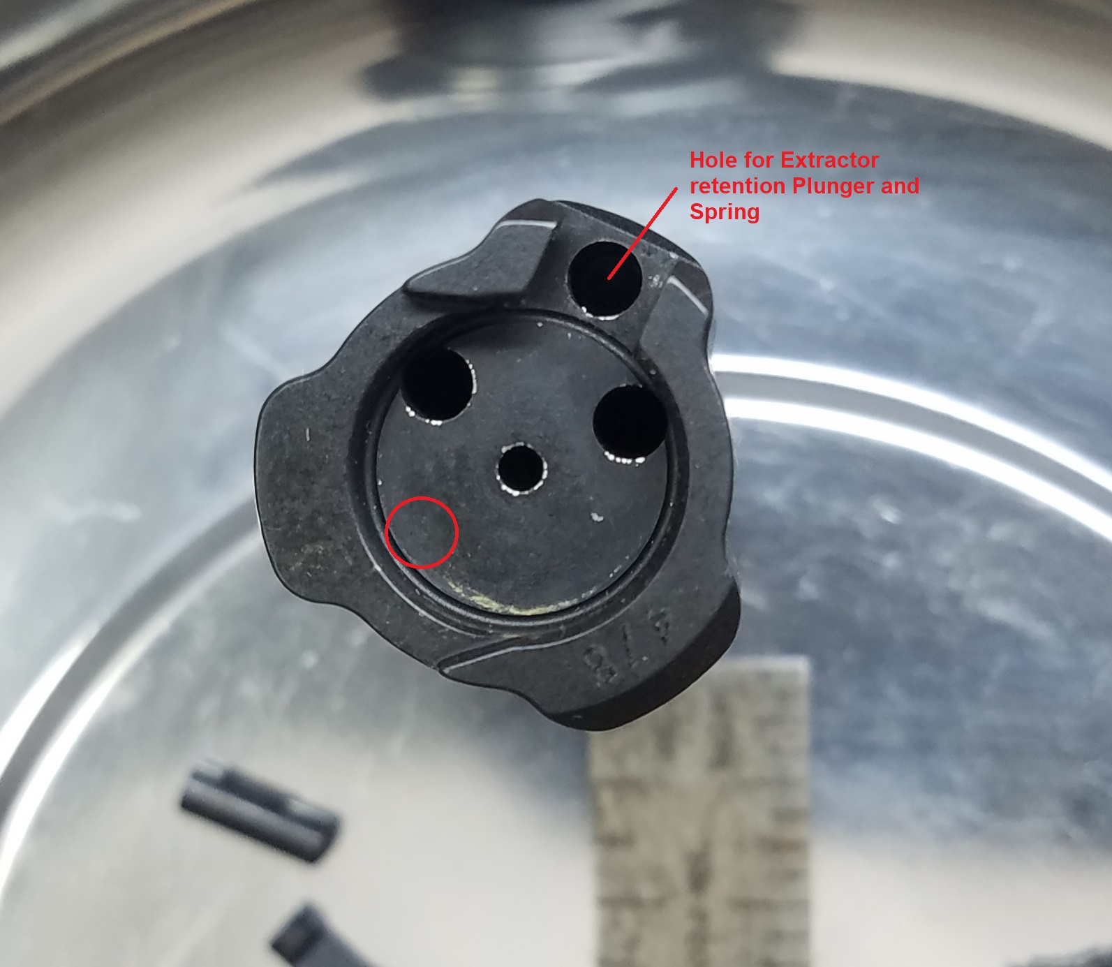

I received one of these and finally made time to look it over.
I figured I would send some of the bolt parts off for IonBond with a large batch of other parts already going and then barrel it up for a class loaner rifle to see how it holds up.

Cons:

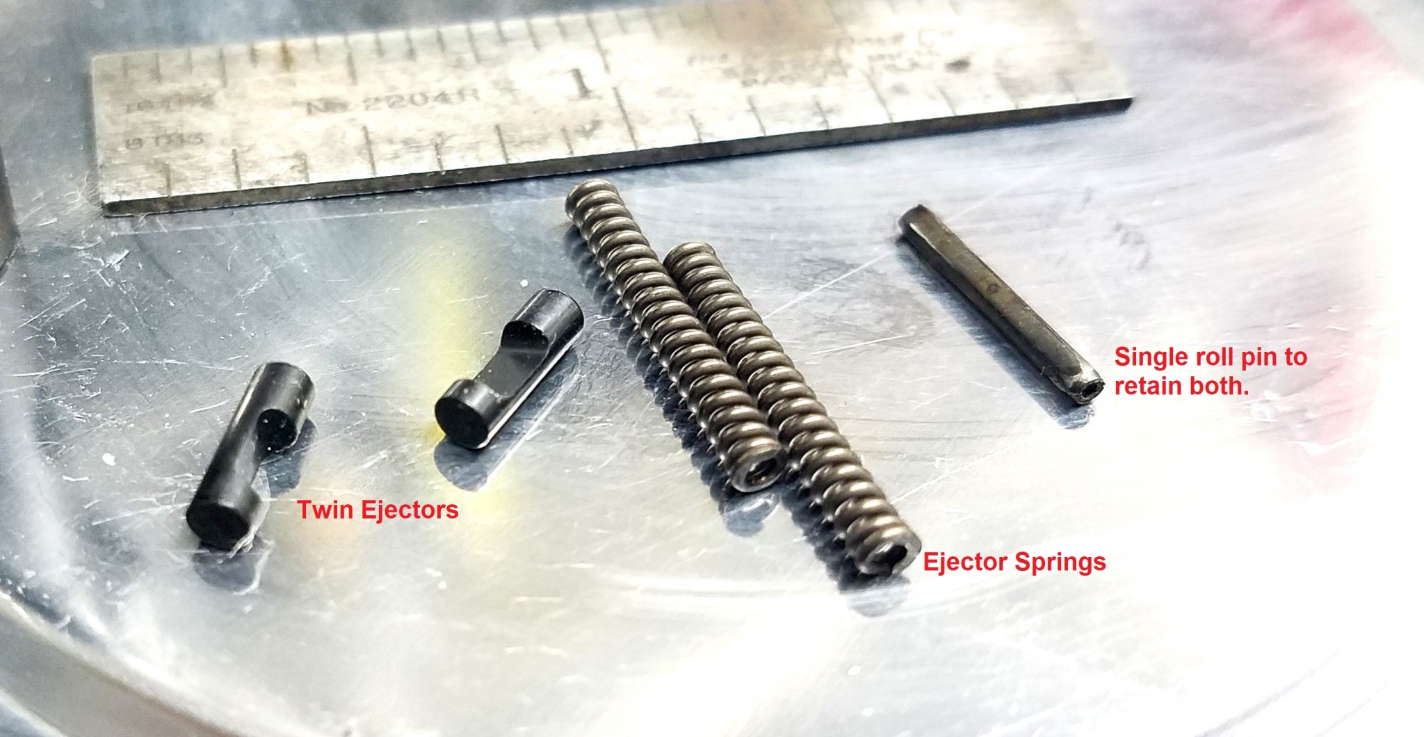

The bolt head has 2 ejectors. Both are too close to the extractor.
Both are too short to operate smoothly in their host holes under repeated load. Both have springs that are too short to allow smooth movement across the ejector’s travel.
Simply moving their location to the other side of the breech face would double the amount of leverage they could provide in relation to the pivot point of the extractor.
Both ejectors have no chamfer at the rear face which when combined with their short length and no center spring guide feature allows the ejectors to try to twist and bite in their respective holes.
The existing bolt head has ample room and material available to change the ejector position, go to a larger diameter/ deeper depth hole that would allow a Rem700’ish ejector with spring guide feature and longer spring. Even a single ejector with such a proven design and location would far outperform their current double ejector design.

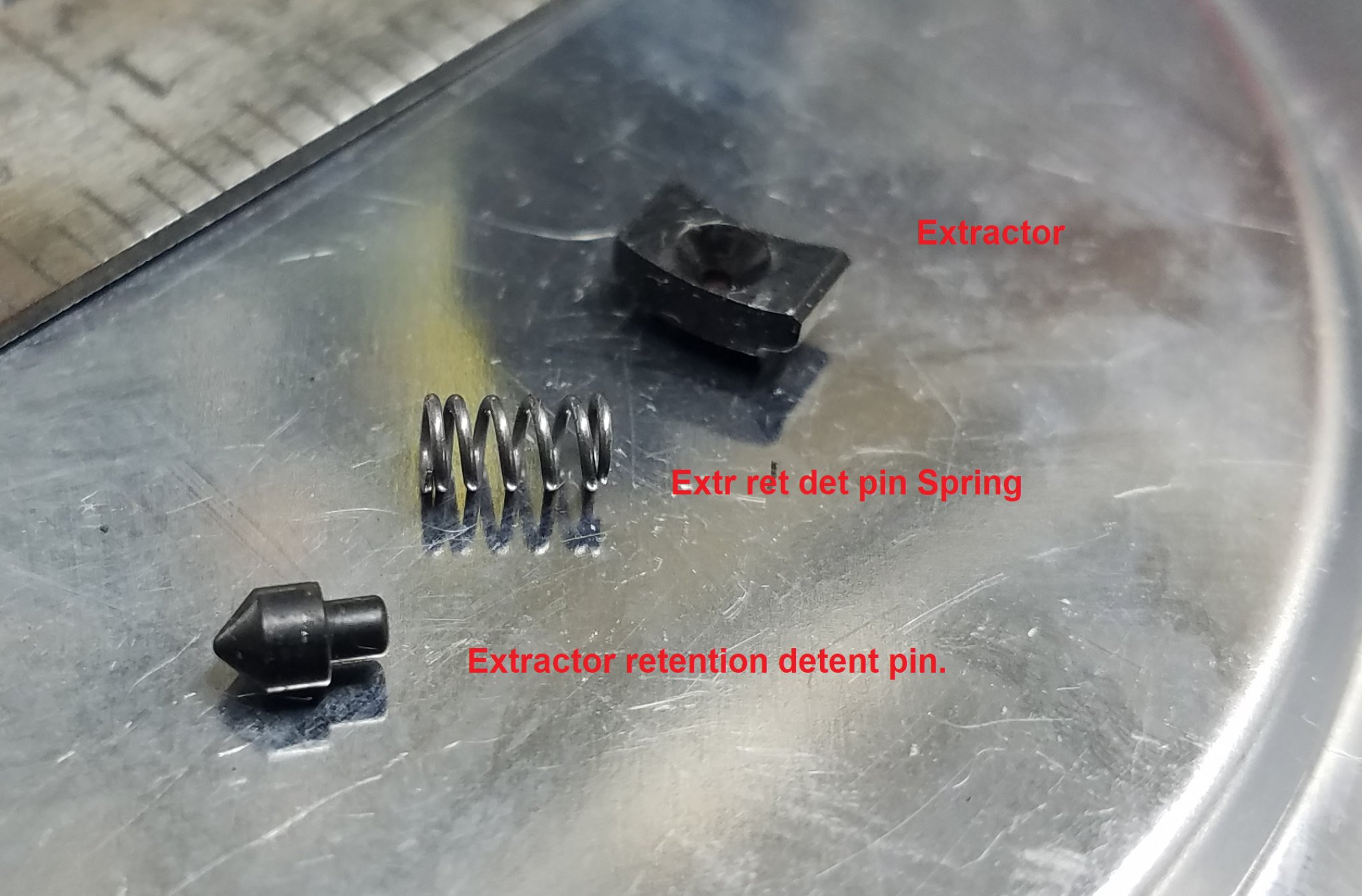

The Extractor is small and is not smooth in its movement. I believe the spring needs to be longer and the host hole deeper for a smoother function within the load range it will live at.

I'm not sure I follow. Moving the ejectors away from the extractor would reduce the leverage and as such the force of ejection.
Cons:

Moving the ejectors to the side farther from the extractor will provide more mechanical leverage for the ejector (making it easier for the ejector to push the case) think of a pry bar with the case head being the bar and the extractor being the pry location and ejector your hand pushing.
The dual ejectors close to the extractor is interesting, I don’t think I have seen that before. Could help with the short cases like the BR’s.
