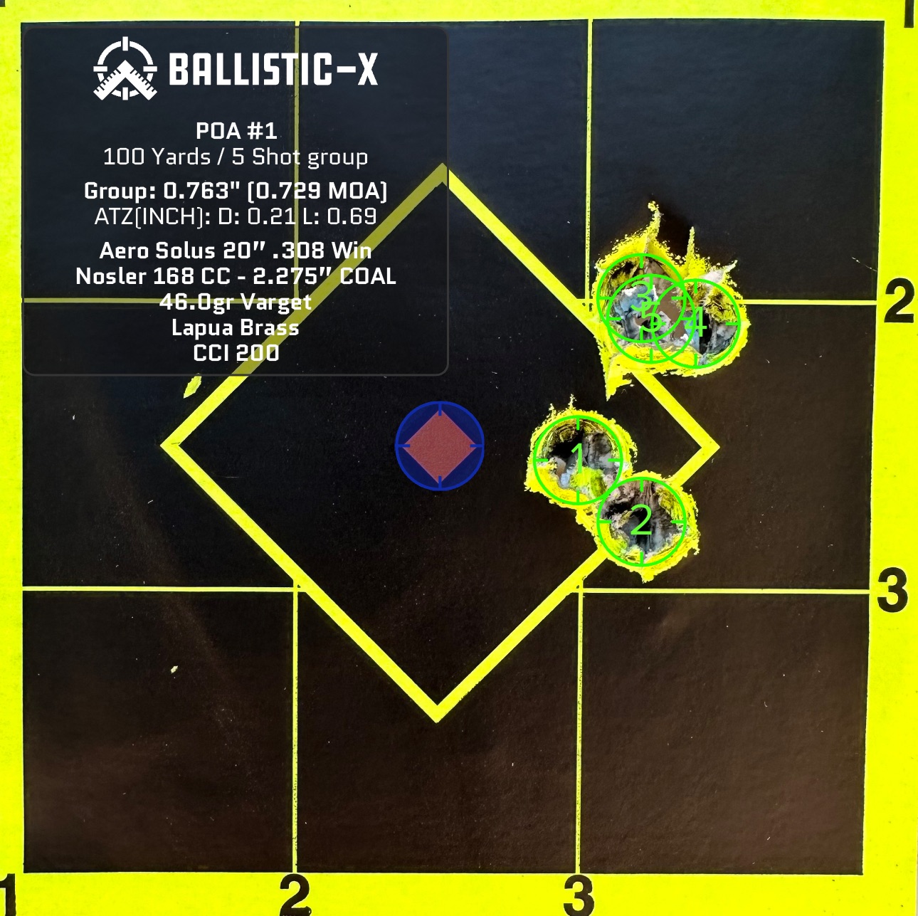

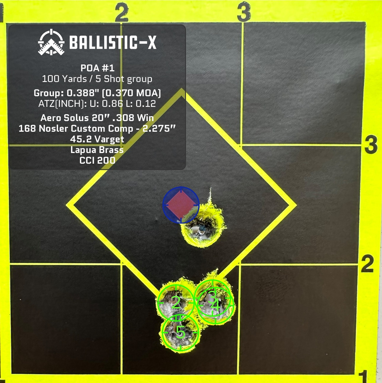

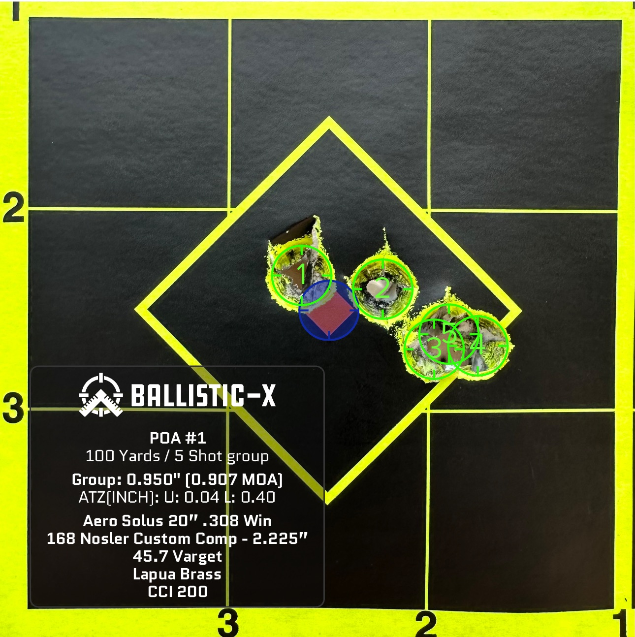

Quick range session today yielded some less than stellar results... I think this factory barrel might just be shit... Because it always has a damn flier in EVERY group. Otherwise, the groups would be amazing.
Best groups of the day... If you pulled the fliers from the groups, then they would be sub-1/2 MOA. 🤦🏼

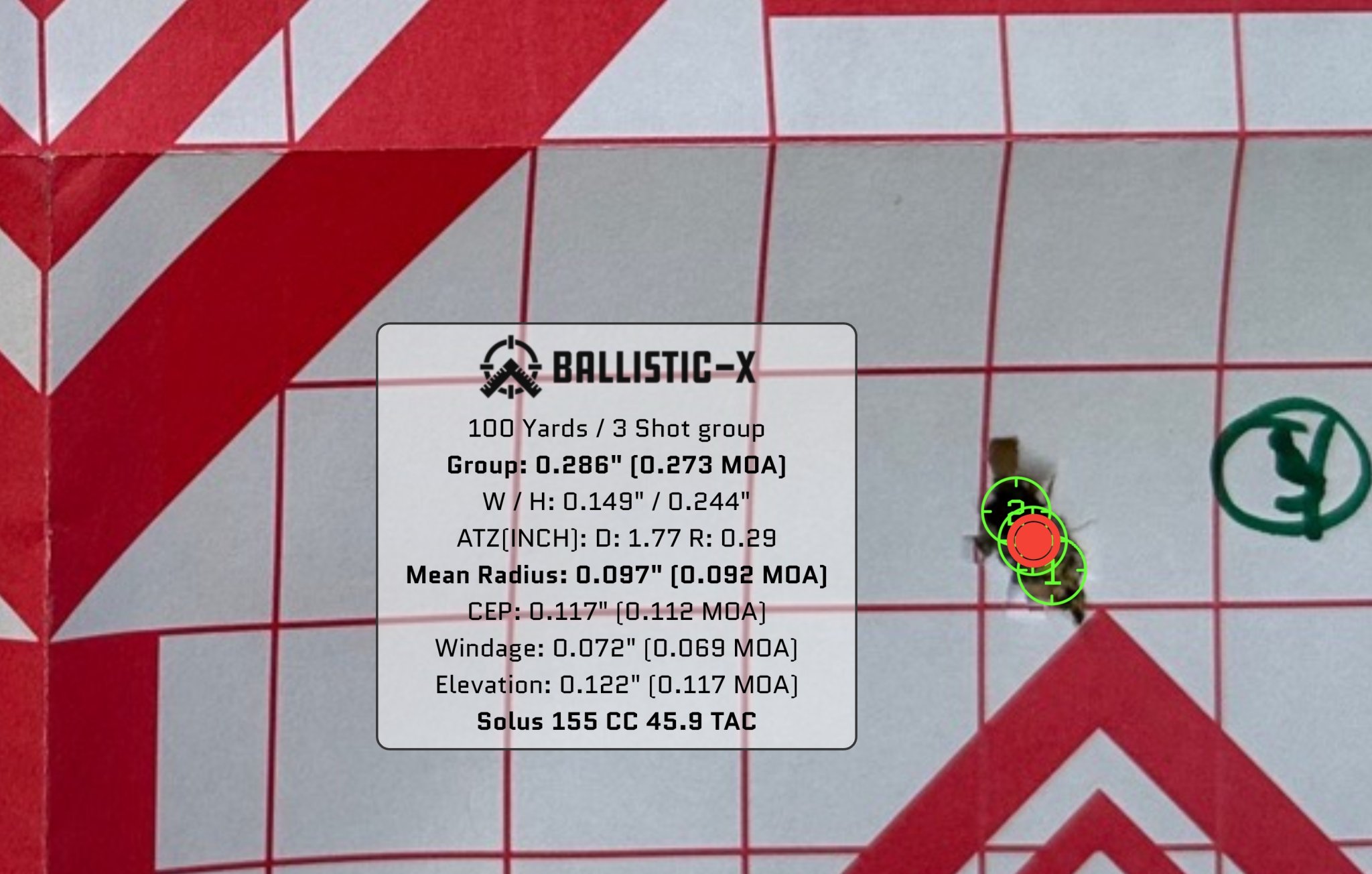

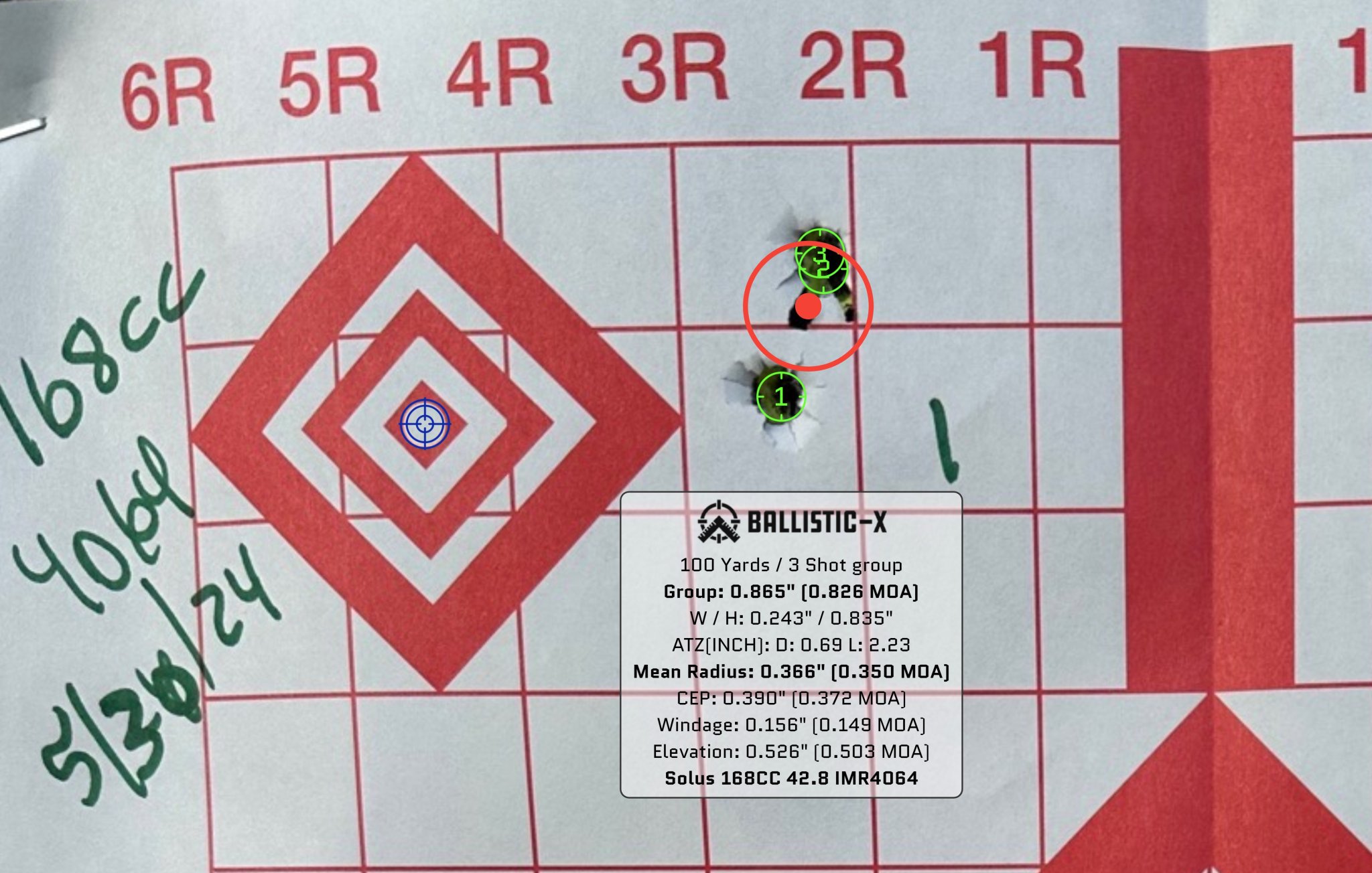

Is it always on the first shot? Those groups look similar to mine with 168 CC’s; I was using IMR4064. They also look like my test groups with a 140RDF in my 6.5 CM. It’s maddening. At least I know my 6.5 will produce 1/2 MOA or less with a 123 CC; I’ve just begun experimenting with the 308, it’s a Solus with a 20” PVA “Wilson” barrel. It seems to like 155 CC’s better so far. I’ll be trying 175’s in it too.
168 Nosler CC
Ballistic-X-Export-2024-06-05 20:48:48.258593.jpg
155 Nosler CC with TAC
Ballistic-X-Export-2024-06-05 20:37:17.661320.jpg
Mostly on the first shot. Shot #1 when I measure my groups is not always the true first shot of the group, it’s just the closest to the bull, since you start marking shots directly after marking POA…It’s just the first shot hole that you see, gets the “1” marker.

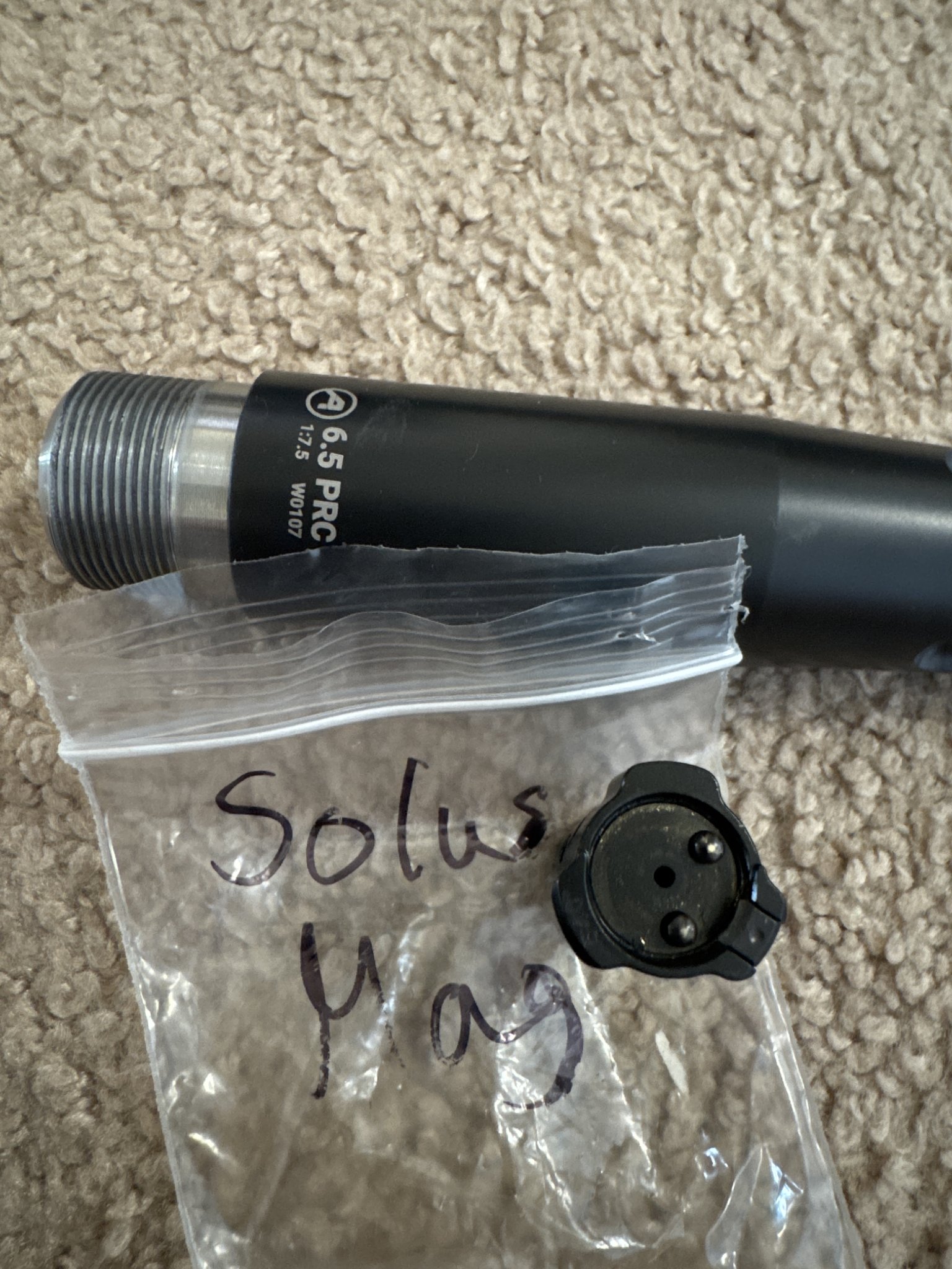

I was frustrated because I was using factory 6.5 PRC rounds. I got a new bolt face and barrel, it's a .308 now.
I'd be interested in that mag bolt face! It sucked that it didn't work out as expected, but I'm really liking this action. That's coming from someone that's owned origin, tl3, deadlines, impacts, defiance, AI, and badger 2013s. My origin sa that I tried to use 6.5prc with would trap empty brass during ejection between upper rear port corner and top rd in mag, no matter how hard you cycled bolt. Zermatts solution was bend feed lips down to lower top rd in mag, nevermind there was barely any overlap between top rd and bolt face to feed.
I find the saami freebore of 6.5prc is a bit long to play nice on short actions. My Smith ordered a custom reamer that is no turn with adg brass and freebore is .155 or .160(saami is .188). Works better with long slippery bullets and also constraints of a SA.
where did you get the 308 barrel?

I've generally had good luck with the nosler CC bullets, but I've saw sometimes a bullet/barrel combo cause a flier like that. Best case I can think was an old Lothar walthar savage barrel, during load work with 107smk, 105h-vld(pre hybrids), and 105amax the amax would be 2 in a hole and 1 1/2" away. I just chalked it upto bullet. I don't think it's a barrel stress issue, or flier would be consistent to main group. In 1 it's high, and the other it's to the left.
Because your new member you’re not able to do private messages? are you interested in selling the barrel in the bolt face?

I’ll probably hold on to it. But if I change my mind I’ll let ya know.

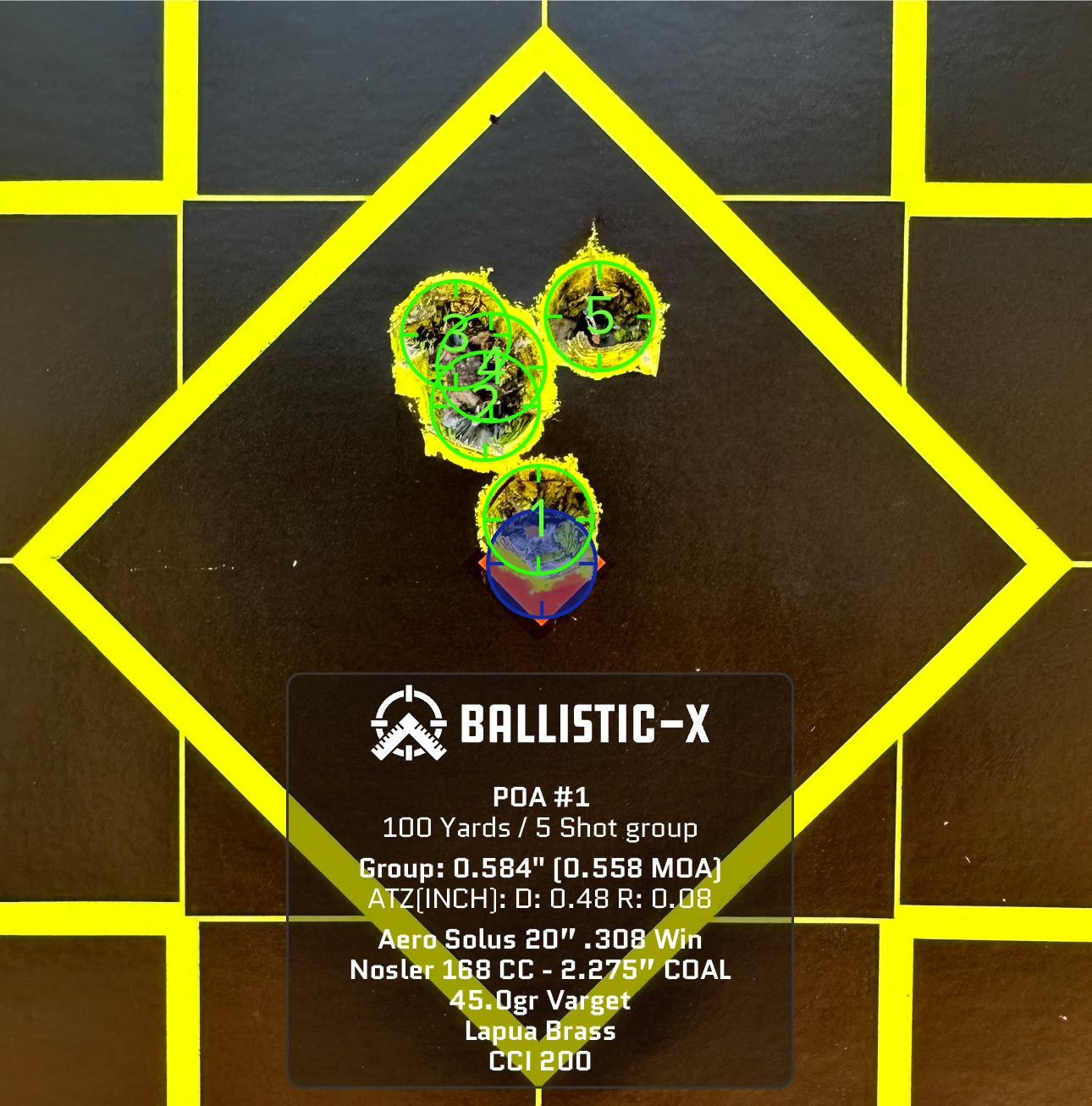

More range time today... Put 50 more through it at 45.0 grains of Varget with the 168 Custom Comps... Still not happy with how it's grouping with handloads, but cold-bore zero is pinwheeling the bull @ 100, and I had no issues hitting the small MOA sized gongs at 200 and 300...So, even though it won't group worth a fuck, it seems to make hits on MOA sized steel targets. Never seen a really picky .308 Win before, most are tack-drivers. This one loves throwing some shots and fliers. Not sure what the deal is, but it's just irritating as hell fighting this. 150 rounds down range it should be more than broken-in... I'm just glad @CarbonSix owes me a barrel, since I bought that Proof CF prefit for my other Solus build (.25 Creed). I might get Gene to spin-up a 16.5" .308 Win CF barrel for this one with a 1:7 twist for shooting subs and heavies...Or possibly a 20" 1:8 twist prefit chambered for 7 SAW for it. I have enough .308's in the safe, this one can become something new and different just to mix things up a bit.
44gr varget and 168gr smk was the street equivalent to fgmm. While that load always shot good, along with 43.7gr and 175smk, switching to h4895 got better numbers and accuracy.
Well, 44gr of Varget behind a 168 has always been my go-to load to see if any .308 Win would shoot, or not... This one did NOT like 44 grains, and is SUPER picky. Best groups were 45.0 and 45.2 grains. I'm probably going to snatch the barrel off and send it back to Aero, to see if they'll do some testing to find out WTF is wrong with it. Maybe tolerance stacking? Chamber seems to have been cut really nicely, and so is the crown, and the muzzle threads are also about as perfect as you could ask for, so I doubt any of that's the issue. And I'm seating bullets at a MAX of .030" off at a +/- 0.0005" tolerance, which should be more than short and consistent enough jump to eliminate seating depth as an issue. It has to be a bore issue. I'm going to scrub the shit out of the bore again before next range session and see if that helps settle it down. If it doesn't settle in the next 50 shots, then I'll be contacting Aero.
