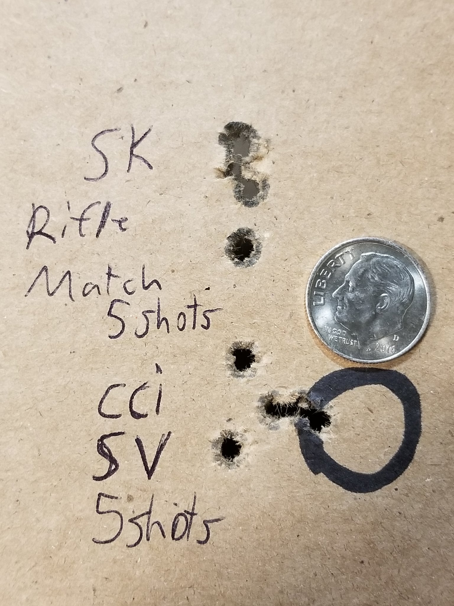

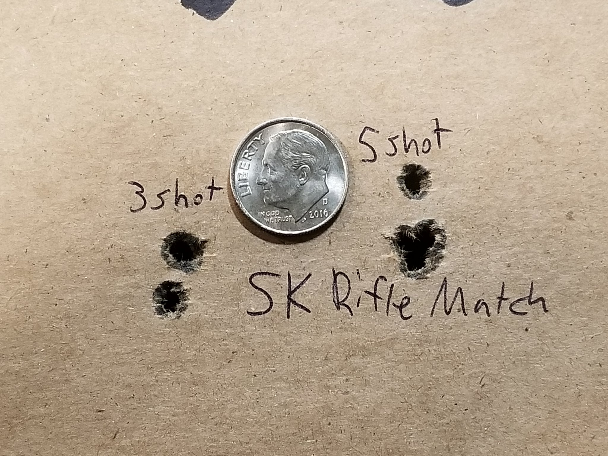

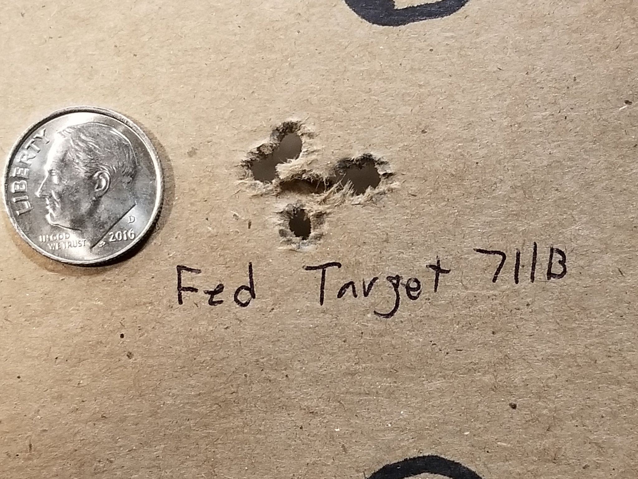

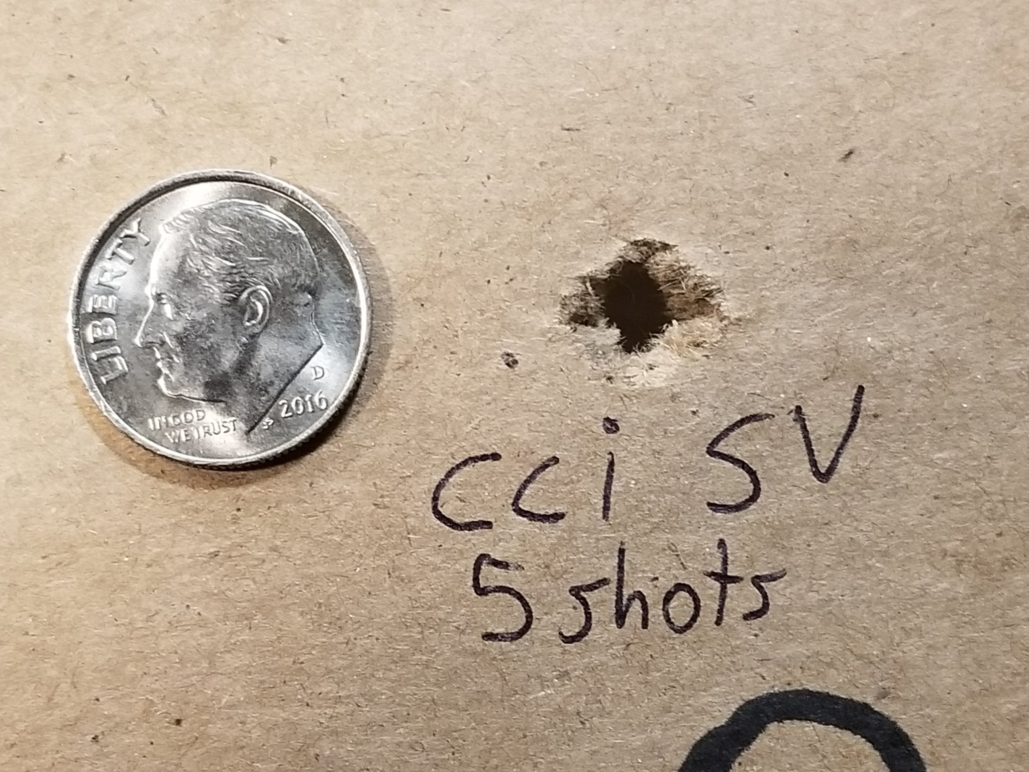

All shotat 50 yards with the t1x off of a bipod and rear bag. best group I've ever shot with a 22lr

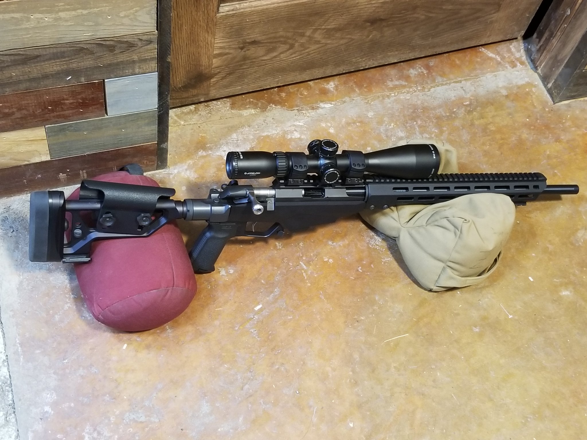

Because I like and use the factory stock on my CTR (after light sanding and painting to fix the slick texture), same treatment and the T1X is a perfect trainer. Swapped the pistol grip for a vertical one, put on the same scope and the form factor is the same. Been shooting cheap sub sonic mostly so far and accuracy to 50 y is sub 1”. Sweet rifle.

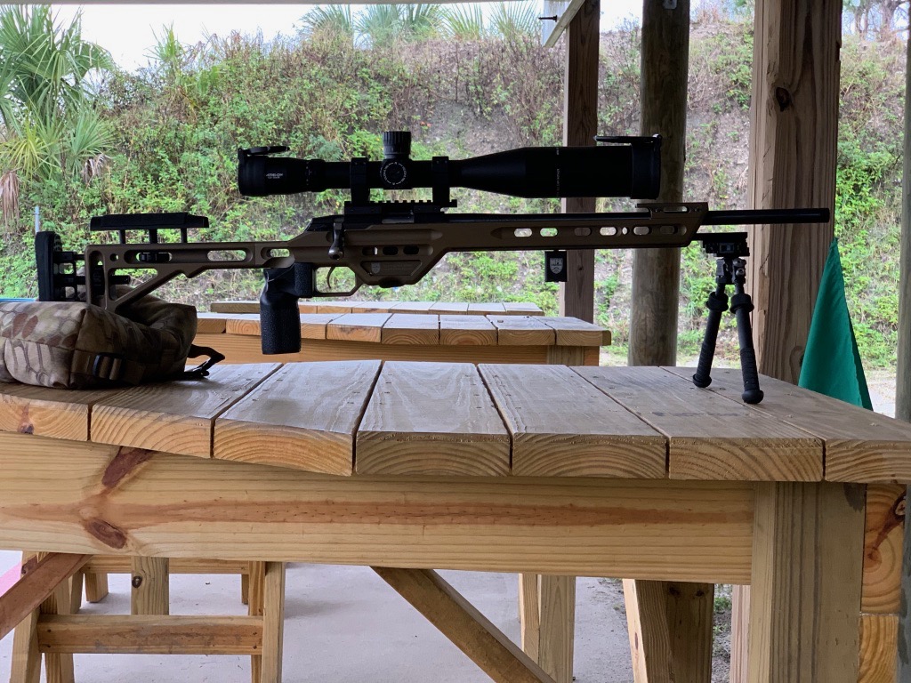

Huge shout-out to @skinnj1 for the excellent work he did on my MPA Competition Chassis. Got a chance to mount it up and shoot it this weekend. I don't have a Tikka CTR to test with but it should remain fully compatible if I ever want to swap it out. I don't see any reason I won't just be leaving the T1X in though. He documented the mods in this thread already so I won't duplicate that information.
If Vudoo comes out with a Mag that works that would mean only the bolt catch would need to be relieved with this Chassis (unless MPA starts making them adjusted to work). I would love to see an AICS magazine for these. I hope the chassis manufactures can start modifying their chassis for cross compatibility with the T1X. For the MPA I don't think it would be very hard for them to do. For other companies it might be more of a challenge depending on the design.
I had to remove the rail from the front bracket to fit my Athlon Ares ETR with sunshade. I'm using the 20MOA EGW Mount for the CZ from Midway and Seekins Rings 1.26" extra high.

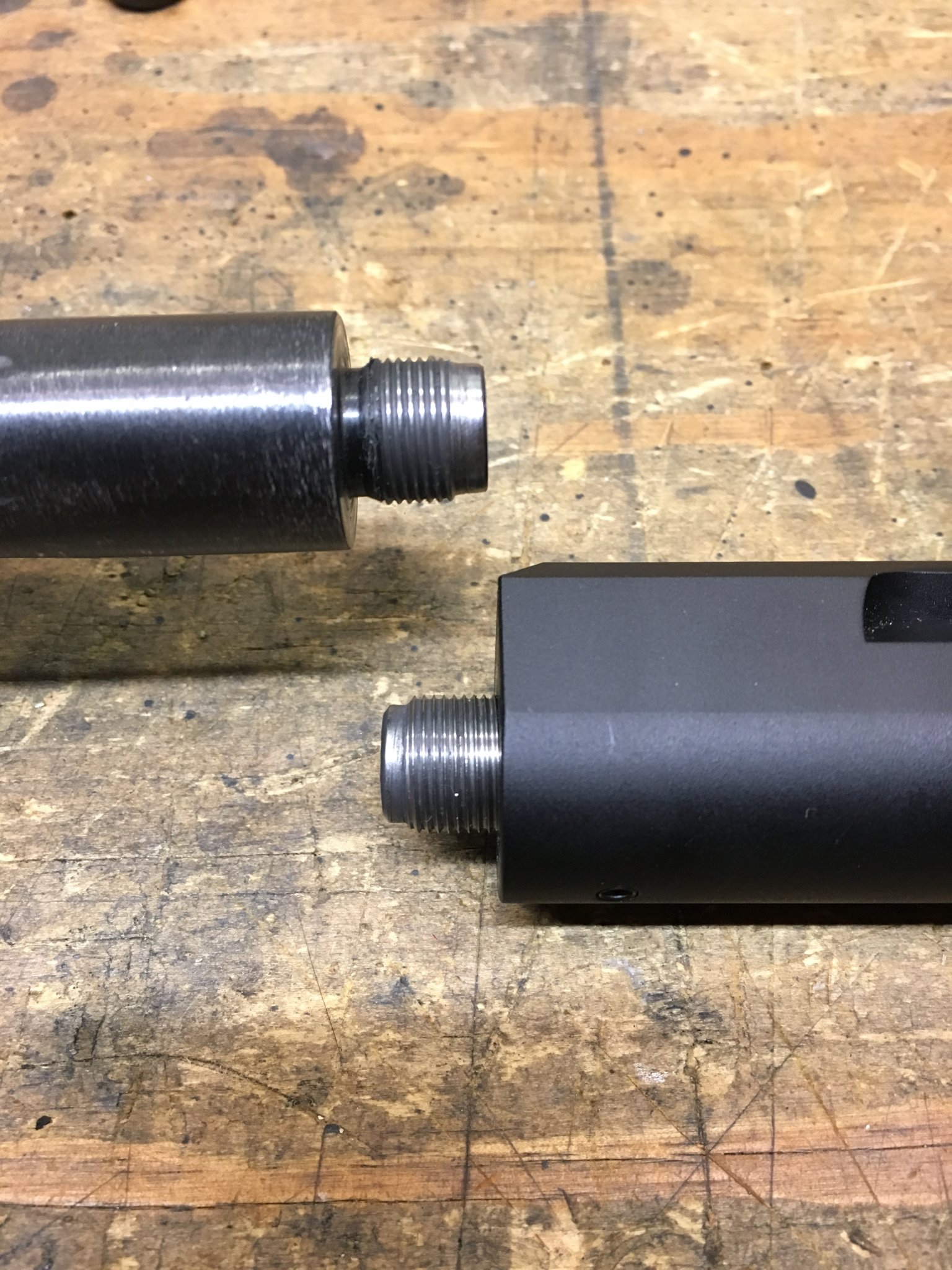

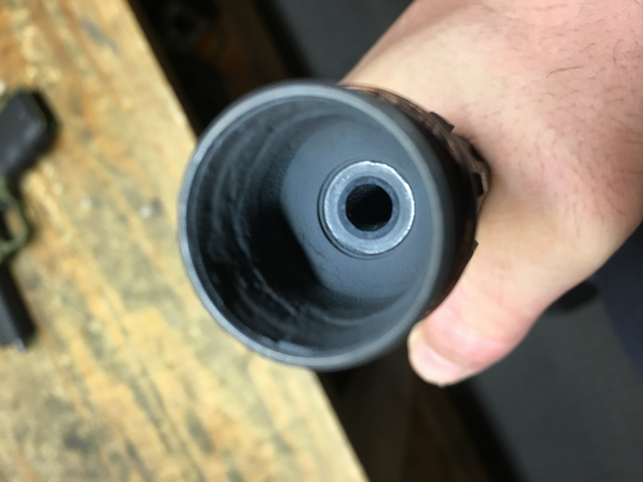

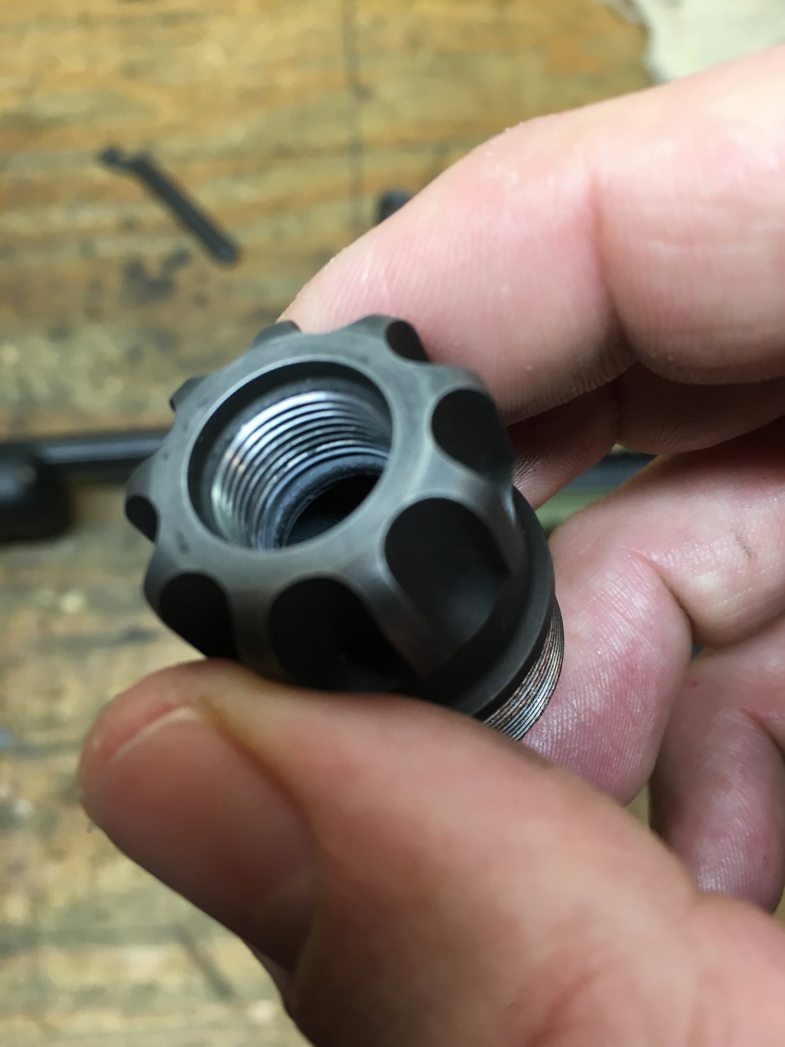

For those using a suppressor, are you able to thread the suppressor down touching the shoulder?
I have a Sparrow22 and it seems like I can't thread it down enough to touch the shoulder, wonder if I need this: https://www.store.silencerco.com/co.../1-2x28-rifle-thread-spacer?variant=221756564
SilencerCo has a specific thread spec so the o-ring seats against the barrel threads (https://s3.amazonaws.com/com.silenc...cs/Rimfire_O-Ring_Engagement_Thread_Guide.pdf)
Essentially, you need to have the first few threads removed or purchase the 1/2x28 to 1/2x28 adapter
(https://www.store.silencerco.com/products/rimfire-adapters?variant=1107308244 )
I have a Spectre II, which has the same thread requirement.
Reactions: derek1ee
Looks like on T1x it's 0.497 in, longer than SiCo's .476±.002. Still wonder whether if the spacer is sufficient or if I will need the 1/2x28-1/2x28 adapter. Probably will give SiCo a call tomorrow.
Here are my two SpectreII hosts, modified by a local gunsmith. You can see the o-ring seat at the end of the barrel to do its job.

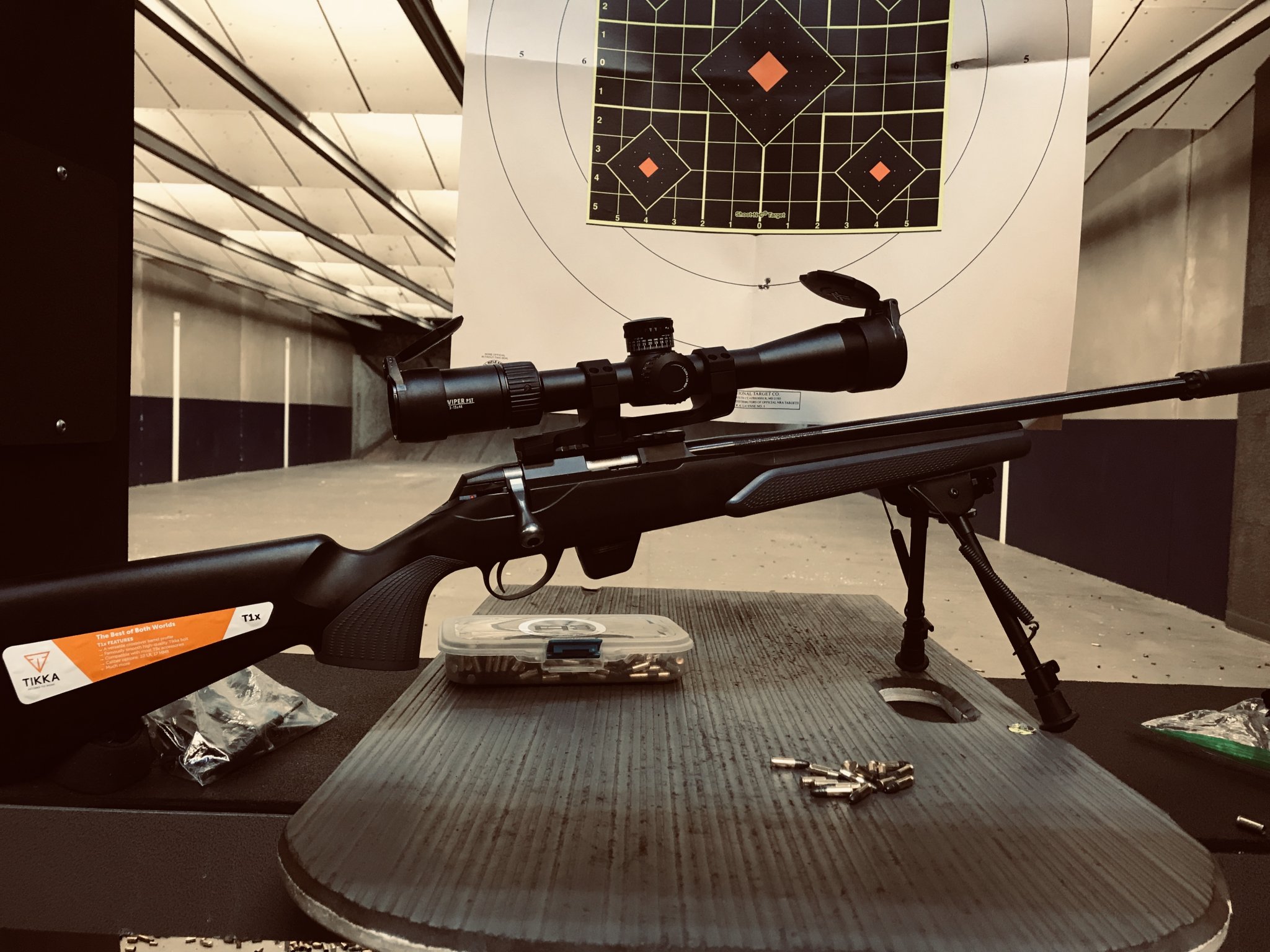

Spent time on the range this after for the first time with my new T1X, it lived up to all expectations. I’ve mounted to the stock chassis a Vortex PST scope on a 11mm Magpul 11mm rail (slightly modified), Harris bipod, Tikka T3x vertical pistol grip. The Silencerco Sparrow fits perfectly tight right up to the barrel with no timing issues.
My only gripe is the Tikka 22LR mag miss fed about 10 or 12 rounds out for the 100 rounds fired. Definitely worth the nearly 1-year wait.
