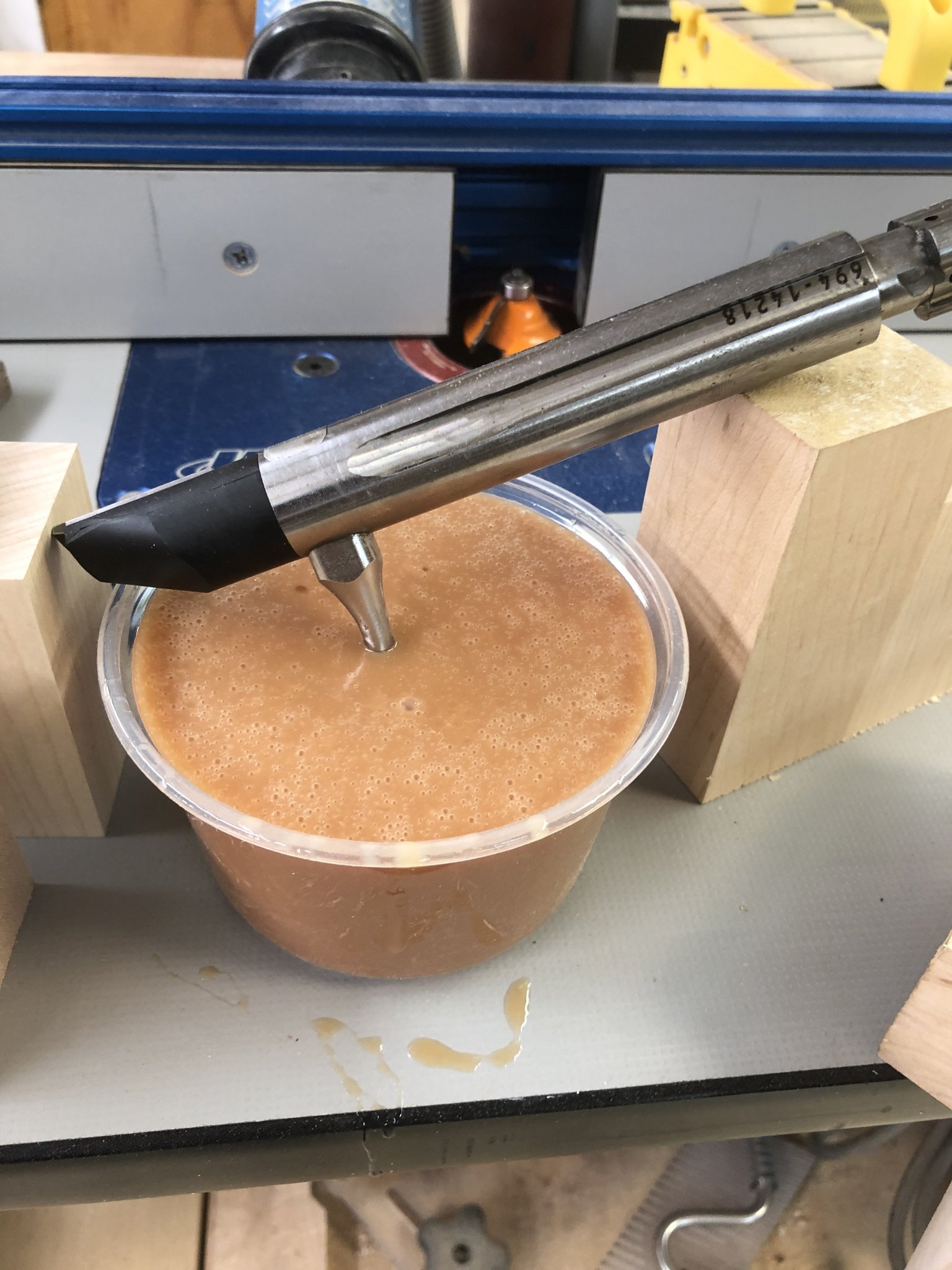

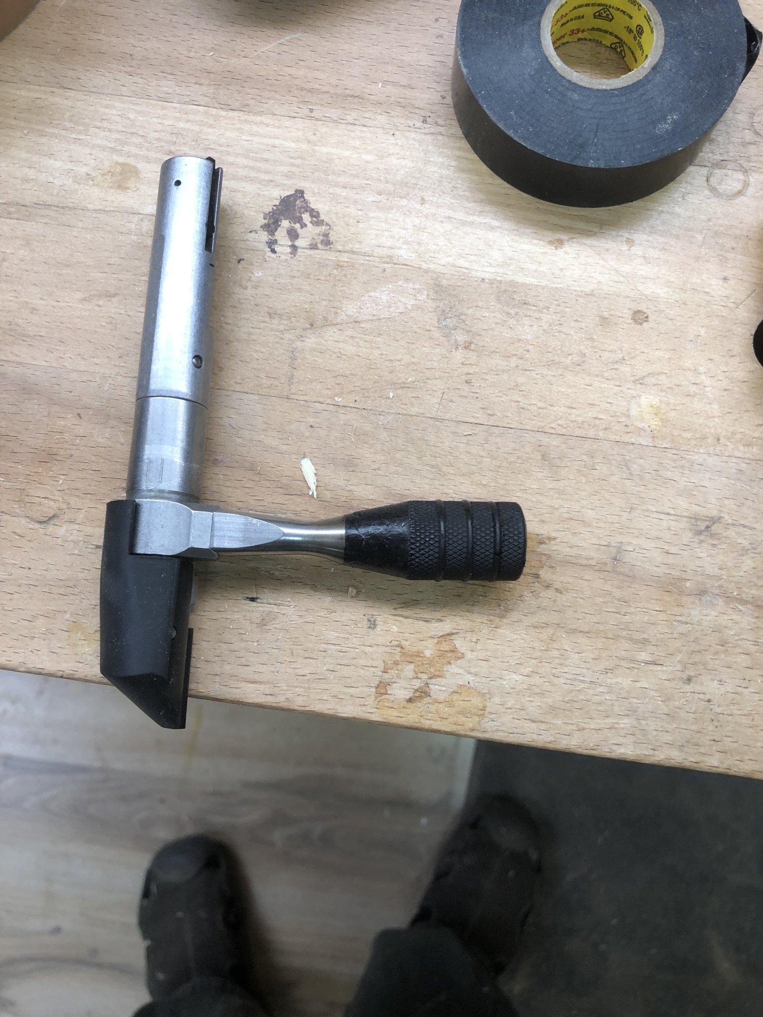

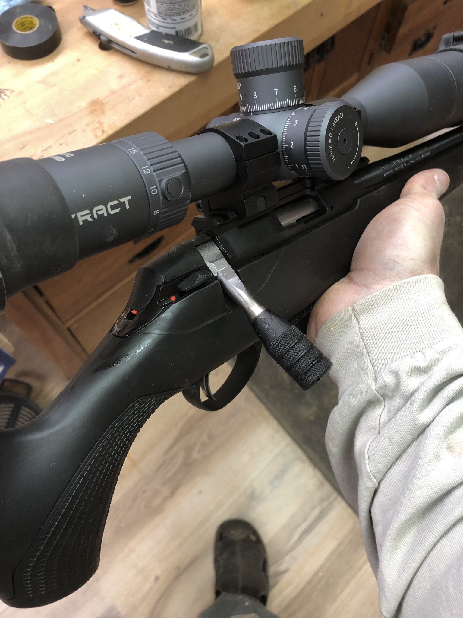

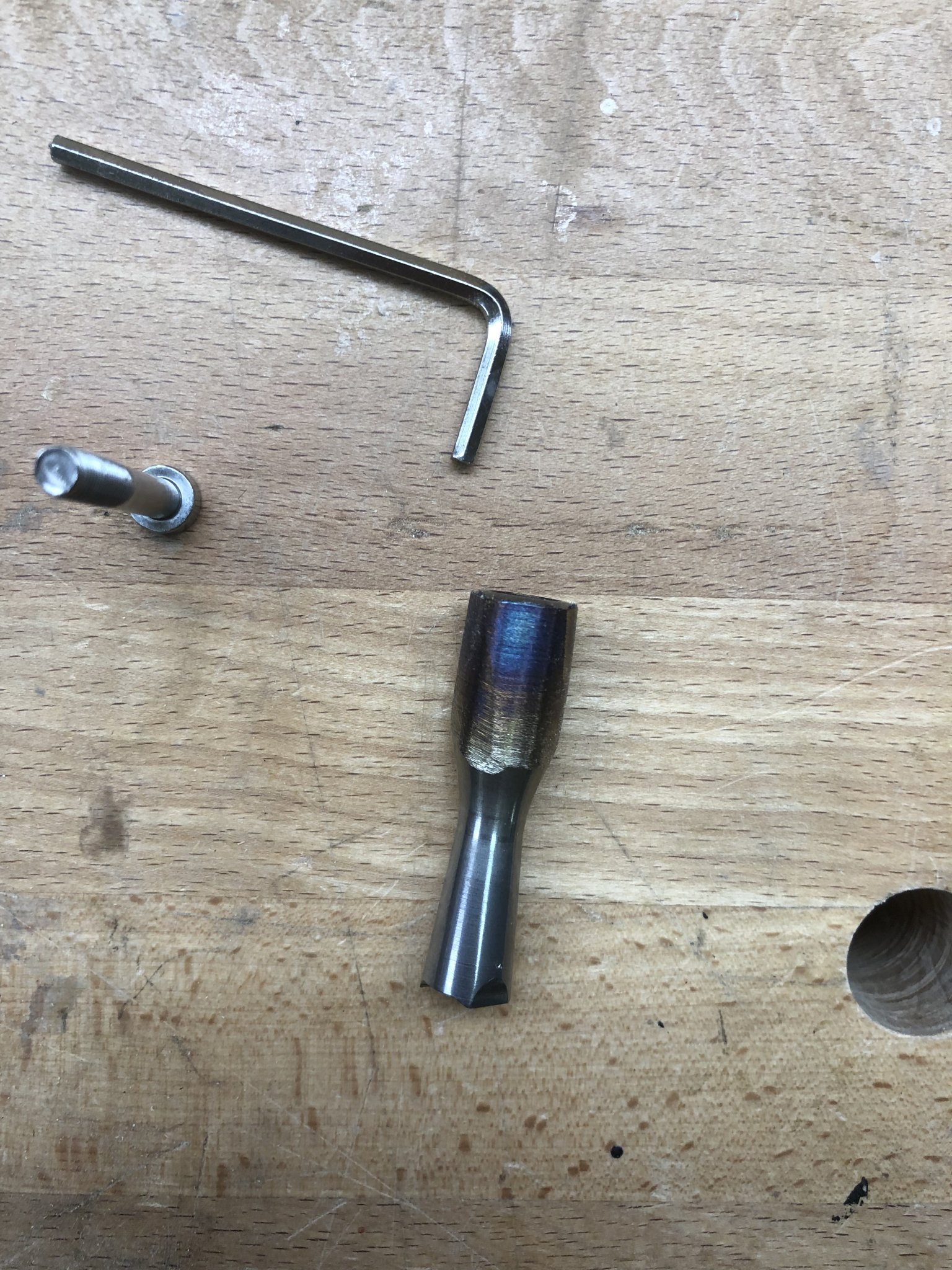

So I got my rifle last week and shot it yesterday. My only complaints about it are the bolt handle and stock. I just got a KRG Bravo to put the rifle in so that part is fixed. I did not really care for the add on knob that is available so I went a different direction. I wanted something longer. What I did was made a mold of a knob I have that I really like. I then ground the knob down and cast a tooling resin over the knob. The resin has a high metal content and I added a black dye. All and all I’m pretty happy with the result.

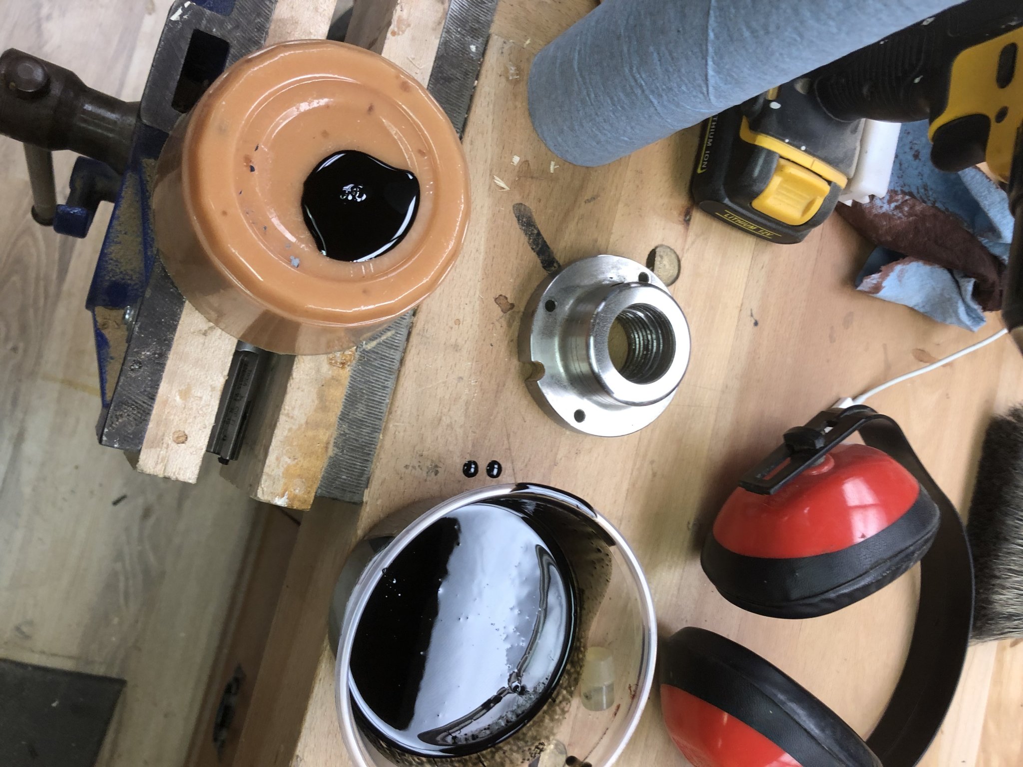

Making a mold of the knob I like

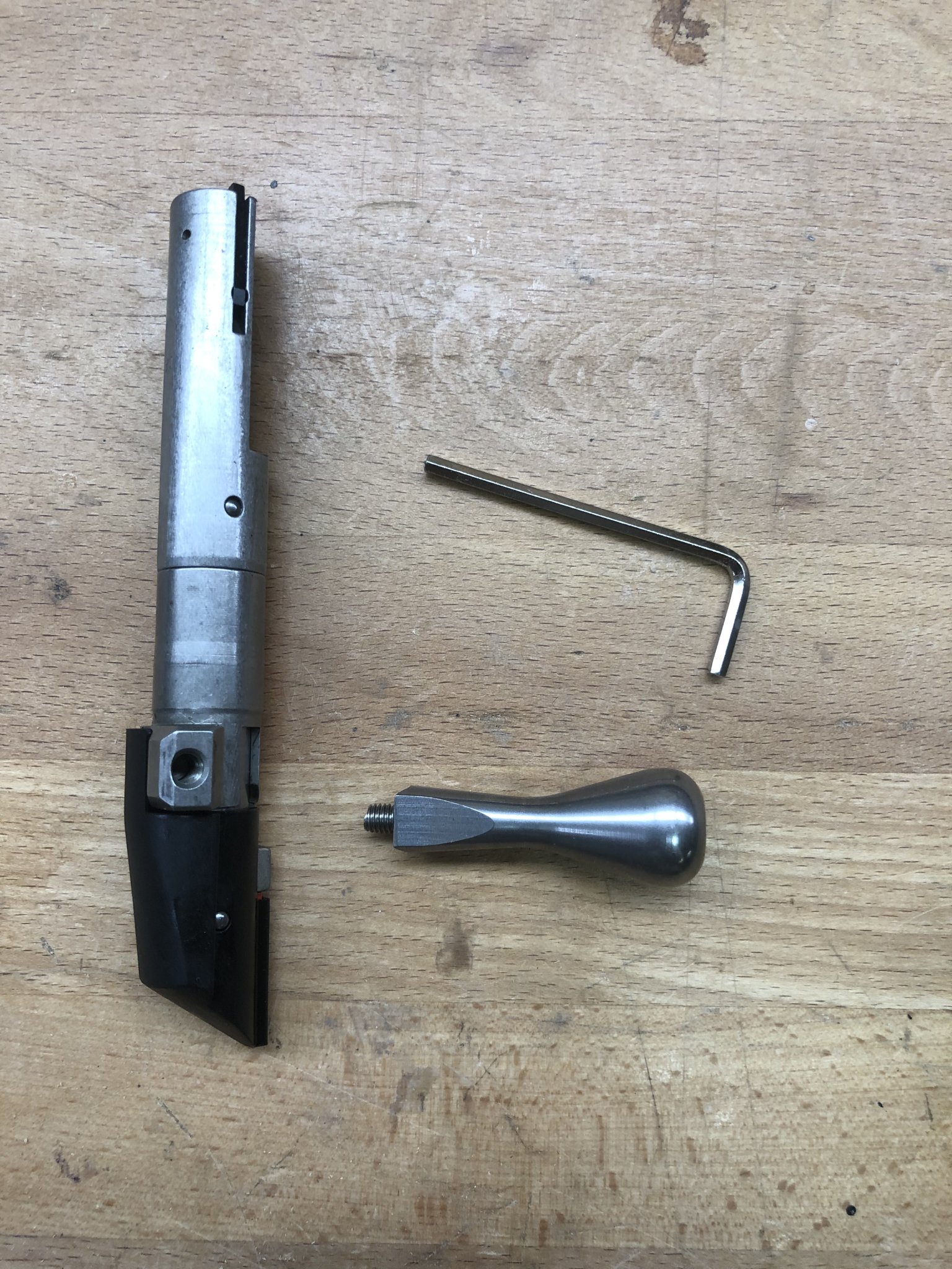

The bolt disassembled
The bolt ground down

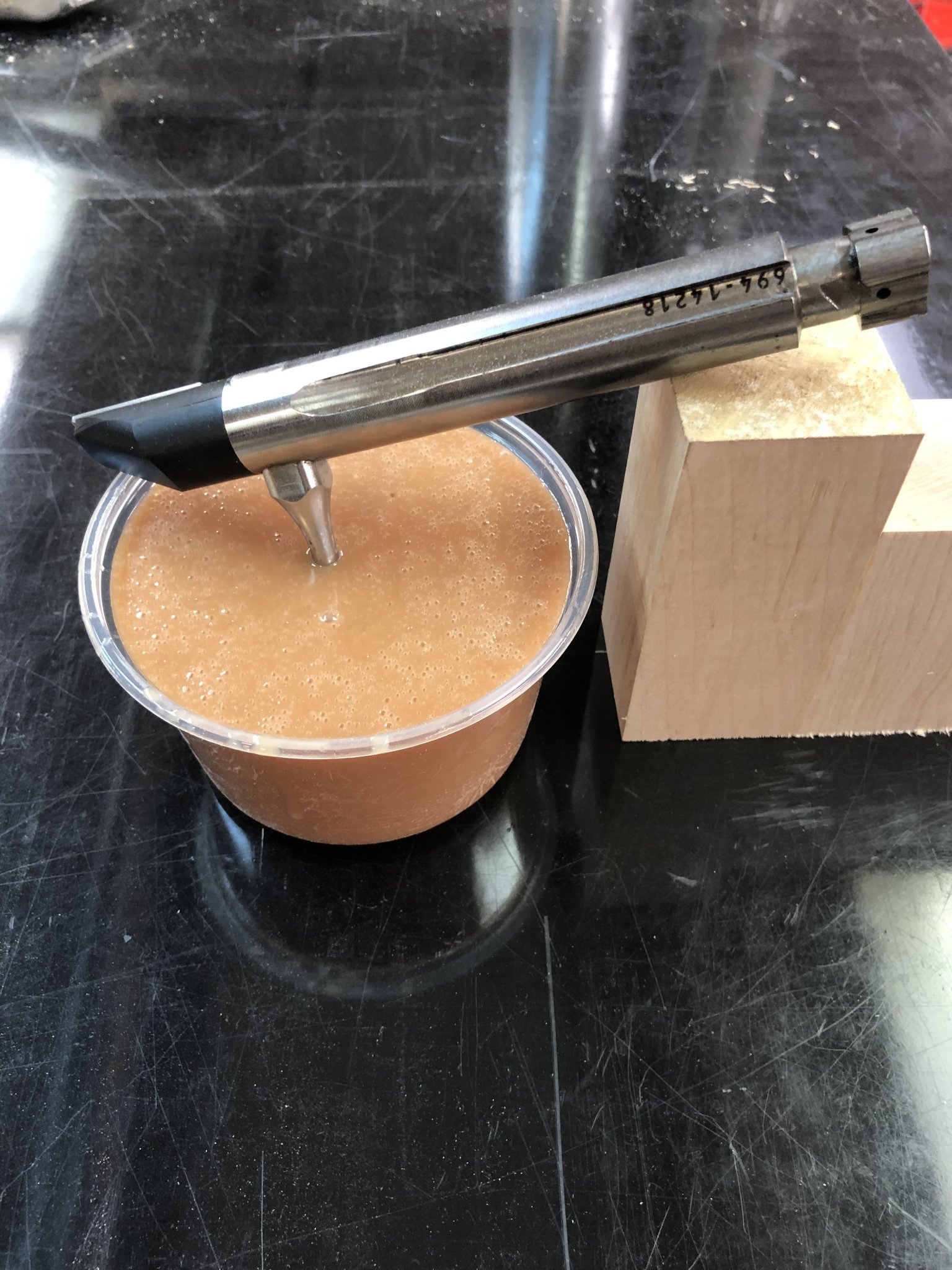

Casting the resin around the knob

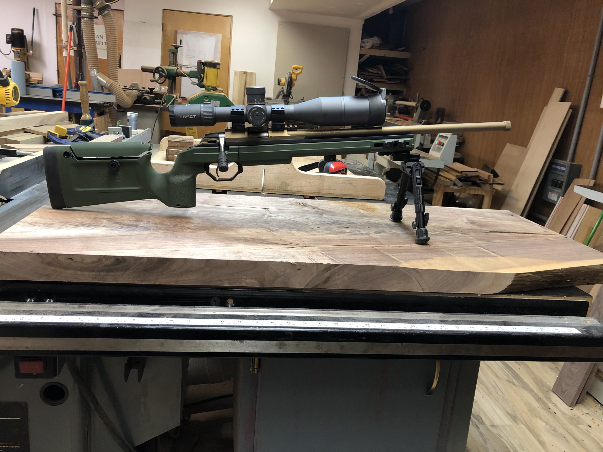

The finished knob installed.
Making a mold of the knob I likeView attachment 7052141
The bolt ground downView attachment 7052144
View attachment 7052146View attachment 7052147
People like you keep me from losing all hope of humanity. Thanks for sharing. Cool and nicely done. I never would have thought of doing something like this. Now, I'm inspired.
And nice sandals hippie. ?
Those are my Shop shoes. They are Crocs. It is hard to tell but they are covered with paint and finish. I have been spraying a lot of Cerakote too and that stuff doesn’t come off once it’s on. This isn’t a T1x but this is my other project from last night. I cerakoted my sons AR15. I’m thinking about doing something with my T1x but haven’t figured out what I want to do yet.

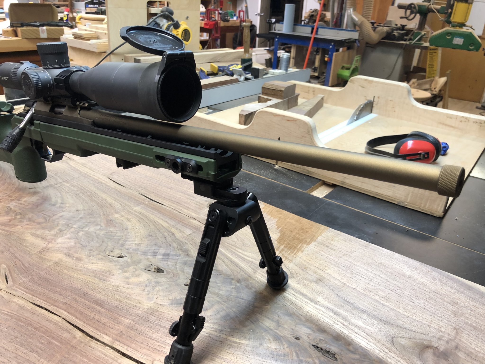

Which bipod rail did you use? Does it add a qd cup. I love my tikkas and the plastic stocks are much more comfortable than they look. However, the single sling stud configuration on a narrow sloping neck is unfortunate.

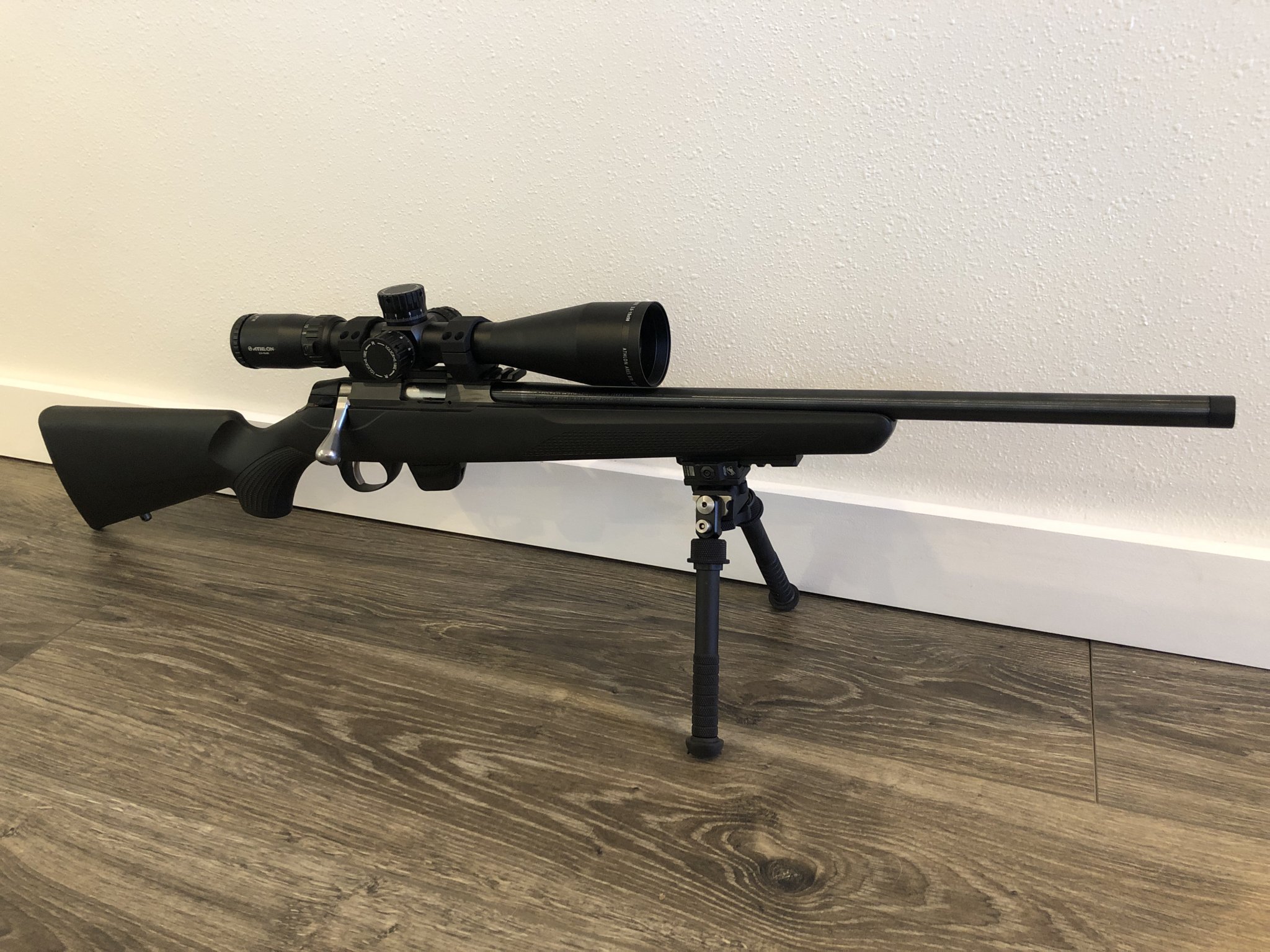

2” Seekins srs.

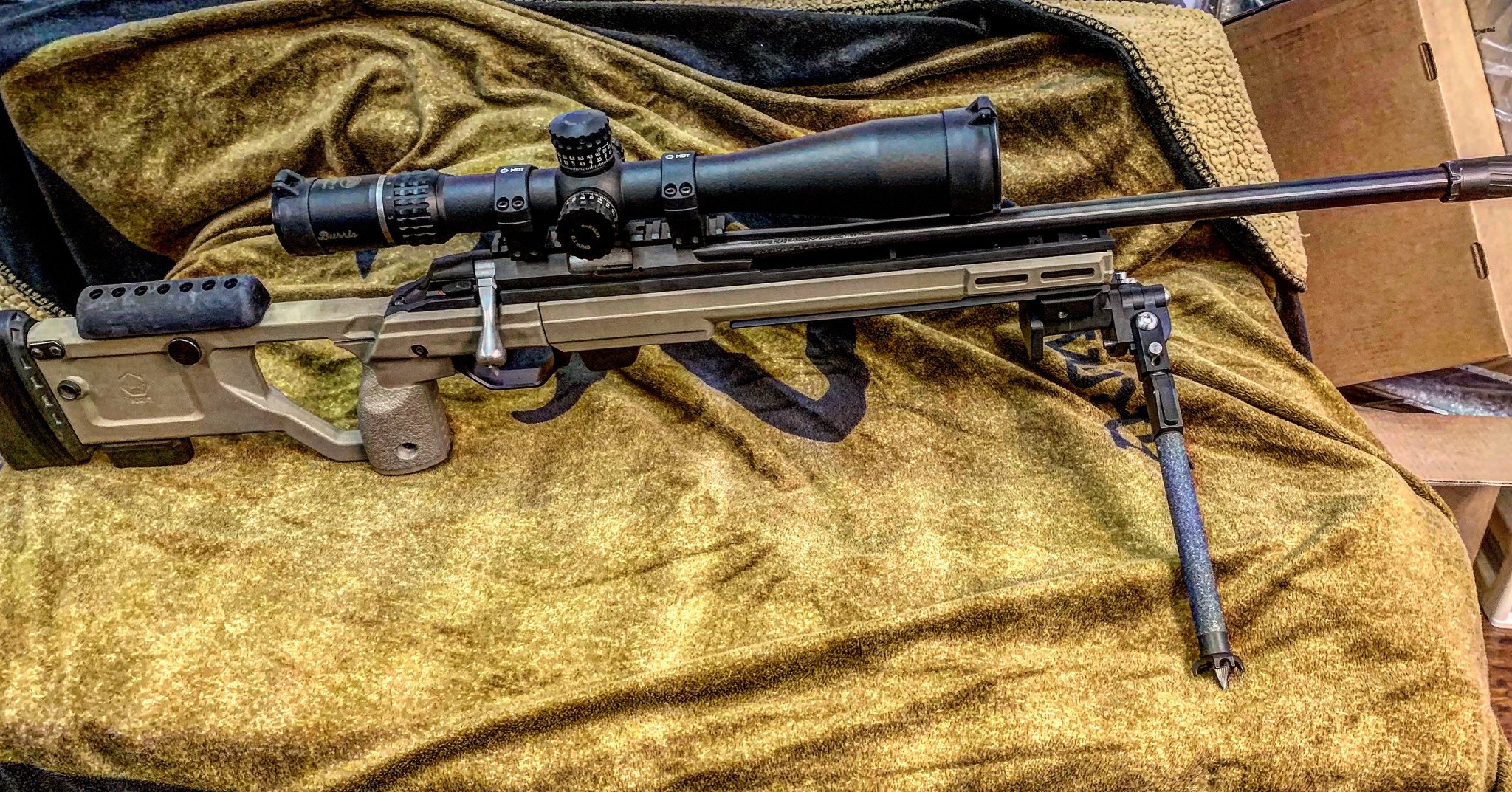

I’m about to put my action into my KRG Bravo that just arrived. Does anyone know what the action bolts need to be torqued to. I have skimmed through the posts but if someone mentioned it I must have missed it. Reading the manual it looks like they are calling for 62 in-lbs or 44 in-lbs based on the application but I have seen other settings mentioned for aftermarket stocks as well. If all else fails I will try calling KRG and see what they recommend.
@Eoddave27 I’m also curious about torque values in the Bravo. Are you using the factory action screws or Mtn. Tactical, etc?
I used one one action screw (front) that came with the Bravo. It was shorter than the factory action screw which is my guess as to why it was included. The rear action screw is the factory screw. I checked the torque settings on the factory action screws and they were just shy of 30 in-lbs. I tightened to that for now until I can get a definitive answer from someone. I just didn’t want to over tighten them until I’m sure. I will say I am super impressed with this Bravo chassis for the money. I think I’m putting a Whiskey 3 on my wish list now for one of my centerfire rifles. I’m going to Cerakote the action and add the accessories to my chassis tonight but as soon as I have that done I will post some photos.

I was going to Cerakote my barrel and action tonight FDE but I am going to think about my color choice a little more. The it looks good now as is and if I do Cerakote it there really isn’t turning back. All and all I am really happy with the Bravo. Can’t wait to take it out and shoot it again now that it is in the chassis and I have the trigger adjusted. I took that cheap plastic thread protector off and put a nice metal knurled one on that came off my savage of all things. Who would have ever thought I would use parts off a Savage to improve a Tikka ?

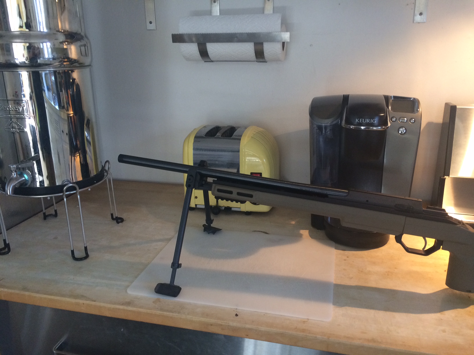

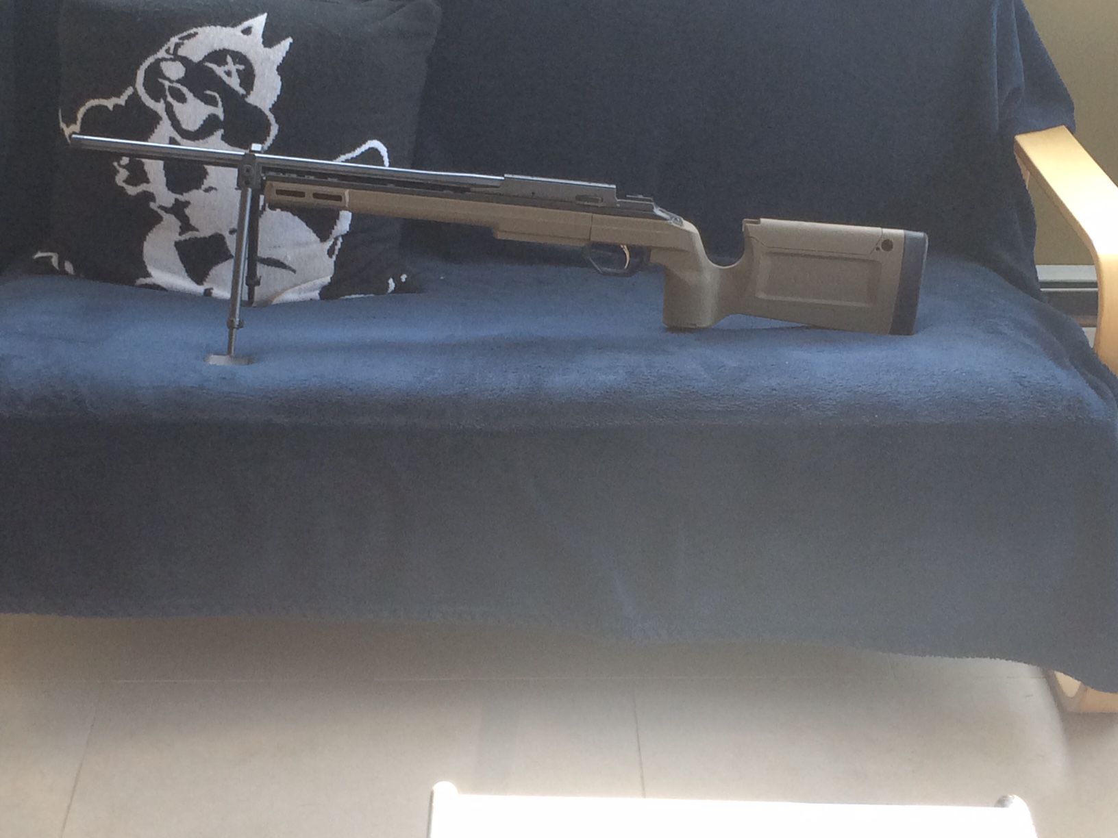

We finally picked up our Tikka after a 3 month wait through Bass Pro, the Bravo chassis will arrive Weds, and the Murphy Precision rail we ordered hasn't shipped yet (might need to call), we are excited to put this thing together.
A quick question... Is the Bravo set up to accept the Sako TRG bipod? I went on KRG's site and found their bipod options hard to understand, never having seen one in the flesh. I saw a Harris mod part but we only have the TRG and an Atlas, so wondering if we need another attachment for a forend picatinny.
The Bravo comes with a 2” picatinny rail for the front to mount a bipod. If you look at my photo above I took off the sling lug and put the pic rail in its place then added a QD sling mount to the front.
The Bravo comes with a 2” picatinny rail for the front to mount a bipod. If you look at my photo above I took of the sling lug and put the pic rail in its place then added a QD sling mount to the front.
Thanks, I had looked and enlarged your photo to get a look and didn't know if it was something else I needed to pick up. Thanks for clarifying
I did 65inlb in my J Allen with my T1X and in my T3X in my other J Allen.

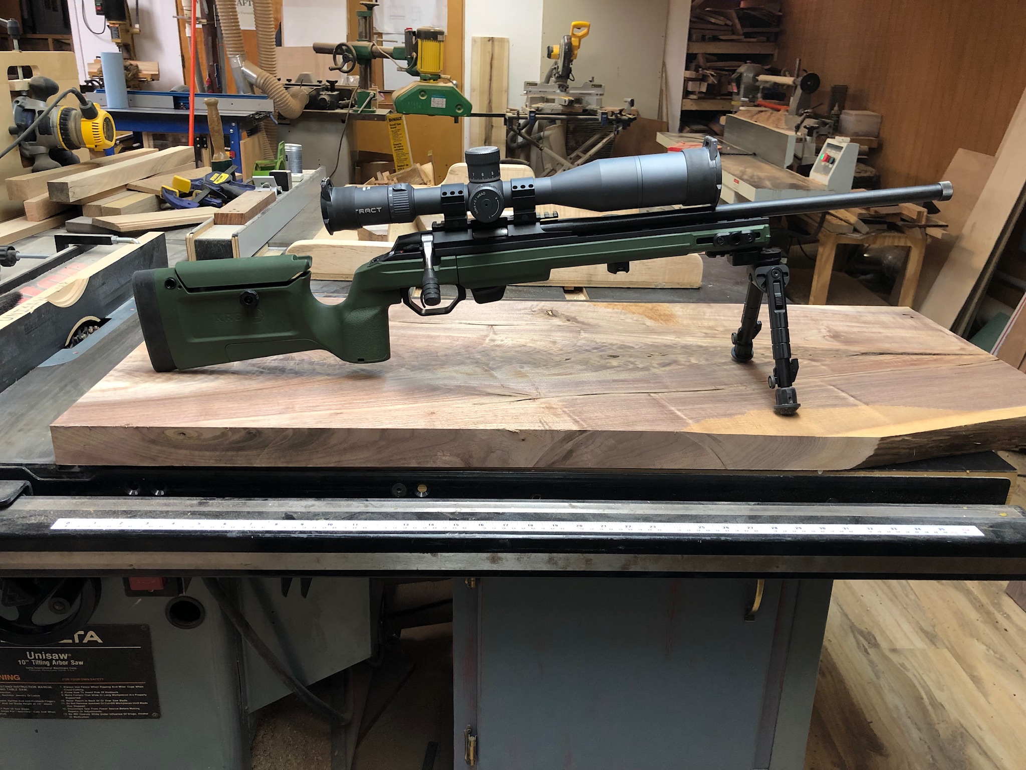

@Eoddave27 Looks awesome! Is that the 20” barrel? Can you guys get the 16” barrel down there (in the US)?
Yep, it’s the 20”. I would really wanted to get the 16” but I haven’t seen those here yet. Now that I have it in the chassis though I’m actually glad I got the 20”. It balances really well and I don’t plan to shoot it suppressed so it will not get any longer.

I'm waiting on Fed Ex now for the KRG delivery, have to sign for it..... Can't wait to get started. Unfortunately, as I thought, the Murphy rail was out of stock and "may" go out today if they catch up. So most likely no range time this weekend with the Tikka as planned.

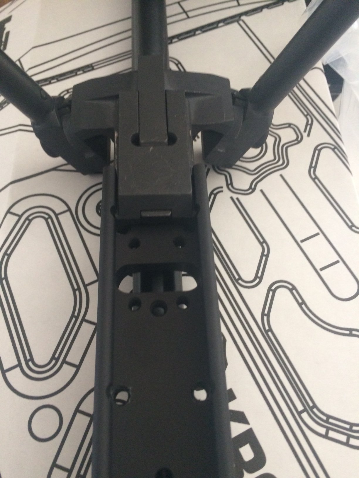

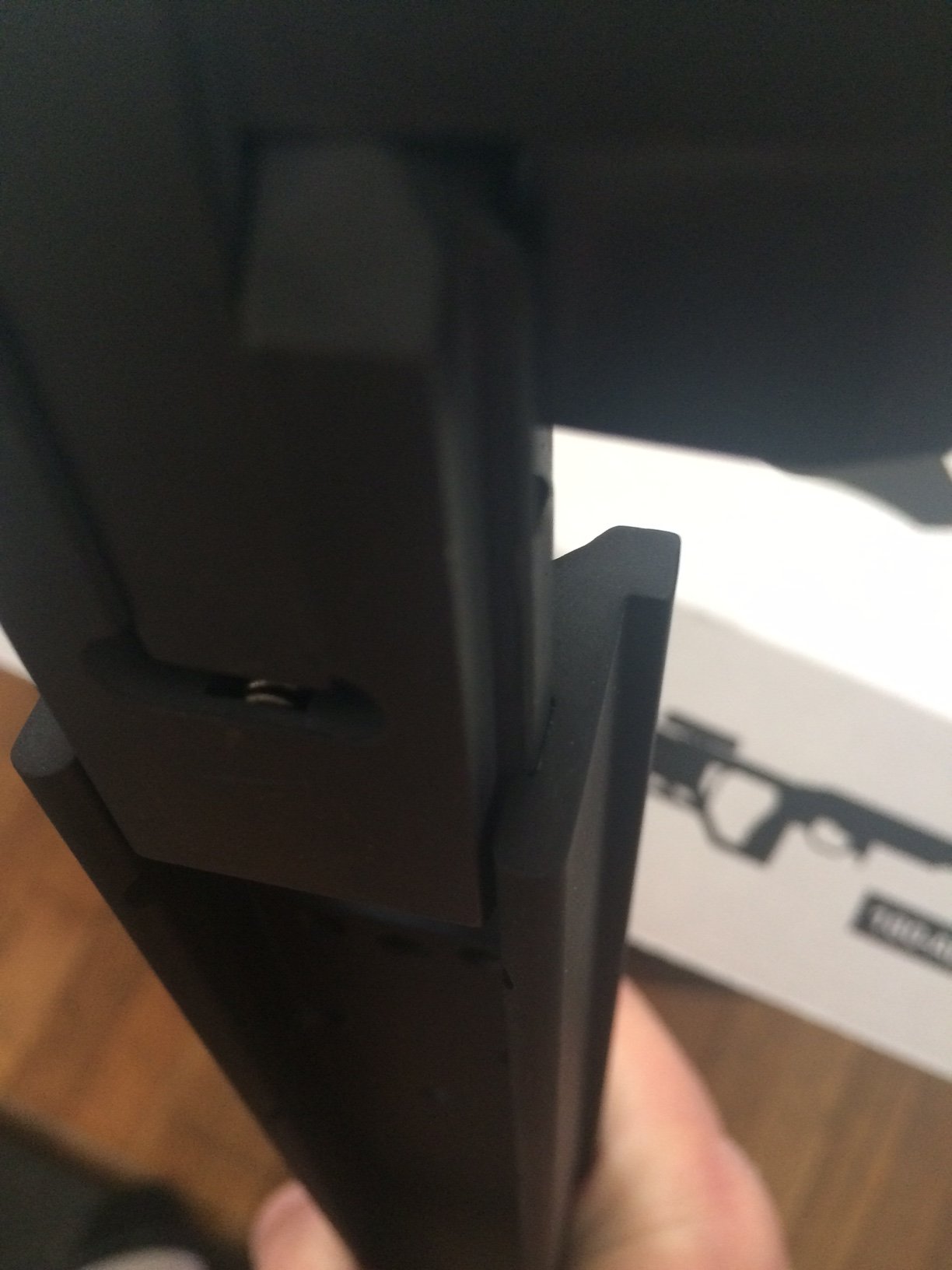

My KRG arrived, and looking at the front of the forend, I swore it looks like it should accept the TRG bipod, BUT.....it is just a little bit too tight. Not sure if I can find an appropriate file to loosen it up.
Also they didn't supply a second screw base for the picatinny. Grrrr. LOL CORRECTION: I just found the bag with the pieces :)

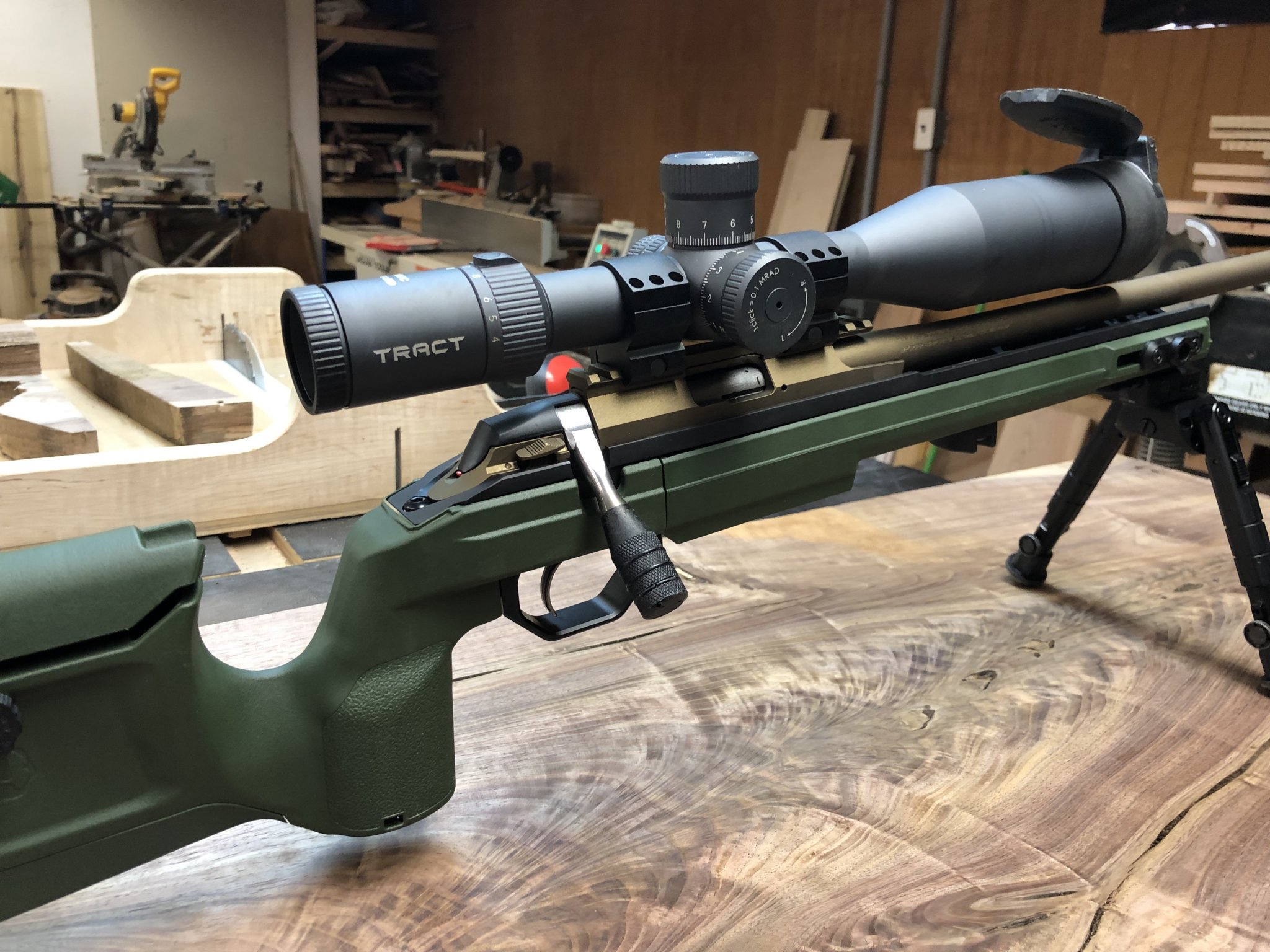

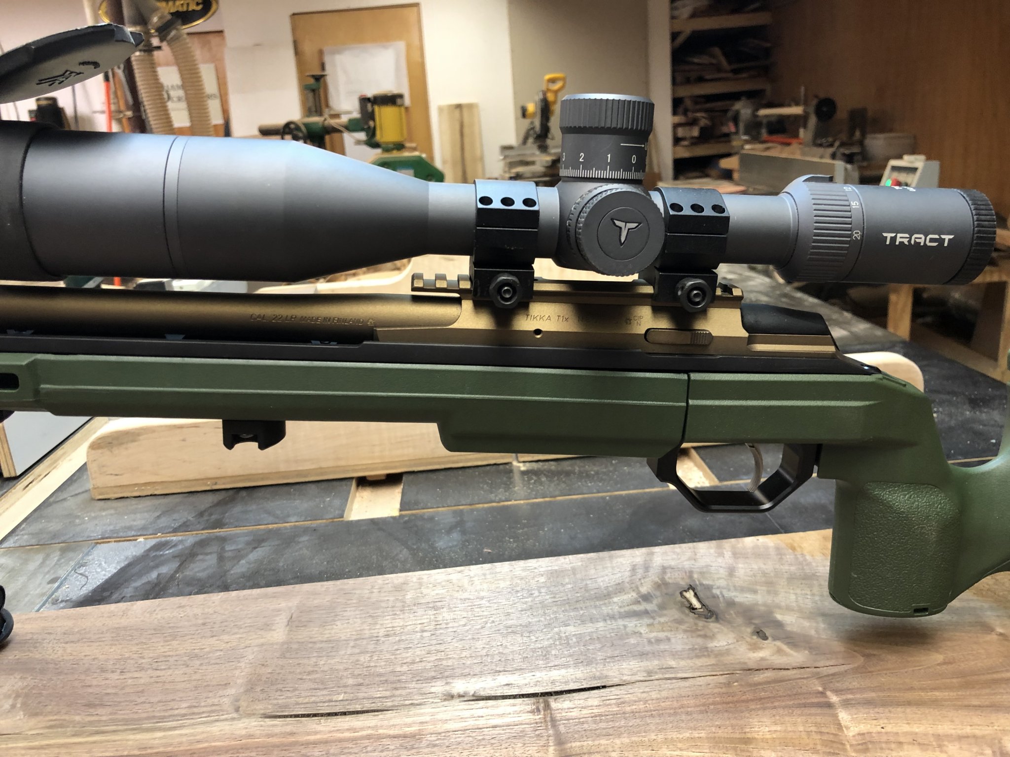

haha cwinston, I was just going to post that with a bit of filing I got the OEM Sako TRG bipod to finally fit in and lock.
edit: I also removed the first set of screws as they appeared to be in the way of the insert.

Looks great, I love the trg bipod. I’m so on the fence about a T1X. If I didn’t have a Sako quad Range that shoots great, I would get one in a heartbeat, what does your T1X in the bravo weigh?
The Tikka in the Bravo is very light (missing rail and scope). I don't have a scale so maybe someone could weigh in with specifics (pun intended)
I was just joking with my wife that the bipod basically costs as much as the rifle :) But I like how much the .22 in a Bravo with the bipod feels like a little brother to my TRG 22. And lol in our house we cant have too many .22's so cheap to run and at 100 with weather can be a challenge.
Color looks great, and I'm jealous at how damned handy you are!
As much as I like the Sako green stock, that might look even cooler with Bravo in matching color. I like the bronze black contrast.

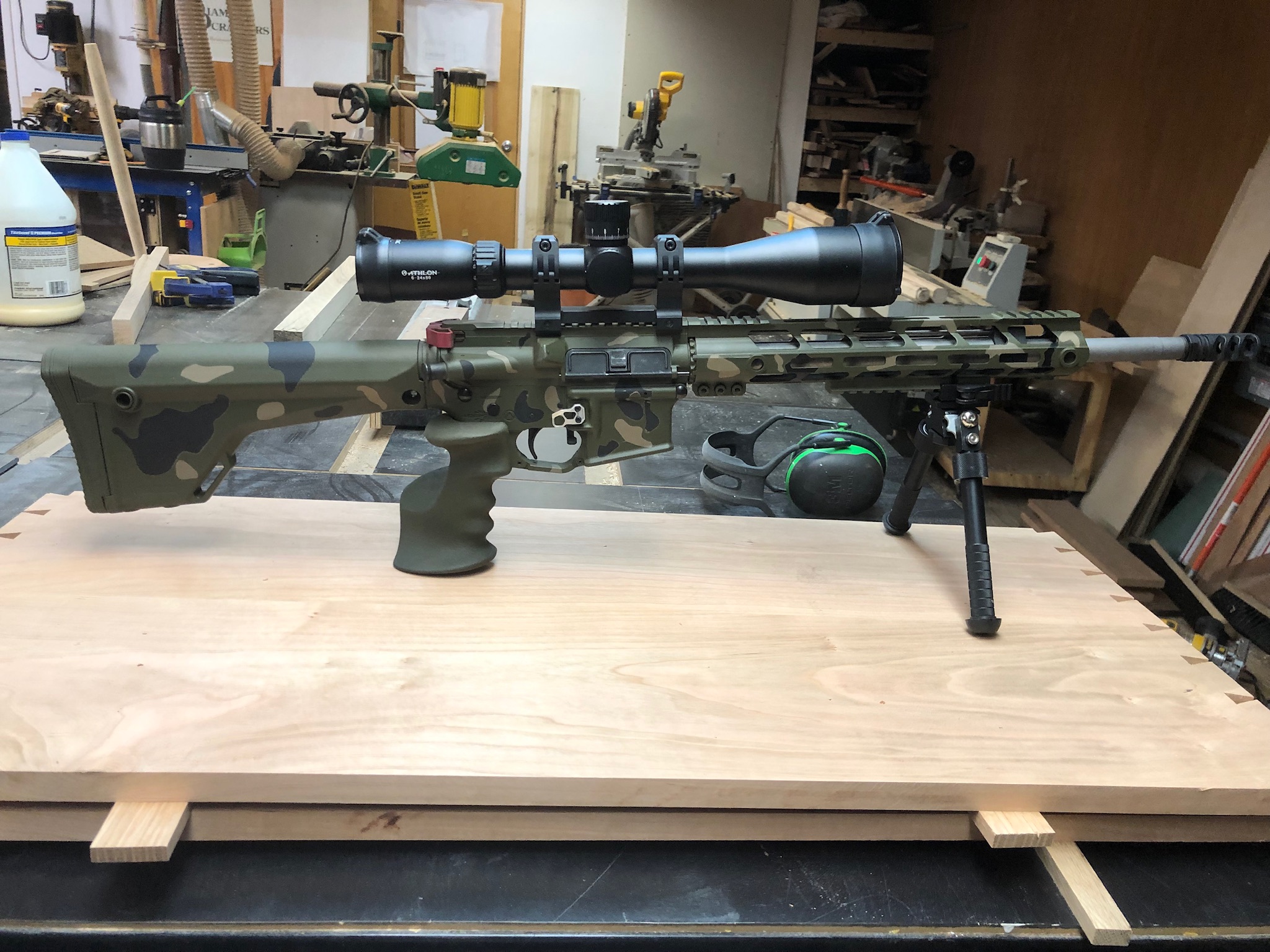

I am going to spray my friends rifle with the old Vietnam tiger stripe camo pattern. It will be interesting to see how that turns out.
