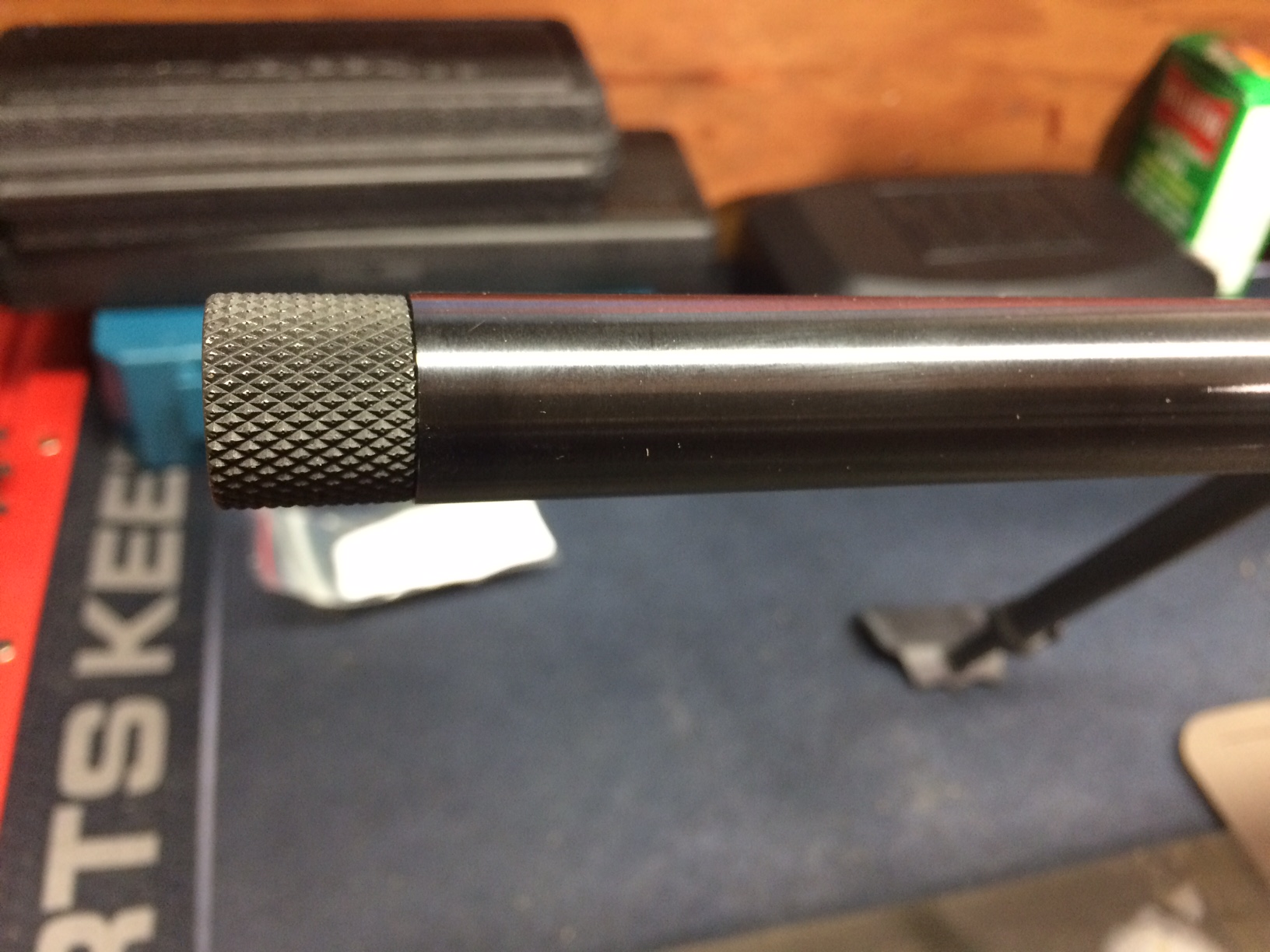

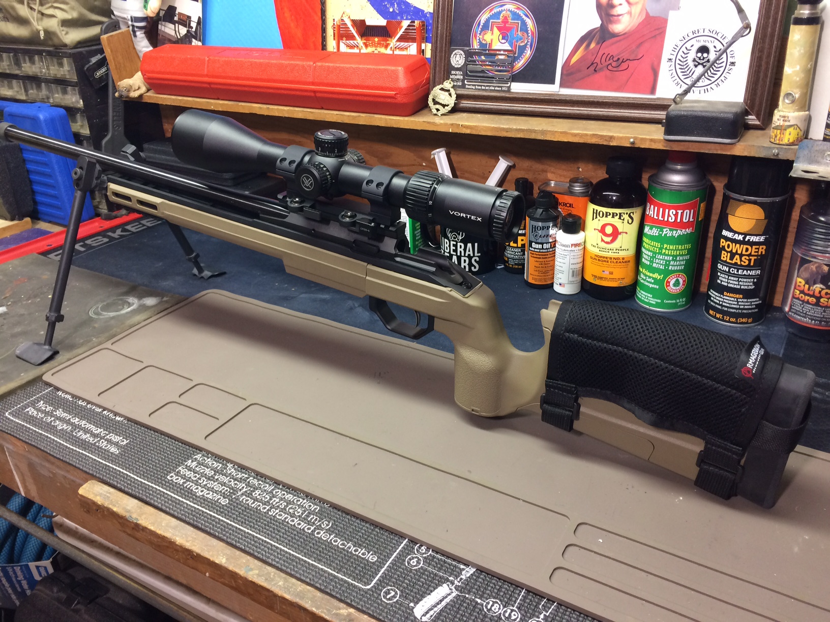

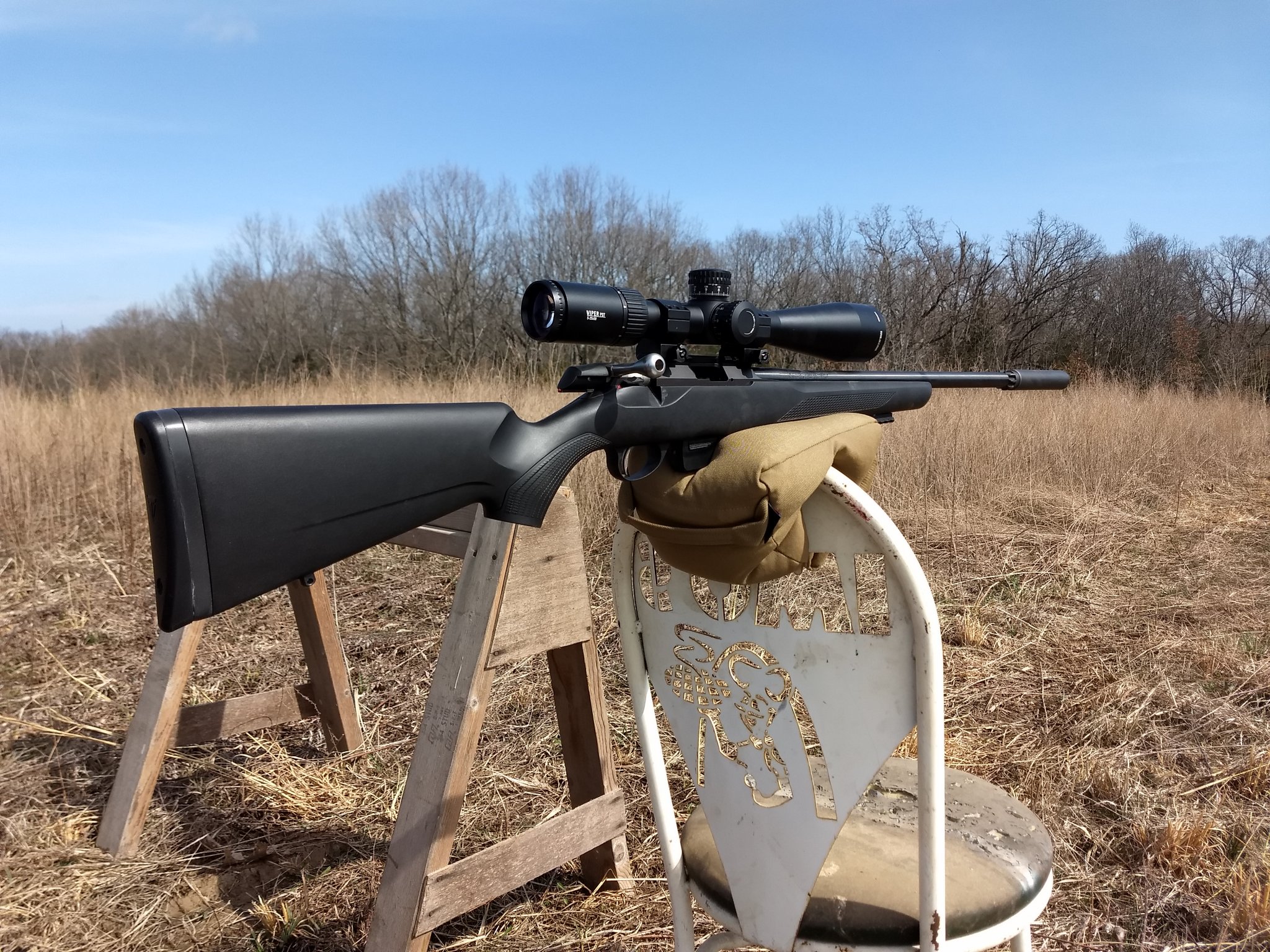

I got the T1x ready for this weekend. The Murphy rail looks/feels well made. I added a steel .223 thread protector that I had in a box, the newer Vortex DBT FFP with Larue mount, and the Armageddon Gear Cheeky Bastard. Also with big brother :)
edit: No Zorph, not heard of a speed loader for the T1x but new to Tikka
edit 2: Amazon order just arrived with a 2 for $10 thread protector for .22 with free overnight shipping. Not too bad.

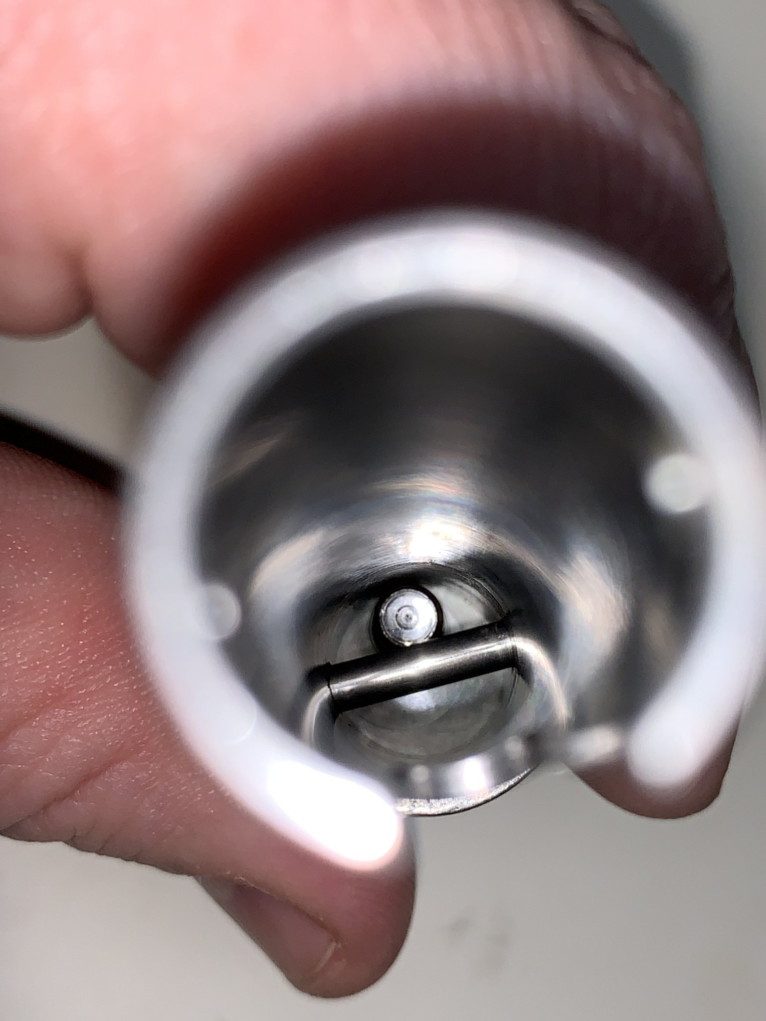

Broke a firing pin this week. I was test-firing after adjusting the trigger weight down to the factory minimum. The trigger felt great, I wasn't able to get a slam-fire everything was fine. Then the bolt wouldn't close and I discovered the firing sitting in a bolt raceway.
Has anyone else had this problem? Was Beretta USA able to help? Am I going to have to wait for parts to get shipped from Finland (or worse yet, Italy)?

I meant to get into it this weekend and pull out and inspect the firing pin so I cab sure sure that is where this pin i found in the action came from. Are there official instructions for bolt disassembly? I didn’t see anything in the owners manual or you-tube. As almost everyone on this thread knows the bolt is different than the T3 and I don’t want to make it worse through trial and error.
Any links to instructions for bolt disassembly?
To be clear. I can remove the shroud, striker, cocking spring and bolt handle.
I am trying to determine if I should be able to remove the firing pin and return spring without pulling the forward lateral pin. And if I do, is there a direction the pin needs to be removed?
@Redshako I was going to make a video how to do it for replacing the bolt shroud.
Punch the pin out from the shroud, make sure you hold onto the shroud when you remove the punch because there's a lot of spring tension pushing backwards. You can use a pin punch or even a small enough allen key will do. Also, take a photo before you start so you know that the cocking piece is at the right position when reassembling.
Once the shroud is off everything comes out, the firing pin will be the last thing to come out.
No need to remove the forward pin, just the shroud pin.

I did all of those steps. However, the firing pin does not come out, it almost appears to be captured by the transverse pin. I attached a picture of the rear of the firing pin and the forward pin. I have also included a picture of the broken pin that I believe is the forward end of the firing pin.
Thoughts?

My mistake, looks like the front pin is holding the section of firing pin.
I tried punching the pin out but it didn't budge. Might need heat if its loctited or something to stop it from sliding out and becoming a problem.

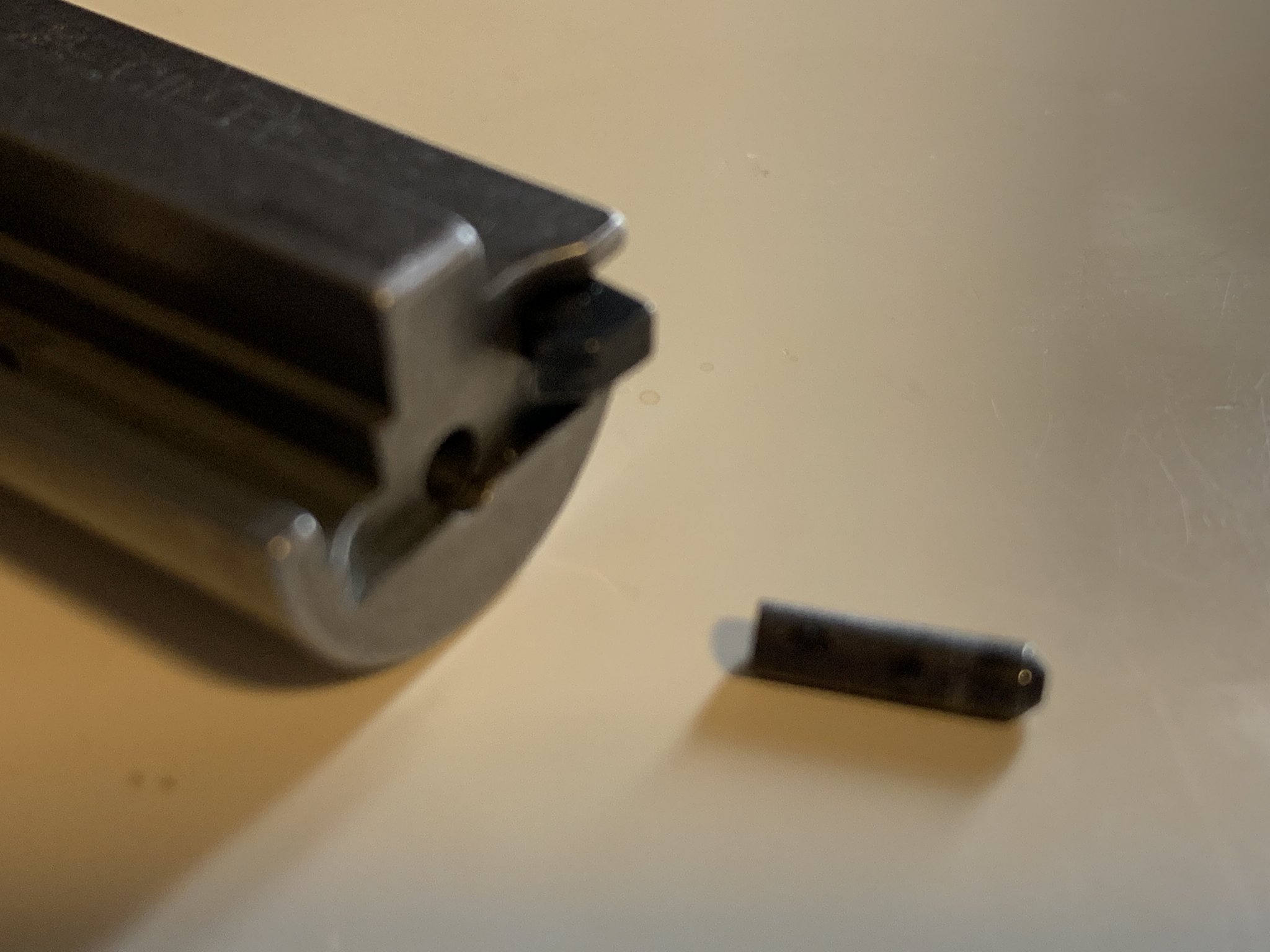

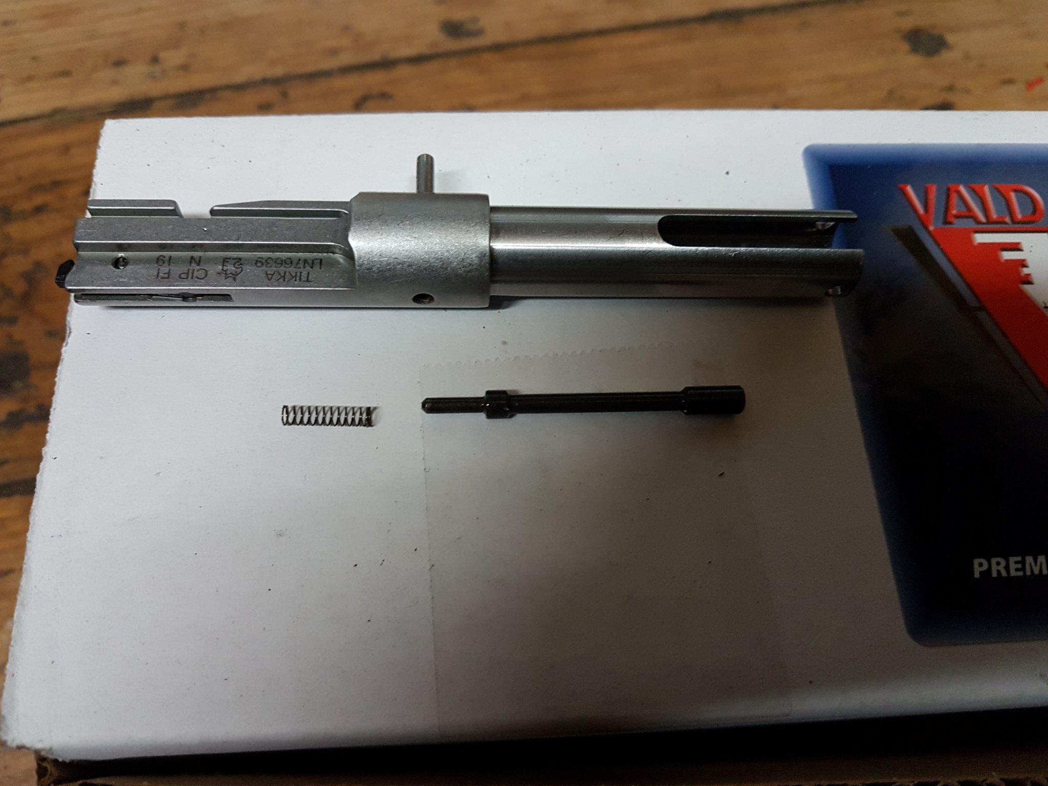

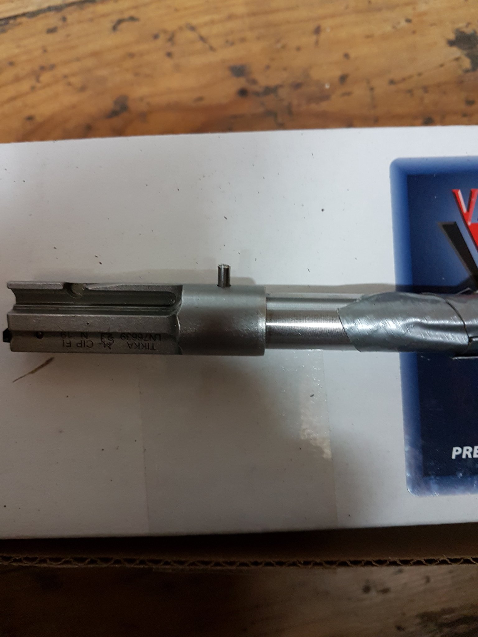

I wrapped the open rear of the bolt with duct tape to prevent the pin and spring from shooting out...added several layers of duct tape to my vise jaws to protect the bolt from marring. Punched the pin from right to left. (If viewed from the top)
@SR361 well done, thank you for posting. how hard did you find it was to punch out?
Any idea if it was an interference fit or any substance/residue left from loctite or anything?
It was fairly snug, as it should be. No glue or Loctite, but you will definitely need a vise! There is no need to drive it all the way out...just far enough for the pin and spring to clear. I'll take a pic of it removed in a sec...phone batt. croaked.
(Installing the firing pin). Be sure to depress the "firing pin" and spring with a thin screwdriver or similar device as you tap/re-seat the "retaining pin". Failure to do so will shear/snap the new/cleaned firing pin.
After complete bolt reassembly, secure in the vise and cock by raising the bolt handle. The bolt won't return to battery otherwise.

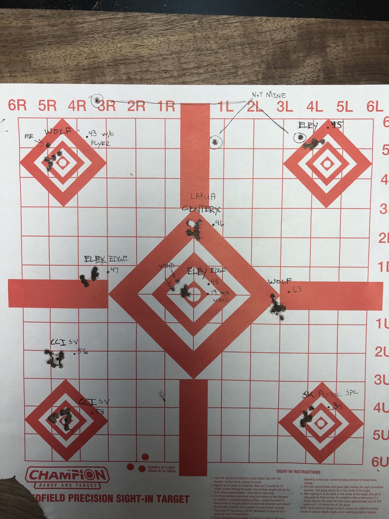

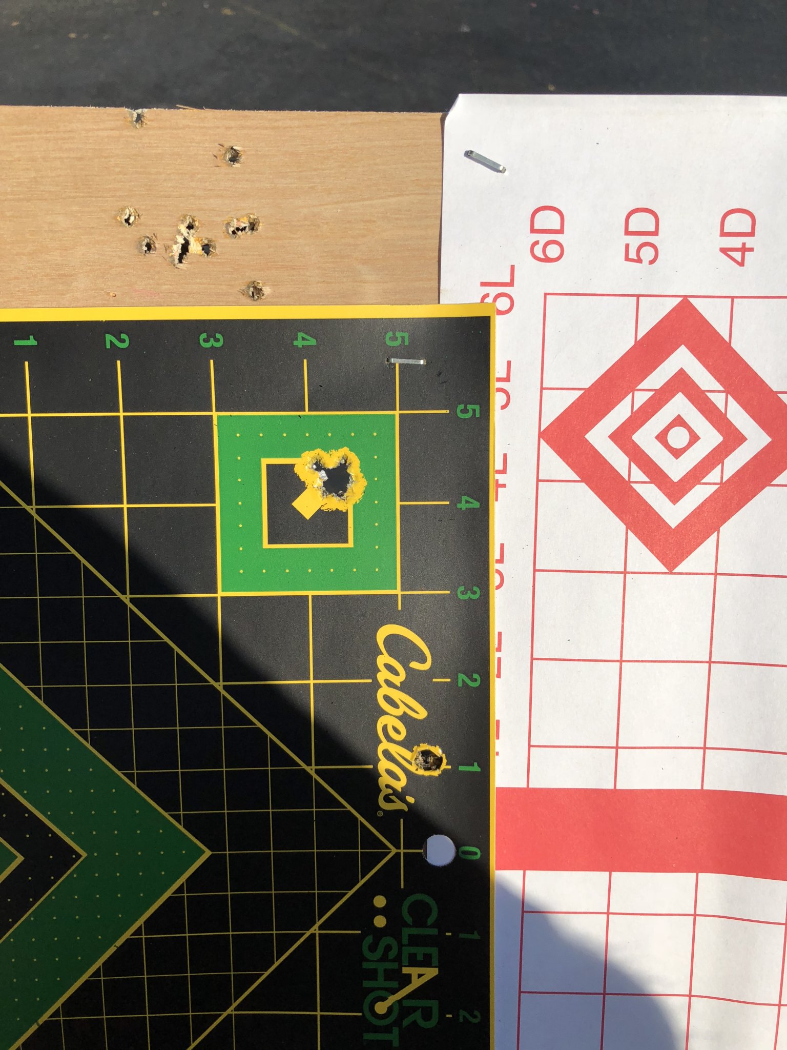

Well I got out today and shot some groups at 50 yards to figure out what ammo the rifle liked the best. I tried CCI SV, SK pistol match special, Eley Edge, Wolf Match Extra, Lapua Center x and Norma Match. The Eley, Wolf and Center x all shot about the same. I will get some photos of the target once I get some measurements on it. The wind was 5mph gusting to 15. It is really easy to see when there was a gust. On all the better ammo the group was almost perfectly vertical based on the velocity I was getting. If I got a gust it was pushing the bullet right. Even with the gust all my 10 shot groups were still around 0.5”. Like I said I will post some pictures tomorrow. If I use some ammo with a really low SD I think this rifle would be scary accurate. I may have to bite the bullet and buy some Tenex to see what this rifle can really do.

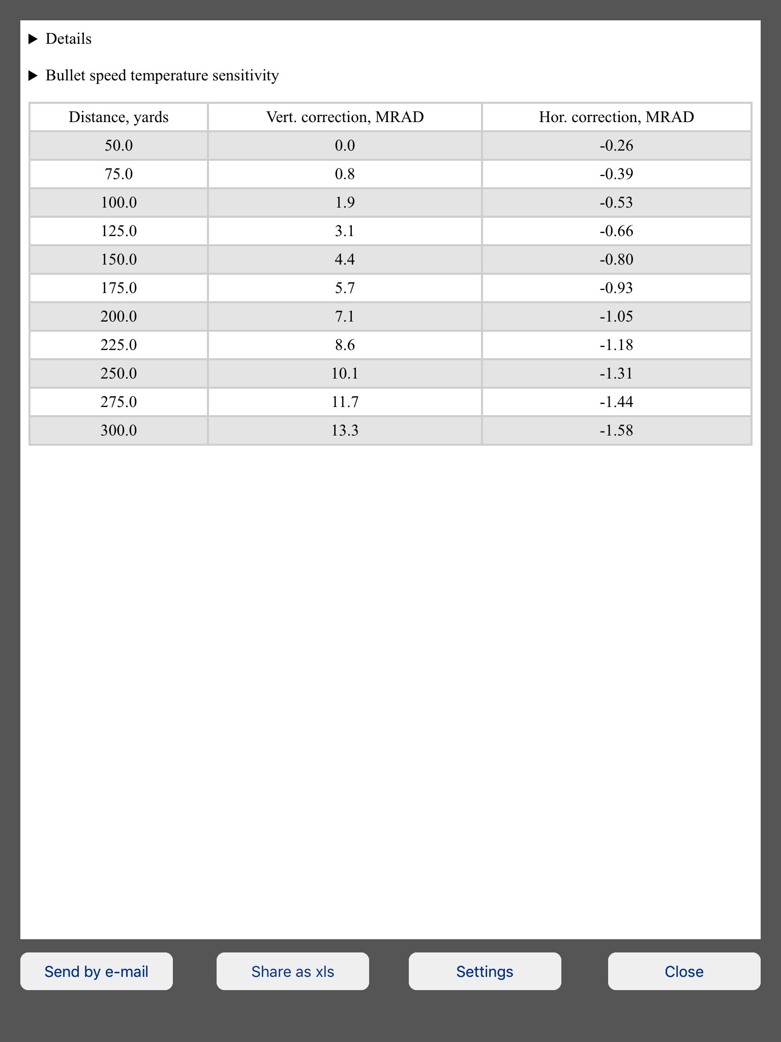

I will be doing some DOPE on the Tikka T1x with the standard velocity CCI ammo. I am going to start out at 50 and go from there. I have run two ballistic apps that are not lining up with what I am finding in the field. So I will be running targets tomorrow at 50,87.5,100,125,150,175,200 All ranges will be shot with a Leica 2000B range finder. I will have results by 1 pm eastern time.
Paul, this is what I have been getting for CCI +- 1/10 a mil out of my rifle. Eley Edge is about the same.

So here are my results. Distance seems a little off because the range I go to, I found out today after going for 22 years is way off. ( The range is supposed to be a 50,75,100,200 After using a Leica 2000b I found out it is actually 47,73,96,191 ) Guess I should have checked that years and years ago.
So here is what I have
50---------0 mil
85---------1.3
125--------3.4
150--------5.1
175--------6.6
191--------7.6 mil
I set up targets at these exact range found intervals, I was shooting CCI standard velocity. I was shooting three shot groups for vertical correction only. In today's wind, it would have been stupid to shoot for groups.
The set up I have is a Tikka T1x, Timney 2 stage trigger, DIP 25 moa rail, and Burris Xtr2 5x25 SCR. This was shot suppressed. I had a 5-22mph wind at my 430.

Paul, what elevation are you shooting at? Your dope looks a lot different than mine using CCI SV. Looking at yours you need almost a full mil more elevation at 150 yards. I wonder if it is just lot variations in velocity.
