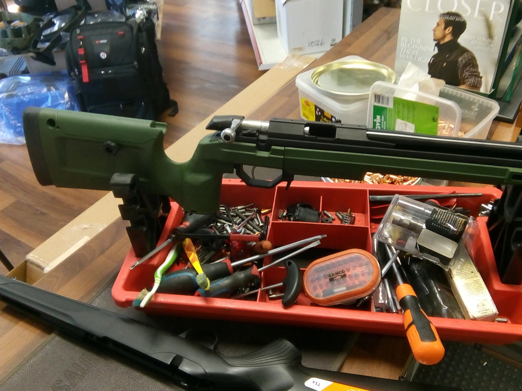

There are no magazine yet for the AICS chassis in to Tikka T1X, still waiting the first one to drop in the market.
I just drop the T1X in to a KRG Bravo, to see what it looks like and would the original magazine feed the ammo, if the chassis is mounted.
Magazine lips are in the right place when i tryed that, but there is nothing that holds the magazine on the place.
AICS 22lr magazine or adapter is the thing what people are waiting.
Adapter might be easier to do than the whole magazine for the AICS system chassis.

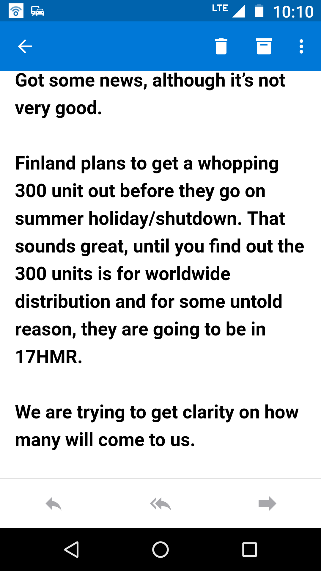

Not sure where the good news is in this I just got from Whittaker's.......shoot should of did another form 4.…probably would of beat it here....
I called uk distributor and was told they have shipment of .17, enough for maybe 1 per dealer, then more in September and the remainder in October. They said they won’t have .22 until October.
The also said there was no recall. Delay from now on is due to August shutting down in Finland for holidays.

This KRG chassis is using AICS magazine, so now you are not talking the same thing.
That T1X can be used with any Tikka T3/X chassis, that use that normal Tikka magazine, not CTR, Wildboar, Artic, but all the other Tikka models it is working.
Aftermarket chassis, like GRS is ready to drop in this T1X rifle, and there are few other too, but GRS is one of the best, that use the factory Tikka plastic bottom metal.
Stockys have plenty to choose, just remember, do not choose CTR stock, because that model use different magazine.
https://www.stockysstocks.com/stock-finder/tikka.html
And i bet my balls off, that there will be magazine, or magazine adapter later from some manufacturer, and then this T1X rifle can be used
in any AICS magazine feeding chassis.
