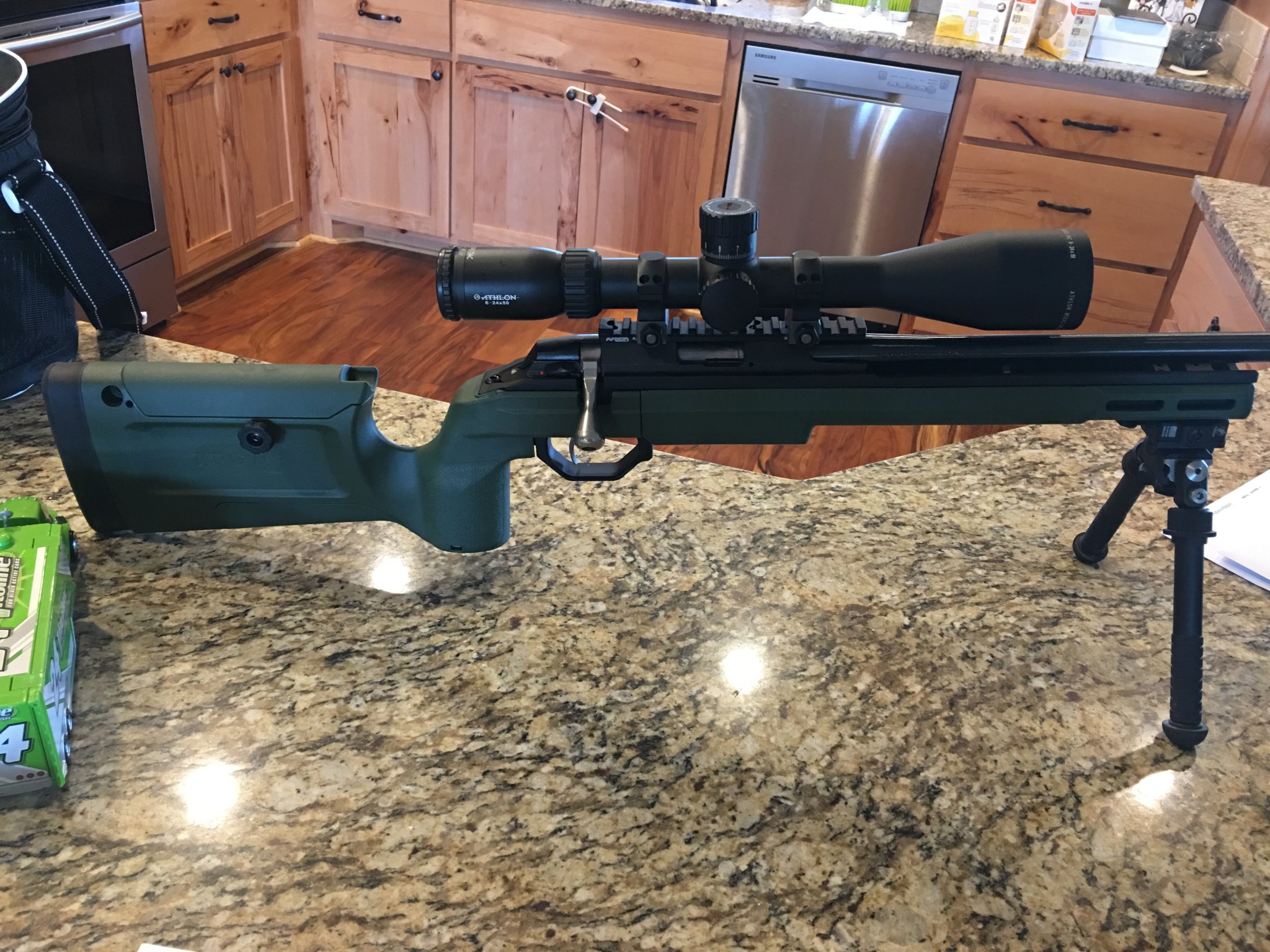

Here's things coming along today... I didn't go for the arca rail, to keep some costs down... I went with the Atlas BT46-LW17 and will just connect it to the L2 rail up front.
7094240
The cheapo compact kiddie stock... would anyone buy that? I guess it'd cost nearly $25 to ship, and probably only sell for like... $30.

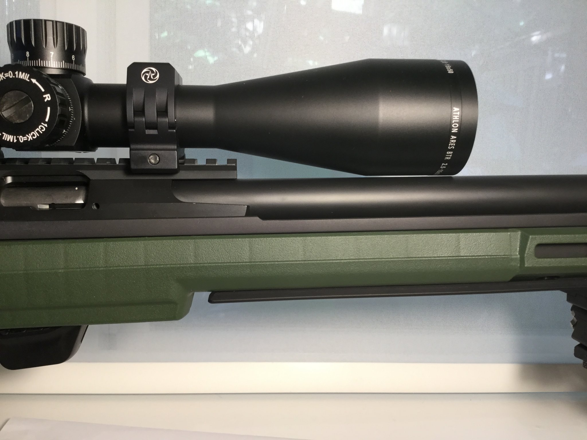

I thought a pic might help explain what I’m getting at. On both my rifle and my daughters the front of the pic rail isn’t used and forces a higher mount in order to bring the scope back where it needs to be. Mine actually fits me about perfect. Hers and my wife’s don’t. I either need to do away with the rail and get some rings or get a cheek riser for them.

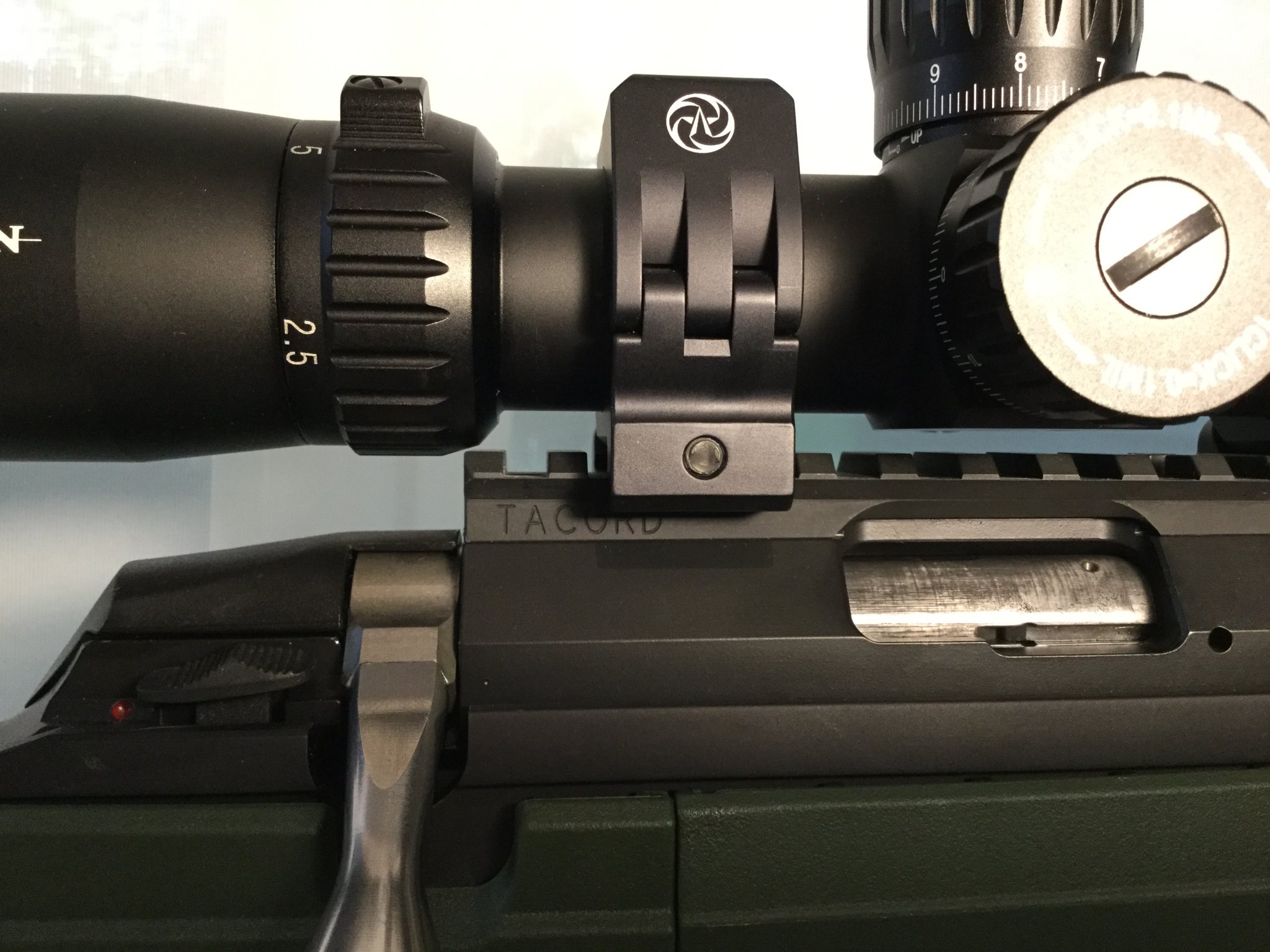

@JSchell1309
They are the X-Low ones. They bring the scope way down about f*ck-all millimeters off the barrel (pic below). Lol.
Thanks for the photo, didn't realize you are using an aftermarket larger OD barrel. Setup looks about like mine with scope gap.
Area419 rail, ARC X-Low rings, and stock barrel gives me a gnats ass gap between the objective and the barrel.

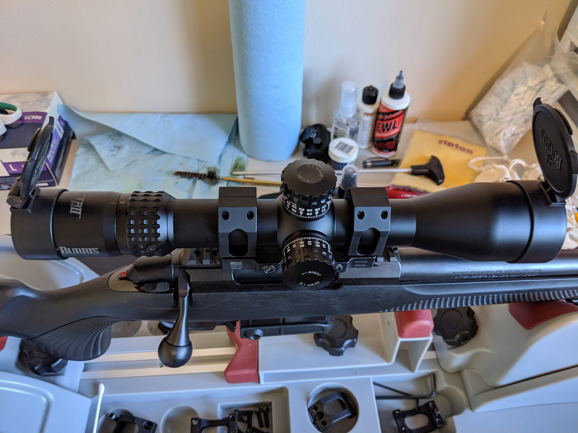

On another scope I had, I encountered a similar issue you had where it barely cleared the rail (1mm). Current scopes don't have that problem -
7094486

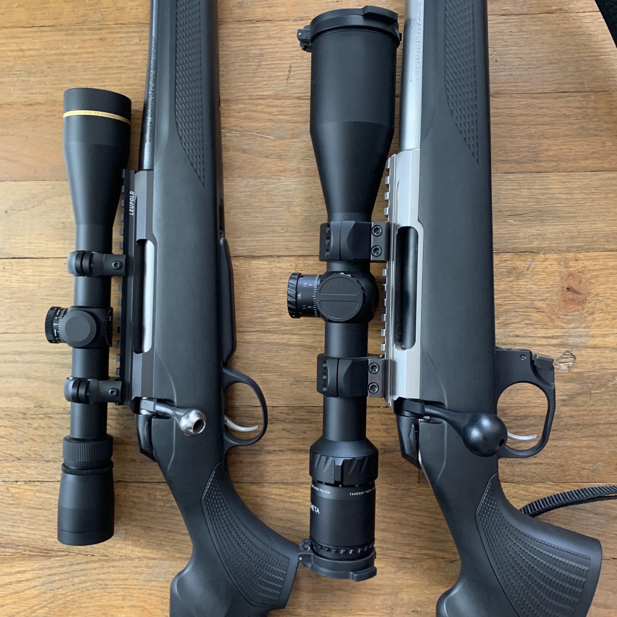

Anyone actually needing the extra room the extended rails provide?
You can see in my below photo I am using the extended portion of the rail. This allows me to space the rings farther apart on the scope as well as fitting the bubble level in there. This is set with proper eye relief in prone with the PST Gen 2 5-25 scope. I also have max LOP spacers in the Bravo stock (tall with lanky arms)
I may be able to move the front ring all the way back against the scope turret housing and keep it on the front rail over the receiver. However, i opted to space them out for better scope support.
Reactions: nakoa01 and 260284
I’m 6’2” 195, so probably fall in that lanky category. I use to have my scopes way forward, but started mounting my rifles/getting my cheek weld in a more neutral position. I am up in the air which pst I’m going to put on it I have the 3-15 and the 5-25. Either way they have a lot more room than my tt315m in front of the turrets.
Although I appreciate the above examples of why an extended rail is useful, I on the other hand prefer them a little shorter. Both the Area 419 and Tacord could do with a shorter rail option that eliminates two of the rails out front. I’ve tested several of my scopes out on this rifle before going back to this Athlon, and as you can see the forward rails are useless for me. This is the case with all the scope/rings setups I’ve tried with both the 419 and Tacord rails. With this specific setup, moving the scope forward causes the magnification ring to hit the back of the rail, and moving the scope back causes the bell to hit the front of rail. This is where the shorter DIP rail has the advantage, but I have to change my rings to the NF .885 Low. No biggie. Looks about the same and is more versatile.. I just wanted the extra 5 MOA of cant with this rail for no extra reason other than gaining about an extra 1.45 Mils (~25 yards) of dialing haha.

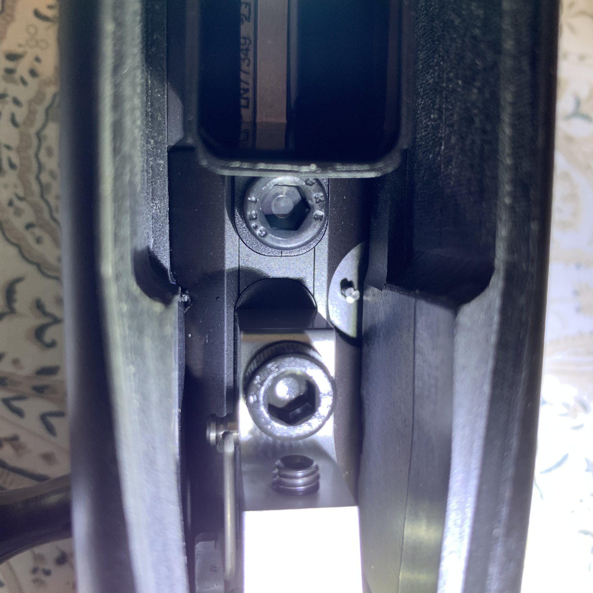

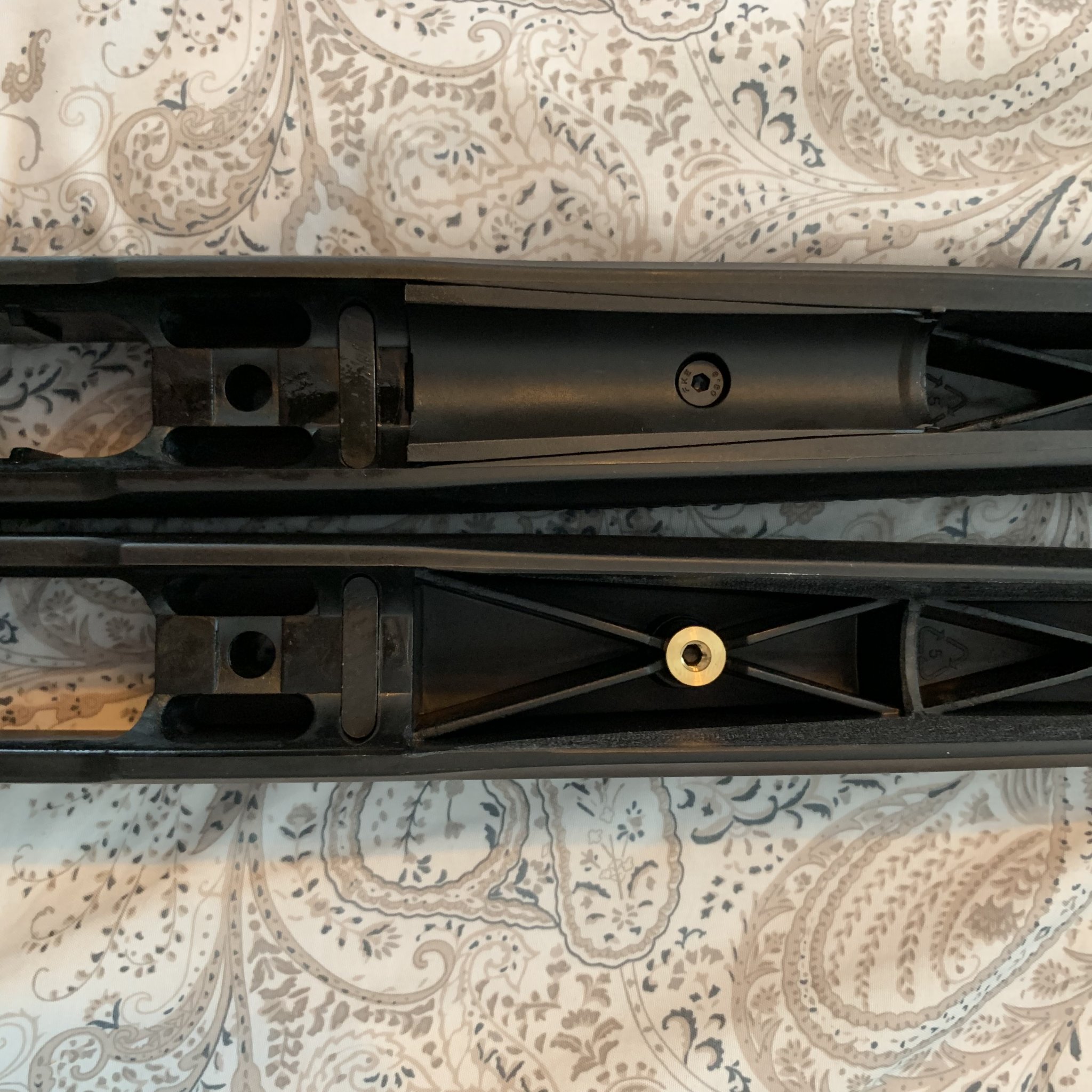

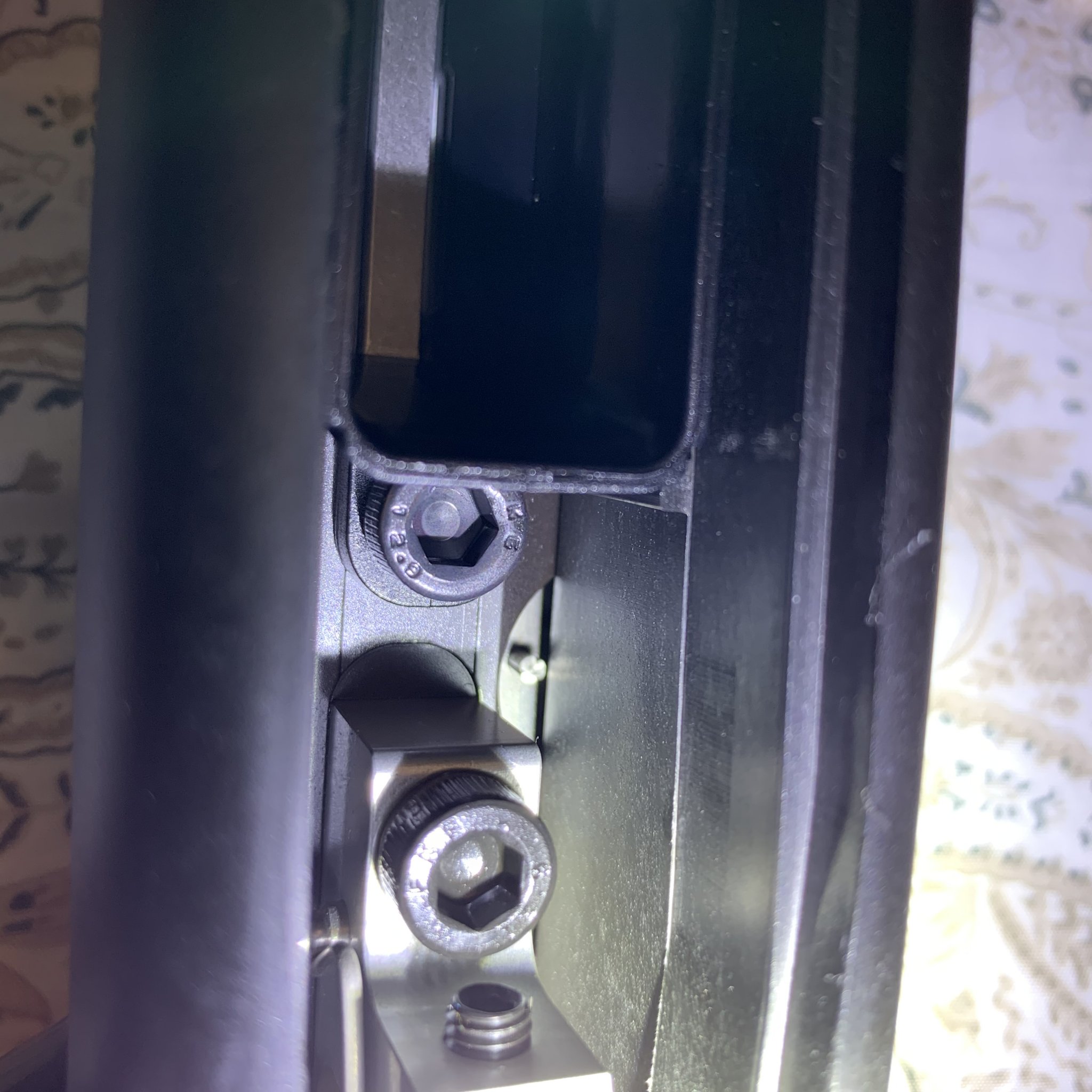

I just put my T1x in a CTR stock on my lunch break and now I’m confused. I thought someone said that things would need modified.
What needs done for the bolt catch pin?
Any benefits to moving that spacer/shroud piece in front of the action?
7095117
7095118
7095120
@Lmatt - pretty sure people were talking about aftermarket chassis. In my case my T3x CTR does not fit the T1x Bravo chassis and same going the other way. The pin hits the chassis. Sure it can be modified with a Dremel but it’s not a simple drop-in fit.
I thought someone mentioned that a factory tikka T3x stock needed modified for the T1x to work. Because the bolt stop/release is in a different position and there was some sort of issue with the pin I took a picture of. I think it was mentioned about 5 ish pages back. I guess I will have to go back and look.
IIRC, it was for aftermarket stocks fit for T3x actions. Tikka's stocks, except the Tac A1?, are interchangeable with other Tikka stocks.
From Tikka's webpage for the T1x.
"ACTION
The action shares the same bedding surfaces and inlay footprint with the centerfire T3x rifles."

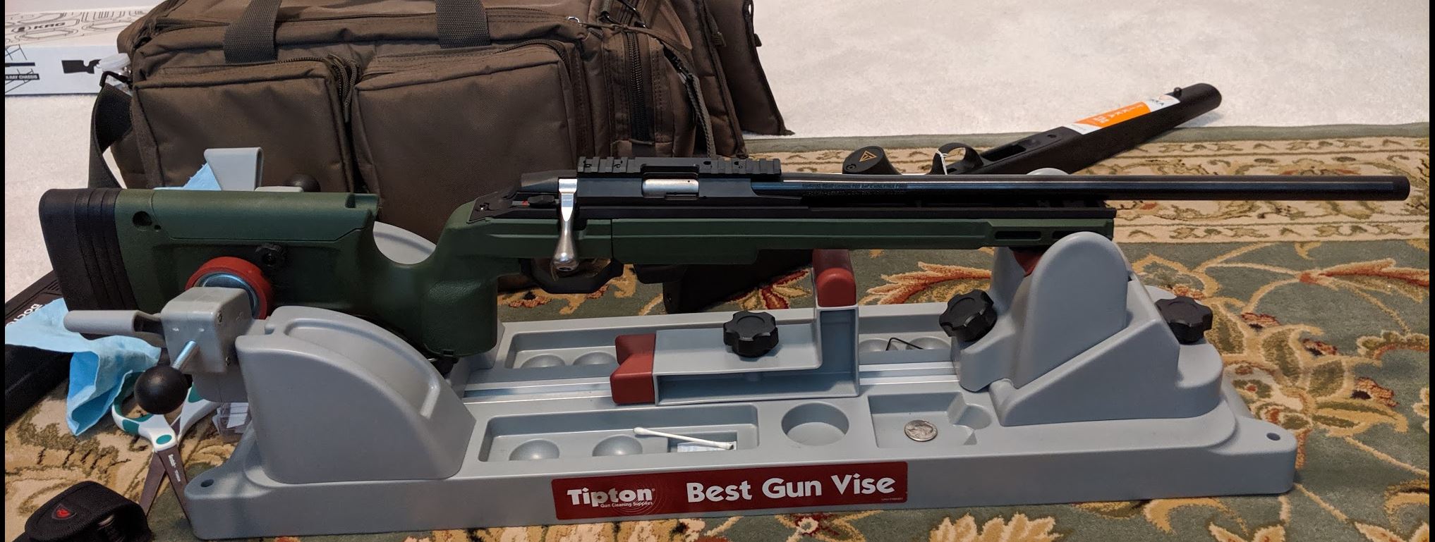

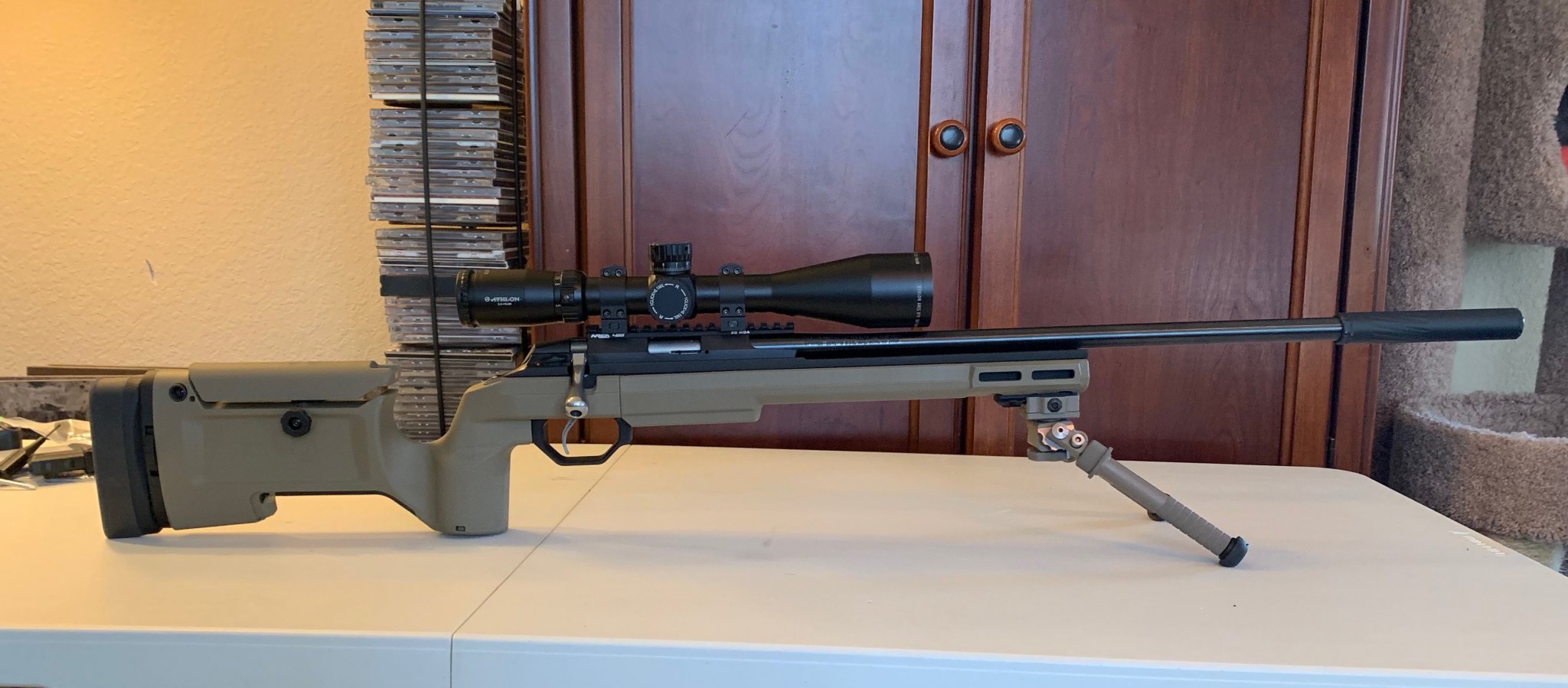

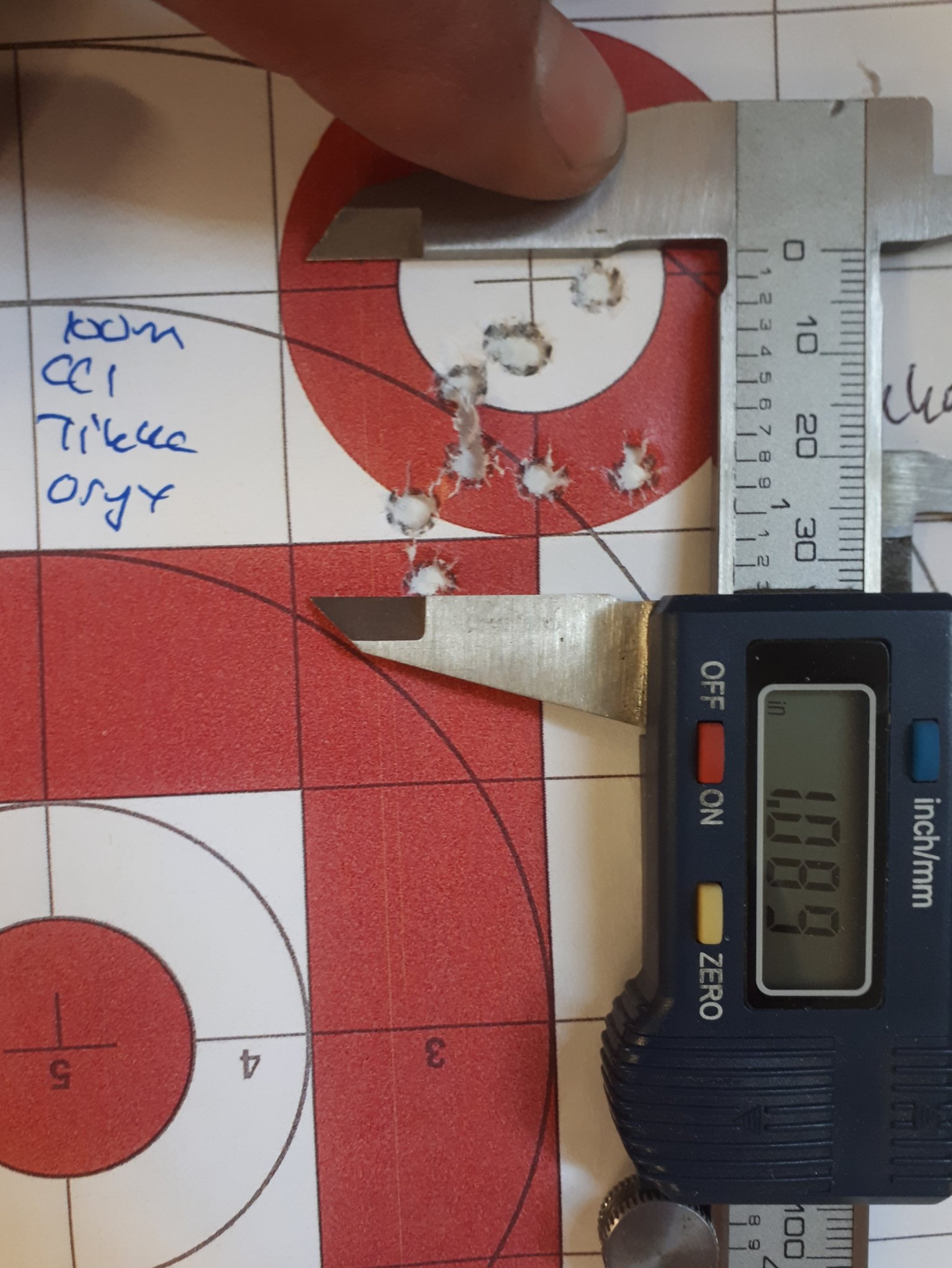

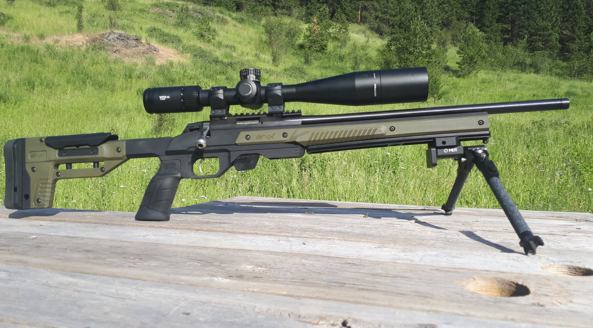

Just installed by Tikka T1x into the Oryx chassis. Just trip to the range, shoots great despite the windy conditions. Definitely likes the Action screws torqued pretty tight. Just over an 1 inch at 100m with CCI SV, shoots SK Rifle Match nicely as well. More ammo testing in the works. Backed out the trigger screw and the trigger is down to about 1.5 lbs, typical excellent Tika trigger. I running an Area 419 rail, using Burris rings and a Vortex PST Gen 2. I installed a generic 12 inch Arca rail on the bottom of the forend. I'm liking the Oryx chassis in this configuration, poor man's ACC?. I will probably get another Tikka and keep it in a factory stock to match my hunting rifles.

Do you have an Arca rail on that?

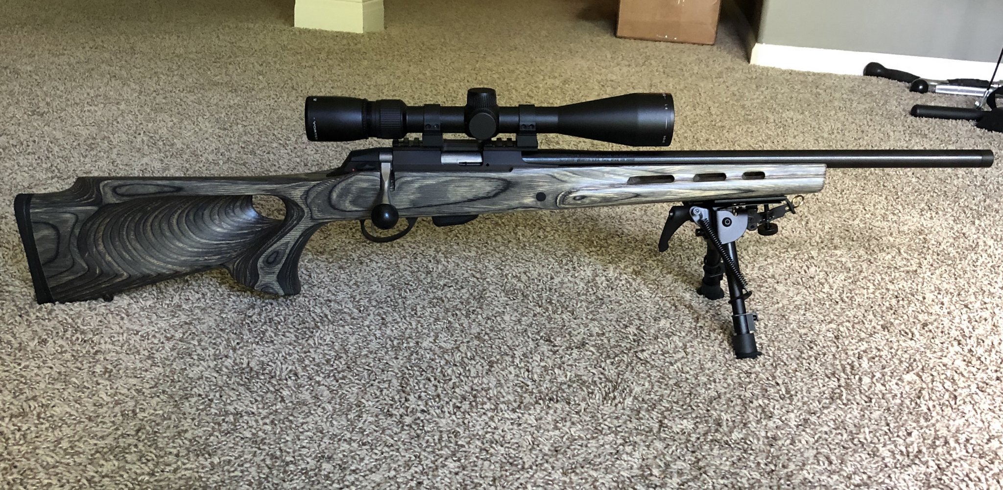

This is a T1x in a Boyd’s stock, which I had originally purchased for an older T3 I have in .243.
I had to drill a hole for the trigger guard tab (WTF is the purpose of that thing, btw?) and I had to dremel out a small amount of material to get the mag well to fit, and then a little fine tuning to get the mag to drop freely. Easy modification. Hopefully some T1x stocks will start hitting the market.
The Vortex Razor LH 3-15x with G4 reticle is a great little (~16 oz) scope for this one in 17HMR...the round is impotent once it starts dropping, so I’m enjoying a simple reticle with no guilt of untapped potential. Haha

Sorry, missed the clear statement in the text. Which rail fit? I thought the fore-end was curved...
I'm using a 12 inch Arca rail of ebay, slight curve when I installed it, but works with all of my Arca attachments including a tripod with a 4 inch clamp. This Arca rail allows some flex to follow the forend.
On my Vudoo, I ran two rail sections, a 6 inch and an 8 inch, but the one 12 inch is a cleaner look.

The Arca Rail issue is what has kept me from pulling the trigger on the Oryx. The clamp slides and locks up on that rail even with the curve, eh? Interesting... ?
