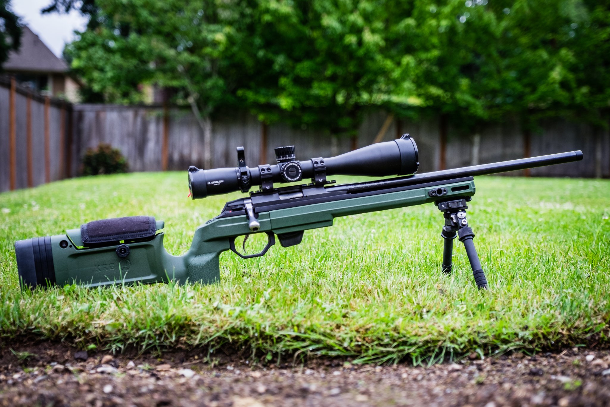

You all are on to something with this Tikka. I just picked one up 3 days ago, ordered a dip 25 moa rail that came in like a day, and hit my range yesterday. Man, it's a sweet shooting rifle. From the variety of match ammo, I'm getting great results at .5" or under. Even Blazer is shooting well.
I can't wait to put it in a KRG Bravo or Oryx chassis. I can run the same inlet as the T3 or T3x right? I see they specifically make a T1X inlet..?

If a company makes the T1x inlet for a chassis/stock you like and they have it in stock save yourself the headache and get it. The T3 can be made to work, but most will like require some work on your end to work properly.

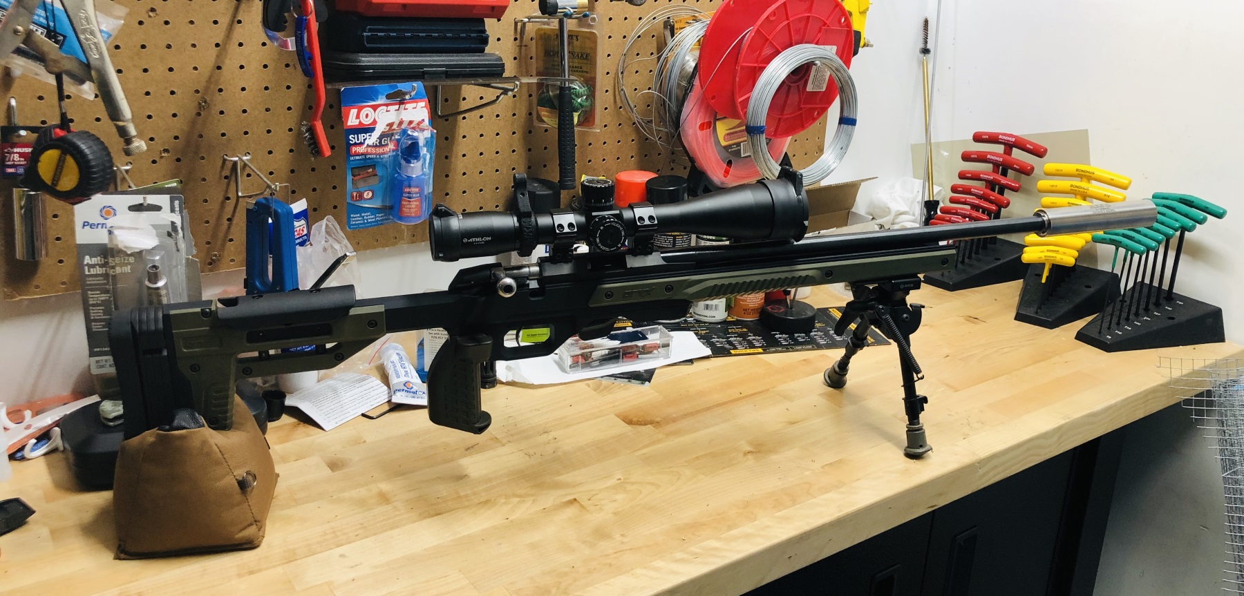

I based buying my T1x on the availability of the Bravo. Once the Bravo came in stock and I ordered it, I then began to order everything else, including the rifle. I got lucky and built it in just over 1 week.

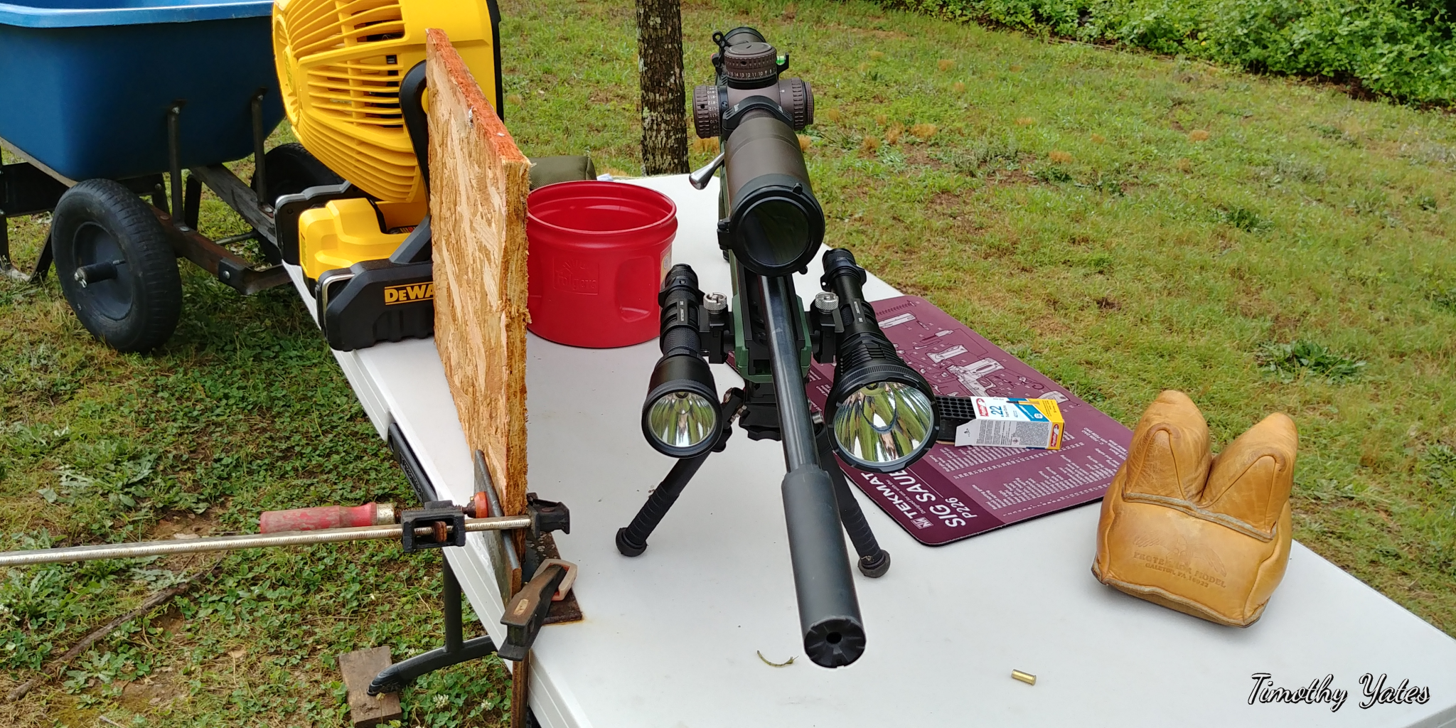

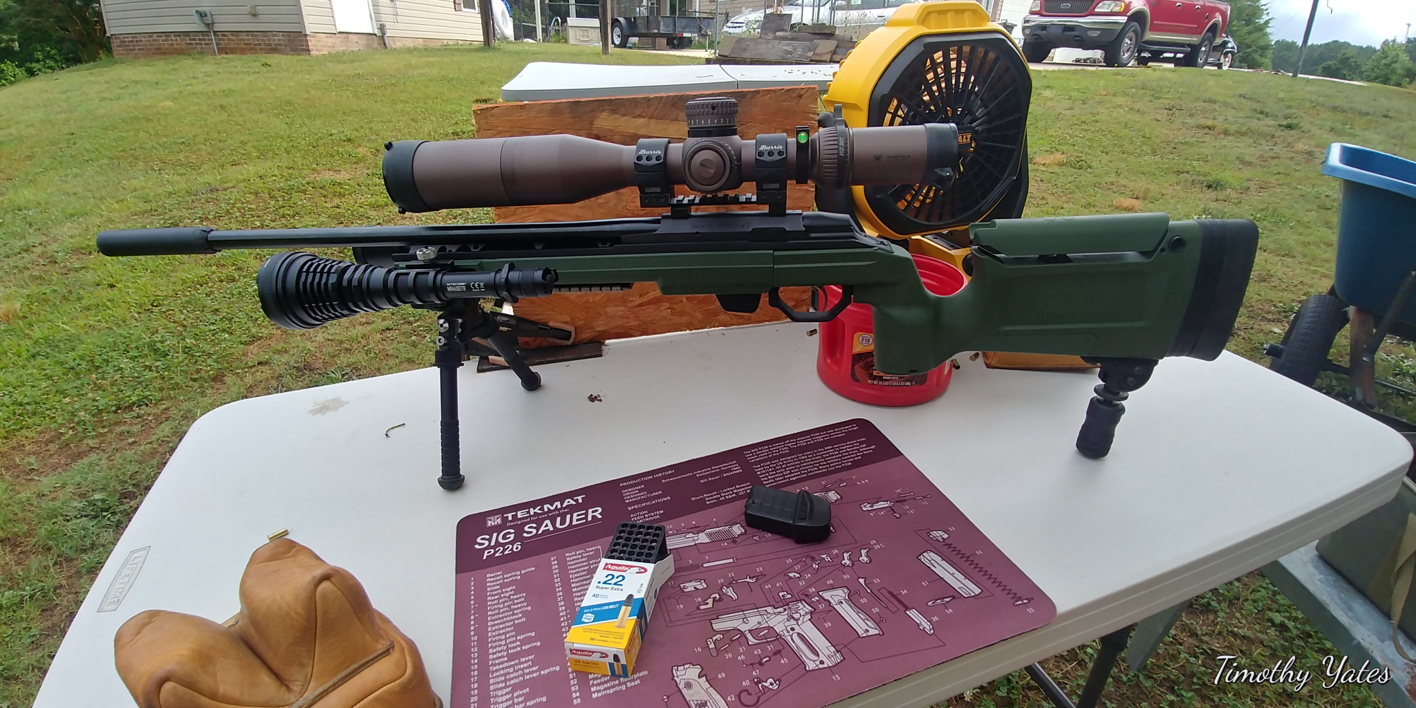

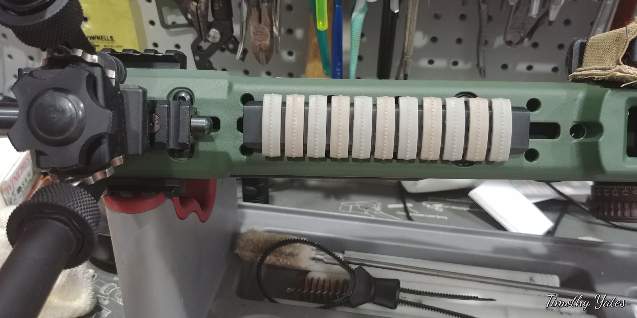

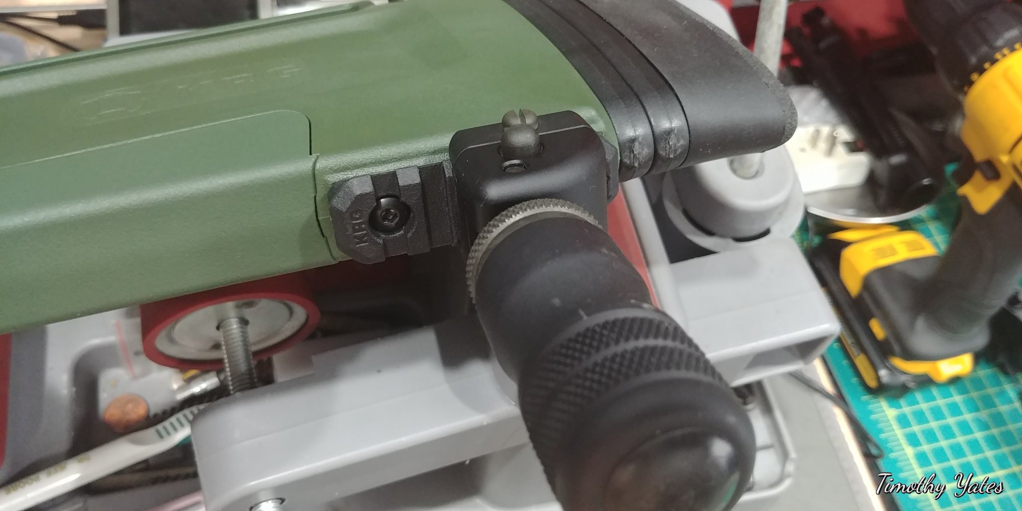

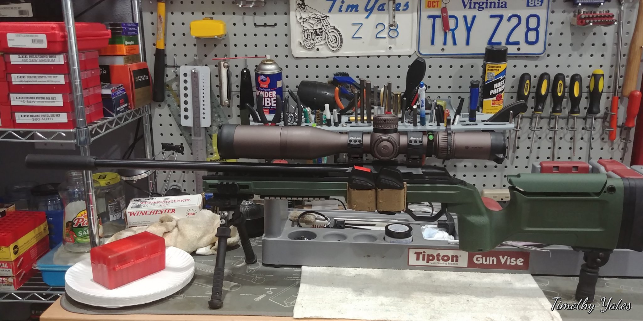

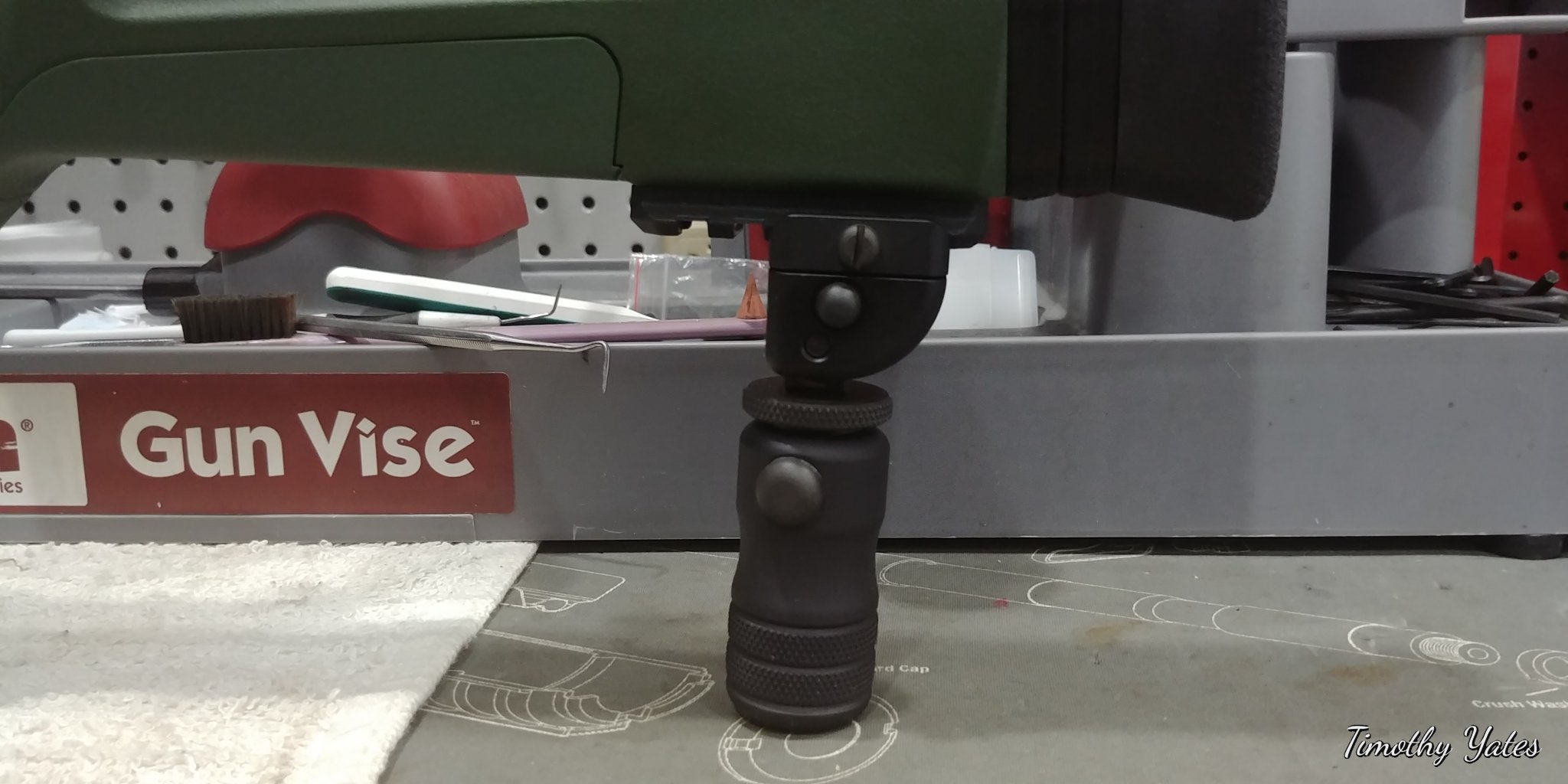

New Night Stalker photos. This is how it sits now. The monopod is pretty effective for either bench or prone shooting. I have a few extra rails so I decided to put one on the lower forearm section. I then installed some left over LaRue rail covers I had. Works out pretty good. It's there if needed, if not it's not hurting anything. Items that wasn't being used are at least on a rifle now. The KRG supplied rail worked perfect for the monopod.
What are you using for the mag holder on the side?

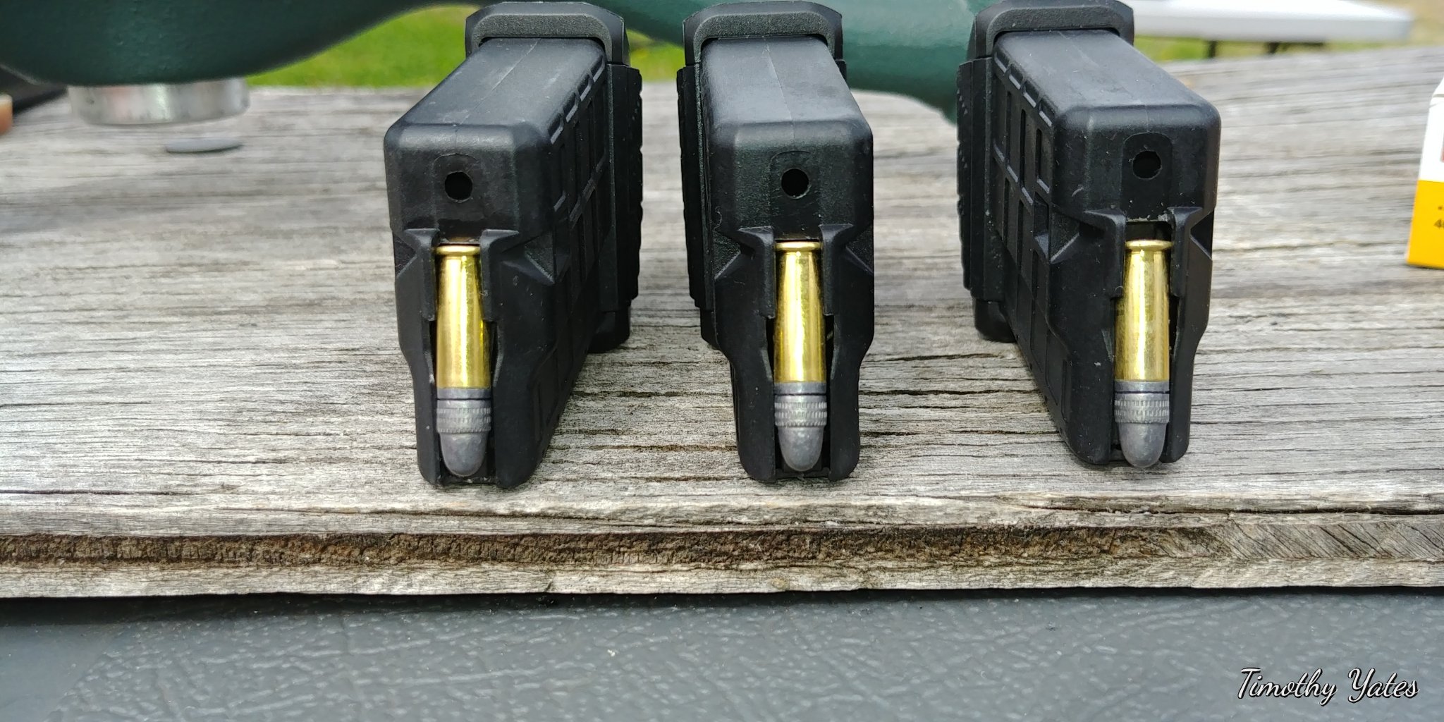

Shot a match today. Used the T1X for the first time. I have put about 600 rounds through it before the match with a few issues of FTF and FTE. So, at the match today and on 1 single stage I had 4 FTF malfunctions out of 4 different mags. Luckily I kept my composure and was able to finish the stage. But damn I was pissed. These mags must suck. Anyone else having consistent issue with mags feeding properly? Stages we shot are in the pic below.
Sure thing. Every one of them, the nose of the round tipped up and tried to feed above the chamber. It would be mid mag as well and not just the first or last round.
Dang, that's the first I heard of that kind of FTF. I had some on my first Tikka, well not really FTF but bullet shaving. I traced it to a bad mag which was quickly replaced by Beretta free of charge. Not sure on that one as the mags should all be the same as far as injection molded mags go. I'll post a photo of a bad mag. The spring is so weak it won't hold the round in place.

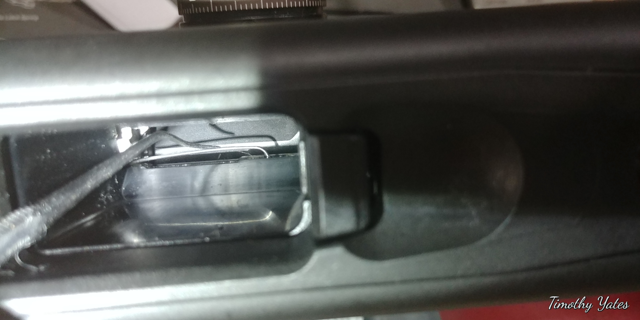

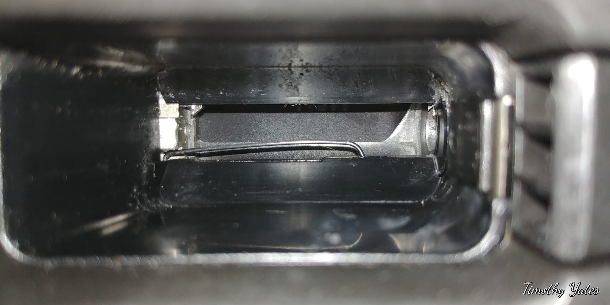

As for the FTE, I guess that's an ejection issue? If so I had that problem too on my Tikka #2 22lr. See the photos above for what I did and it has worked 100% after that. Just call me lucky I guess. My FTE rate before the bent ejector was probably 30% at least, yeah 3 out of 10.
The magazine on the far right has the weak spring. Notice how it doesn't even hold up the round. Not saying or insinuating this is your issue because your FTF is not the same as I had but it's still something to look for.

I wish someone would make an after market ejection spring ! ?
Yes!!!!
I bent mine like others, a little too much, and it definitely ejects better. Unfortunately I got a little over-zealous and bent it a little too far and not it interferes with feeding?. After 100 rounds it seemed to smooth out and still eject fine.

Oryx chassis, Harris SBRM w/ RRS Clamp, Athlon Ares BTR 4.5-27 in some cheapo rings, Form 1 can. Swapped the grip out for an Anarchy Outdoors penguin, but not sure if it'll stay or not.
Waiting on Area419 30 MOA base, Sterk swept bolt handle, Sterk bolt shroud, and yodave spring.
