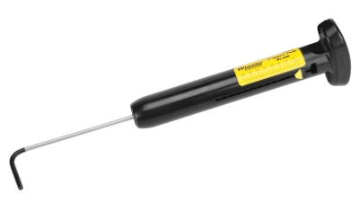

Join the contestThat's a desirable trigger pull for many running this set up. If it's safe, I'd run with it. Waiting on my new spring to get here. I don't have a trigger weight scale either. I guess it's time to get one. ?
Safe depends on your rifle. I consider safe when you can close the bolt with moderate force and not release the sear.
Jeff, time to step up and get that scale.
I have all my triggers at 1 1/2 lbs. I was able to get that pull weight without changing out the spring on my 3 Tikka’s and the 2 of my friends I adjusted. Just bump your stock of the floor a few times and see if you can get it to fire (while unloaded of course ?). I don’t think you will have any issues though. All mine function great at that weight.

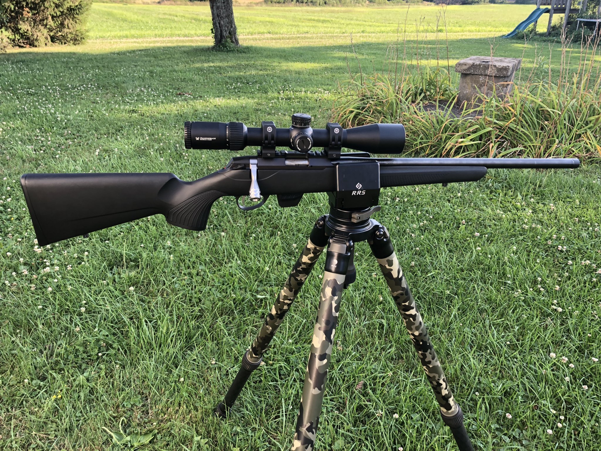

I, too, like 1.5# pull. We NEED an updated photo, 013...

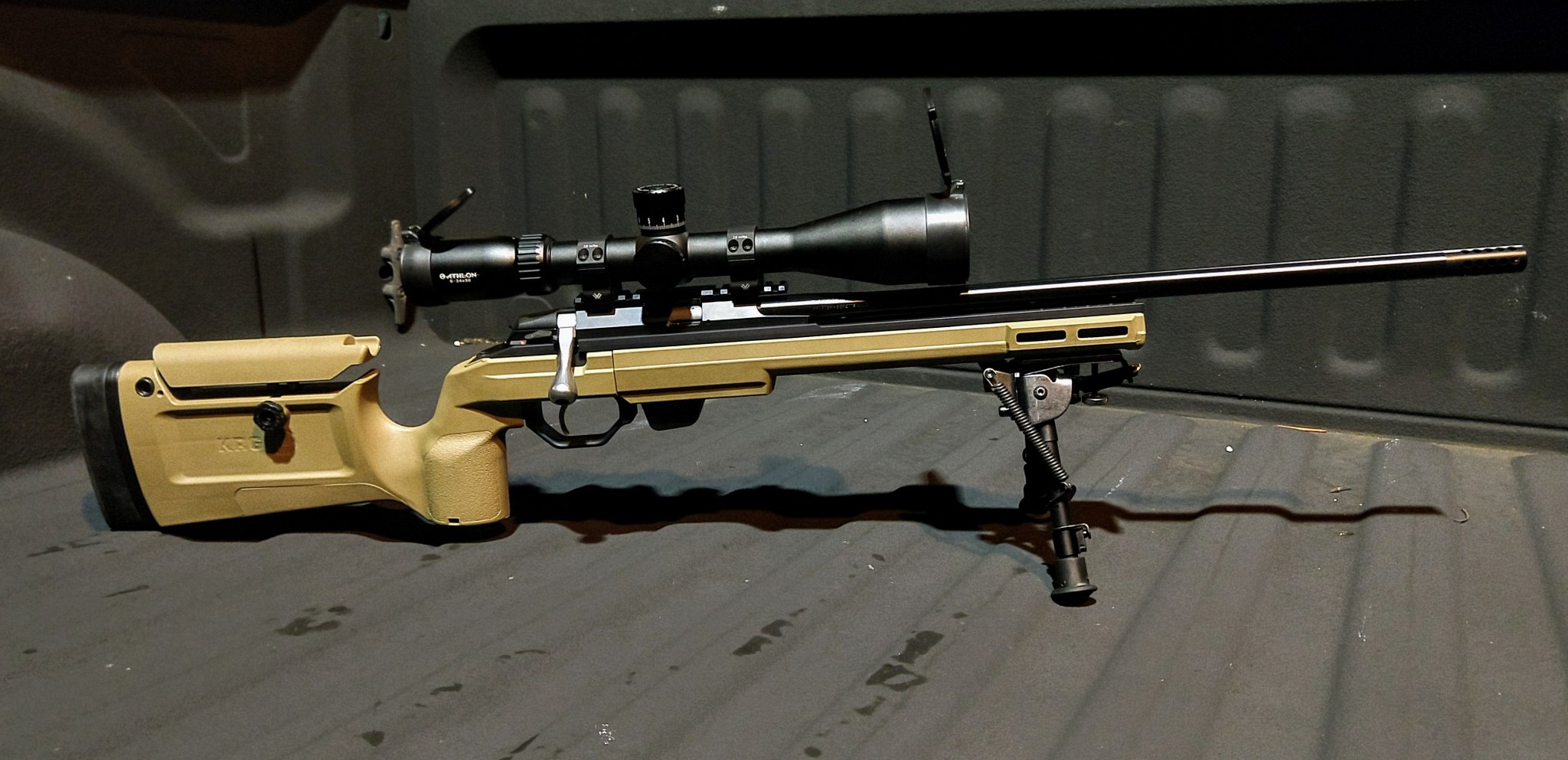

You guys running your Bravo's torqued at 65 in/lbs? My factory stock broke at 30.
Just take the plastic forearm off and you can get to that front screw no problem
Thanks for the tip @eightyeight mag, let me give that a try.

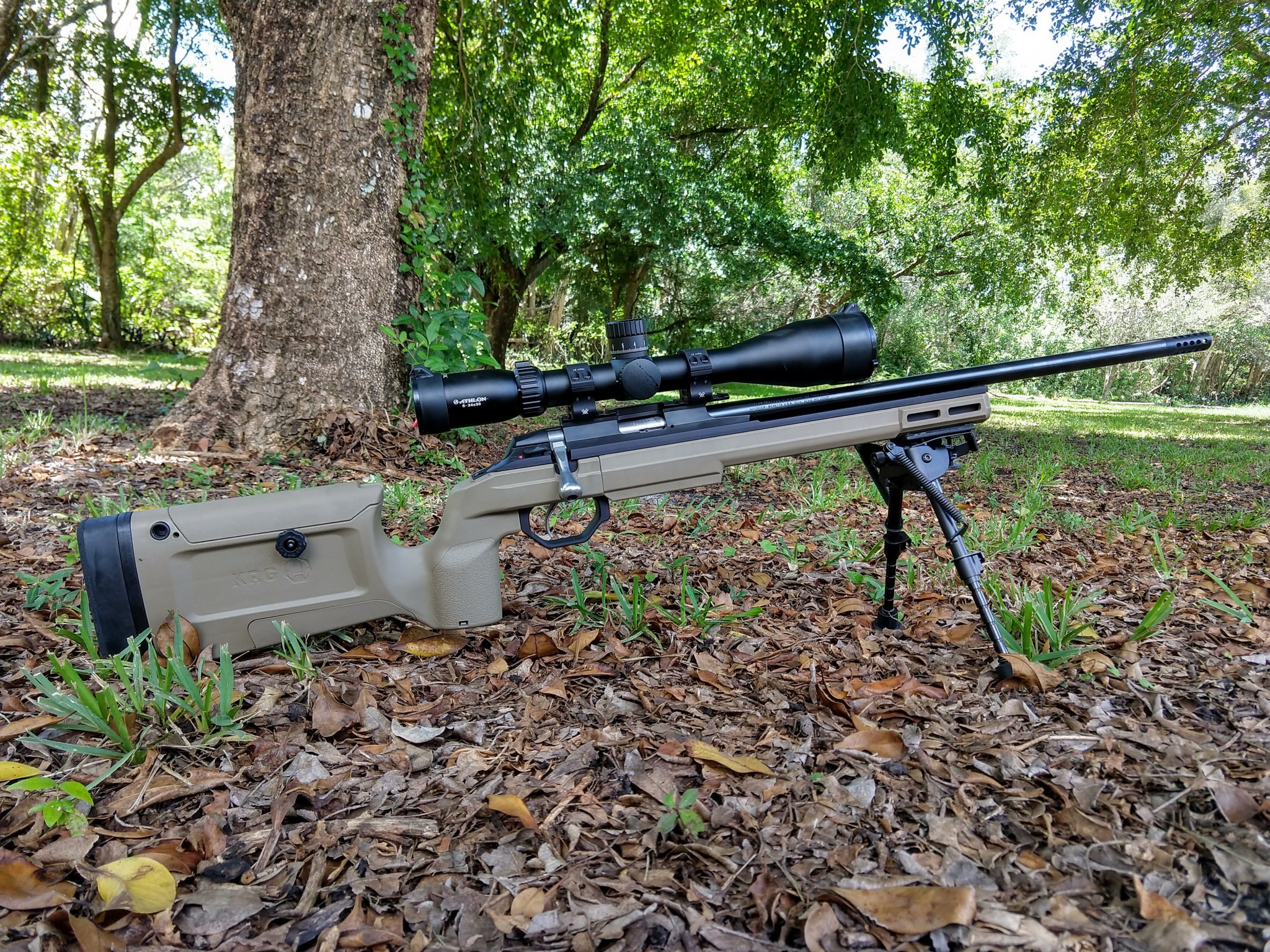

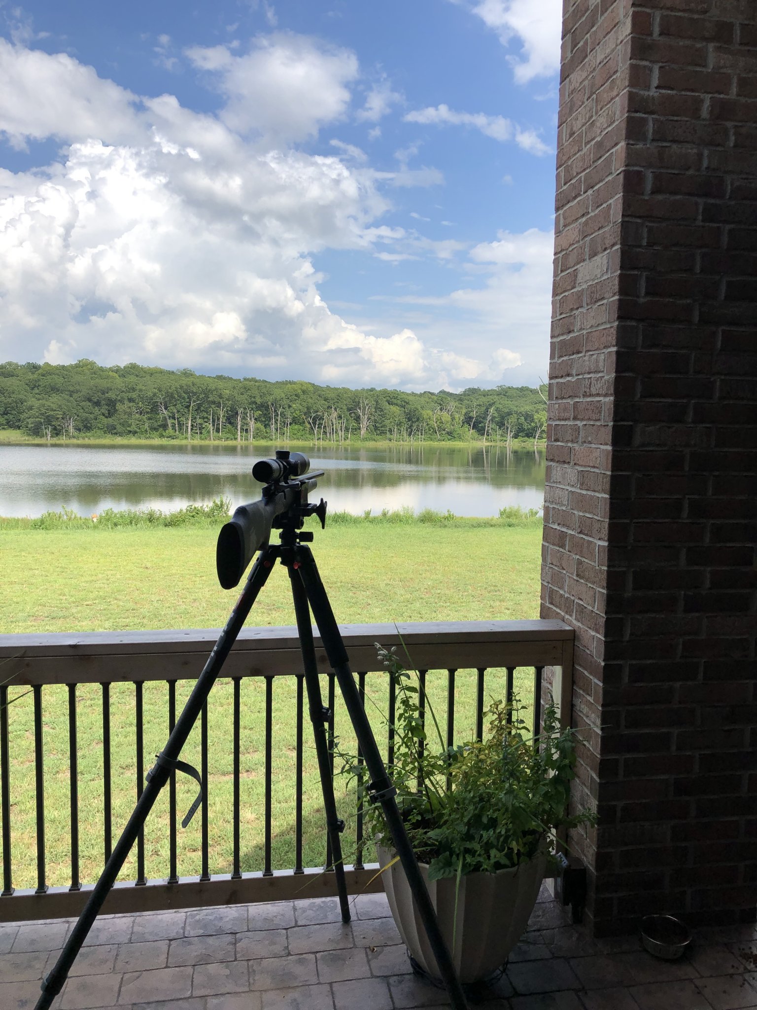

New favorite pastime is shooting stumps off the deck. Stumps at 60 yards to 360 yards. Water sure does make it easy to see misses. No wind today. SK Rifle Match hitting a 4”x6” stump at 296 yards was pretty easy. 47 MOA up from 50 yard zero.
This worked like a charm! Didn’t realize until you pointed it out the forend came off.
