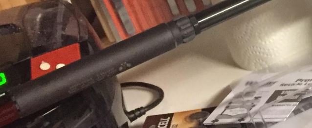

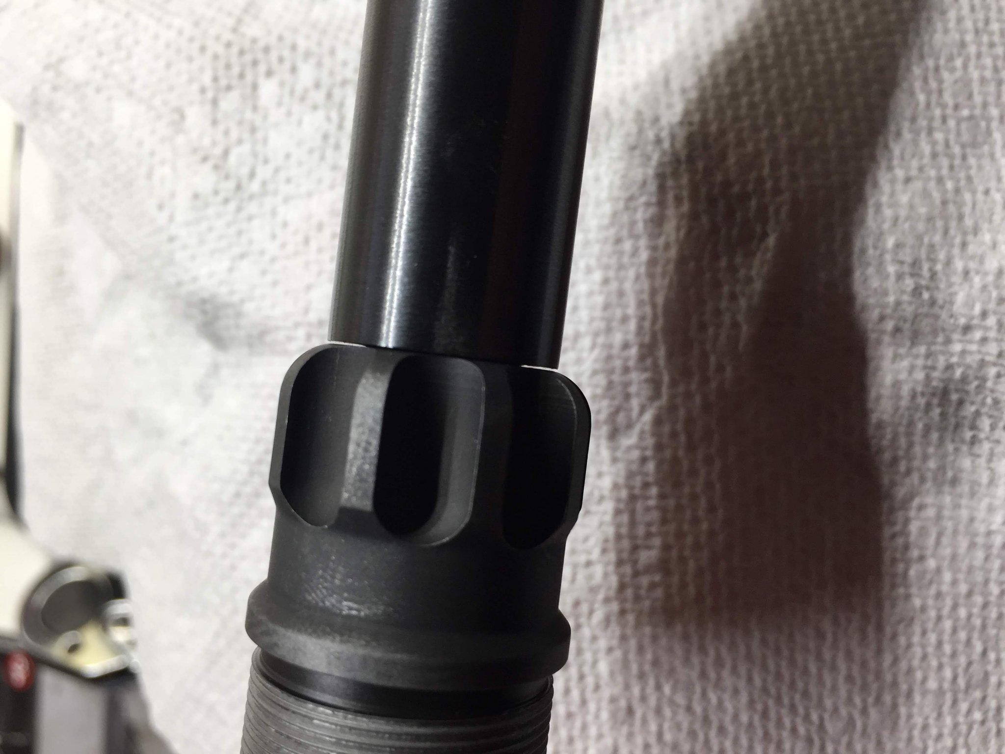

For the threads, I tried putting my Silencerco Spectre II on it and when getting tight, it didn't quite hit the shoulder of the barrel. It was bottoming out internally, which is not recommended since it could cause the baffles/exit to not be concentric to bore. I had a small spacer from using on my ARs and put it on the threads. This allows me to get the silencer tight without bottoming out the threads. Might be worth looking at getting a spacer if that's an issue for you? No issues shooting Bulk Winchester through it. Need to try some subsonic stuff.
If your spectre isnt threading all the way down, there's something wrong. Do your other hosts have really short threads? I'd bet the threads on your suppressor are caked with carbon and lead.
I run the Spectre II on a GSG 1911 host and it threads on fine. The Spectre II on the T1X would get to within about a business cards width of the barrel shoulder and stop. This was after fresh cleaning in the ultrasonic cleaner, so it wasn't carbon build up. I did some research and the Spectre II specs are for .400 thread depth. Like many here, I measured from the muzzle to the barrel shoulder at something like .492. Runs just fine with the spacer, and it seems to be an issue with my particular can. Just a heads up with others with a Spectre II. Pic attached of the can with spacer.
I run a spectre 2 with no problems. The reason the spec is .4" is because of the internal O-ring interface to keep carbon out of the threads. Longer than that just threads into the O-ring. Screw just the rear cap on and see what's going on in there.

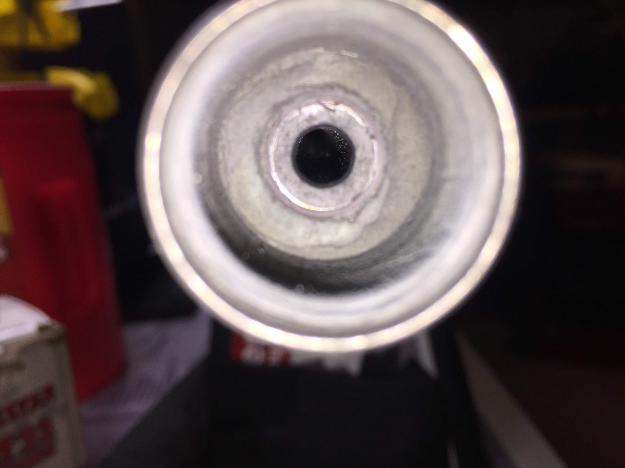

Maybe my o-ring is too fat, or I just don't want to mess anything up. I feel I could tighten it more with a tool, but I'd never be able to remove it by hand. Here's a couple of pics of it as tight as I can get it by hand. You can see a gap where the back of the silencer isn't mating to the barrel shoulder. On the inside you can see the O-ring starting to squeeze out (sorry for crappy focus). I read that if it's not mated to the shoulder, then the baffles aren't necessarily concentric since you're relying on the "evenness" of the O-ring. Kind of along the same line of thinking of using peel washers vs crush washer when putting on a QD brake. There's no guarantee of the center hole being inline with the bore. Threads are clean, though the blast chamber is dirty. Side note, anyone know how to clean the hard carbon off the blast chamber? Used SimpleGreen solution in a heated ultrasonic cleaner.

I'm betting the resistance you are feeling is the o-ring rolling over and bunching up instead of the barrel threading into the o-ring. Try putting some lube on the o-ring and trying again. Personally I stay away from the spacers since it's just something else to stack tolerances and they are a band aid at best.
I put mine in a stainless tumbler when I clean brass. Comes our very clean and no extra chemicals to deal with. If you dont have one, CLR is what everyone recommends to remove carbon.
Debris in either set of threads? Doesn't take much.
Possible slightly oversize male threads? Can you check dimensions over wires?
Agreed that you should be using the shoulder to ensure the can bore is concentric to the rifle bore.
Don't worry about minor carbon/lead buildup, doesn't hurt a thing. Brush off the loose stuff and let it go.

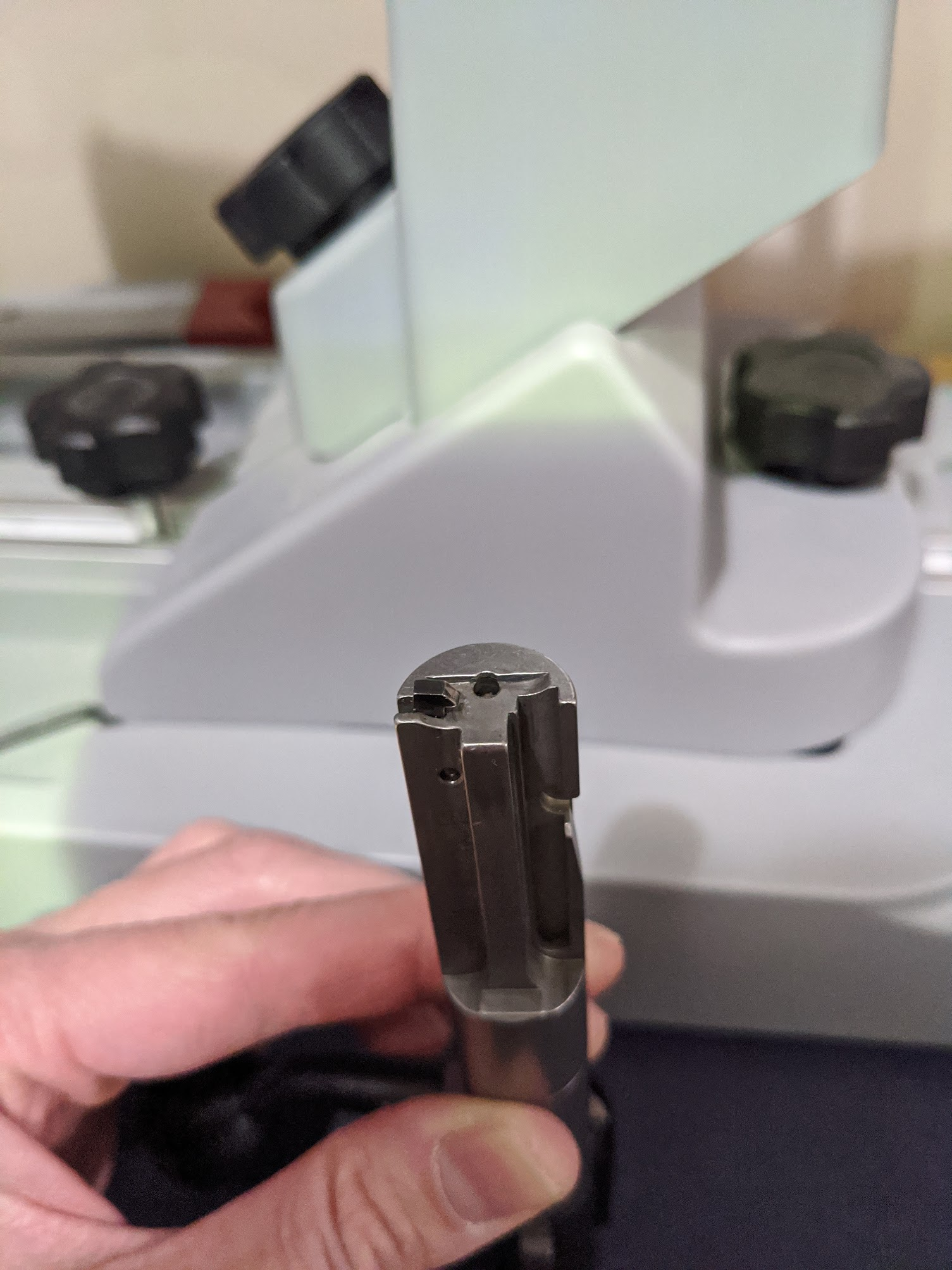

@Jefe's Dope so I went to a gunsmith today to get a polish on my IBI barrel to put in a feed ramp and he noticed that the angle in which rounds were being pushed from the magazine were off. I believe this symptom could also cause FTF which causes the bullets to flip upwards if that's what some people are having.
While having a feed ramp is definitely good (I need to bring it back tomorrow to get more of a break on the hard edge), the gunsmith noticed that the rim of the ammo was not properly seating behind the extractor. So if the rim doesn't make it behind the extractor, the extractor is just pushing the ammo at a weird angle instead of it being seated more horizontally with the barrel.
He ended up polishing and sharpening the extractor, and he also rounded the bottom edge of it so that rimfire rims will easilly roll under the extractor. This changed the angle of feeding dramatically. You might want to take a look at the extractor as the culprit behind Center-X not feeding.
Spent 3 hours with the gunsmith going little by little. We didn't want to do too much and screw up the precision of it. At this point it's not buttery smooth but it feeds a whole lot better than before. Also going slow isn't generally what people do, if I feed normally I don't notice anything.
Here's the extractor
And here's a video (if these will attach)
Notice that the round will go behind the extractor and get pretty close to horizontal. I guess no sound on imgur? But you'd hear a click when the round jumps into place behind the extractor.
This is where it gets semi-hung up, it was a lot worse before but rounding up the edge, I can possibly have him work on it some more, but if I'm not feeding slowly, it isn't that much resistance. The round no longer has a deep scratch on it, just a small imprint. It was a lot worse before.
Yeh the gunsmith took off the barrel multiple times and did a bit of polishing stone to take off piece by piece. It's hard to capture how much was done, but it's a lot more than what the picture shows. The issue is doing more means going more into the chamber, and not sure what that could cause to the precision of the barrel if we start taking it deeper into the chamber to prevent the round from rubbing at that angle. The T1X factory barrel doesn't have that much of a ramp, but I think their chamber is a decent bigger. If I take off too much and go into the chamber, do I worry about pressure leakage? Brass rupturing? I'll talk to IBI and see what they think.

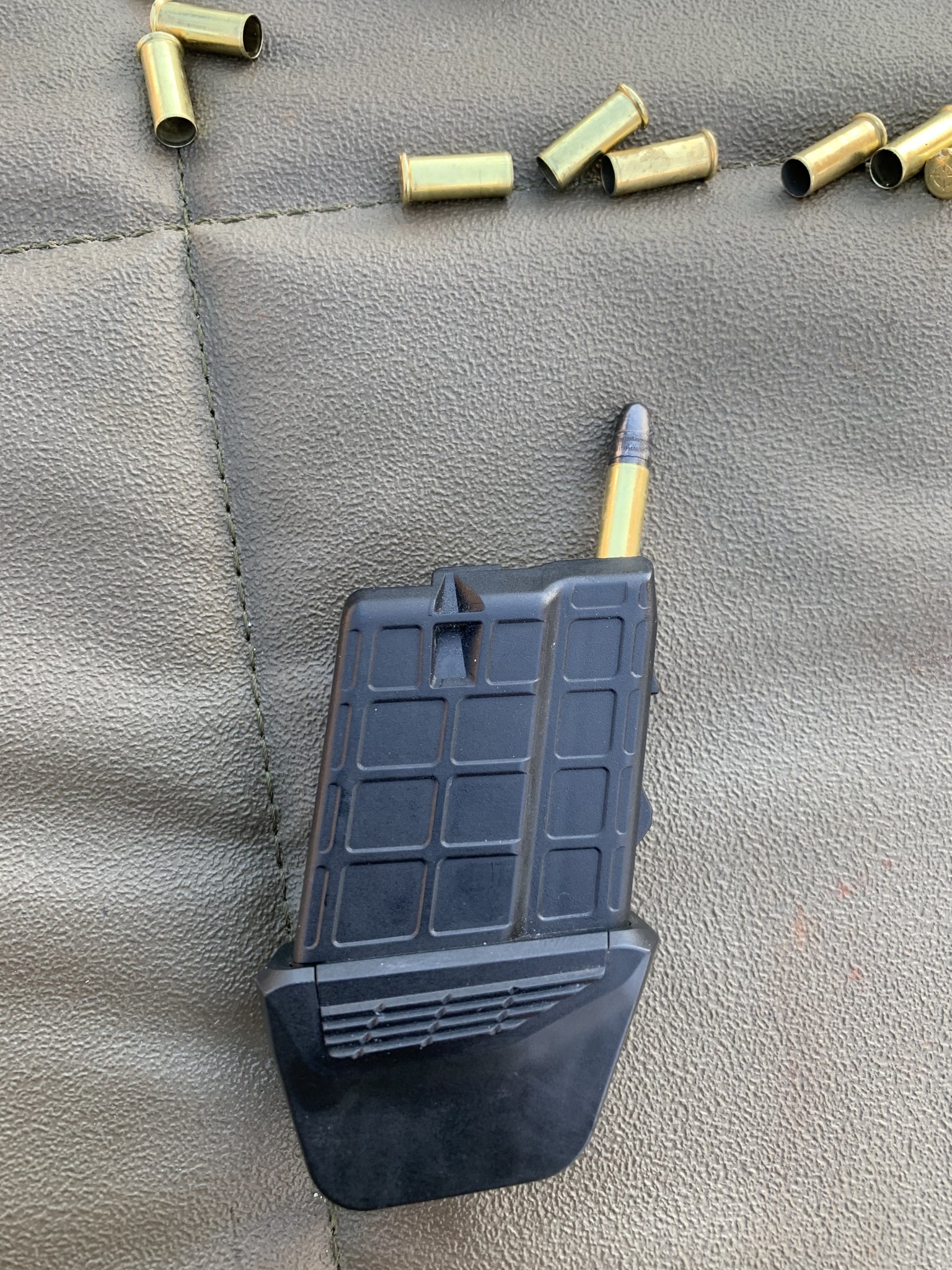

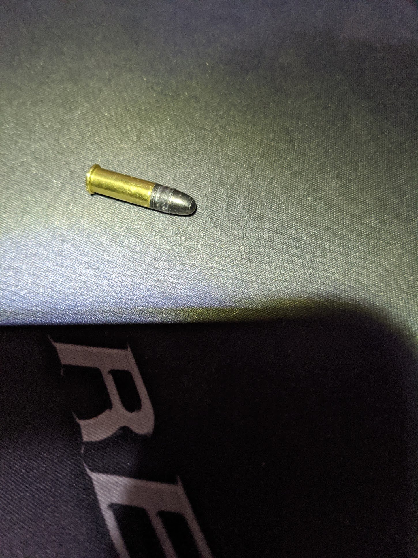

Yesterday I had my friend get the first FTF on my rifle where the round was stuck up straight, I've never seen it happen before. I noticed that it had nothing to do with the ejector/feed of the barrel and had to do with the magazine. When I took the mag out and put the round in, the round would still pop upwards at a pretty steep angle. I had to unload a few rounds and re-put them in, somehow the spring in the magazine was not seated straight down and causing the rounds to push upwards at the nose. He either might not have loaded the rounds in all the way seated, or something weird happen, but never saw that until yesterday. And only happened once to him, I shot 100 rounds w/o issue.
I should have taken a picture, but the rounds were clearly pointing upwards from the magazine.
I e-mailed them to order the barrel. And then eventually called in to give my CC information. jerry @ mystic precision can also do the order - [email protected]. McGowan might be making T1X barrels now, but they weren't before. I've also heard great things about McGowan, all around the $315-350 USD range. IBI is now putting feed ramps into their barrels from the factory so people won't have to do this. They offered to exchange mine for me but they can't fix mine and send it back due to US/Canada import/export rules. I already ammo matched my rifle with 2 cases of ammo so I really didn't want to get a new one that didn't like the 10,000 rounds I just bought.
So when you run it fast, you're also pulling back fast right? I had a RO look at me when I was having some FTE and he was like, you're not pulling back hard enough / almost short stroking it too. After I started pulling back faster/complete I never had an FTE again.
I’m guessing it looked like this...
I’m guessing it looked like this...View attachment 7198011
That's the after effect after pushing the round forward. When I put the round back into the magazine it was angled steeper than usual which causes it to miss the chamber and push straight upwards. I had to unload two rounds and get the magazine spring to reset properly and then everything was fine.

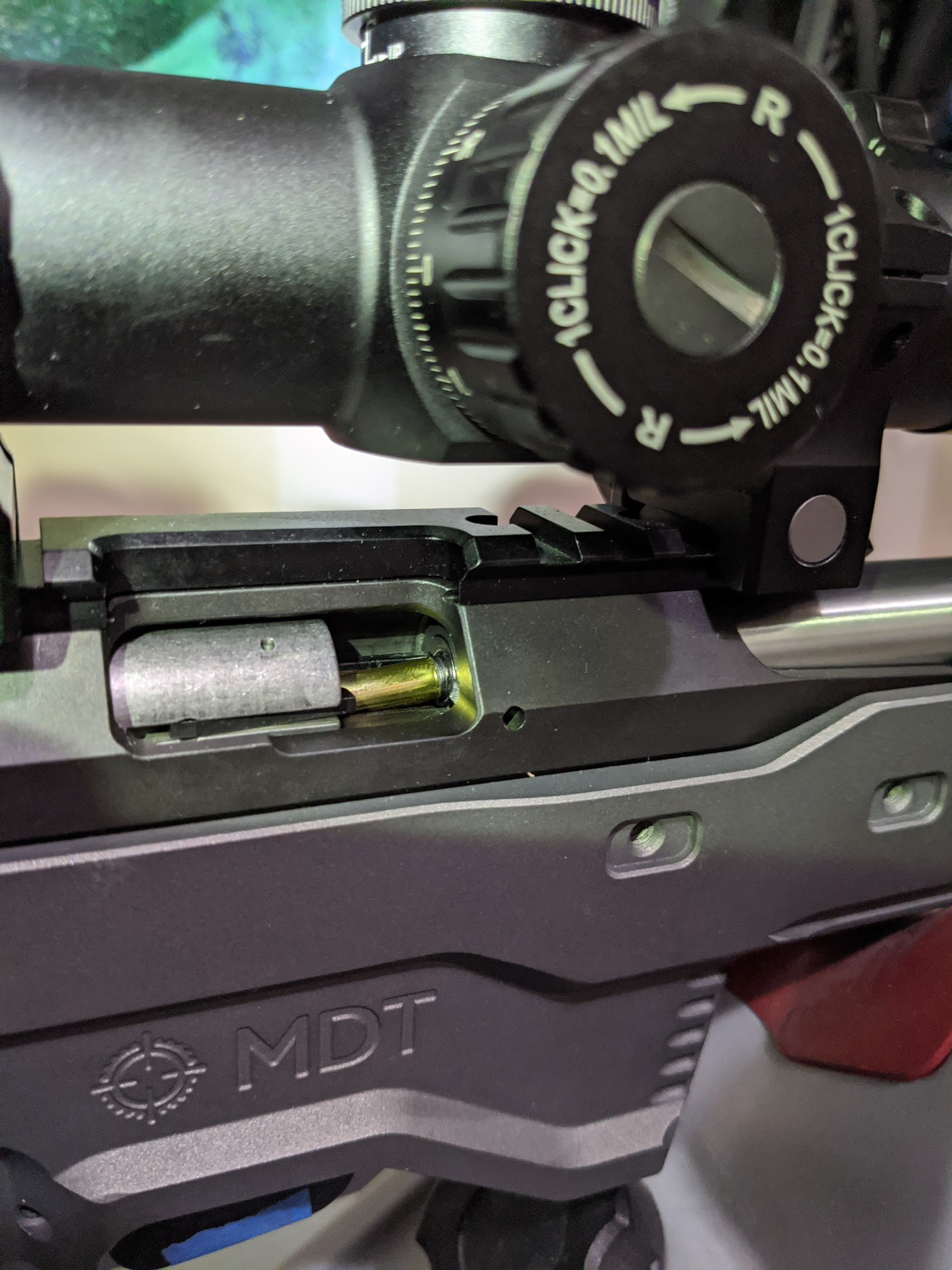

I came across this video - But I can't find any information on what mod he did though to get the feed to be basically centered right onto the barrel.
Very minimal post on Canadian GunNutz (he refs it in the YouTube comments but provided no link).
Here is the link (can I cross post to other gun sites here?)
See post 1 - he modded the mag
I'm a member there - I sent him a PM to see if he can add more info to that thread.
