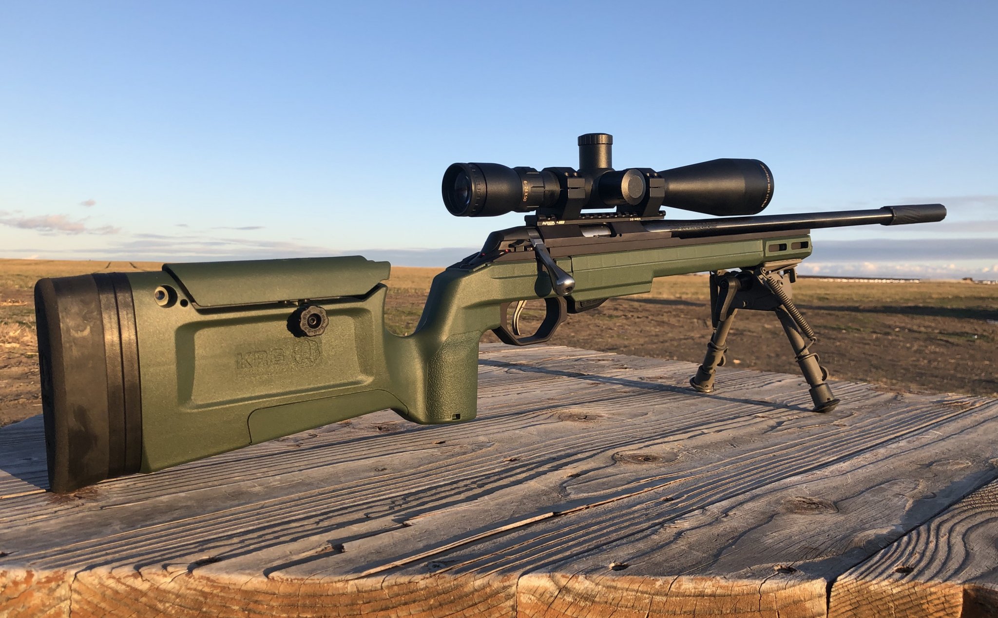

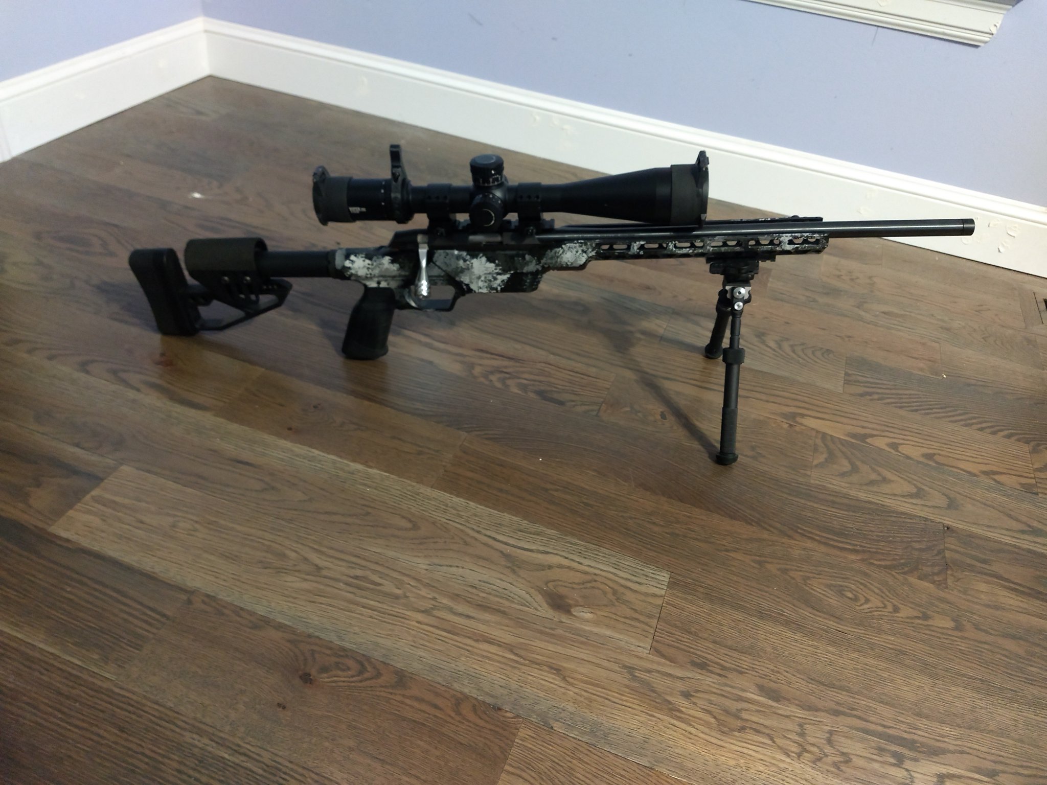

Here it is. I love the XLR buttstock too. I am putting together a Tikka varmint 6.5 in a MDT ACC chassis. It's all weighted and balanced. I love it for the full size T3, I don't know if I'd like it as much on the T1x. That just me though.View attachment 7180148
How does the larger magwell do when trying to change magazines quickly? Has anyone made a 3d printed block or funnel to fill the void space yet?
I love the larger mag well. The magazine rides flush against where the trigger guard is so it's easy to align and push in.

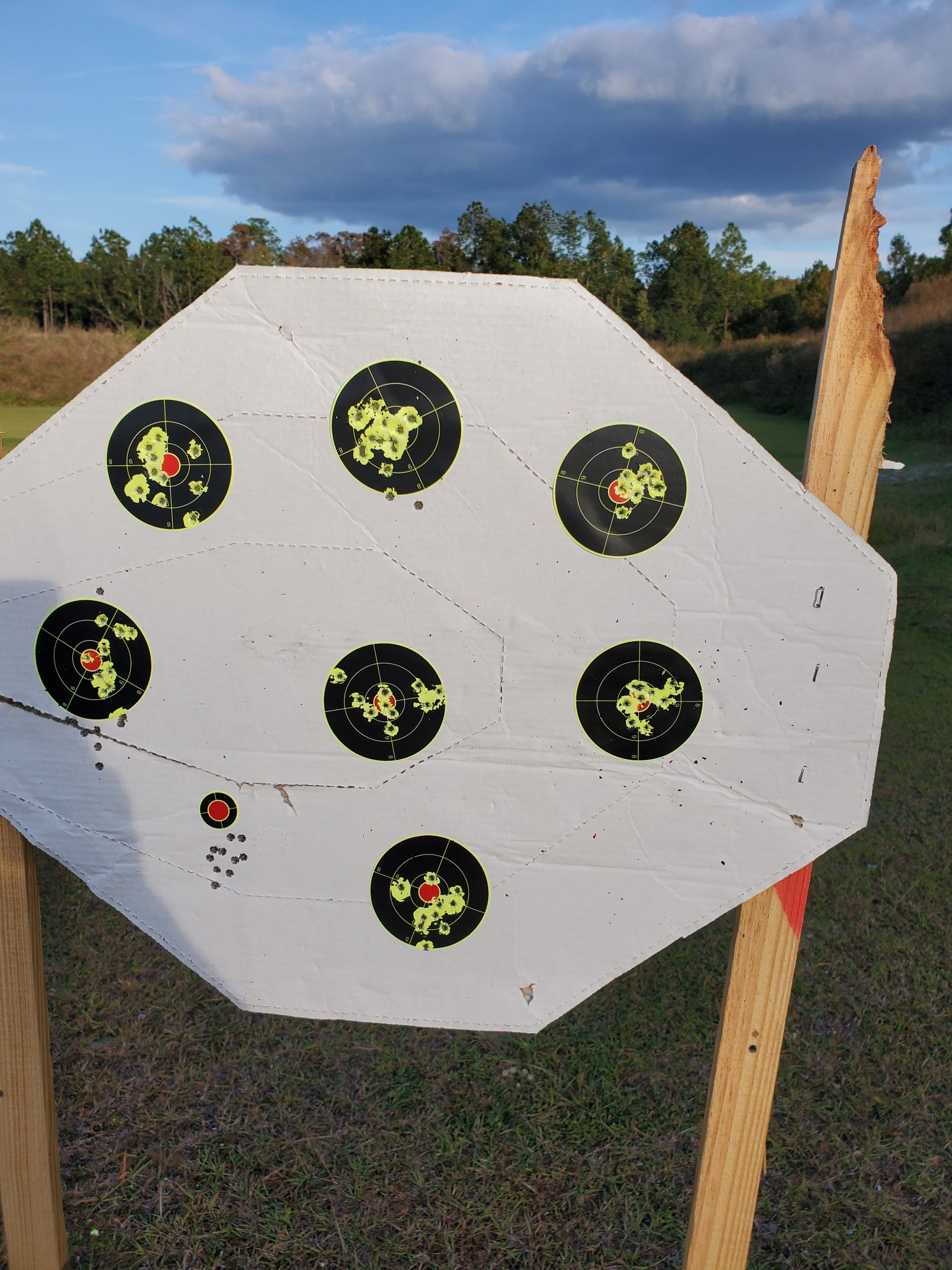

I did a 10 shot group at 203 yards, and it looks like 10 shots did shoot within 1.5" horizontal, 9 shot within 1" horizontal. But my vertical was 8 within 5.5" vertical spread, and counting the last 2 it was in 8.5".

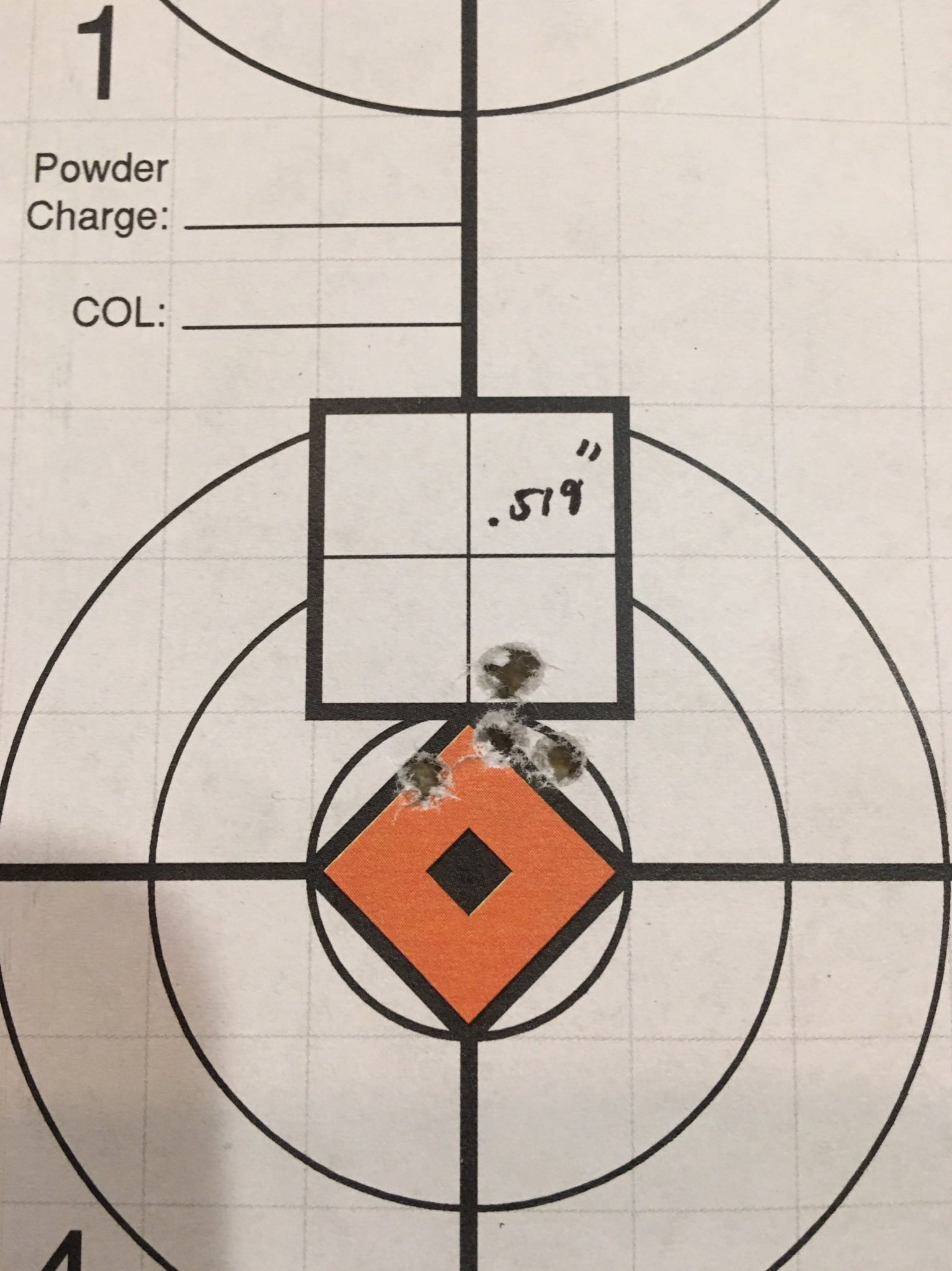

100 yard groups with hornady 17hmr ammo. Not great but not the worst considering I was rushing due to time constraints. These were the last 10 rounds out of a total of 80 ish fired tonight from a brand new rifle and a nice hot barrel lol all in all though, I love this little rifle and it will be quite the p dog slayer

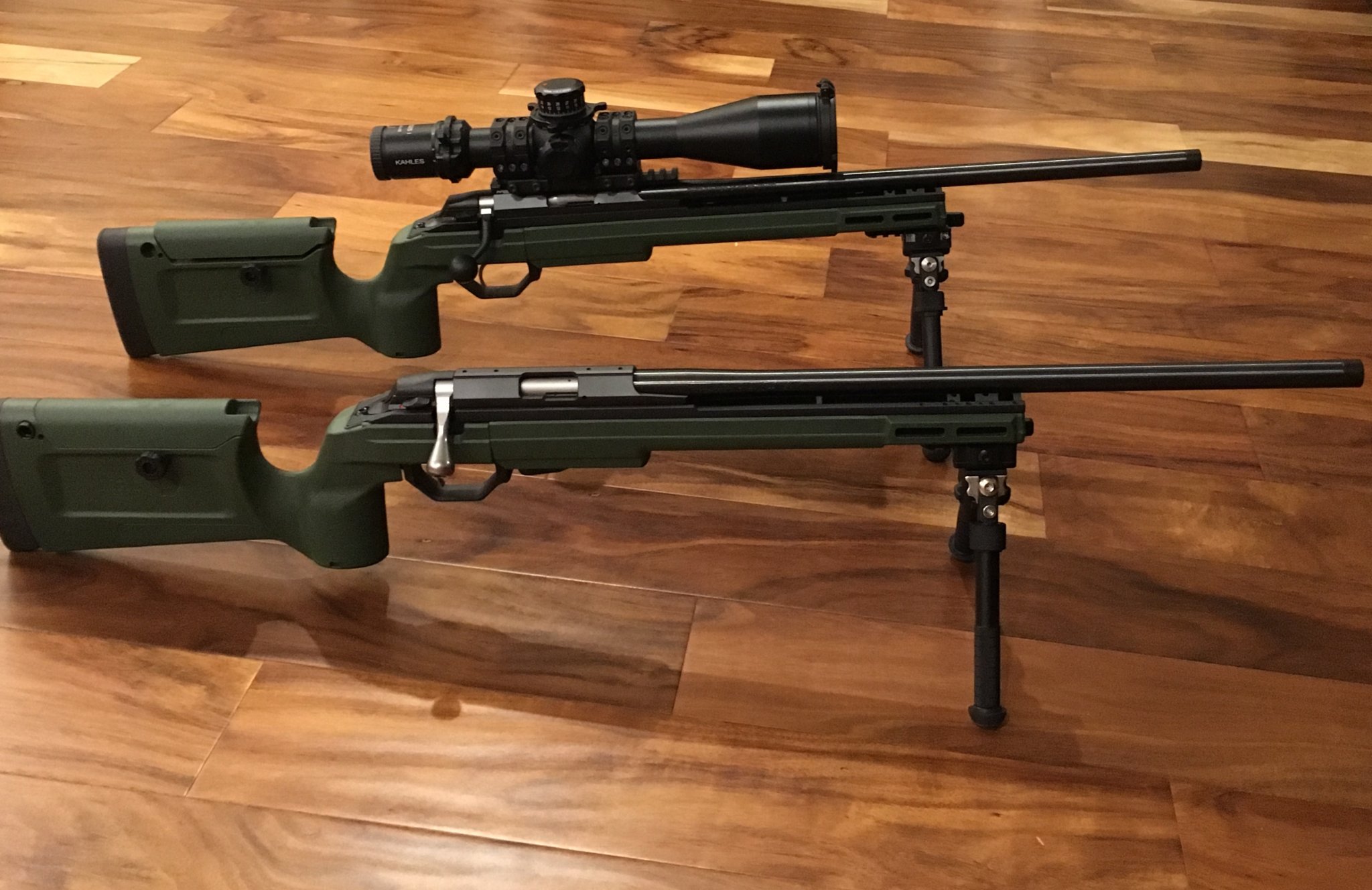

New T1x 17hmr in a Bravo. Shoots pretty good so far. My groups are pretty similar to the 17 groups pictured above by @Krob95 but I don't have many rounds through mine either. I really like the T1x and the Bravo. A huge step up from the Savage 17 hmr I used to have.View attachment 7187212
I'm curious for those with the KRG Bravo, if the stock is heavy enough to stay steady on a bipod when lifting the bolt? it seems like in the factory stock, I shift the entire rifle every time I lift the bolt with the factory bolt knob. Seems like there's not enough leverage to pull it up without it moving the entire rifle since it's so light?
I stay down on the gun when I rack the bolt so I haven’t had too many issues with the factory stock. But I could see the issue for sure as those bolts are quite stiff

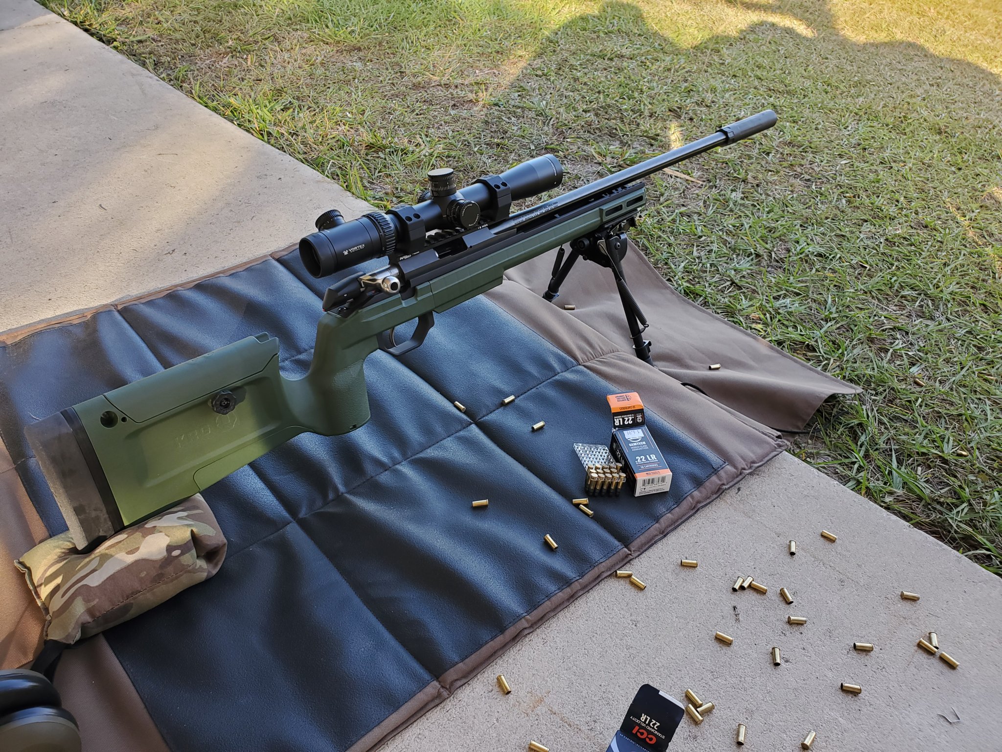

Shot 50 rounds of gemtech 42 grain sub Sonic. 5, ten shot groups @ 100 yards. One was about 0.9 MOA, the other four around 1-1.5 MOA with vertical spread greater than horizontal. Only 200 rounds through it so far very pleased. 50 rounds CCI sv. Almost as good
It is still pretty light. I would agree with @Krob95 that if you stay down on the gun, it isn't too bad. I also agree that the bolt lift is a little stiff. I guess there is only one way to fix that..... shoot it until it smoothes out. :)
I did get a little more shooting in today. Tried CCI Green tag and Hornady 17 gr Vmax. Both shot fairly well with maybe the slight advantage to the CCI. Again my 10 shot groups at 100 yards are about equal to the 17 groups posted above.

Took the 17 out today as well as the 22. Few target pics below.
Shooting SK + is Meh in the 22. I’ve got 1850rds if this stuff left before I swap barrels and start lot testing. I’ve got about 1500rds through this rig total. It was 37 degrees this morning and I was just looking to get some dope out to 200. Nothing really impressive other than one lucky group. All measurements are edge to edge and shot at 50yds
Reactions: Jefe's Dope

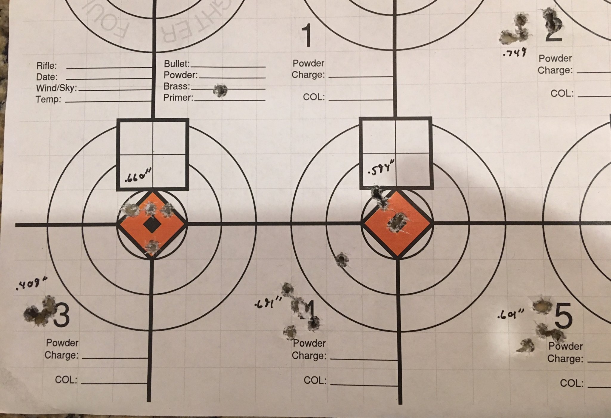

Now on to the 17. This is 15 of the first 20rds out of this rifle. This was shot with a magical lot of CCI A17 that I sadly only have 400rds left of. These were shot at 100yds. Measurements are edge to edge. I have the same aftermarket spring in both the 22 and 17 but the 17 is noticeably lighter. Prolly gonna swap them and hope it stays that way.

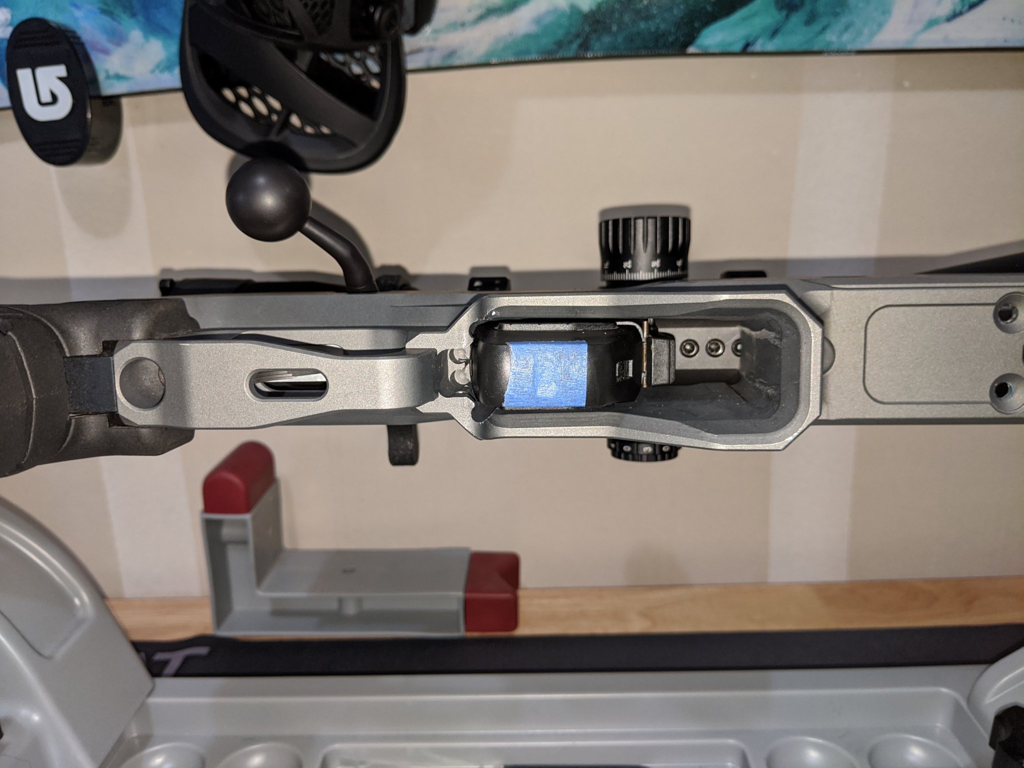

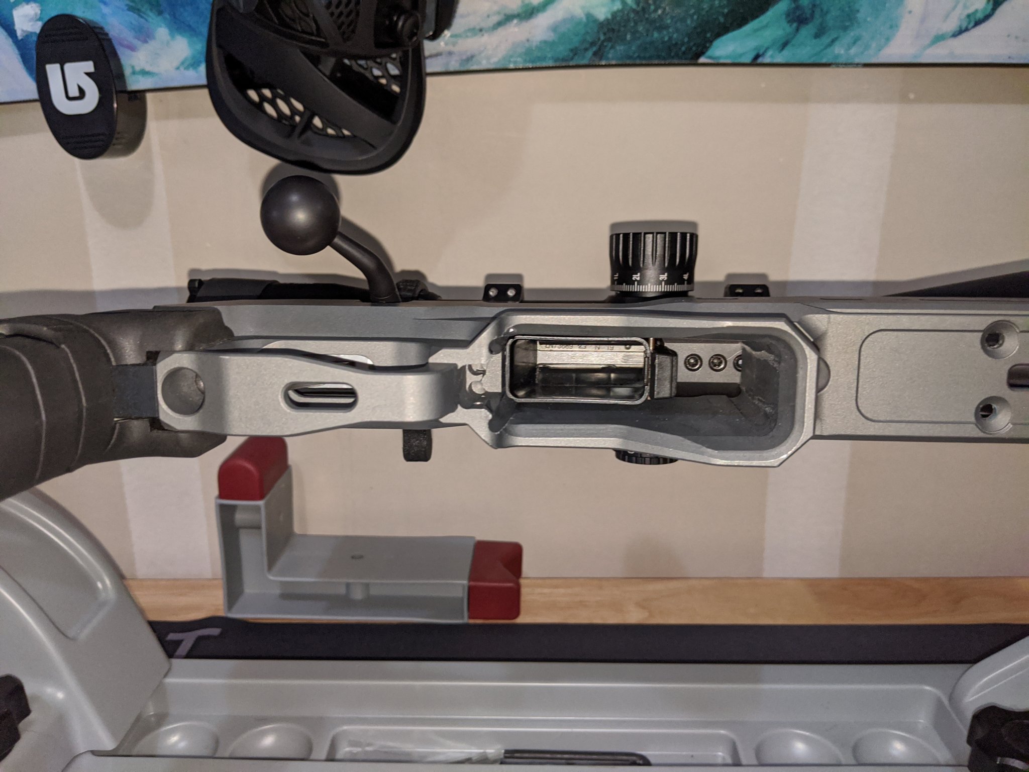

Dinked with my extractor last night and might have solved the Center C feed issues. Will try tomorrow at the range.
