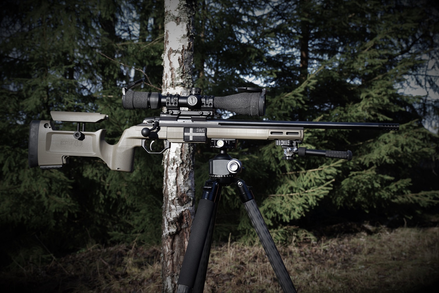

..... hmmm fancy.....

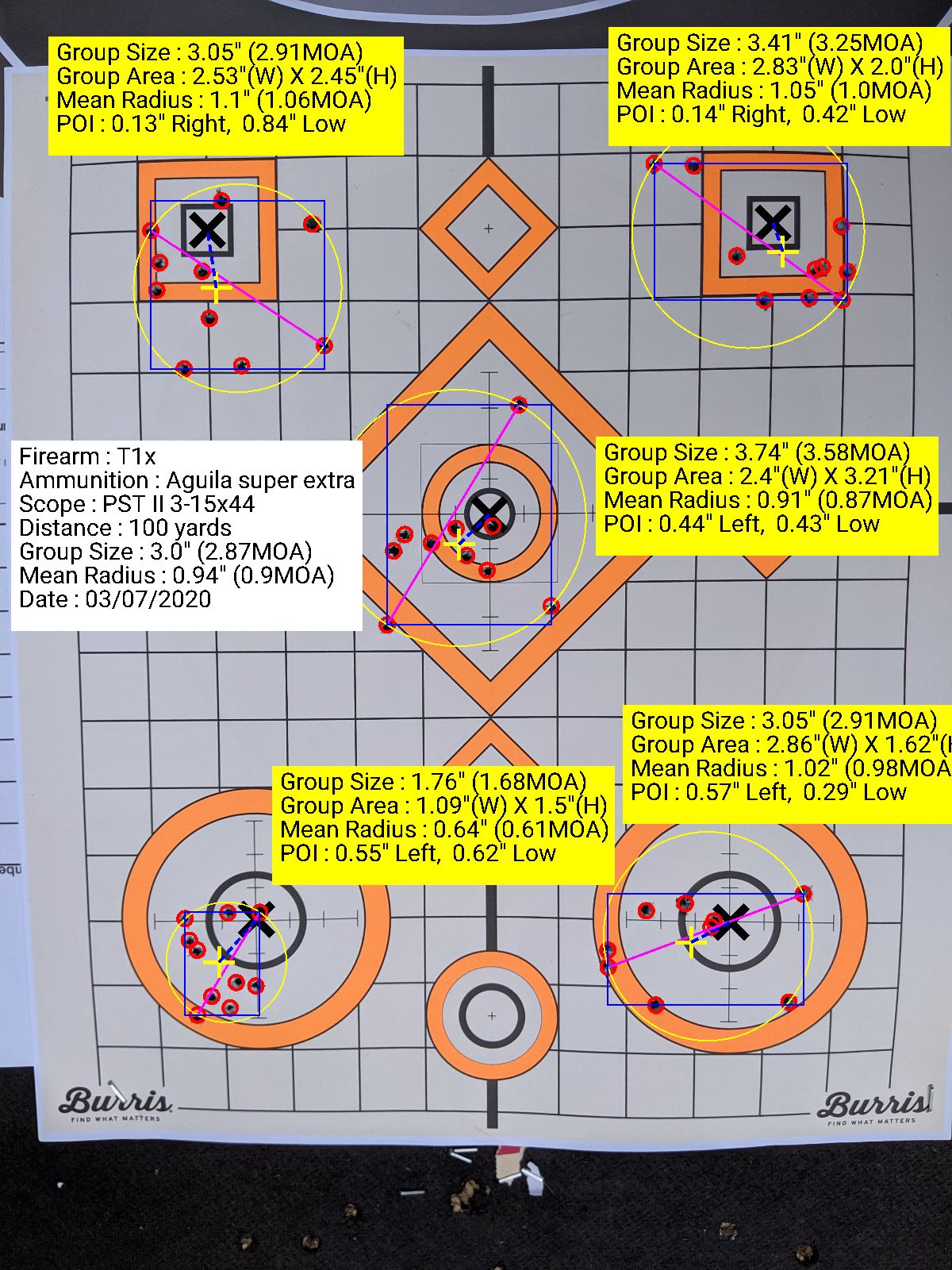

Finally got a chance to take the new t1x out the past two days. Getting 2-3 MOA but im sure that's me.
The number of FTE's is insane though, 3-6 per mag. I tried CCI SV and aguila. Any consensus on how to bend the spring? How do I even remove the spring?
15x mag at 100 yards is less than I was expecting, can't wait to try 2-300 yards and see how the hell people manage that.

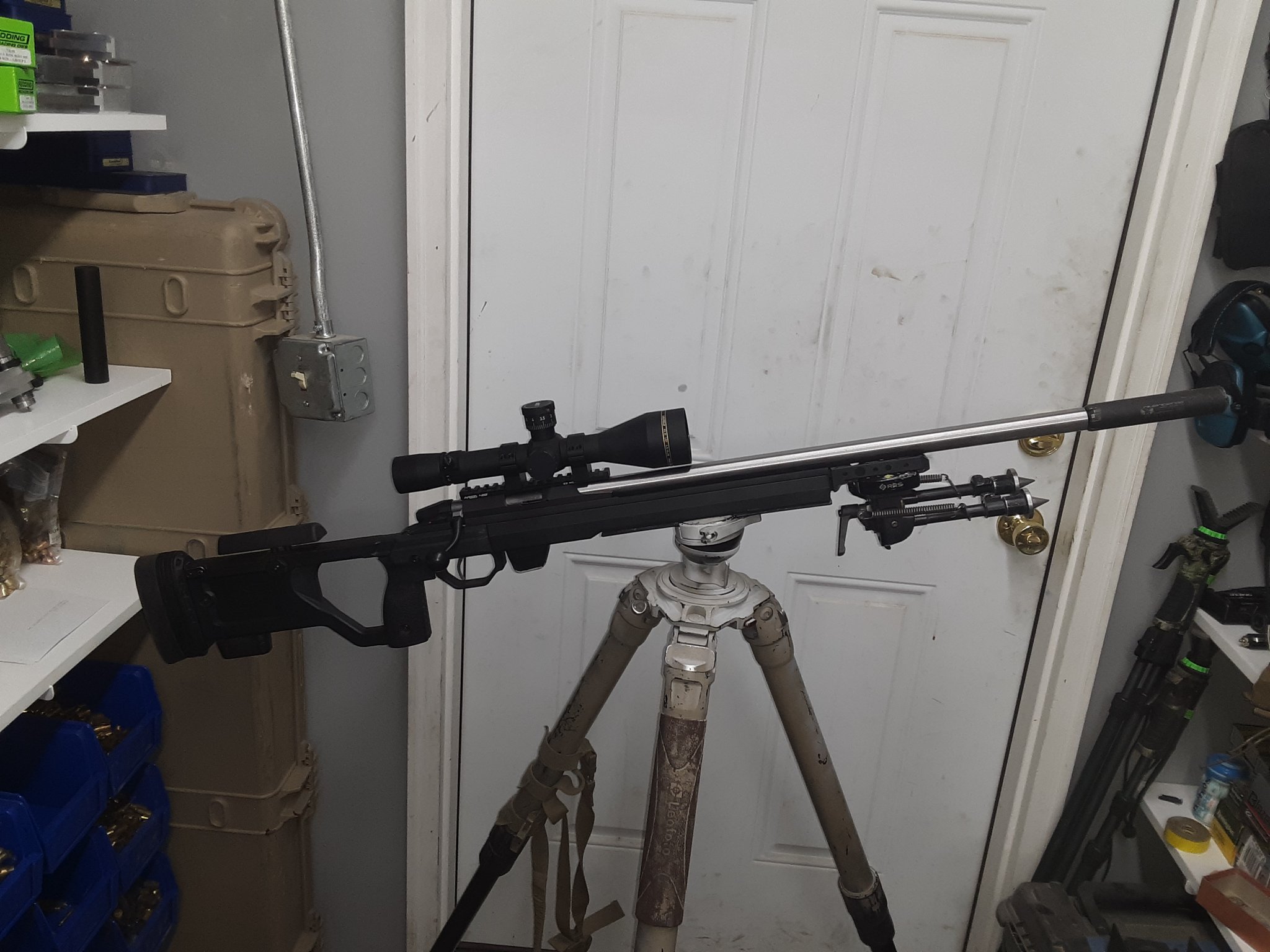

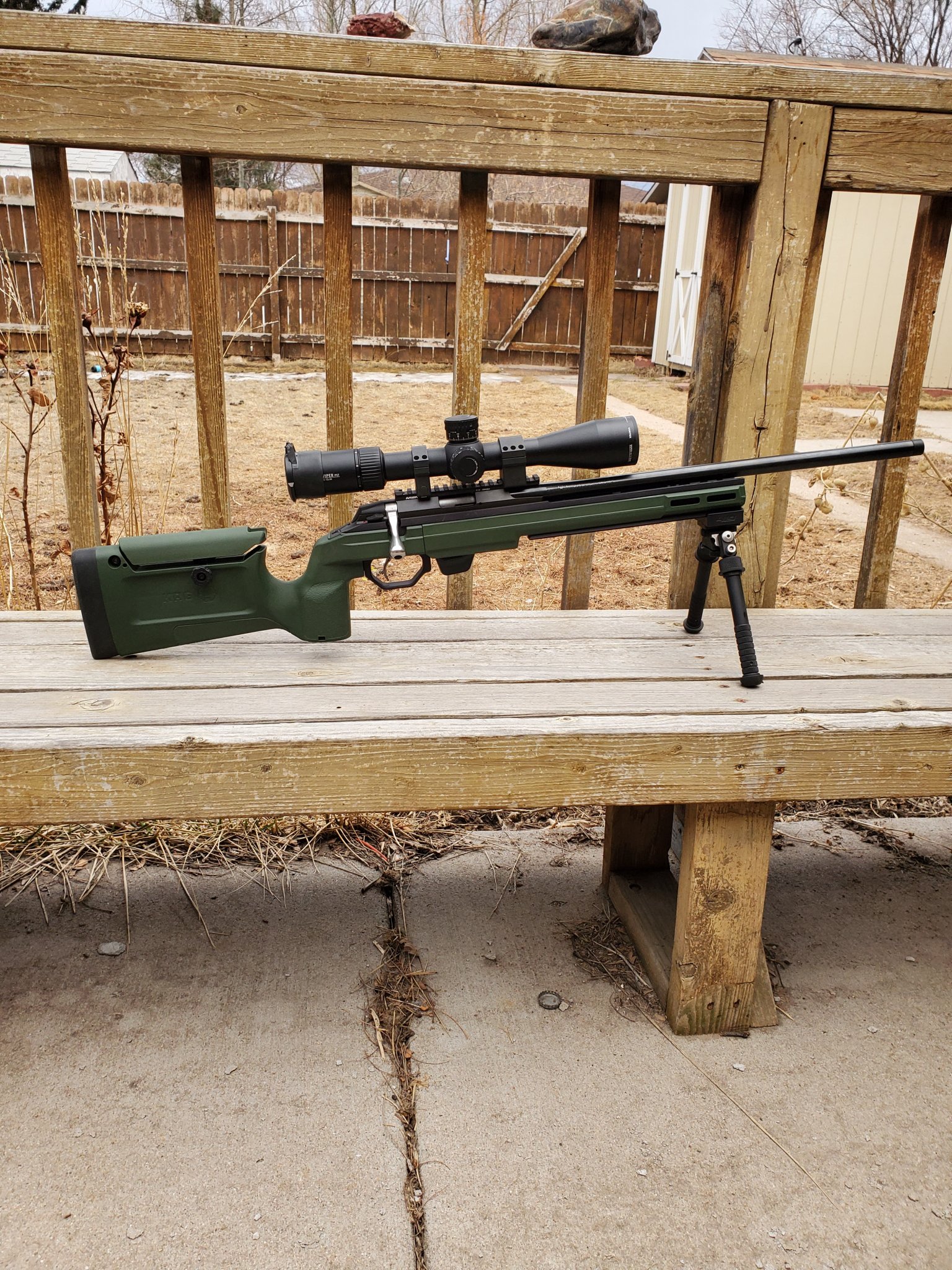

Is that an IBI or Walther? I would say Walther since it's threaded. How is is shooting?
It is an ibi, I have no clue how it shoots... haven't been able to go to the range(new baby I the house)

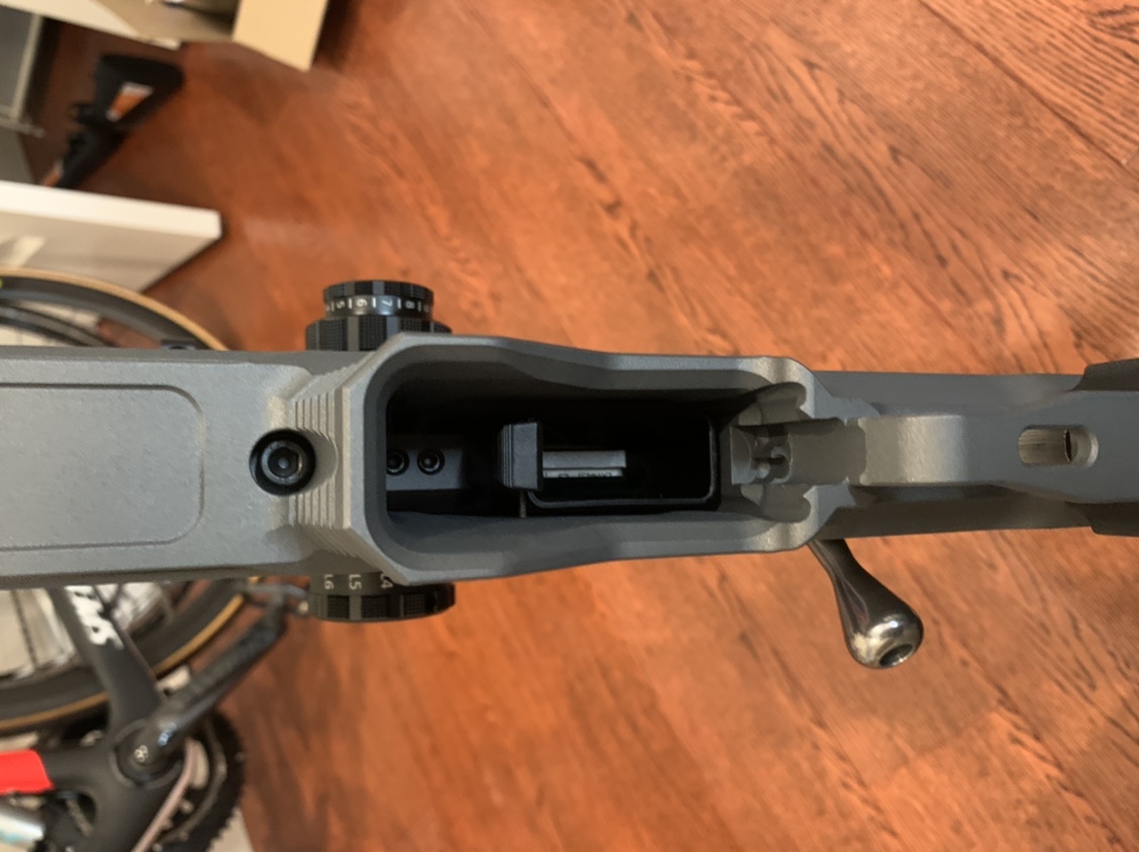

And the pic is more to draw attention to a t1x in an xray not a bravo(ie the krg t1x bravo can have parts swapped with a standard t3 tikka to make a 100% functional t1x xray with out having to mess up the mag well on it. which means more than likely you could do the same with a whiskey 3

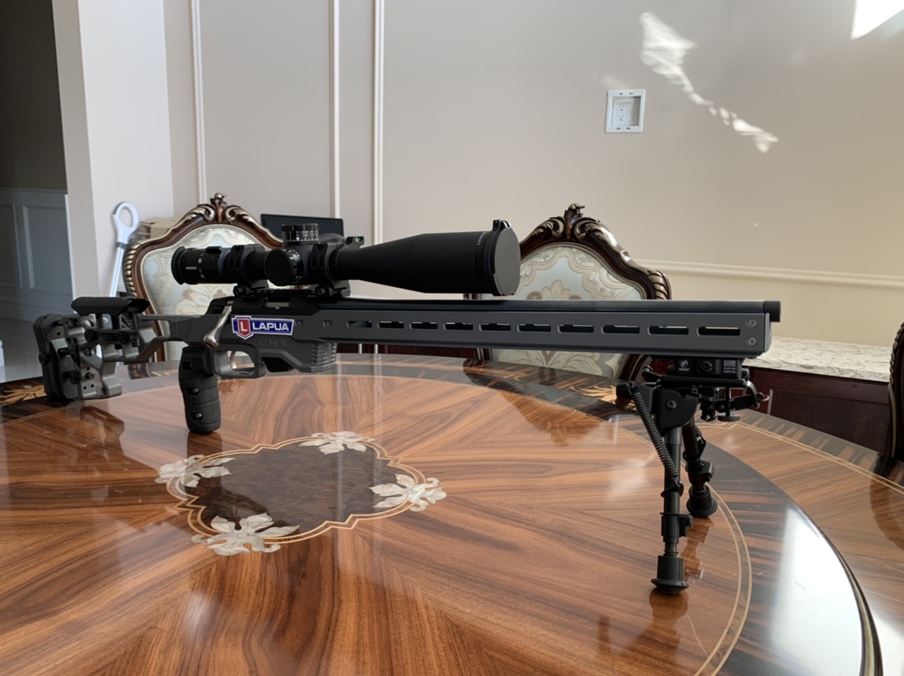

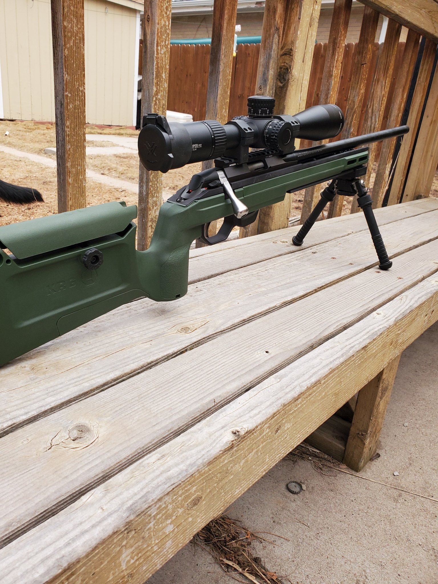

My first precision 22 build:
Tikka t1x
Area 419 30 moa rail
Krg bravo
Krg arca rail
Anarchy trigger spring
Atlas psr area 419 arca adapter
Vortex pst gen2 3x15
Badger rings
Mountain tactical diamond bolt knob on the way.
I've ran multiple types of ammo threw it and haven't experienced a single ftf or fte.
The group is cci standard velocity 10 round group @ 50 yards (other "flyers" are from someone else)
Needless to say I'm extremely impressed with it!

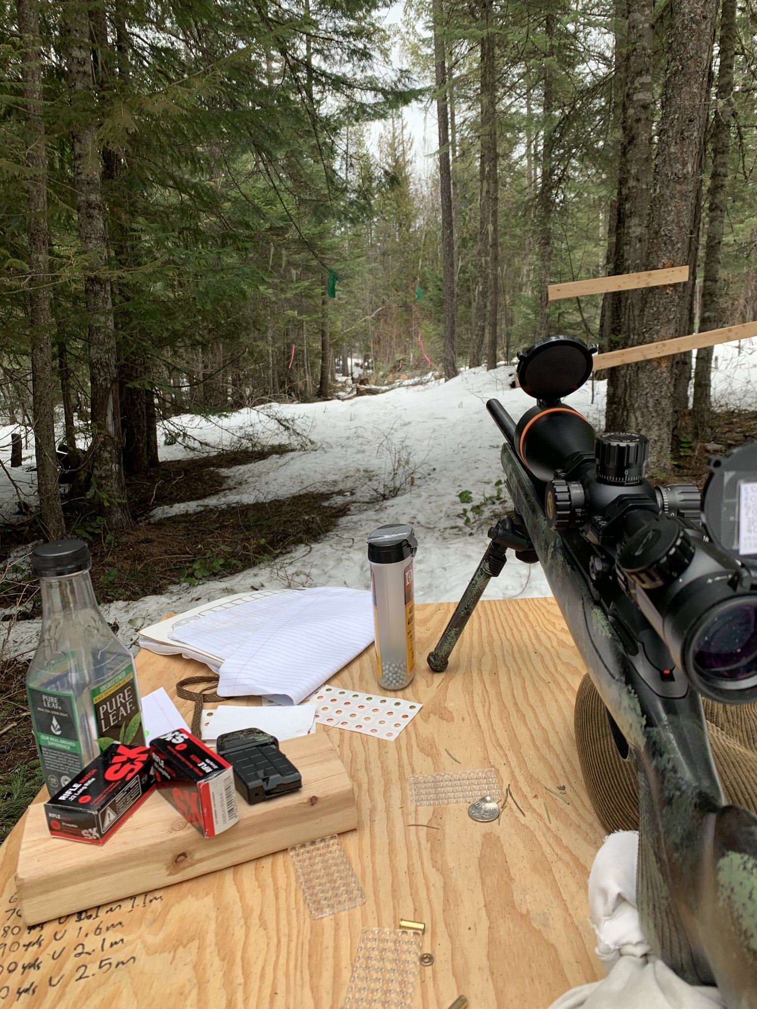

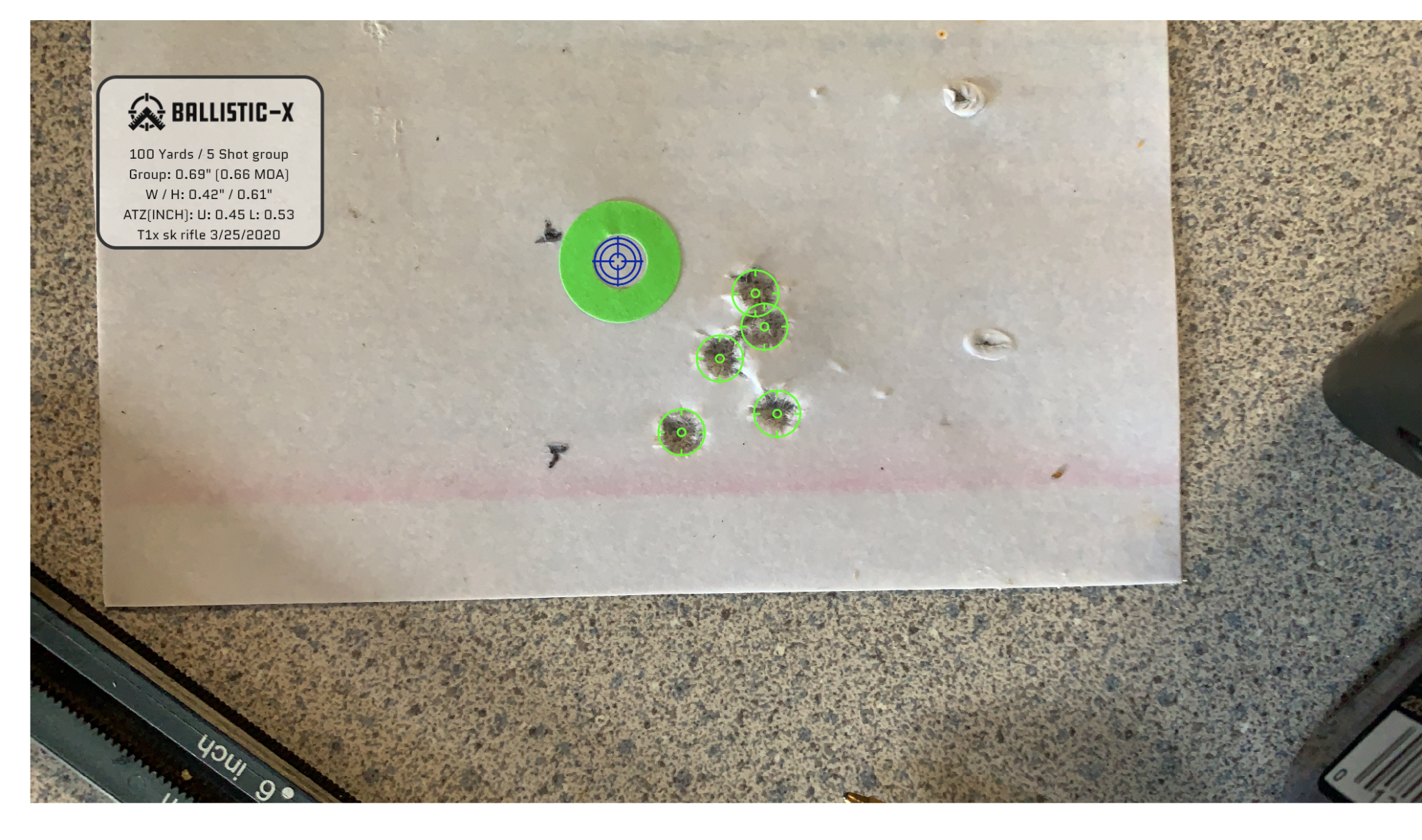

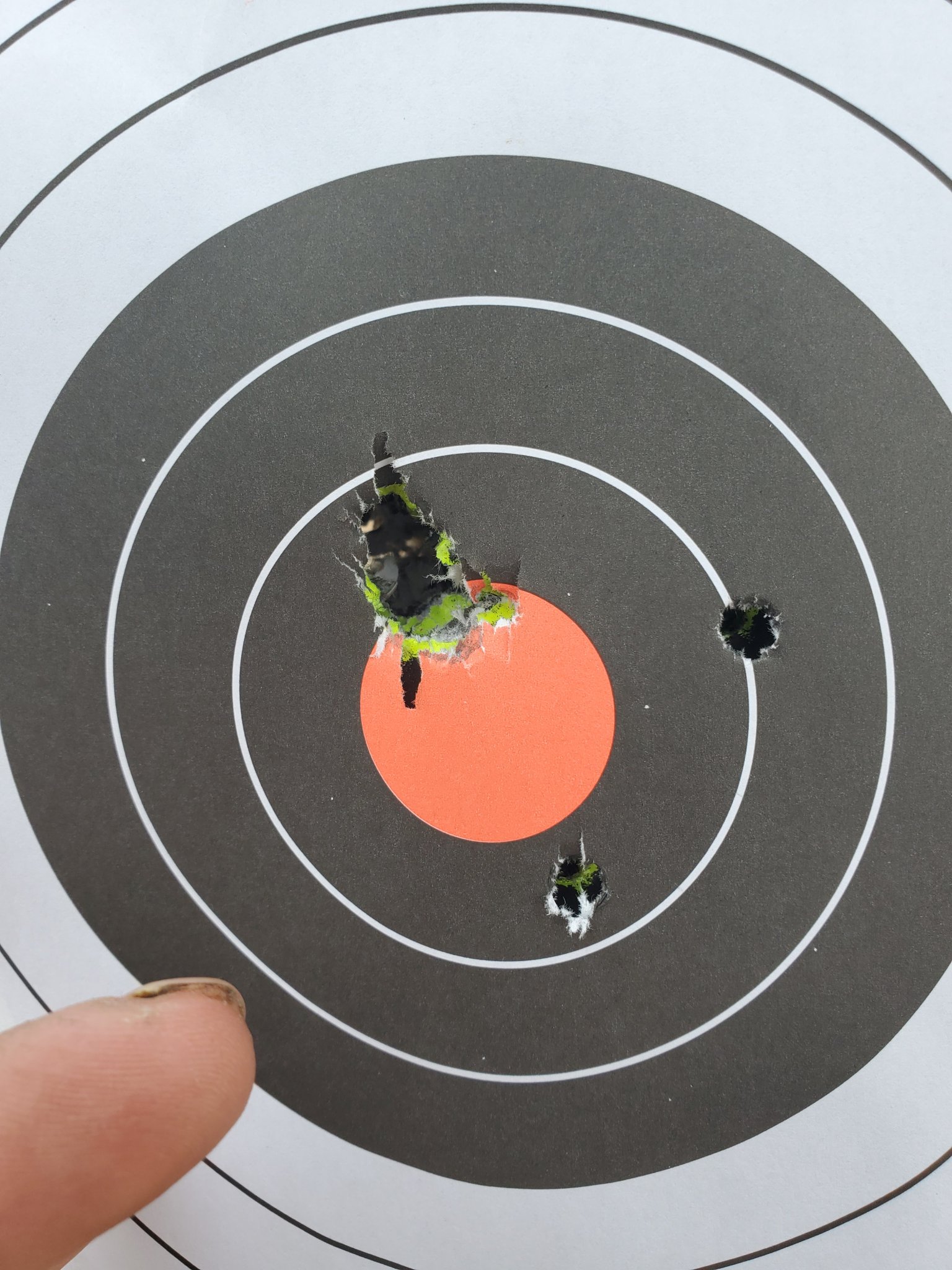

100yds, Everything about gun was stock, Athlon scope, SK rifle match ammo.
Yes it was cherry picked, But I don’t care, this group just made me happy!
