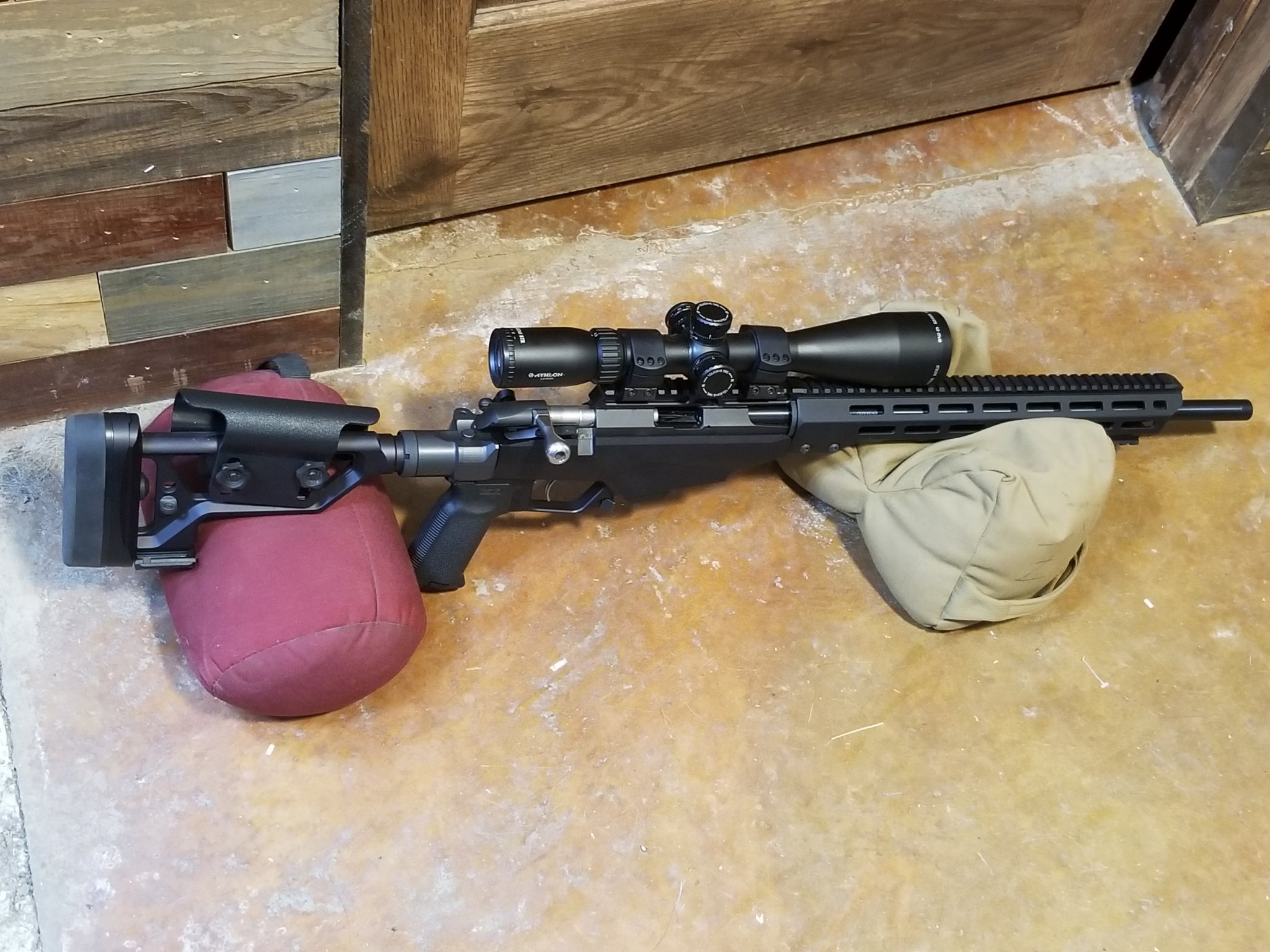

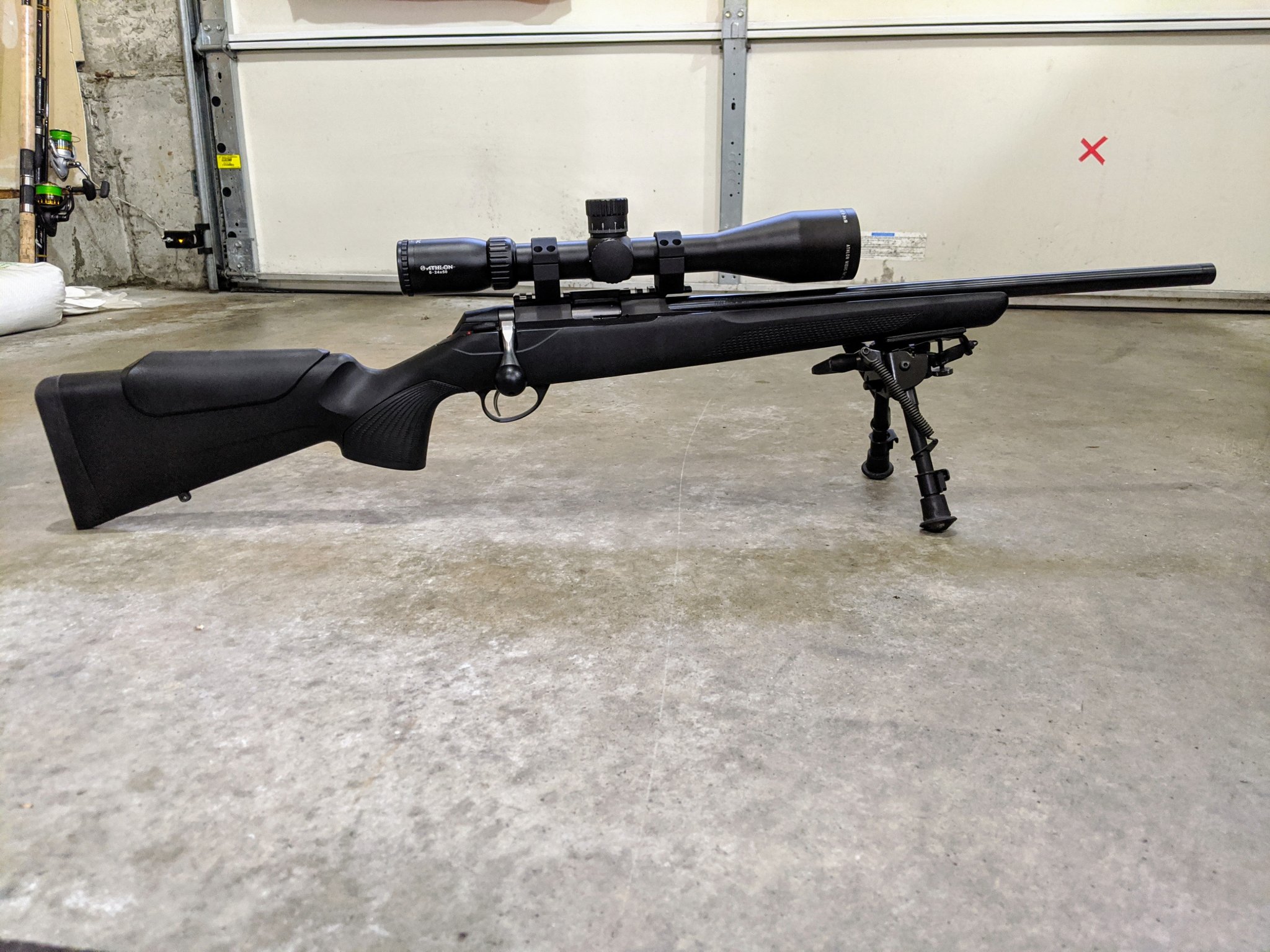

Just built up my new T1X. I threw it into my spare CTR 6.5cm factory stock. DIP 25moa rail, Vortex PMR 0.87" rings, Athlon Midas Tac 6-24x50.
Looking good!
How is the ctr stock compared to the t1x stock?
I like the way the T1x stock fits my hand, but it’s got so much flex.. I’m back and forth on whether to replace it.

I haven't shot it yet due to the lockdown, but I like the CTR's "pistol grip" angle better. The rubber butt pad adds some lop (also have spacers from the CTR available) and the cheek rest puts it right in line with my scope height. The T1X bottom metal is not as wide as the CTR bottom metal so there will be a small gap at the bottom. I don't foresee this as being an issue other than aesthetics.

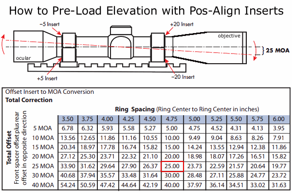

The distance between and the position of rings on the base makes a huge difference. Windage not at mechanical zero reduces the amount of elevation adjustment also.
I have a 20 moa rail for a 10/22 that I’m going to switch out just to see what happens. I have a 40 moa rail on the way which will ultimately be replacing the DIP rail but the 20 MOA rail I found should be the closest comparison. I’ll report back later today and see what happens.
Sixgunjeff is correct. Look at column that has 4.75" ring spacing at the top highlighted in blue. Each row in that column is the same as the total offset on the far left. What that means is if you use any offset and you set your rings at 4.75" apart your offset in MOA will be correct. Let's use the 25 MOA Total Offset row, again spacing the rings at 4.75" you will gain the exact amount of offset as shown by the 25.00 in the red box. Using that same 25 MOA offset row, if you increase your ring spacing to 6" you will only have 19.77 MOA, losing 5.23 MOA of elevation.
The inserts doesn't matter. The only reason Burris shows this is because if someone is expecting a 25 MOA increase and they put their rings 6" apart they will not get the full 25 MOA.
No KOD I was wrong. Using regular rings on a inclined base the angle remains the same regardless of spacing. Using Burris Signature rings you are changing the angle by changing the distance between rings.

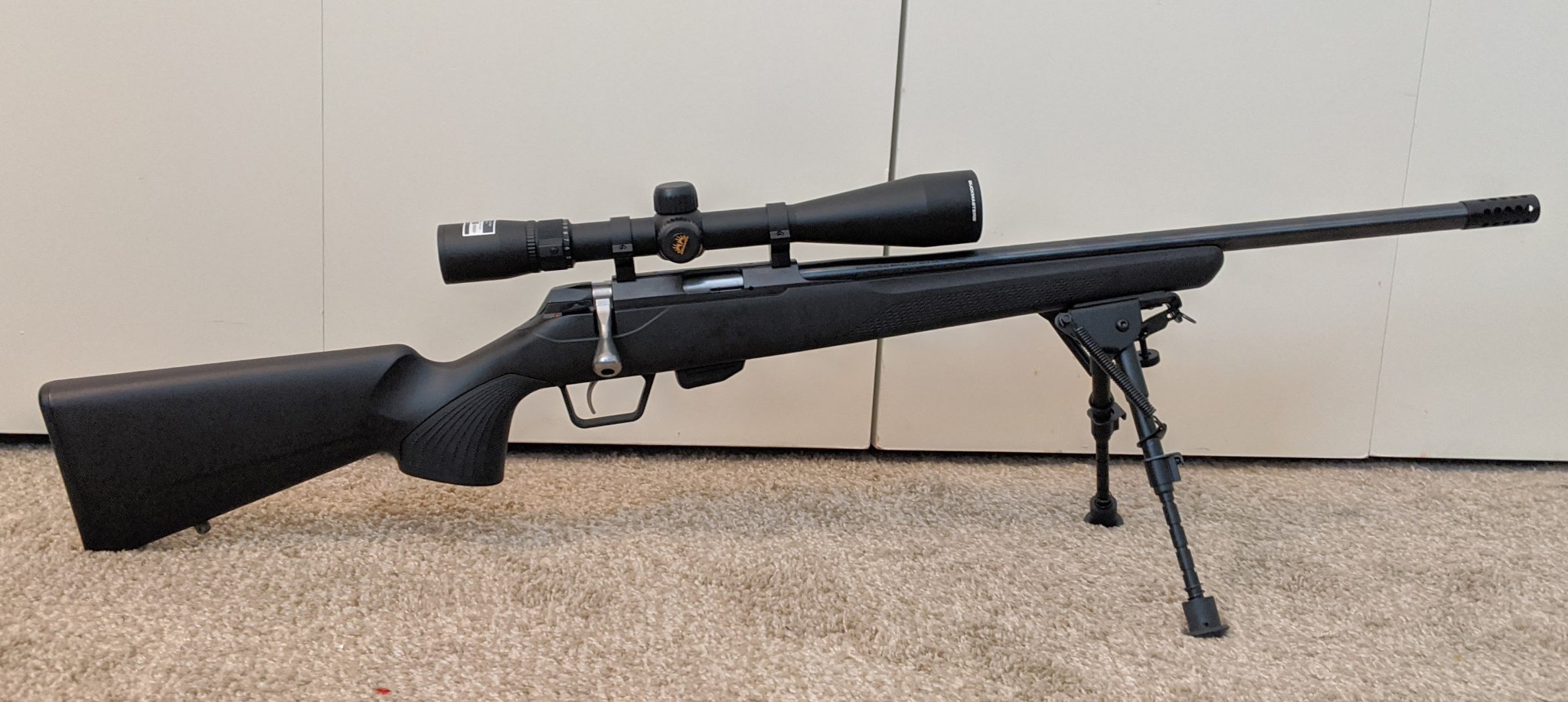

First time posting, but I have been creeping around for a while. I"m not a great shot, but very impressed with the Tikka T1x. Here's mine and what I have done to it:
  • Tikka vertical grip
  • High Velocity metal trigger guard
  • High Velocity metal bolt shroud
  • Bolt polish
  • DIP muzzle break
  • Amazon bipod
  • Nikon Buckmasters 4-12x Scope
    I pasted in my "best" from the most recent trip shot at 100 yards. I think that is 1 moa or about that... but again new at this. I haven't shot it yet with the new trigger guard/shroud. But the new shroud definately has a different feel cycling.
