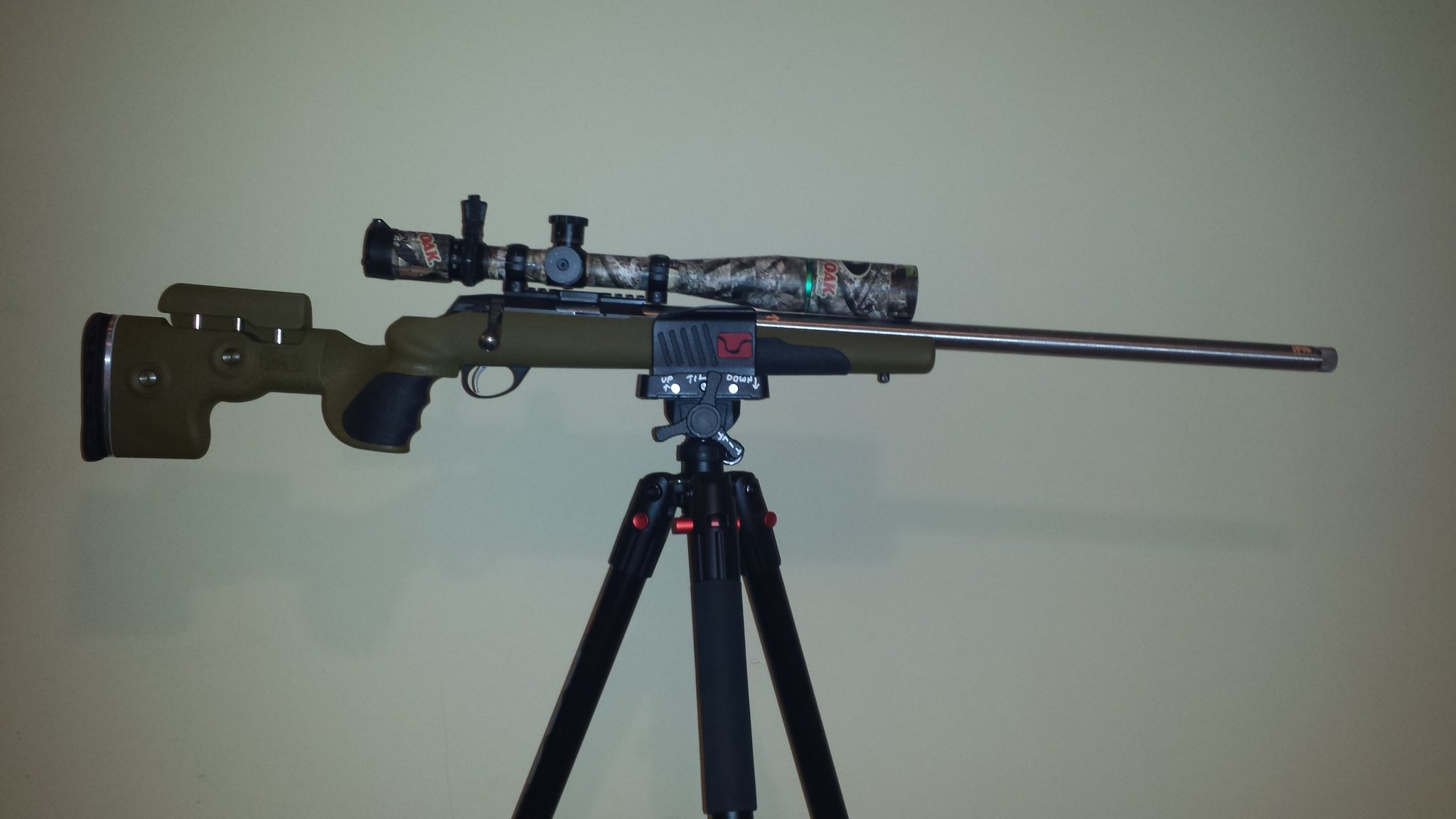

tikka t1x rebarelled/restocked/trigger upgrade spring 1#.just want to share mine.
So far I can't tell you much as I don't shoot much always busy ,this Barrel need to be break in first atleast put some 200 rounds on it.So far the barrel has only less than 30 shots on it.For me it shot pretty darn good an am only an average guy.I only use cci standard for break in then I started testing a lot of different ammo after the breakin period.
-I always get a feeling like every time I used this gun... that this barrel make me a good shooter in the future somehow/somewhat I can hit what am aiming at yah know that kind of feelings.

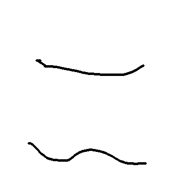

I was trying to engineer a ejector wire design with @zenbike to make something that would have good ejection and good feeding.
The top one is the original. The bottom one is an exaggeration, but what I wanted to do was when the bolt engages to just push the ejector wire out of the way, and it will bring back when the bolt is pulled back. This allowed for pretty straight feeding right into the chamber, and the ejector to only hit the spent brass when the bolt is fully pulled back.

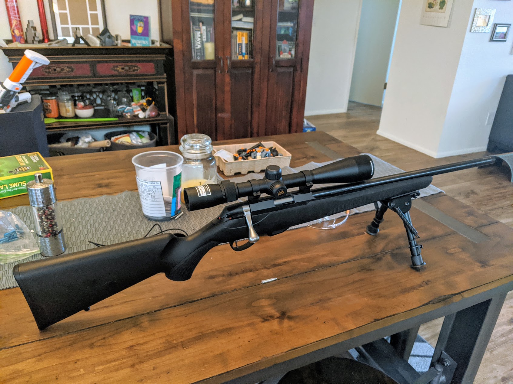

Quick question for Tikka owners. Did you get a separate warranty card somewhere in the box? I have the manual, but no warranty card that I can find. Also new here, here is a picture of my new rifle for my son and I.

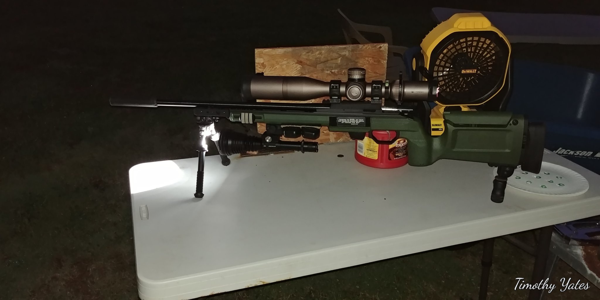

Cheap bipod off Amazon and a Nikon Buckmaster II 4-12X scope.

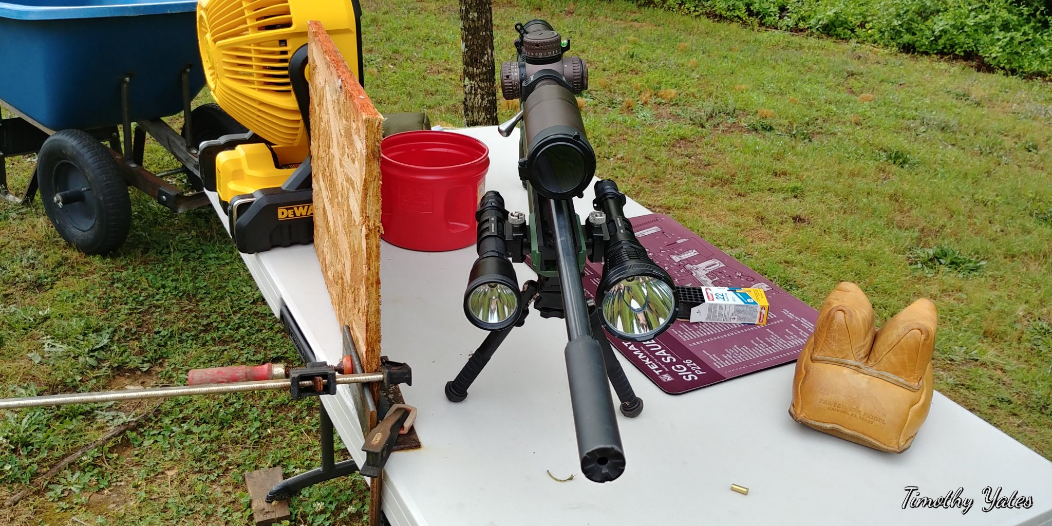

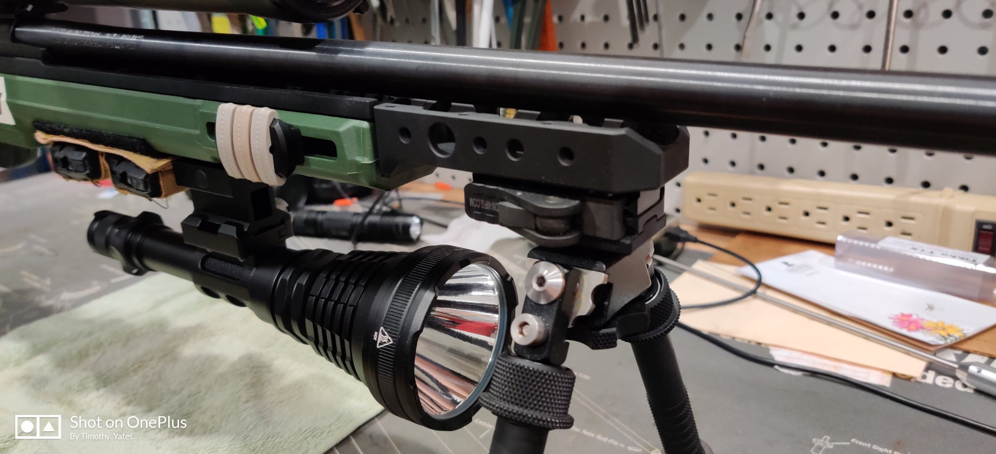

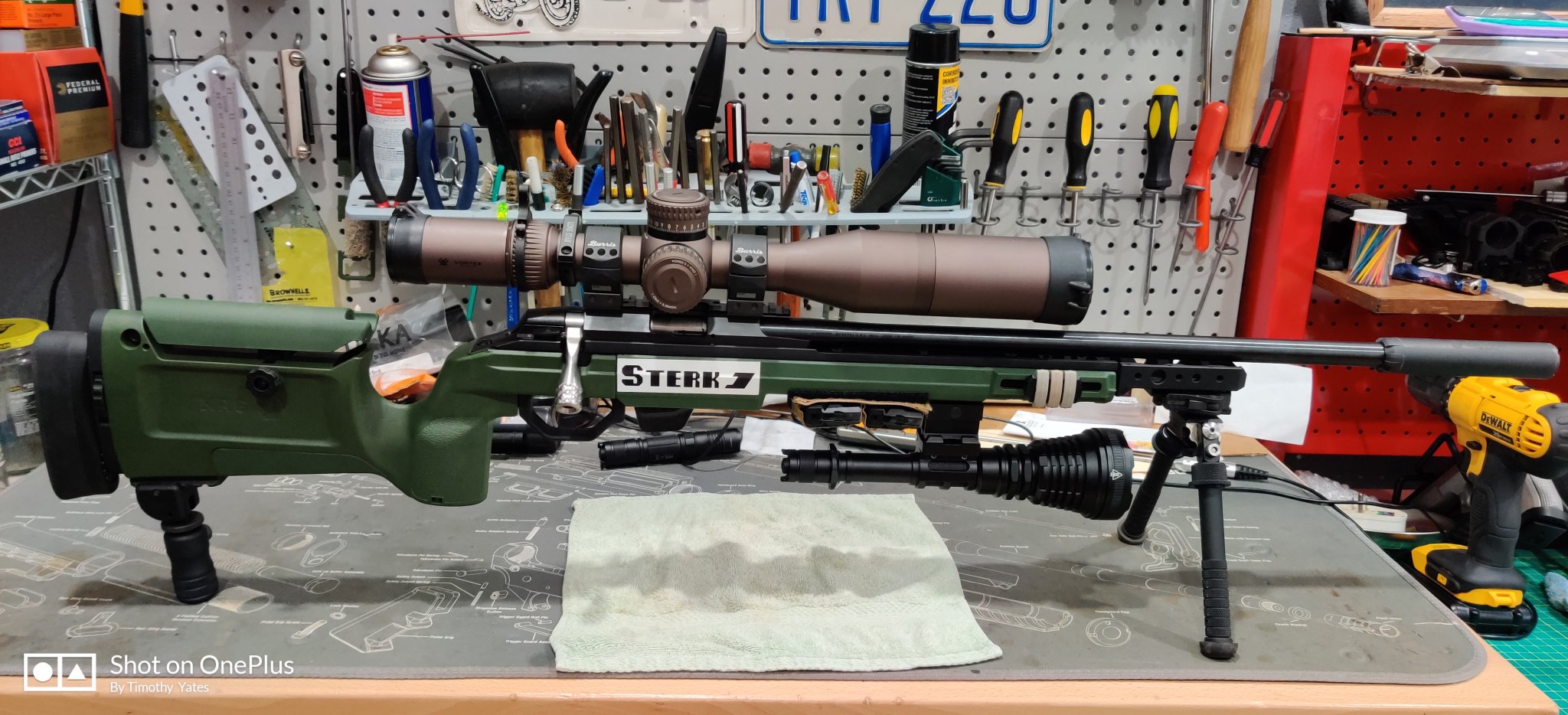

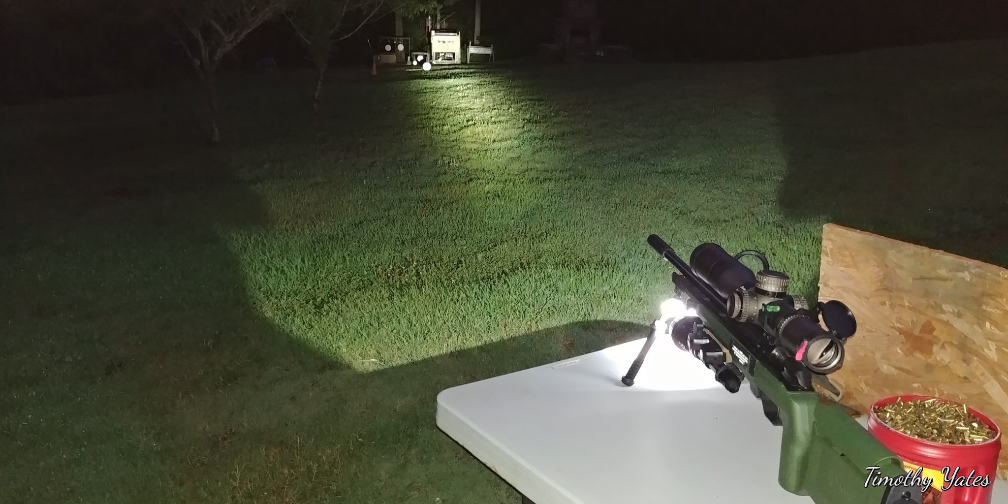

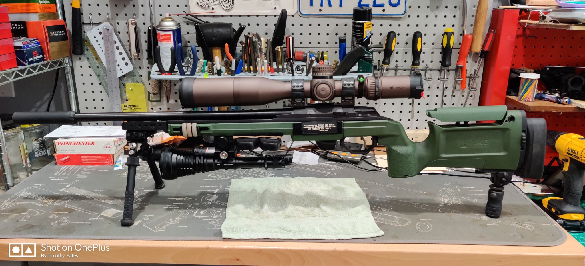

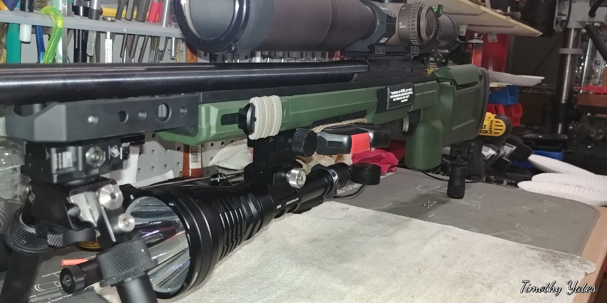

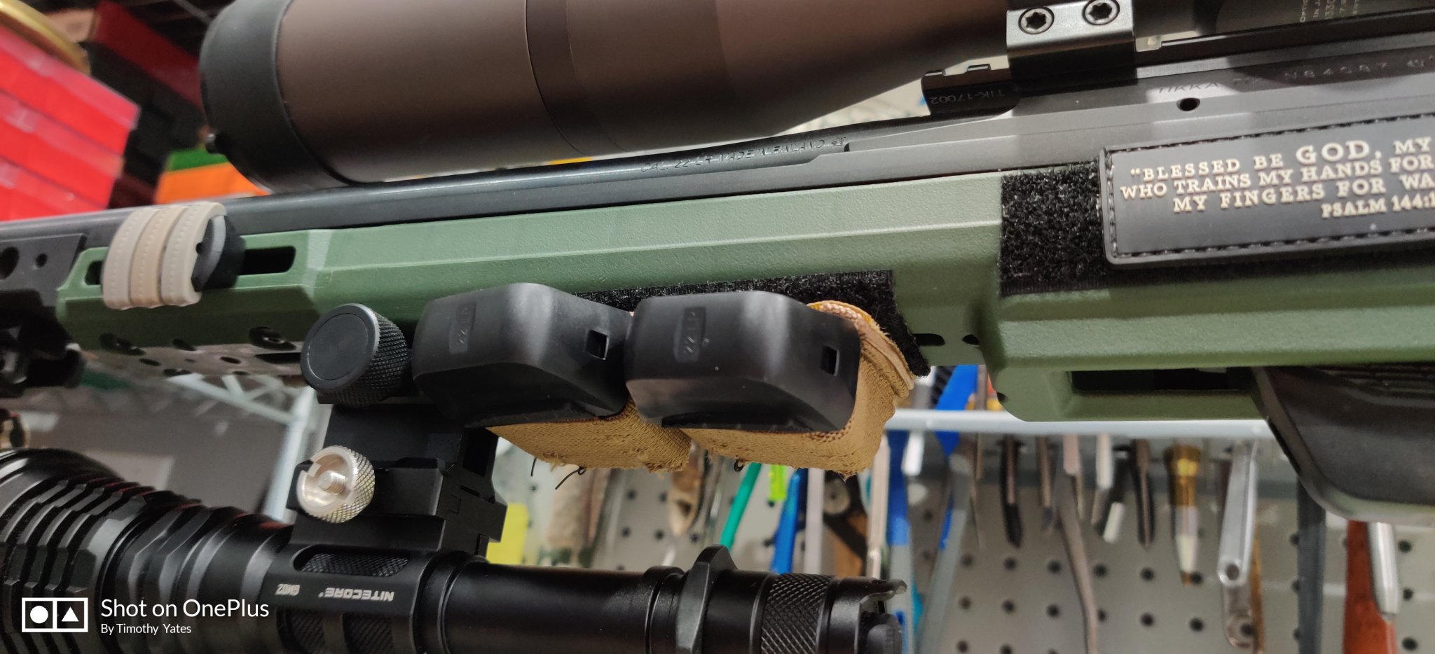

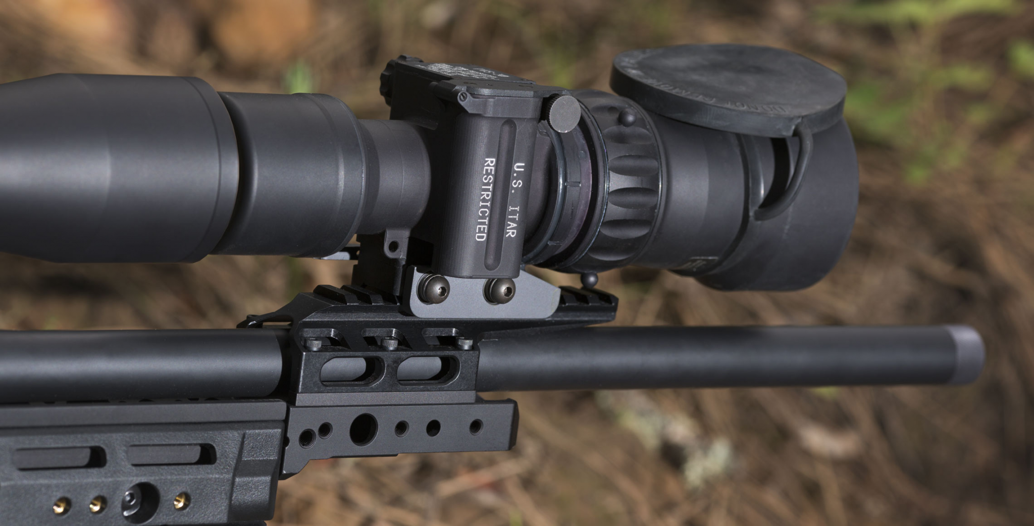

Let me introduce you to the Night Stalker. It works really well for shooting at night. No obstruction, isn't in the way when carrying by hand, easy on easy off both the light beam and the flashlight itself. Pretty happy with how it sits. The KRG Spigot mount is needed if you want to use the light underneath and use a bipod. Even with this setup you could easily get your hand out front on the stock and the flashlight wouldn't interfere with your grip. Also, you don't have to use a big flashlight but once you get used to the output it's hard to put a smaller one back on. The mag holder is just there to.....hold mags lol. I mean, if I was hunting I wouldn't put mags in mine because the fit is not tight enough. When I go to the bench I get tired of rounding up mags so that's why mine is there.
Another thing about the spigot mount is you can buy a night vision mount cap kit that would allow you to mount a clip on night vision device. You could actually do that without the spigot mount with the newer Bravo stock.
View attachment 7234829View attachment 7234831View attachment 7234832View attachment 7234833View attachment 7234836View attachment 7234838View attachment 7234839

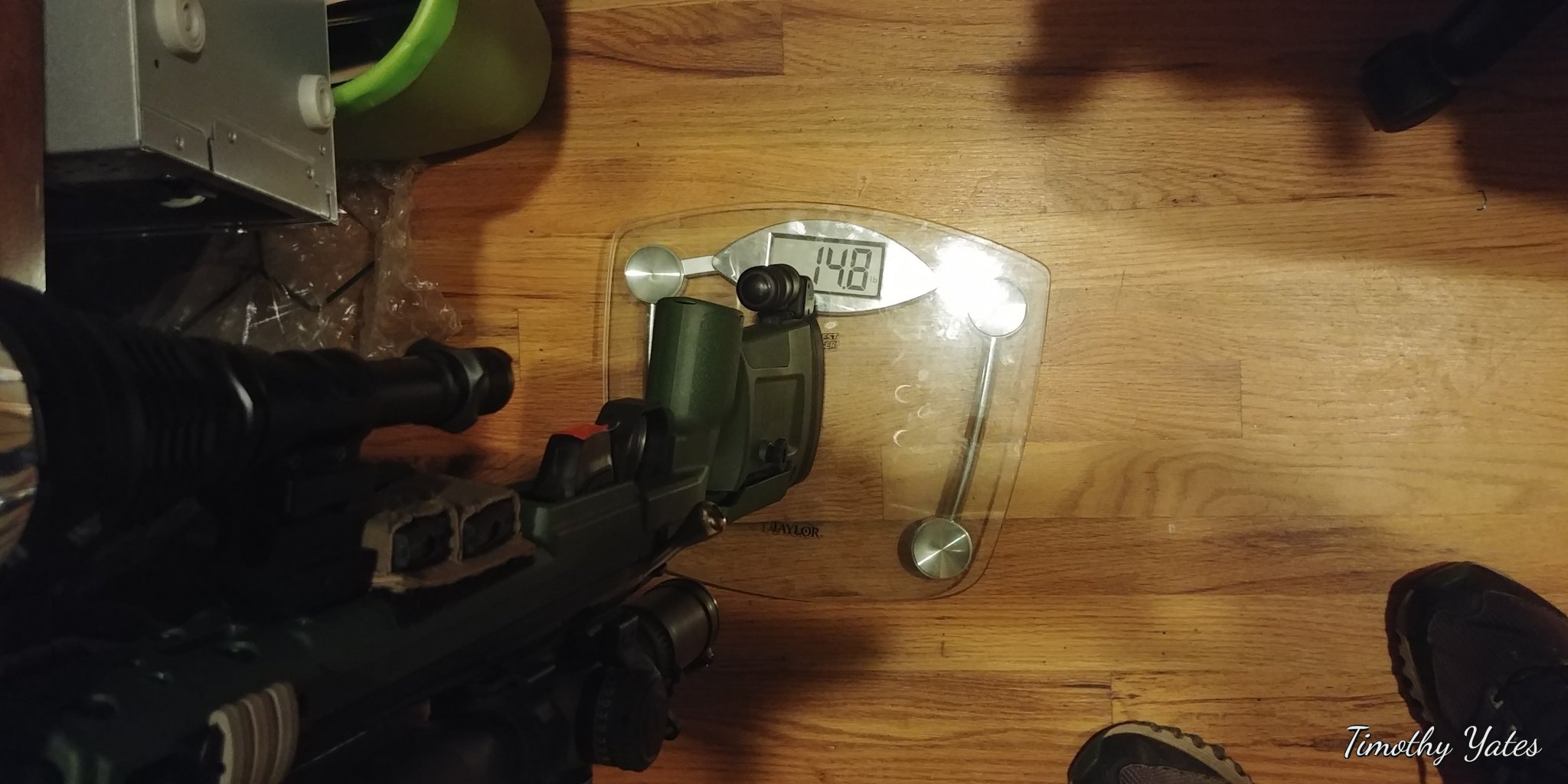

Rifle weight as shown. Can be a lot lighter with the removal of that scope. Scope weighs 46.5 oz according to Vortex's website.
Dual light setup. Wasn't effective because the larger light overpowered the smaller one. Two of the same size would work IMO.

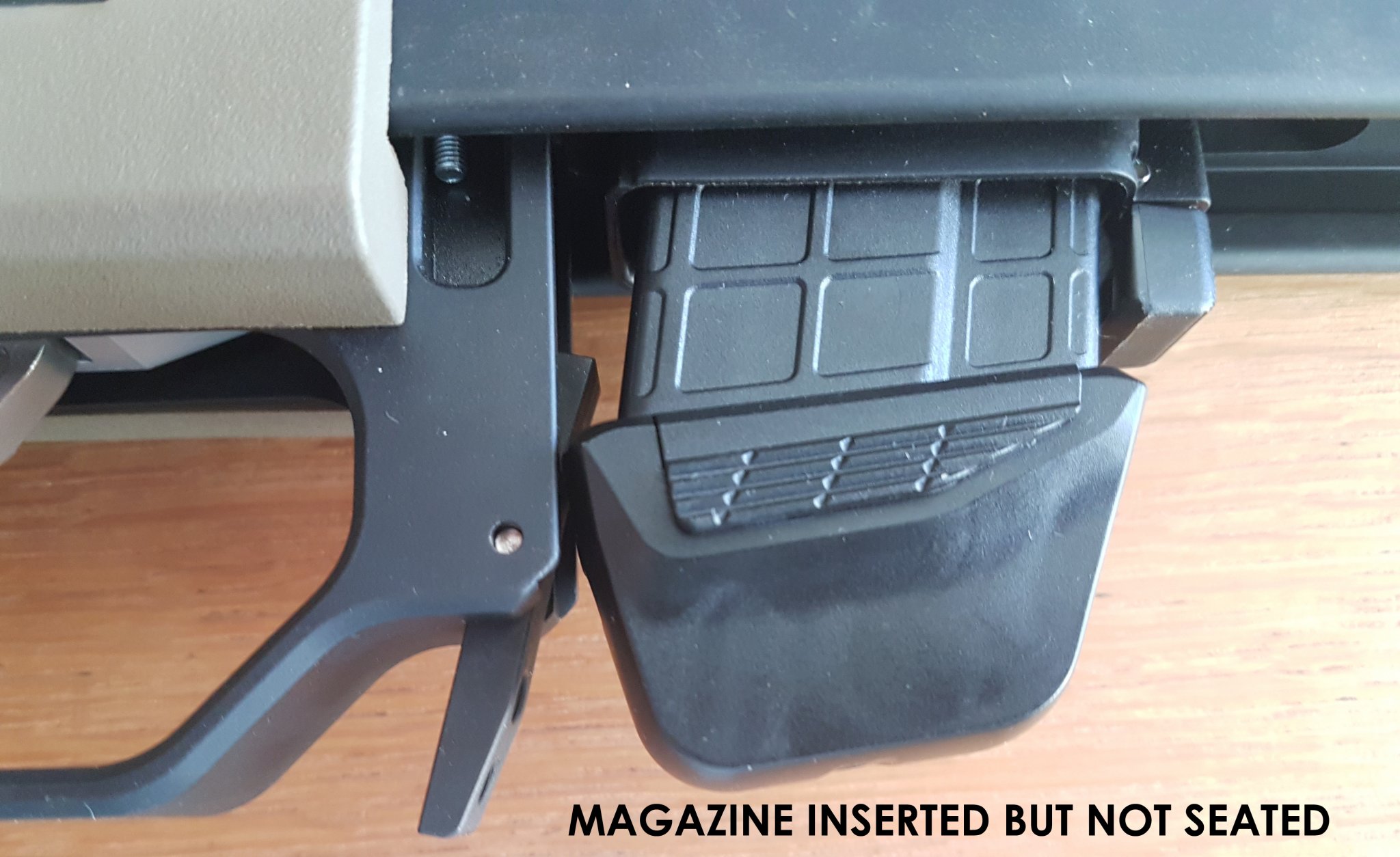

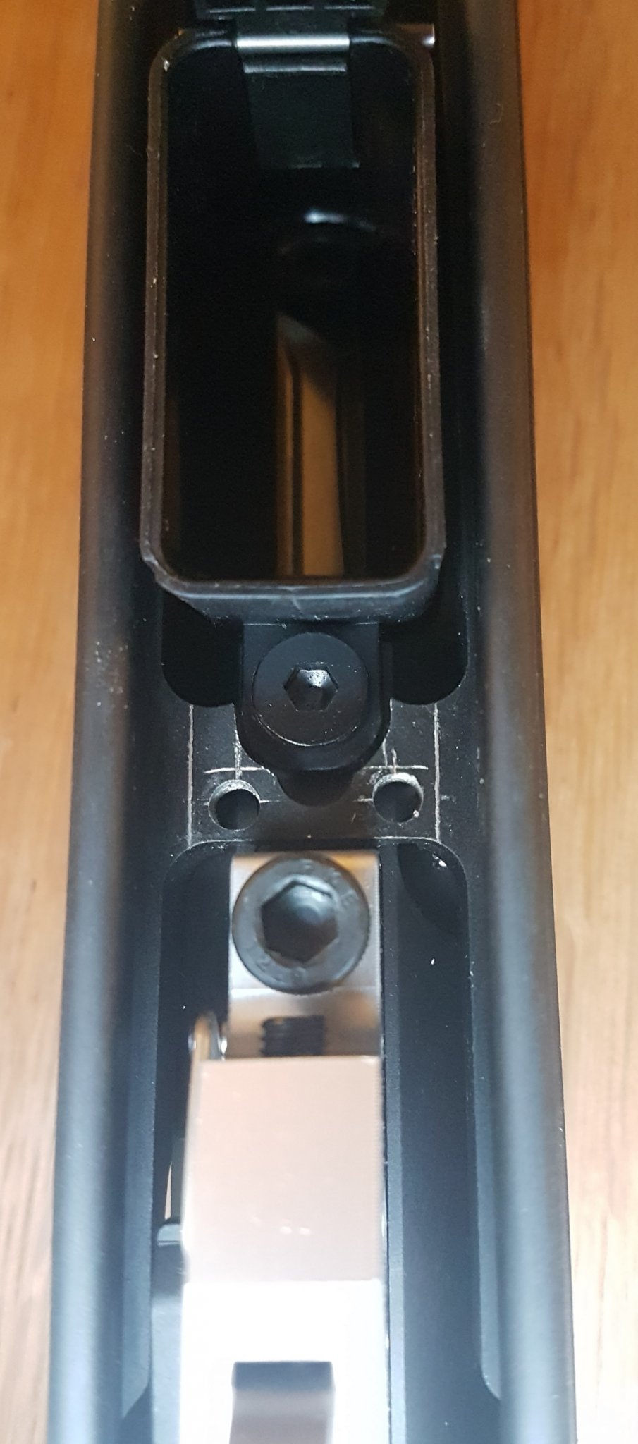

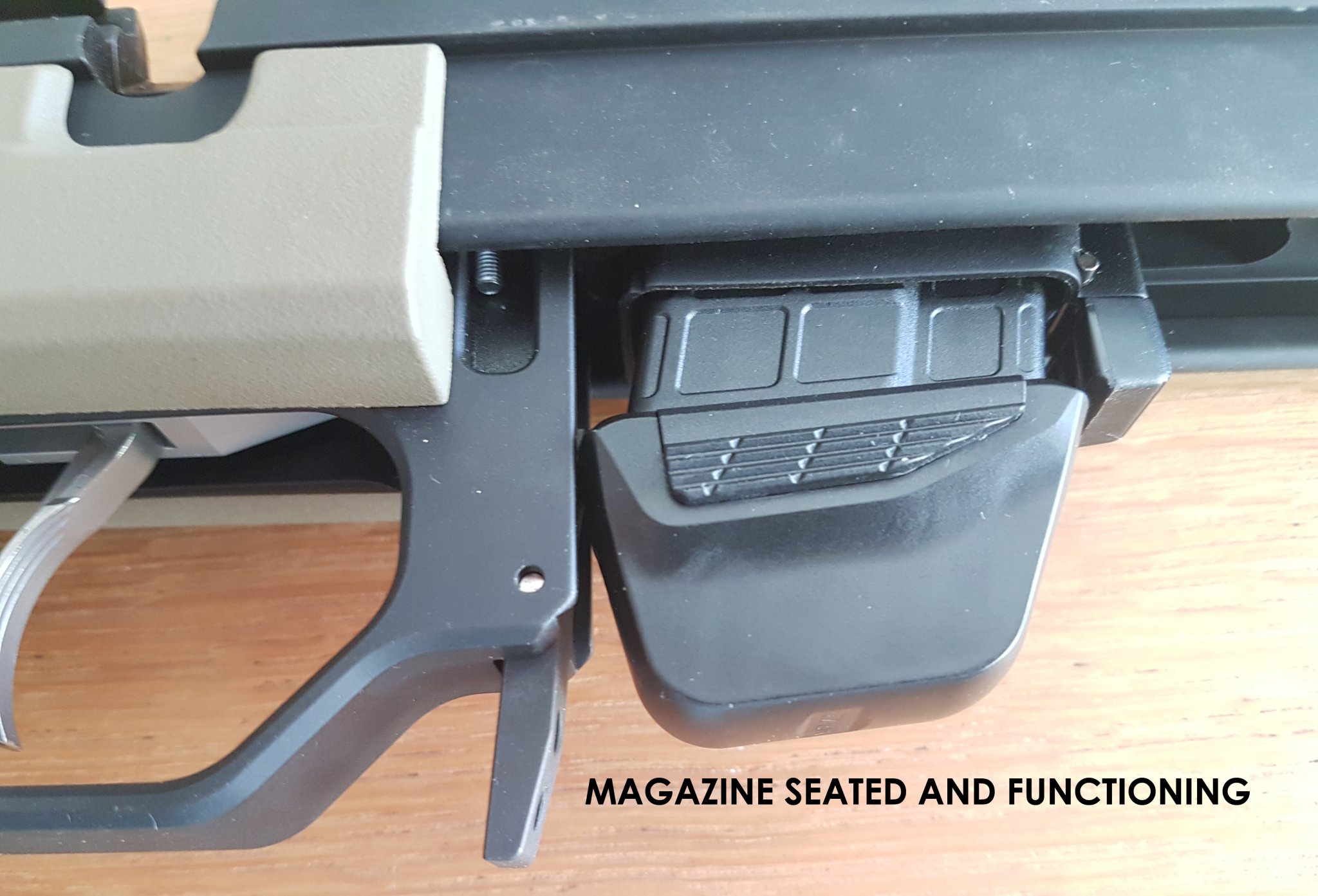

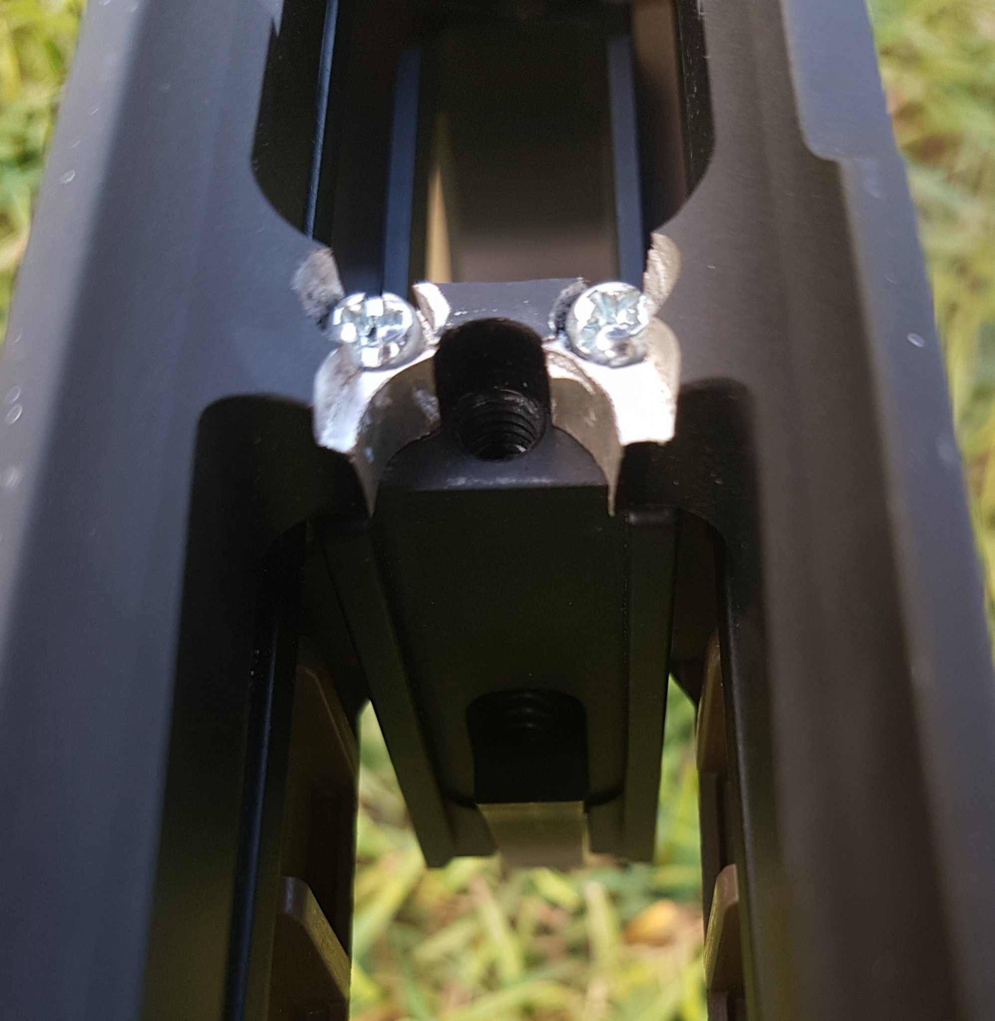

I finally got around to modifying my T3 KRG Bravo to suit the T1x.
Pictures should explain it, but it involved a short head cap screw for the magazine well, drilling/counterboring 2x holes in the top of the Chassis to suit M3 screws (will probably change them to hex drive pan head - zinc philips were all I had on hand).
Drill and Tap M3 into the trigger guard due to the existing screw no longer being used.
Remove/Drill/Mill/File material to allow for Plastic Tab on Magazine and Cap screw.
I've checked it all assembled and can still use the T1x magazine with the AICS mag lever in place. The bottom rear of the magazine presses against it, but it means I can swap a T3/T3x and T1x in the one stock. I did make the Thru-holes a little bigger so the 2x M3 screws can slide a little back and forth to get the right tension when using AICS magazines still (original screw did the same).
Next up will be a Sterk handle and shroud ;)
