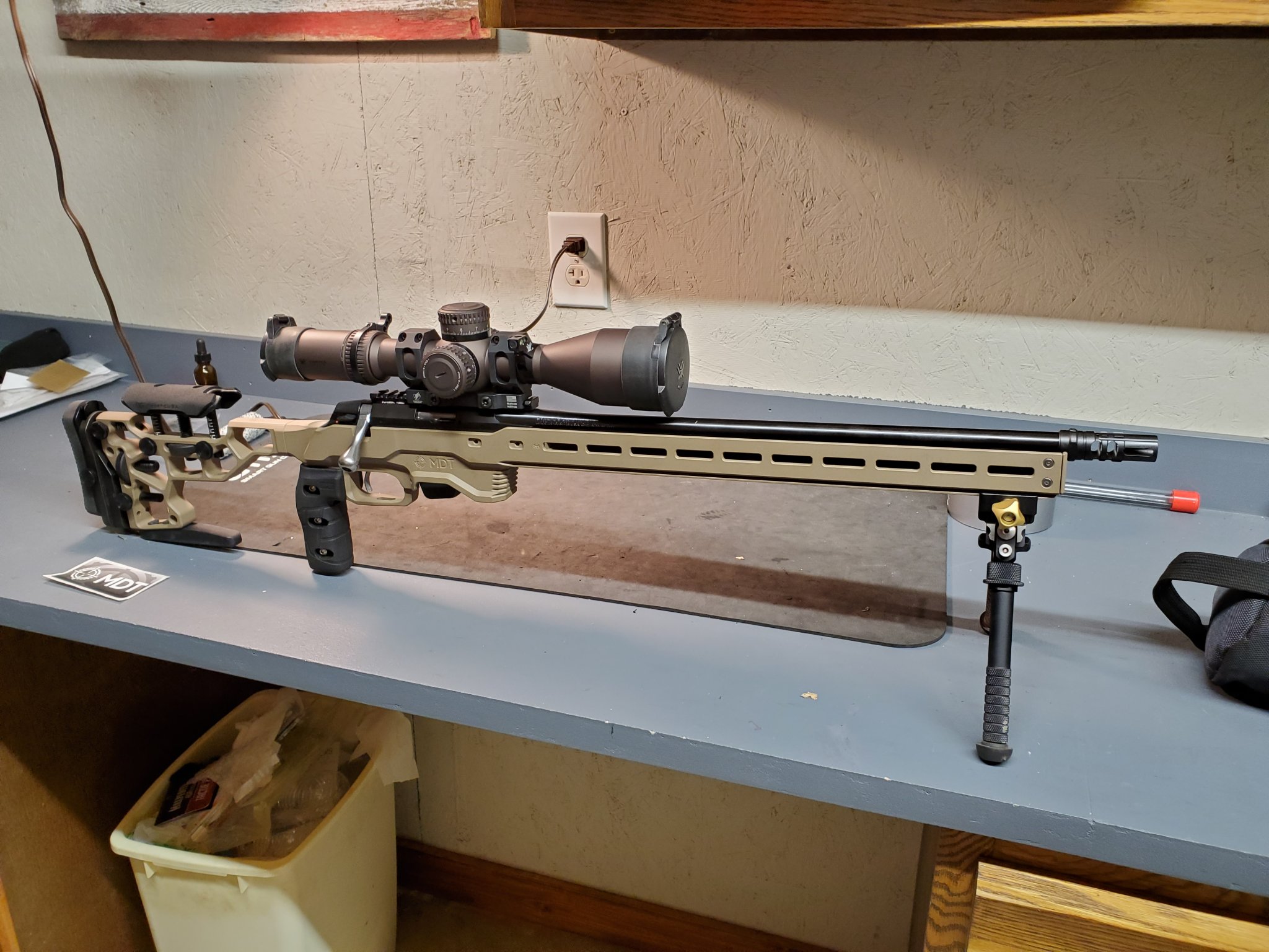

I’ve got almost the exact same setup; did you have to do anything special to get the MDT weights on? Or did they drop right into the Bravo’s Mlok slots naturally?
The MDT weights drop right into the M-Lok slots on the Bravo. For my setup with the weights & the IBI barrel the balance point on the rifle is right in front of the Bravo mag well. As it sits the rifle is 12 1/2 lbs which make it incredibly stable.

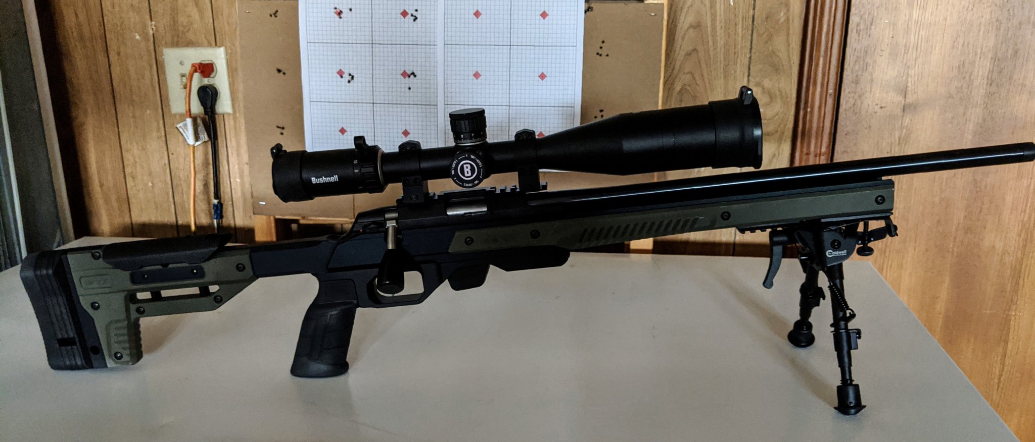

I dropped mine into an Oryx chassis, and since that moves me to open class I went ahead and topped it with a Bushnell Forge 3-18x50 that I used to use on one of my Creedmoors.
I’m just breaking in the barrel with some CCI SV but it’s looking good so far. Lower left is first 5 shots then the other 3 groups were 10 shots at 25m. Looking forward to testing some better ammo when I can get my hands on some.

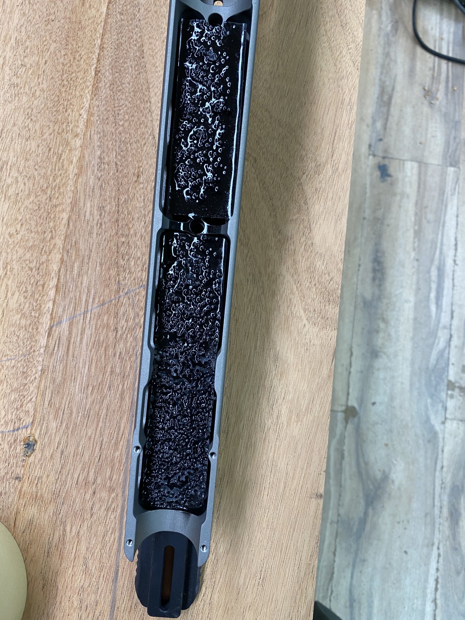

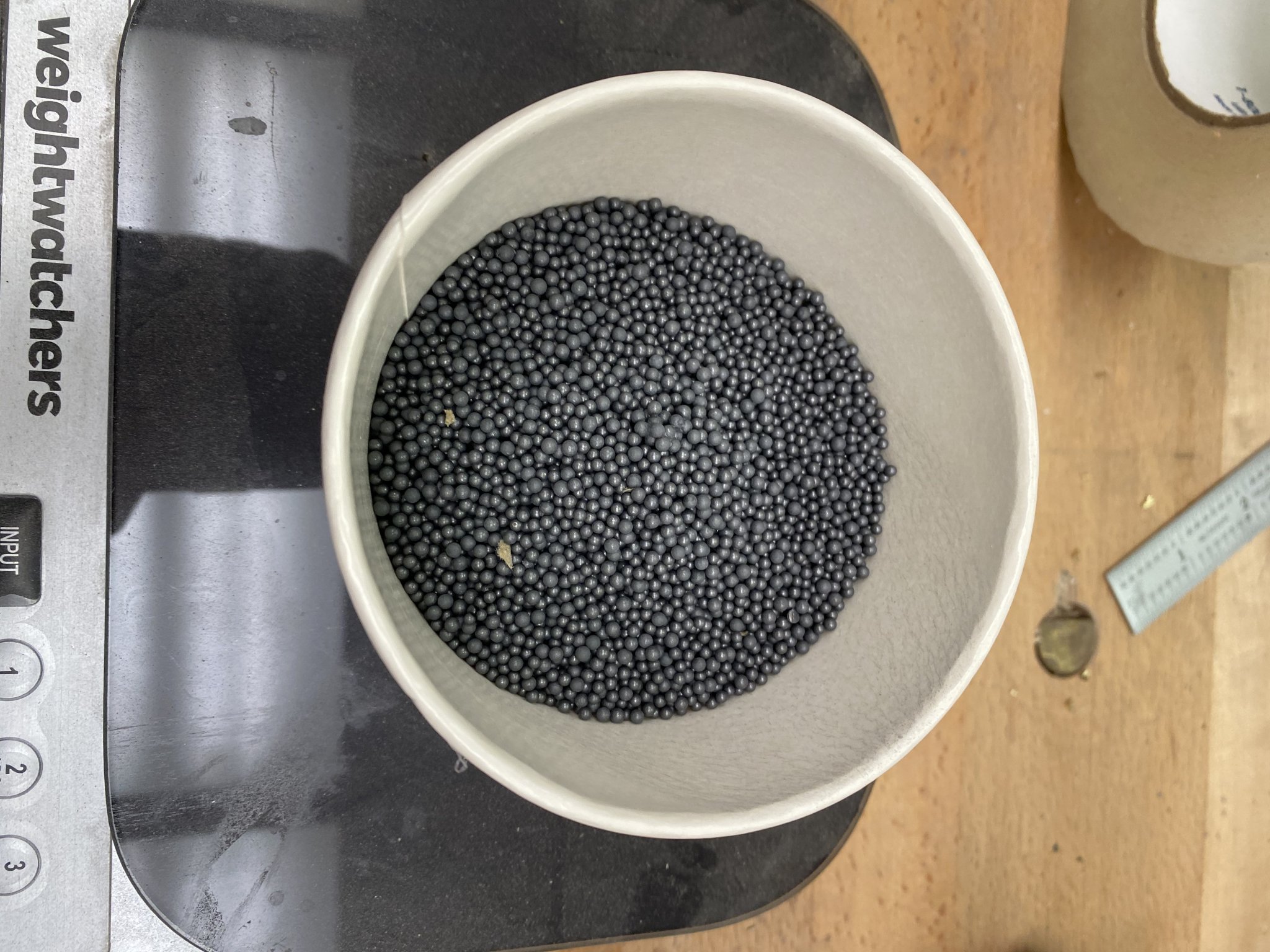

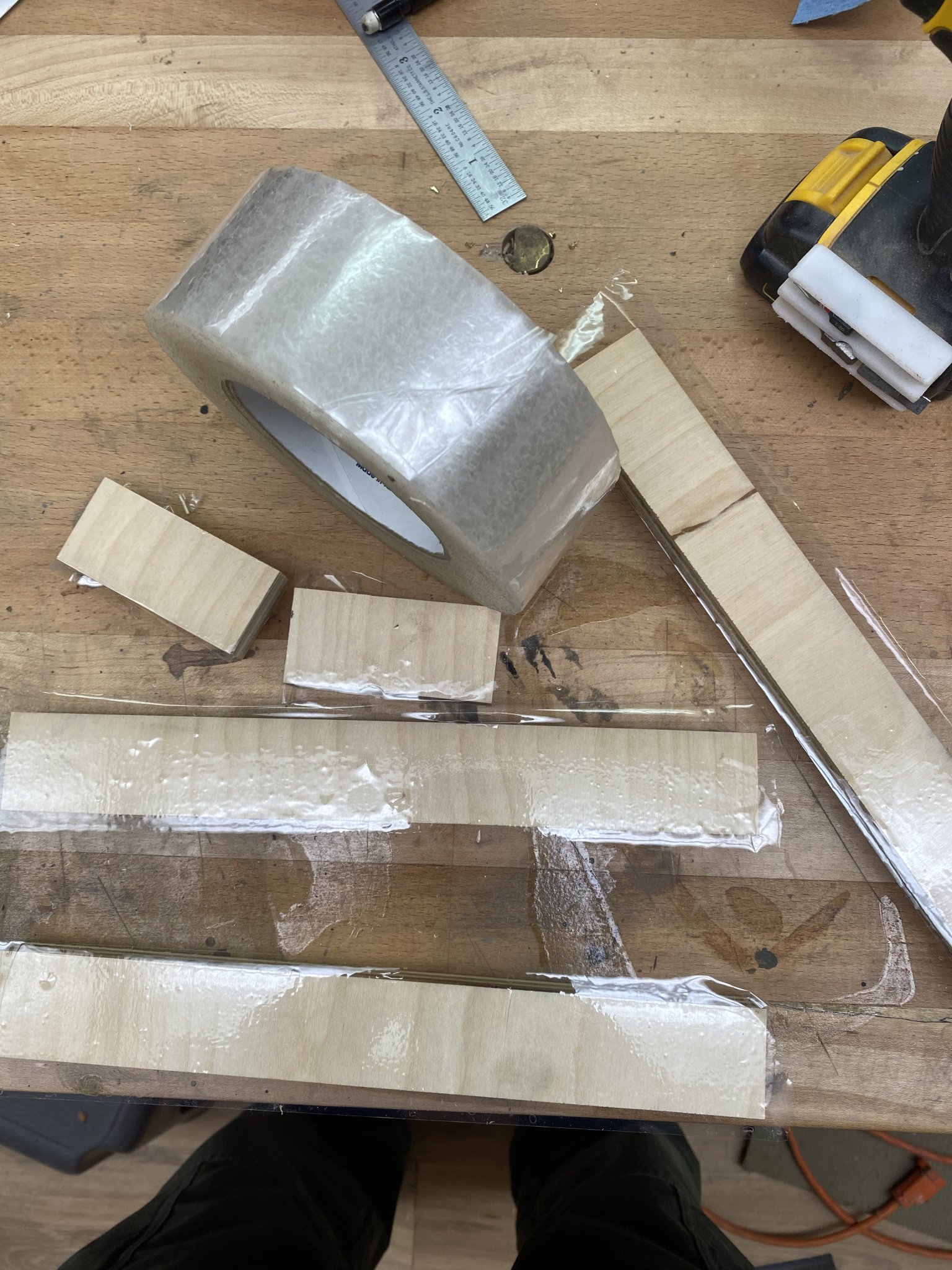

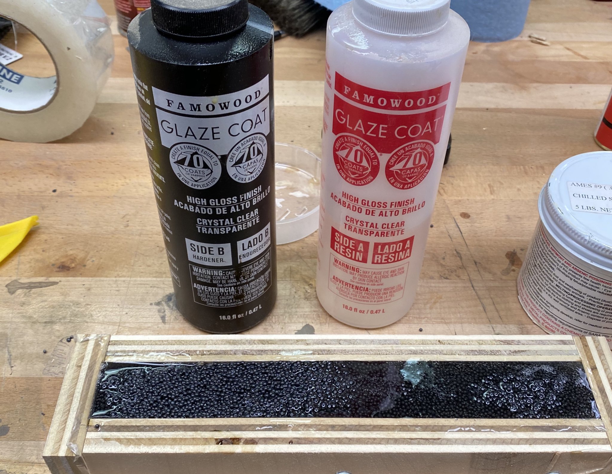

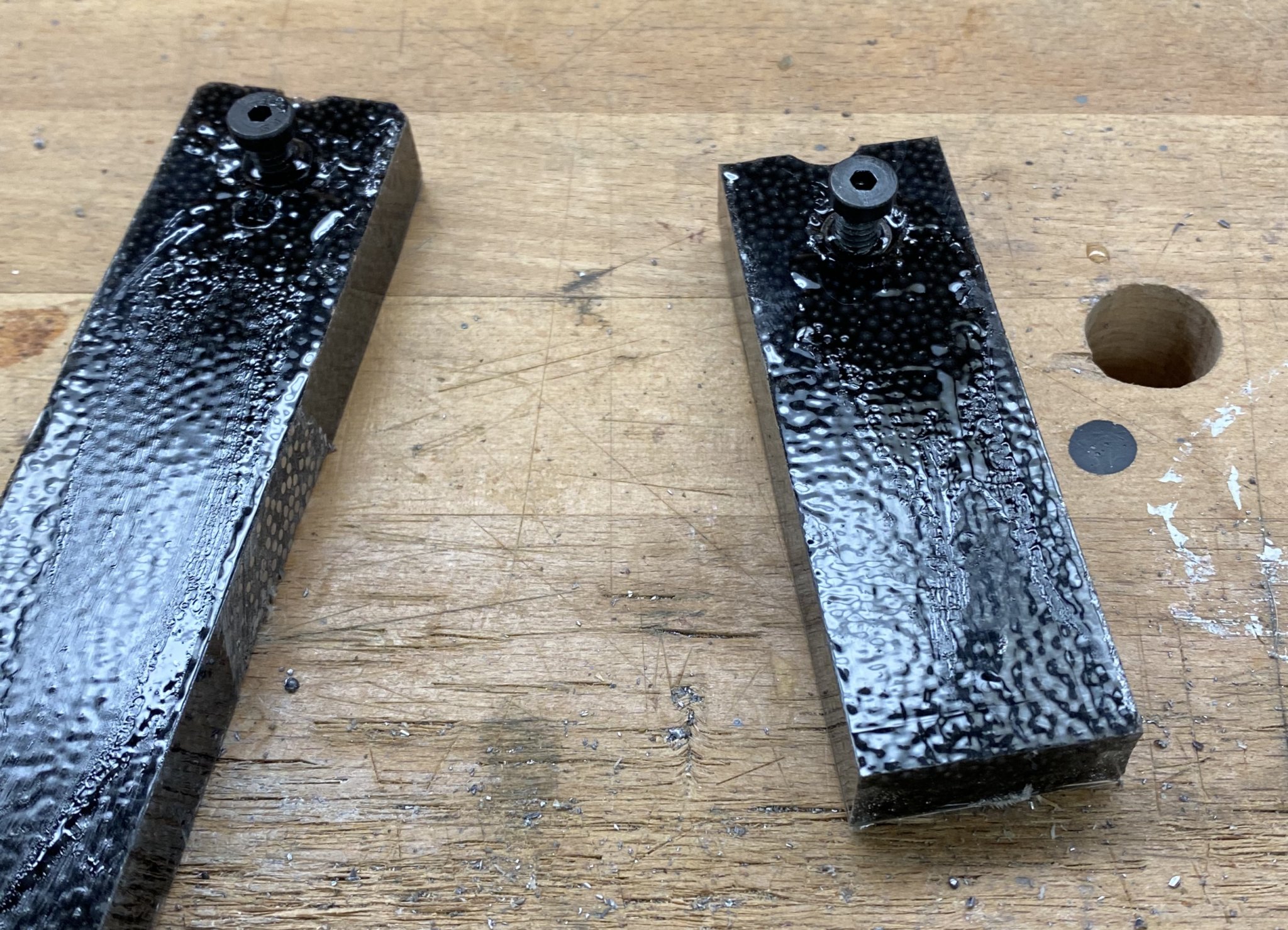

I don’t know if you found a solution for the light weight of the Bravo. I put the MDT exterior weighs on the outside M-Lok slots and they add 0.78lbs. You could also add a set to the bottom slots if you aren’t using them and want some more weight.
There are quite a few options to add weight. For the butt spacers I drilled out the centers of those and filled them with lead shot and epoxy. Each spacer adds about .35 pounds. For the front you can do something very similar to what I did with my MPA chassis. I needed to add weight to the front to balance it but couldn’t find weights anywhere so I improvised. Hopefully these photos will tell the story but I will explain a little as well. I made a mold using scrap plywood that I covered with packing tape. The packing tape is to keep anything from sticking to the plywood. I basically made a box the same size as the inside hollow of my chassis under the barrel. I poured a little 2 part epoxy in the mold then filled it with #8 lead shot. After the mold was full of shot I slowly covered the shot with epoxy. You need to get the kind of epoxy made for pouring on countertops like Home Depot has. 5 minute epoxy is too thick and will not flow. After 24 hours I broke everything out of the mold and hit it with a coat of black spray paint. In my case I wanted to be able to bolt this to the chassis so I drilled a few areas and imbedded the nuts I needed and used thick 5 min epoxy to secure these. I was able to add about 2 lbs to the front this way. Once the weight is cast it’s pretty easy to cut and can be designed to fit pretty much any chassis with room under the barrel

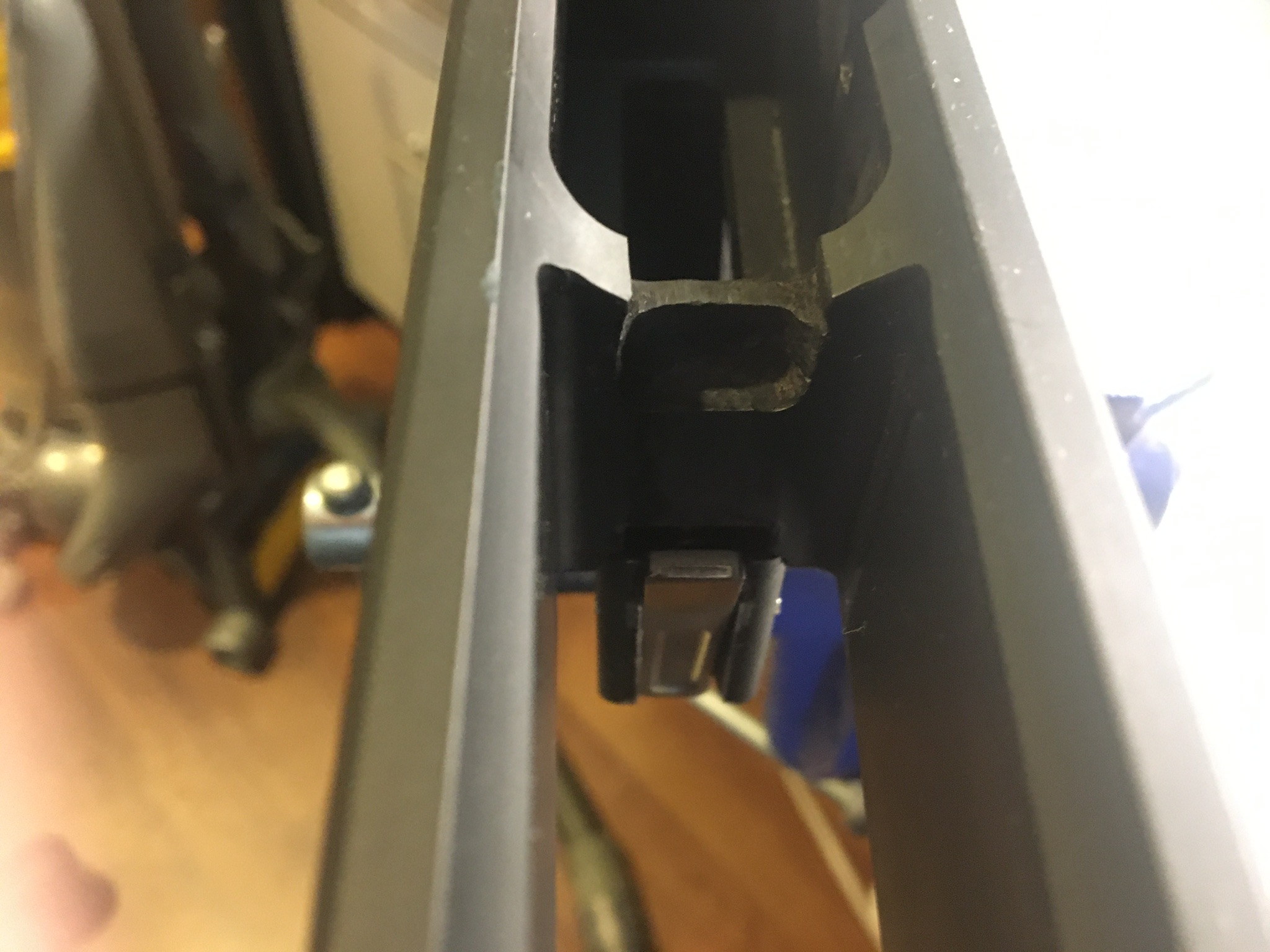

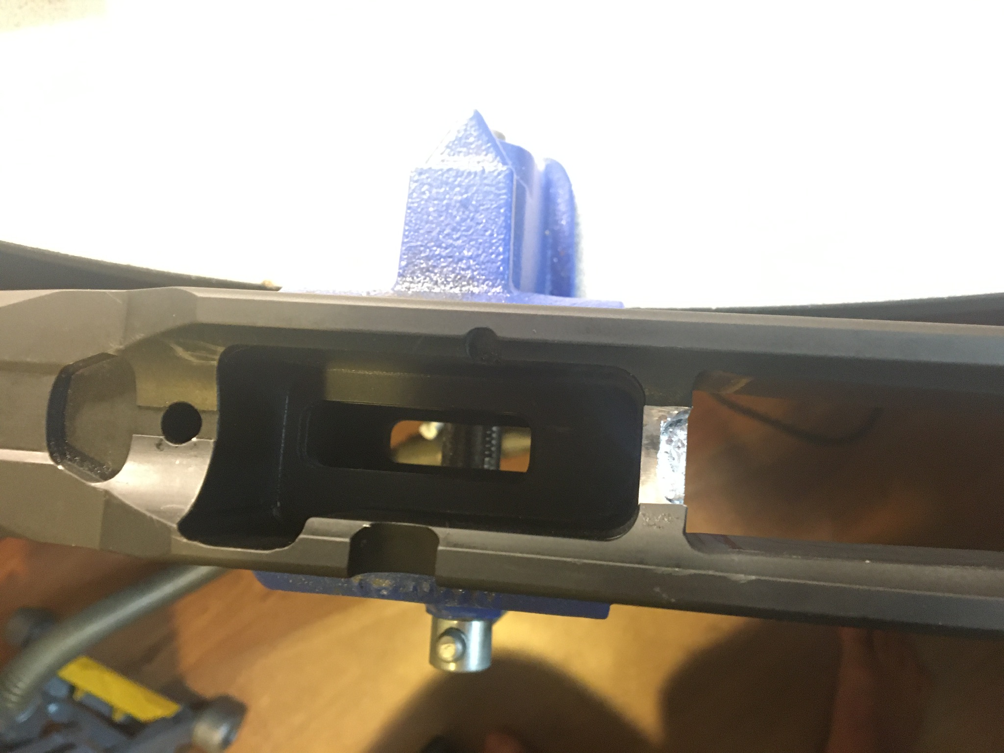

Anyway; if the element is anything like my carbon chassis for the T3 then you will need to at least mill out clearance for that bolt in order to put the T1 into it. Below are some photos of my crappy Dremel work as I was to lazy to bring it into work. XLR sells a new trigger guard that removes the mag release that interferes with the Tikka mag. But I’m not certain it’s required but it’s only $35. Anyway; here are my photos if it helps you with the element. View attachment 7300545View attachment 7300546View attachment 7300547View attachment 7300548

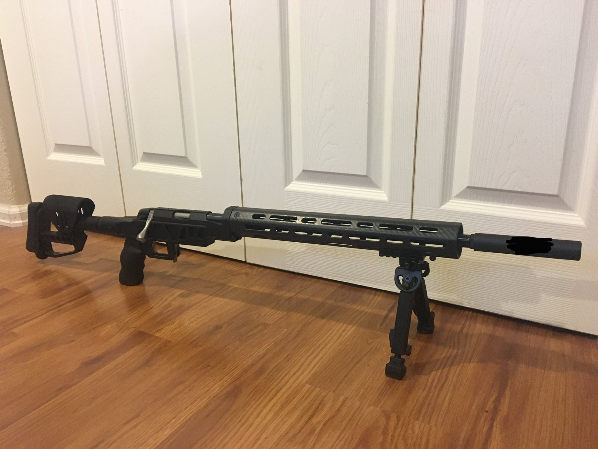

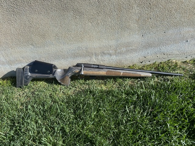

Oh man UPR.... that looks like the borrowed really nicely from KRG. I love it, wish that was available when I was putting mine together....but nicely done Tikka. Give the people what they want. They are definitely listening to the market.
Well the wife’s Mother’s Day present is half done :)
I still hate that they haven’t sent out the 16” barrels but oh well
