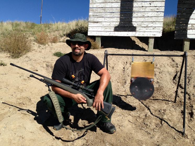

I had the same thoughts of building a light weight rig last spring. I was tired of hiking a 12.5 pound rifle through the mountains. After a lot of research I choose a tikka lite in 7mm rem mag. I added a break, a limbsaver and I duracoated it. I hand load and shoot 140 hunting vlds. This rifle is unbelievable. 1/2 MOA out to 600, and 1 MOA out to 1000. I've attached a pic of a six shot group on a 12 inch gong at 1050yds, and the elk I took at 352yds a month ago. I think your project would be money. Do it!

dang. Nice shooting soldier.
