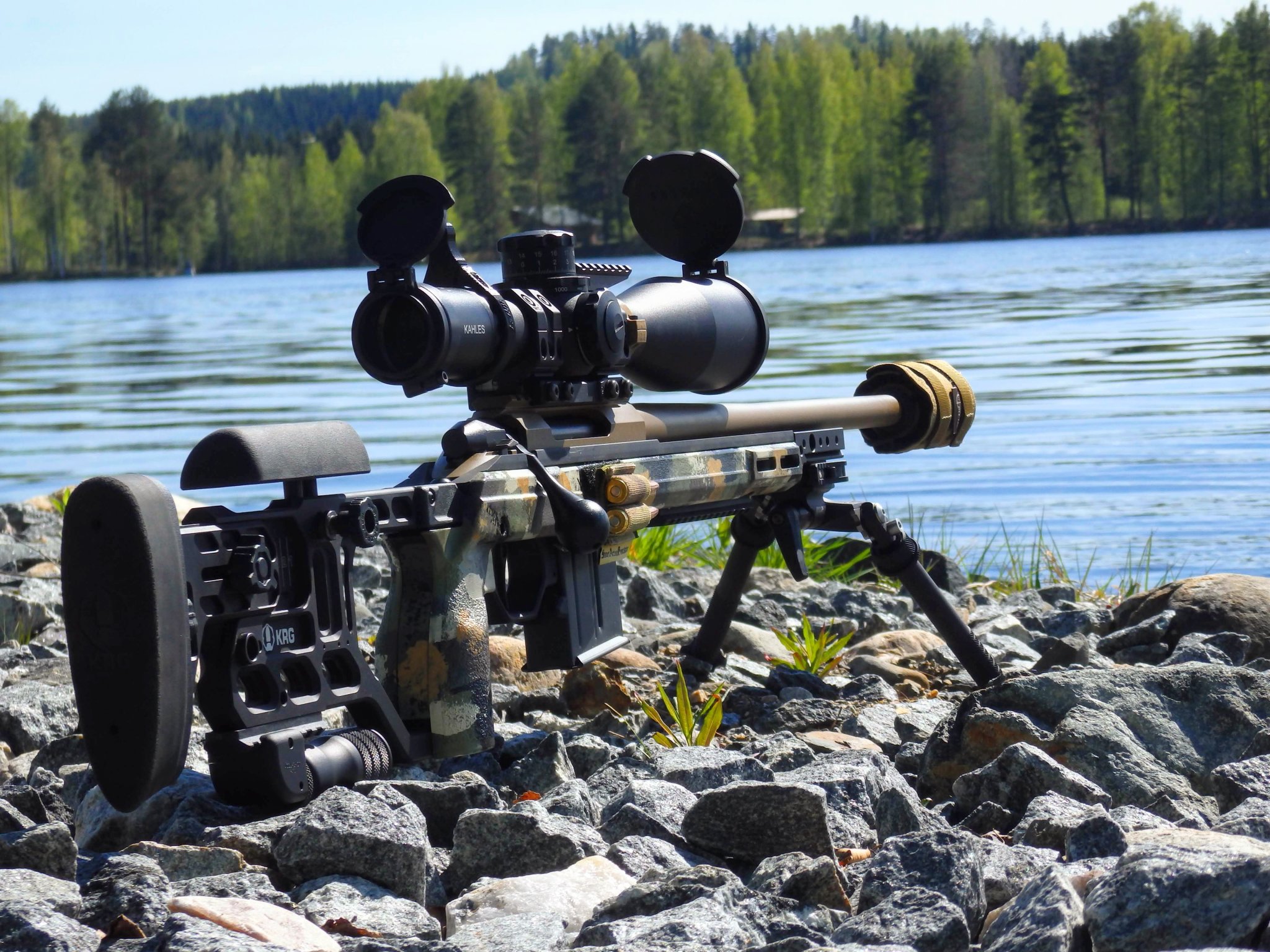

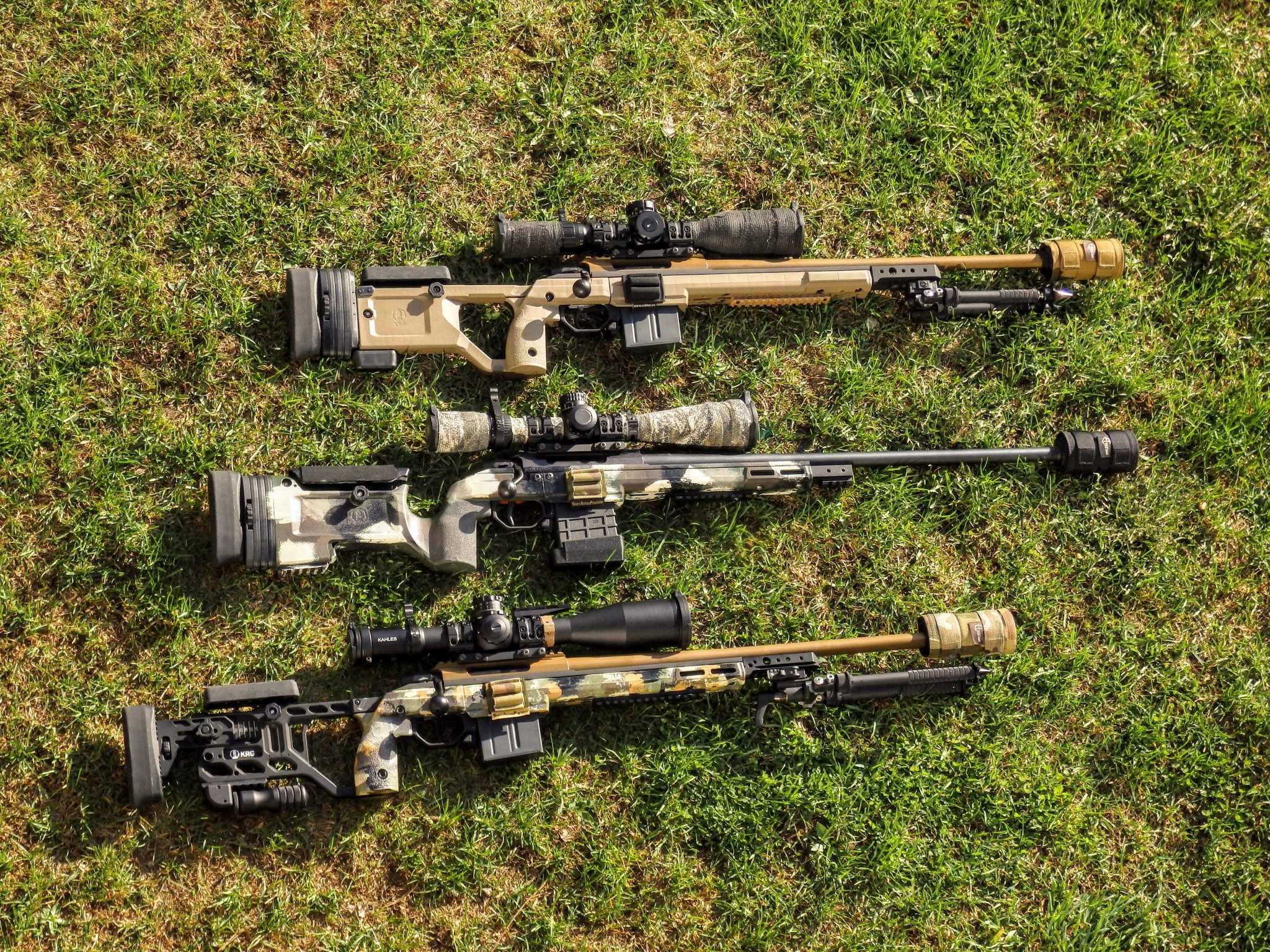

It's the one in the middle of the photo with the vertical grip

Viking, I could really use a hand with a question.

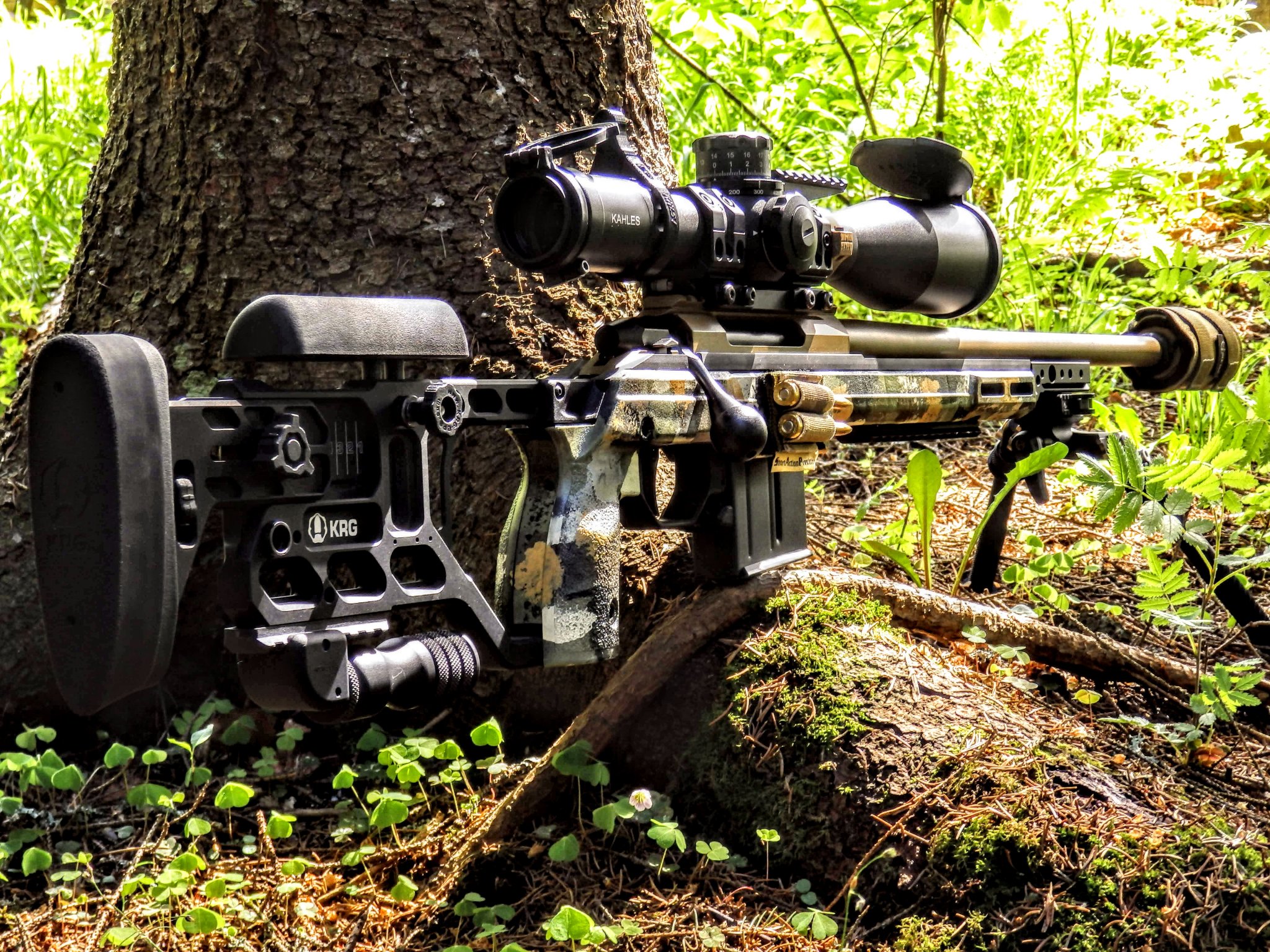

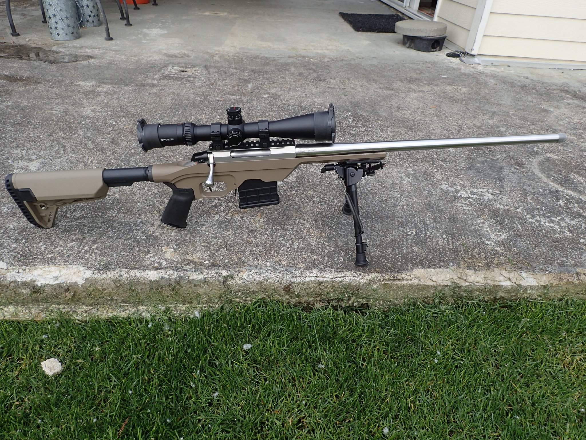

The center rifle pictured with the KRG Bravo and 223 mag... what is that magazine? I have an accurate 223 mag in my T3X stainless 223 and while in the Bravo, the mag will *not* stay fully seated upwards... I have to actually apply upwards pressure on the mag or it is too low to feed. Just swapped a week or so ago to the Bravo, but I have got to find a fix. Thanks man.
Hi.
For sure.
That is MDT 223rem polymer AICS magazine.
Work very well on KRG chassis and feed ammo to the chamber with out any problem.
That magazine has MKmachining extension kit on.

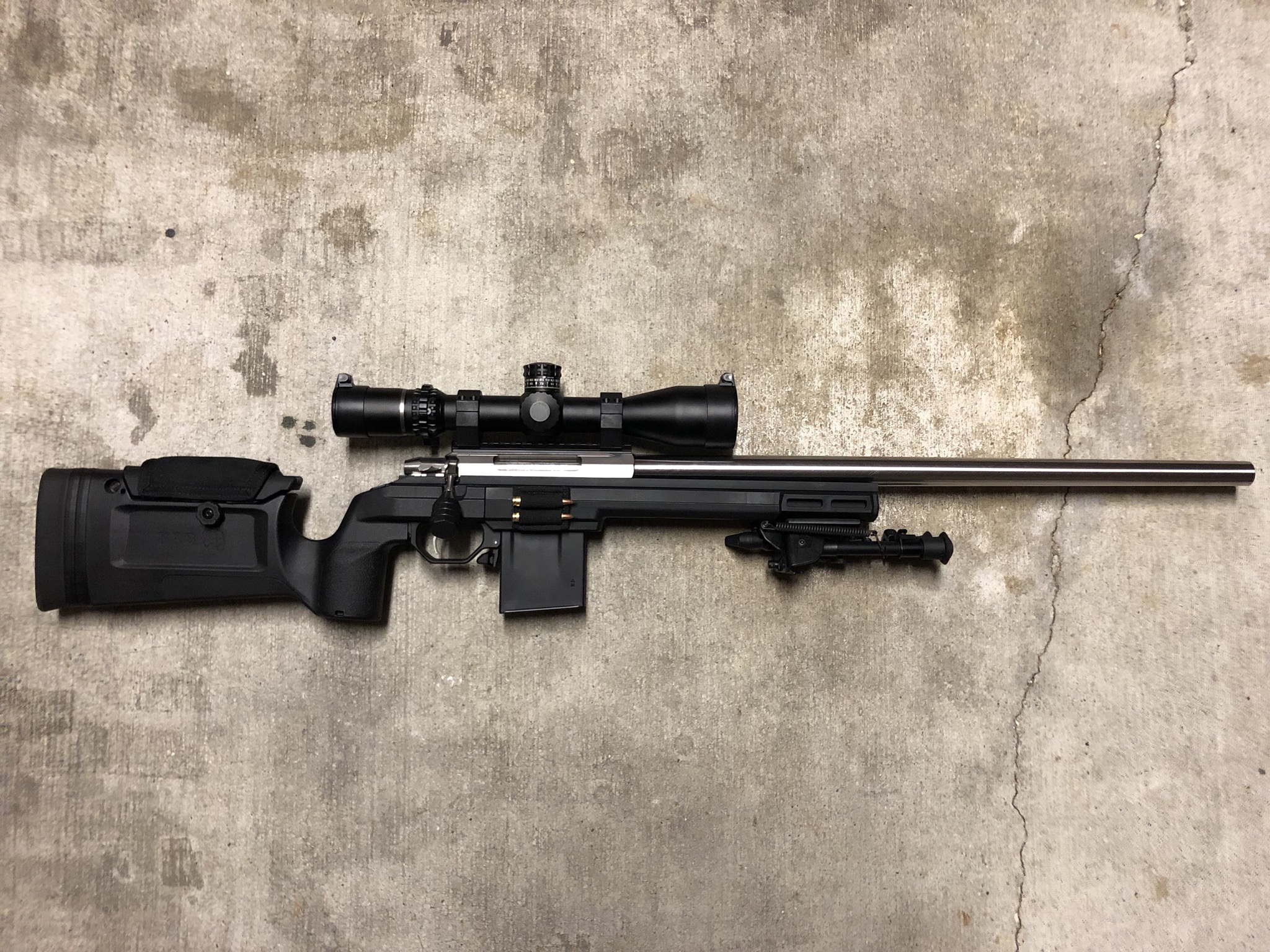

What is that cheek pad on the cheek riser? Is it strapped around it via velcro? I can't wait for the new krg bravo with the CTR inlet.
It’s a mini cheek pad by Wiebad. It attaches via Velcro. Only disadvantage I can see is that you cannot fully lower the cheek piece unless you remove it. It just happens to be perfect for me fully bottomed out + cheek pad.
What’s different about the CTR inlet? Thinner barrel channel?
Nice rig :cool:.
Who´s barrel you got in your Tikka?
Thank you! The previous owner told me that it was a Kreiger. It’s a 1:8 twist 223, 24” long. A local gentlemen sold me the entire barreled action and trigger set unfired for $825, I believe.
With some purchased 69gr TMK loads, it regularly shot around 1.6” at 300 yards for me. I’ve taken it out to 700 and it’s a great little shooter. Can’t wait to get it threaded for my Sandman s. It’ll be a ball with a can.

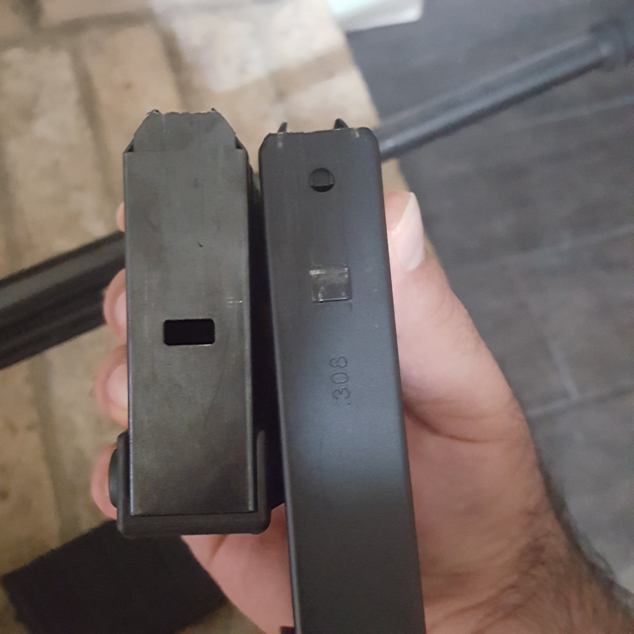

Fyi for you TSR-1 guys. The McRees G10 chassis meant for the CTR will lock up and feed with a single stack accurate mag. Thanks @jram for letting me borrow one!
