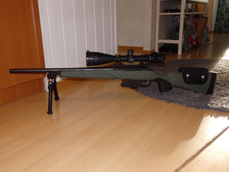

Latest improvement with the ESS stock outfit.
Kind of think, that this could be it.
Next thing i got the PRS bipod from Atlas, more or less easier to handle with that on the gun range.
Also in the santas wish list is a much better optics, something with 34mm main tube, more light and more view.
But this Sightron will do the job for that time, this aint bad, but dont got the +2G´s cahs for that optic now.
I really want to pull the trigger on one of those ESS stocks. Yours looks awesome. I have a couple questions for you:
-Is that the 18" forened?
-Are you using a 20MOA rail?
-What height rings are you using? My bell is already pretty close to the barrel and Im worried I would need to order taller rings to work with the added forearm height above the barrel.

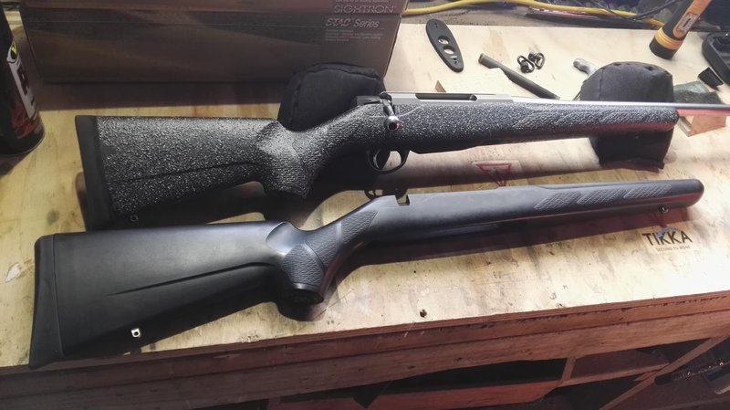

Got lucky and found a T3X CTR SS in 6.5 Creedmoor at my local gun shop the other day. They were charging the same as Europtic so I bit. Paid $1148. Now the hunt for some glass.
From reading through some older posts, I was getting pretty nervous about removing the stock rail, but I decided to give it a go anyways. To my surprise, only took about 5m to get it off. Not sure if they are using some weaker loctite, but all my screws came out easily and I was able to pop the top rail off with a heat gun on low for about a minute or two. Cleaned it up with some acetone. Now all I have to do is order my 20moa rail.
You got lucky, the front two screws came out with no heat just torx bit and socket. The back two didn't let loose with heat, I drilled them with a 9/64 bit and tapped a t20 torx in and they came out with a little finesse and heat. I'm glad it's over and now I have some experience with my next Tikka. I'm going to pick up a T3x 223 varmint as soon as I find one in stock, these things are a hell of a deal compared to other guns at the same price.
Oh most definitely. I was going to just try getting the screws out and if they weren't going to budge, I was just going to get a 20MOA scope mount and call it a day. I think I said a quick prayer before each screw when they started coming out so easily.
Is yours stainless? I ask because I heard those don't have as much threadlike. Mine is not, the rail wasn't epoxied on too terrible either.
I believe the stainless doesn't hold as good, I don't see them using a different threadlocker for the different finishes. There's no telling though, I have heard a few people say that the screws for the rail are much easier to remove on the stainless rifles.
I have a SS and it came with threadlock on the screws and rail. A few passes with a gas torch and it came out easily. It took me more time cleaning the threadlock residue on top of the action than removing the rail itself.

Hi.
Yep, that is 18" NV forend, and i do not have the ESS 20MOA picatinny rail on that, just the basic Tikka CTR picatinny rail, work just fine.
But i had to buy the high model Vortex precision rings for my scope, because of that forend tube, scope is Sightron SIII 6-24x50, i had with GRS Berserk stock before this, and mid high
was just fine for that stock model.
