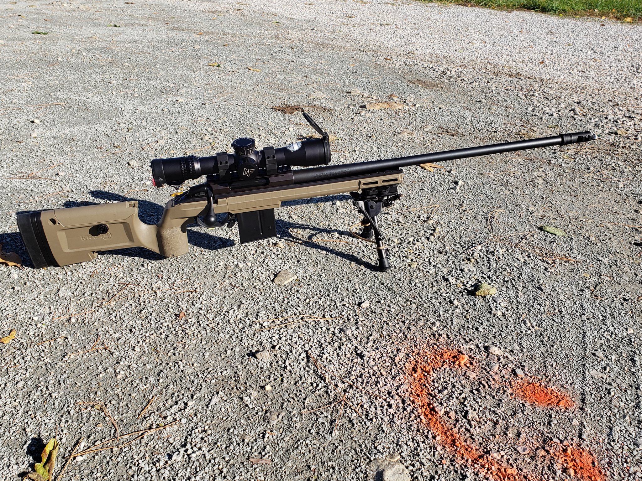

My first attempt at a precision rifle
CTR 24" 6.5creedmoor
I am completely new to Tikka's. Ordered a CTR last night and expect to swap out the stock fairly quickly. I was just reading the thread discussing KRG creating a different inlet for the Bravo so it would accept the CTR mags. Sounded like it was in the works but, based on projected date, seems to be stalled out.
So my question to this group is, has anyone done (or seen done) the modification of the AICS inlet to accept the CTR mags and bottom metal? I've got the skills and equipment to do the job but, wondering if there is enough "meat" on the Bravo chassis to accomplish this.

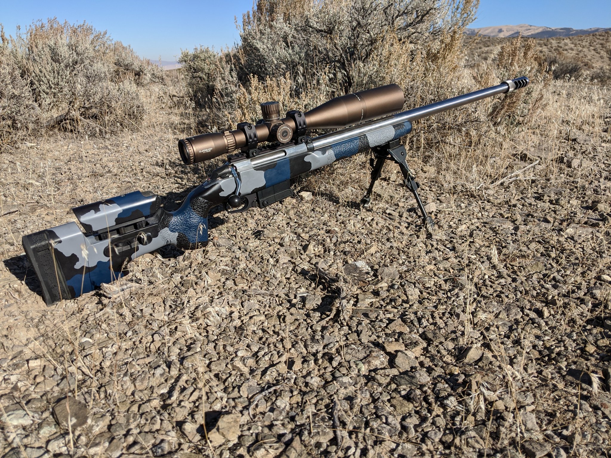

This be my Tikka:
  • Tikka T3
  • Tikka performance trigger spring
  • Arc Barloc
  • Sterk bolt knob
  • Area 419 Sidewinder
  • Athlon Ares ETR with sunshade
  • McMillan A5 Fully Adjustable in McMillan Urban Camo
  • McGowan .260 AI 26" #7 profile barrel
  • Arc Rings
  • Nightforce 20 MOA rail
  • Currently using CTR DBM, but I switch it out for the Mountain Tactical AICS sometimes
  • Freaking piece of garbage QD bipod

Looking very good, how does she shoot´s?

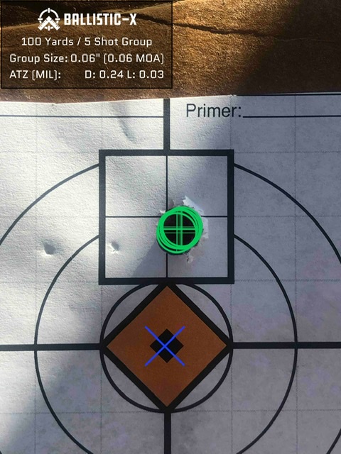

Nice. What's your freebore and COAL? I'm one of the few folks that I know that use RL23. I get great results as a replacement of RL26
I load to about 20 thousandths off the lands with a base to ogive desired length of 2.62ish. I should be more particular about consistent base to ogive lengths, but truth be told, I'm ok with some variance as long as my gun shoots sub 3/4 MOA. COAL is somewhere in the neighborhood of 2.94", 0.005 from max mag length.
I want to use RL26, but over the last year, I have never seen it on shelves. I can readily find RL23 from multiple local locations, and I only just start to see pressure signs around 47gr and 3016 fps. I wanted to shoot for 3k fps and got it, so I'm not complaining. I'd much rather go with something readily available than have my shooting be at the mercy of a unicorn powder's availability. I feel like RL23 is one of the best kept secrets as far as Alliant powders go.
