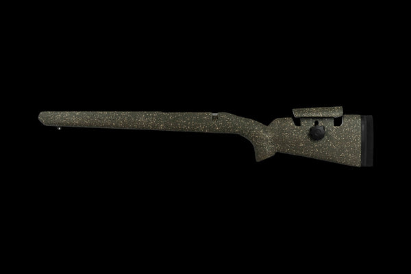

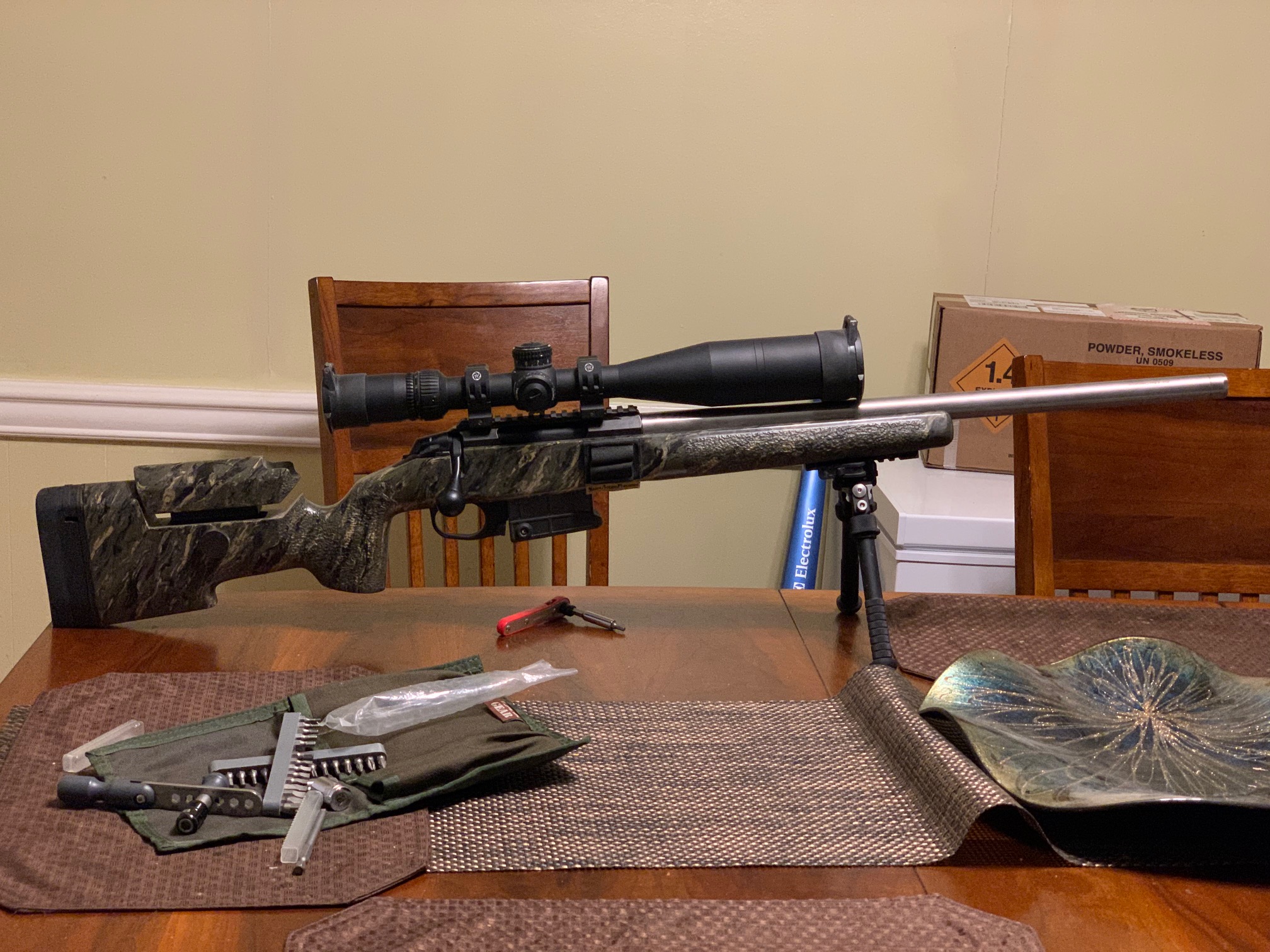

My new B&C Medalist #6 stock arrived today. Not a lot out there on how these fit the Tikkas so I thought I'd share some pics. Two things I think are important to know;
1) The aluminum bedding block and recoil lug fit perfectly. I had to get the alignment exact to allow the receiver to fit down over the recoil lug. After installing the action screws and torqueing to 65in/lb. I loosened the rear action screw to see if there was any movement. There was none! The receiver stayed exactly in place and pushing down on the rear of the receiver induced no movement.
2) The fit of the factory Tikka bottom metal is outstanding! I was not expecting the fit to be this good.
The finish of the stock is very consistent. The adjustable comb has E-clips that allow you to quickly set it back to your height if you remove it. The only things I don't really like is the need of an allen wrench to remove the cheekpiece so the bolt can come out and the somewhat large gap between the barrel and the stock. The stock is opened up to accept a pretty large barrel so the gap is to be expected. I may swap out the allen screw on the comb adjustment for a thumbscrew of some sort.
Bob
2019-11-14_04-21-12 by Bob, on Flickr
2019-11-14_04-20-54 by Bob, on Flickr
2019-11-14_04-21-37 by Bob, on Flickr
Bob
Very nice Bob!
Is that a CTR that you have installed? I have a 223 Varmint I need a stock for, this might be the ticket.
Since it has an aluminum bedding block, does that mean it doesn't have to be bedded? Just trying to learn.
Any reason to get this over a KRG Bravo?
It is a CTR. It does not need to be bedded. The bedding block is pretty much the same as bolting into a chassis. I seriously considered the KRG Bravo but went this route because I prefer a more traditional style stock. I wouldn't say I dislike the skins-over-chassis concept but, I prefer a more solid feel. This is my first Tikka so I can't say much about them but I've seen that a lot of people are pretty excited about the new Bravo that will be inlet for the CTR mags. I like that the CTR mags are shorter than the AICS mags so that was another reason I went for this stock. The new Bravo is not yet available but, is supposedly coming very soon.
Bob
