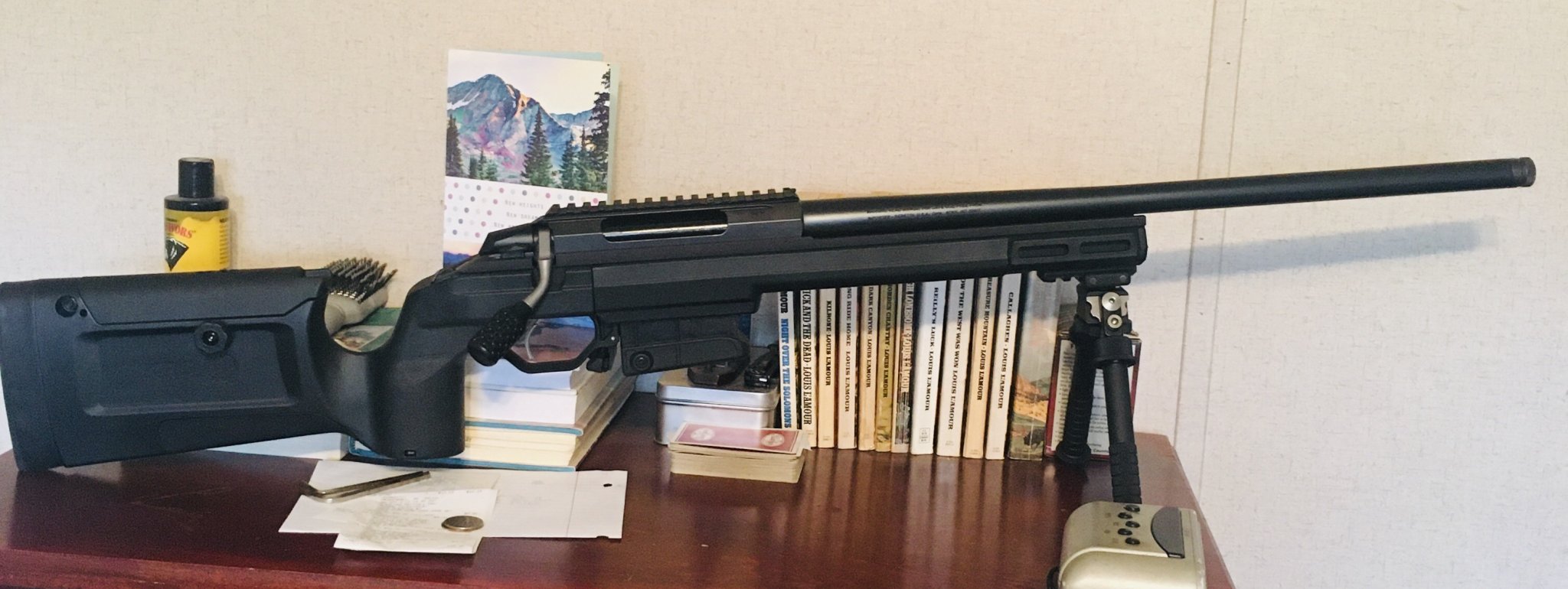

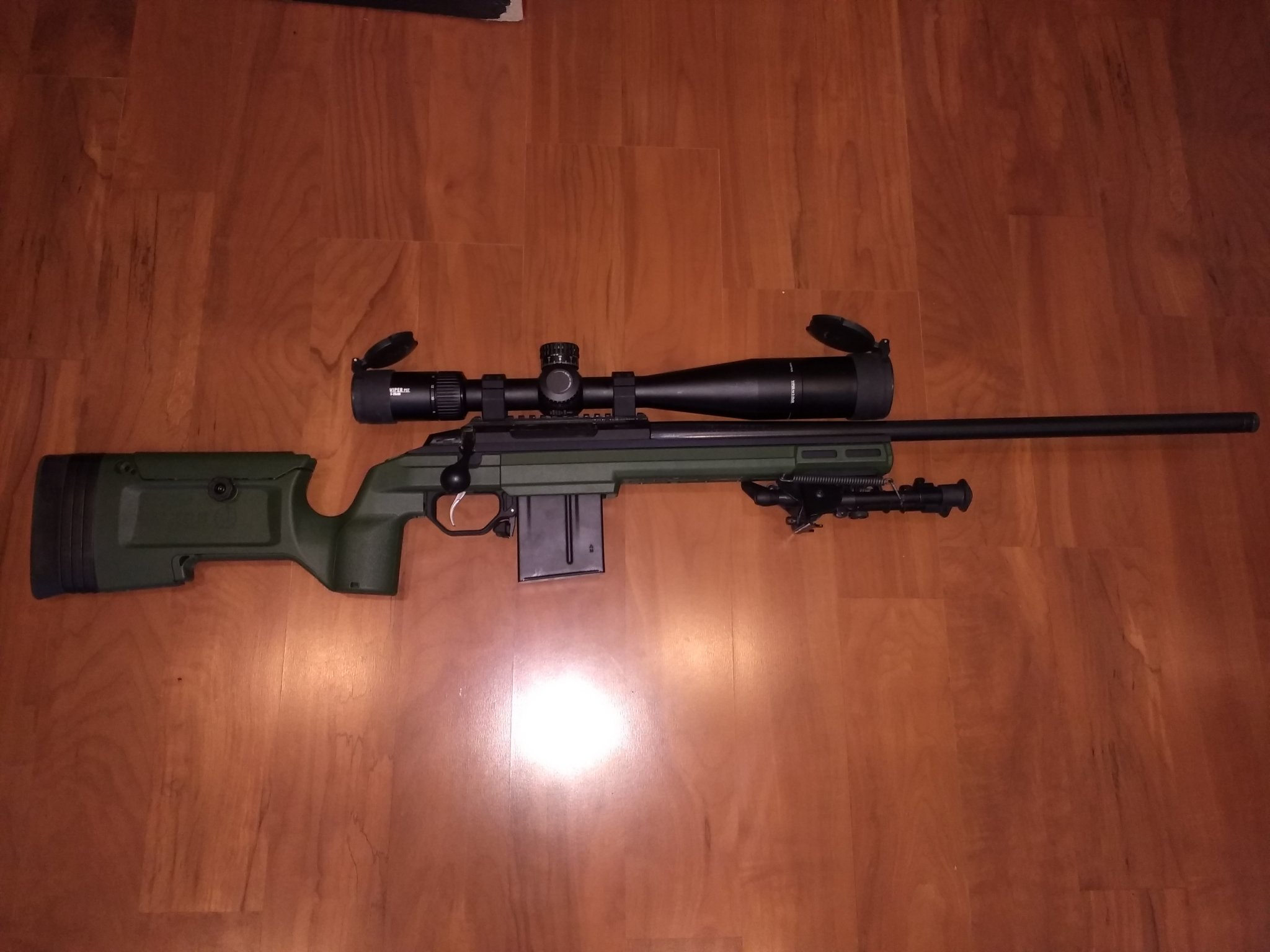

Got my KRG Bravo today
I was going to get the CTR version, but I wanted to put KRG's enclosed forend on this (they dont make a version for CTR mags yet), and give AICS mags a try. Getting it in Sako Green is also a bonus, but not really important.
I gotta say, CTR mags really are noticeably easier to load, feed much smoother, and are much shorter.
I don't really regret it though since they aren't huge issues, besides maybe the mag height. I might try MDT mags next.

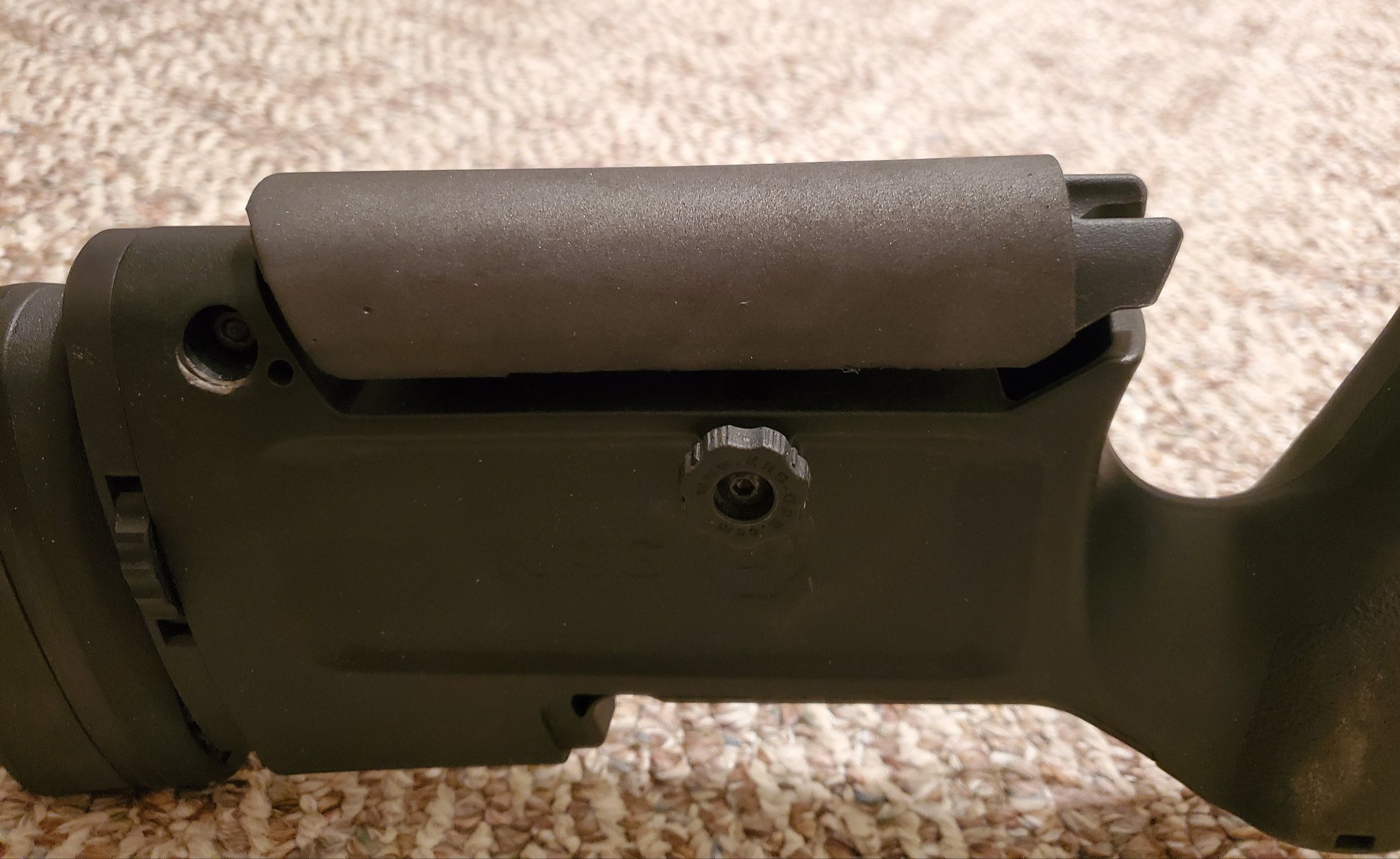

After taking my rifle to the range, decided I wanted a little more padding on the cheek piece of the Bravo....
Not wanting to pay $15 bucks for a laser cut piece of foam, I stopped by the local craft store and found a sheet of black self adhesive foam... for 99 cents!
I used the cheek piece as a template and traced it with a ballpoint pen. After some slick scissor work, I had a nearly perfect fit cheek pad.

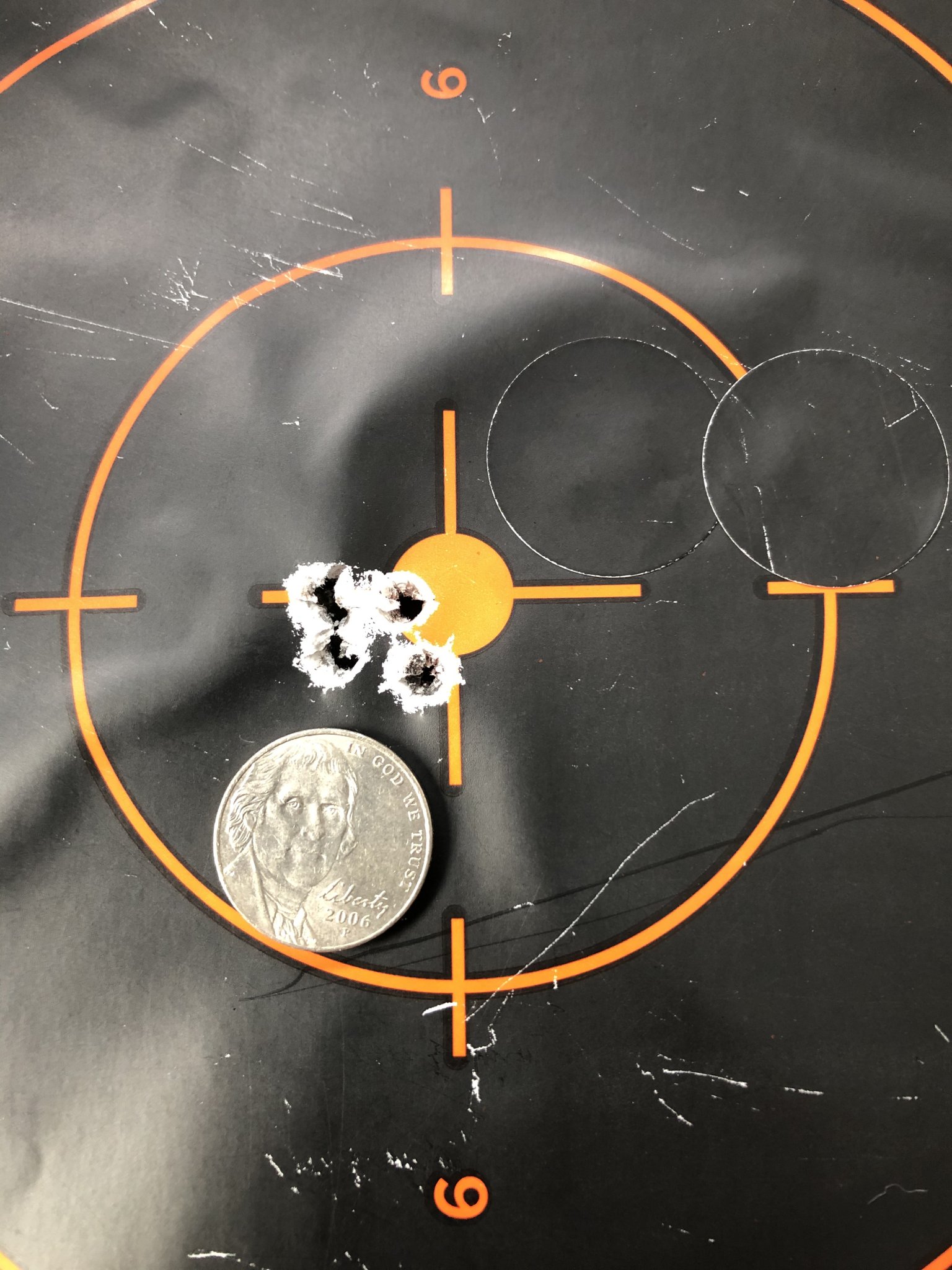

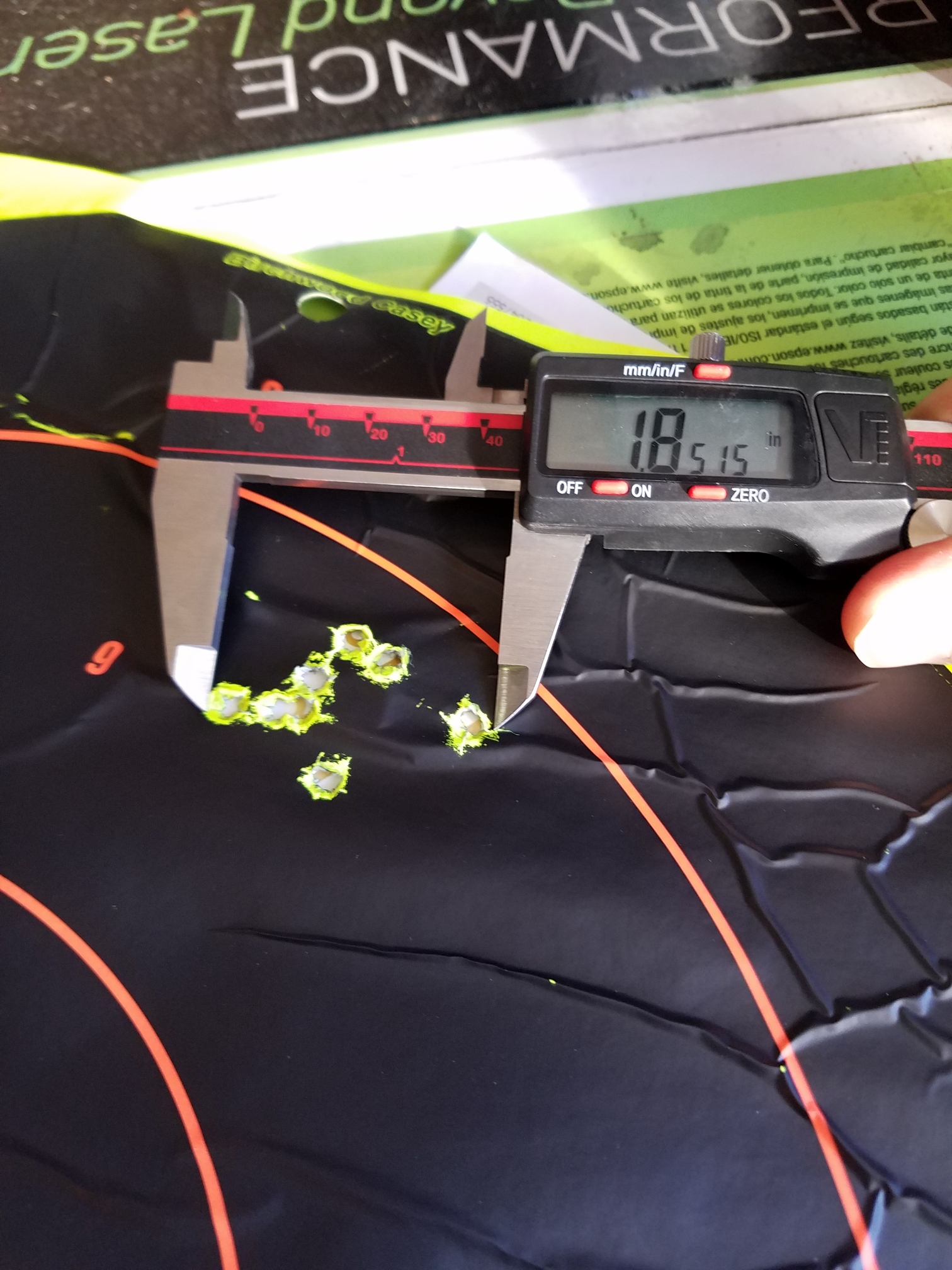

Took out the T3x Varmint (223) out to 200 yards. Ran out of the load it loves (75 grain Hornady match boat tail) before I could shoot a group on paper. Had some 68 grain hornady match boat tail that it doesn't like as much. Shot a group of 8 or 9 rounds at 200 yards. This ammo shot 0.7" group at 100, while the 75 grain shoots 0.5" groups. Pretty happy with this gun. I doubt I will let it go anytime soon.
4" inch plates at 300 yards aren't a challenge any more. Need to stretch the distance a little, but don't have access to longer range till June.

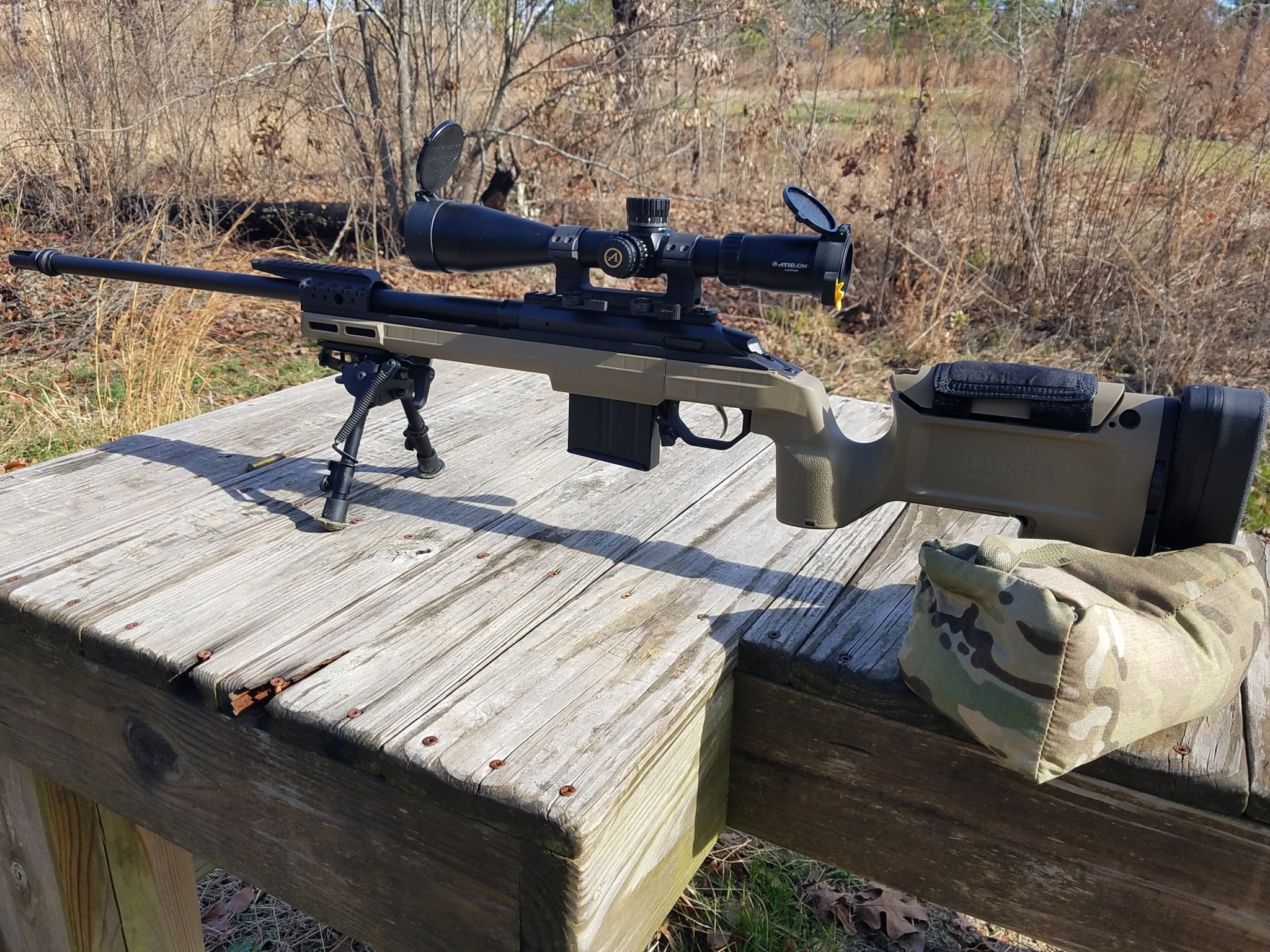

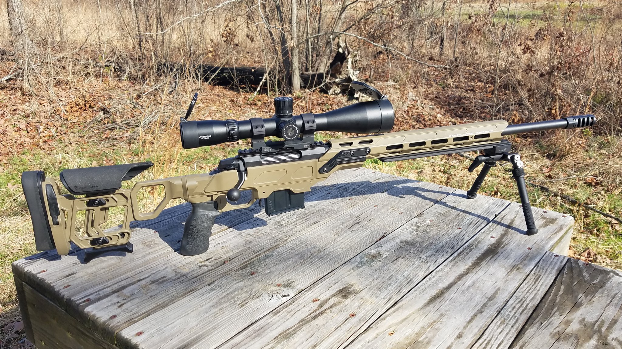

Looking at throwing my Tac A1 into a McMillan A-10 stock to match my Impact set up. As the Tac doesn’t have a bottom metal does anyone know if the action will fit just buy buying a factory one? McMillan is saying they currently only have inlets for that DBM. However I’ve seen the DBM swap to AISC that are drop in. Any idea if that would work? Thx
There's bottom metals that are at least advertised as drop in replacements for Tikka/Tikka CTR bottom metal. Sometimes you hear that a small tweak here or there might be needed to get it just right.
"ejg", here, has mentioned Atlasworx bottom metal. I think he sells them in Ireland.
