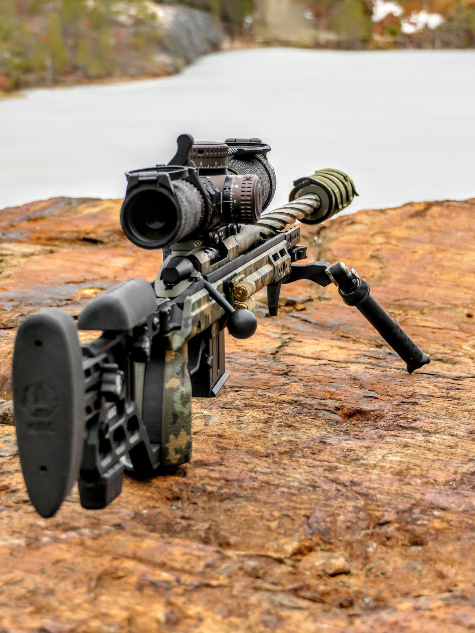

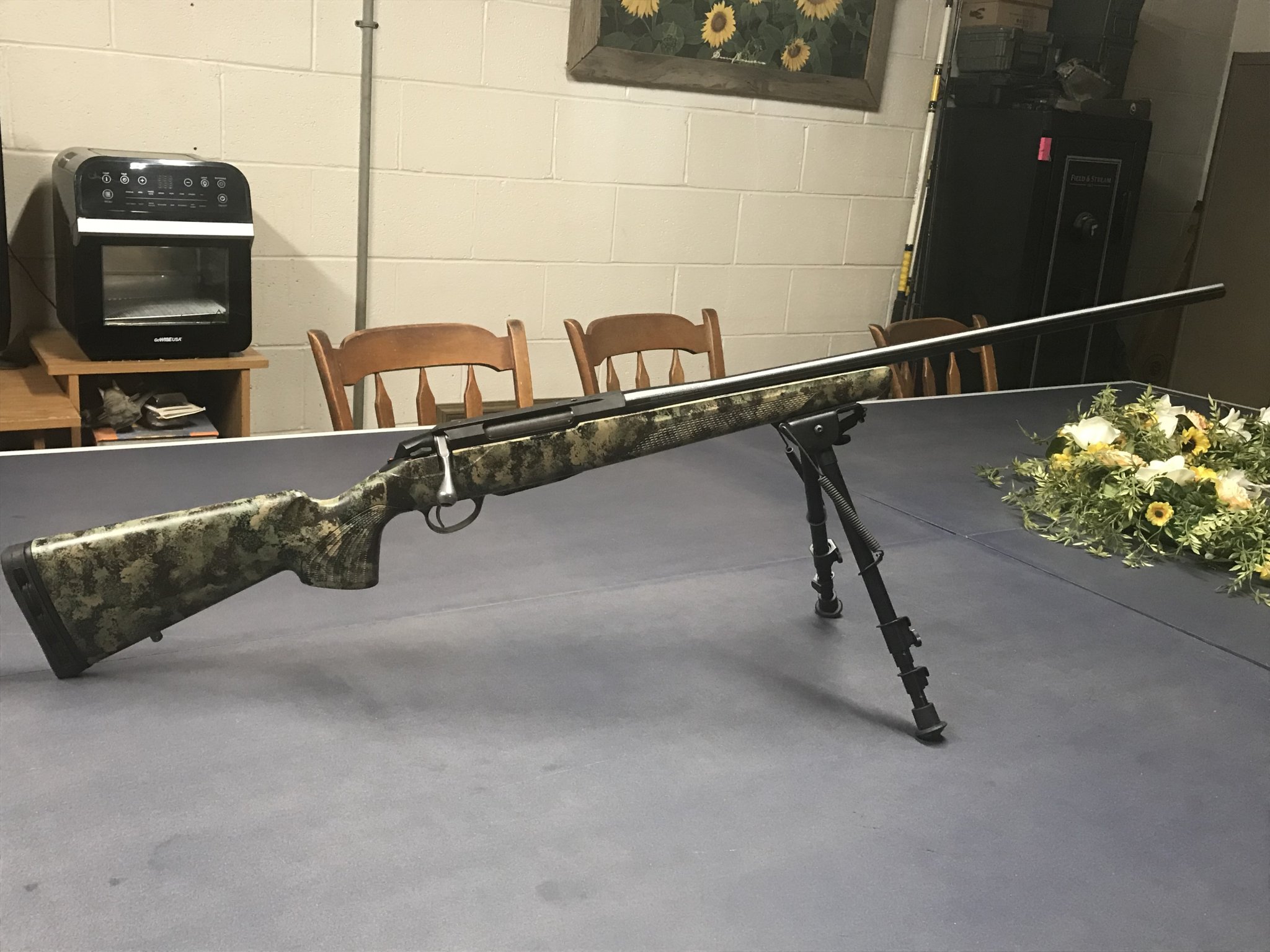

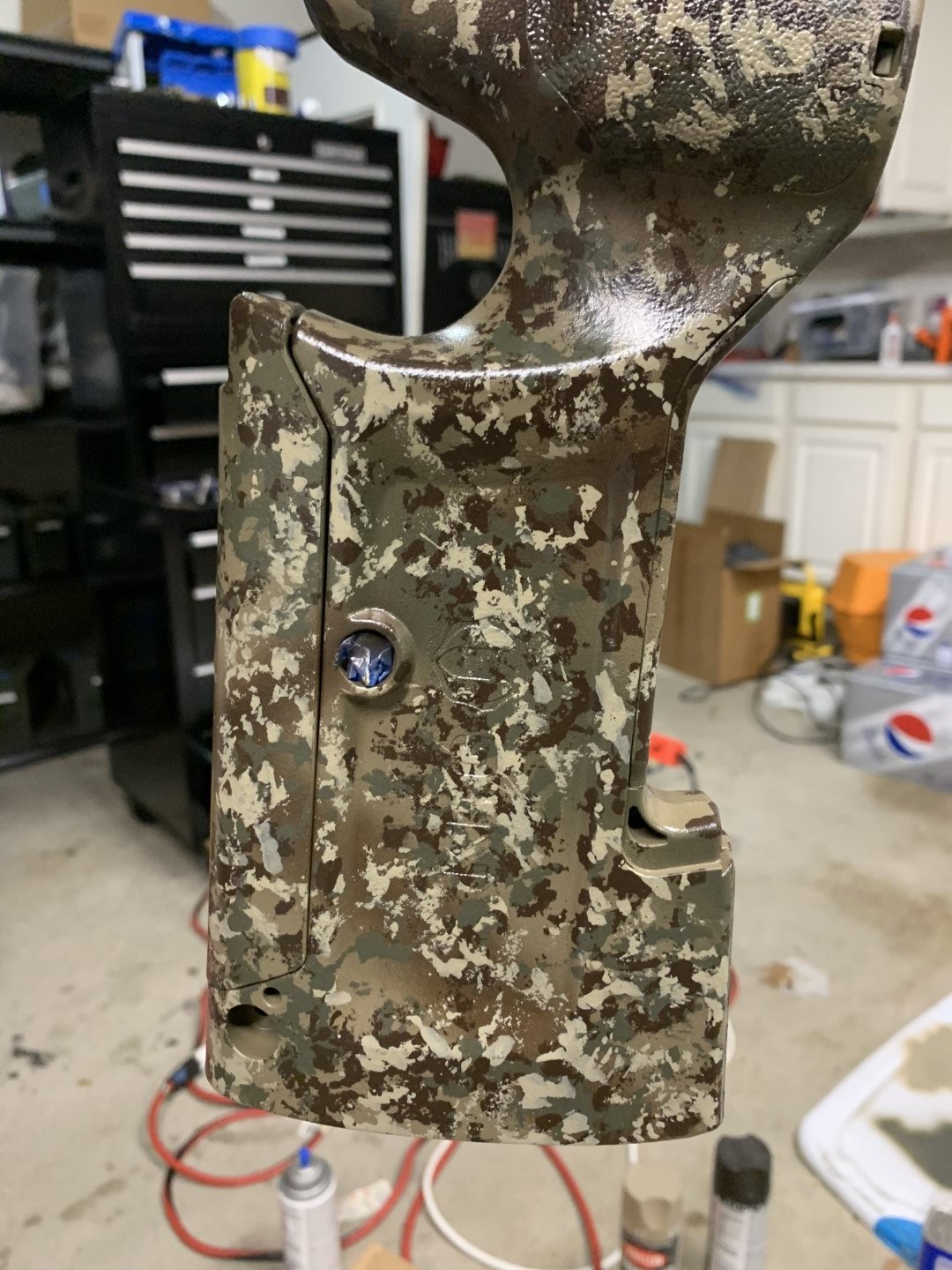

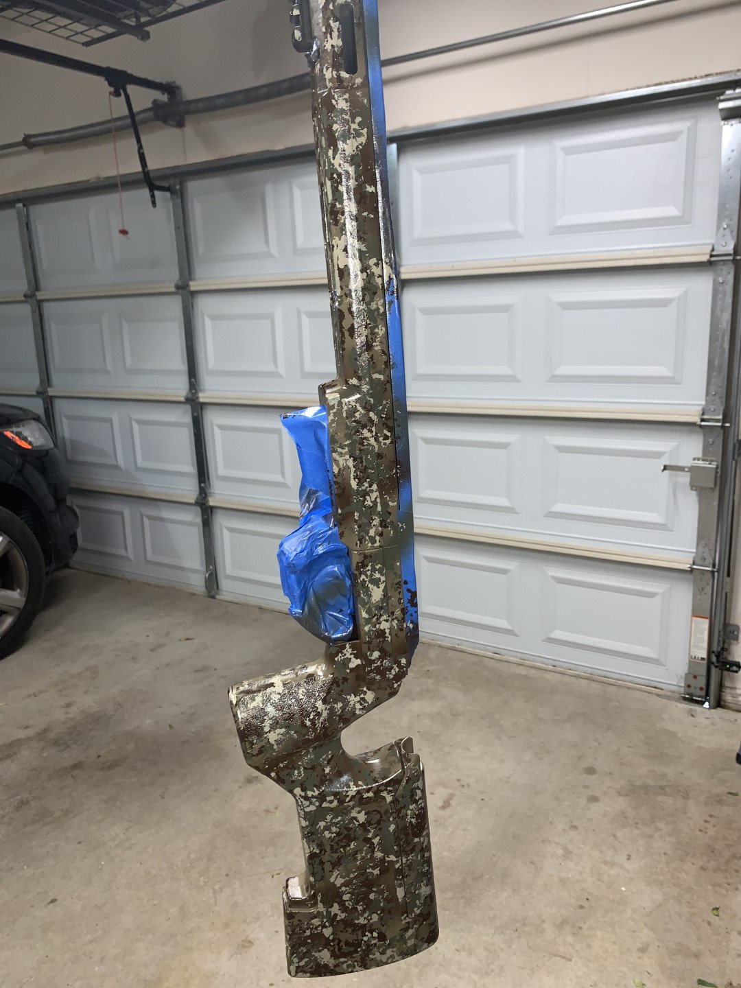

Just did my first camo paint job I've ever attempted this weekend. Painted KRG Bravo for my in progress Tikka build.
Considering this was my first time and I don't consider myself good with this kind of thing, I'm very happy with the result I got with the sponge method.
Basically I copied the method in this 3 minute YouTube video:
I used these sponges ($5 on amazon):
Set your amazon smile (donation program) to 2nd amendment foundation.
Used it with some camo spray paint, brown/olive/tan, spraying it onto some tin foil then dipping the sponge in.
The base color of my KRG Bravo was FDE.

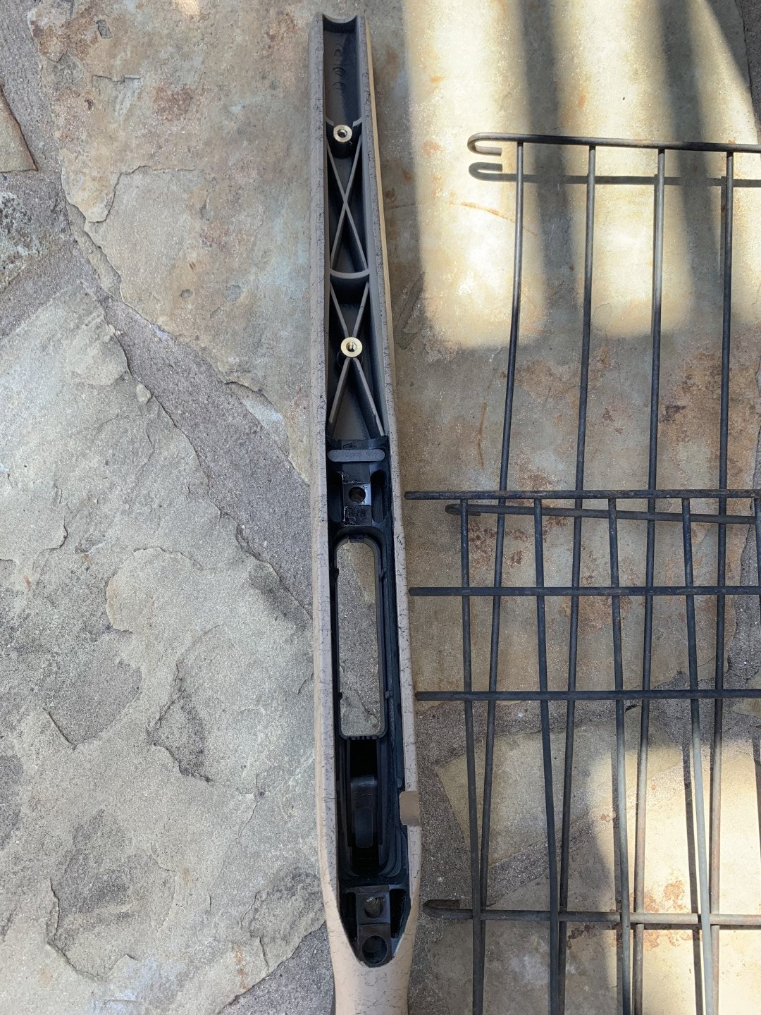

Tikka T3x RoughTech Stock Details
Picked up my Tikka T3x Roughtech model today.
Here's a photo of the inside of the stock.
The weight is 1 lb 15 oz.
I purchased the Roughtech model to get the new D18 barreled action with fluted barrel/bolt to put into a KRG Bravo, so I'll be selling the Roughtech stock later.
Looks like the inside of a CTR stock.
Make sense. This is the only Tikka I've handled. Bottom metal is integral to the little "mini chassis" in the Roughtech stock.
To my knowledge Tikka hasn't made a new mini chassis bottom plastic/metal. It's not down as a new feature and im sure they'd shout about it too - changing something like that costs money and the point of Tikka is quality but lower cost by having modular/interchangeable design. So id take a closer look - it's still a standard T3x stock, just with the Roughtech finish. Trigger guard will come out, might be a snug fit.
Reactions: JGR1953 and 260284

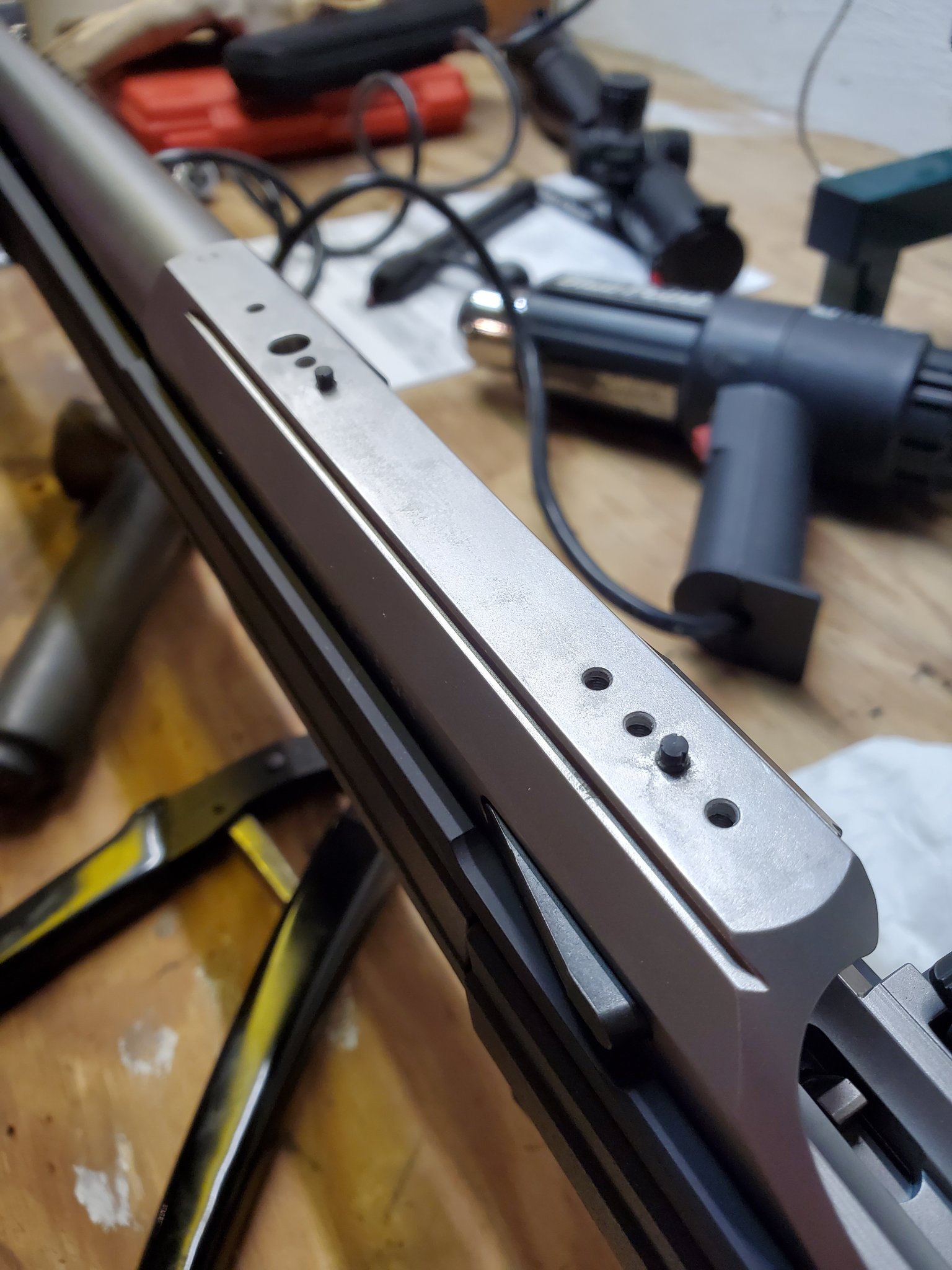

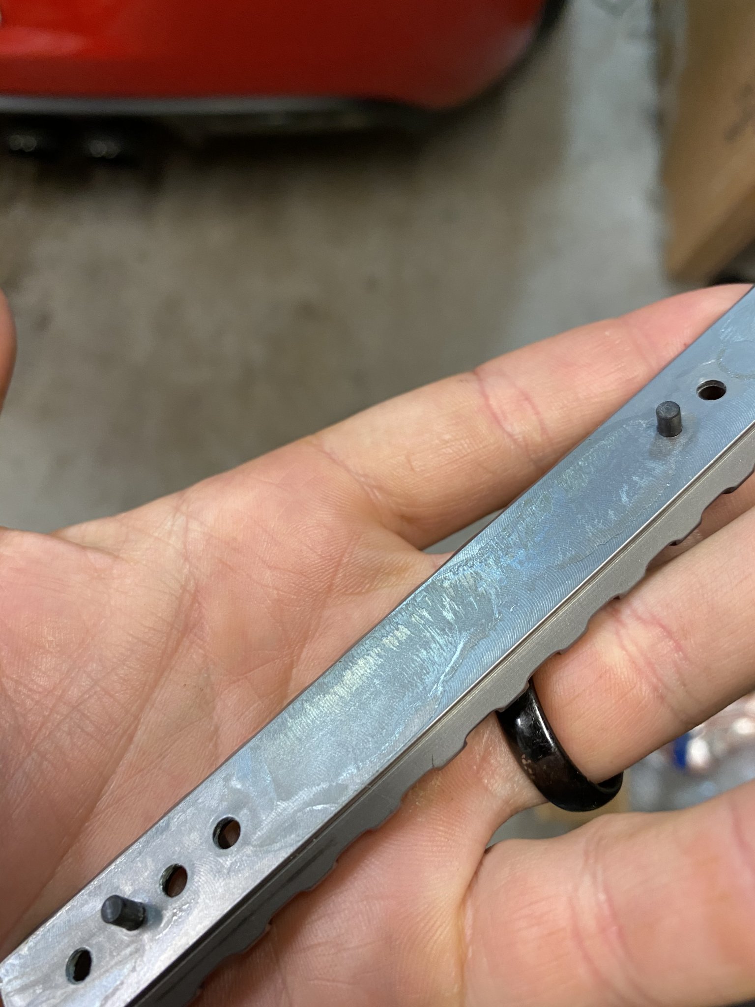

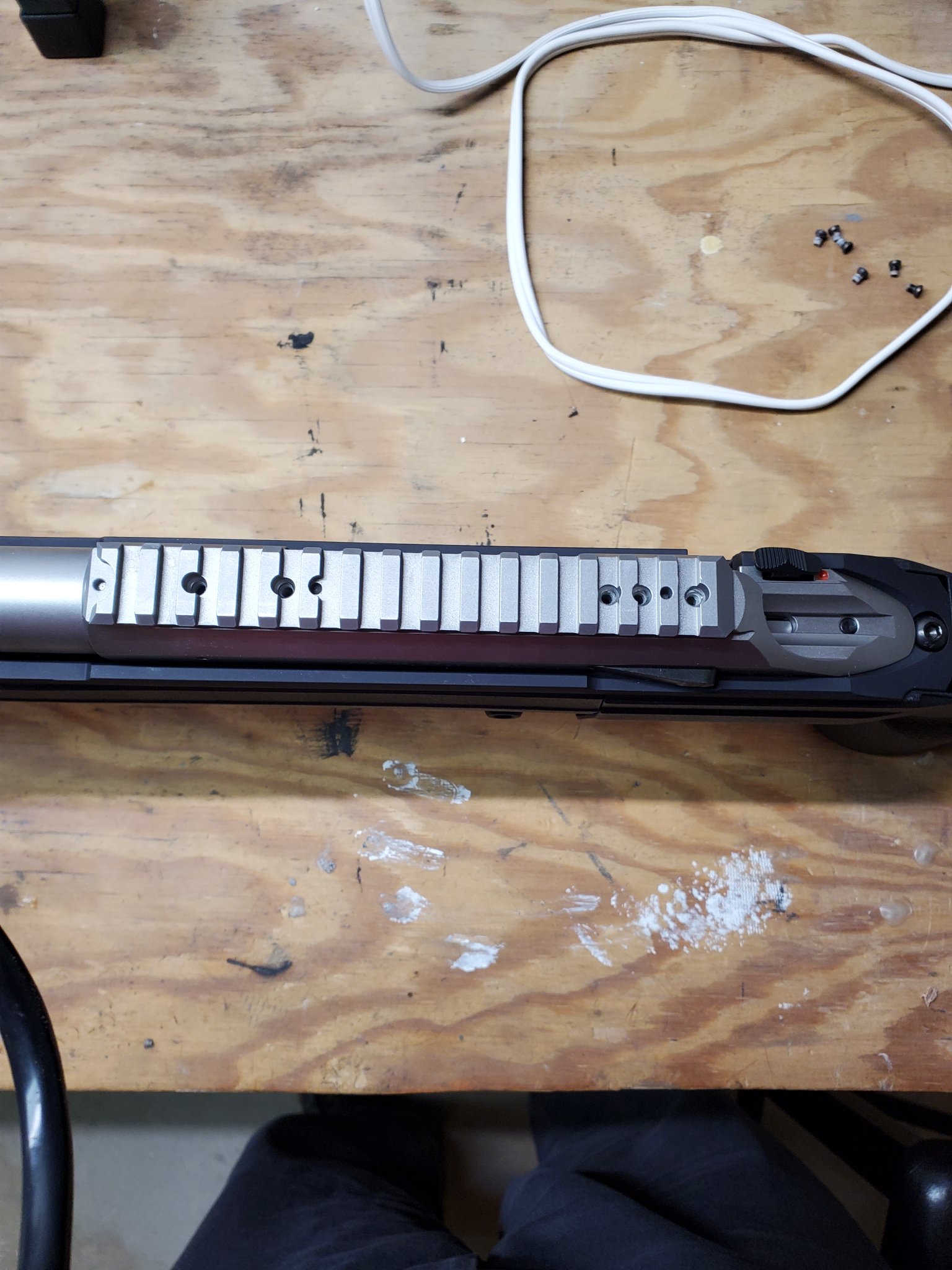

Just did the same thing with my new CTR the other day, the pins are a light press fit and mine were glued in with some sort of thread locker. Apply heat (little propane torch works best, but a soldering iron will work too - just take longer) till you see a little puff of smoke (that's the thread locker releasing) and they'll pull right out with a pair of vice grips.

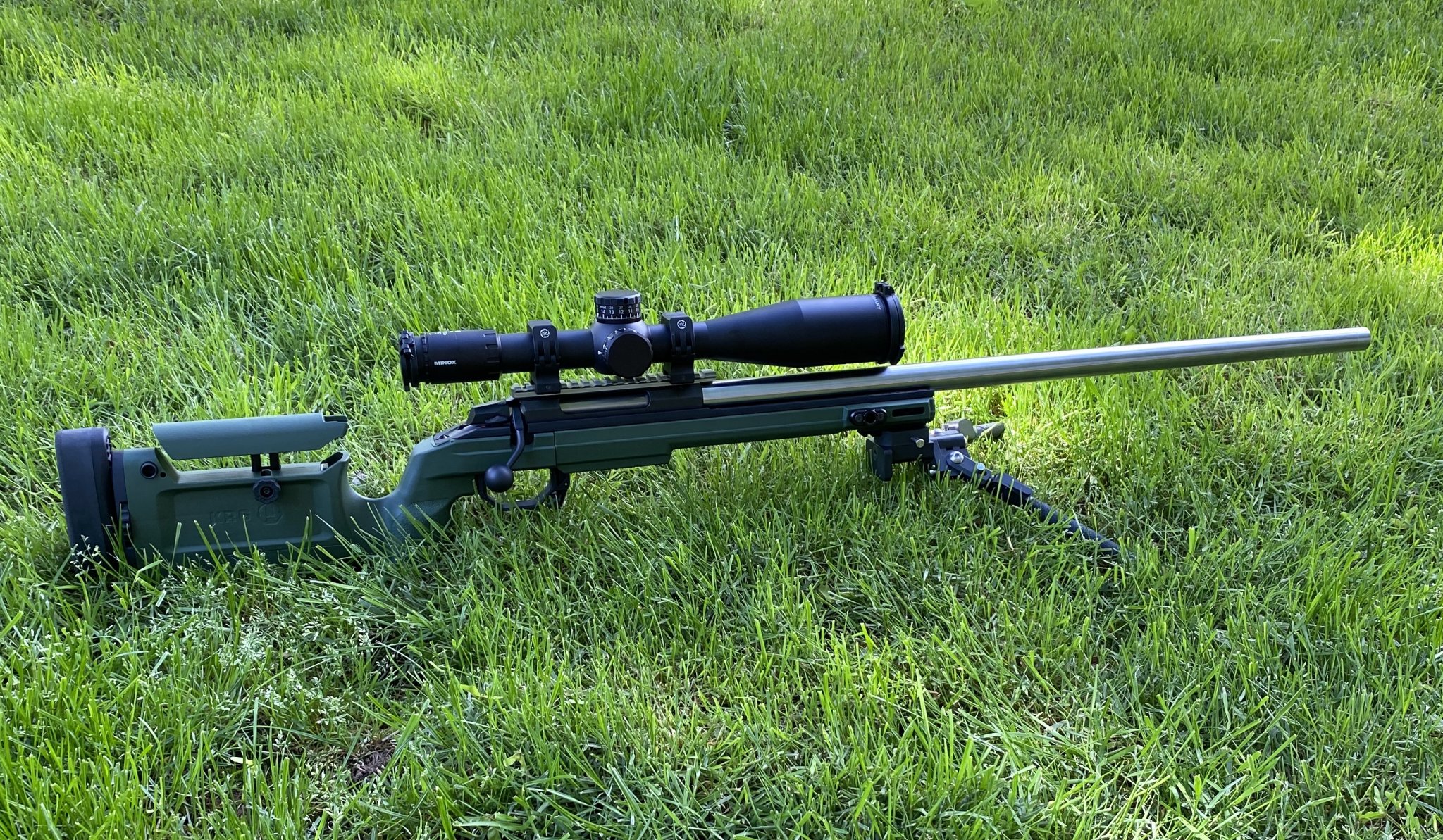

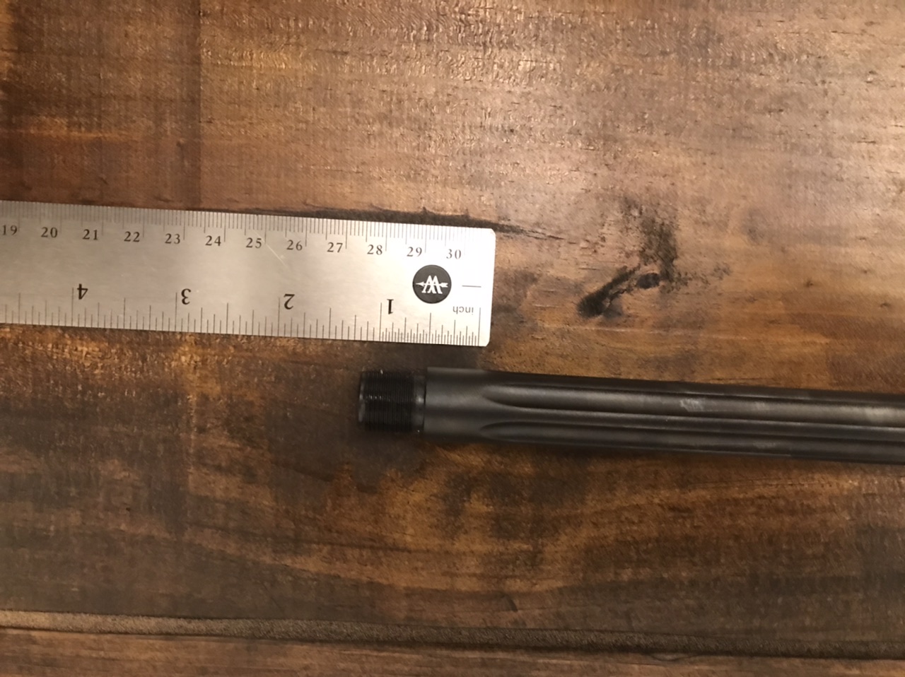

Roughtech D18 profile Barreled Action Chop Down:
Bought Roughtech model for project, came as 22.4" fluted barrel .308.
I had it chopped down to 18" by Class 3 Machining.
Results:
- Flutes come to within a couple inches of muzzle, so new muzzle ends up well into the fluting
- At 18" the narrowest width (in the "valleys" of the flutes) was 0.601"
- Therefore needed to be threaded 1/2 x 28 instead of the 5/8 it comes with
No big deal for me since I will be using YHM Mini Brake to interface with their Kurz Kit suppressor mount, and per Hansohn Brothers, "the mini brakes are bored .350 and mini flash hiders are bored 9mm" for both their 5/8x24 and 1/2x28 models.
