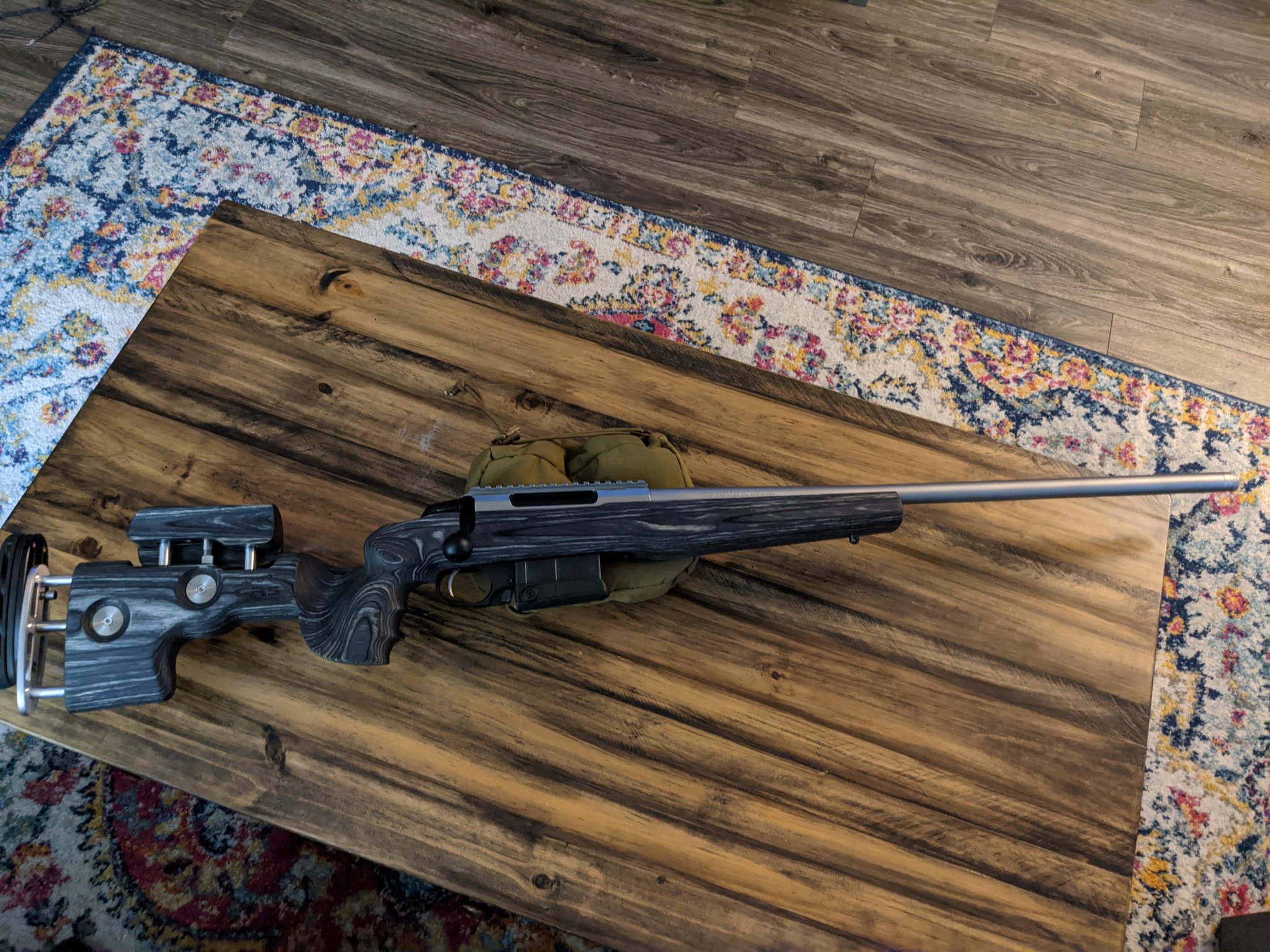

I have seen a couple guys ask the gunsmith to add a chamfered edge to their barrel so it doesnt look as weird, but it wouldnt be my preferred choice with so many different offerings from barrel makers for Tikkas.
This is how it looks with preferred barrel dimensions
