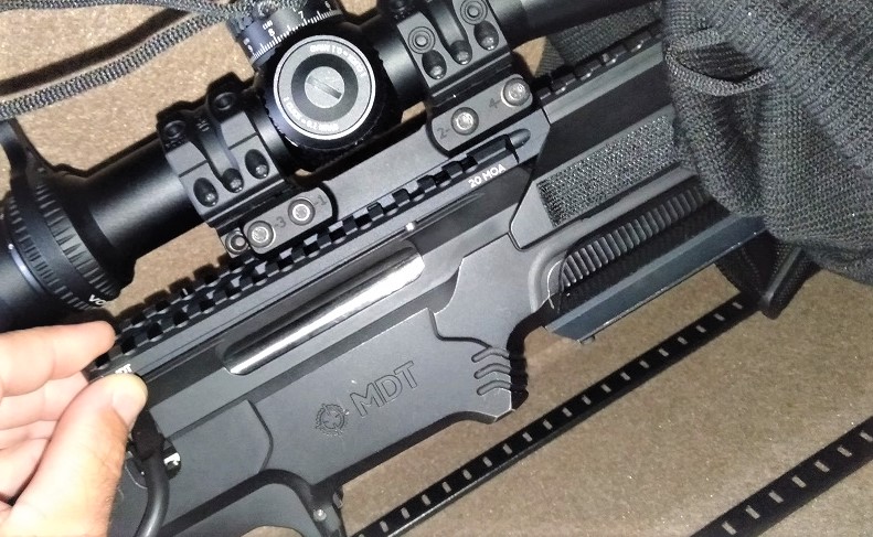

I'll check out MDT. Is it extended or receiver length? I much prefer receiver length if possible.
Thanks
MDT's standard 20moa rail is receiver length with included recoil/locating pin
doesn't look it but i'm holding it beside the higher version where it would bolt up to the receiver

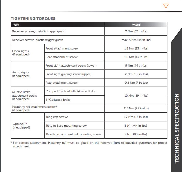

30-35 in/# on all .
One would think Tikka would have manuals on line with such information.
This is not correct for the Tac A1.
The trigger group to action for all models is recommended 55 to 65 in/lbs. which is also what some aftermarket triggers are suggested.
The action screws on Tac A1 and CTR are recommended 62 in/lbs. because it is a metal trigger guard.
The above posted is what a lot of people use for the standard plastic trigger guard on T3/T3x.
The recommended max is 44 in/lbs.

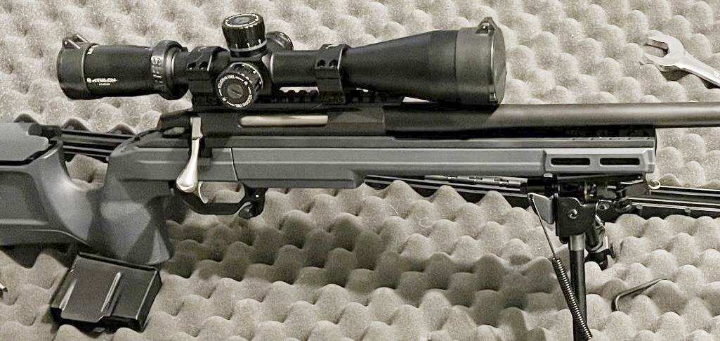

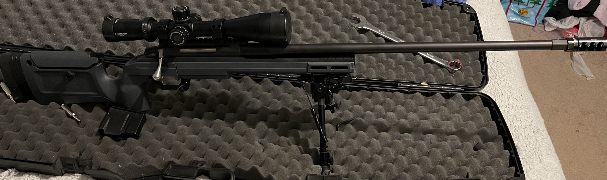

Doesn't look to me like your fully seated on your recoil lug.
I lightened the picture to show you how it's angled up.

I’ve taken the stock off 3-4 times cause a few people have said that. I’ll try again
I would double check the lug just see if it actually fits the notch on the action first.
It always helped me to take my thumbs and see-saw the action back and forth until I felt it slip down into place.
It might also help to file off the sharp front and back top edges of the lug a little to keep it from catching.

I’ll mark it with a sharpie and see if it’s rubbing any where
Think it’s finally set. Got everything all snugged up and it does look to be on the lug.
i will say this per krg instructions is where I believe the issue lies. Putting it on the butt and pulling down will almost definitely cause the lug to be unseated.
You seat the lug into the slot on the action, start the screws AND then pull down. Idea is to seat the action up against the lug so the action doesn't shift under recoil.

Anyone know the torque spec for the bolts attaching Picatinny rail to action? (on CTR). Tikka won't tell me
40 inch pounds is usually good
Be sure to clean well and hit threads with blue locktite
Feel free to use 40 inch-pounds if you want, but the factory instructions specify 22 inch-pounds (2.5 Nm) .
You might also think about purple Loctite instead of Blue considering the thread size.

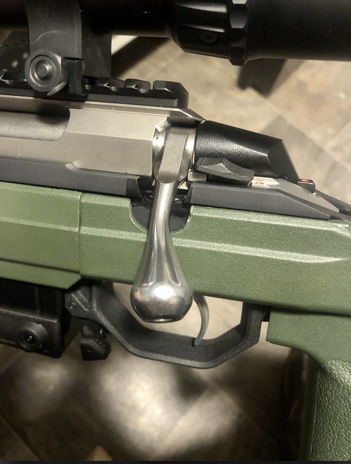

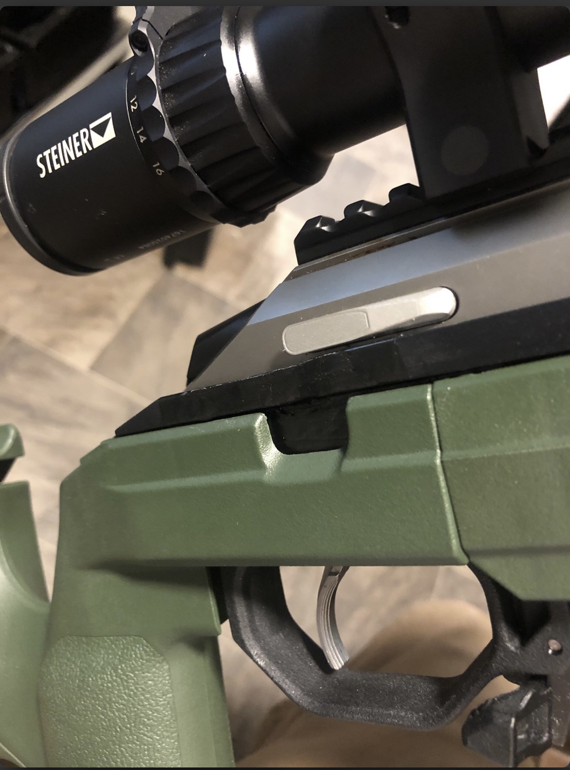

You need to create a bolt handle cutout on the left side. You can use a round file, a Dremel, or an end mill cutting bit. You then need (should, maybe not a need) to fill in the gap on the right side in the aluminum backbone part of the chassis so that junk doesn’t get down in there in the trigger.
I used an end mill bit in my drill press, chucked up the Bravo in a table vise to make the cutout. I filled the opposing gap with Bondo, and when dry sanded and filed it to desired shape. Painted these areas with Brownells Alumhyde.

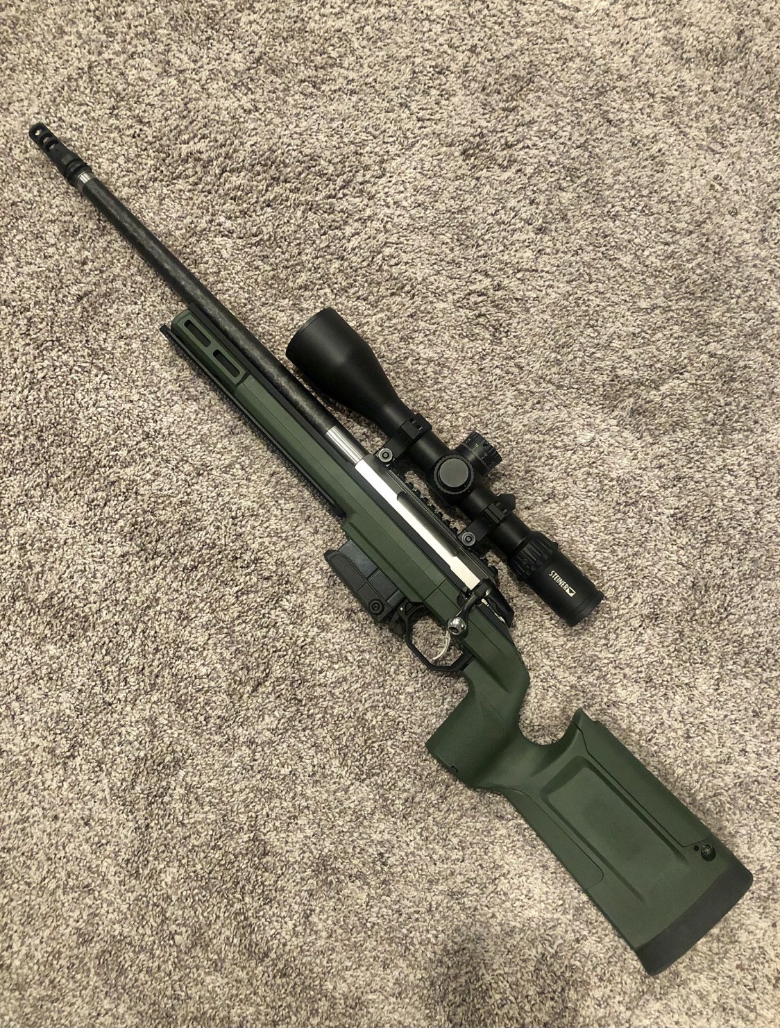

didn’t realize how green the krg stock is... definitely not an od green.
Pictures on their site doesn’t make it look like that.
