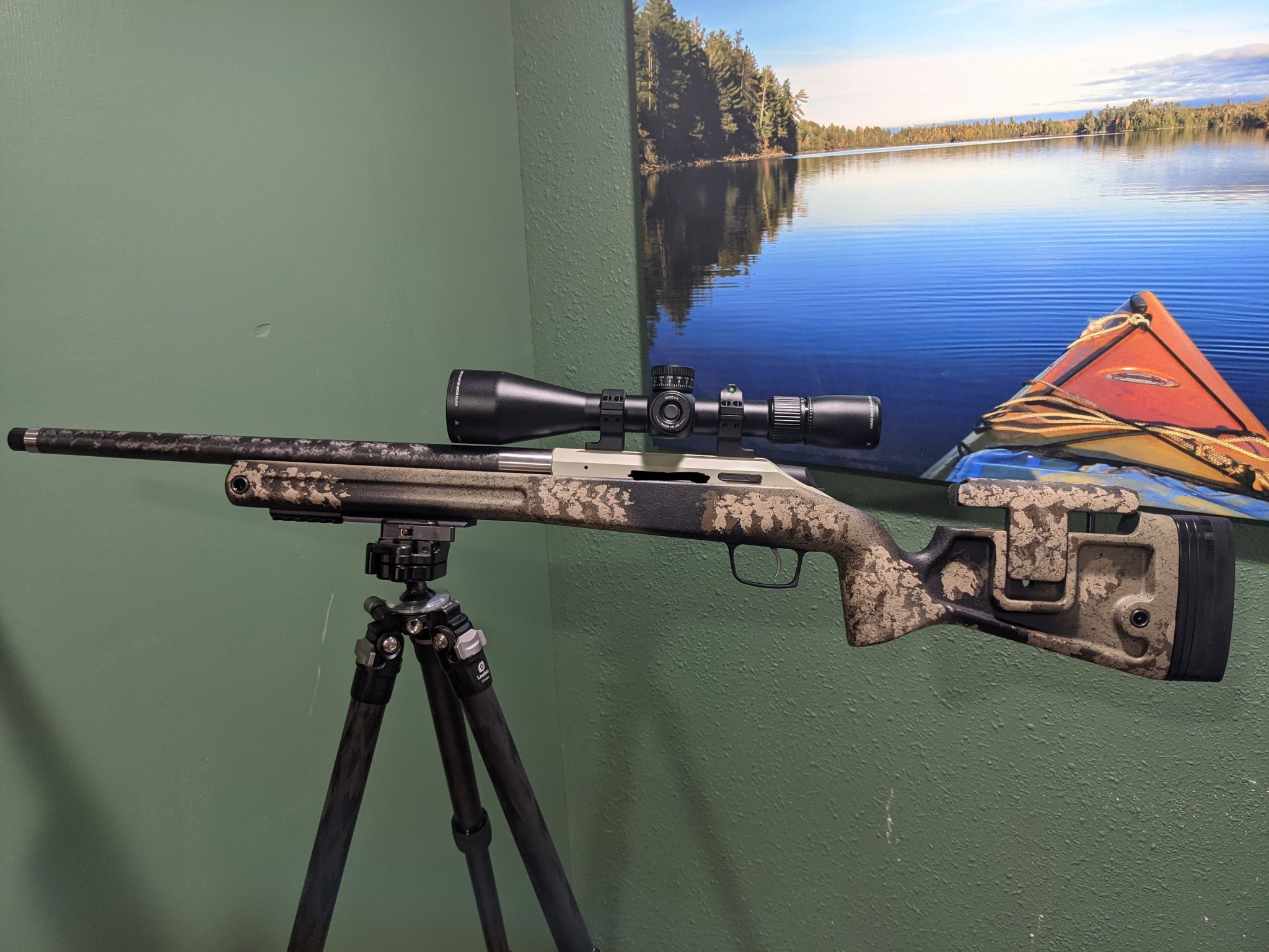

Not quite finished product, but getting close. Haven't torqued the barrel up yet as I need to find a gunsmith to throat it for longer bullets. Scope came in Monday, but its too close to the barrel for caps even with Hawkins highs.
What color Cerakote should I go with on the barrel ends and the action?
T3X Lite Alpine Veil action from JA outdoors
18" 7SAUM Carbon6 Prefit
Grayboe Phoenix in Desert Sage
Mt Tac factory bottom metal
Lumley bolt handle/knob/shroud
Salmon River Solutions 4" MLOK ARCA Plate
Hawkins Hybrid 25MOA Rings
Vortex Razor LHT FFP MOA
8.5lbs scoped, 3rds loaded. Will be just over 9lbs with a suppressor

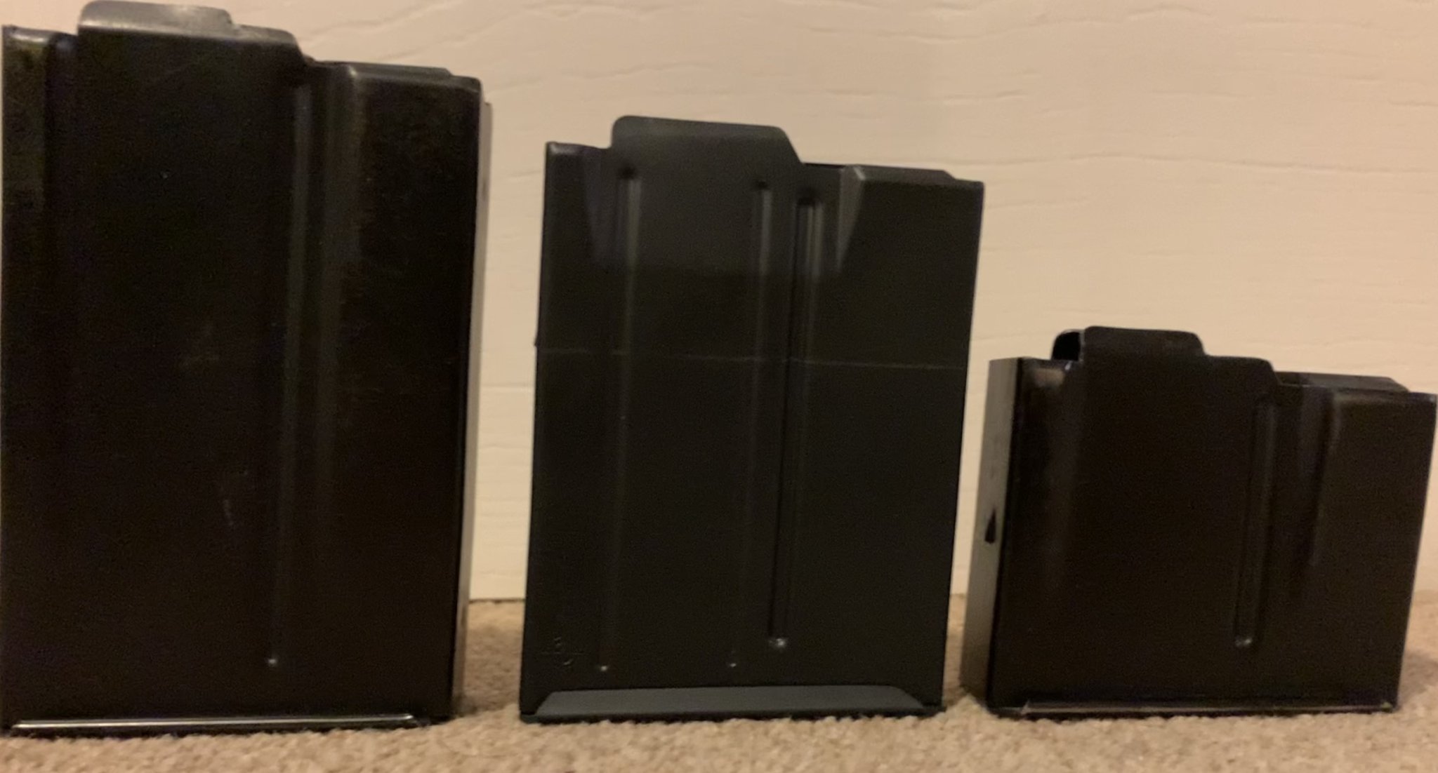

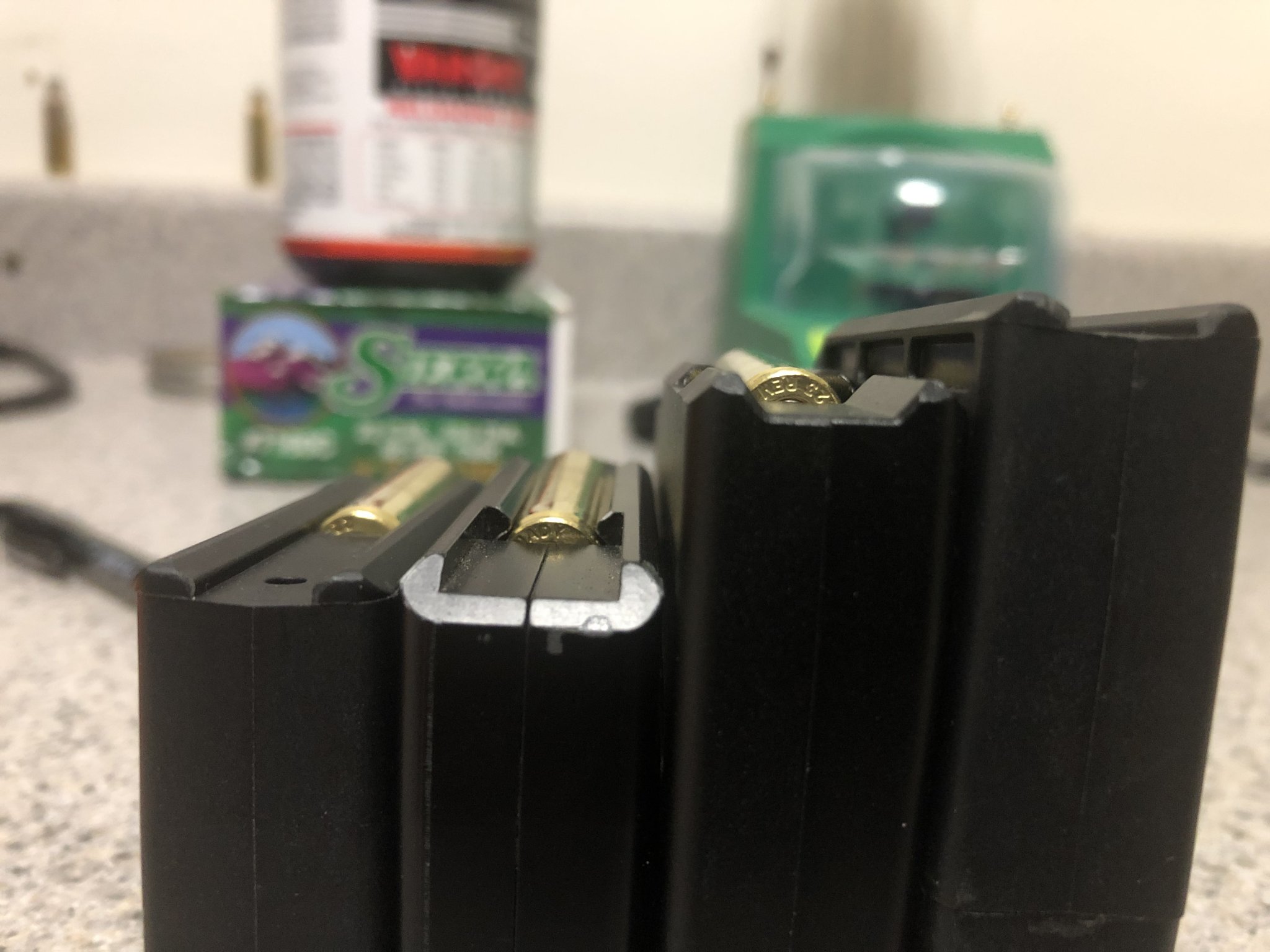

Has anyone seen this? MDT appears to be working on a MAMBA Mag for short action tikkas. Also says it can't be exported outside of Canada? Touche Canucks. Thought USA was the only one with strict export laws/ITAR lol
Edit: NVM Mambamag.com has existed in the USA and my Google Fu is weak. If only they did LA Tikka
More mag options for 223 users. Picked up a waters rifleman 2.6” 223 mag, was supposed to be a ten rounder but got sent a 6, 10 should be s route from Australia soon. Sucker goes in tite! But is well made and seems to feed well, time will tell. Suckers are not cheap, but to have the option to go from a ten round, to a flush 4 round for different hunting applications I’m hoping it works.
I’m hoping the 10 will allow me to shoot a match with the rifle if I want to. That and less reloading in prairie dog towns.
