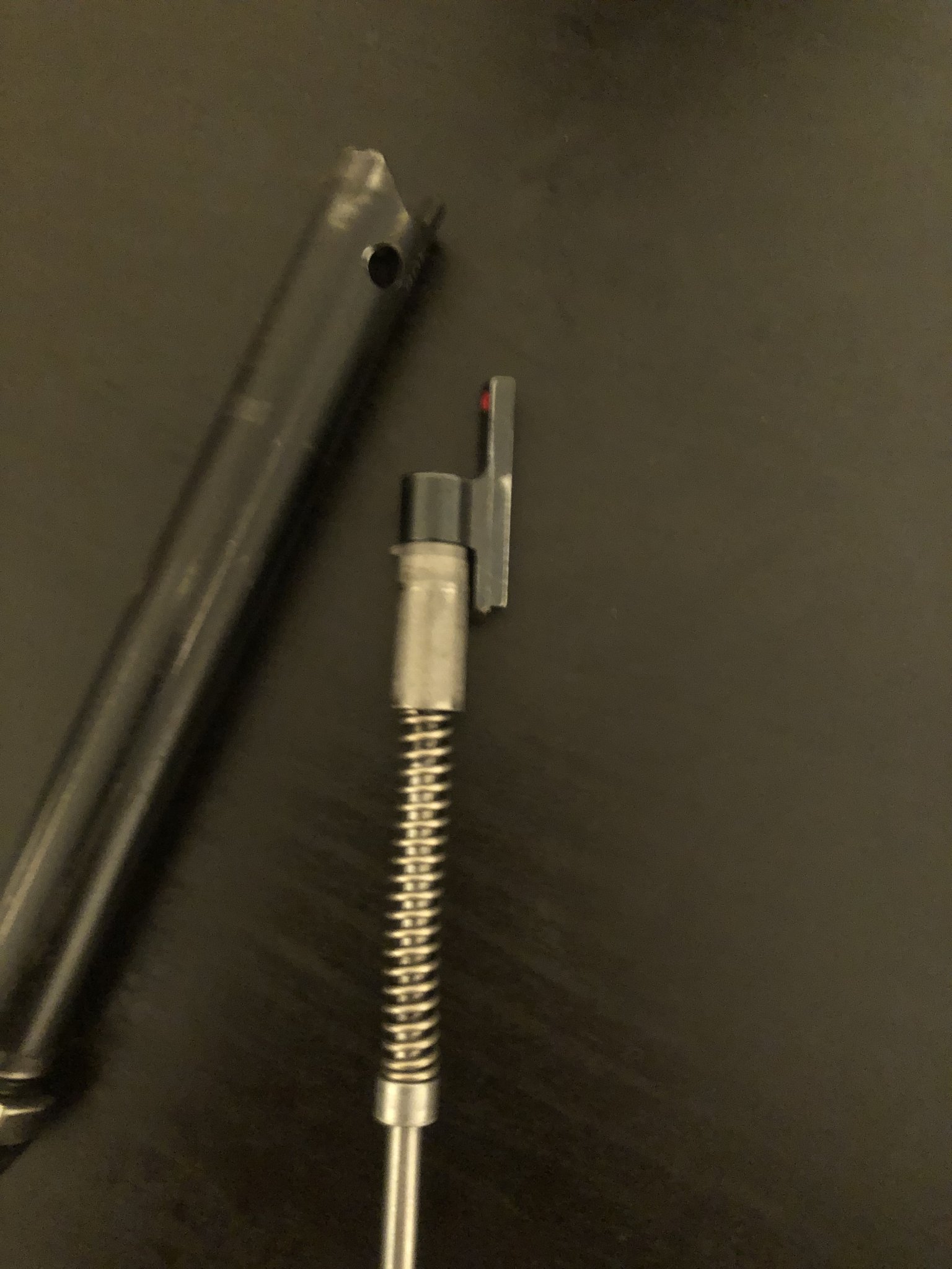

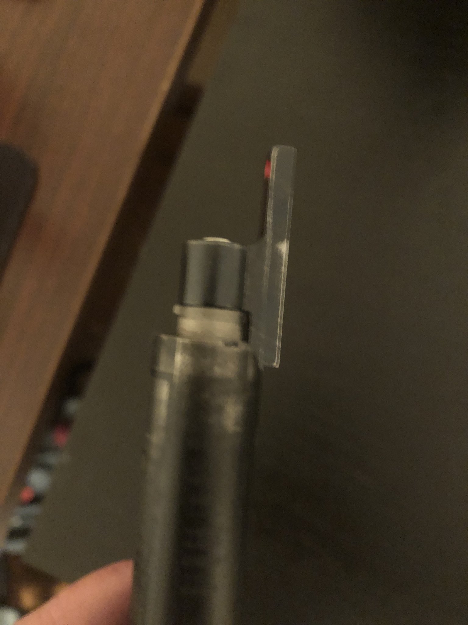

Am I totally fucked or can I fix my mistake? Was changing the bolt handle on my tikka and the Allen key I had in the firing pin assembly came out, releasing the spring pressure. Now I can’t get it back in to decompress the spring.
Has anyone got any advice or made the same error?
I am sure someone will answer you,, I am pretty sure I have seen this before and your not screwed,,, I just changed mine to a Sterk about 20 minutes ago… I can’t remember the fix,,,,🤔
Here is a video showing you how to reset it.
Sterk makes a tool that works great also.
I purchased a tool from Mountain Tactical a couple of years ago,,, pretty close to the same design,, I think they still produce them… works great!!! Edit my post with pic of rifle..

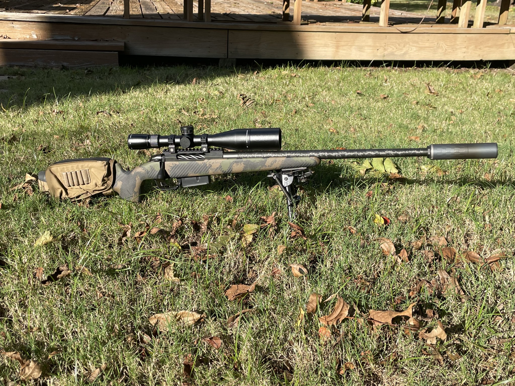

Finally got the 6cm assembled hoping to shoot groups this weekend.

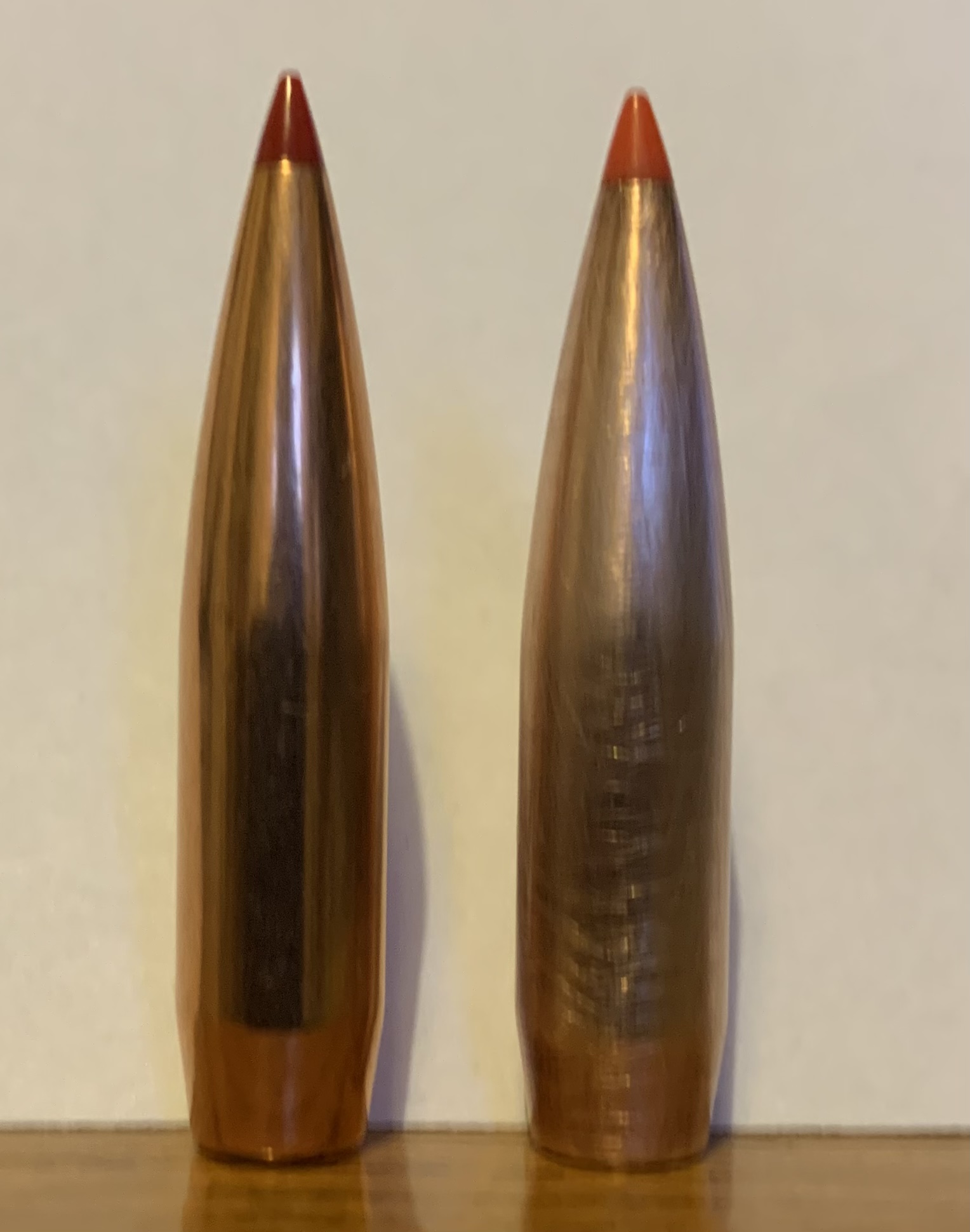

Just some anecdotal empirical evidence to back up Hornady's claim that Amax tips were melting at distance. I was testing some new loads at 600yds. Zero'd the 178ELDMs & 175TMKs then switched to 208ELDMs. I dialled these in & they were all landing in or close to V-bull but constant elevation, there was a strong gusty cross wind needing 3.5moa correction. I had 18 Amax 208 left, which are identical to the ELDMs except for the tip. I had loaded these in the same batch just to finish them off. All bar one landed 6" low on the target or 1moa. Went back to ELDMs & straight back in to the V-bull !
YMMV
208gr amax isn't identical to eld-m
So I just measured my last 208 Amax & an ELDM. You are correct.
Amax 38.9 mm ELDM 39.2mm, other than that they are identical in every dimension. I don't see an extra .3mm length making a whole MOA of difference. The calculators say 1/2moa elevation & .2moa windage. Pic attached, sorry Amax was pretty grubby so did a quick polish on it, left ELDM right Amax.
There are definitely some dimension variances between the two.🧐
That is mostly poor visuals. Apart from OAL & the tiny change to the ogive that creates, all other dimensions are the same. Boat tail length & angle = same. Diameter & Bearing length = same. Weight = same. So the only difference I can measure are the ogive & oal. The tips appear to be identical size externally. Looks like the jacket has been drawn out the extra .3mm to get a slightly finer ogive.

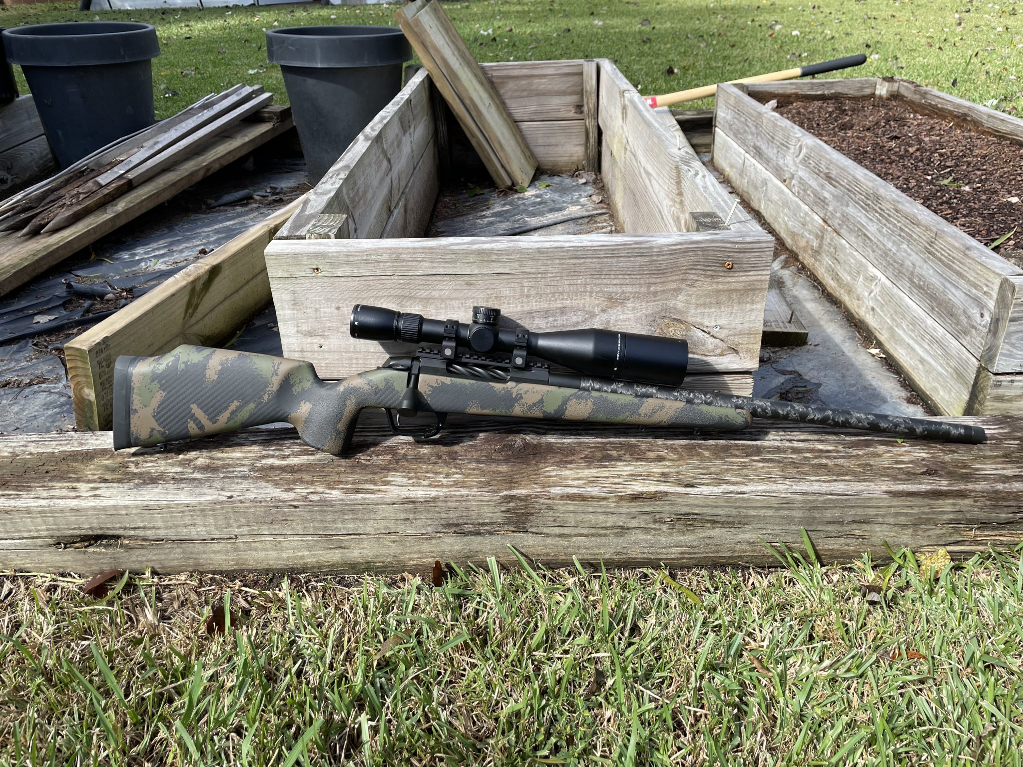

@5RWill Nice rifle!
Who’s carbon barrel? Finish looks like a proof?
