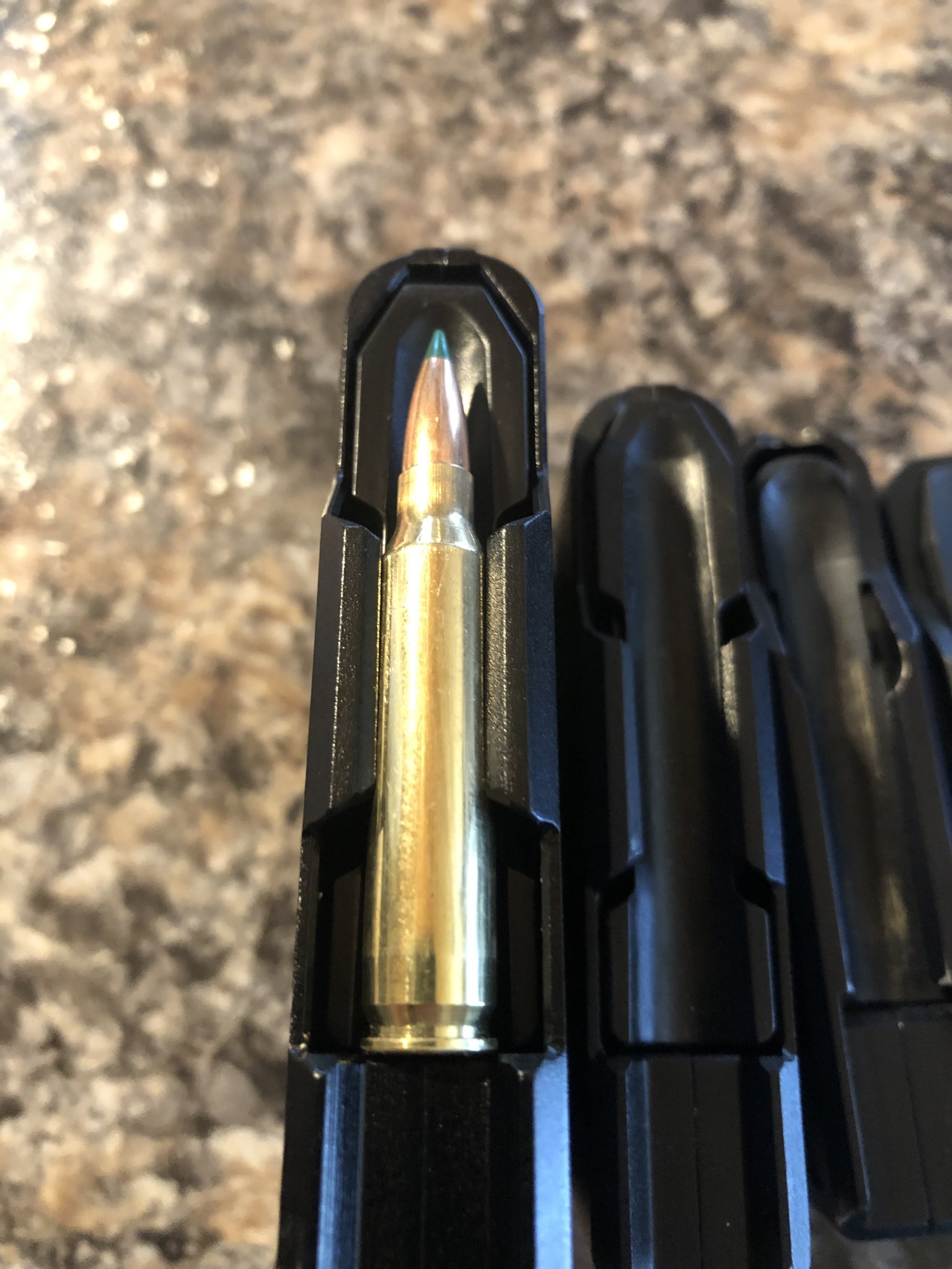

Waters rifleman 10 round 223 showed up today. Quality on these mags is great. They lock up tight, feed well. Prairie dogs are screwed now. If you need an extended option and don’t want to leave the smooth feeding of the factory mag looks like there are options. Plus they fit a 2.6” 223 round. Might even try a day match with my 223.

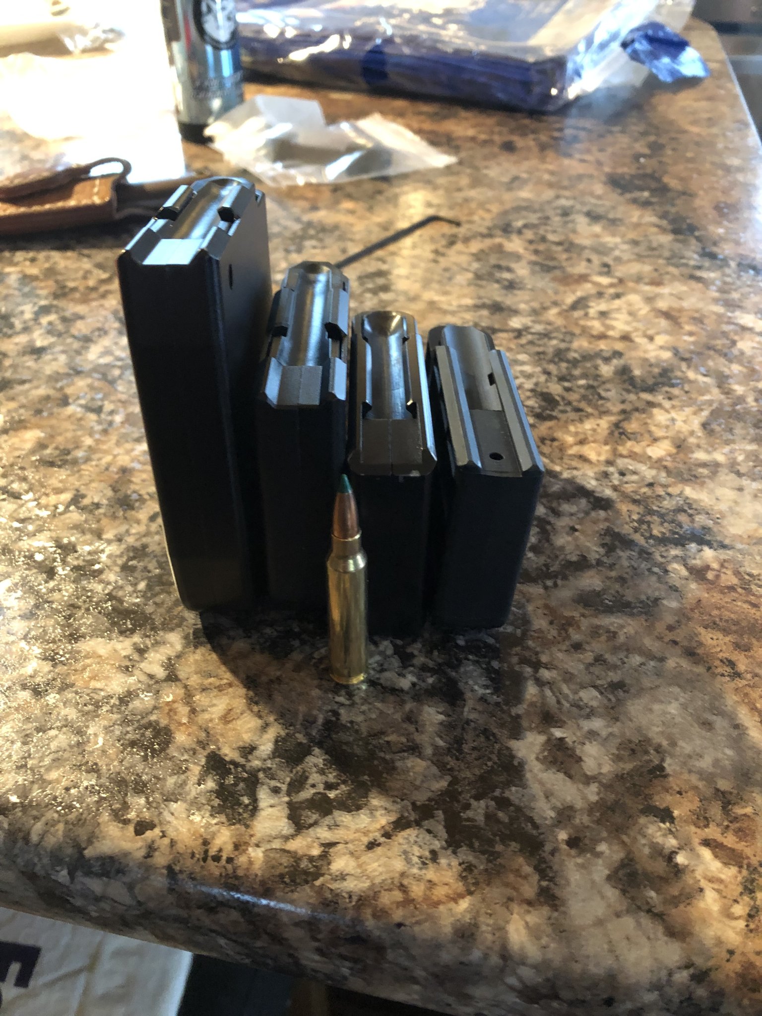

I have a fairly uninteresting question that I’m sure has come up before. I’ve searched quite a bit but couldn’t find a definitive answer on the variance between magazine types so here it goes:
I have a Tikka T3X .308 CTR in a KRG X-Ray chassis. MDT had the best BF deal in town on magazines so I bought one 10 round metal w/o binder plate, one poly/metal, and two polymer mags.
Are all of those going to work with my set-up? I saw on KRG’s website they reccomended the non-binder plate mag for Tikka’s that measure 2.950".
The MDT w/o binder plate mag = 2.960" so I should be clear.
However both the poly/metal and polymer mags = 2.870”
Anyone have personal experience or success with all three types?
Thanks!

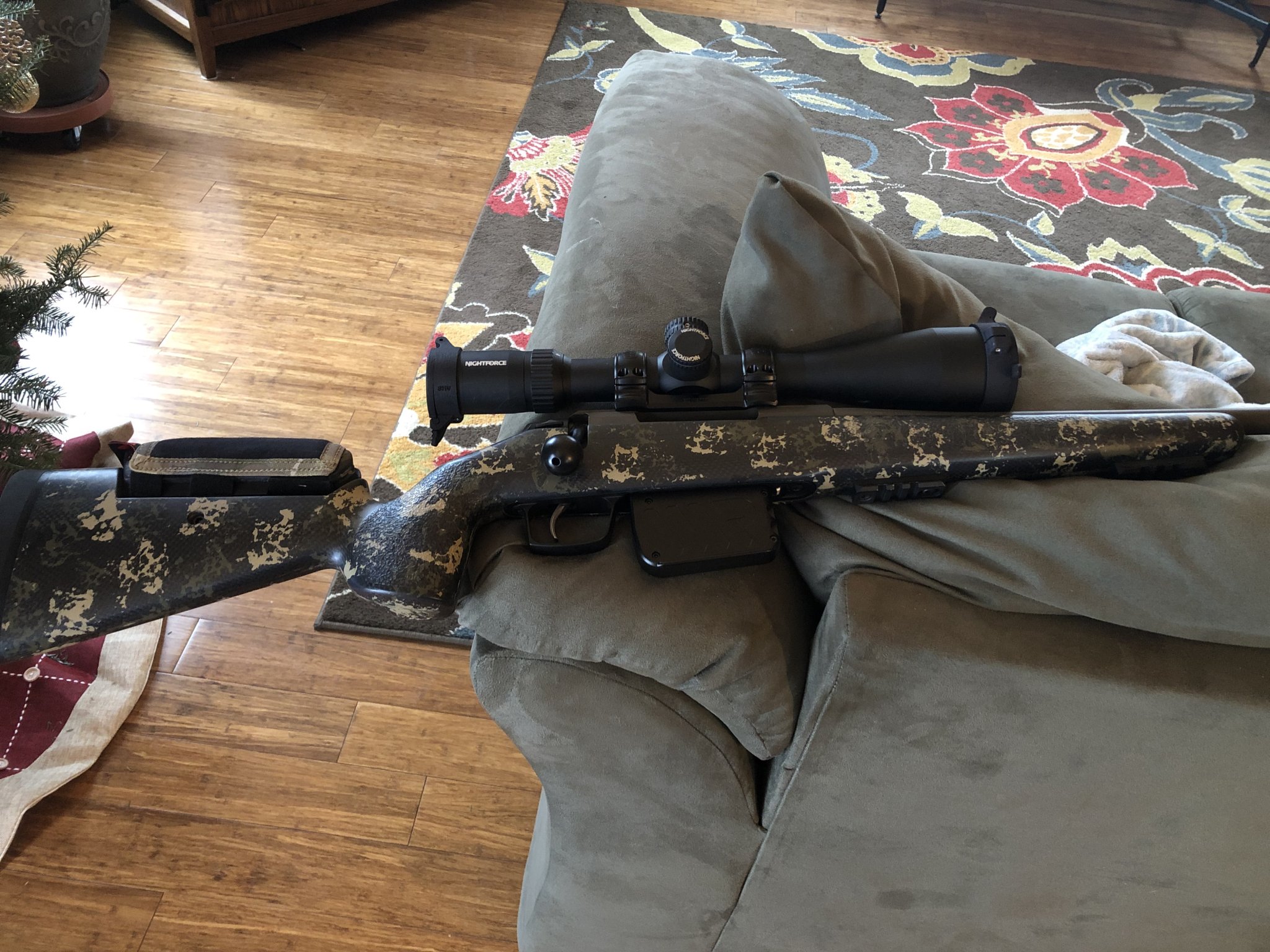

So I got myself an MDT Oryx on Black Friday.
I Kind of get the feeling that maaaybe the action isn't sliding all the way down into the chassis. Is it at all feasible that the recoil lug wouldn't fit in the slot in the T3 action? I don't want the action screws to have to take the recoil impuse, obviously.

It depends on how long you load your cartridges. Factory cartridges work in all as far as I know. So just measure the COL of what you want to use. If under 2.87" all of your mags will do. Above then the one without binder plate.

Thanks for the clarification. I’m new to bolt-actions, large calibers, and the AICS pattern so this is all extremely helpful.
I am using factory anmo for the next year at least until I accrue enough brass and knowledge to safely reload.
Do folks ever reload and still keep their COAL under 2.87”? I see that correlation a lot and didn’t know if there was a reason why people extend past that length when reloading

Depends on the throat. Generally you use a bullet comparator to get a base to ogive measurement and back a few thousandths of an inch off of it to back the bullet off the lands. The COAL is what it is and you can buy mags accordingly.
View attachment 7750021View attachment 7750023View attachment 7750025

Generally i think a 308 will be very tolerant of a jump. With some bullets you might not reach the lands if you want the bullet to be in the case. I go by the boat tail to straight junction of the bullet being where the neck transition shoulder meets of the case. I use that as a starting point. It has served me well with at least 10 308's over the last 15 years. I have never reached 2.87" yet as I only used 155, 168 and 175's.
One trick to find your lands is to take an empty case, put a very slight dent into the neck. Some 5 min epoxy only on the inside of the case neck then stick the bullet in about 1/8" and chamber that. Leave it chambered for half hour and you have a dummy. This will let you know where your lands are at which COL with that bullet. You can then check your jump with the shoulder meet boat tail junction method. All of my 308's shoot the same load very well from .2's to .5". All well off the lands.

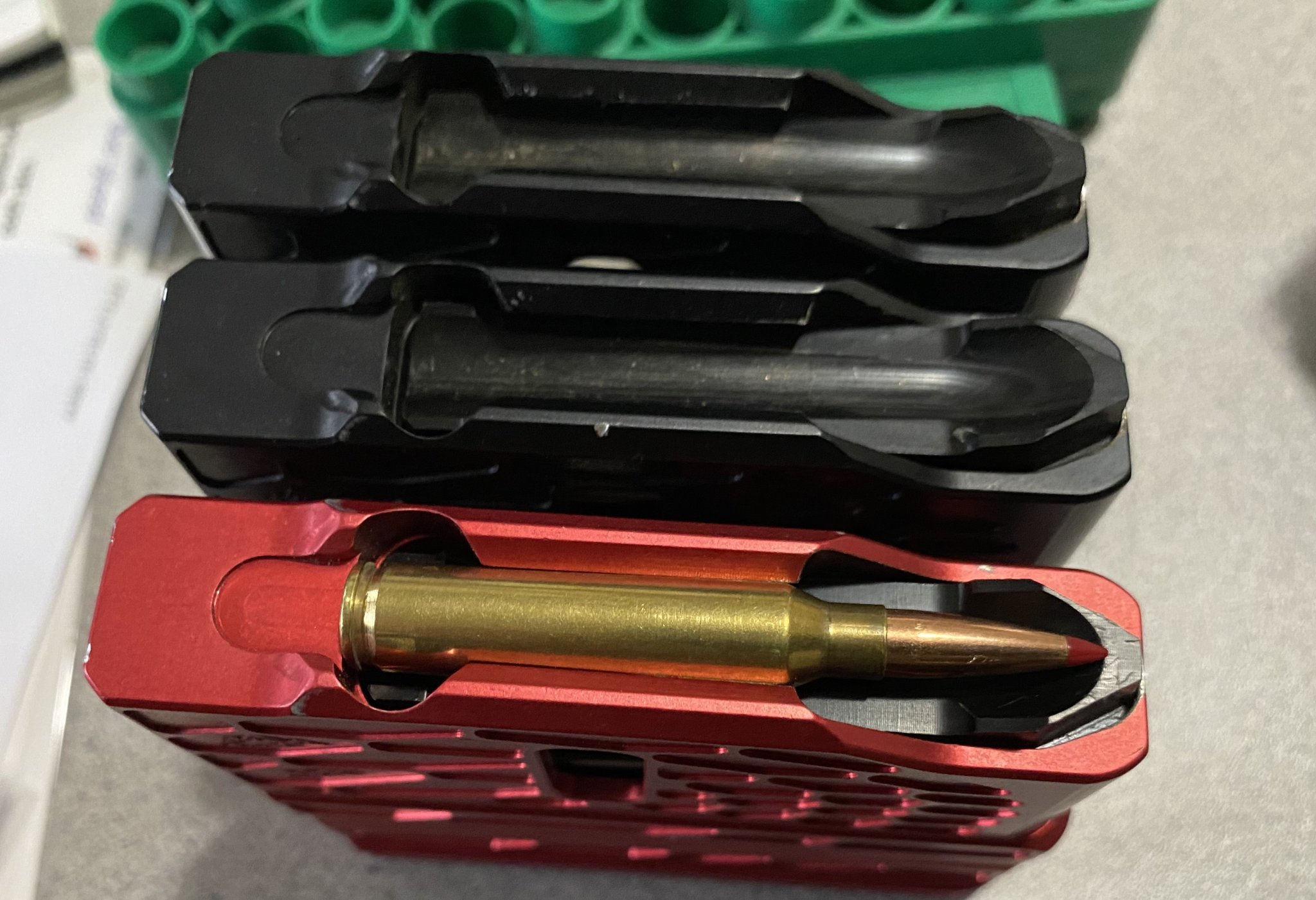

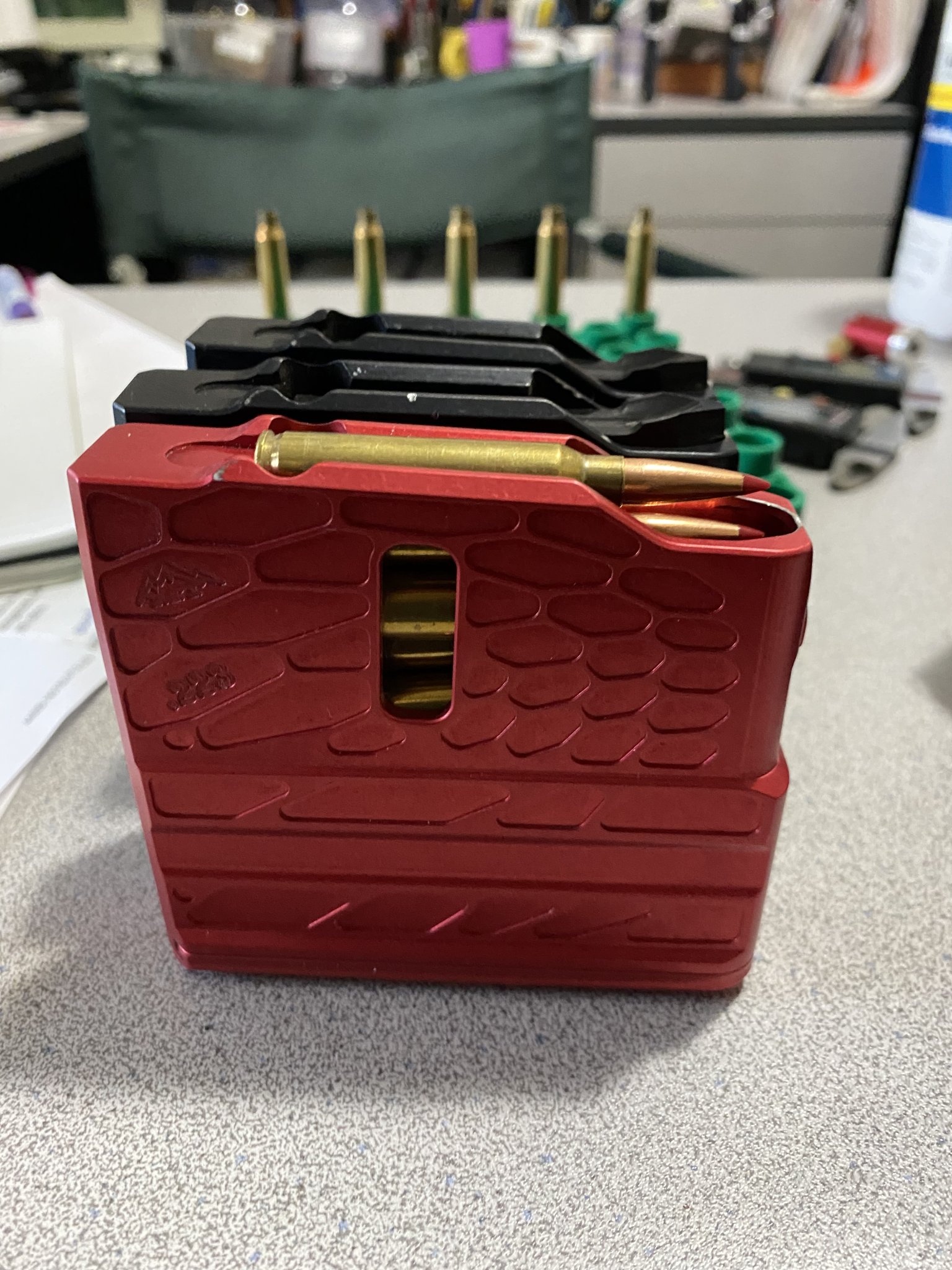

Here’s my Mountain Tactical extended magazines. They’ll hold 8 but 7 is more comfortable.
When loading 8 they all feed fine.
Max Mag length is 2.620”. The 75 grain ELDM pictured is loaded to 2.451”.
P
Those are definitely last gen mags. Don’t get rid of them! Hopefully they pump out an extended 223 mag of their newest generation but I’m not hopeful anymore.
