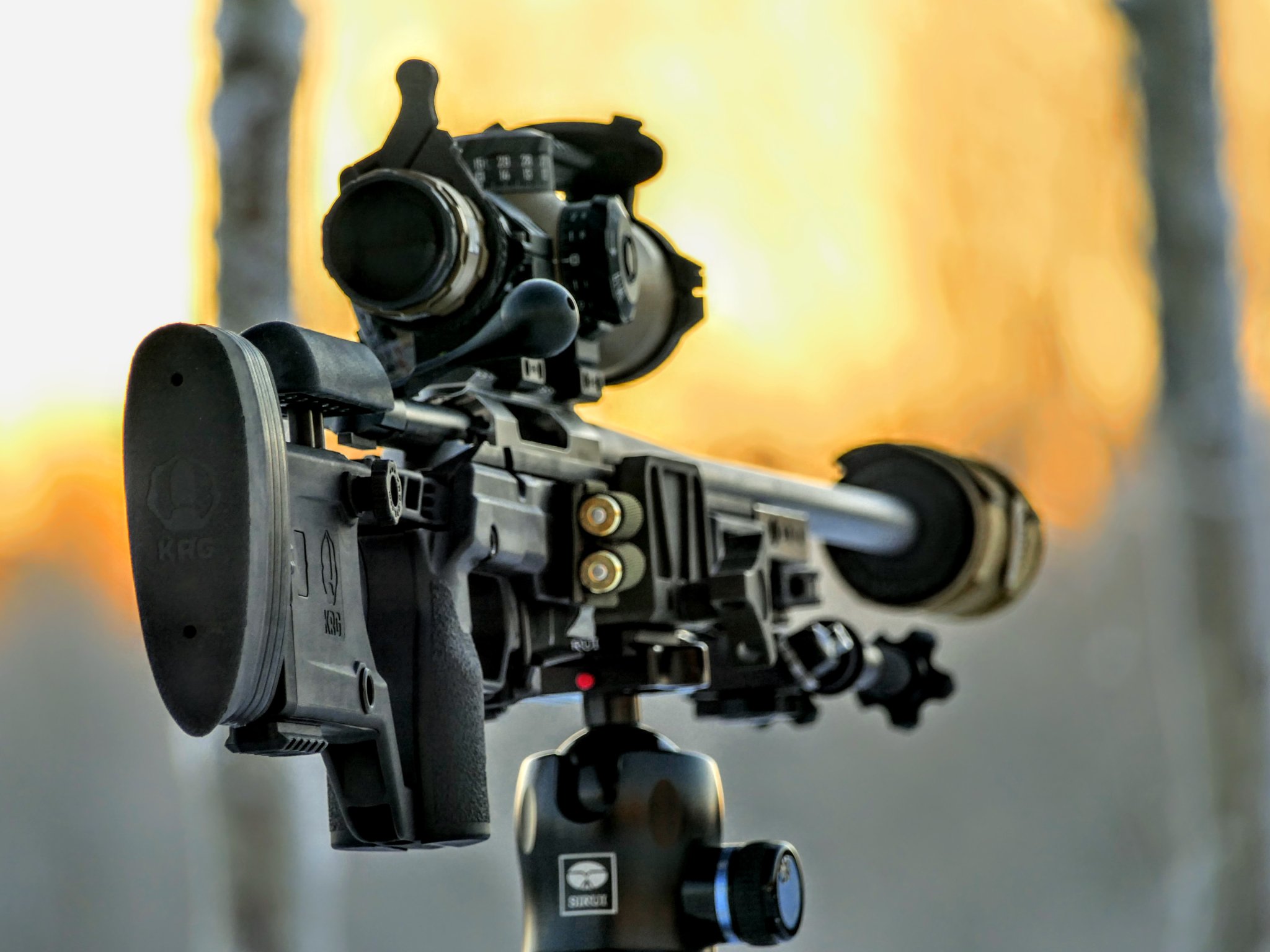

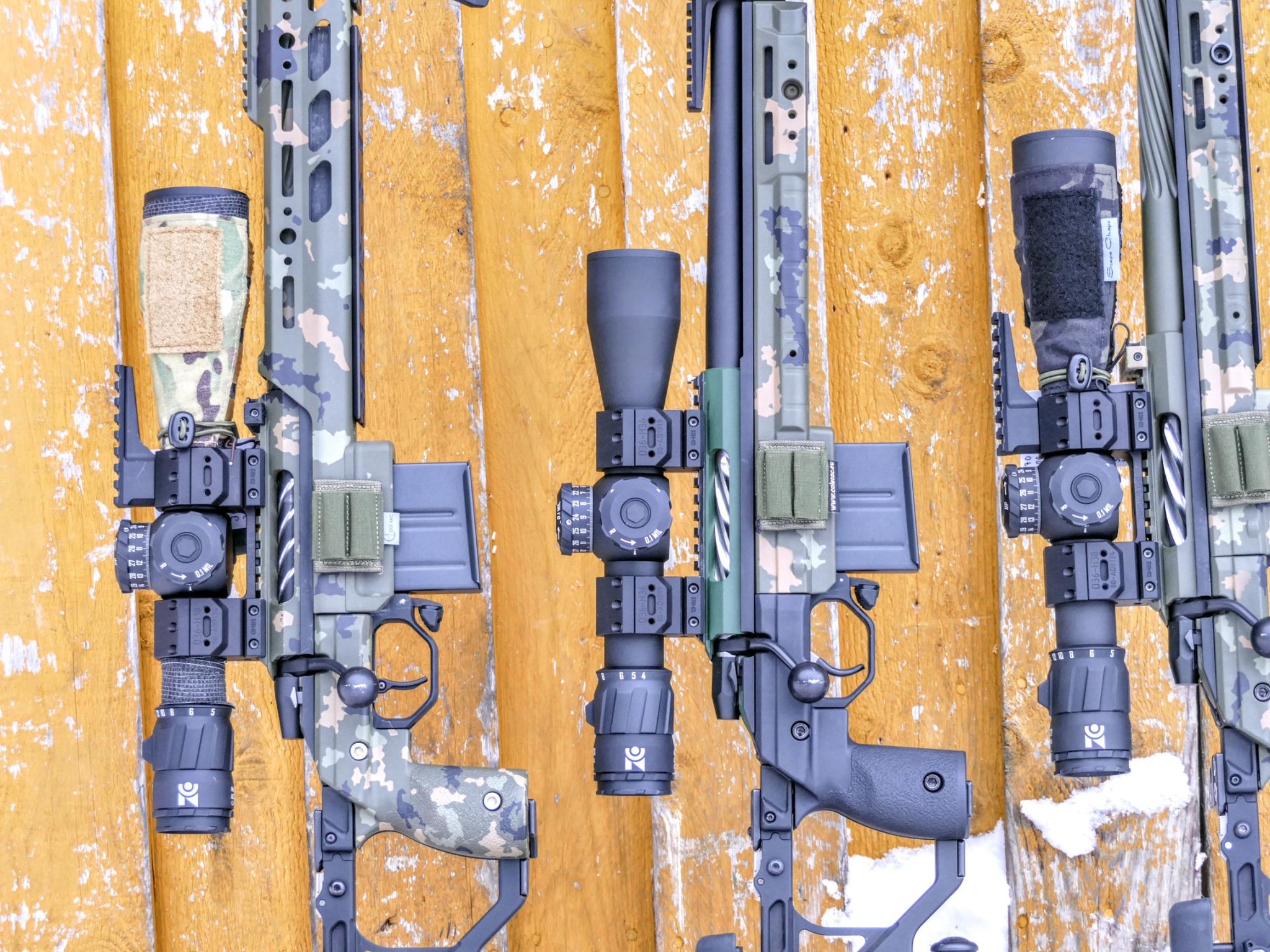

First test at the range.
Great product and love the bolt throw.
It might be the grs bifrost stock or my grip. But the sterk seems a touch too low. Gets a little in the way of my Trigger finger when 90°.
Anyone else experience this?
I have a LARGE hand, i have the the problem with the Sterk swept bolt handle.
I did modified one, and that is lovely, but i have 2 other of those too.
Really love the model and the hot it look´s.
But it does not work so well with the big hand.
John, this is something you could take on the "custom" section on the orders.
Add 10$ AU fo the job, but make it as a custom job.
I have a size 12 hand, the Sterk bolt handle is so sweet, just lift the trigger hand a bit, and the bolt is open.
But if i could add the option of the angle, i could do a rase it a bit and put it a bit closer to the shooter.
So that it would not stay over to the trigger hand.
Overall Sterk quality is top notch.

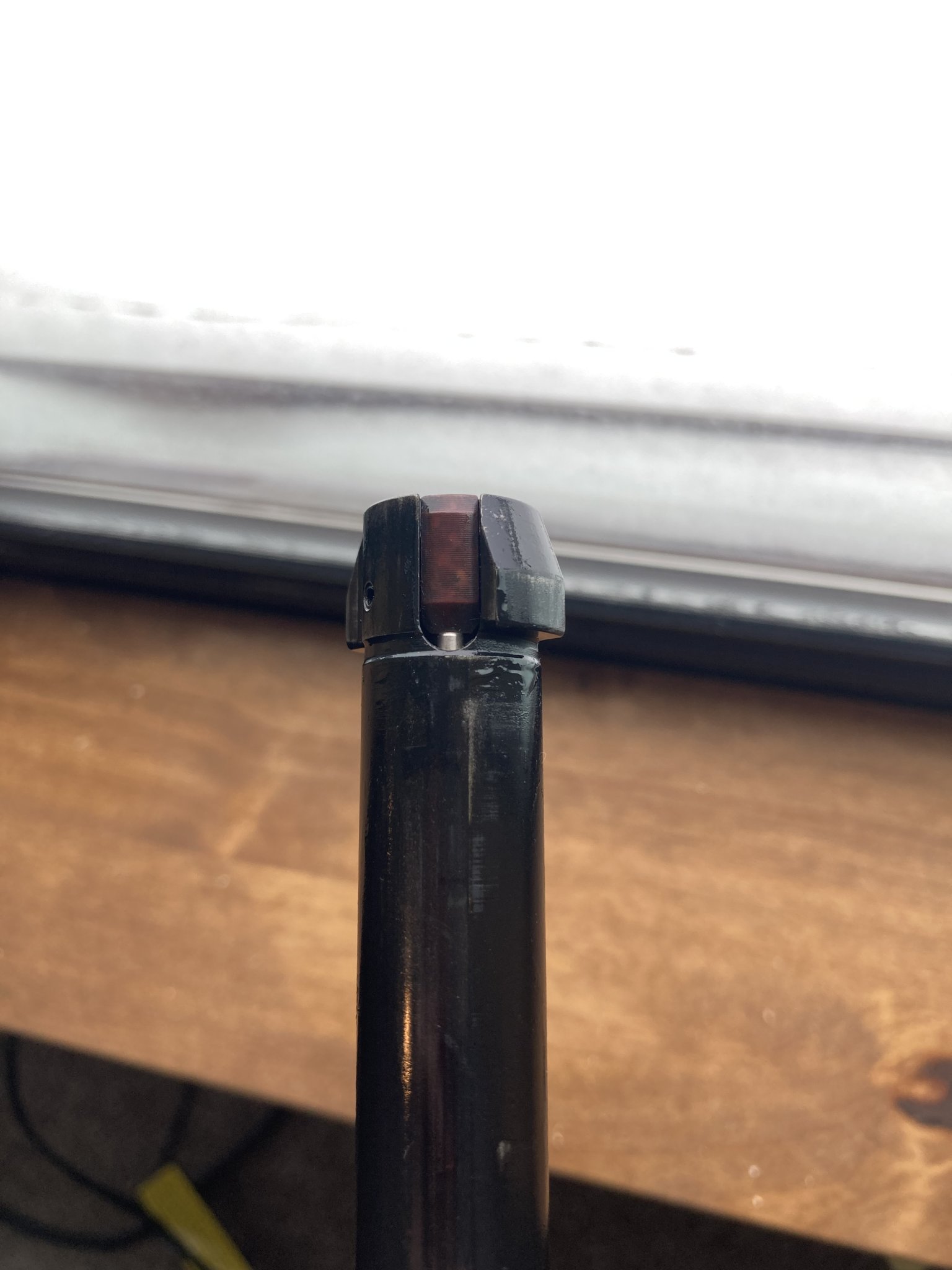

So noticed my bolt giving heavy resistance after my last range day.
Only when the firing pin has been released. Going through the rifle and parts. I discovered what appears to be treads visible. Where i have not seen any before...

Or there's no problem with your barrel at all and it's maybe an issue with your rifles cocking piece/ firing pin. Or heavy bolt lift on an uncocked T3 is normal because the action cocks on opening. And you just noticed it. Or you're shooting high pressure loads.
Things are pointing towards an issue with cocking/firing pin yes.
This is occurring during DRY Fire.
So pressure or ammo is not a issue.
Also had APX 3000 rounds through rifle before it became heavy. just after switching the bolt knob. Same problem with the original. As i have checked with both.
cocking/decocking, same happens with mine
bet if you cycle the bolt without dropping the trigger it will feel smooth

Ive had the problem before. It was an assembly error on my part when swapping the bolt handle.
Yeah could be.
Cleaned bolt, firing pin assembly and shroud with acetone. Then polished with steel wool. Dry fire runs smoothly now.
Gotta get some range time to verify all good 👍.
Still wonder about those treads by the chamber. Seems nobody else i talked to has them🤔

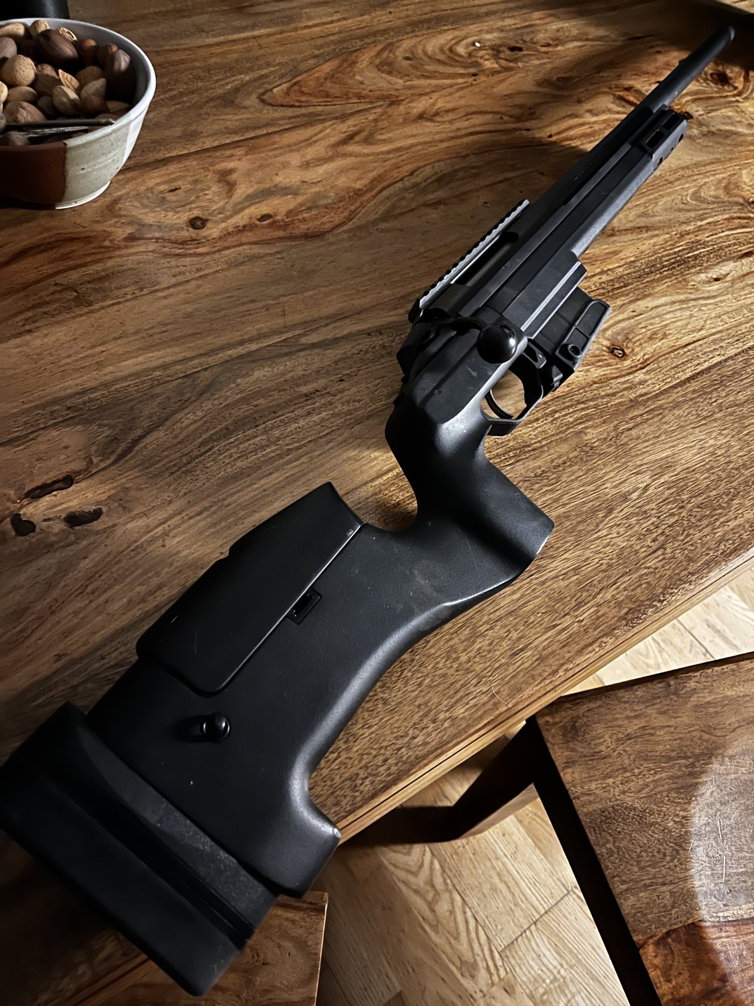

I have big hands and unfortunately the Sterk swept is not for me. Unfortunate because it's a nice product and the gentleman that owns the business seems to be a class act. I am able to use the everglades swept handle pretty comfortably though. Finish isn't quite as nice but I am happy with it. If you're big ass knuckle is hitting the Sterk, try the everglades
That handle can be modified, i have done that.
You need a gas torch to heat the metal on the handle swept area, then carefully bend it to the way you want, i did straighten it slightly, and now it is perfect.
Need to do this for the 2 other swept handle too, only thing you loose the cerakote, but that can be redone.
Mod Sterk Swept on the left.
Once you do that, it is one bad ass handle, just love it, and the look of it.

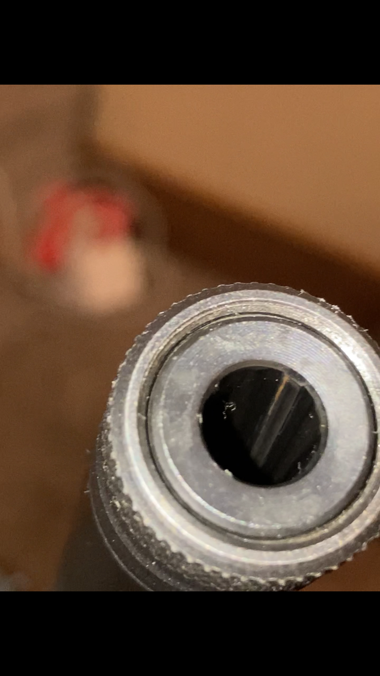

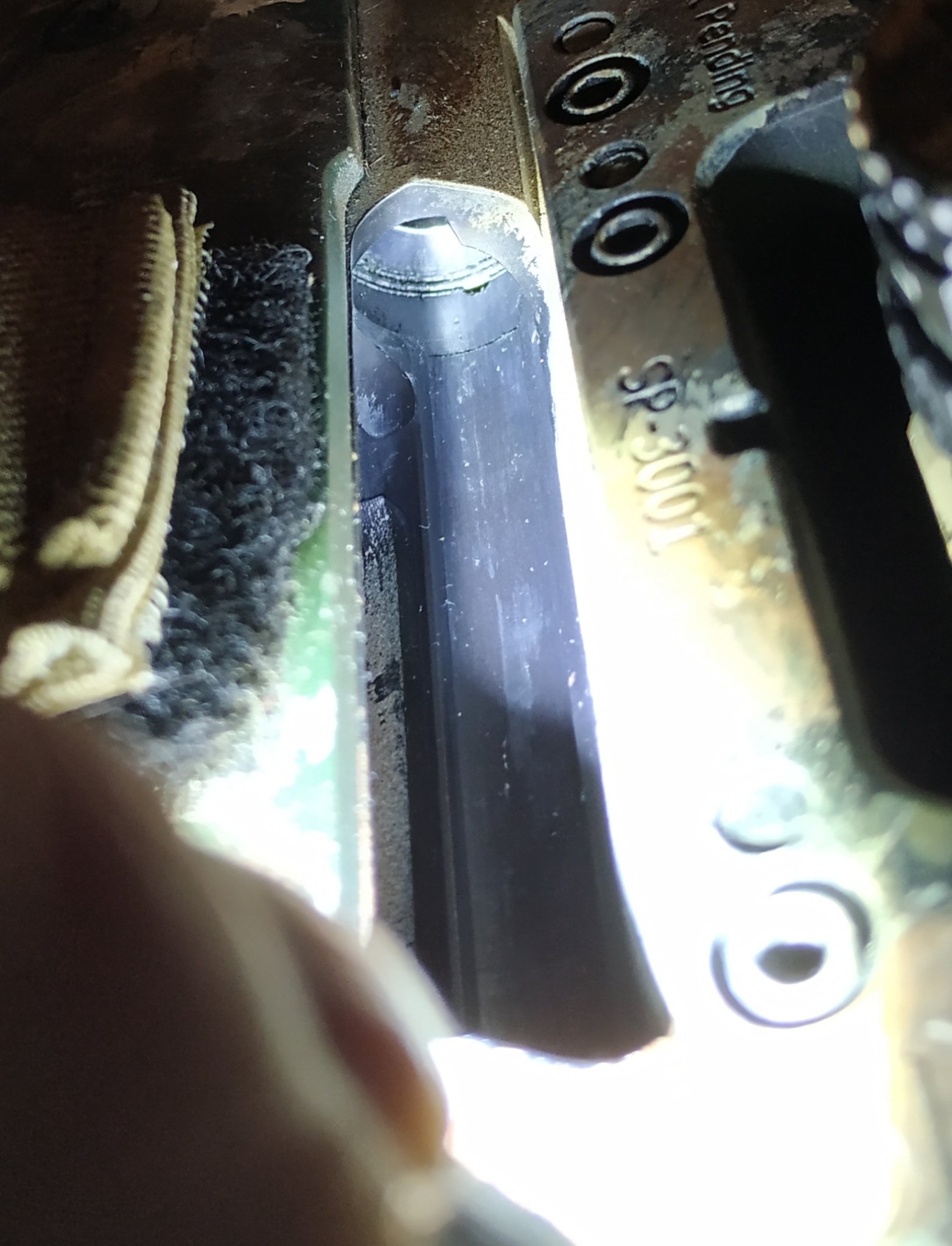

Can anyone help me ID if this is rust on my tikka bolt?
I have never dealt with rusting before. I am on family trip that took 15 hours to get to Idaho. There was snow and rain throughout. We had to leave the bags in the car overnight and it was 20 degrees.
My gun bags were supposed to be in a weatherproof type bag but I noticed a bit of surface rust on the outside of my Tikka barrel and a bit on the steel Leupold scope base.
I used CLP to get off what I could and plan on using 0000 steel wool in the next day or two to remove what remains. The rifle is coated in CLP for safety now. Lesson learned.
I wanted to see if this bolt face/extractor is rusted as well since it has that color? I couldn’t get it off as of now and can’t remember if that is always the color of it.
FWIW my AR didn’t get any rust on it whatsoever during the trip outside of a QD sling swivel so I am thankful for that.
Since this rusting started am I destined to be fighting rust off of it from here on out?
Looking for thoughts, opinions, and guidance moving forward.

Its normal, all 4 of the extractors on my Tikka bolts look like that.
Reactions: white_rushin
Are you getting any colour on a white rag when you wipe it down? If not is fine...
FYI, if you have aftermarket pic rail...check under (ie remove) your pic rail unless its full epoxy bedded...you may have water between action and rail...

No color so far. I’ll see if there are any different results once I use the steel wool. It was all very minor so I’m over exaggerating how bad it was most likely.
I’ll do a full disassembly including removing the action from the KRG to make sure there’s no rust on the underside as well once I get back from the trip

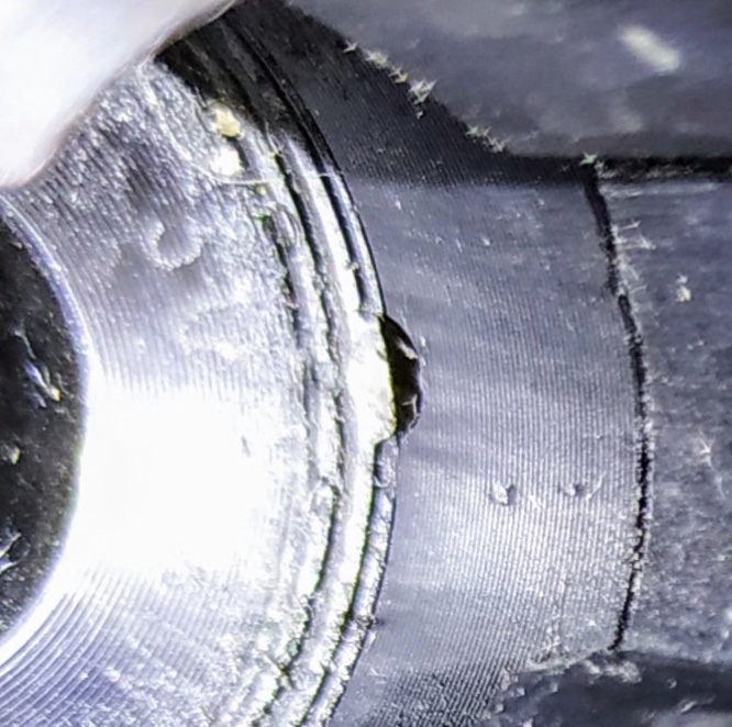

Hello all, it’s the rust guy again, back with another question. I took a look at the bore where I could and found some discoloration. Do you all suspect it’s copper fouling or rust?
Clean that rifle, oil it lightly, then dry rag it, then lightly oil for storage and dry rag before next session.
