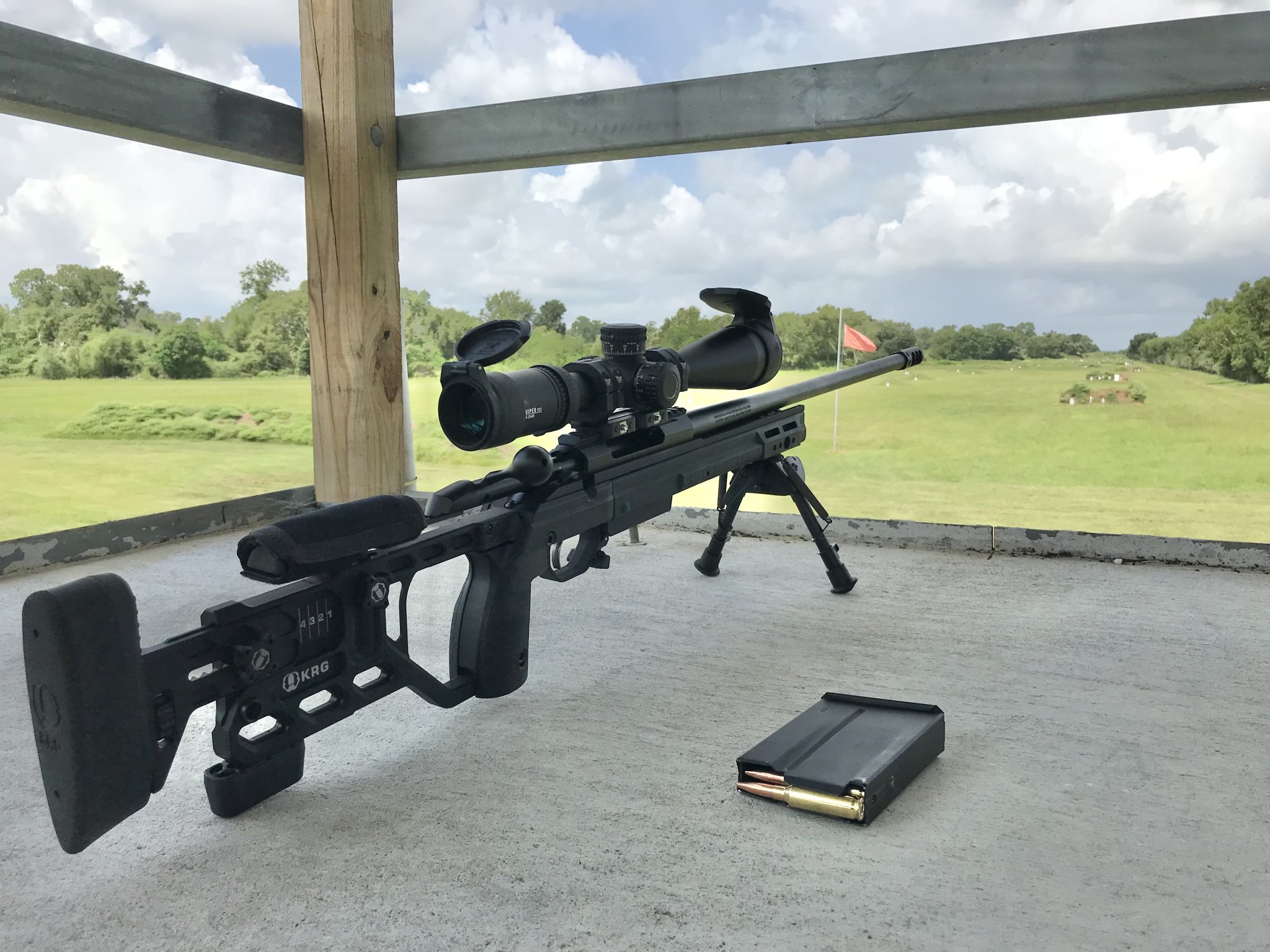

If i want to use a KRG chassis on the 6.5PRC, magazine will be doing some gray hair.
Nevern hold these XM magazines on my hand.
Is it bigger on length as AICS SA magazine?
Will it fit inside the mag well of SA.
If it not much bigger, i think it could be able to tuned in.
Also MDT AICS with out the binder plate might work with some bullets.

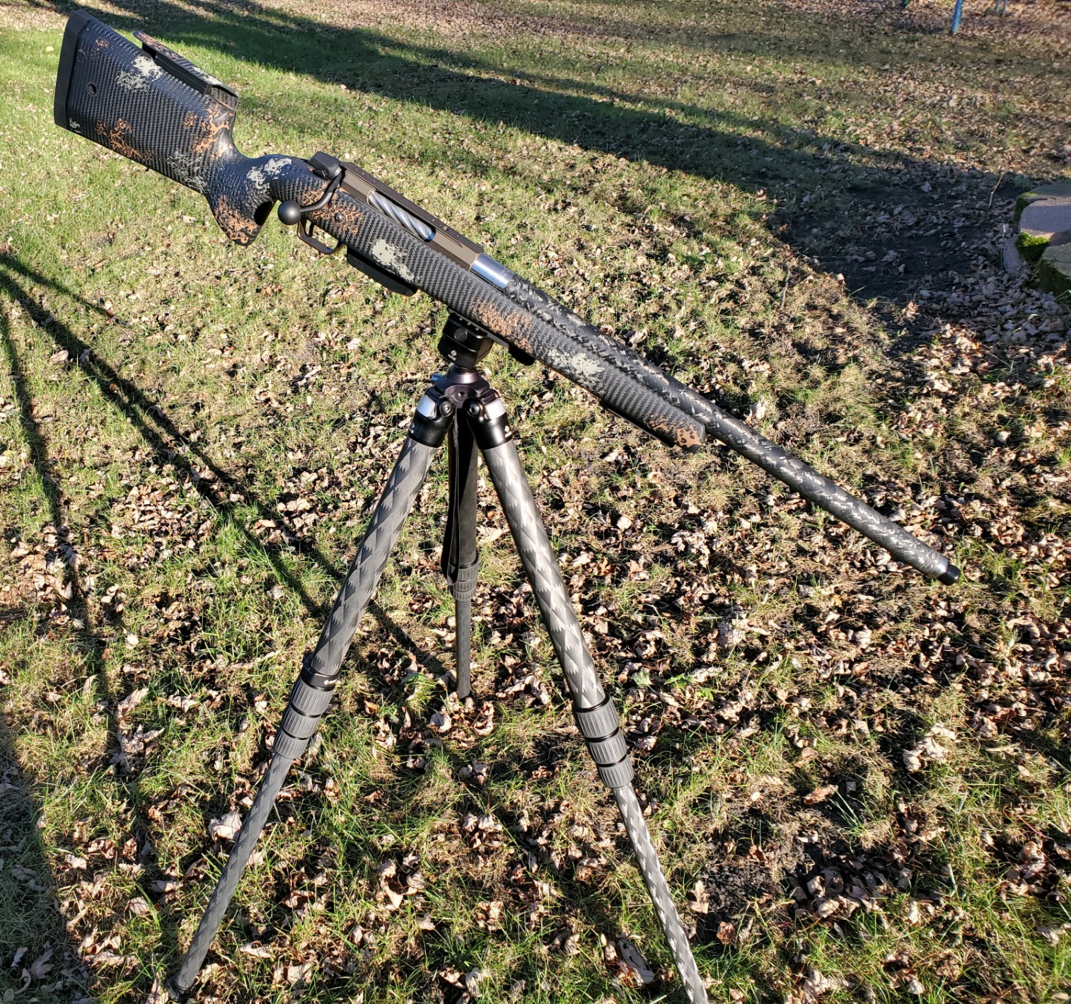

What started as a factory Tikka Wideland in 6.5 PRC.
Updated specs:
Tikka action
Manners new Tikka stock with MCS for factory Tikka mag use and minimalist cheek.
High desert matching cerakoted bottom metal
22" Proof CF 6.5 PRC
Sterk bolt handle and shroud
Timney 2 stage Tikka trigger
Rifle 7.5lbs as pictured

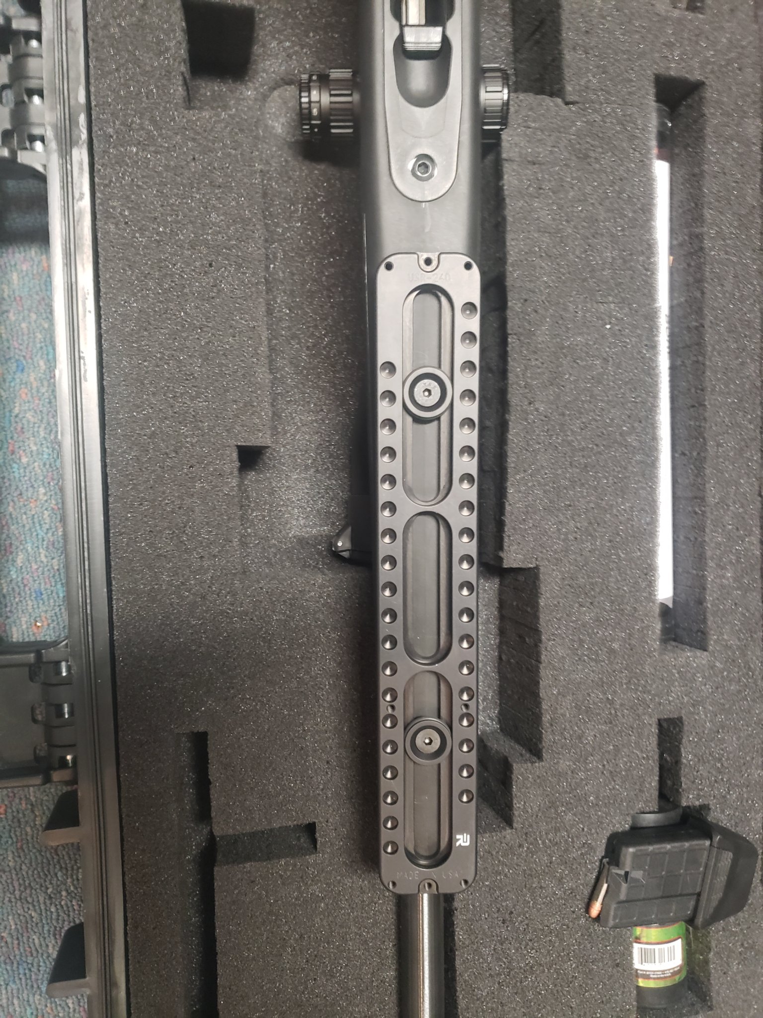

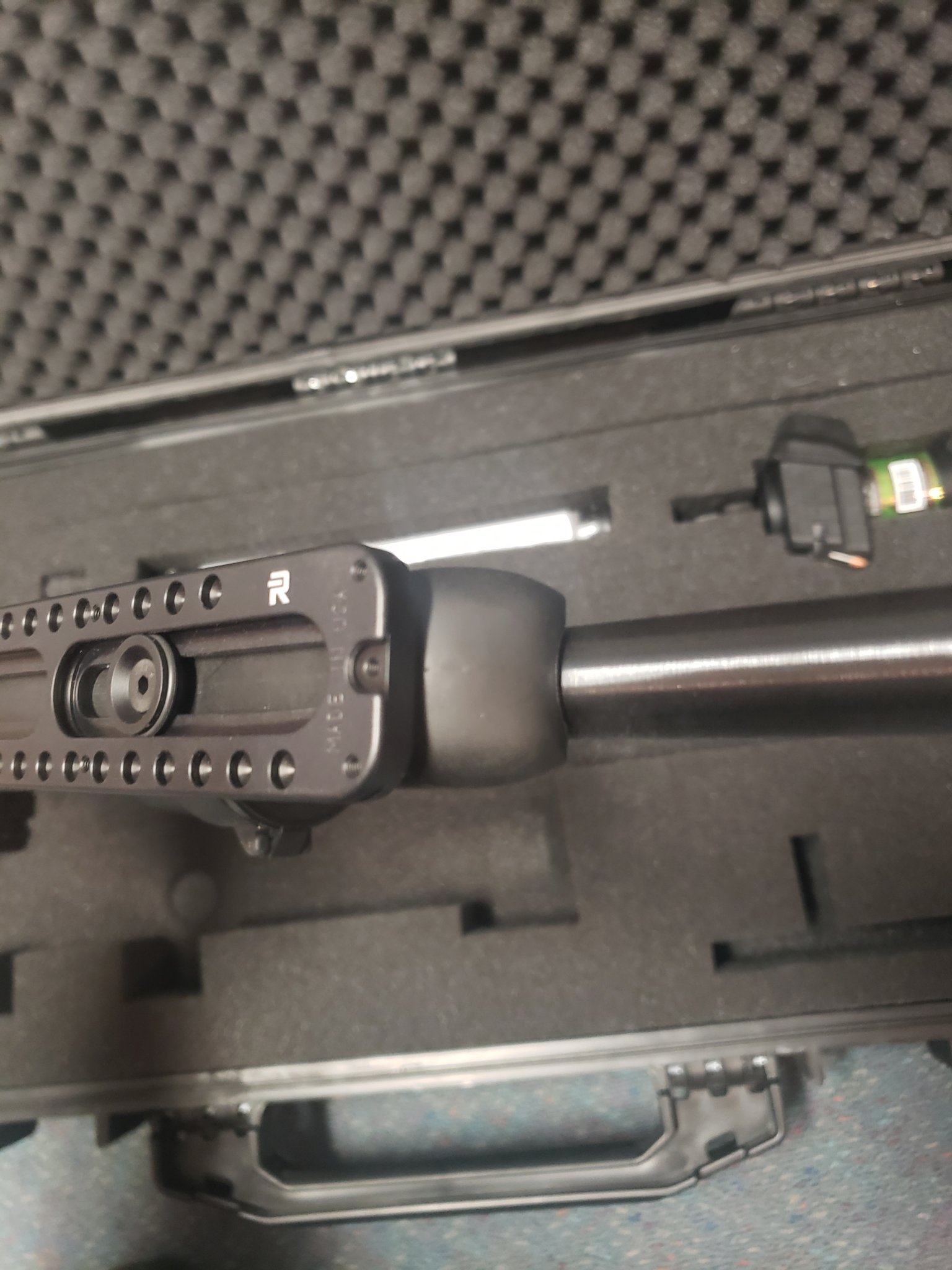

@DanoC33 I finished up installing the rail and tried a few fastener options out. The Really Right Stuff 240mm arca rail fits very well onto the factory T3X and T1X stock - no drilling needed. The existing swivel stud and existing screw are too short to work well. If you wanted to keep a swivel stud available and also use the rail the longer swivel stud from this kit will work. You can still attach a sling to the swivel stud while the rail is on. If you want screws instead, these 10-32 1" alloy steel black oxide screws work well. The 1 1/8" screws are too long. 7/8" might work as well. I went with the 1" length.
Also, the Caldwell pic to swivel stud adapter is neat, and also works quite well for a bipod attachment.

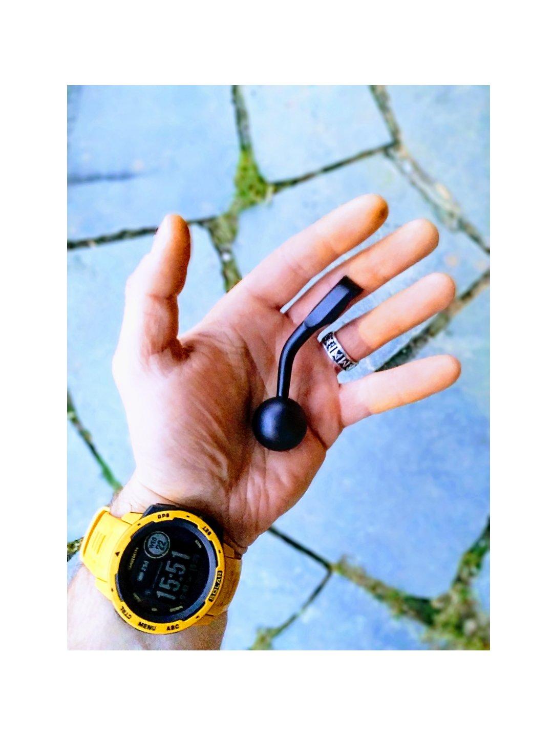

It might be the grs bifrost stock or my grip. But the sterk seems a touch too low. Gets a little in the way of my Trigger finger when 90°.
Anyone else experience this?

The stock is probably playing into that some since the GRS positions your hand rather uniquely. I've never noticed my sterk handle get in my way.
