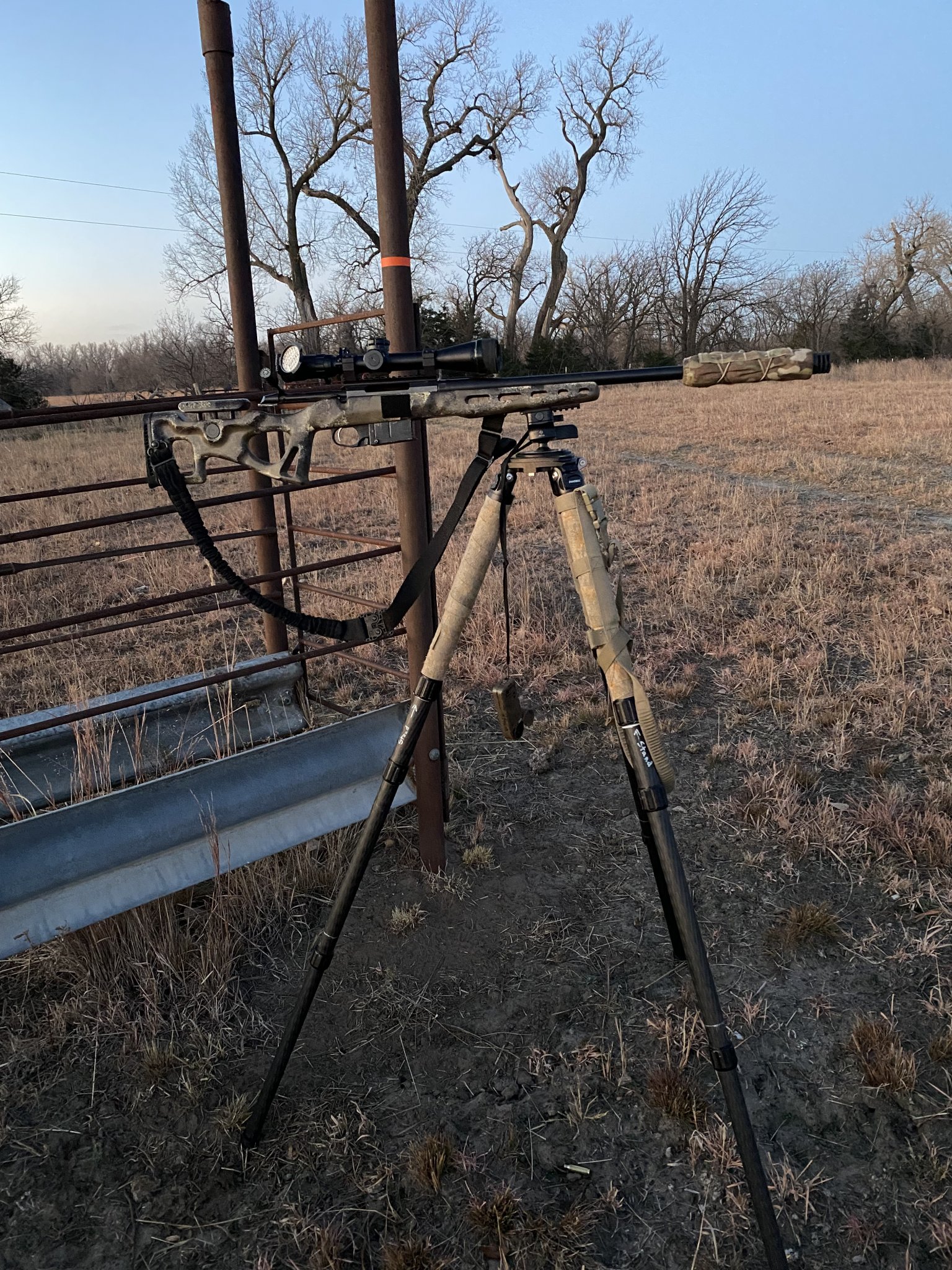

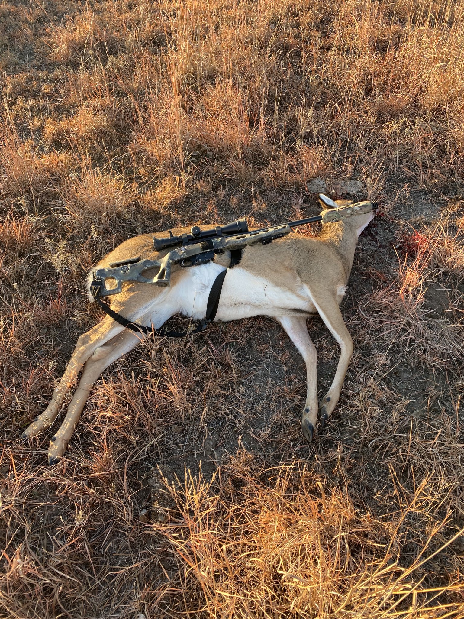

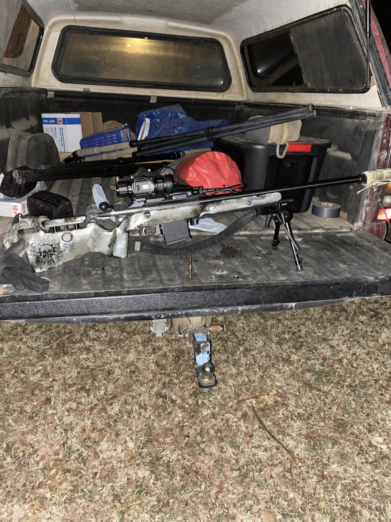

Wife killing it with the .308! 1.5” groups of the tripod standing at 100y and 4” at 300y. And like a retard, I did t take pics of the groups 🤦🏻‍♂️. Really liking this Tikka.
Liked the Remington 700P’s I’ve had Especially the older one, but I don’t see me going back to Remington any time soon.
Two targets under the arrow. 10” gong and an IDPA with B8s

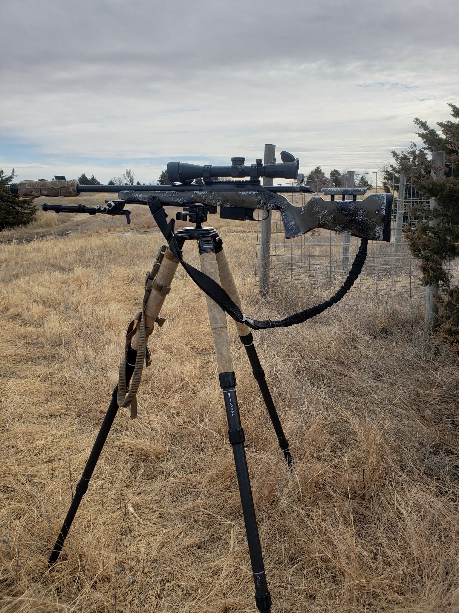

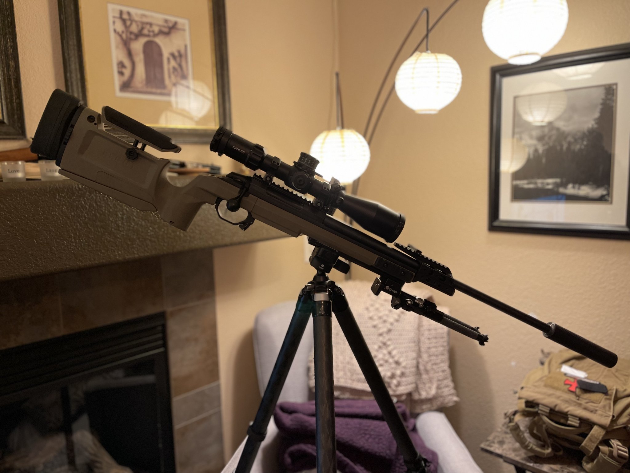

Take a look at the German Gun Stock offerings. They have several models to choose from and they all have an aluminum mini-chassis. I like the Reaper and Ranger for hunting. I used the Reaper for an NRL Hunter match. They have a Veloci-Raptor that is more of a competition stock.
The first two are the Ranger, the other is the Reaper. I added the Area419 rail to the reaper. Their competition version has M-Lock slots on the forend. I had them inlet for CTR bottom metal and I use Mountain Tactical CTR/AICS bottom metal when for my 223 and 22BR/6Dasher.

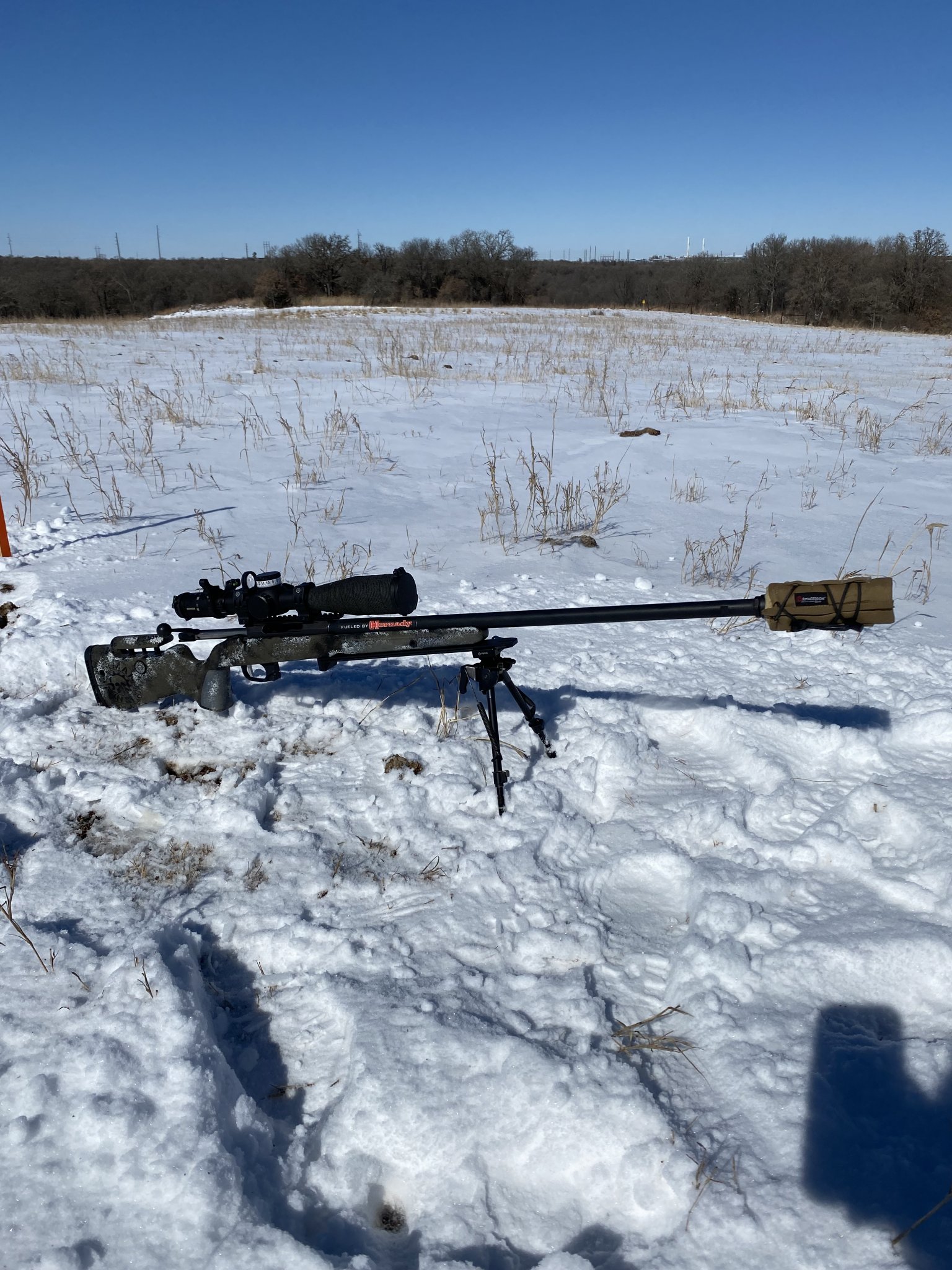

A few more of the Reaper with a 223 Varmint and my 18" 6.5 Creed with a medium palma Bartlein. I used a 28" heavy palma for the NRL Hunter match.

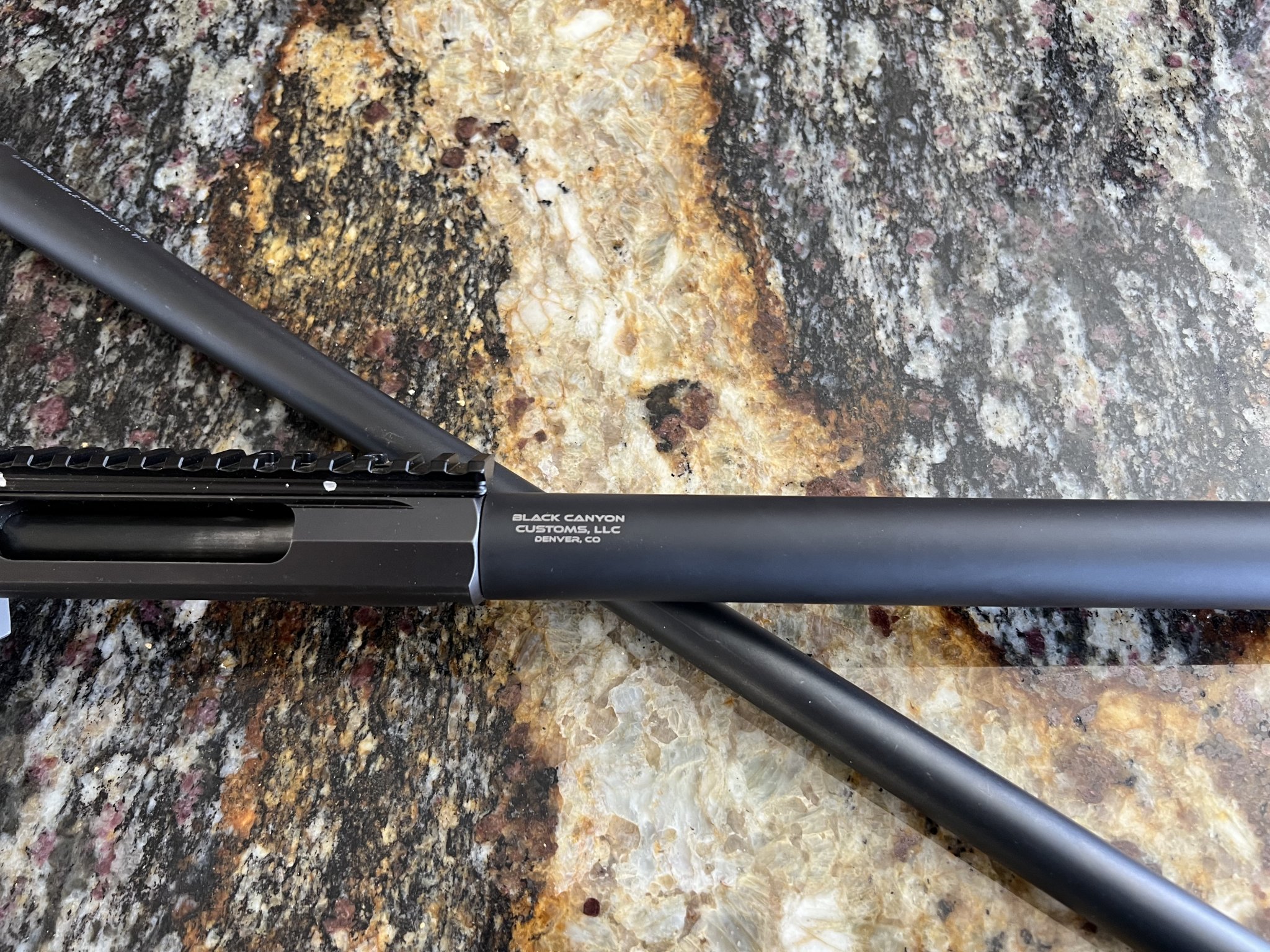

Can someone tell me the diameter of the T3X receiver between the flats and between the corners?
I figure based on most of the barrel shank diameters the flats are 1.19-1.20. Do not have an receiver in hand yet but want to get the barrel ordered.
I am wanting to use a barrel shank the diameter of the corners and mill the barrel to continue the receiver flats onto the barrel shank. (Of course after milling the radius off the front of the action.) Think it will give it a good look and as it will be chambered for WSM the extra steel will not hurt as its a .375 cal.

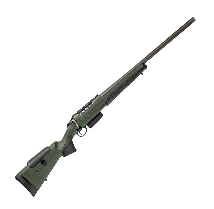

Greetings to all,
I have been around but no posts since i have not had the means to enter this wonderful world. Well as it stands i am about ready to pull the trigger as they say and my choice was a tikka t3x supervarmint chambered in .308w that i will use for hunting from stands and target plinking(mostly plinking) now just about when i decided i found out they are offering the following
TIKKA T3X SUPER VARMINT GRTECH, cal.308 Win​
now trying to find out what is "GRTECH" in that. Is it cerakote finishing on a ss barrel? or stock material it is covered in? Or something completely different?
The shop i called could not really give me a definite answer so i am hoping some of you here might be able to help.
If i am not mistaken it has a 2 stage trigger, 24" barrel, threaded, adjustable cheek piece.

Stock is Green Roughtech finish....

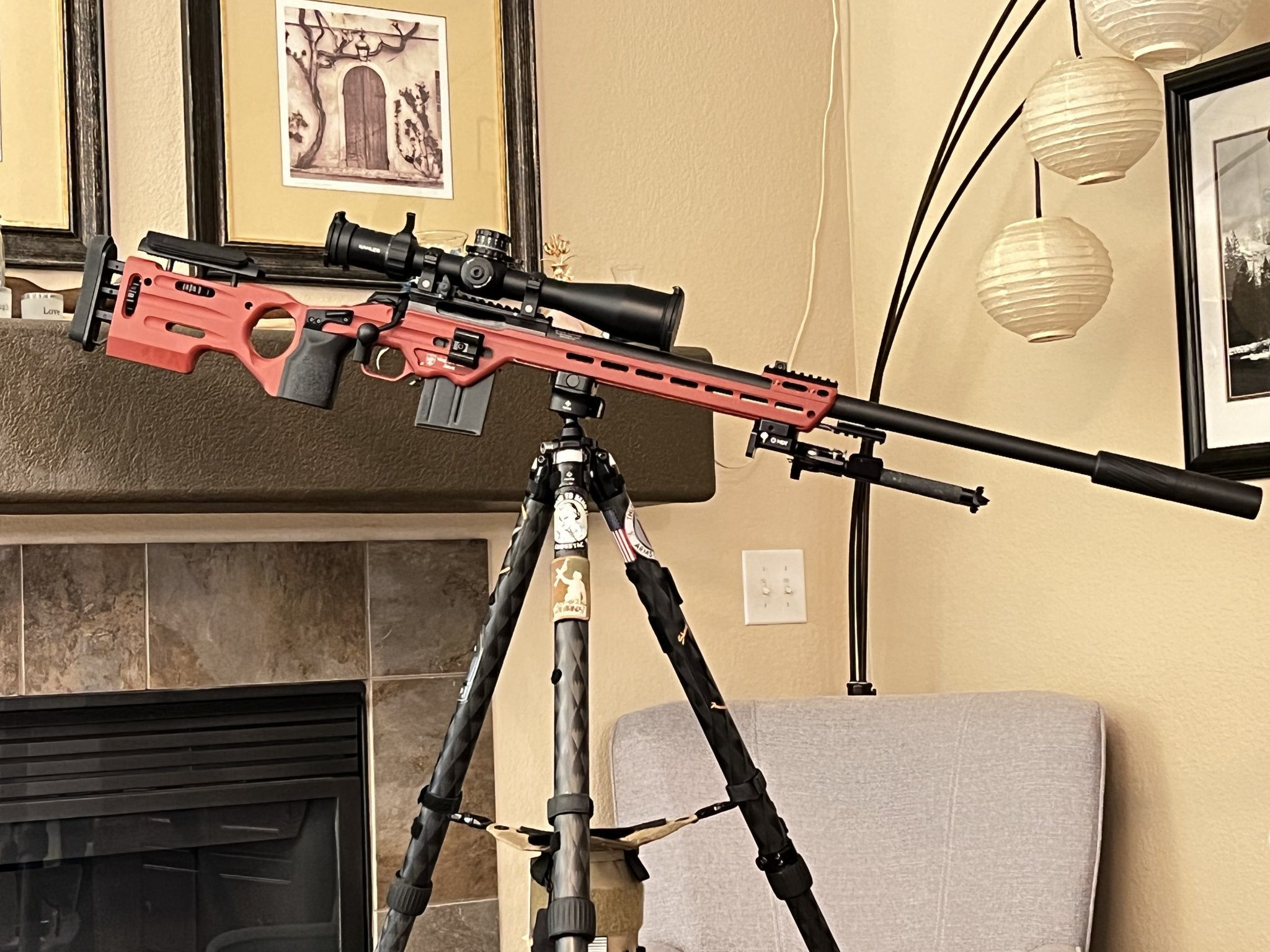

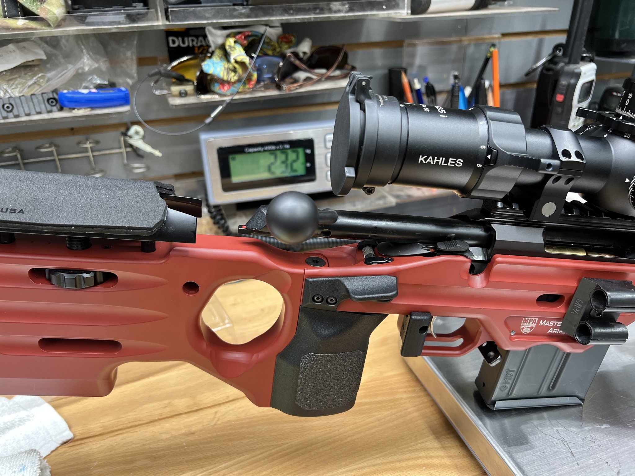

OK, an update from prefit hell (not really). Spoke with Proof, since it was below SAAMI max they didn't see a huge issue with it, provided it was performing. So I shot it today, 60 rounds. No issues w accuracy, 5 round groups yielding a 0.48 average so I'm happy for now. It did seem to group really well for 3-4 rounds (0.25-0.3MOA) and have one flyer, but I'll put that on me. Going to chrono around 100 rounds, apparently these barrels speed up around there and may see some accuracy improvements. Hoping for 2700-2750fps out of my 22" barrel.
With the Proof barrel in the Spuhr chassis, she's sitting at 14.8# loaded with 12 rounds as pictured here. Definitely happy with where things shook out overall with my first deep dive into bolt guns.
That is one good looking setup!
Thanks man. Just got back from a MDS 2 day course with Phillip and Ryan of Achilles Heel Tactical. Things worked really well, was fortunate to win top shot among a bunch of studs, and I learned a ton.
I had used the factory chassis in a similar course in May on the exact same range so I was interested to wring out the new setup. The rapid adjustment on the LOP was a definite improvement for the varied positions we shot from, and the large barricade stop on the magwell provided enough standoff on things like corrugated barrels, even with AICS 12 round magazines. The bag rider is also a great design, that 'notch' being up front allows you to have your forearms perpendicular to the gun (helps keep me squared up) while building that bridge and getting even pressure rearward.
Full arca, longer enclosed forend, and lower rail/optic mount all yielded obvious advantages as well. Not in love with the cheek piece but it's better than stock. All in all, huge improvement over factory chassis.

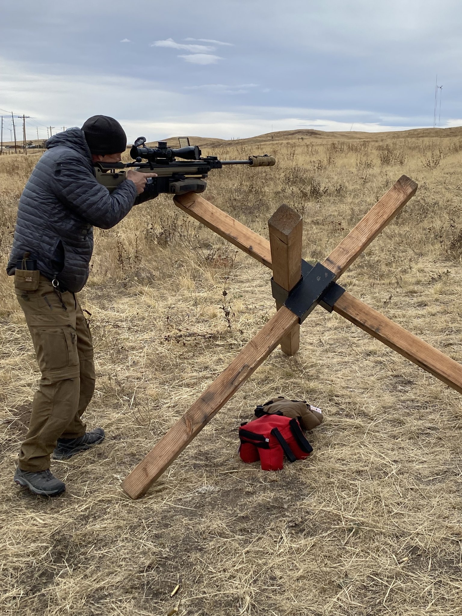

So far I've had it on a: barricade (wood), tire, corrugated pipe, on a railing, through a window, on a car hood, and off a roof. It's been quick to get into position and comfortable pretty much anywhere. Sitting at 15.2 with the new optic so it's still easy to maneuver but heavy enough to be solid.
The stock is different for sure, like I said on the last page I like that forward 'notch' as it keeps me square and I'm not reaching my support hand to the back of the stock or relying 100% on my rear bag to be pushing back/up on the stock.
Here's another look at the back end. This is typically where I have my bag, support hand can get on the stock in a forward position (in that notch) and can also control the bag easily which offers a ton of support on the long bag rider, filling the negative space.
